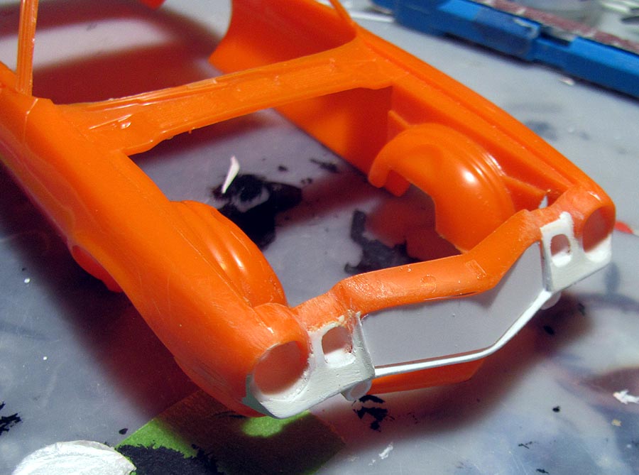

MarkJ Posted June 20, 2021 Author Posted June 20, 2021 Starting on the grille. Traced the grille opening directly on the styrene sheet to be used. Will be putting a border around the base to install the grille bars to.

MarkJ Posted June 21, 2021 Author Posted June 21, 2021 (edited) Thanks, David and Mike. I started on the fins, but will have to start over because my process was not making them equidistant from each other. I think I have come up with a plan that will work better, that I will try today. If you look at the last picture you will see that the fins are not evenly spaced apart and I used too many fins. Won't be the first time I have had to do a redo on this project.I know the fins are too wide, too. But I did that on purpose so I would have something to grab with the tweezers to put them in place to glue. I was going to trim them down later. Edited June 21, 2021 by MarkJ
MarkJ Posted June 22, 2021 Author Posted June 22, 2021 I tried to salvage the grille, but it was too far gone. So i had to start over. I found a head on picture of the grille. So I made it 1/25 scale picture of it and am using it for a pattern to install the grille fins. I got all the vertical fins done, so now on to the horizontal ones. There's a whole lot more of them to do, but I think I have a good process now, to get it done. Won't be like a kit grille, but I think it will work . The real car did not have a chrome grille, so this should look better in some ways.

MarkJ Posted June 23, 2021 Author Posted June 23, 2021 (edited) Thanks Rusty and David. The only problem is, I have to make 98 little pieces of grille to do the horizontal part of it. I just needed 13 vertical fins. Needless to say this will be the last grille I make, unless its a fine mesh one that I have the material for. That would just be a one piece grille with a border around it. Edited June 23, 2021 by MarkJ

bisc63 Posted June 23, 2021 Posted June 23, 2021 Instead of making all those grille pieces, why not just make continuous length pieces that are the width and contour of the grille, then mark the location of the vertical pieces on the backside of these. Mark the location of the horizontal elements on the vertical. Take a hobby saw that cuts a kerf the sane thickness as your plastic, and saw half way into the pieces; on the front of the vertical, and the back of the horizontal. Essentially, making half-lap joints that lock everything together. Just a thought...

MarkJ Posted June 24, 2021 Author Posted June 24, 2021 14 hours ago, bisc63 said: Instead of making all those grille pieces, why not just make continuous length pieces that are the width and contour of the grille, then mark the location of the vertical pieces on the backside of these. Mark the location of the horizontal elements on the vertical. Take a hobby saw that cuts a kerf the sane thickness as your plastic, and saw half way into the pieces; on the front of the vertical, and the back of the horizontal. Essentially, making half-lap joints that lock everything together. Just a thought... Thanks , Rusty. I tried that but my 2 exacto saws, both cut, way too wide a kerf for the .010 inch thick plastic I'm using. Plus marking and cutting a piece of thin plastic that long accurately is way above my paygrade. But thank you for your input. it is most appreciated.
MarkJ Posted June 24, 2021 Author Posted June 24, 2021 12 hours ago, TransAmMike said: Wow Mark, your patience working on that grill is awesome. I could and would never attempt that? Thanks, Mike. So far I have done 4 rows of horizontal fins, so I have 10 more to do . It is frustrating , painstaking work and will probably look terrible when finished. I might just cover over the grille with sheet plastic and make a decal to represent the grille. The real car had a fine mesh screen over the grille but my mesh material is so tight you can't see the fins behind it like you could on the real car.

MarkJ Posted June 25, 2021 Author Posted June 25, 2021 As you can see its not looking real promising. I'm going to go ahead and finish this and see what kind of fine tuning i can do. After that I might just have to rethink the whole grille process. Maybe a fine mesh grille screen which would not be correct would allow me to at least finish the build.
