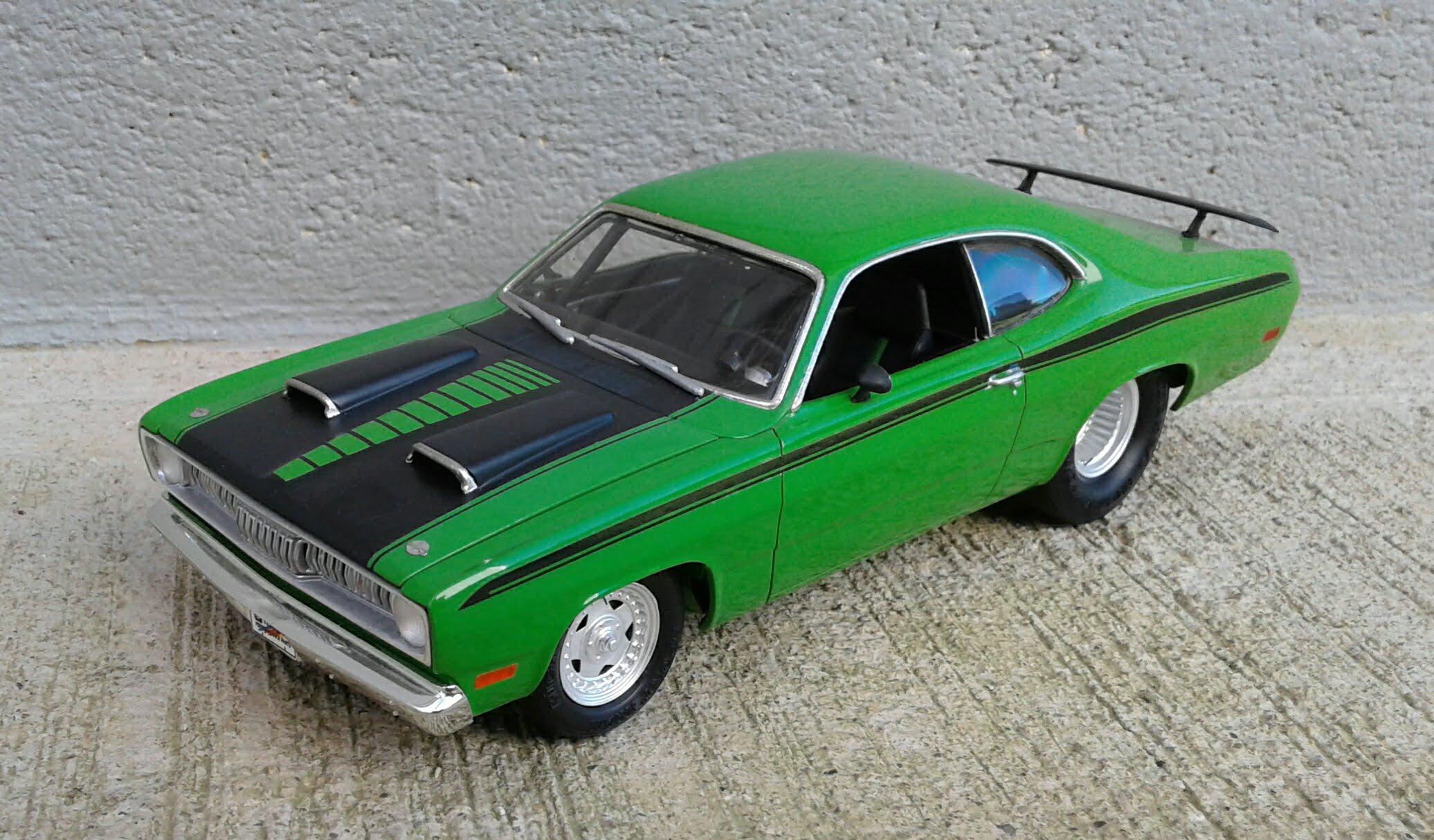

Plowboy Posted September 11, 2021 Posted September 11, 2021 The hood/cowl on this Duster was done with Model Masters Go Green, Satin Black and Tamiya tape. The pinstripes and strobe stripe are paint. There's no better masking tape out there IMO.

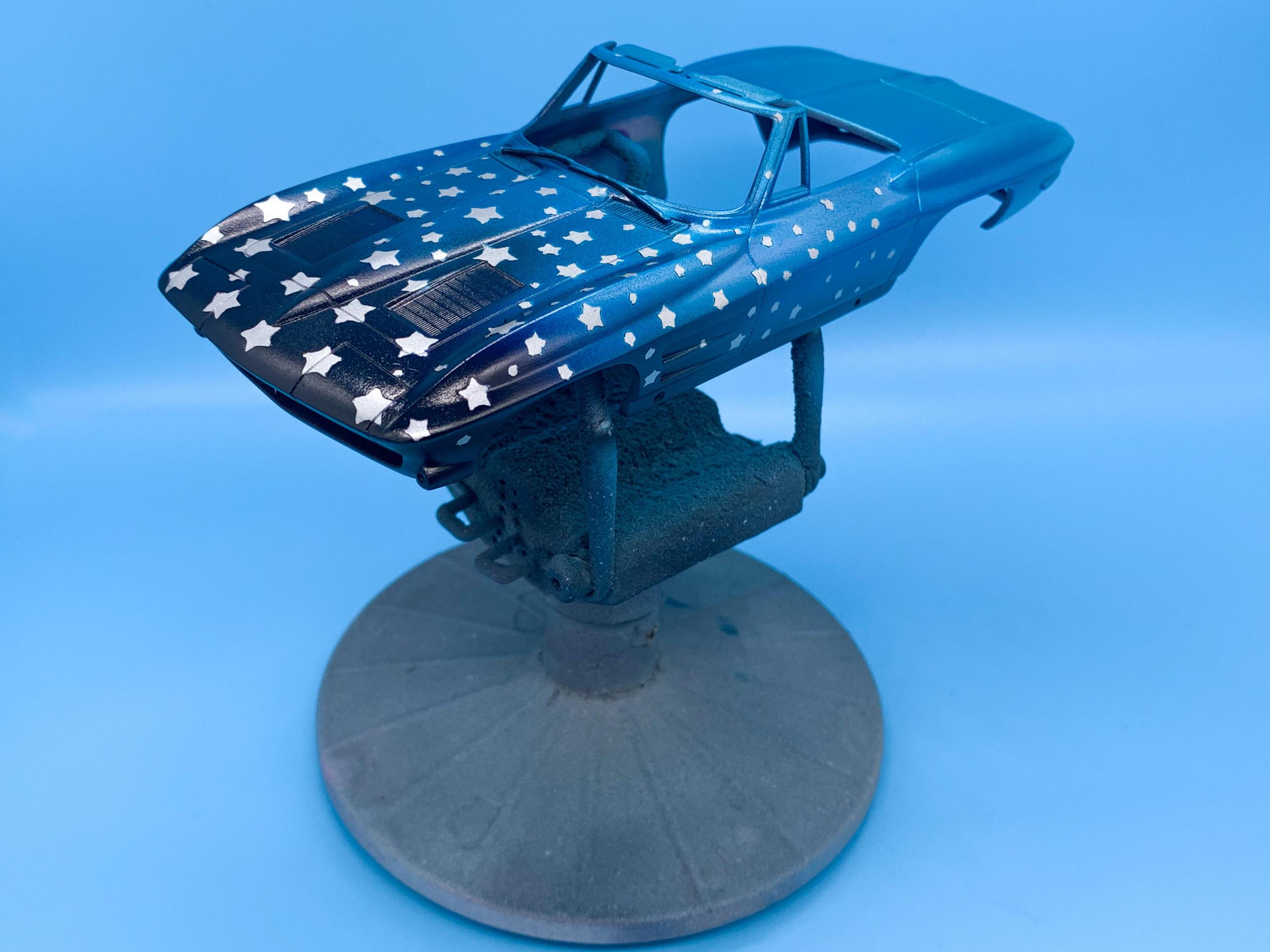

MrObsessive Posted September 11, 2021 Posted September 11, 2021 OK..............I've been using Tamiya Tape for masking for MANY years now and I've had nary an issue. These pics will speak for themselves.......... A still in progress '55 Ford which two toning was a must for the car I wanted to replicate........ I have to agree with what others have said about the tape. I only leave the tape on until the paint is dry to the touch. When pulling off the tape, NEVER pull the tape straight up. You'll want to pull it back, and then slowly at that. It might not hurt to use some clear paint along the edges before you paint to prevent any bleed under if there's a problem with soaking. BTW, I've used Tamiya Tape on all sorts of paints and simply have not had an issue. Along with the use of Parafilm, it's my go-to source when I want to do two-toning or stripes. 1
