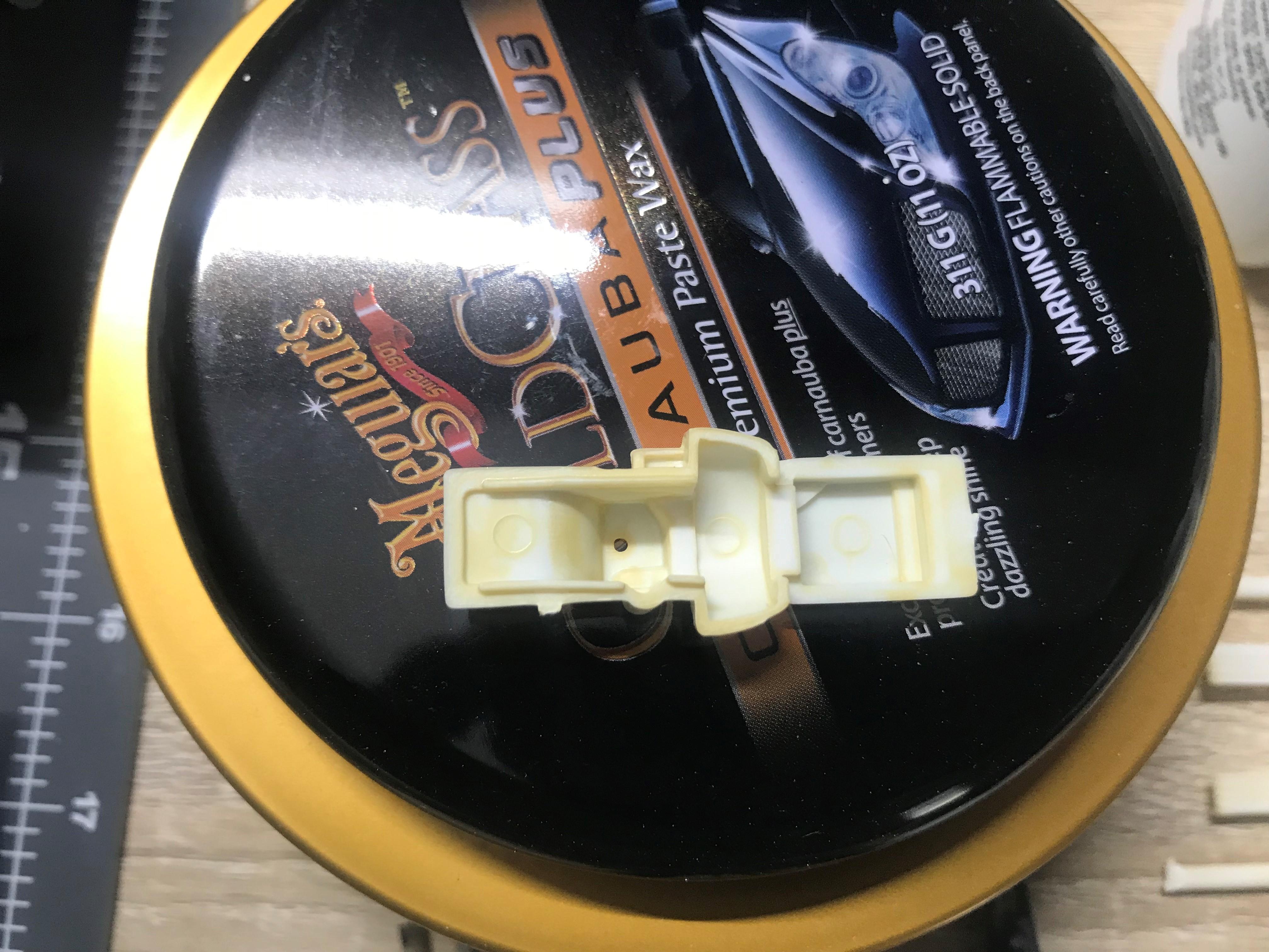

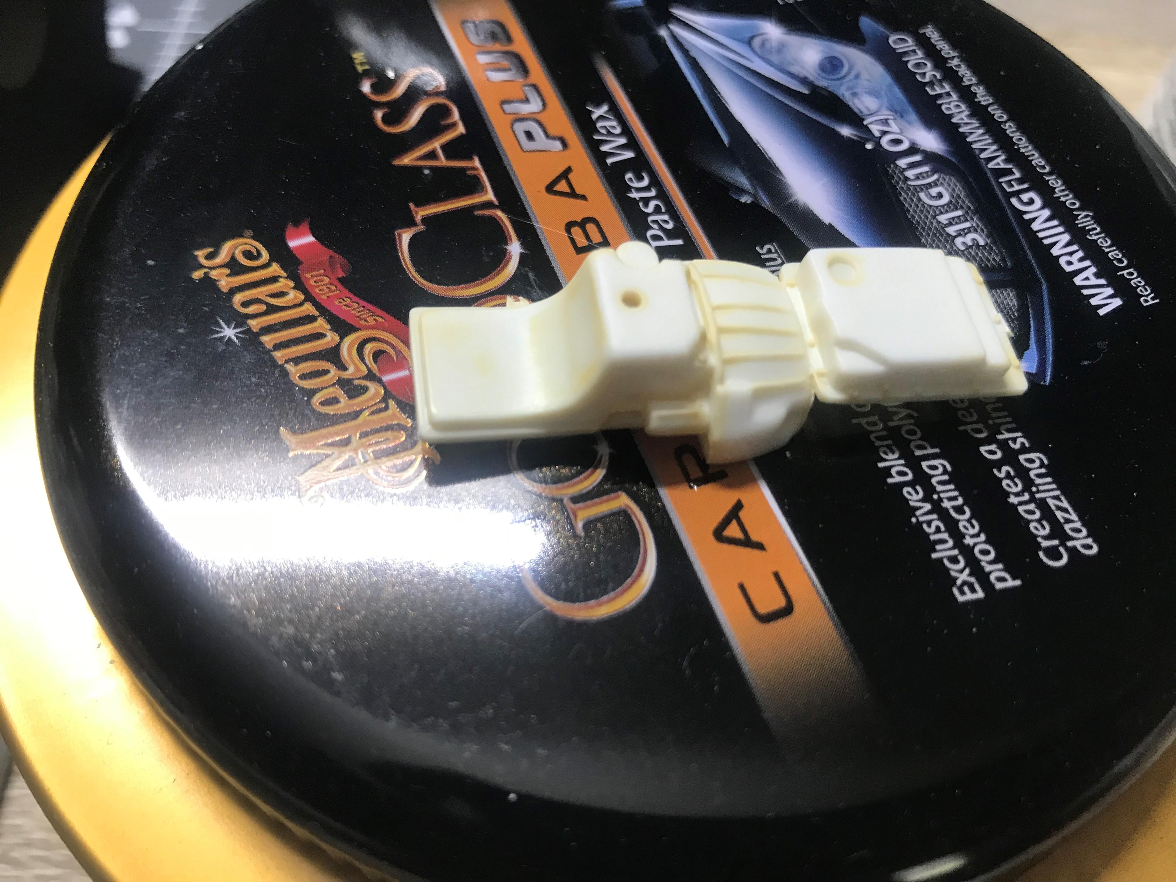

So i use super clean for stripping chrome parts and it works great, but i end up wasting a whole gallon of it after it's used up.  So i figured with it have lye in it i would get some lye and try out on some test parts.  Basically the lye takes the chrome off in a matter of seconds, but takes even longer to take off the under coating.  So after leaving it in the lye for a whole day - the undercoating was gone, but the part is stained a light yellow looking where all the under coating was left at.  Looks kind of weird and i wish now i would of took a picture of it.  Seems the 100% lye needs something with it to clean along side of it.  1Ib of lye was $6 and gallon of super clean is $9, and i figured the lye would last much longer, but if this issue is what happens I'll stick with super clean.
The clear undercoat for the "chrome" is usually light amber color, and the plastic is usually whatever color they were using for molding the kit during that run.  You mentioned that the clear coat was stripped (which is as expected considering you used Lye).
Is it possible that the bare plastic used for the "chromed" parts was naturally yellow to begin with?
If the part are still on the tree, scrape the top layer of the bare plastic on one the runners (some call it "sprue") to see of the yellow color is only on the surface.
Also, be really careful when working with Lye (by itself, or in other fluids that contain it)-- it will attack your skin and eyes!

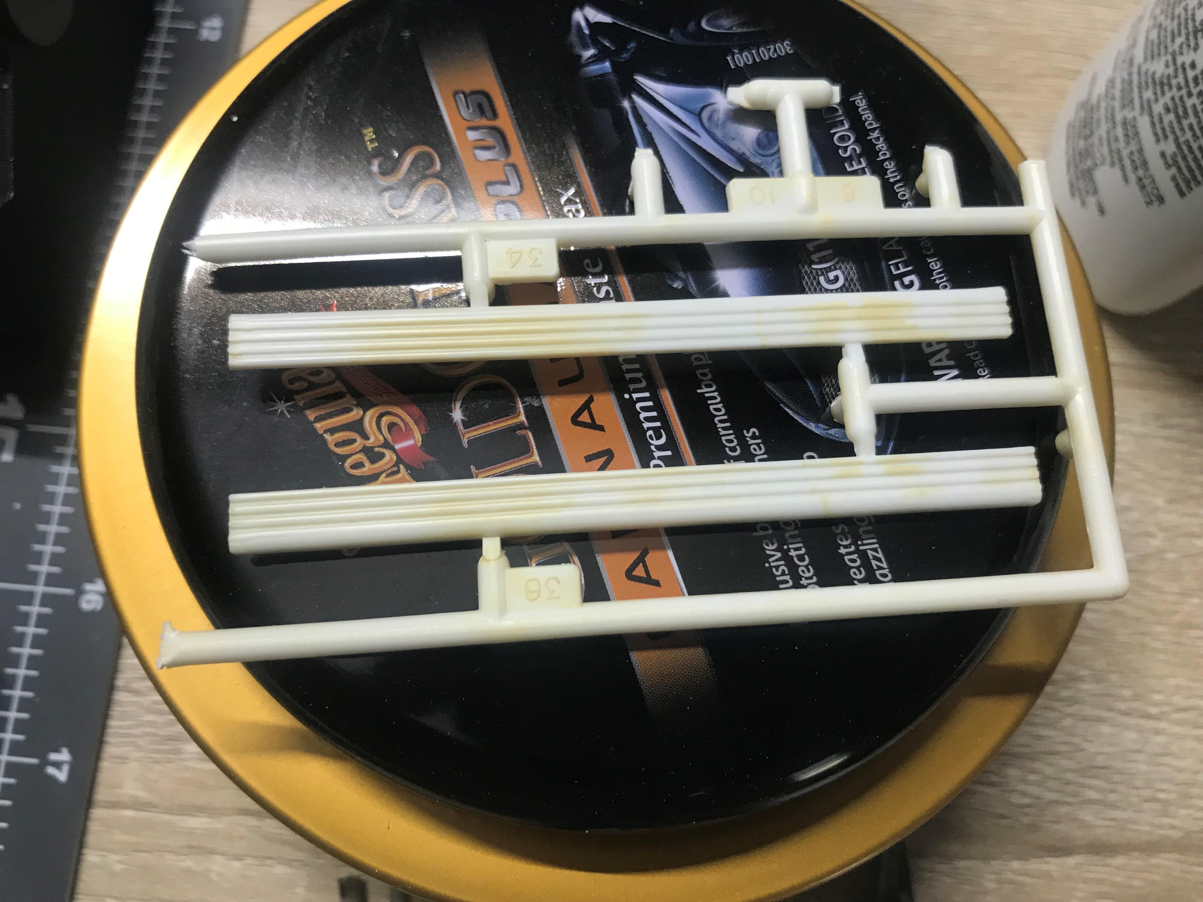

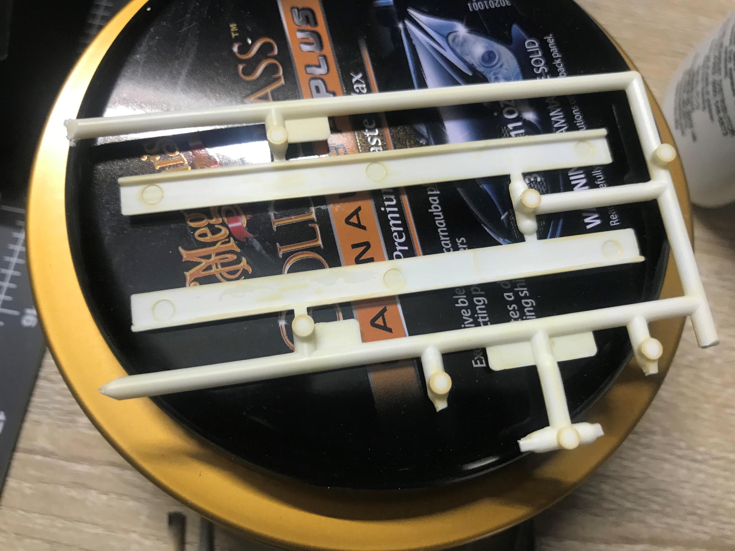

I'll have to do some more testing or maybe i used to much lye in the water.  Some of the chrome parts are like half white and half of the stained yellow after scrubbing.  Never had this issue using just super clean.  I'm gonna do some more test parts and take some pictures, but to better explain the look - it's looks like how old decals get with the faded yellow look.  Maybe it could just be the chrome parts itself like you said? I'll check again tomorrow.

The plastic under plated parts is often stained yellow by the lacquer undercoat itself, so the lye may not be causing the problem.
As long as it's not damaging the parts, try it a few more times on parts from various kits.
If only some of them have the staining, it's the undercoat, and not the lye.
I've noticed the same phenomenon with Super Clean and other products, so when it happens, I just chalked it up to undercoat staining.
As Peter stated, it might just be the plastic under the chrome as well.
As you can see from these valve covers that were stripped of their chrome, they are very yellow.
But, if you look closely, the plastic on the inside of the hole that I drilled for the oil filler cap is the same color, indicating that the plastic is that color through and through.
A little yellowing on the part is really not going to hurt anything anyway if you're going to paint or re-plate.

Could those spots be remains of the clear undercoat?  Either way, I don't think the lye cause that.  Whatever it is, I don't think I would worry about it.
No i don't think its the clear undercoat -that's 100% gone.  Just looks stained.  This is after sitting in the lye for 2 days. So it's got to be just the parts itself so I'm probably gonna put a nice white part from a RIP kit and let it sit in the lye for 2 days and see what happens.  I think the lye is 100% safe so after i use up this new gallon of super clean I'm gonna stick with the 100% lye.  It works even faster than the super clean, and it's pretty amazing to watch it eat away the chrome in a matter of seconds lol.
