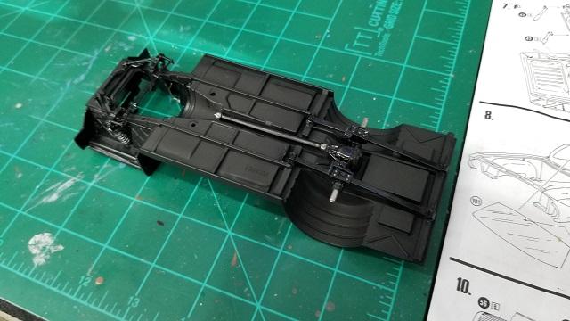

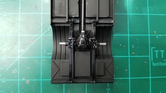

Zippi Posted November 18, 2021 Share Posted November 18, 2021 (edited) I have an AMT 66 Nova chassis setting around. I believe the rear half that is tubbed out has been cut off and graphed onto other chassis to get that Pro Street look. Looking for advise on what kit would be a good candidate to start my first major mod for a Pro Street build. If you have a build you've done this on let me see some pics and what all was involved in the process. Edited November 20, 2021 by Zippi Quote Link to comment Share on other sites More sharing options...

Zippi Posted November 18, 2021 Author Share Posted November 18, 2021 (edited) Thanks fellows. Greg, I have the 66 Nova chassis in the pics. I'm looking to do just what Roger explained in his post. I've got the AMT 60 Ford Ranchero I'd love to put some big ol meats on. Edited November 18, 2021 by Zippi Quote Link to comment Share on other sites More sharing options...

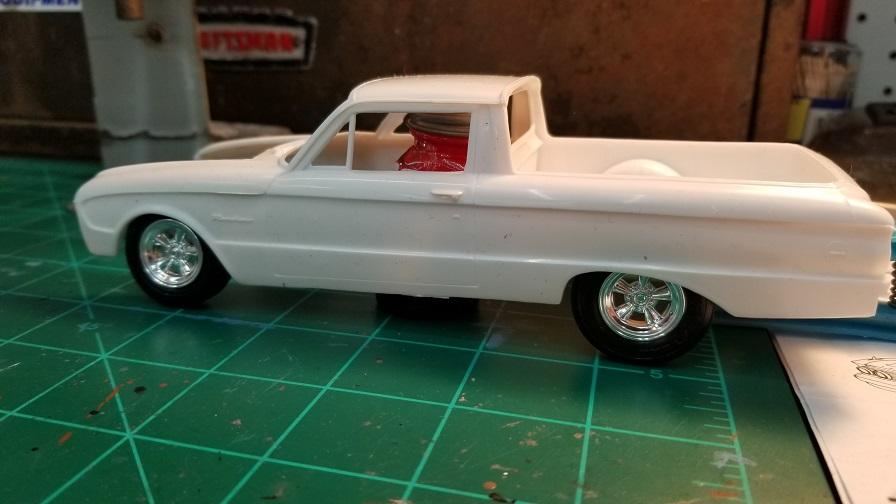

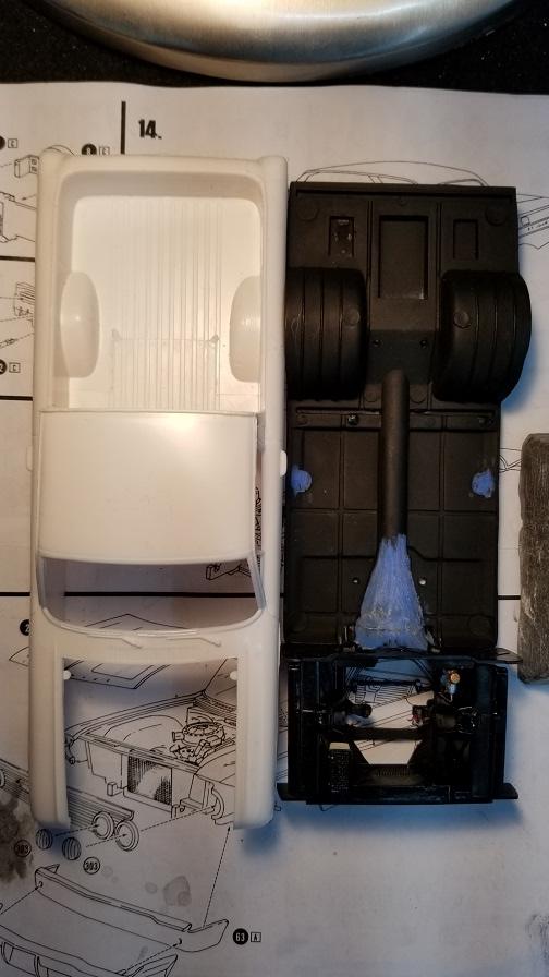

Zippi Posted November 24, 2021 Author Share Posted November 24, 2021 (edited) I opened the box on the 60 Ford Ranchero. Looks like the entire bed would need to be cut out to mate up the 66 Nova back half and I'm not sure how I could get in there to do that. Plus, the tubbed out area is wider than the Ranchero body. I did a moc up with the mag wheels and tires out of the 61 Chevy Impala SS and that looks pretty kewl. Edited November 24, 2021 by Zippi Quote Link to comment Share on other sites More sharing options...
Painted Black Posted November 24, 2021 Share Posted November 24, 2021 I like the look you have mocked up there!! Quote Link to comment Share on other sites More sharing options...
Zippi Posted November 24, 2021 Author Share Posted November 24, 2021 6 minutes ago, Painted Black said: I like the look you have mocked up there!! Yeah.....I think that's how I'll build it once I get to this one. Quote Link to comment Share on other sites More sharing options...
