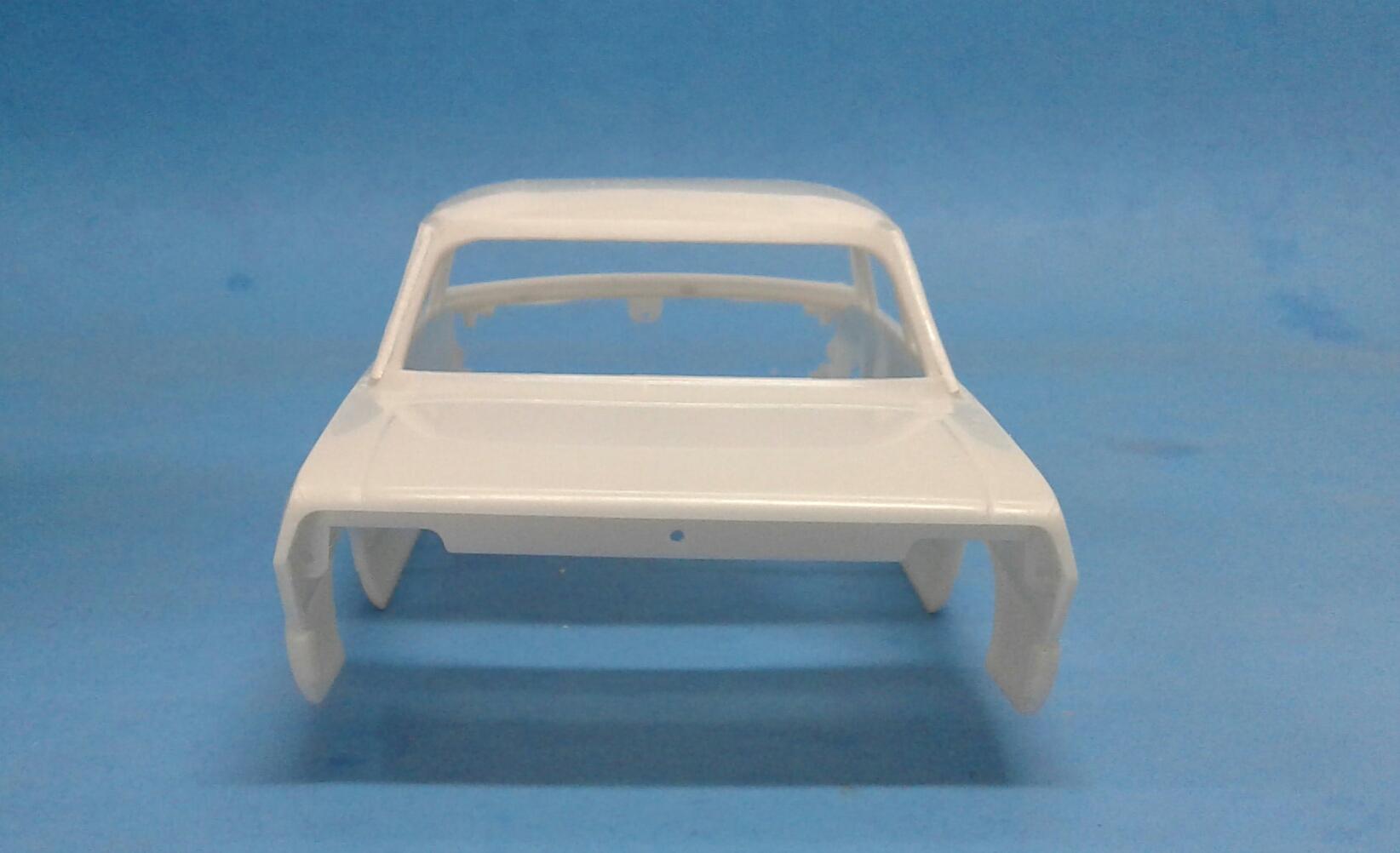

slusher Posted March 23, 2022 Share Posted March 23, 2022 10 hours ago, Plowboy said: I have to respectfully disagree Tim. There was no excess material at the top of the door panels. Please look at the photos that J C and I posted. Making the DLO the right height ruined the top of the door panels as well as the framing at the quarter windows and door. The framing under the drip rail is barely there. There's no denying it. The roof height is wrong. Measurements prove it. The AMT '63 Nova wagon has the correct roof height. It measures .6755 from the beltline to the bottom of the drip rail. The Moebius '65 Nova measures .6175. That's a difference of 1.45 scale inches. The backlight measures 1.8665 inches. That scales out to 46.6625 inches. It should be 55 inches. That's a difference of 8.3375 inches. How can anyone explain that away? I'm going to attempt to fix it and have began the process. It probably won't be 100% correct. But, it will be way better than it is out of the box. I look forward to watching the build Roger, if you post it… Quote Link to comment Share on other sites More sharing options...

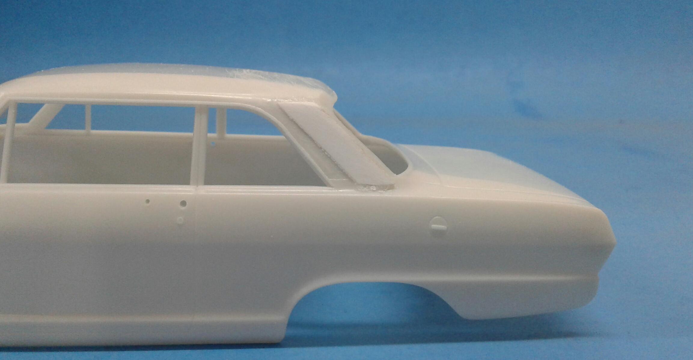

Plowboy Posted March 26, 2022 Share Posted March 26, 2022 On 3/22/2022 at 11:33 PM, slusher said: I look forward to watching the build Roger, if you post it… I may do a build thread if I can get the roof fixed. I have begun the correction process. I'm actually farther along than these photos. I had to add more styrene to the rear of the C pillars as the roof is too round at the brow of the backlight both at the top and bottom. I've also replaced the lip above the beltline and the framing around the DLO. 4 Quote Link to comment Share on other sites More sharing options...

slusher Posted March 28, 2022 Share Posted March 28, 2022 On 3/26/2022 at 1:43 PM, Plowboy said: I may do a build thread if I can get the roof fixed. I have begun the correction process. I'm actually farther along than these photos. I had to add more styrene to the rear of the C pillars as the roof is too round at the brow of the backlight both at the top and bottom. I've also replaced the lip above the beltline and the framing around the DLO. i believe you can fix it! Quote Link to comment Share on other sites More sharing options...
Plowboy Posted March 28, 2022 Share Posted March 28, 2022 10 hours ago, slusher said: i believe you can fix it! Thanx Carl! It's getting closer! But, it's been a battle! I think I have a happy medium on the side profile. It doesn't immediately look chopped. But, when you look closely, you can see that it is. It may look worse with primer on it or it may look better. I'm actually pretty close to being able to shoot a first coat. I know this is a gasser. But, I don't understand why there's absolutely no badging molded into the body. No scripts. Nothing. I'm guessing they're on the decal sheet? 2 Quote Link to comment Share on other sites More sharing options...
