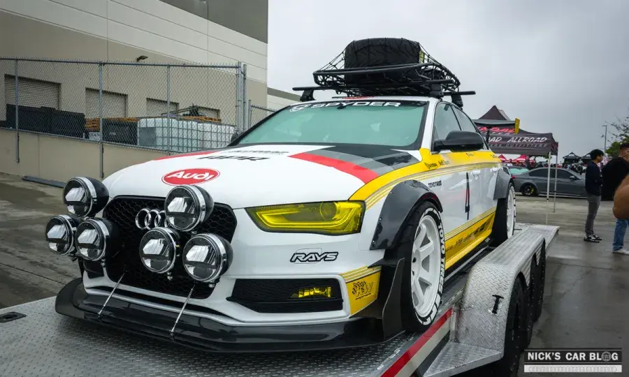

33 minutes ago, 89AKurt said:
Cool subject, I'll be watching.   I will beg off getting one, would be tempted to rally it.
I was very close to using the white and yellow colour scheme
  • Like 2
5 minutes ago, slusher said:
I think that will be a cool look…
It would if it was a lower model of audi, the arches of the rs would mean a lot of the yellow would just be pin stipes so a lot of the rally look would be gone. Here it is on non rs saloon of the same age. On the rs the arches would be pumped out and a lot of the look would be lost imo. But it would work really well on something I already have planned.... a rally audi r8!!!
