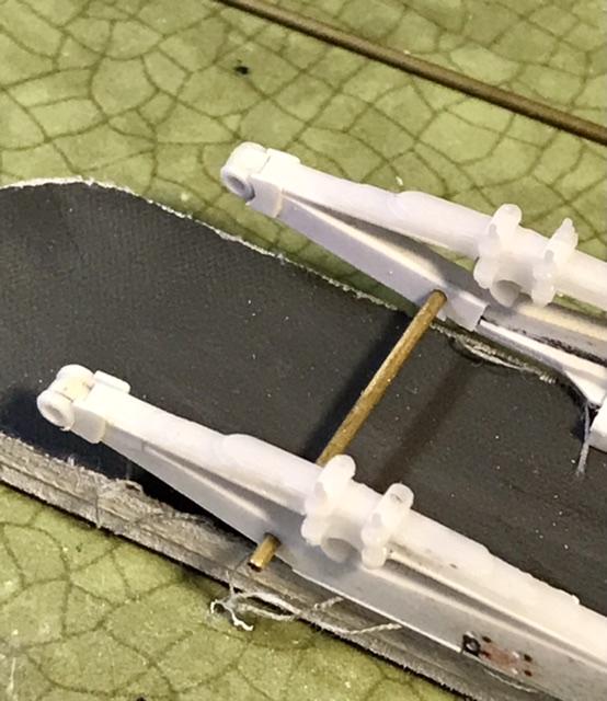

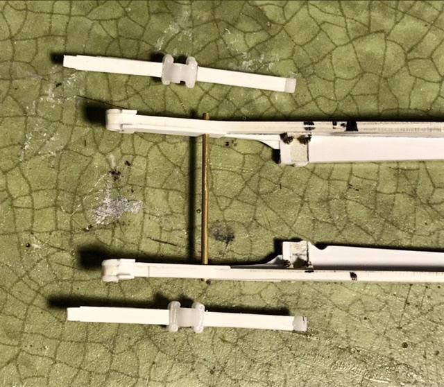

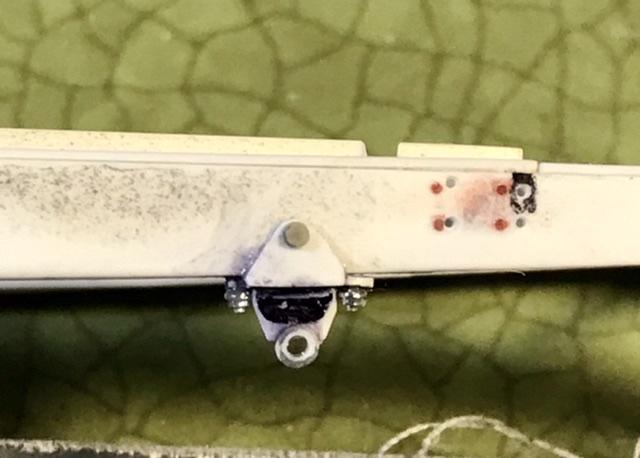

A concession to scale - the front shocks are glued to the front of the chassis legs - so I’ve  added small tabs to grasp the ends …

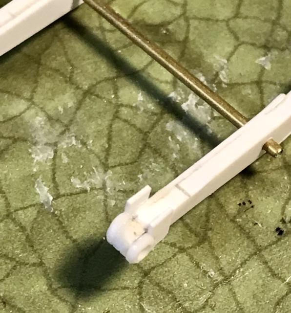

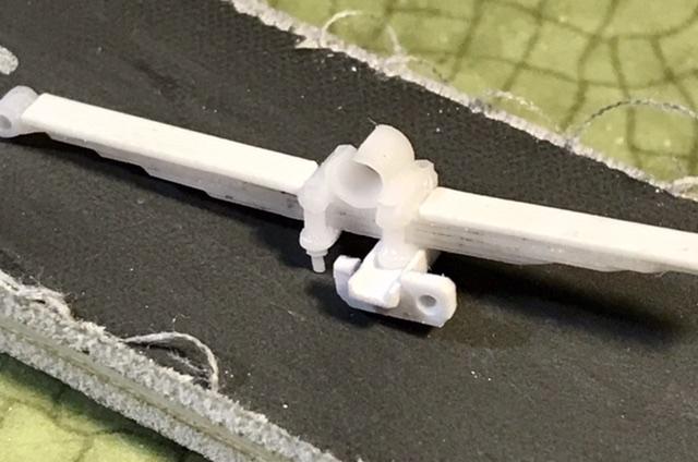

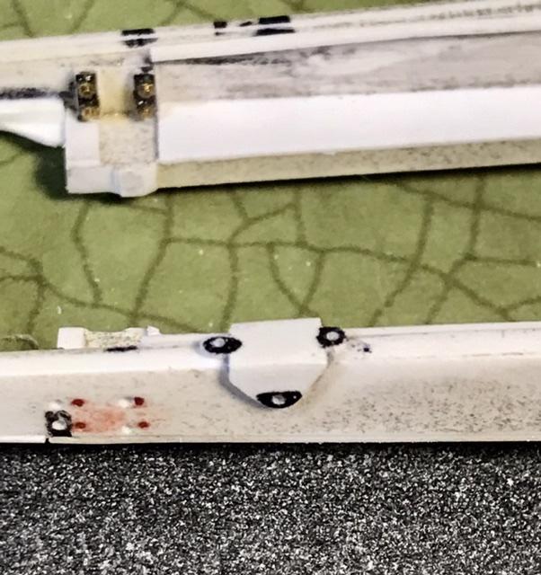

The mount for the fr leaf spring is made fr Evergreen angle stock and bar  - and a short section of plastic shrink tube - once everything was carved up and glued to the chassis leg - the bolts were added - AnyZ - and Master Club …

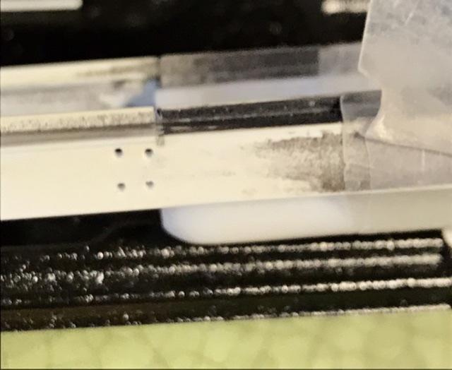

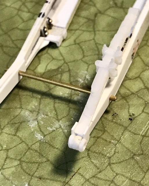

The Indy Millers used friction shocks front and back - I’m figuring out how to fabricate the angled casting used by Miller to link the bottom two shock leaves to the leaf spring - bits and pieces of Evergreen  …6A237ED7-5633-4BF9-AA29-D190E0BC5DCC.jpeg.5b662b63b5cd8695f113e386a58af584.jpeg

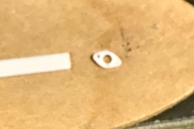

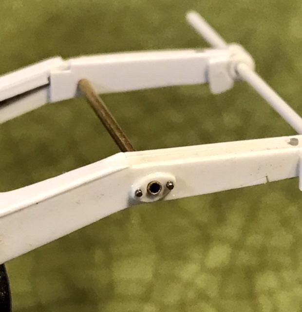

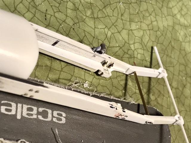

Alrighty then - more pichers -  Evergreen strip for some flanges - the bolts on the chassis are sourced from RB Motion, Master Club, AnyZ, whatever seems to look right - that I’ve got in my stash … the cross brace w the flanges serves as a top mount for the friction shocks …
Using Scale Hardware bolts too - but I’m running low on my favorites and restocks nowhere on the Horizon - but
ill reach out to the guy who created the business  - but then sold it - to get his thoughts …

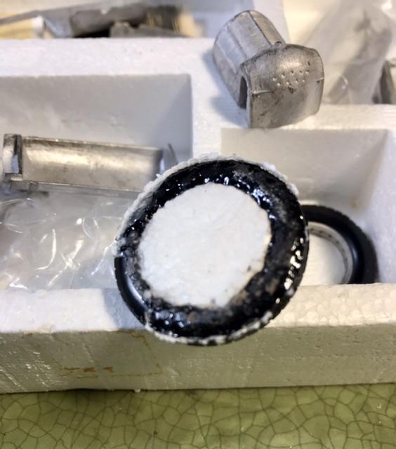

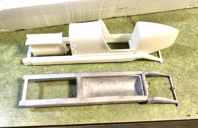

The white metal Miller 91 fr Dr kit In question ….  Note the rubber Tires tried their best to eat right through the bottom Of the foam packaging - yup I’ve had it a while - but the foam peels off the tires with no damage …

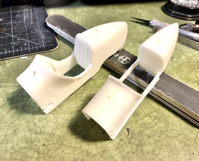

Photo 1  -  the white metal Miller kit has a nice 2 Piece frame ….  The resin kit behind is Harold’s 91 fr Dr Miller -  if my recollection is correct - it was mastered years ago by Etzell but never kitted - Harold may have mastered the detail parts - anyway - it’s first rate ….
photo 2. -  the Miller 91 fr
dr body compared to my 122 body / frame …

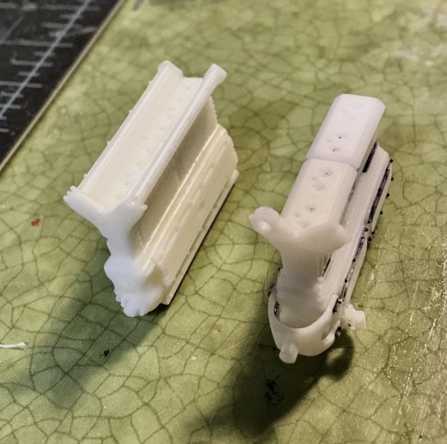

photo 3. -  comparison of Etzell’s great Miller 91 engine Casting with my 122 crankcase and Cyl heads - Etzell’s eng was 25th scale vs my 24th sc eng castings - not much difference … I’ve split and made two separate cyl head castings - so you can see the gap /opening - which is about 3/4 inch scale …
Photo 2 above - phone swallowed the text [dog ate the homework ].  Comparing my Miller 122 body to the Etzell / Bradford 91 front dr …

Andrew mentioned about the tyres in his Auto Kits Miller reacting with the expanded polystyrene packaging.
Model kit tyres  made with vinyl has a chemical reaction to polystyrene plastic. I found out the hard way when I had a kit that was stashed away for years. Upon opening it I found that the vinyl tyres that were against any of the kit parts had sort of moulded themselves into the plastic. Both tyres and parts were ruined as a result. I always now ensure that tyres  are bagged or wrapped in tissue to separate them within the box before storing. Not sure if real rubber would react in the same way, but err on the side of caution .
