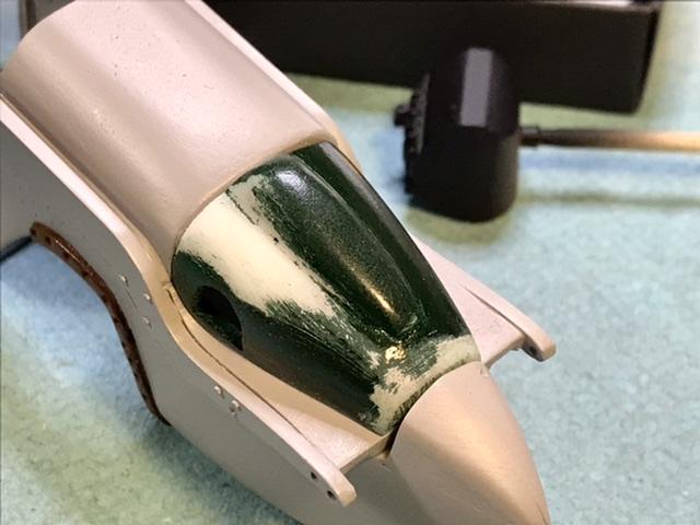

Paint re-do - the fairing under
the tail and the footwell fairing were sanded and re-painted - this time I dialed back the air pressure and used a little less thinner - the footwell fairing is feeling much better and the tail peice looks great - even without a  coat of primer …

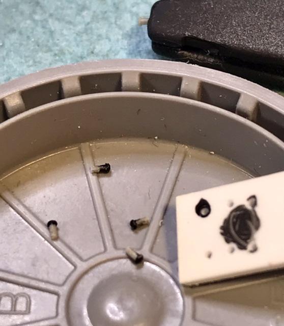

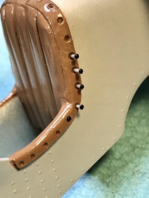

Once i re-spayed the seat - with a lighter shade of “leather” - i began to install the  rivets that secure the leather to the body - used .07 Master Club flat rivets - hard to judge scale size - .06’s - which are just over 1/2 sc inch - might be more scale accurate …
Thinking - what if i thinned some of the dark br leather paint from the Model Master jar ?  Applied w a cloth applicator or a brush ? … or my finger ?? …

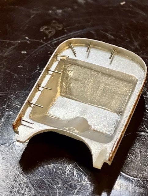

The rivets on the fabric edging the cutouts had to be shortened to lengths of .40 - so they wouldn’t poke through the body - they were poked into holes drilled into that Evergreen strip - painted , cut, and sanded to the needed length …

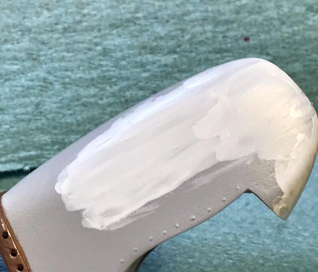

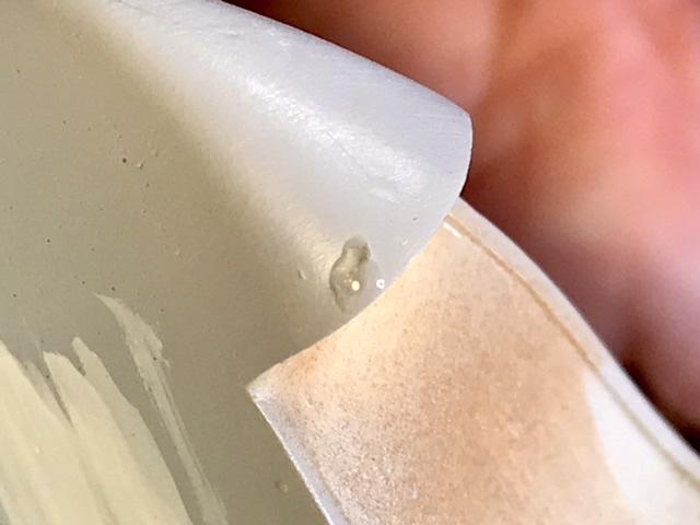

Whilst pondering the finish of the seat - i took a morning to re-finish the tail - which had a small cavity at the base - and was a little porous -  - due to the master - which i made from a relatively soft sheet of Renshape - so i brushed on some Tamiya white bottle primer - which is thick enough to swim into most of the pores - and some CA for the cavity - sanded with some sanding sticks - i want To do as little as possible with the enamel color coat …
