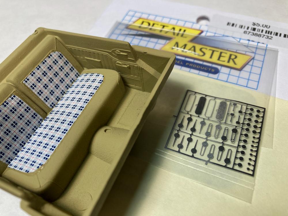

I've had some Scale Motorsports decals for a few years and decided to give them a try. First order is to tame that flat tan with gloss so the decals will stick better.
To create my pattern I taped over the seats and tried to get rubbings of the piping. Then cut out the pattern and lightly laid them over the sheet to cut the decals. I used painters tape. If you use this rather than light tack tape, I recommend rubbing it over your pants first to decrease the stick.

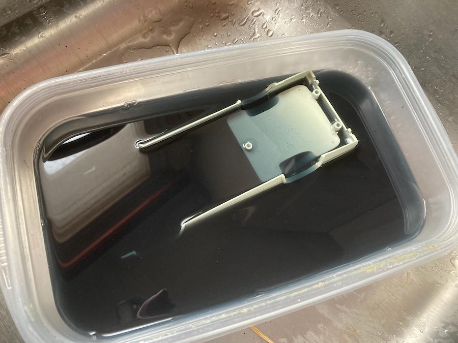

Had our first warm day of the season and I got a little impulsive to finally get that clear coat on the '61 Ranchero. Didn't think it through and put a coat of Testors One Coat lacquer over my Rustoleum green, which I think is acrylic enamel. The green almost turned white and obviously put on a finely crazed surface. I think this is the first time ever I've had to strip a body that I painted myself. Grr! ?
I used .08" quarter round strip.
I forgot to mention in this thread that I got some detail elements from Art Laski over at Scale Pro Shop. You can see the obvious problem with the dated interior bucket of the '61 Ranchero. I'm guessing the lack of hard edge, protruding door detail has more do with the state of molding in the early 60s than it does about anything else. Regardless, I'll build these old dinosaurs any day.

Super Clean, or whatever it's called now, (purple pond) really did the trick. An overnight soak and a soft toothbrush cleaned it like a whistle. Nothing residual in the scripts or grooves. Very happy, so all I've lost is a little time, and I've got lots of paint left.
Also I got the photo etch details onto the interior doors. Not liking the old-man-trousers look of the seats I grunged them up a bit with a careful wash and knocked down that gleaming white and spotless tan. Now it's more like vintage-thermos-found-in-a-shed.
