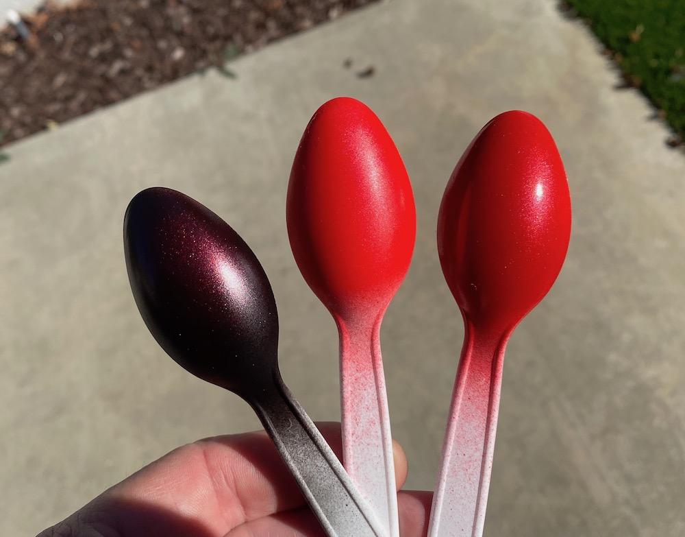

Spoon test! These are all Tamiya rattle-can Mica Red, TS-39, applied over the following:
  • Left: Mr. Finishing Surfacer 1500, black. Not the effect I was going for, but interesting!
  • Center: Bare plastic. Nice, but a little too bright, and kind of a matte appearance.
  • Right: Tamiya Fine Surface Primer, light gray. I love it!! Just a shade darker, and man, does it go on smooth. This will really pop after clear coat.
I didn't realize that this paint was a very fine metallic, only noticeable in bright sun, but it'll be great for the Starliner.
Now, just waiting on shipment with the putty...
11 hours ago, slusher said:
The red over grey primer has a real nice shine…
Yeah, I was surprised at the gloss...almost looks like it's clear-coated already. I think I found my new favorite primer!
Just as a future reference, any color that ha ‘Mica” in its name is a metallic. If you really want this red to “pop”, you should try spraying it over gold.
Thanks for that, Michael. Will definitely try it over gold sometime...Mica over Inca? ?
I would go over testors pure gold. Inca is too lime-y. Tamiya’s Mica would work too, but not as dramatic

54 minutes ago, rightrudder said:
Thx! I was hoping for something a little more on the maroon side, but this color is growing on me.
Well, when it comes time to use Mica Red again, try it over Tamiya's new(ish) red oxide primer to get a more maroon metallic tone. As you can tell with your spoon tests, the undercoat does affect how this semi-transparent paint looks in the end.
'Stude looks great BTW. I wouldn't change a thing.
Thanks! I didn't know that primer existed. It'll give it a whirl next time.
