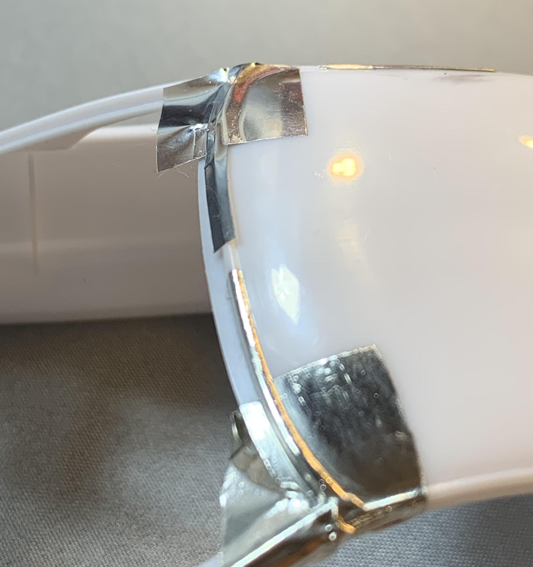

Erik Smith Posted February 19, 2022 Posted February 19, 2022 (edited) A quick follow up: The MIG Chrome sheet did not stay adhered overnight. In the first photo you can see it did not stick to the window trim contour. This is bare unwashed plastic, so results may vary. The next photos I compared a new (purchased today) BMF Chrome sheet, an old BMF New Improved Chrome, and MIG’s Aluminum Sheet. The MIG Aluminum is actually a foil product, unlike the Chrome. It’s quite a bit thicker than BMF and the adhesive is a lot stronger - which depending on what your doing with it could be a good or a bad thing. Notice the Chrome BMF I purchased today has a lot of texture is the adhesive. It was a lot worse before burnishing down with a Q Tip, but it’s still a little rough. The old sheet of New Improved Chrome actually still looks the best, it has some adhesive texture but overall better than the sheet I bought today. Finally, the MIG Aluminum Sheet has some lined texture but not so much adhesive texture. It doesn’t lay down as well as BMF because if it’s thickness, but I do see some possibilities imitating aluminum panels and such and maybe some trim. It would represent actual scale thickness of trim and if used right could be a useful addition. It’s the same price as the Chrome, about $12 for five decent sized sheets. *note - I burnished with a cotton q tip and then tried polishing each one in the middle section to see if it would get more “chromey”. You can decide if it did. I have a piece of the Hasegawa Chrome coming from Peter (Peteski) so I will add that in here soon. Edited February 19, 2022 by Erik Smith

Dpate Posted February 20, 2022 Posted February 20, 2022 On 2/19/2022 at 10:21 PM, Erik Smith said: A quick follow up: The MIG Chrome sheet did not stay adhered overnight. In the first photo you can see it did not stick to the window trim contour. This is bare unwashed plastic, so results may vary. The next photos I compared a new (purchased today) BMF Chrome sheet, an old BMF New Improved Chrome, and MIG’s Aluminum Sheet. The MIG Aluminum is actually a foil product, unlike the Chrome. It’s quite a bit thicker than BMF and the adhesive is a lot stronger - which depending on what your doing with it could be a good or a bad thing. Notice the Chrome BMF I purchased today has a lot of texture is the adhesive. It was a lot worse before burnishing down with a Q Tip, but it’s still a little rough. The old sheet of New Improved Chrome actually still looks the best, it has some adhesive texture but overall better than the sheet I bought today. Finally, the MIG Aluminum Sheet has some lined texture but not so much adhesive texture. It doesn’t lay down as well as BMF because if it’s thickness, but I do see some possibilities imitating aluminum panels and such and maybe some trim. It would represent actual scale thickness of trim and if used right could be a useful addition. It’s the same price as the Chrome, about $12 for five decent sized sheets. *note - I burnished with a cotton q tip and then tried polishing each one in the middle section to see if it would get more “chromey”. You can decide if it did. I have a piece of the Hasegawa Chrome coming from Peter (Peteski) so I will add that in here soon. Expand Crazy how the new improved BMF looks so much better than the regular chrome.
