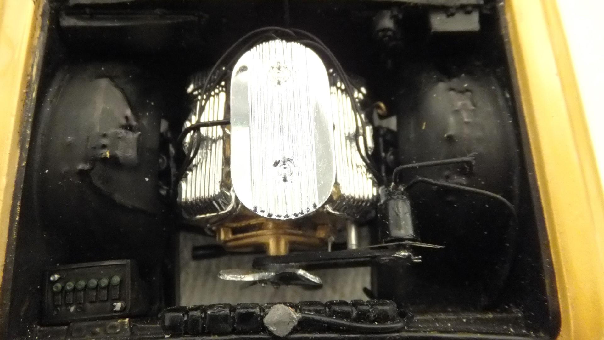

Had to do a little more adjustment of the floor of the interior to get the chassis to finally lay in.  The engine has pieces from the parts box to improve.  I did add a dip stick and some Detail Master PE to “hang” the generator.  The engine bay does not seem to match any of the reference photos I have nor the Revell 59 Impala, but it will do.
The 348 was a very tight fit (it is a wide engine in 1:1, but the headers from the kit are touching the frame to get it to fit right.  Not visible, but not a happy camper.  Also, the hood sticks up a bit even with some shaving I had to do to improve it.  There is no interference with the air cleaner or engine parts as the problem manifested itself in test fitting with no engine in place.  Even initial test fitting of the kit out of the box showed that was going to be a problem.
Remaining, I need to finish off the engine bay including touch up; finish the hood; add the front wheels; add the last chrome bits; and call it done.

Looking great. I had a similar air cleaner and hood clearance issue on the one I did. I used an OEM style dual snorkel air filter with the 3 twos. I had to shave a little off the inside of the air cleaner and the top of the carbs to get it to just fit. Used the headers from the old AMT '62 Bel Air 409 with a little sanding the worked. Hope this info can be of some help.

I’ve taken this as far as I think practical although I may go back and visit the hood some.  It just did not fit well from the get-go.  I’ve shaved the edges to the point where the hood is touching the radiator shroud and other parts of the engine bay.  No impact from the air cleaner, so I will probably chew on it a bit more or just leave it be.
Although better than some older AMT releases, the reissue I have has some major shortcomings.  Besides the aforementioned hood fit, the parts of the pickup bed did not join well and had gaps requiring a lot of putty work in an area with detail that would be quite hard to retain.  The tailgate did not fit well, and I decided to glue in place positioning as best I could.  The passenger side body detail is “softer” than the driver’s side.  The firewall does not reflect any El Camino photos I’ve used for reference plus there is no brake master cylinder there.  The engine squeezes into the engine bay requiring the headers to touch the frame.  Not really visible but not what I like to see.  There is no starter included even though shown in the instructions.  With the fit into the body, the headers would have “collided” with one anyways (I tried with a parts box piece).  So, I simulated one with a piece of Evergreen Rod cut to about the right length.  Again, it is buried from view, but not to my liking.
