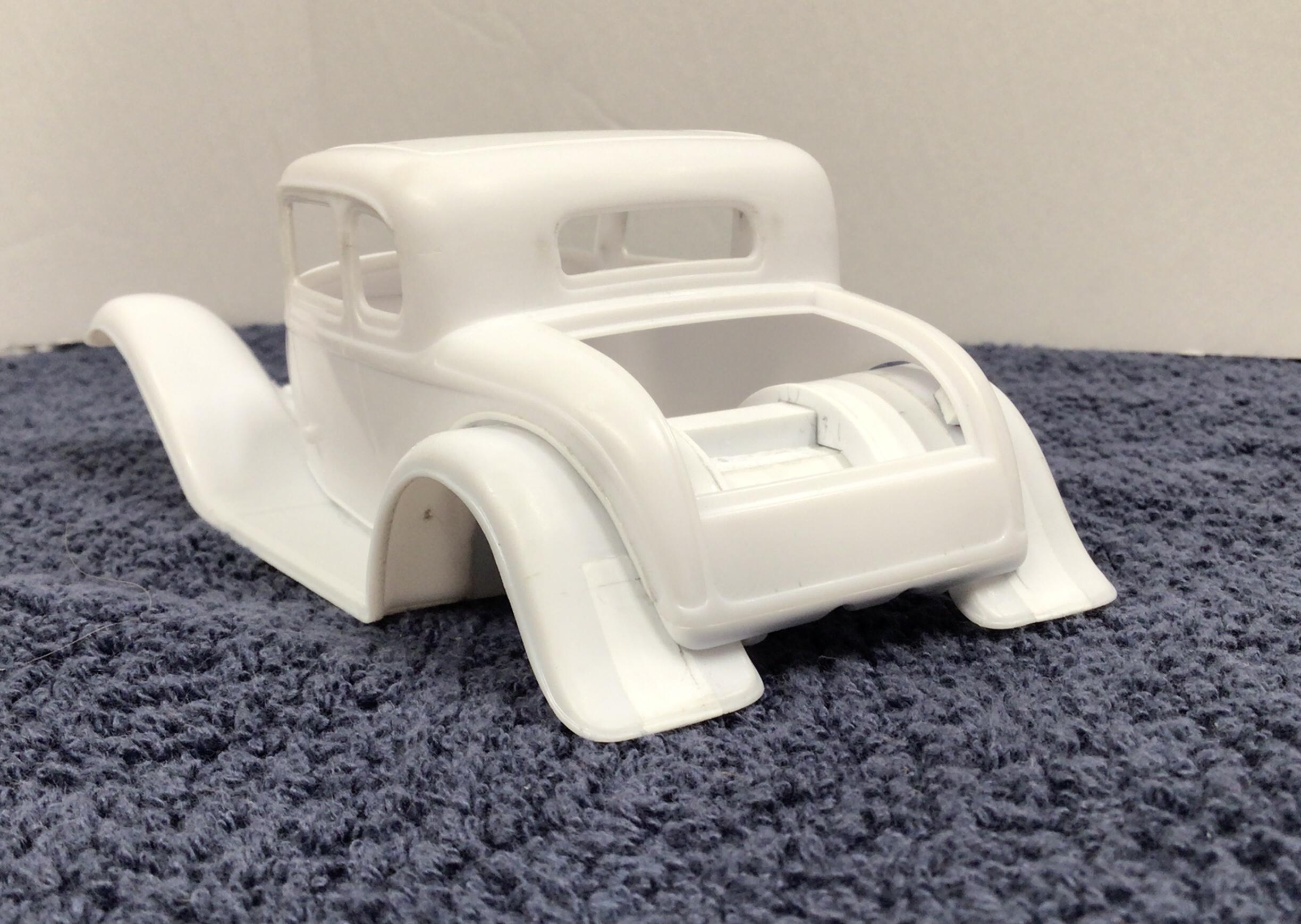

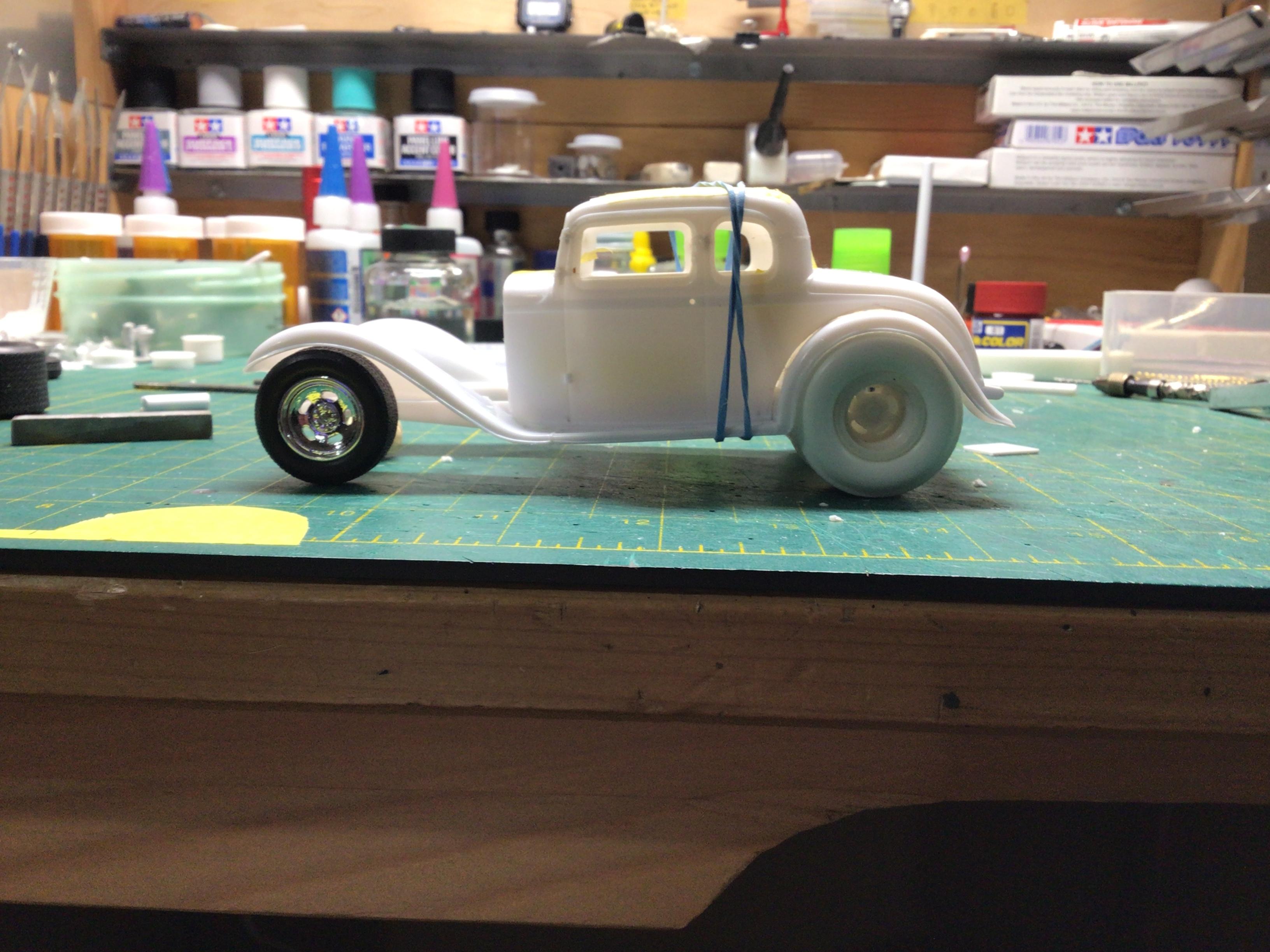

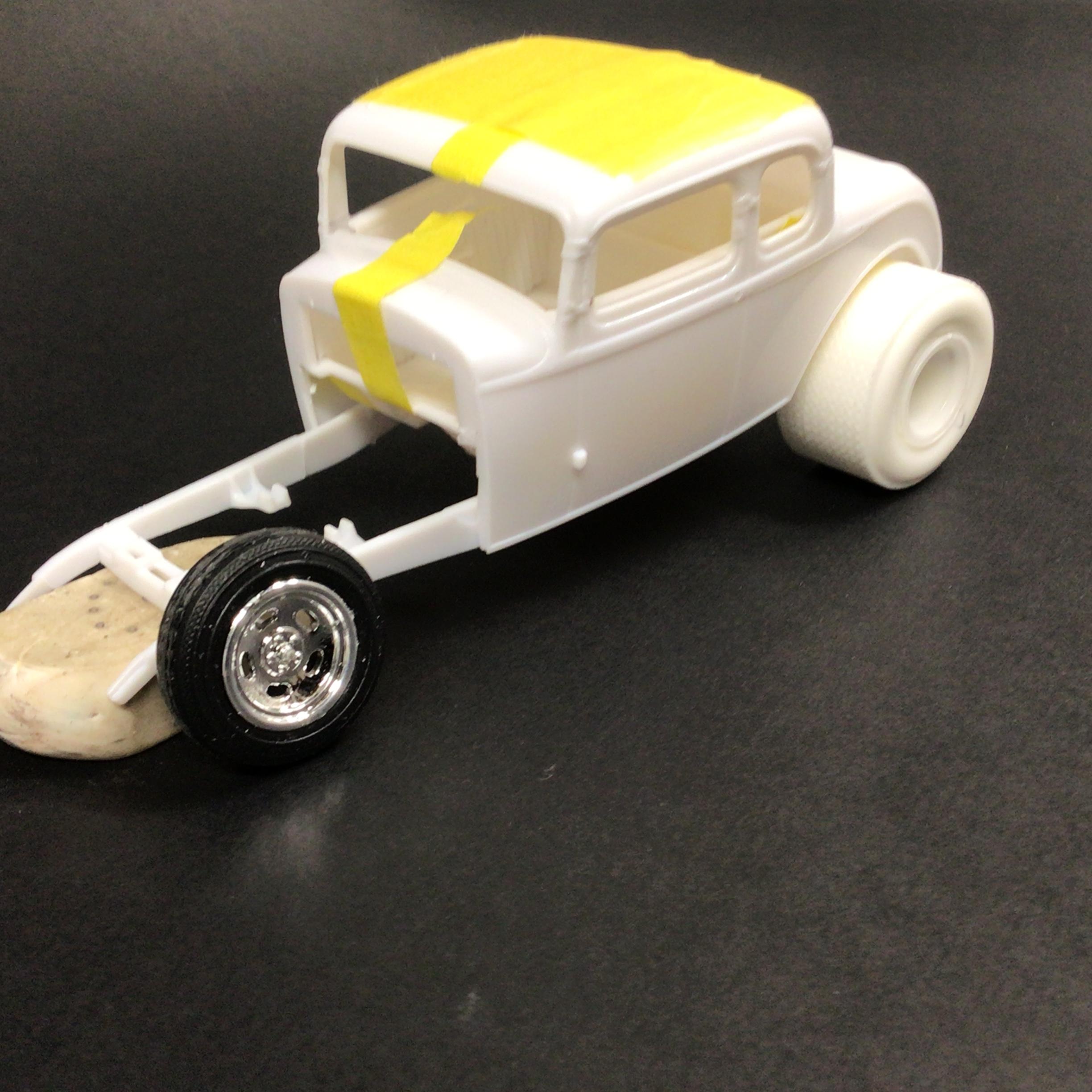

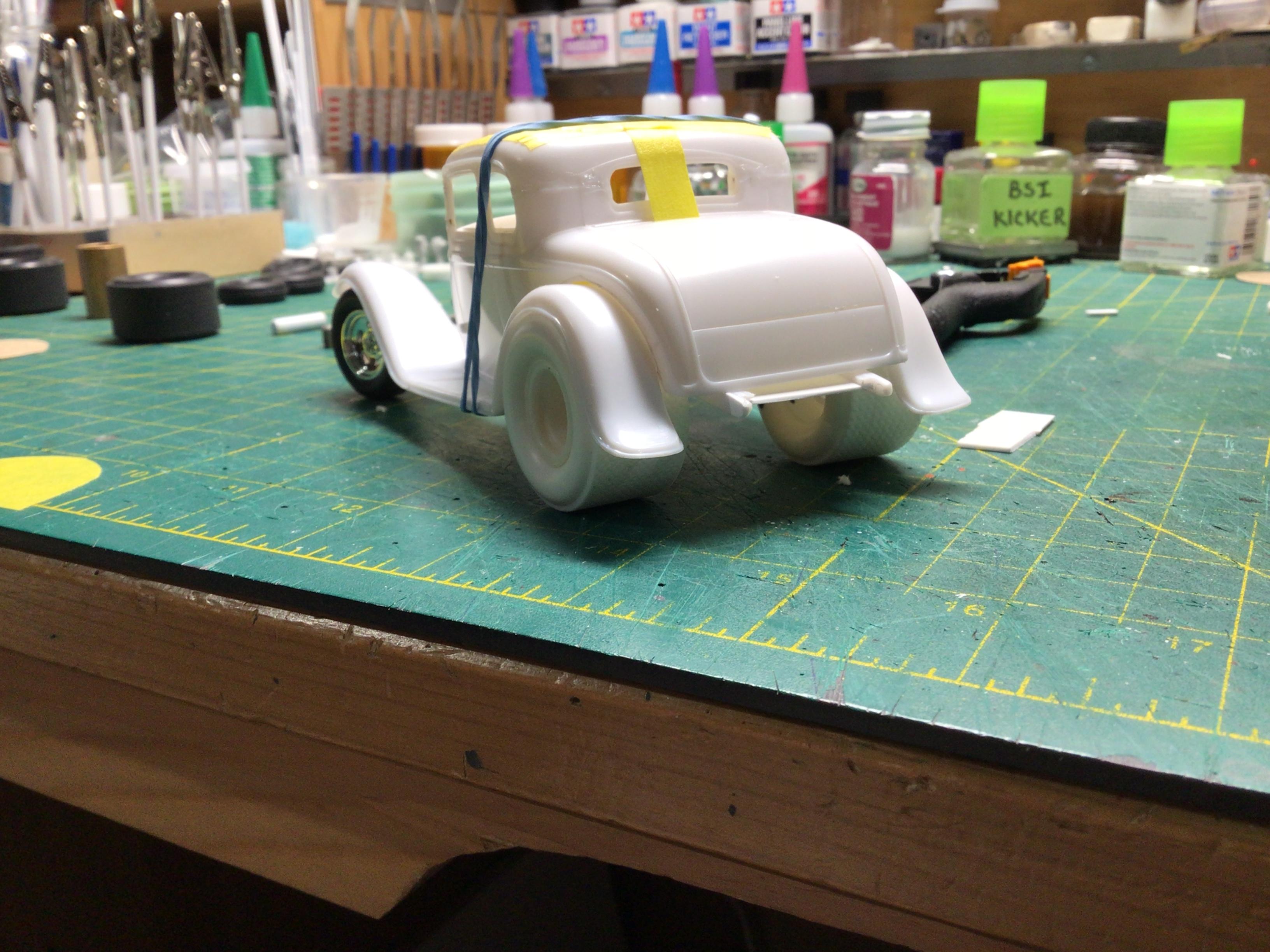

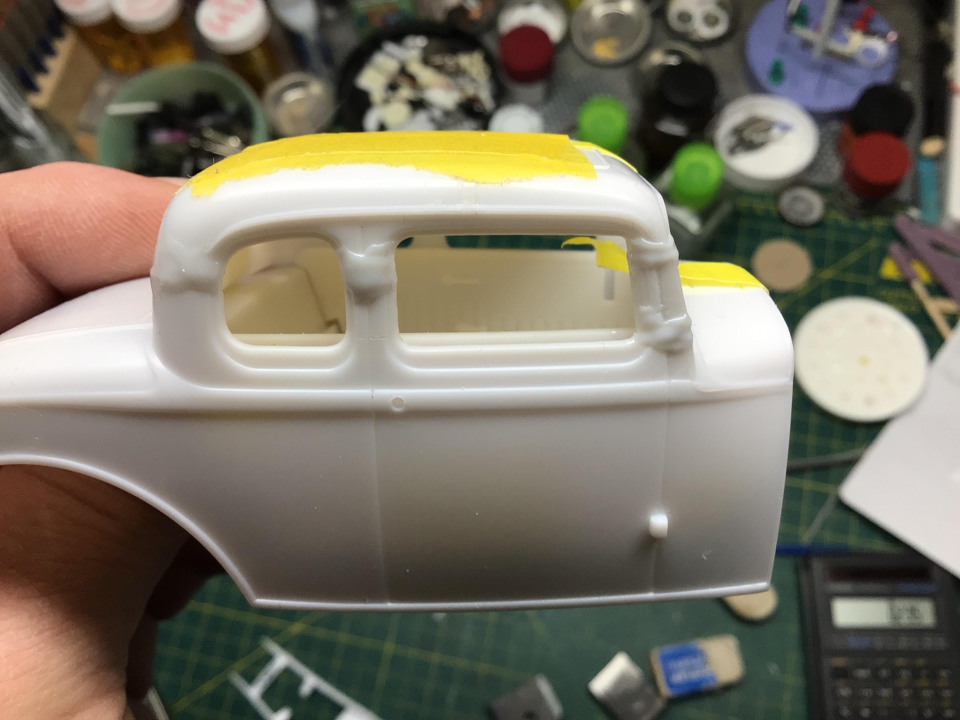

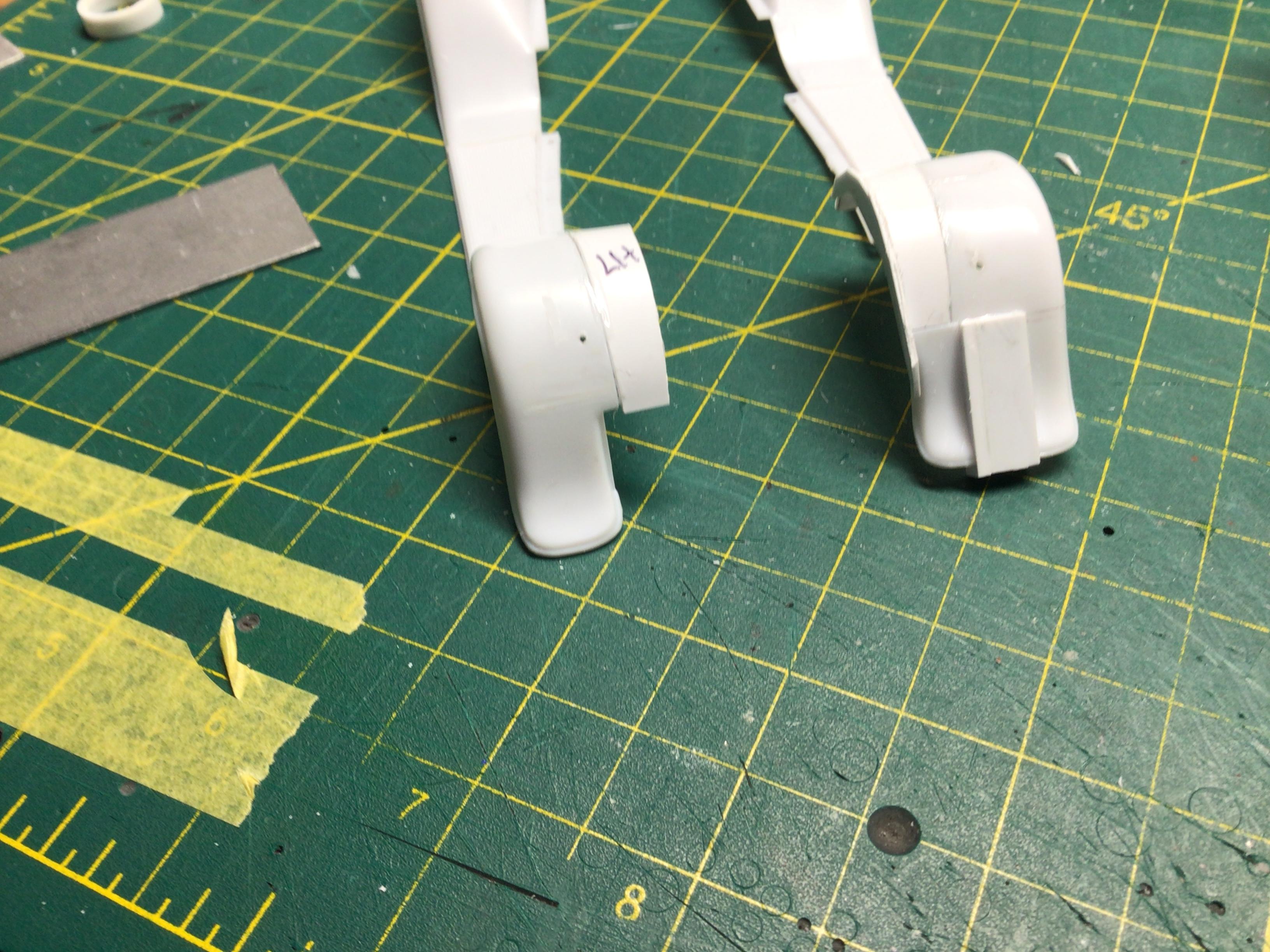

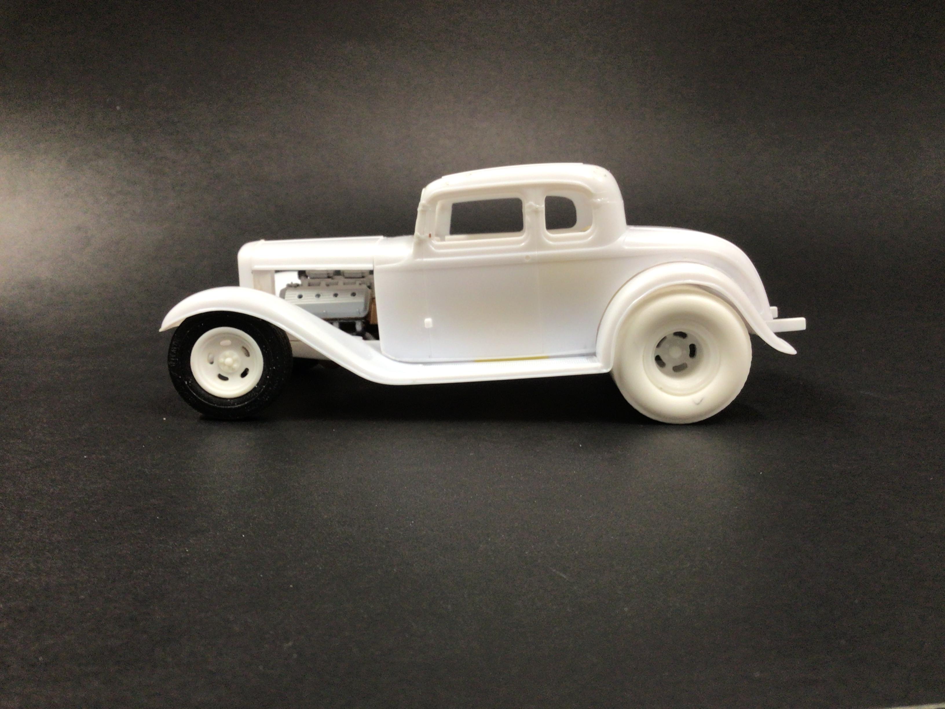

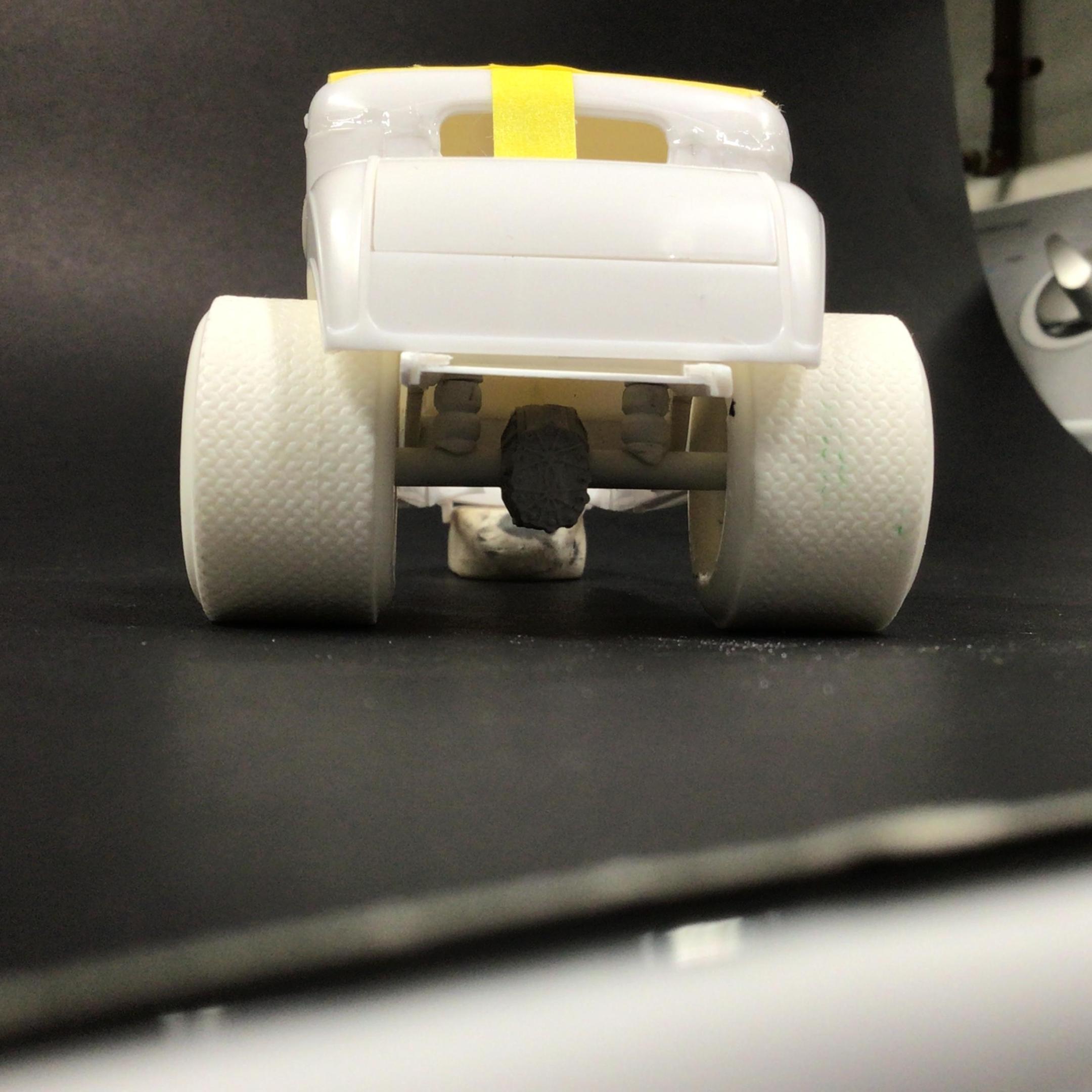

Since this suspension is taking longer than I figured, I mixed up some sprue glue to fill the seams on the chop. It should have plenty of time to set.🥵87A3D2F3-1F74-4FF8-8D7F-C6DCCBBC49A2.thumb.jpeg.a38f242e4b7e8f2e738fc14e0934358a.jpeg

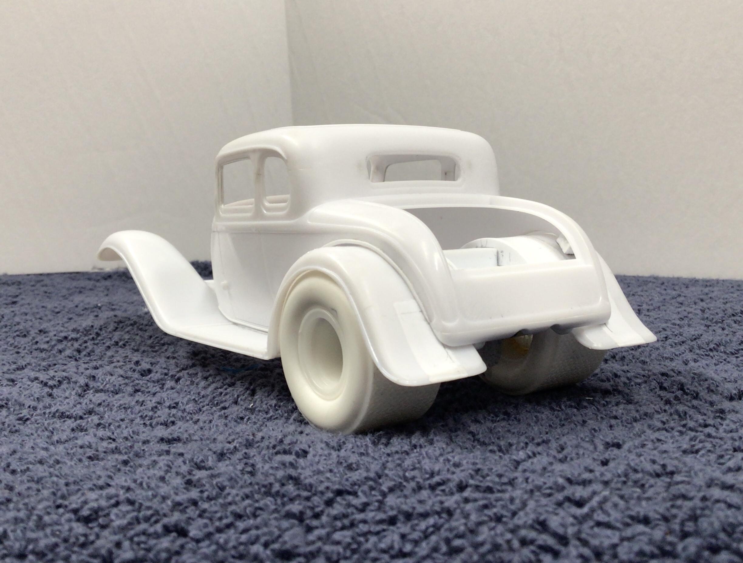

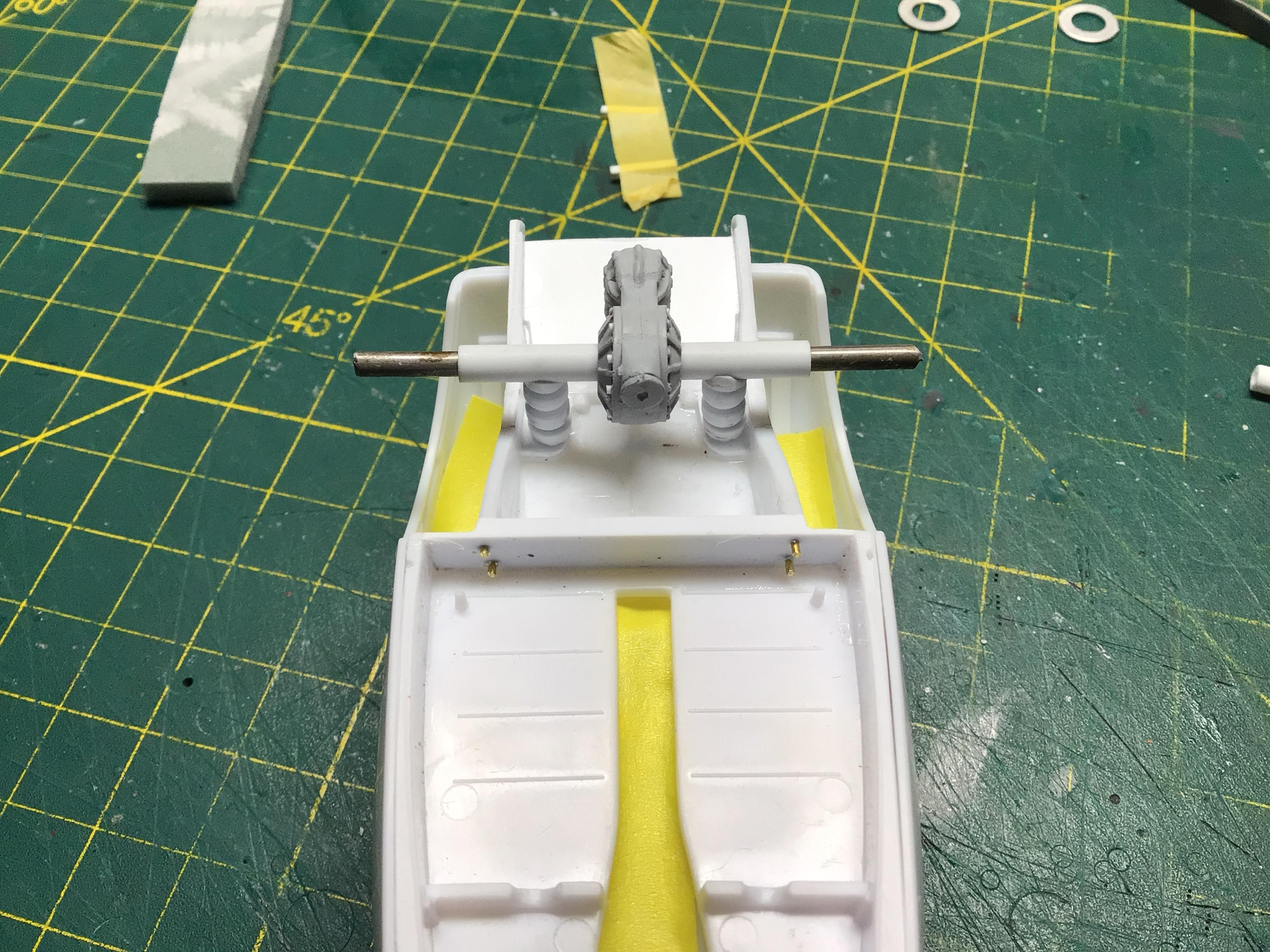

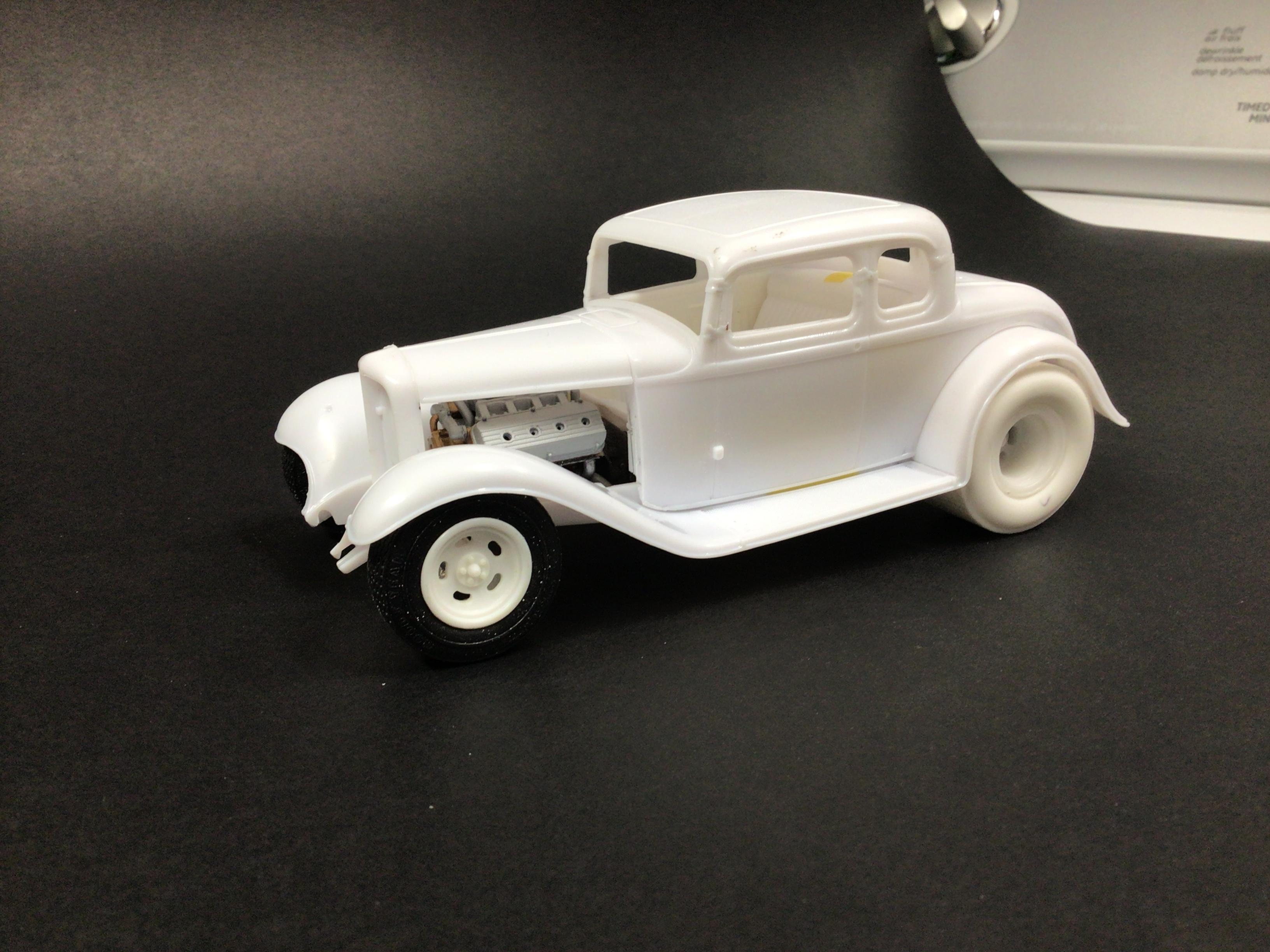

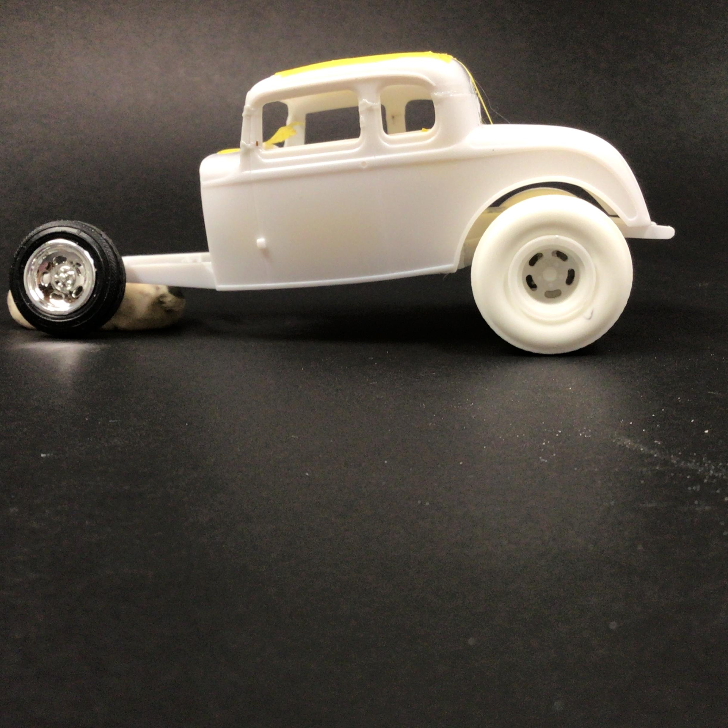

I am trying to use the rear tires I cast from the AMT ‘67 Chevelle. They are a little big but…I have nothing else close.🤪 I don’t like those rims though, so I widened the ones from the MPC ‘34 Slammer kit and cast them too.

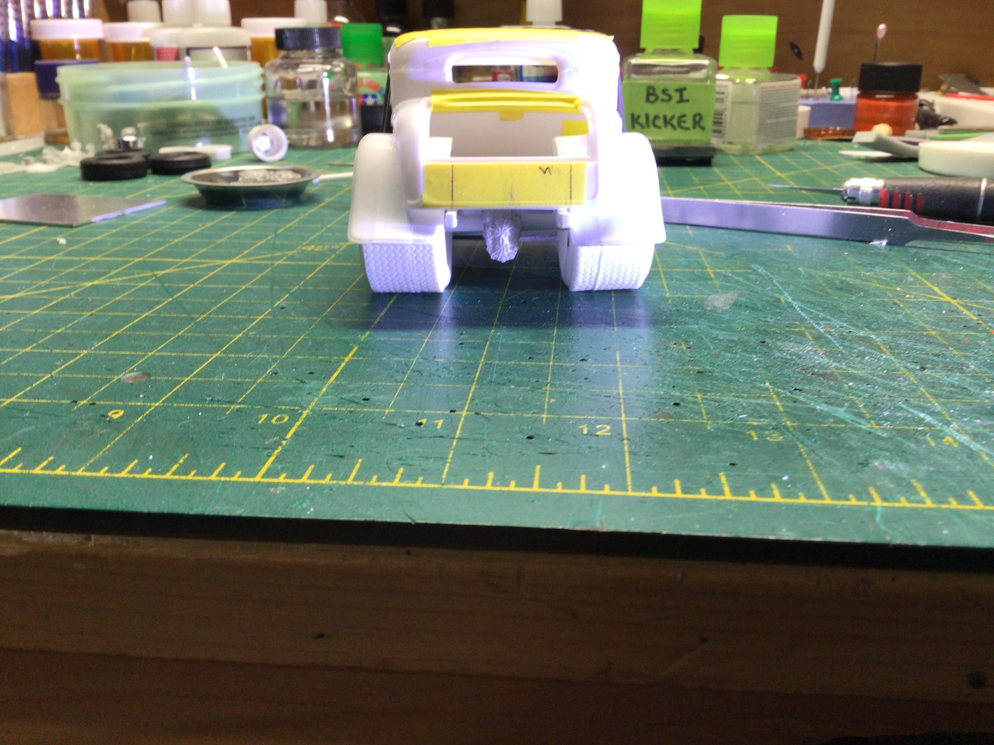

I figured I would need a very narrow center section because of the tubbing, so I scratch built a quick-change rear for it. It looks a lot bigger under the vehicle (I scaled it down off of a schematic) than when I was building it? Due to the channeling, I have to lower the entire rear end with the body and it looks too high in the back I think, so I may wind up radiusing the rear wheel arches.

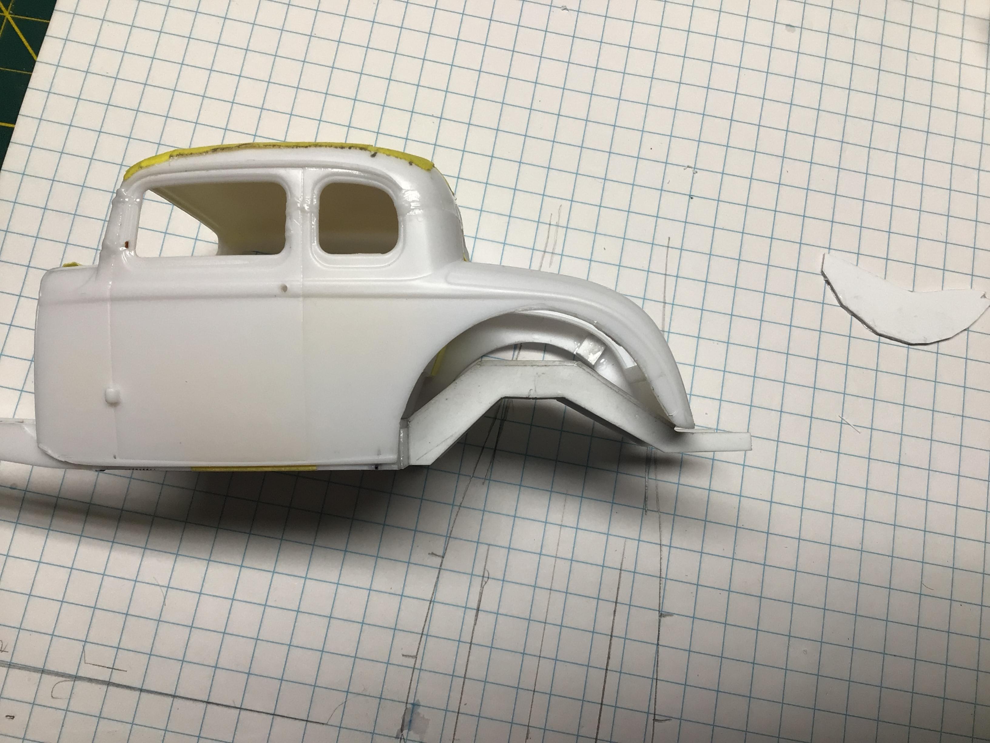

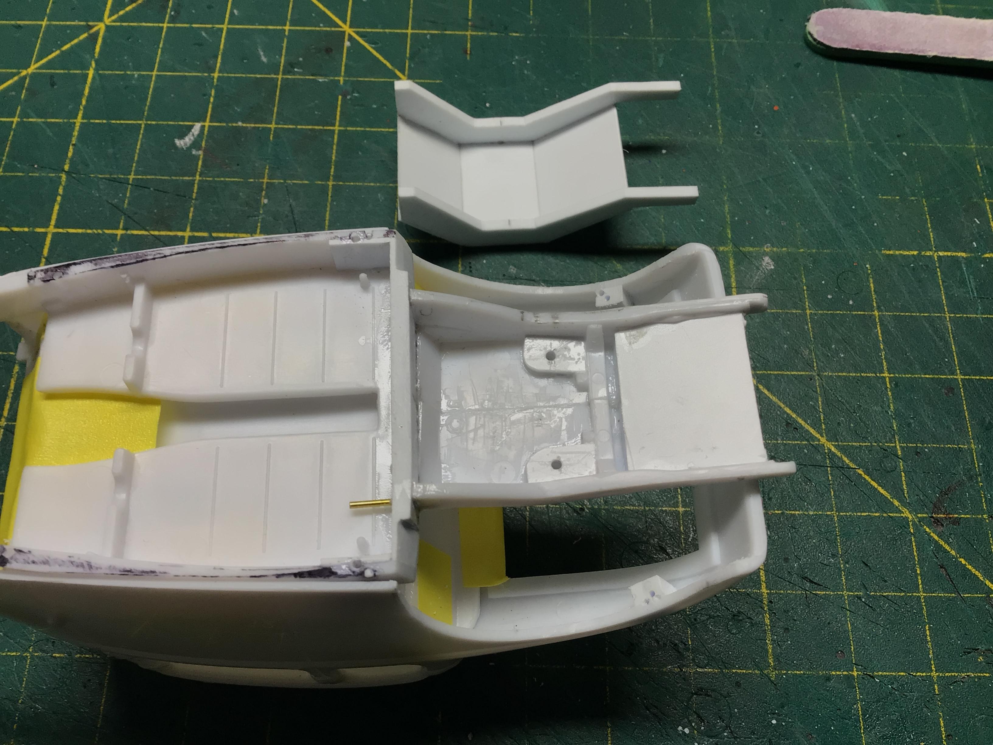

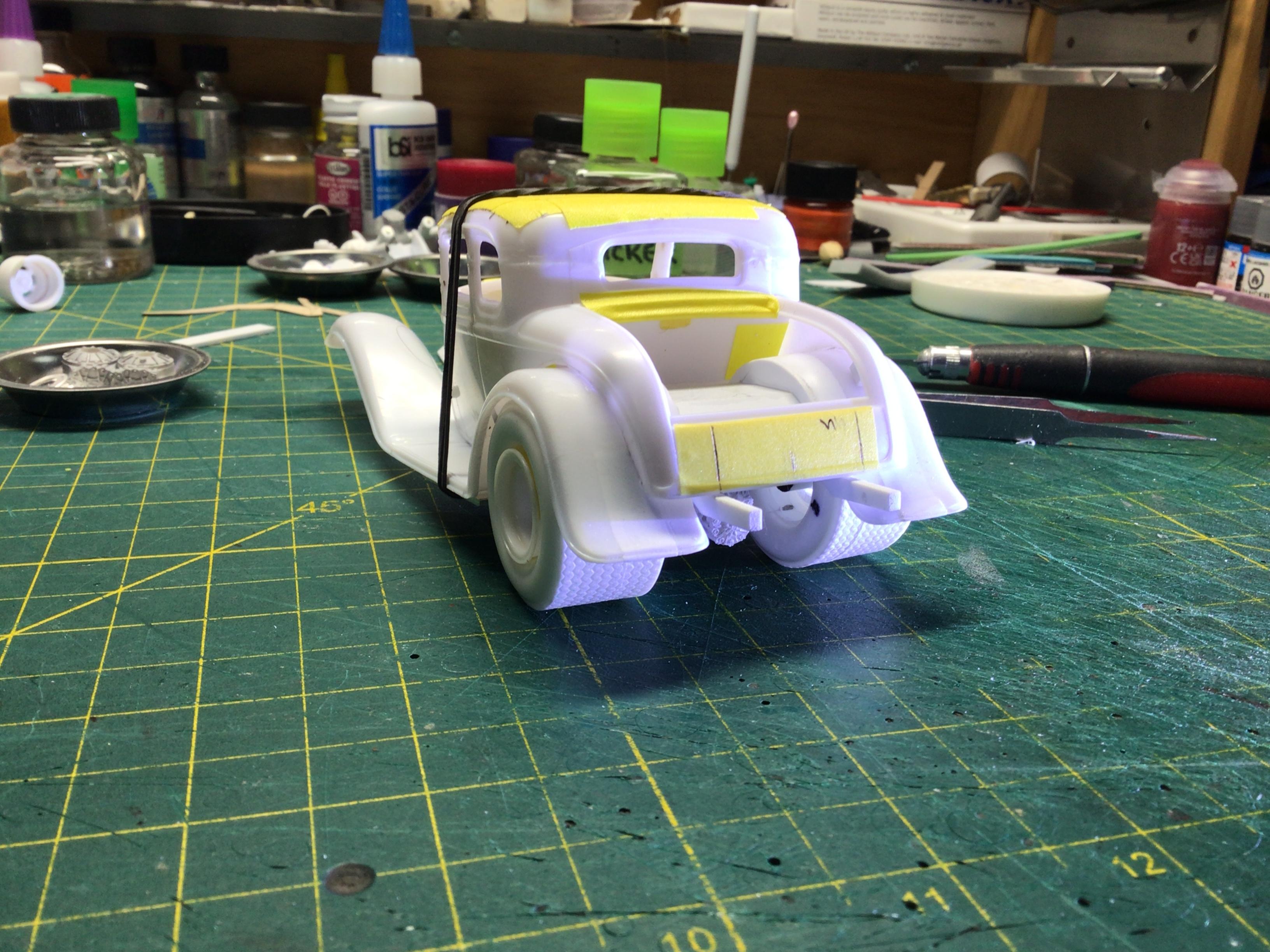

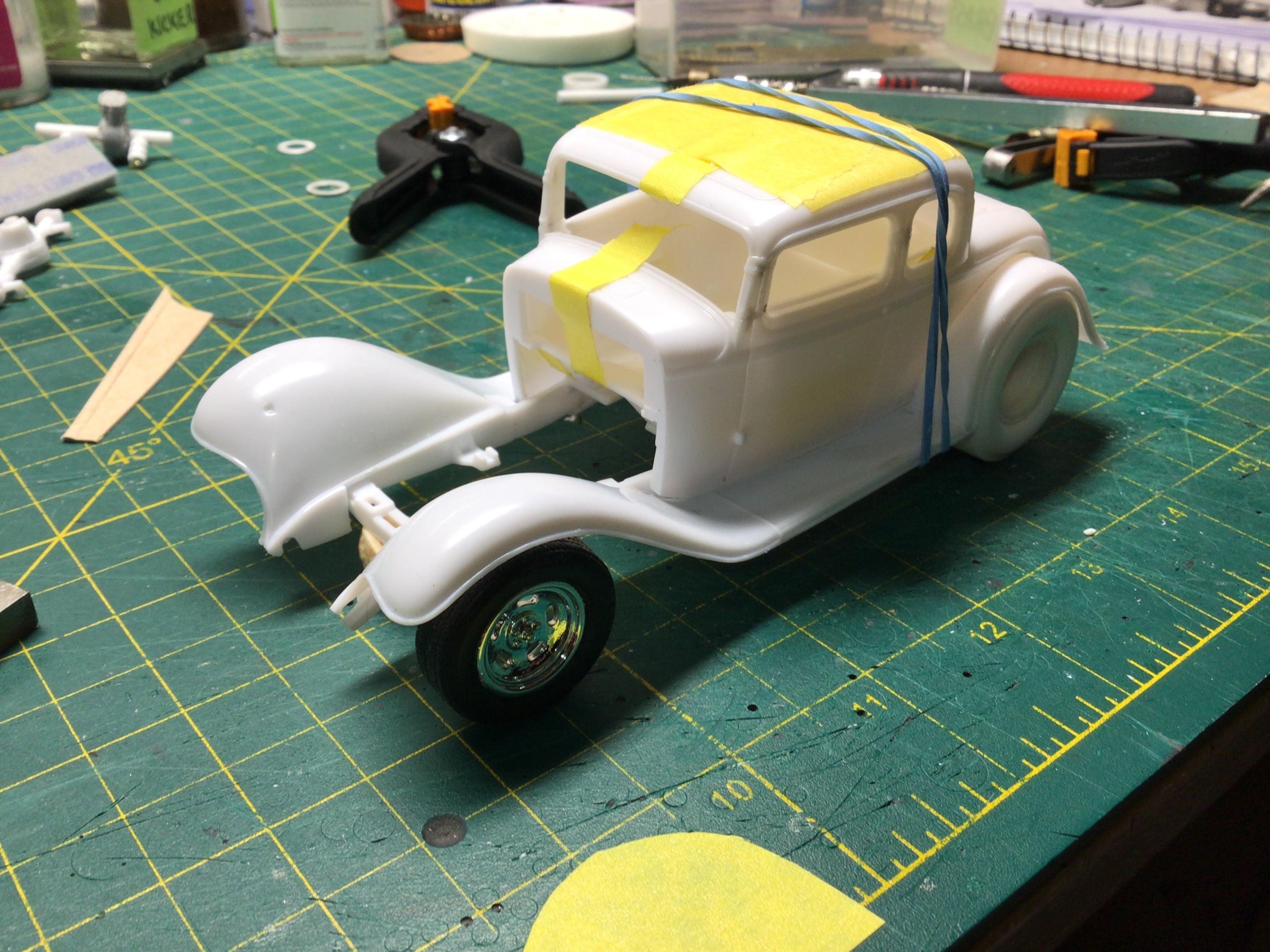

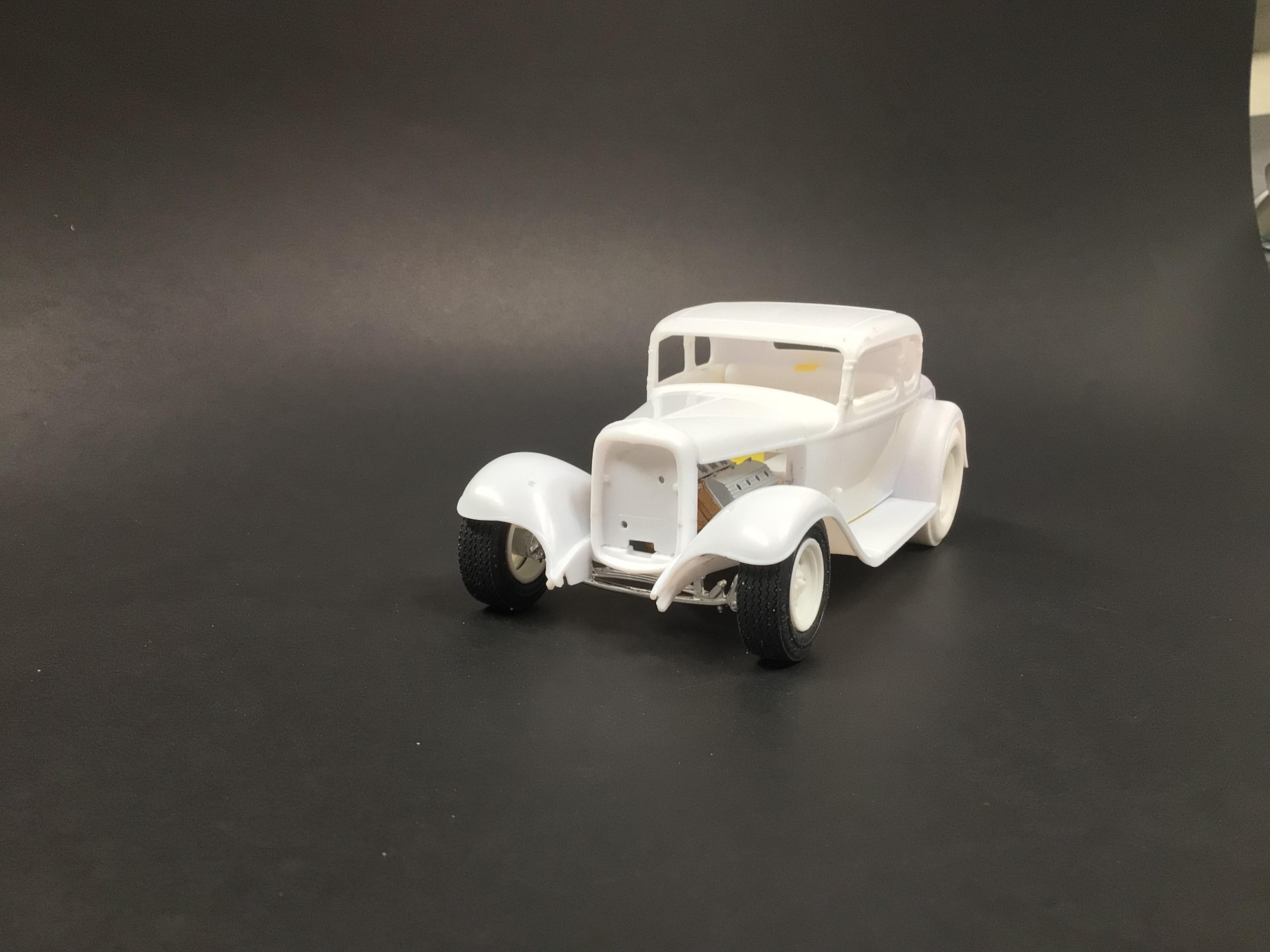

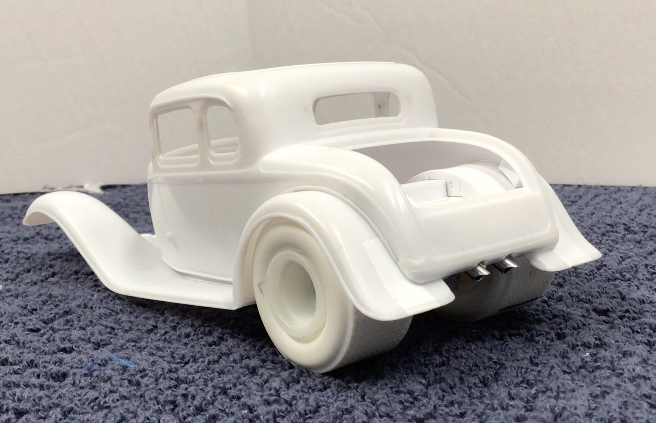

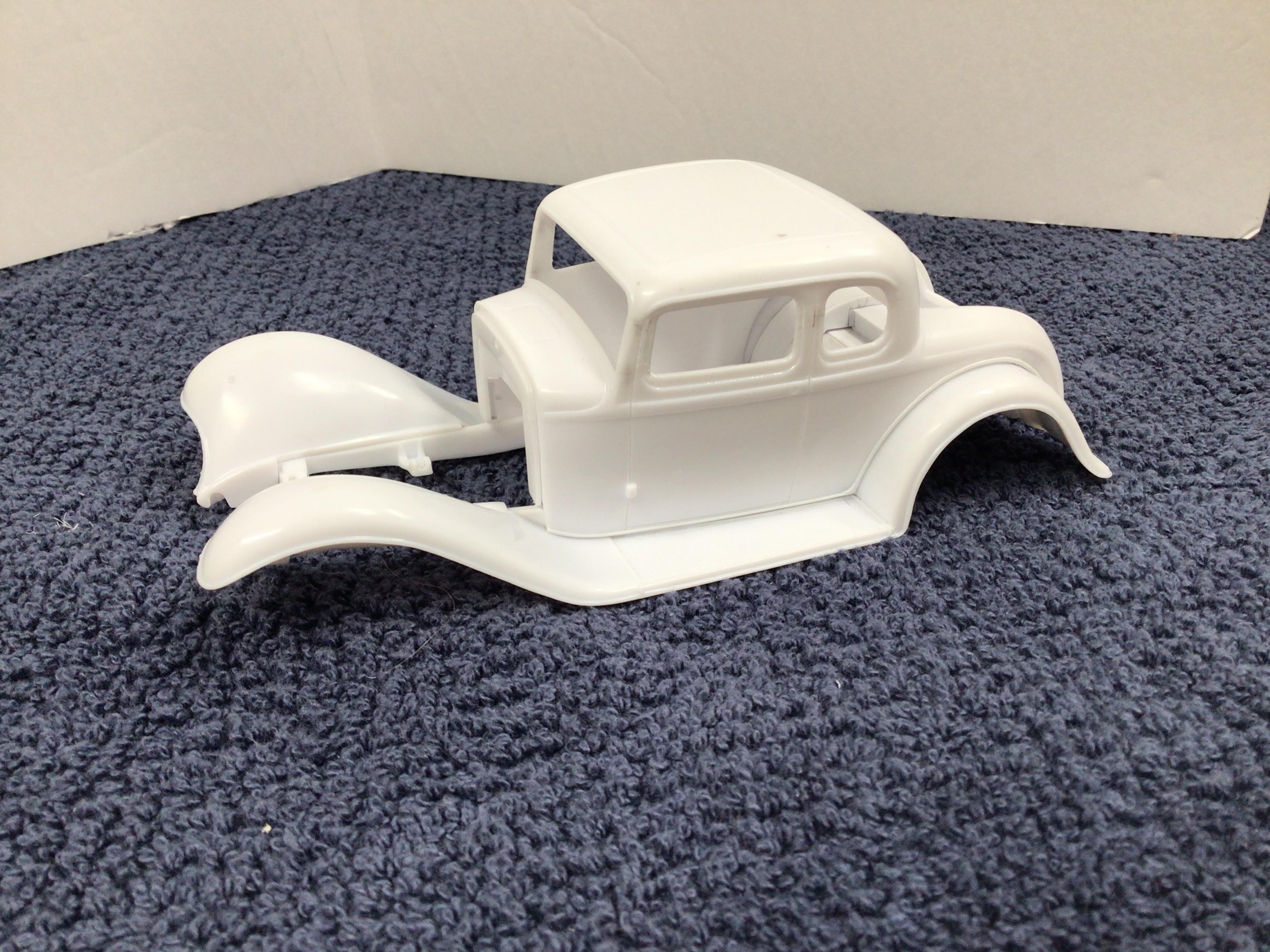

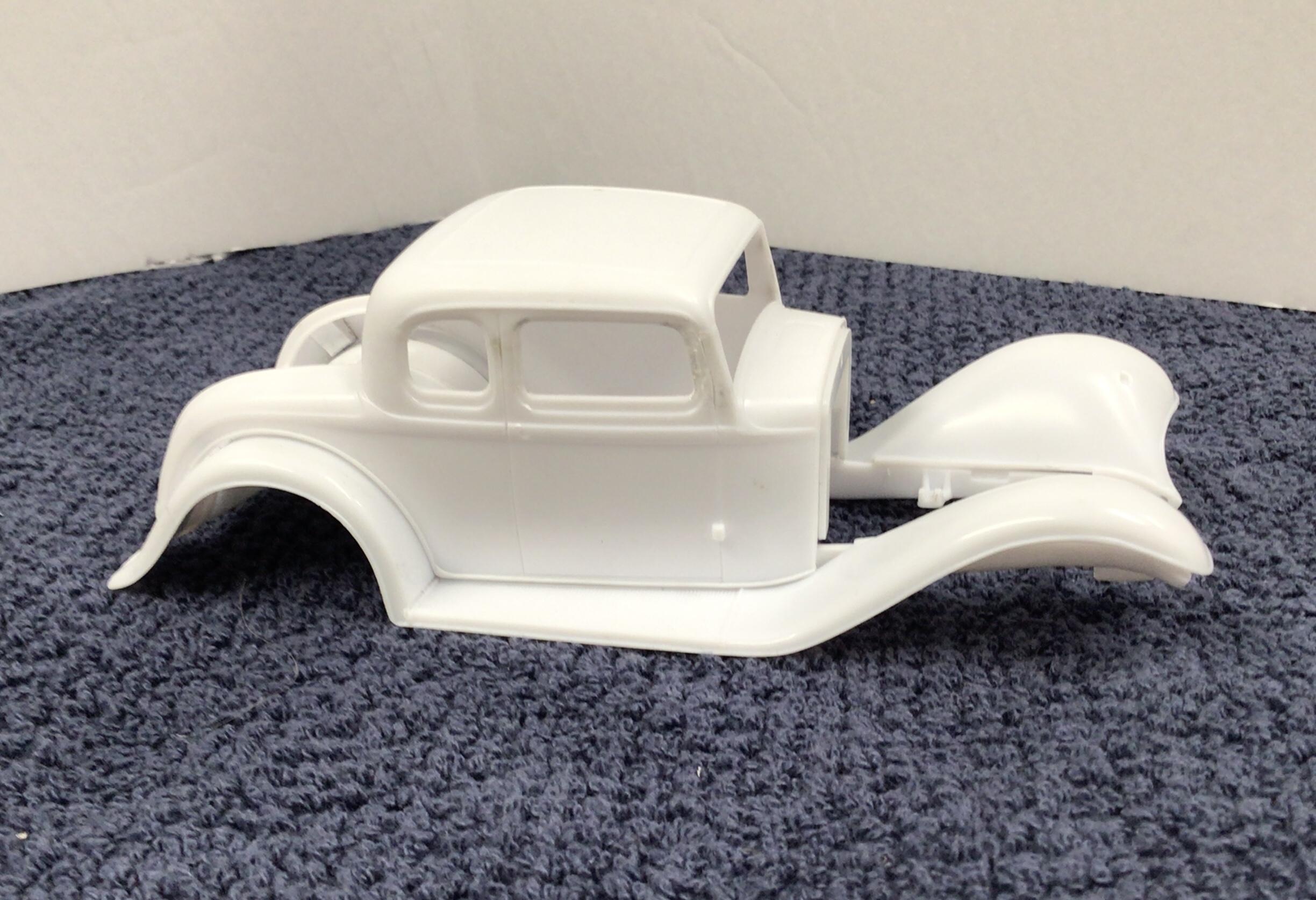

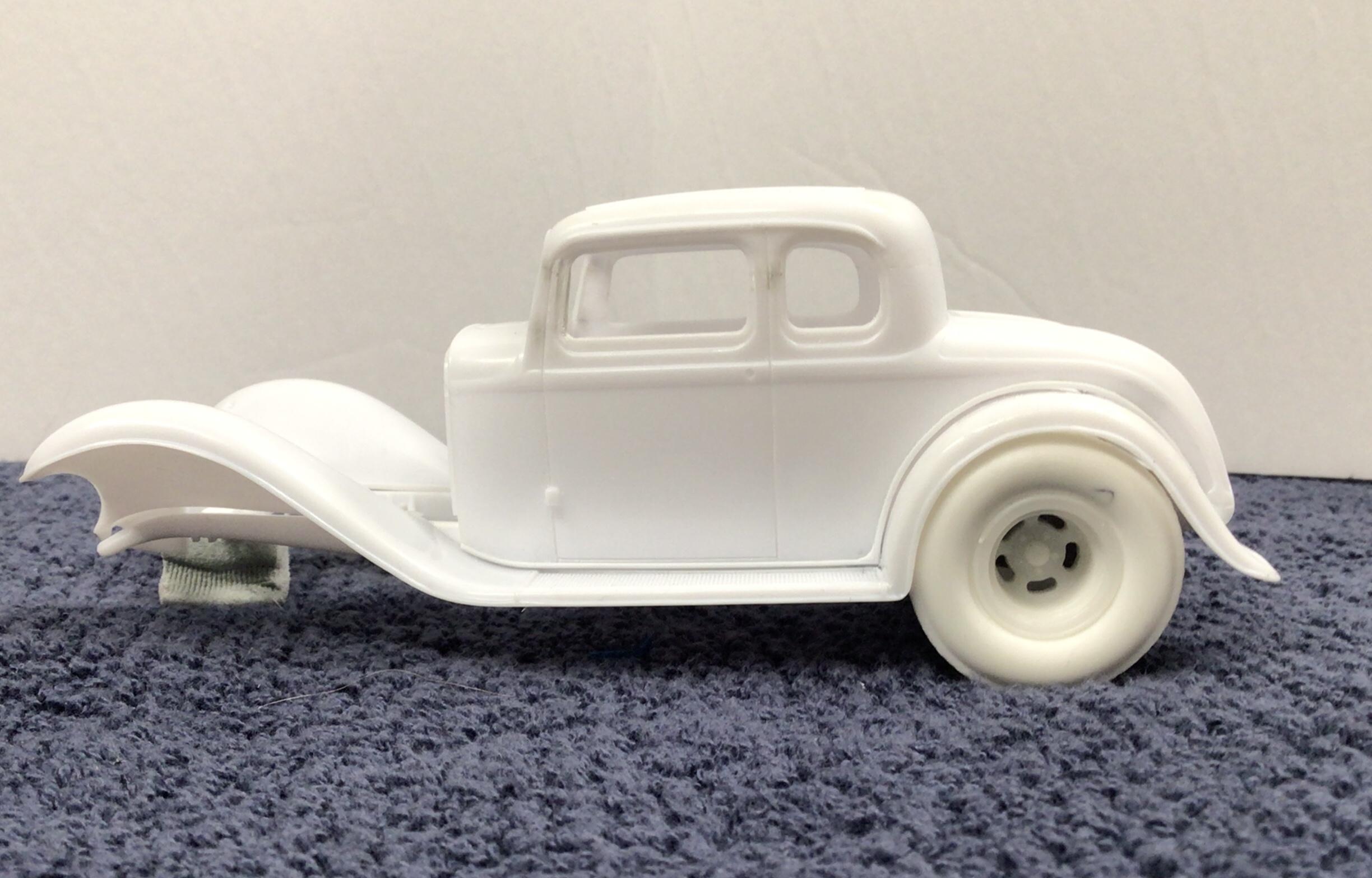

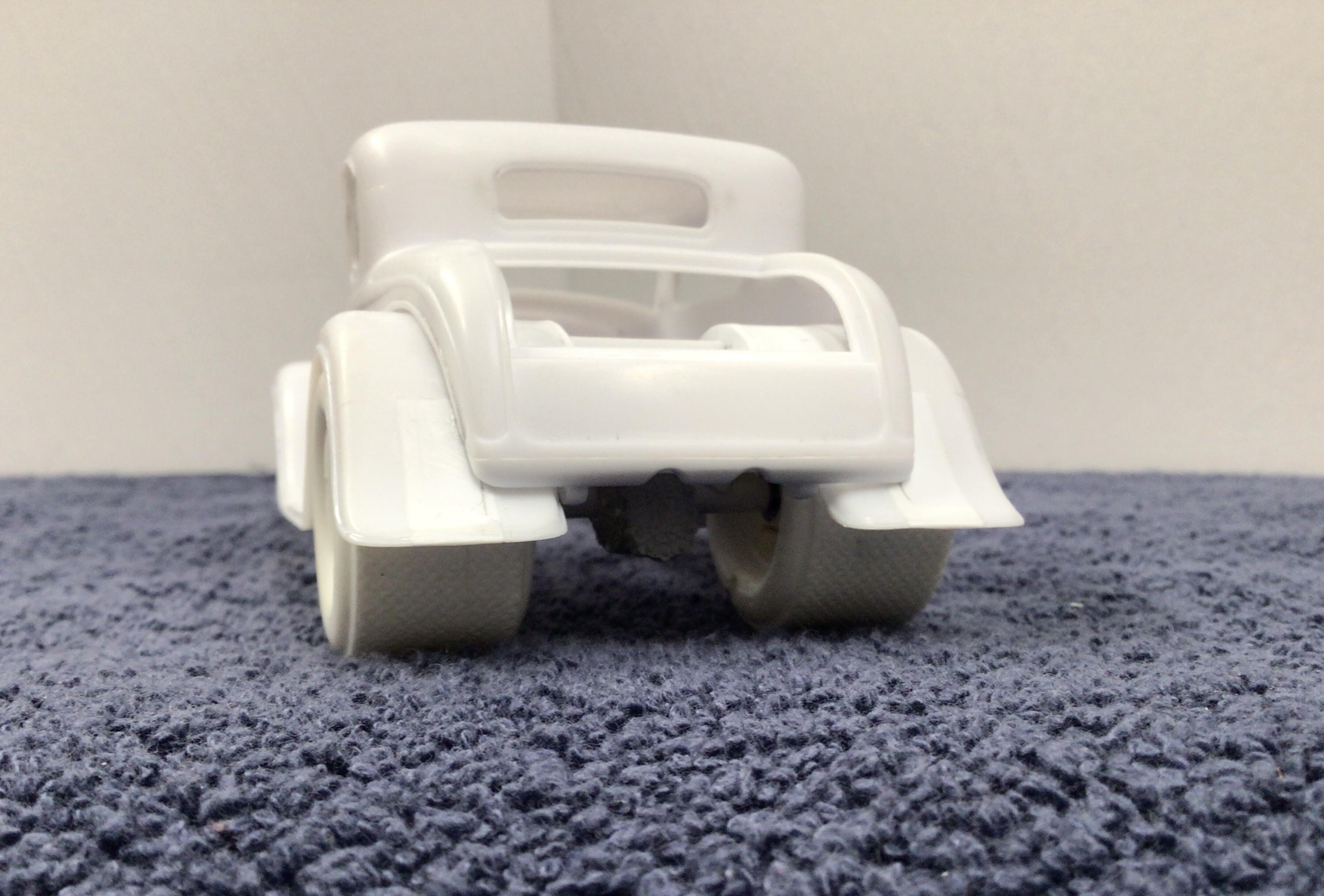

Well I decided to make a new rear frame section for this to gain some room for suspension and a touch more tire clearance. I plan to thin down the rails a touch yet, as they are a bit too beefy looking.

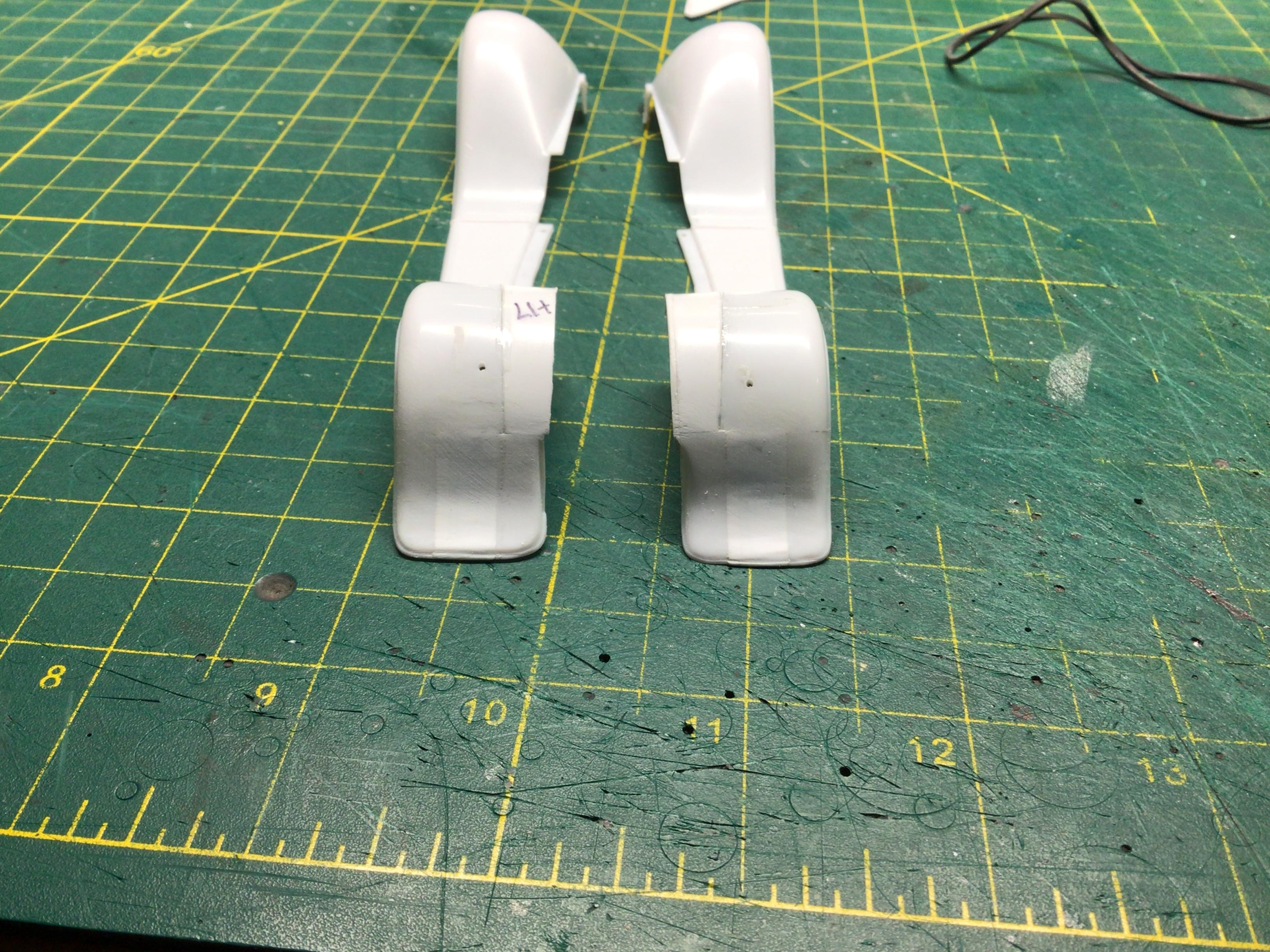

I also managed to get the rear fender widened and tubbed. I plan to bob them a bit yet, but I want to get the axles mounted and ride height set before deciding how much. That’s all for now!

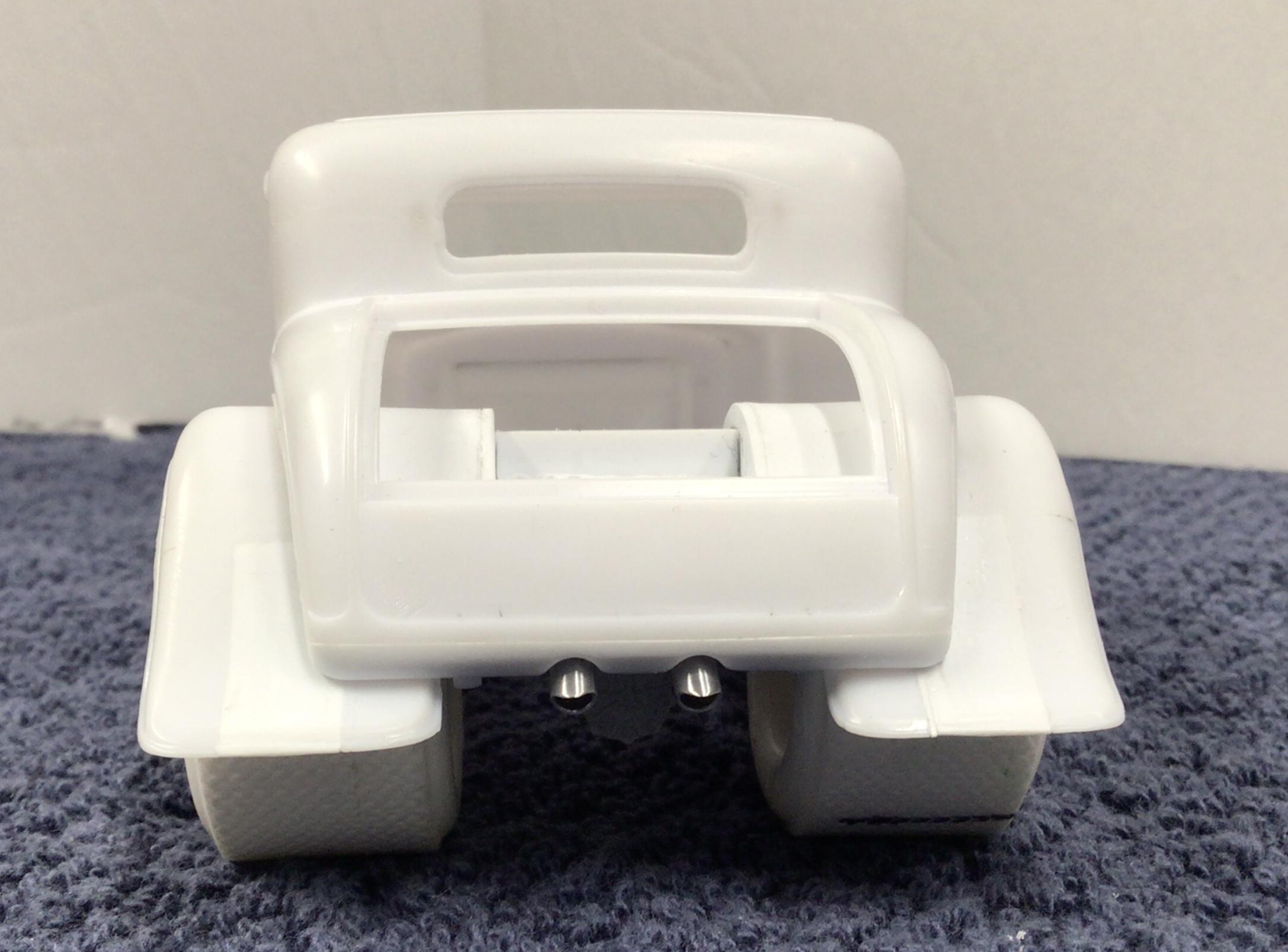

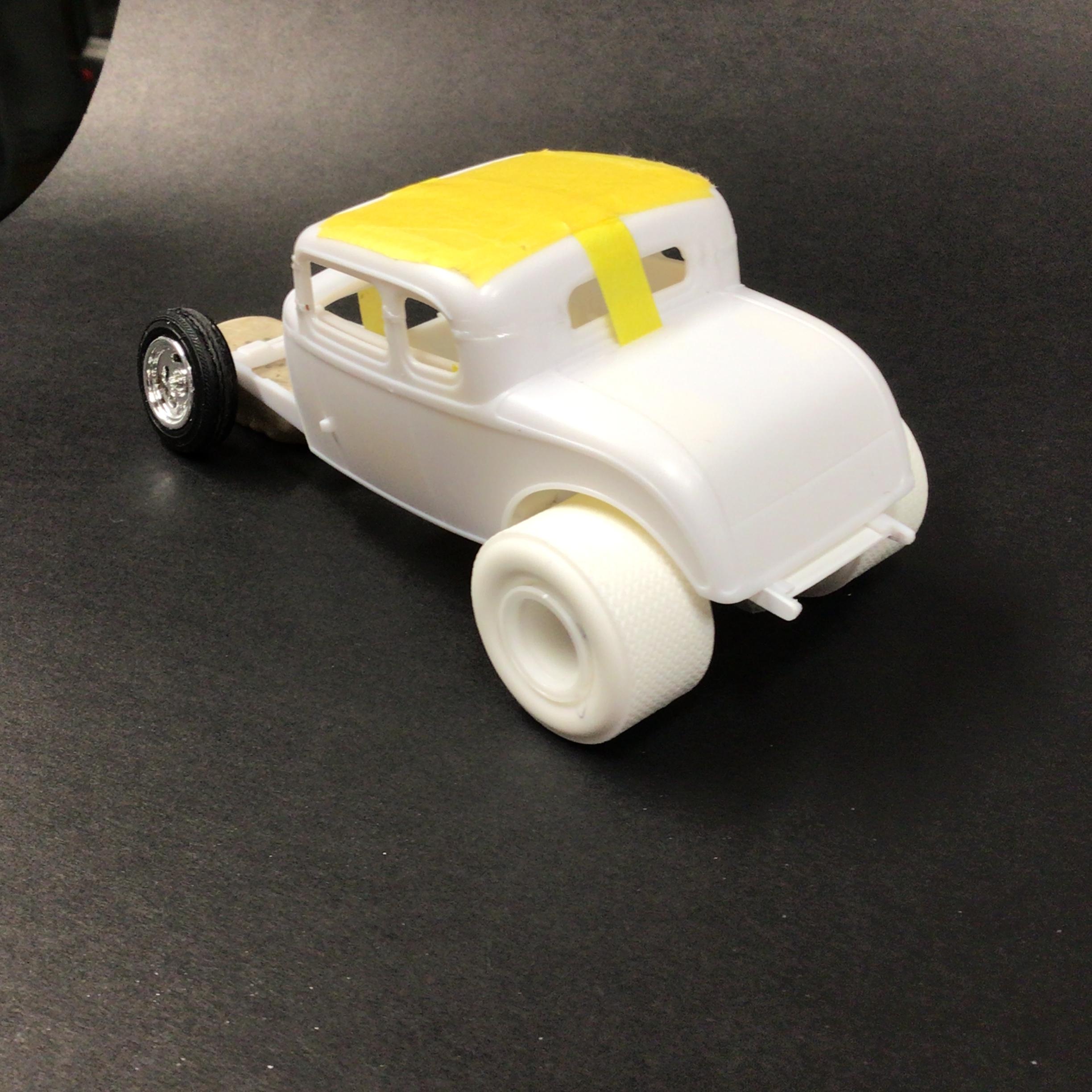

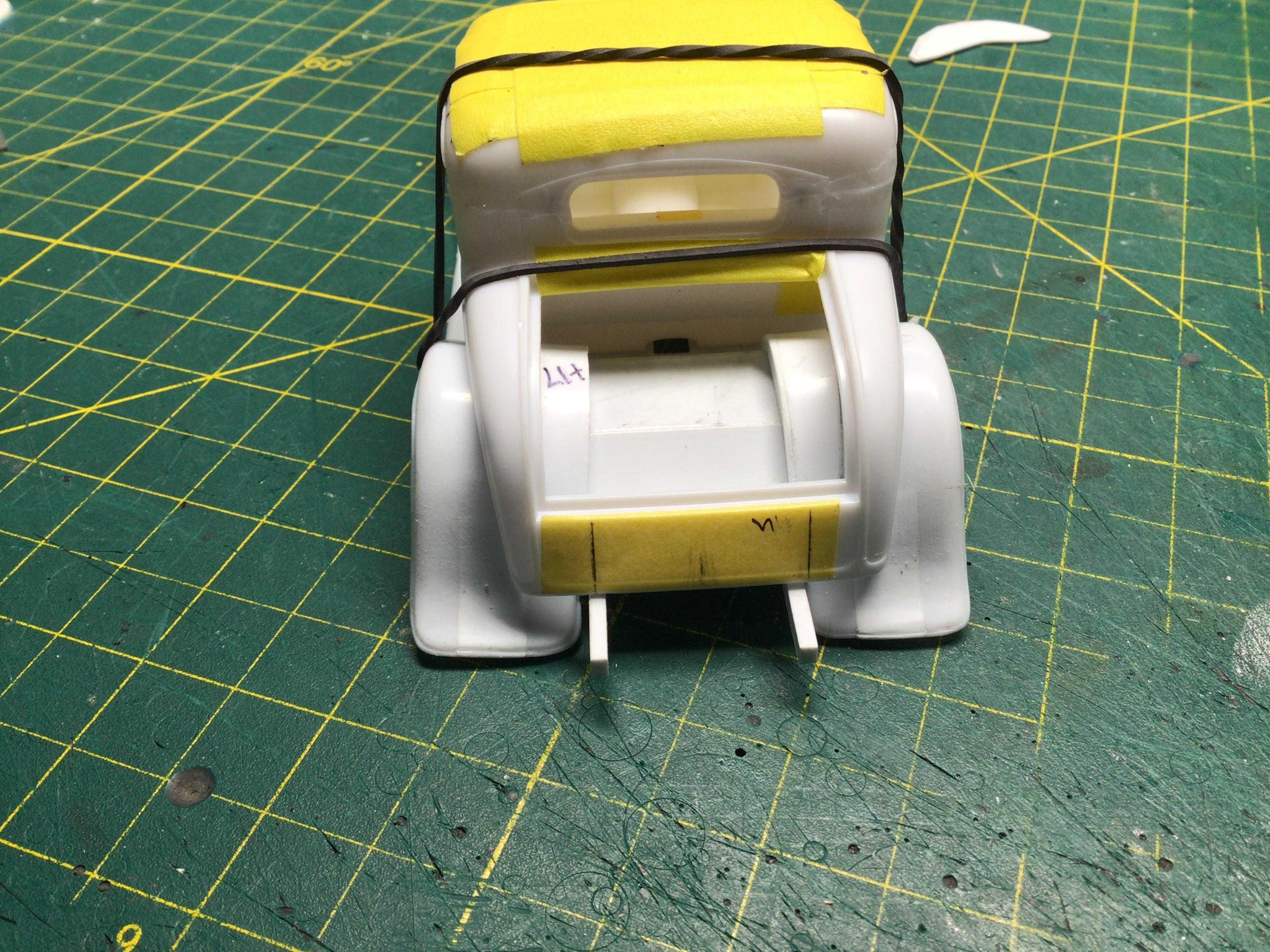

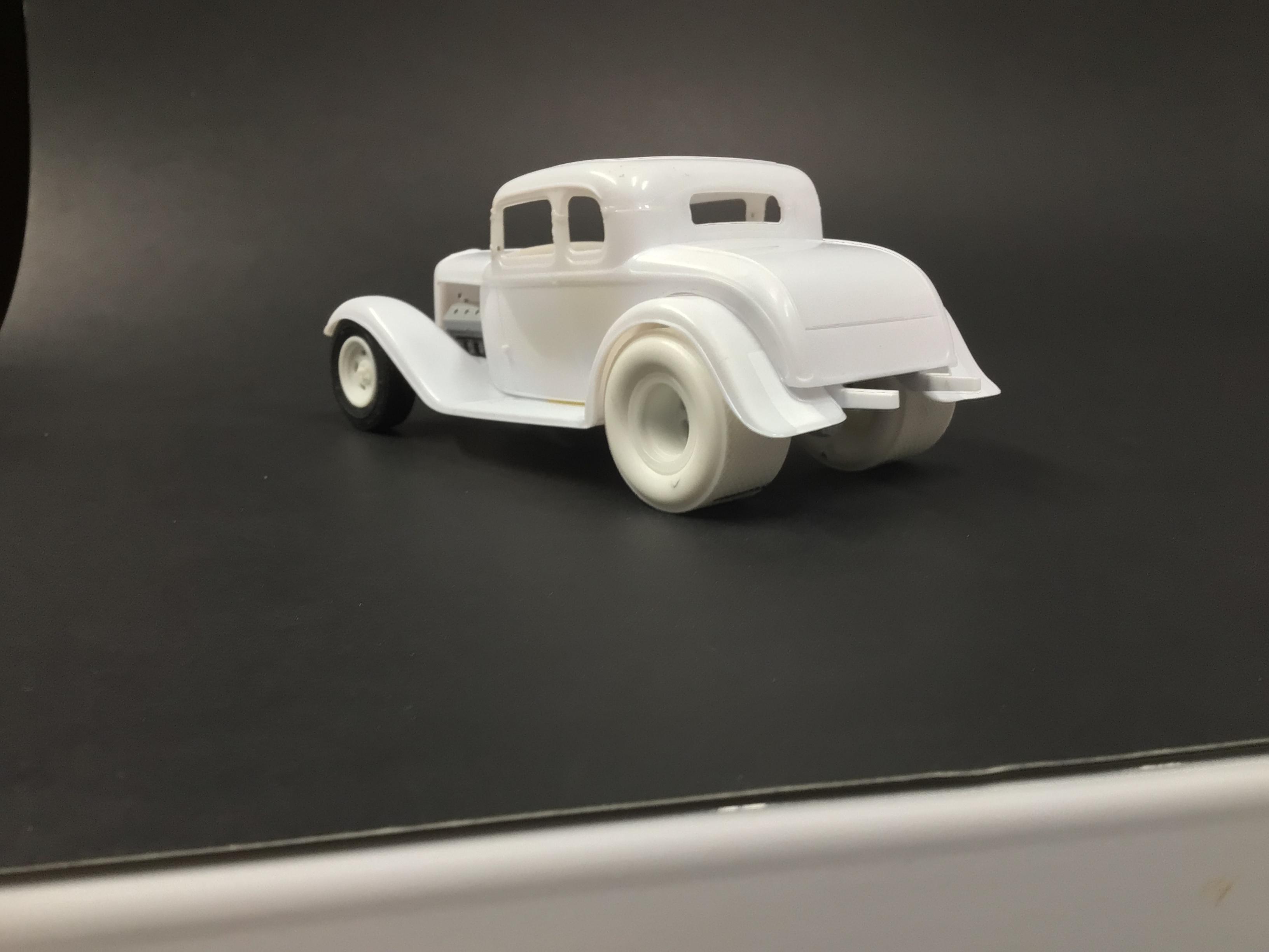

Been playing around with this one again. Not much progress, since I had to re-do the rear clip.🤬 It was not on center and kicked off to one side.😬  I’m sure I did that on purpose to get the frame rails centered at the rear of the body…but it was the body being twisted from not being modified evenly that was causing the problem. Anyways…it is all squared away now I hope. Only new progress is a rear valence added along with new lower body and wheel well trim and re-scribed lower door edge.🥴 Dropped the rear ride height a tad too, but I still need to figure out a suspension system for it.🤔
I’m take some cues from this 3 window I found online.🙂

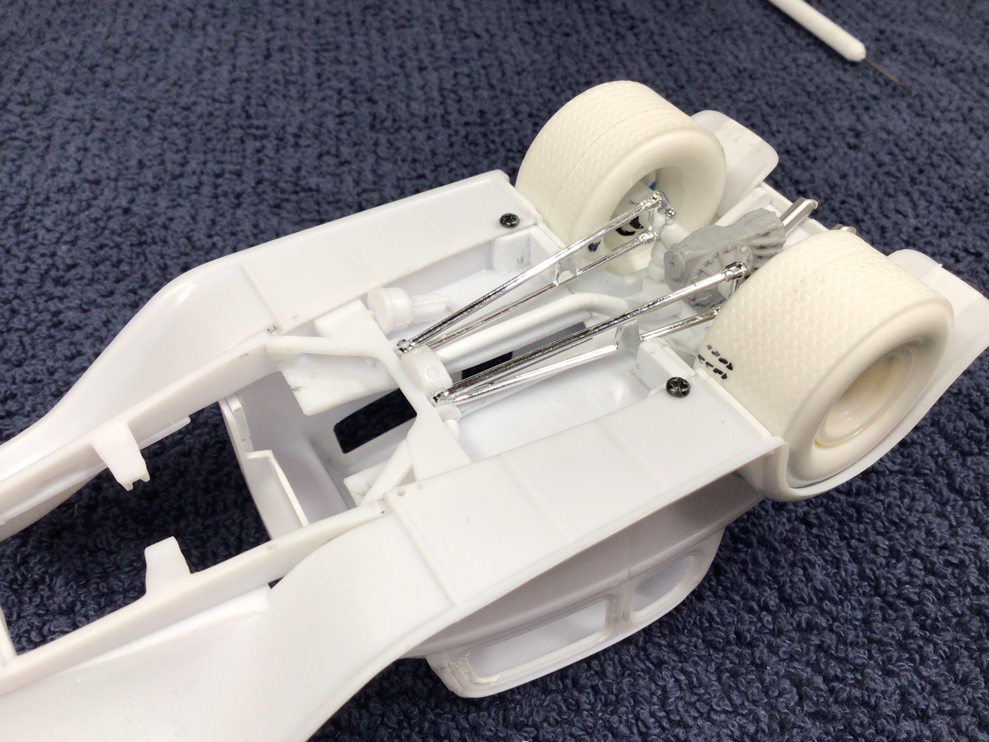

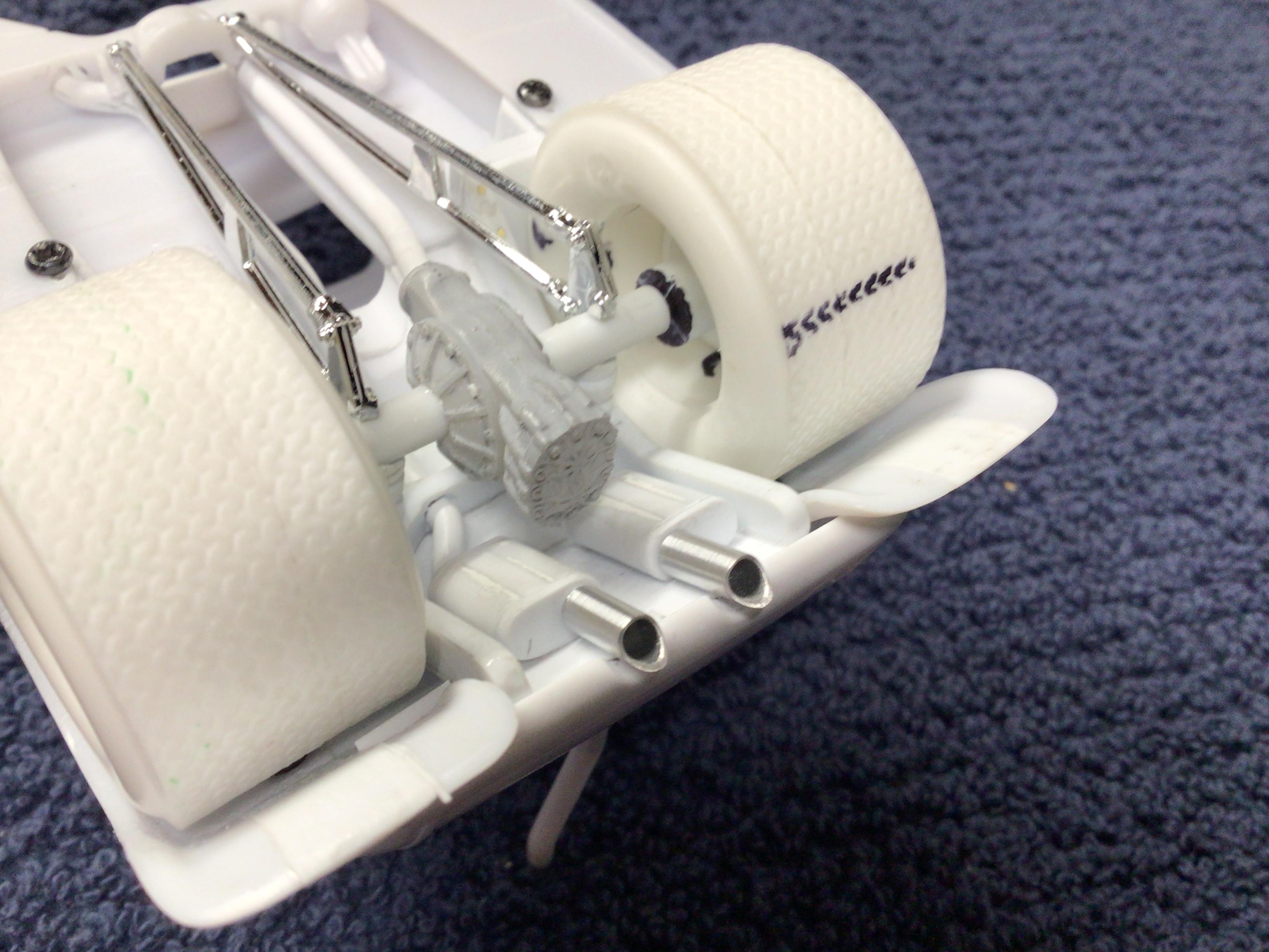

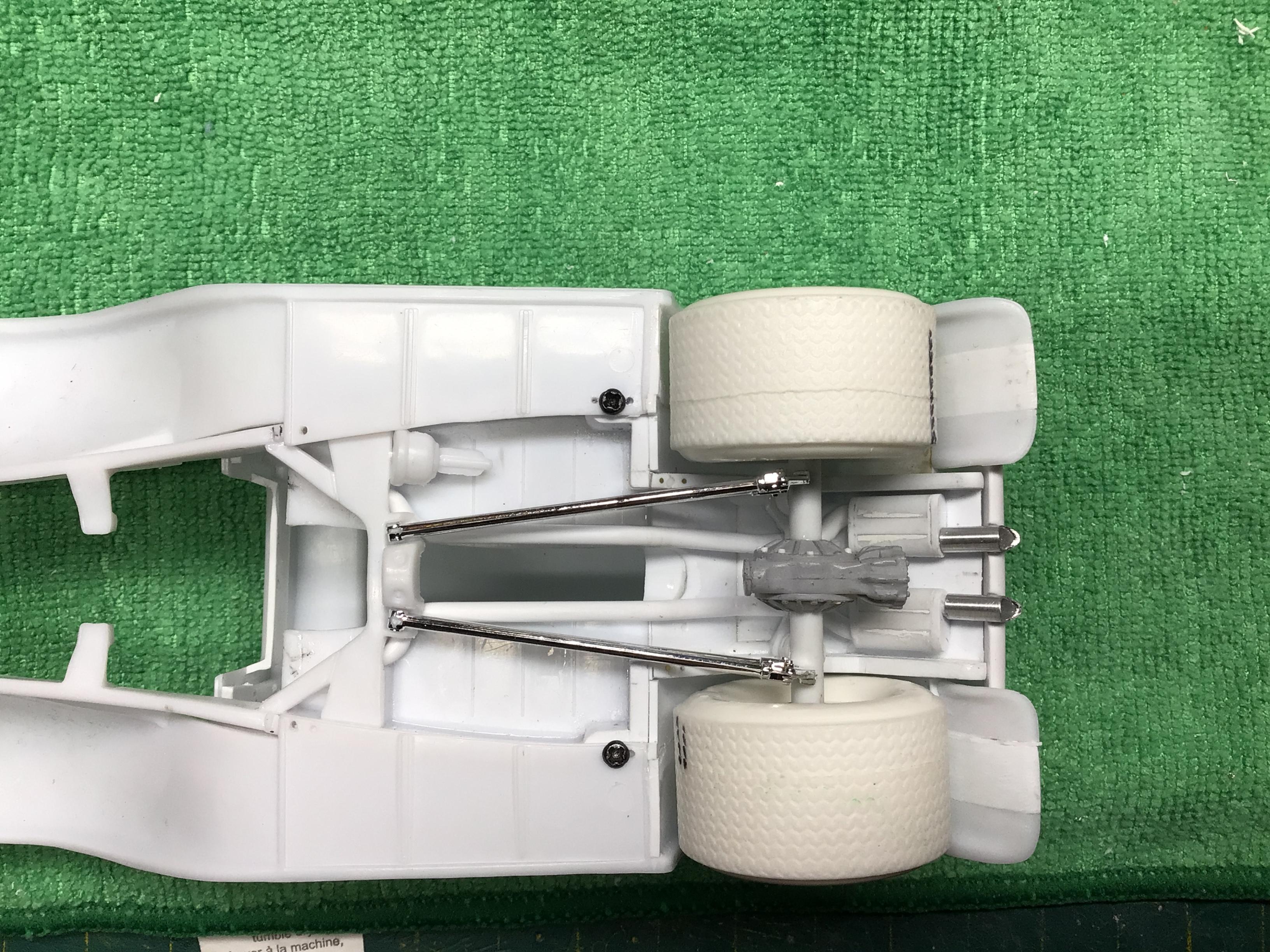

I got the back half of the exhaust roughed in and I think I can use the kit suspension pieces now. I wanted a 3” (.125”)  exhaust, but a 2-1/2” (.100”) exhaust is tough enough to snake around the suspension components.🥵
