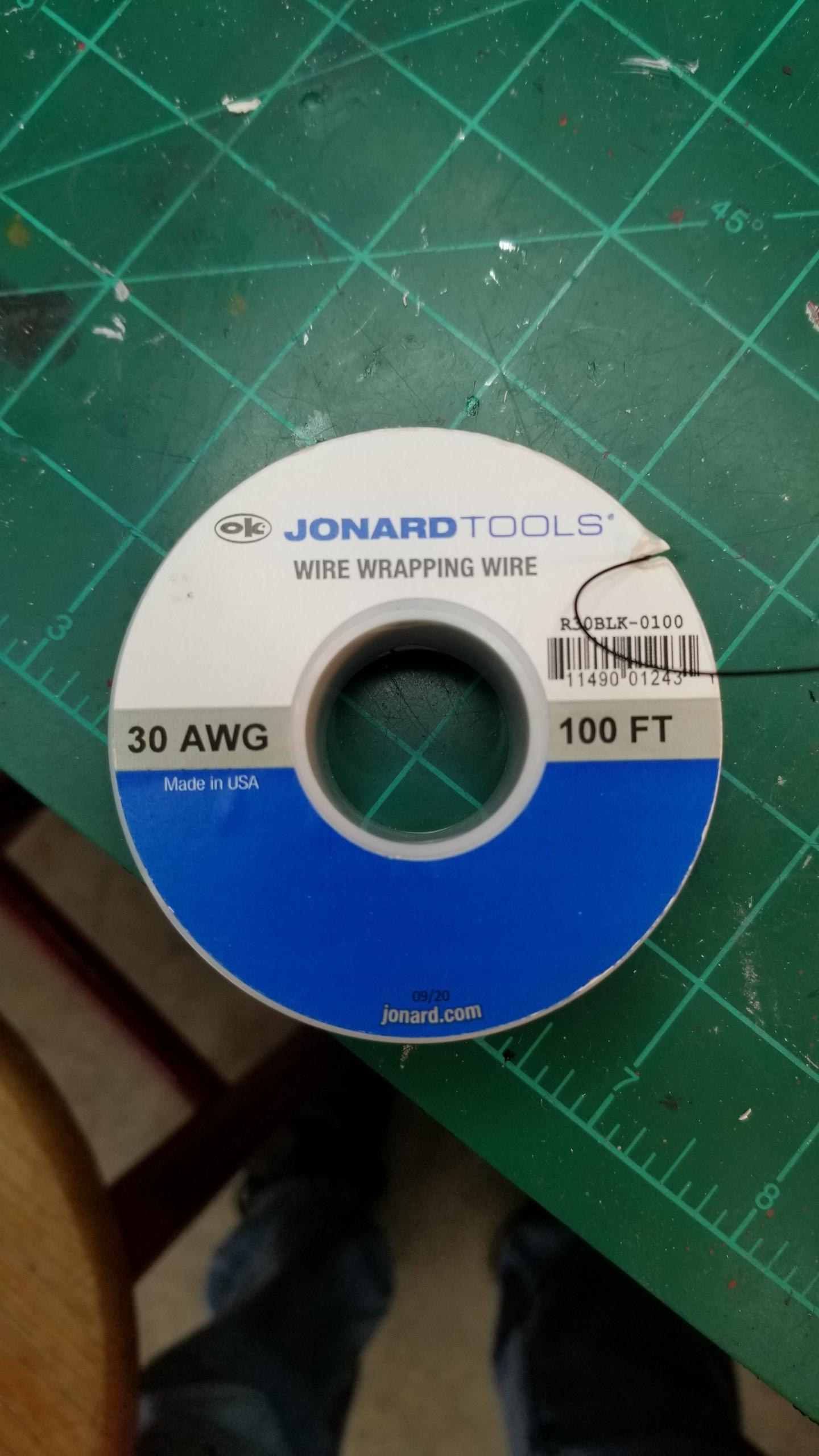

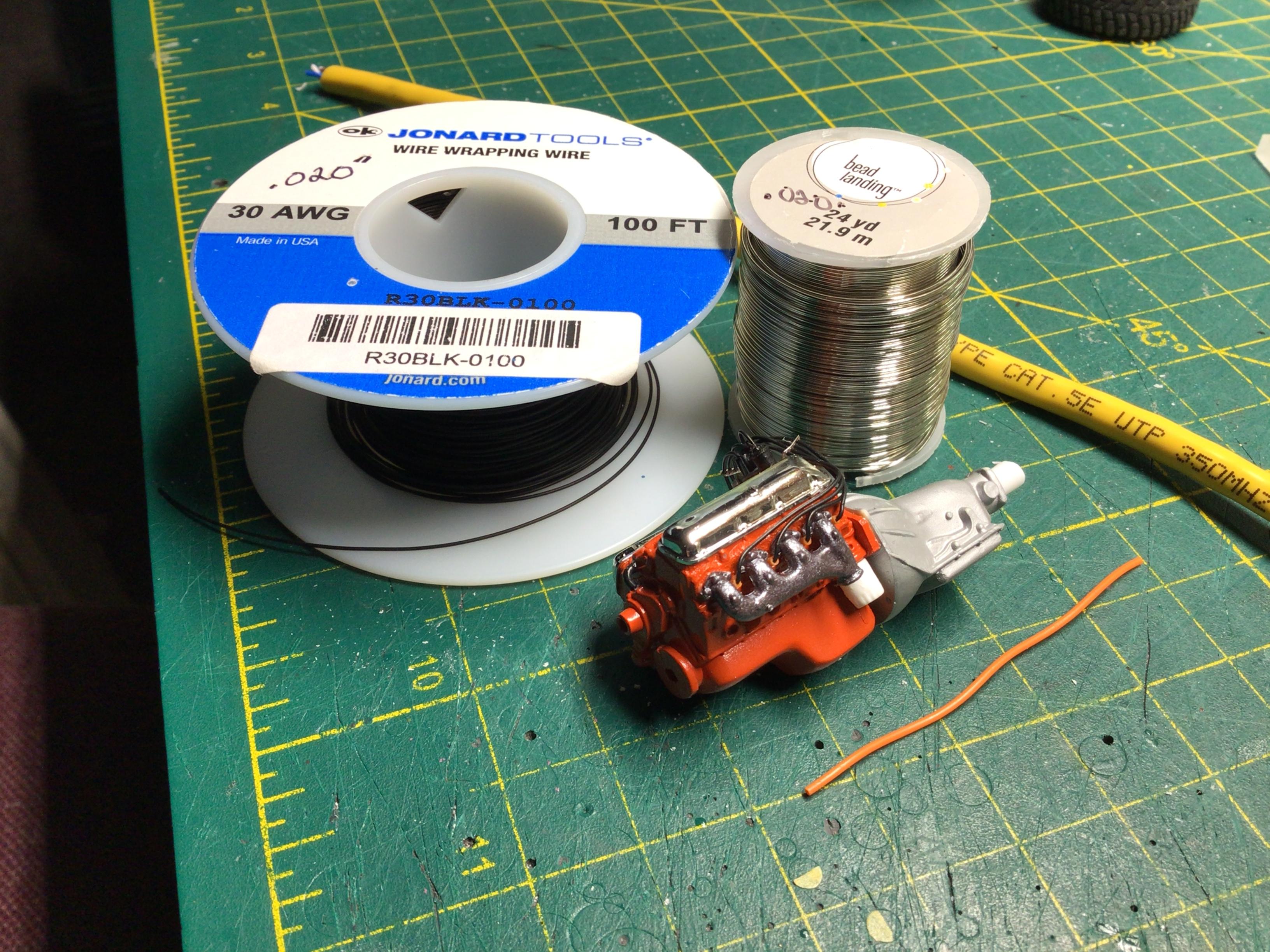

NOBLNG Posted December 18, 2022 Posted December 18, 2022 (edited) On 12/18/2022 at 8:15 PM, Zippi said: I've been using this wire for some time now. Expand Same here. I have black and yellow. It is 0.020” diameter. Edited December 18, 2022 by NOBLNG
customline Posted December 18, 2022 Author Posted December 18, 2022 Thanks, Greg and Bob. I'll see if I can find some.

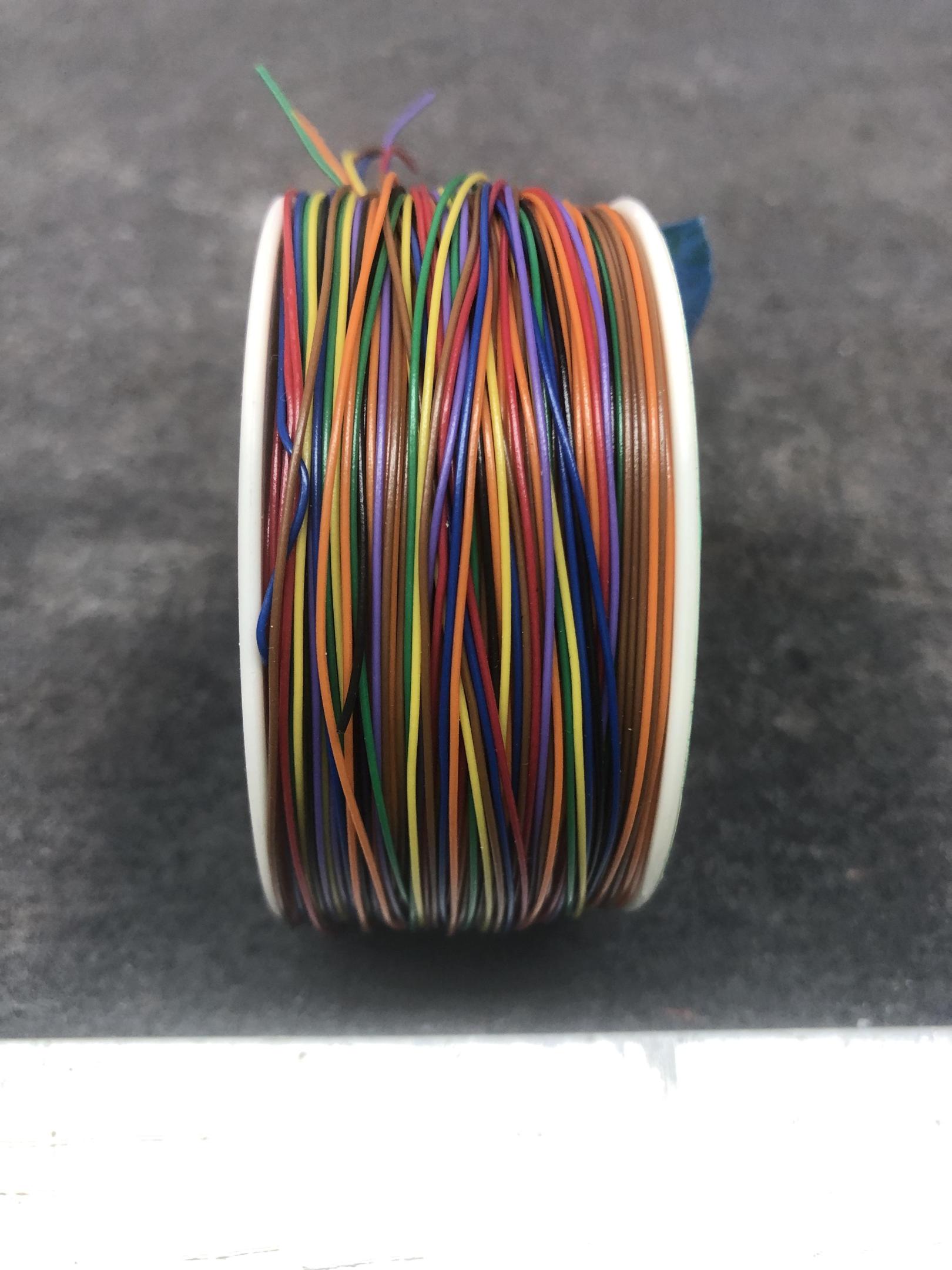

Keef Posted December 18, 2022 Posted December 18, 2022 I ordered this off of Amazon. Don’t know about fitting the wire looms. 1

deuces wild Posted December 25, 2022 Posted December 25, 2022 I'd use awg-32 for 1/25 scale and awg-30 for 1/24 scale..
NOBLNG Posted December 25, 2022 Posted December 25, 2022 The 30AWG wire shown above measures 0.020” which is 0.508mm so it likely would not fit the detail master looms. It looks OK for 1/25 scale in my opinion.

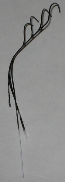

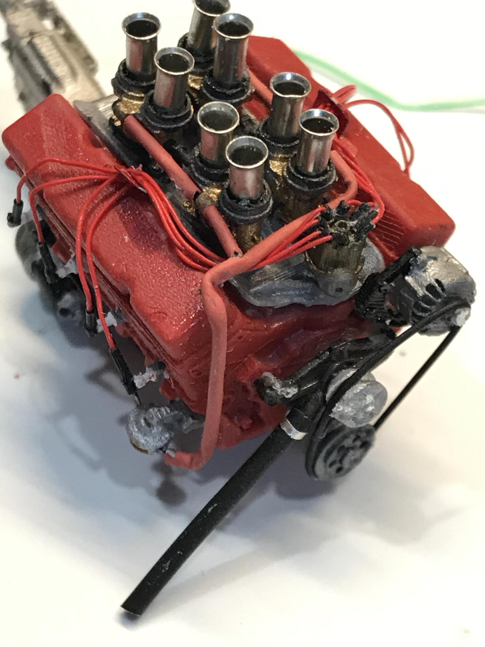

NOBLNG Posted December 30, 2022 Posted December 30, 2022 (edited) I made these plug boots from the insulation on the orange wire from a CAT5 cable. The wire loom I made from a flattened piece of solid wire. You need some good quality bits to drill the looms though. Edited December 30, 2022 by NOBLNG 2
