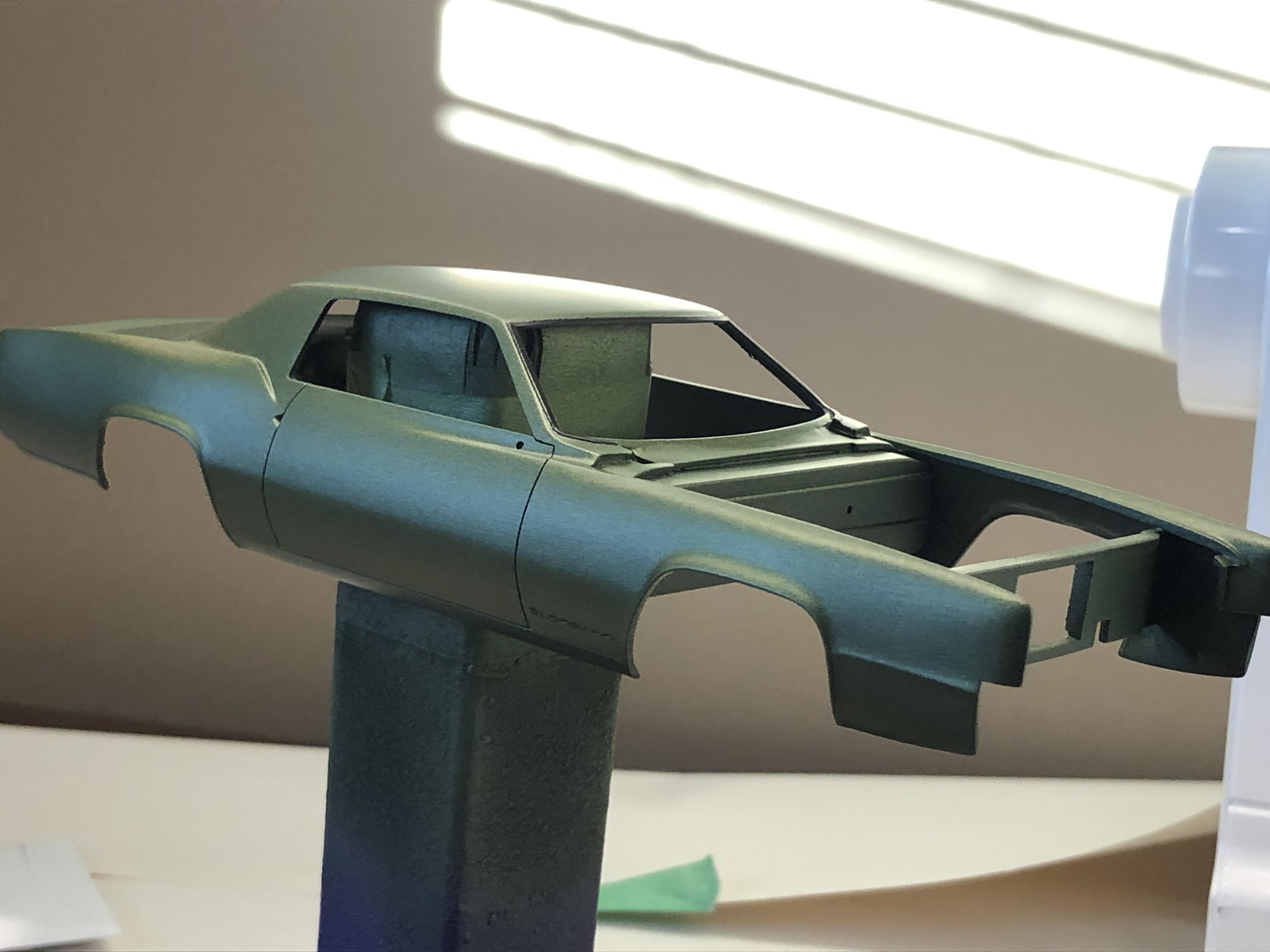

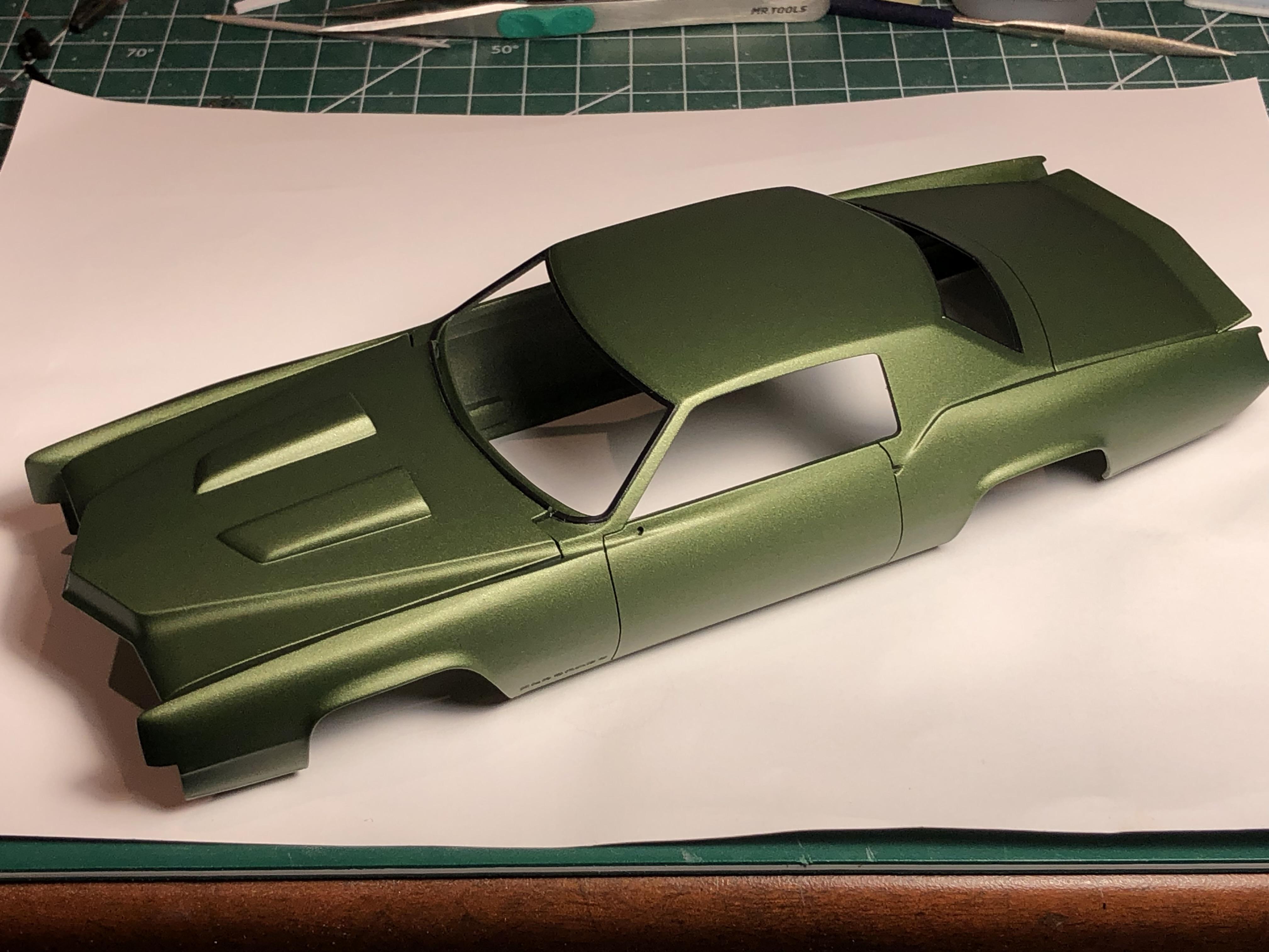

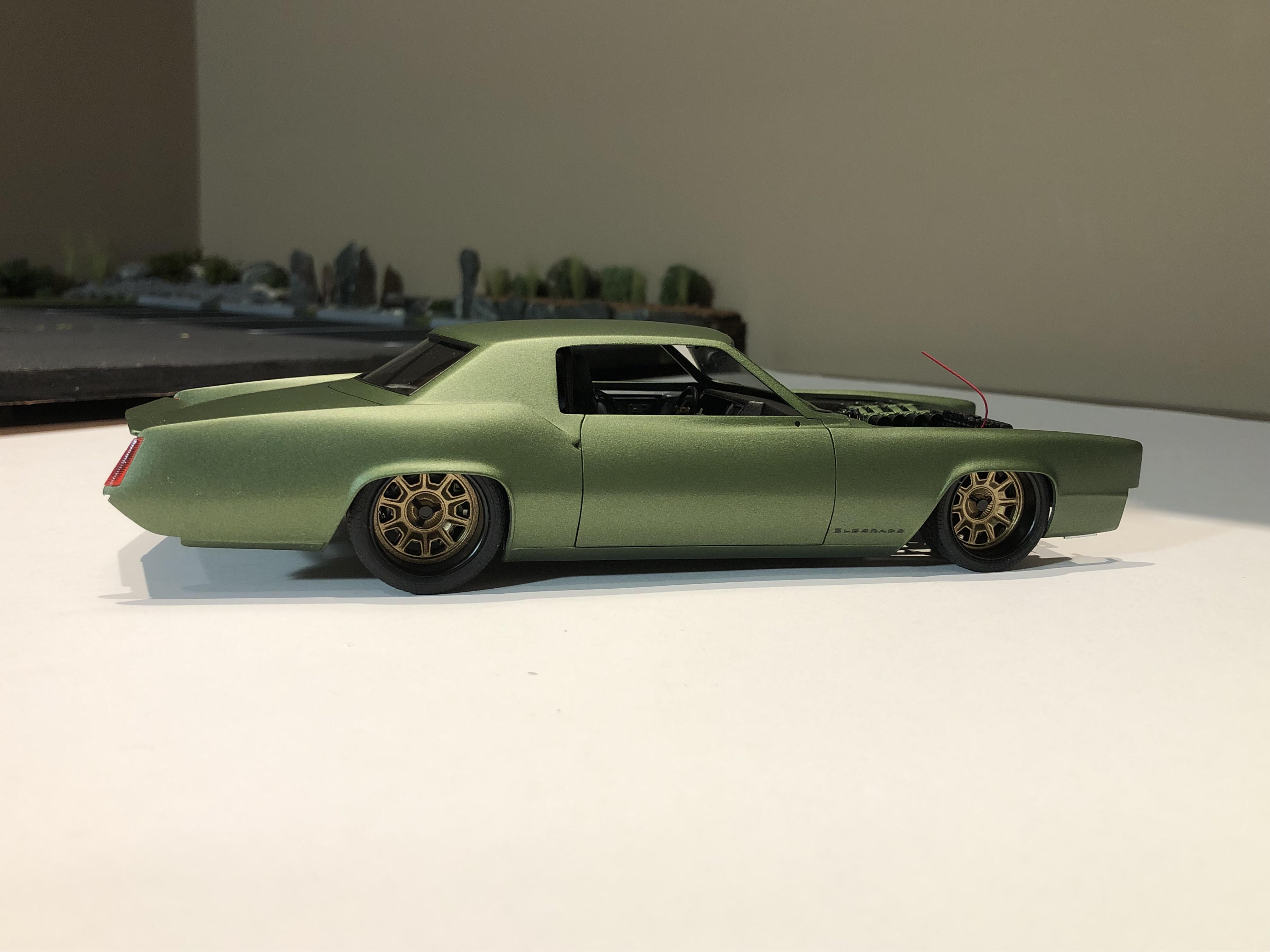

PAINT!! At long last, the body is now in colour. It’s very hard to capture the matte finish well. I will need to get some outside shots with indirect sunlight later. It turned out as I was hoping, and the matte finish ties in the stealth aggressive look I wanted. No mock up yet, but you know I’ll have one up soon. So, after the base coat of Tamiya semi gloss black, it was 2 light coats of Vedoro green, then a medium coat. After that it was 2 light coats of Tamiya pearl clear, then one mist coat of Mr. Hobby super smooth matte clear, followed by a medium/heavy coat. I masked the window trim before applying the green.
First two photos are in direct sunlight, then under artificial lighting.
I cut down some bootlace ferrules to use on the intake. They are now painted black, no photos of them finished yet, hoping to glue them in place tomorrow…
The exhaust headers would not fit between the frame rails, so after an extensive search thru kits and parts bins turned up no suitable options, I decided the easiest solution was to modify the headers that came with the engine. Cut the flange off, removed some length off the tubes and reattached. Yes… those flanges are both beautifully printed, and extremely fragile.?
Not getting too carried away with engine detail, spark plug wires, fuel rail, and I will add heater hoses later. And the finished seats which I may already have shown.??‍♂️
Very pleased to finally have this thing in colour!! Should have the engine complete tomorrow, also have some disk brakes ready for paint. With any luck, it could be a “rolling chassis” by end of Monday…

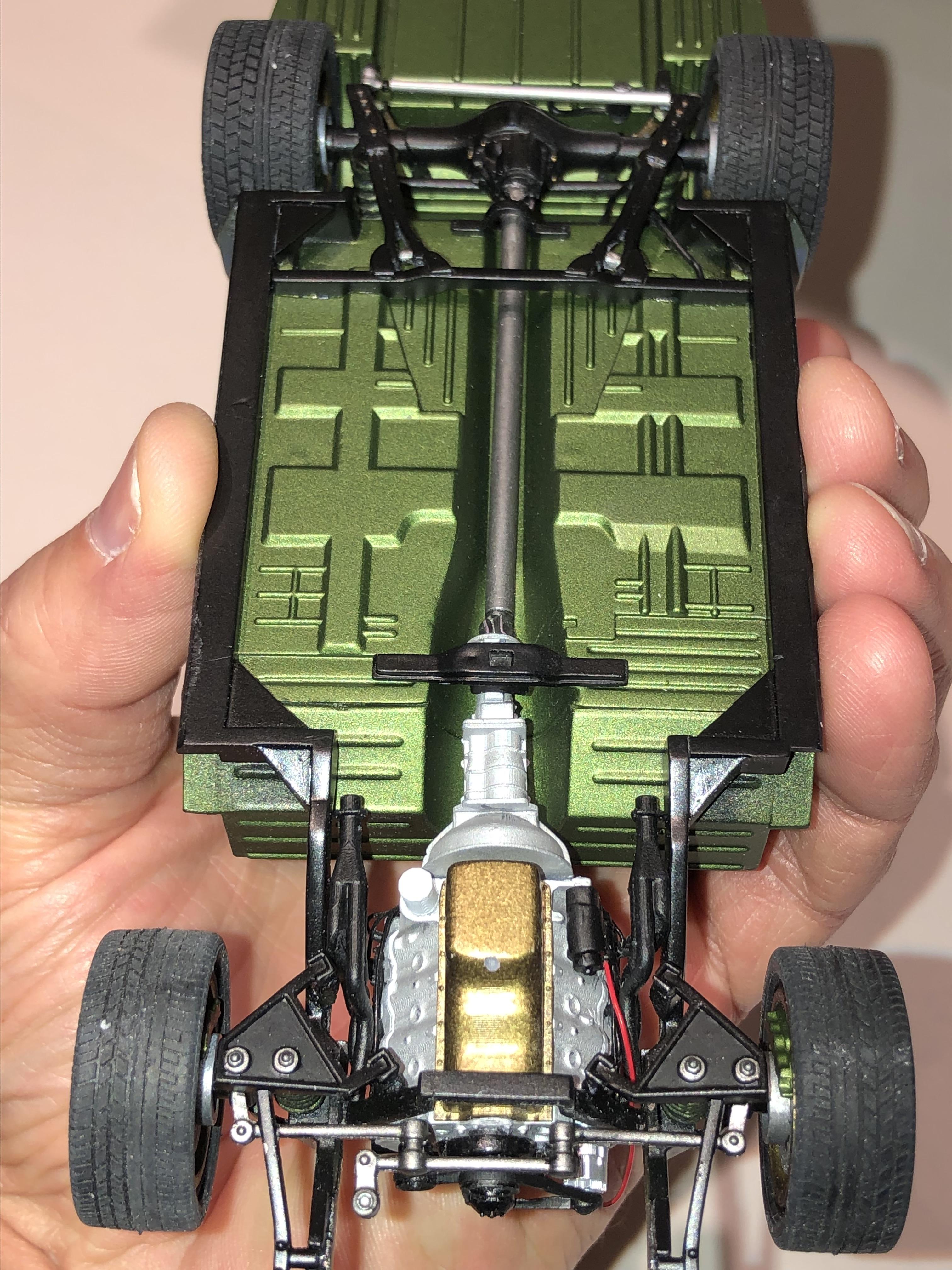

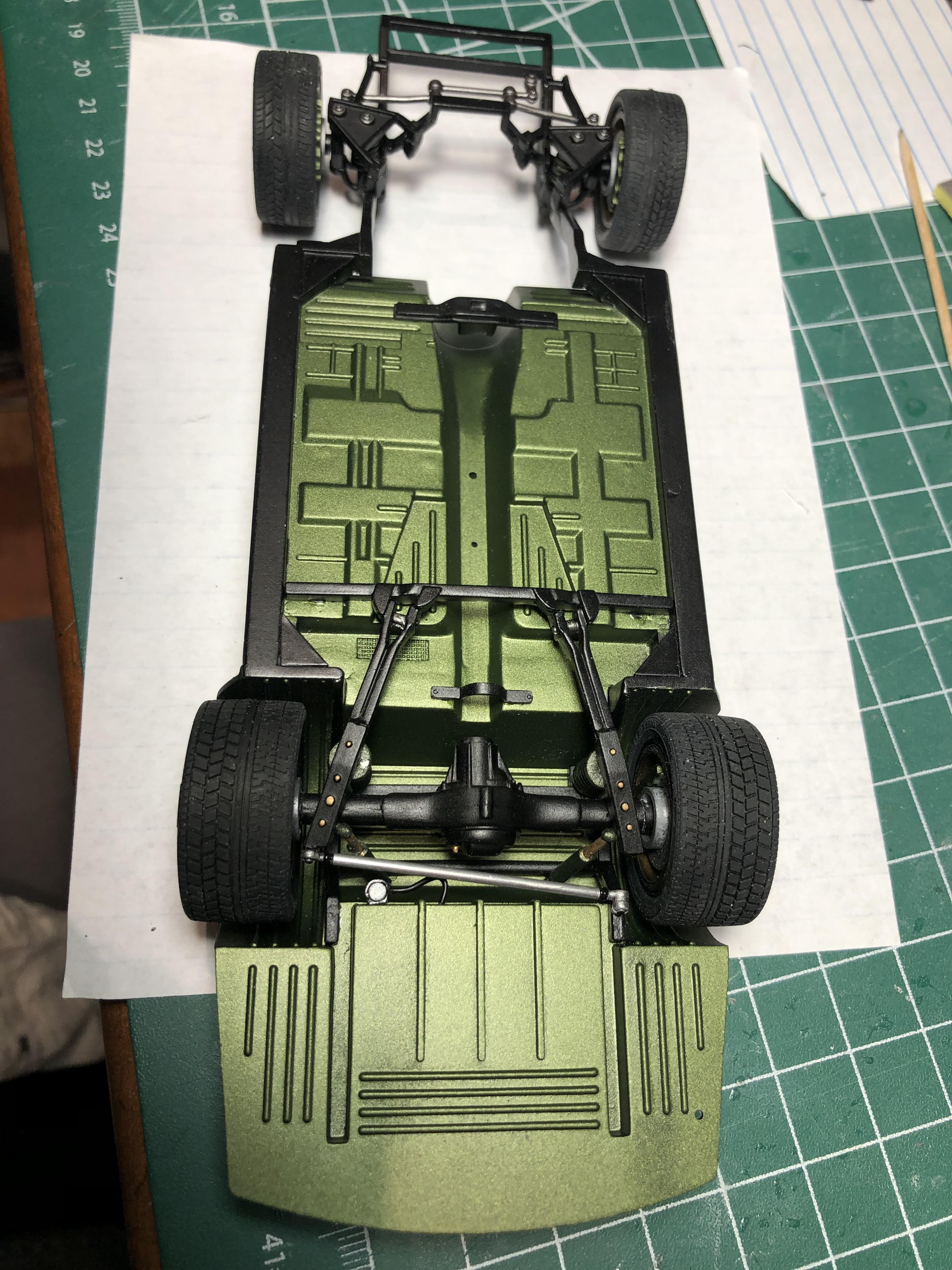

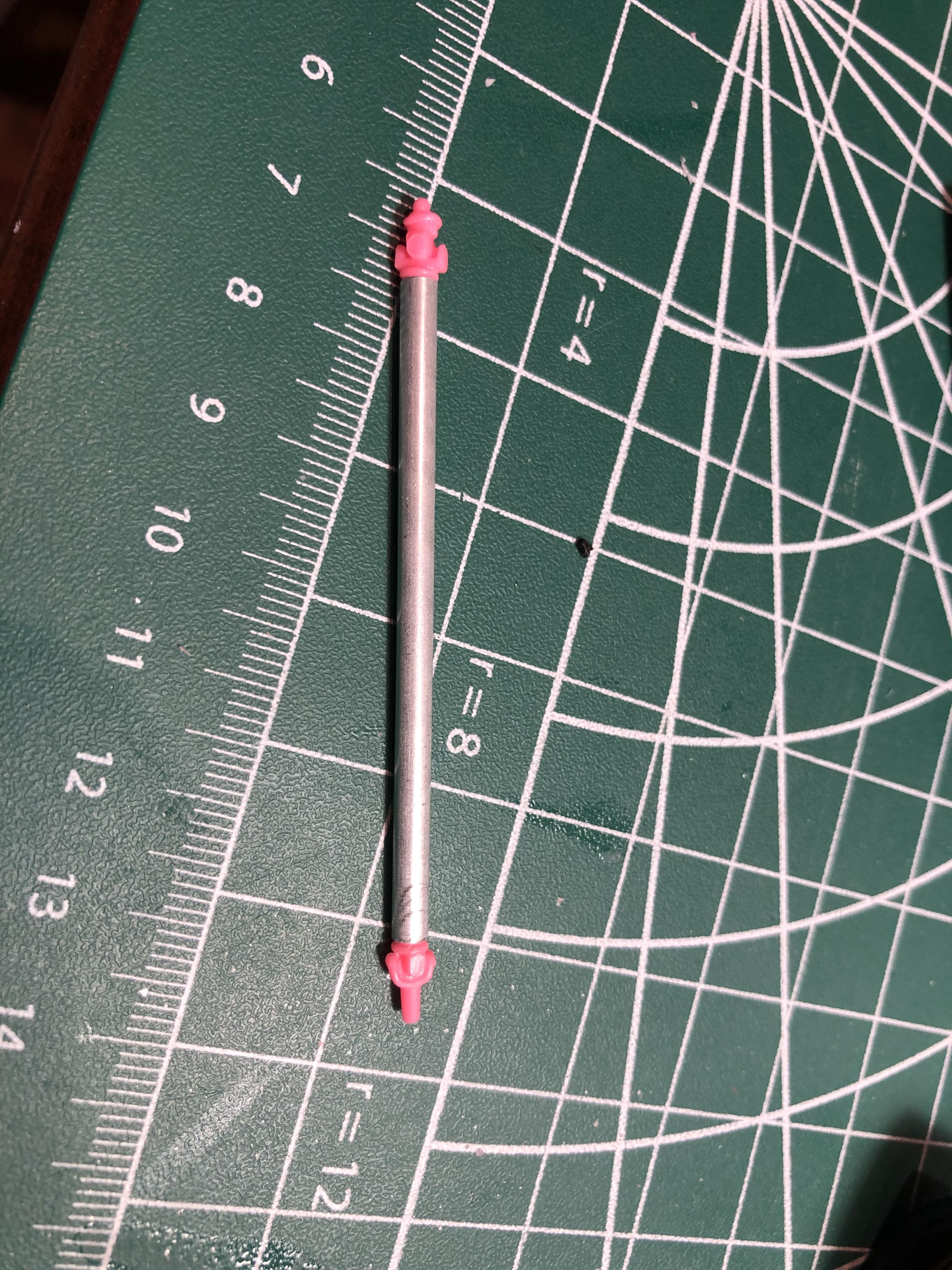

Getting some of the smaller details sorted out now. Disc brakes are painted and mounted.

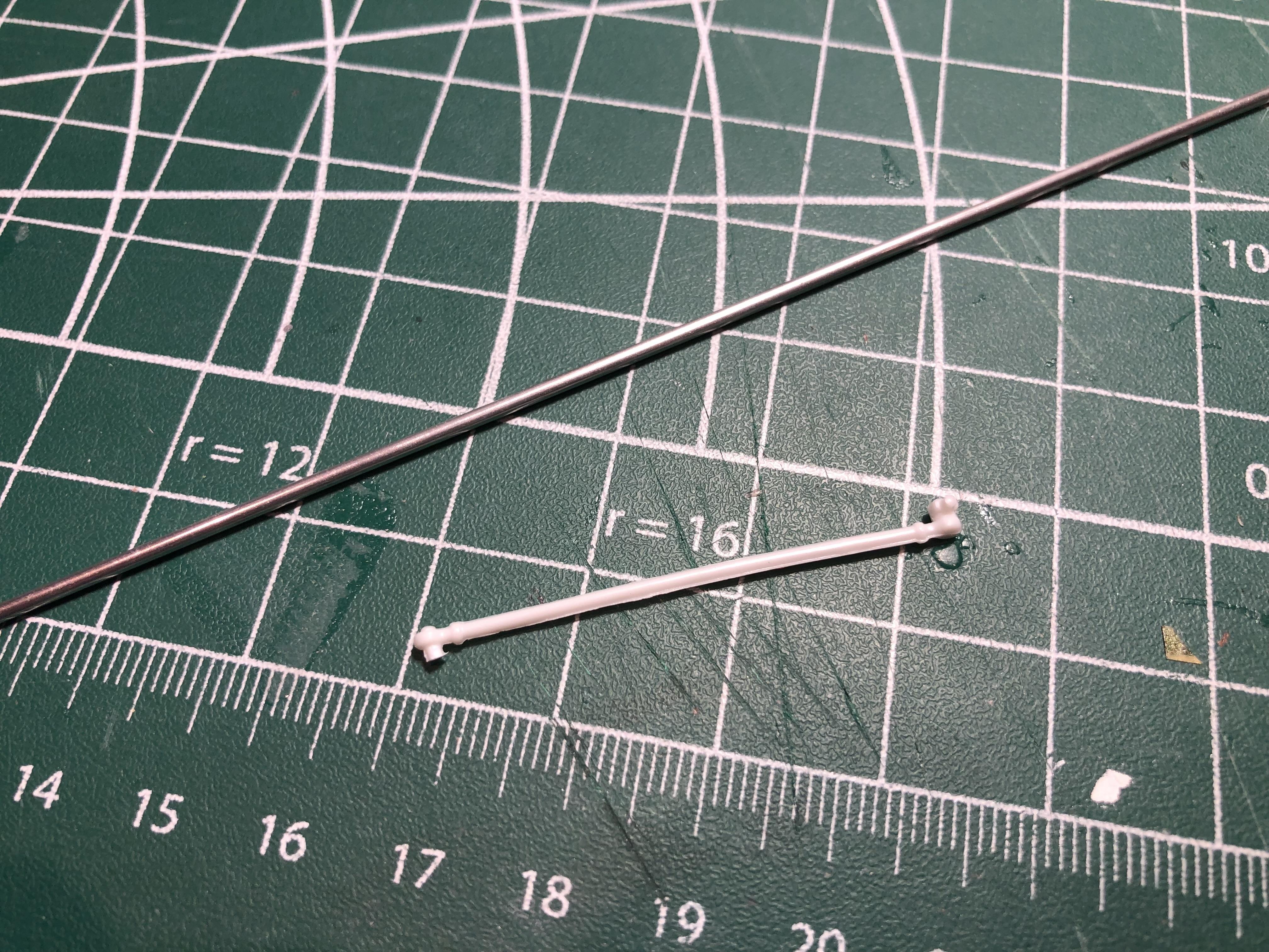

Next was the track bar. Rather than clean the mold seams, I just cut the ends free and added a piece of aluminum tubing.
Bringing that work together, wheels mounted, track bar installed, added a fuel pump and fuel line while I was at it.
For the drive shaft, I used the u-joints from the Hay’s pro street T-Bird and used aluminium tubing to connect them. The paint is still drying on that…

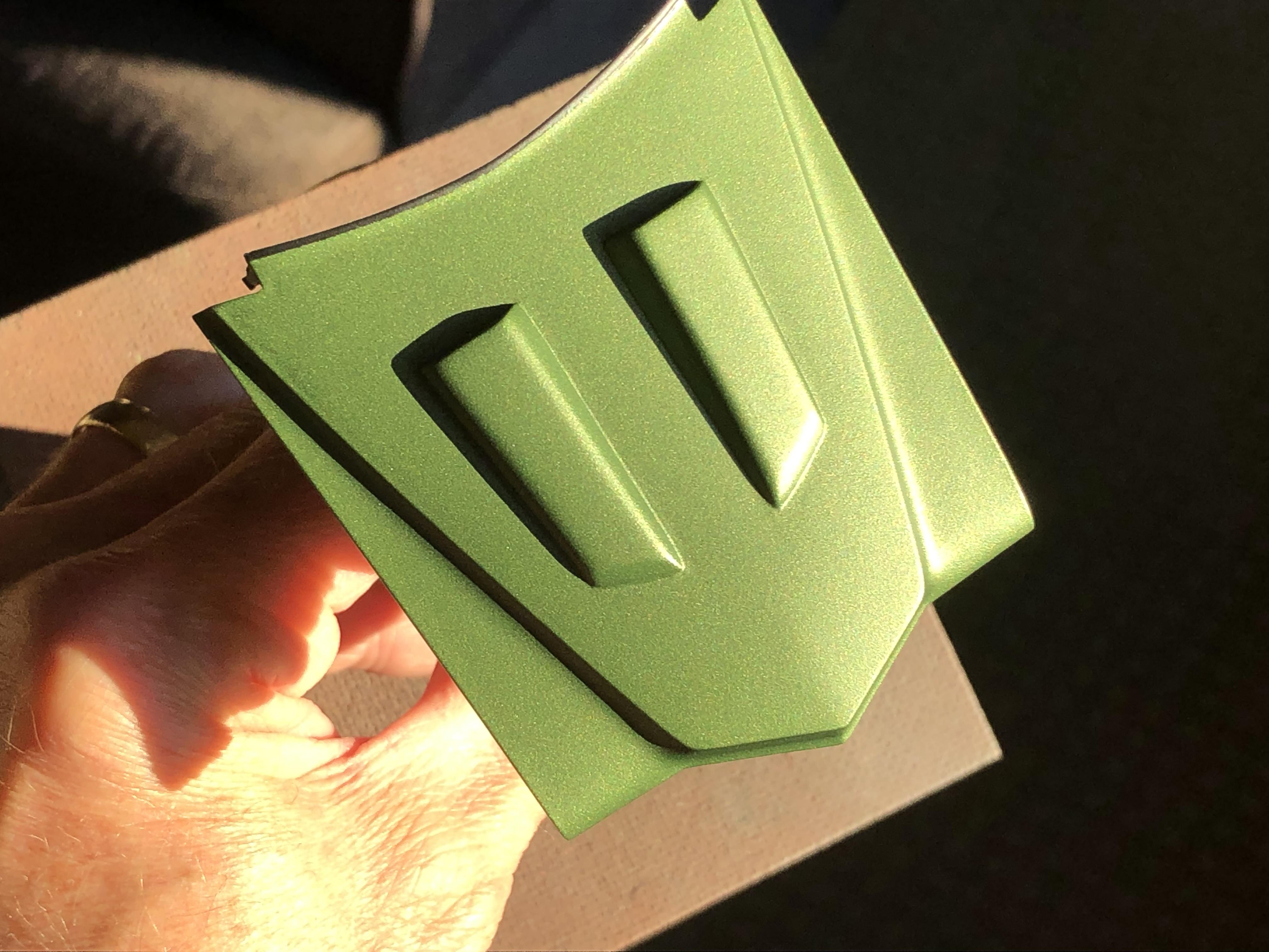

Love the color and the finish Steve. And I like the little recess for the door latch. I’ve been thinking of doing that to my T-Bird.
Thanks Greg. Ya when I saw the door latches on the Dutch Boys Camaro, I had to try to replicate them. They turned out ok the first time so I thought I’d do it again. My thought is that it adds a bit of detail, rather than just shaving off the door handles.

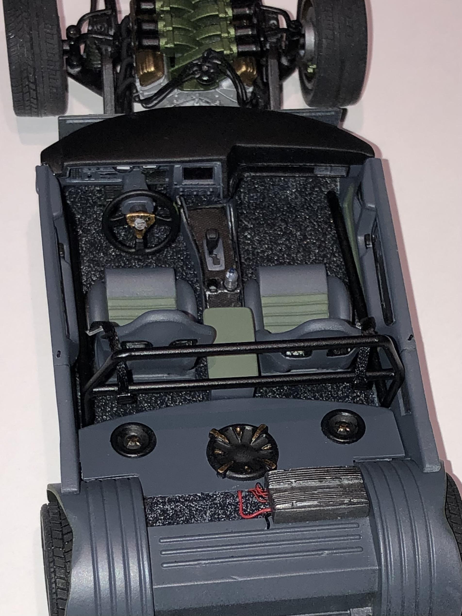

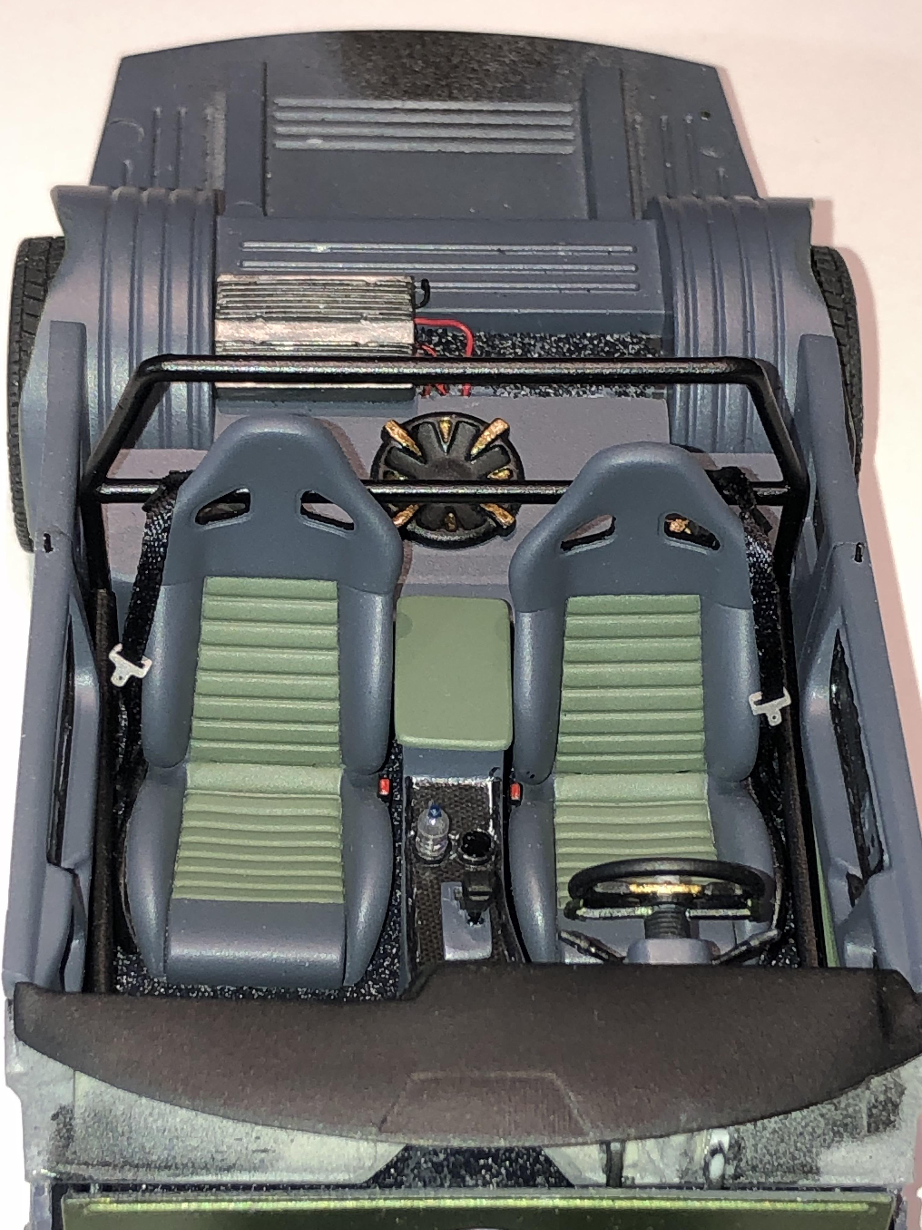

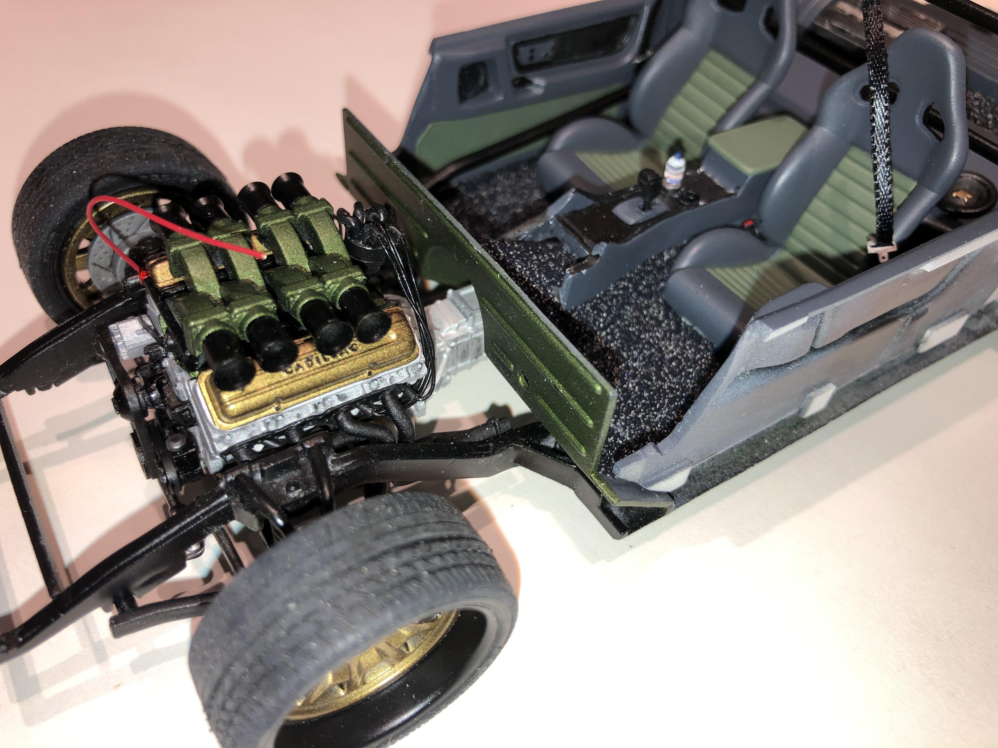

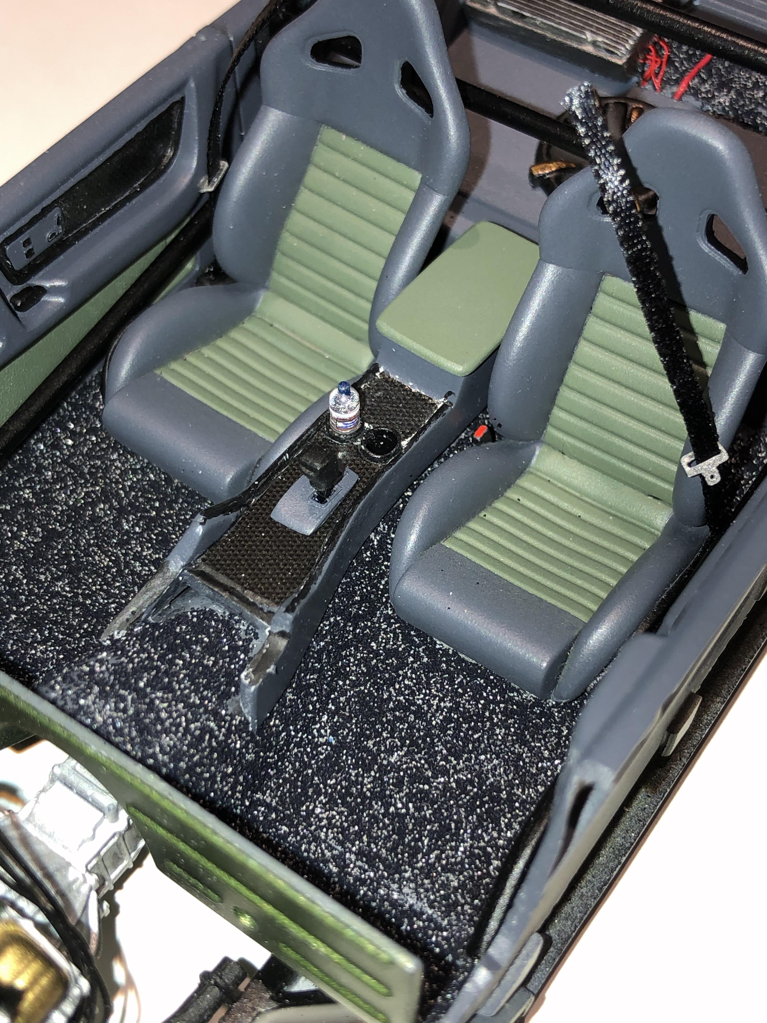

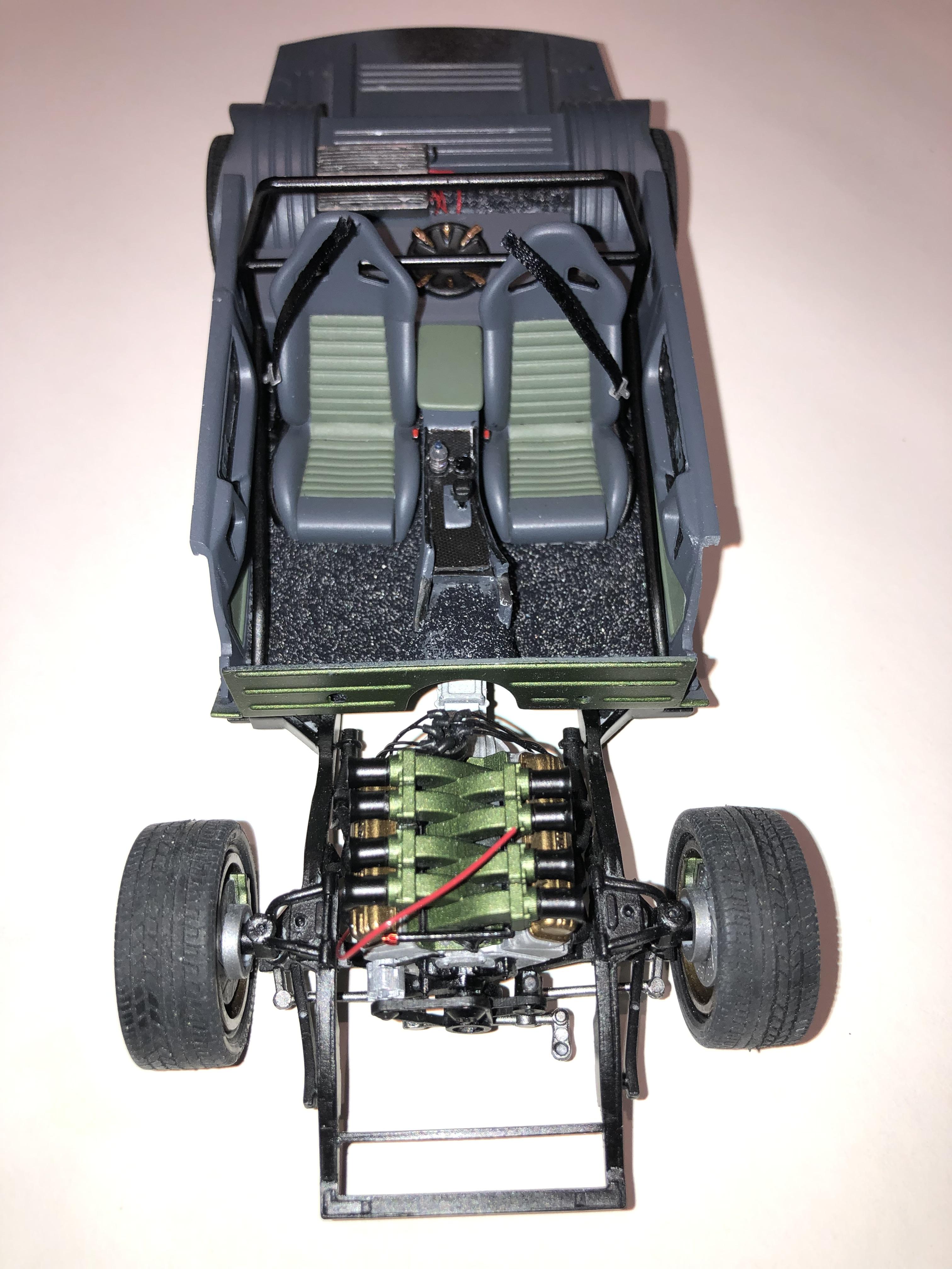

I managed to spend a few hours at the desk last week, and actually have a little something to show for it.
The engine and driveshaft are now installed, so chassis is “almost” complete. I did add the drain plug in  oil pan after the photo…?
The interior platform is coming together. I mixed black and grey embossing powder for the “carpet”, it’s not quite as “disco” looking as it appears in the photos. I made seat belt “retractors?”, still need to add a few “bits” to finish off the shoulder belts. I had to make the seat belt buckle as the photoetch ones I had didn’t quite work out. Added a water bottle in one of the cup holders, the amp has power/ground/and speaker wires.
The intake trumpets are now installed. Yes, they are different lengths, and that was intentional. Slightly shorter ones in the middle to show a bit more of the Cadillac valve covers. Ignition wires have been added, still need to complete some wiring once body is installed.
That’s it for now! Thanks for having a look. Oh… yes I will dust the embossing powder off the seats!

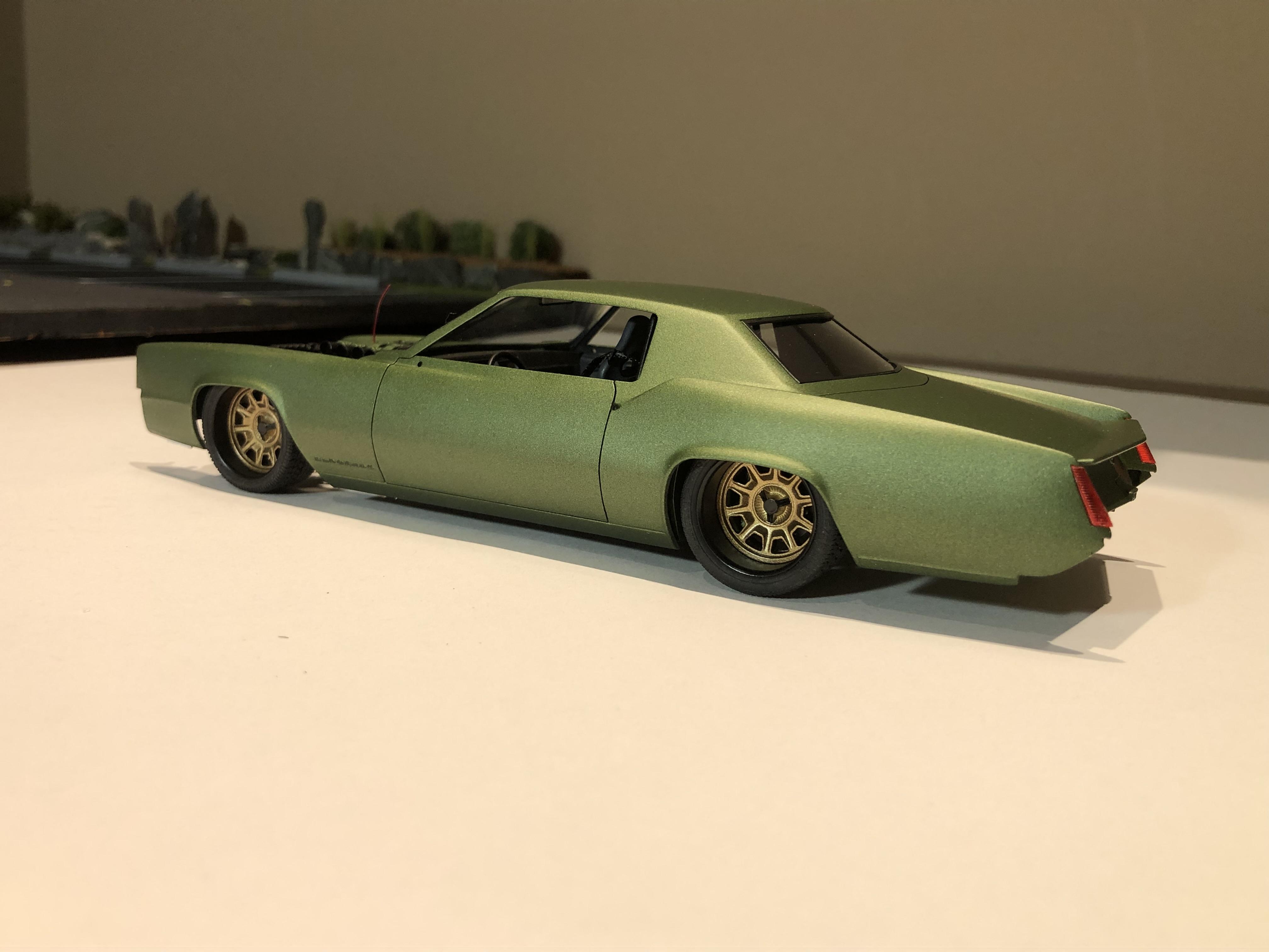

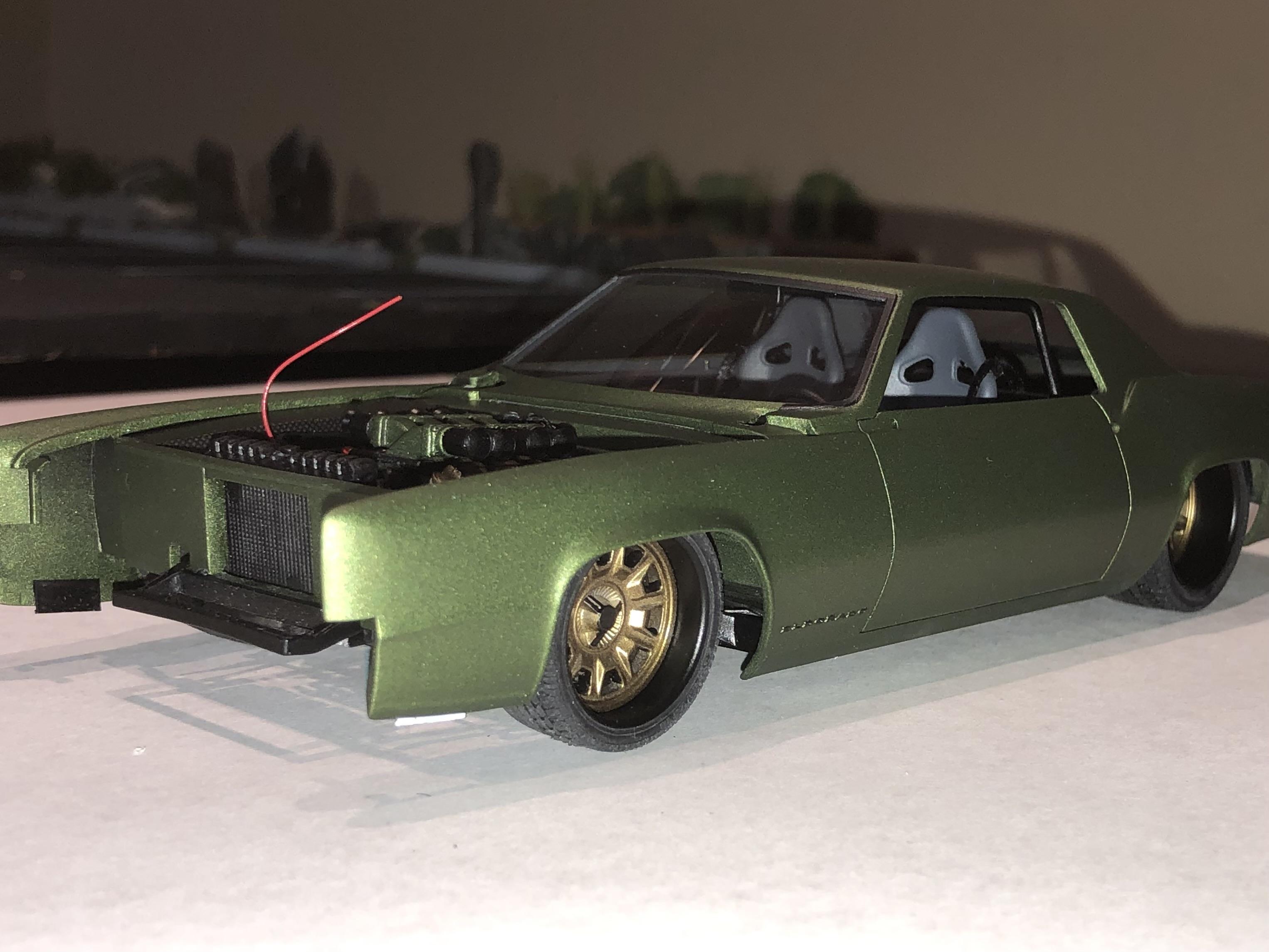

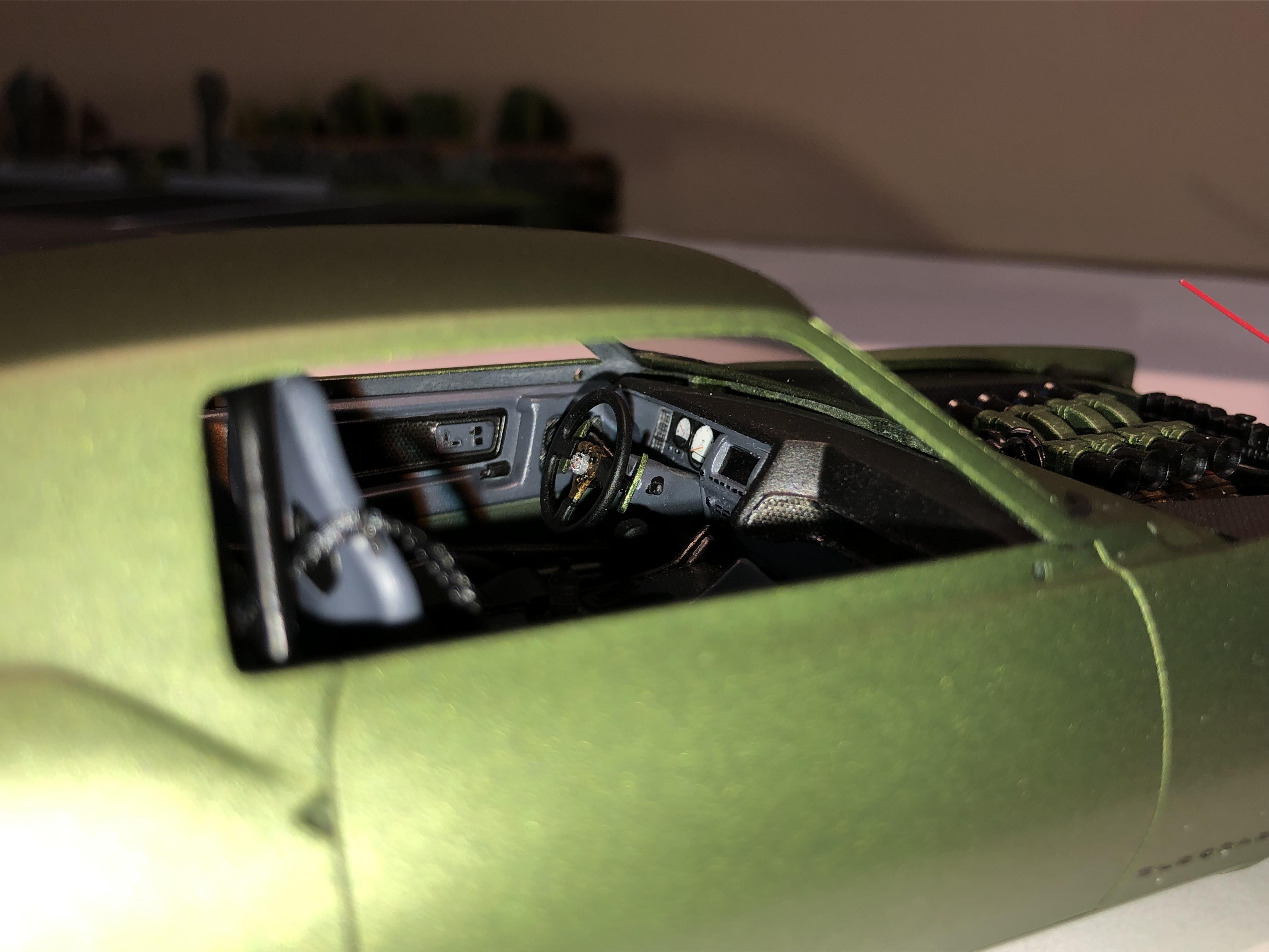

Hi guys, it’s been a few minutes… I had a mini holiday to go watch the last NASCAR race of the season, then managed to get a nasty case of Covid upon arriving home. So, starting to feel better now and have an update.

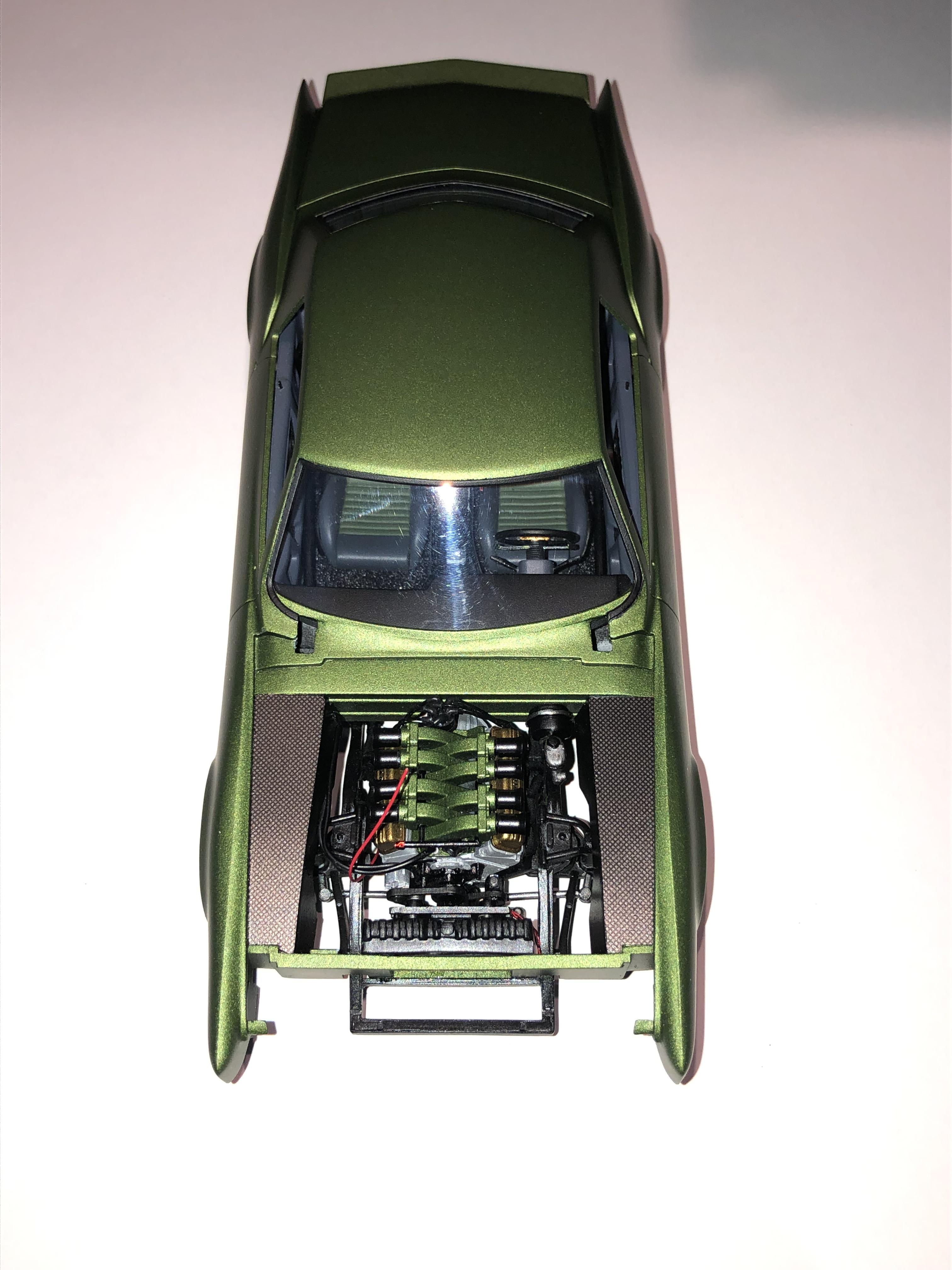

The interior is complete. I had a few things that didn’t turn out quite as good as hoped, but overall I’m happy with it. I added shoulder belt guides for the seat belts, Door locks, and new gauges. The inside of the body got a dome light and rear view mirror.
I tried to polish the kits glass, but there was a couple of deep scratches on the windshield that wouldn’t come out. So I made new glass from acetate for front and rear glass. Not perfect, but a definite improvement, the optical clarity is better, but still has some scuffs depending on the light. With the interior complete, it was time to mate the body and chassis.
As you can see, there are still some wires to connect in the engine compartment. I will get the details done under the hood, then install the bumpers, splitter, nav antenna, and side view mirrors and then, at long last it will be complete!! The ride height turned out as hoped. It’s rewarding to finally have this one close, it’s taken way too long. Thanks for having a look.
Cheers, Steve
