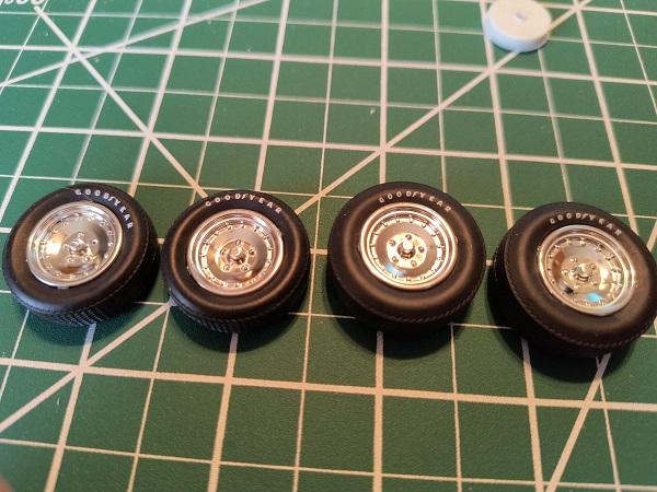

Minor update...
While looking for paint today, I ran across these in a box...
I don't have a clue where I got these, or why for that matter, but I think they may do the trick.

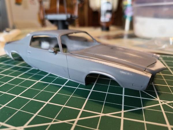

Also, got some sanding done on the primer coat.
It was a tad more uneven than I had figured, so I ended up sanding back more than I expected. I think it's mostly the way it sprayed that day.
It was windier than I usually do, but I wanted to get started smoothing the body out... so I ran with it...
Just finished spraying a new coat. Hope to smooth it out maybe tomorrow. One final coat should do it... maybe...

From the looks of your picture I’d say it had the typical 70’s Camaro tire setup. Either 70’s up front and 60’s on the rear. Or 60’s for the front and 50’s for the rear. Either way, the rear wheels are going to have a deeper offset than the ones you found. I have a set of unpainted grey centerlines that were donated to me by Mike on these boards. They would look perfect with a coat of aluminum paint and I’d be happy to donate them for your project. If you want them DM me and I’ll drop them in the mailbox.
Dave
Dave
I appreciate it, but currently I'm gonna hold off..  These are different sized tires for the back.. after I can get to mocking up the stance now I've found them, we'll see how they look.
