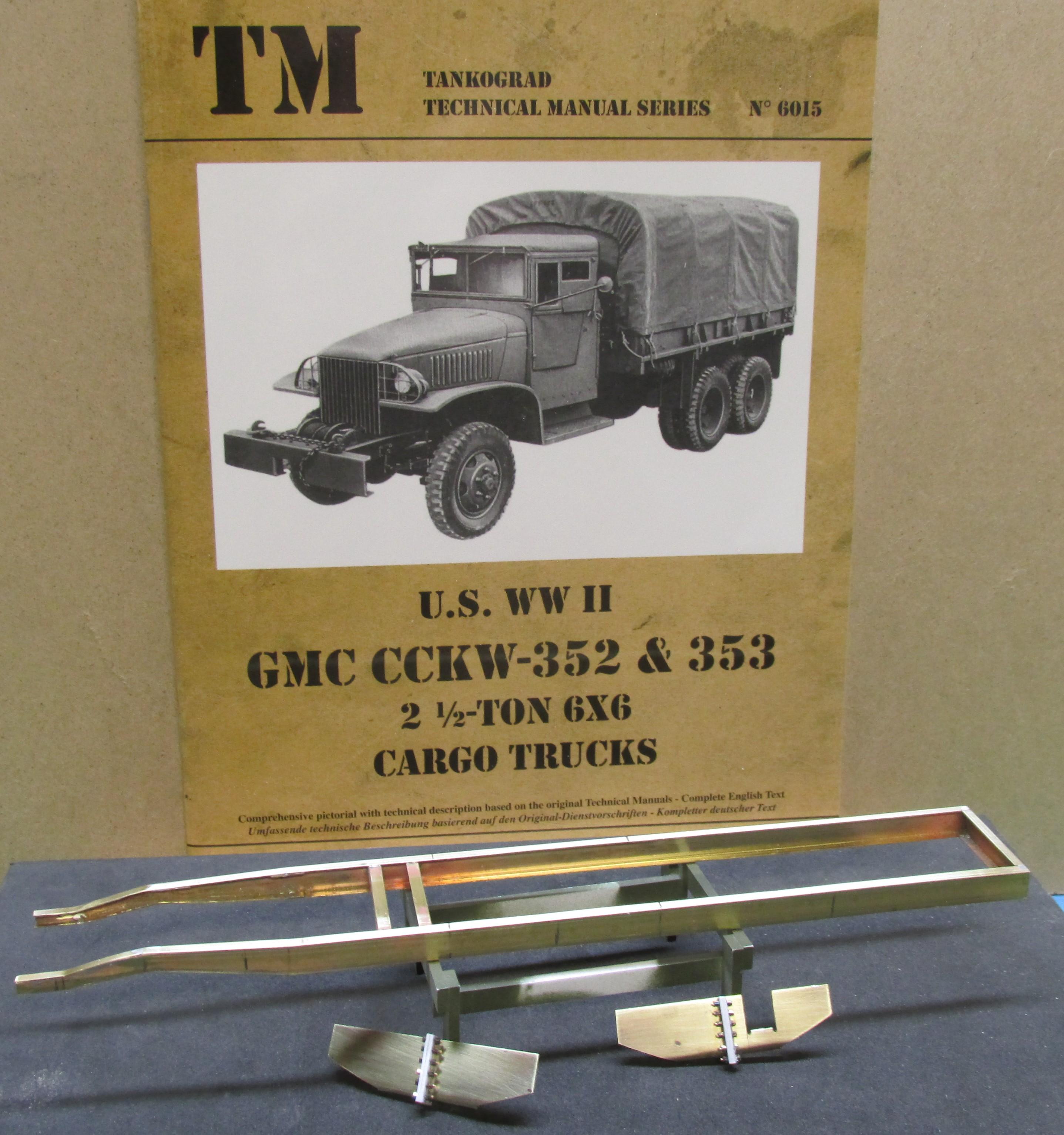

The  next build is started.  It took a while to find the right information to begin the frame.  Three books of photos did not have the necessary look to identify what I was after.  Searching on line, I found a side shot of the truck with sufficient detail of the front of the frame for it to be copied and resized to 1/25 scale.  So the frame rails are done along with two fishplates that will be added to the center of it.  Some of you probably know why but for others, I'll let you ponder for a while and see if you can come up with the answer. ?
001.thumb.JPG.e820ddcb8f138847a57879a99f40d5cc.JPG002.JPG.7125dfe4baee5f6c0a1286a75df7a5b3.JPG
  • Like 6
5 hours ago, Chariots of Fire said:
...So the frame rails are done along with two fishplates that will be added to the center of it.  Some of you probably know why but for others, I'll let you ponder for a while and see if you can come up with the answer. ?
46 minutes ago, Dale361 said:
Wonder how many know what that bolt flange was for.
Having researched these things for a build of my own, I know.
Beautiful work, as always.
  • Like 1
My guess you are building an air-portable CCKW cargo dump. These trucks were built to be split behind the cab to allow them to be transported on the cargo aircraft of WW 2
  • Like 3
  • Thanks 1
? Right you are.  The only way they could get them inside a C-47 was to cut them in half and transport one half in one plane and the second half in another plane.  Even at that they had to unbolt one front spring to lower one part of the cab so it would fit into the cargo bay.

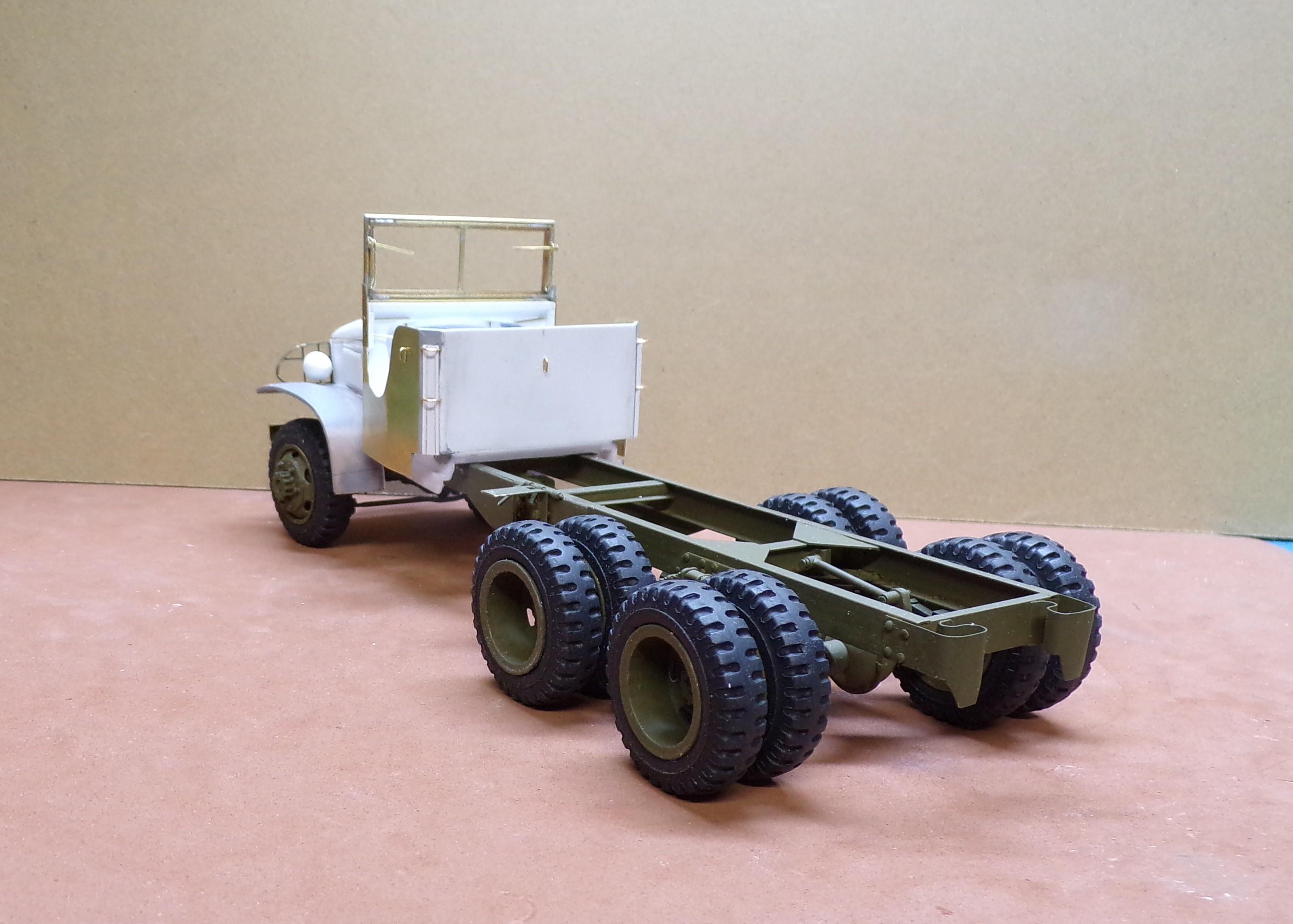

Got the frame up on wheels tonite, at least temporarily.  Mostly to see if the frame would be level with the ground with what has been done to date.  So far so good.  Working on the torsion rods for the back now.  Two done, more to go.005.JPG.b0960dd2256ae650bd48703cb1f997c9.JPG006.JPG.660fb7e6760e821cf25741faa459253b.JPG007.JPG.606594842759d9d4087fe9345ce90aea.JPG

Been busy doing a lot of little things since the last post.  Here is where we are as of today.  Thres and wheels are painted. Although not in the photo, the trim rings are also in place to finish off the tires and wheels.  Fenders are ready for placement but they need some fine tuning first.  The cab is essentially done except for the interior.  The windshield is done except for the glass and wiper motors.  They won't go on until the painting is done.  Hood sides are in position with tape for now.  The Deuce has 12 grill slots and these only have 6 since they came from the 1-1/2 ton Chevy so the 6 were sanded off and a decal has been made to show the placement of the new pieces.  They can be glued on right over the decal and then the hood sides can be painted locking them in place.  The cab is secured to the frame with small pieces of angle stock and screws.  The hood hinges are done and have temporary pins to help locate the hood for accurate placement of the hood sides.  Lots of little stuff but fun detailing it all.

Hah, a split frame! We modelers do it all the time when shortening or lengthening a frame, looks much better when we hide it as we do, too, LOL!
I actually have a frame that comes apart with a secret slip joint so I can swap out the rear end.
Never thought a bolted joint would have been possible!
Such neat work and a great detail that adds so much interest, amazing how you came up with that, in addition to your standard attention to detail! You never cease to amaze
Absolutely superb work as always Charlie! Now, you should build a few 1/25th C-46's or C-47's to put the halves and the body in!!!
Edited by redneckrigger
LOL! It just hit me that that tight fit in a plane might explain the folding windshield and canvas top a lot of these had instead of a solid roof, which would likely not fit in a plane of the time
  • Like 1
That frame isn't actually split.  I just looks that way.  The solid roofs went away as the war went on and only about 30% of the trucks were transported by air, I think for possible delivery to the pacific theaters of operation.  But it is a unique feature that won't be on many models so I included it.  Right now I'm trying to get the hood sides adjusted to where the cab can be painted.  Lots of little fiddly things to do so that when I attach the fenders things will be right.
  • Like 3
The whole concept intrigued me so I looked them up.
They really came apart for transport!
http://www.primeportal.net/trucks/ulrich_wrede/gmc_cckw-353/
  • Like 2
Note the dolly wheel behind the cab frame.  That part of the truck could maneuver on its own into the aircraft since the front axle could drive.  They only had to steer it on board with the dolly wheel.  Interesting stuff.  The rest of the truck was crated.
  • Like 1
