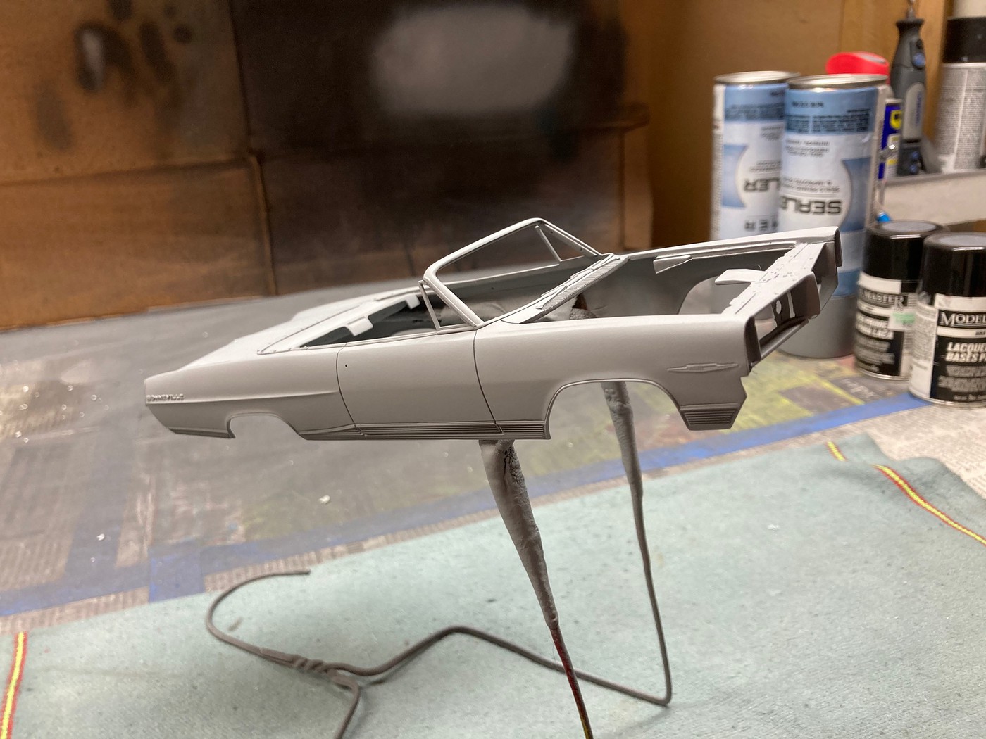

Been using it longer than I can recall.  I use it for color block, sealer and just a primer.
I always sand coats with 1000, 4000, 6000 before I apply color.
I find it a great paint.
3 coats of #1699 sanded.  Then with 3 coats of Tamiya TS-14
  • Like 2
As it's working for you and Steve, I'll give it a shot. Always nice to have another option in the box.
  • Like 2
