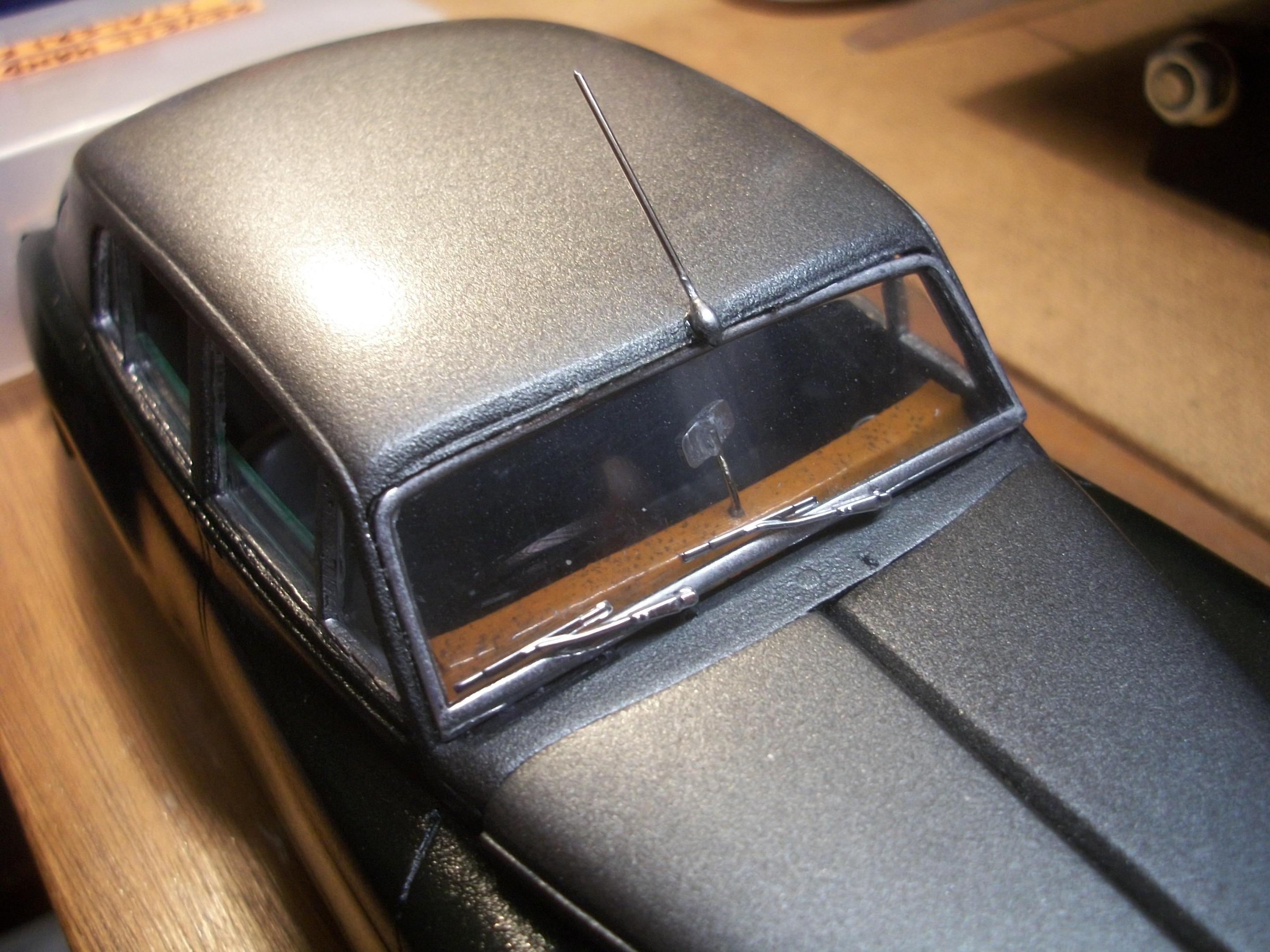

Coming along beautifully. Not to add to your misery but since the subject is spectacular and you can now see you can make this horrible kit body beautiful... you should consider sanding off door handles and wipers and add aftermarket parts?
Looks like you got a really good result on the driver's side / offside / right hand side ( if you building this car as a RHD ), but if this is going to be a LHD car then we are talking passenger side / nearside / left hand side . . .
I am really surprised to see super glue used in that way, but you clearly know what you are doing because that process has worked brilliantly !
I could not help but smile at Pierre's comment regarding the removal of the door handles and windshield wipers . . . He has a good point of course, but are  you brave enough to go down that route? Those door handles do need improvement I must agree, and I did grind off the wipers on my most recent Silver Cloud build . . . I then fitted two wiper arms and blades from the Tamiya Jaguar MK 2 kit, which look great on the Rolls-Royce, but now if I want to build the Jaguar there are no wiper arms and blades in the kit box !
David W.
Thank you for your kind comment Pierre.
There are a couple more repairs that I'm considering but the other features you mentioned will remain as they are. As much as I enjoy building, I also enjoy completing. Completing maybe even a little more.
David W.
Excellent call on the wipers David! They look as if they were meant to be there. I am considering adding an aerial and rearview mirror... and a set of wing-mounted mirrors... and effecting a couple of other casting repairs. Maybe.
But the wipers and door handles will remain as they are. They are... sufficient.
This particular kit was issued in a left-hand drive configuration. I would have preferred a proper RHD model. I also would have preferred not to spend twenty or thirty hours correcting casting errors on a thirteen-piece kit.
But, as we say "It is what it is."
Again, thank you very much David for all your help and direction with this kit.
David G.
