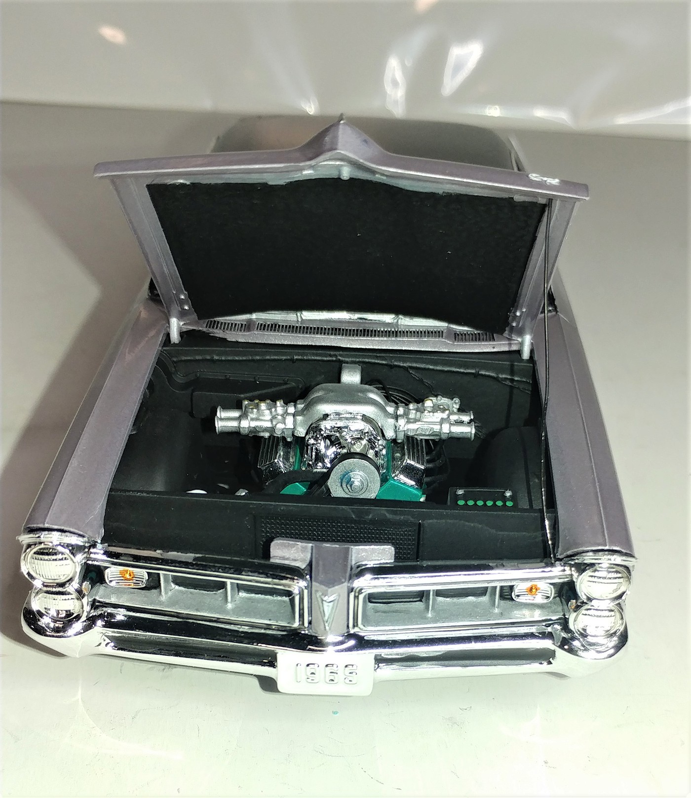

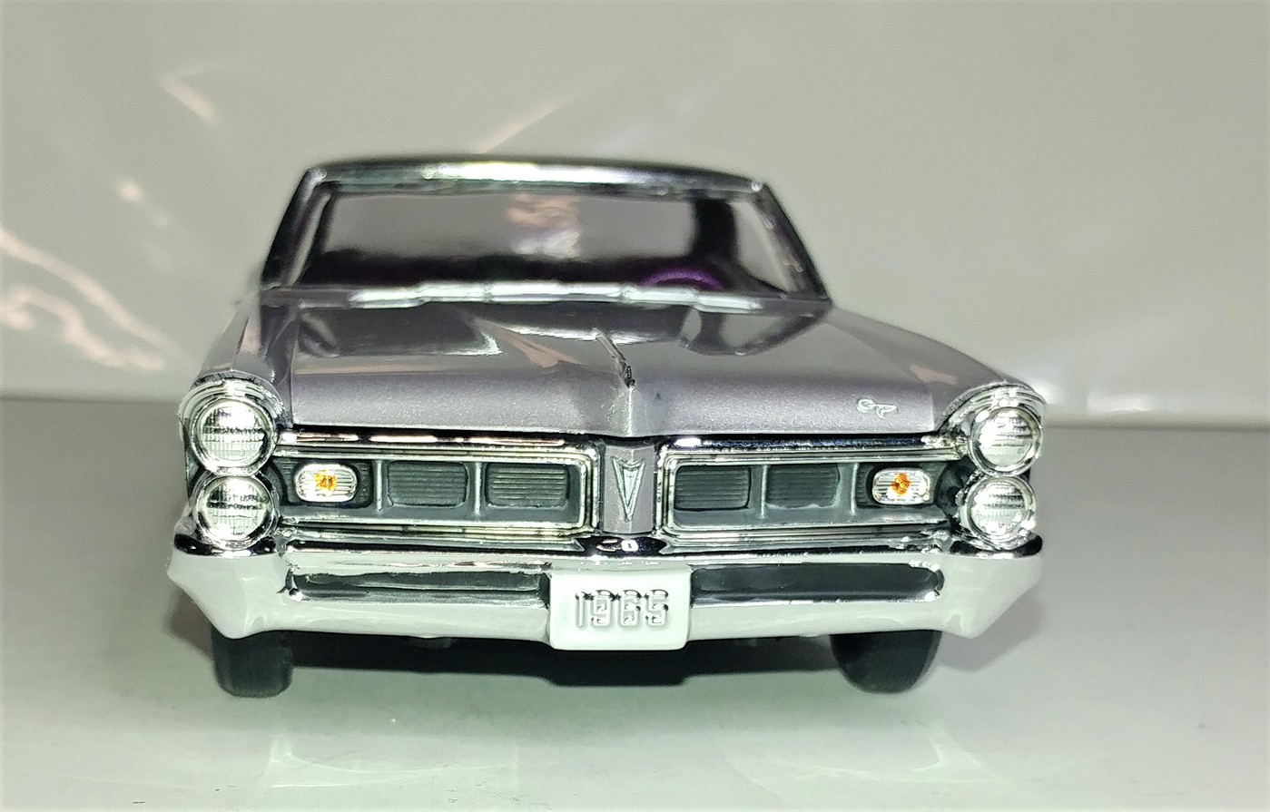

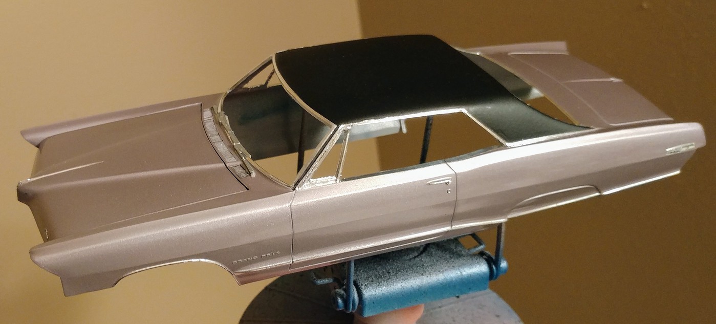

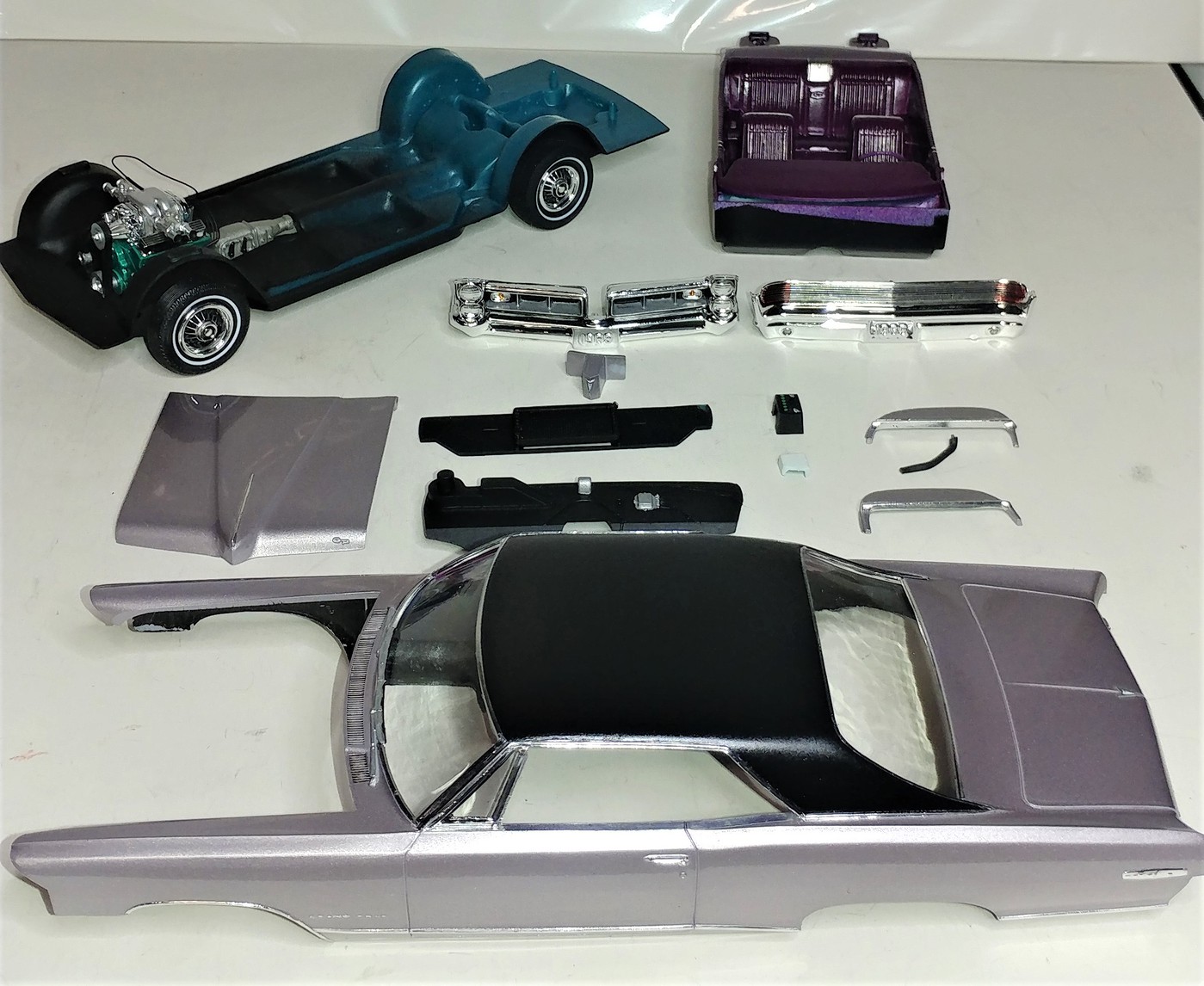

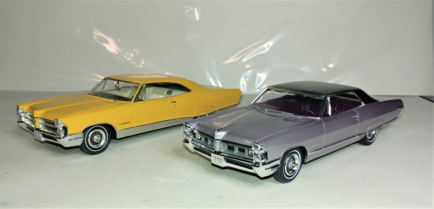

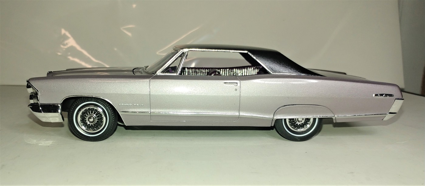

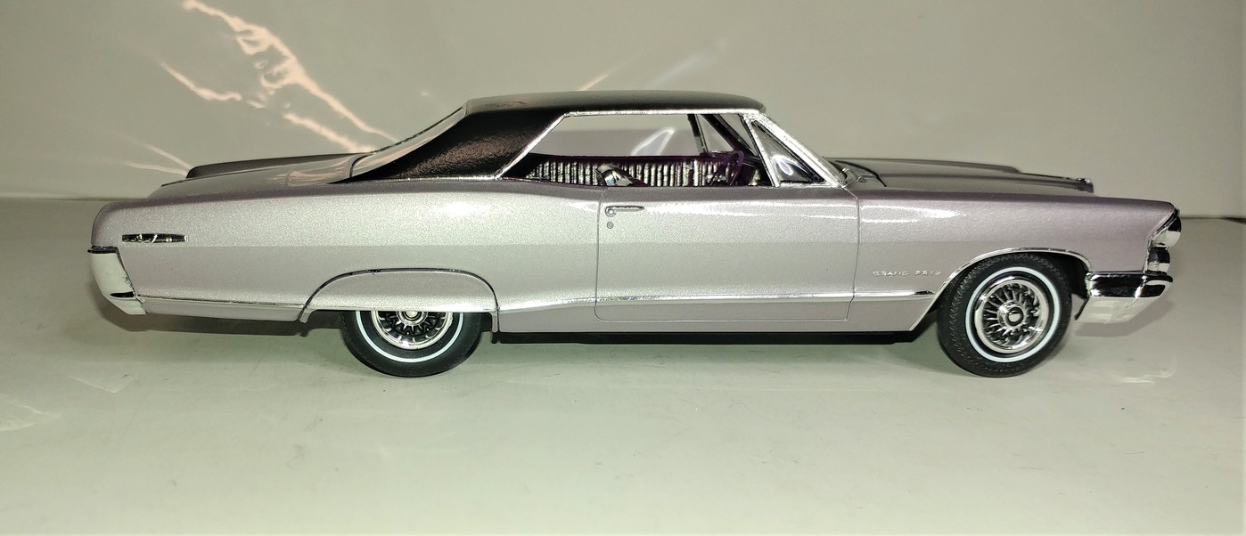

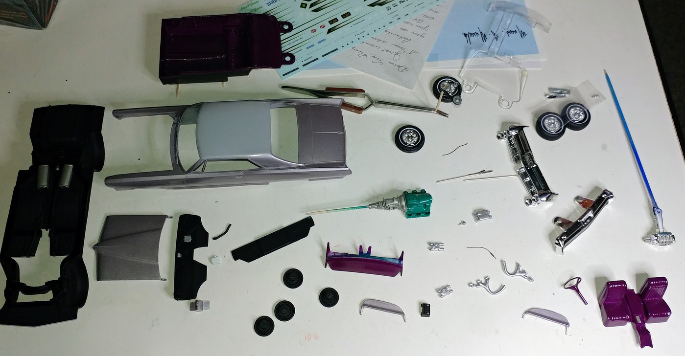

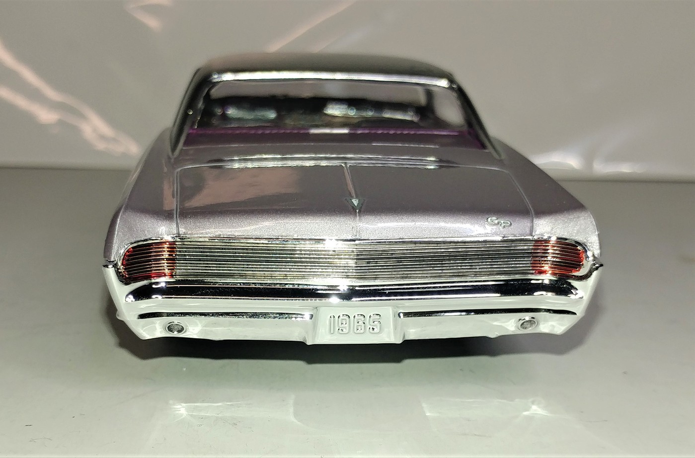

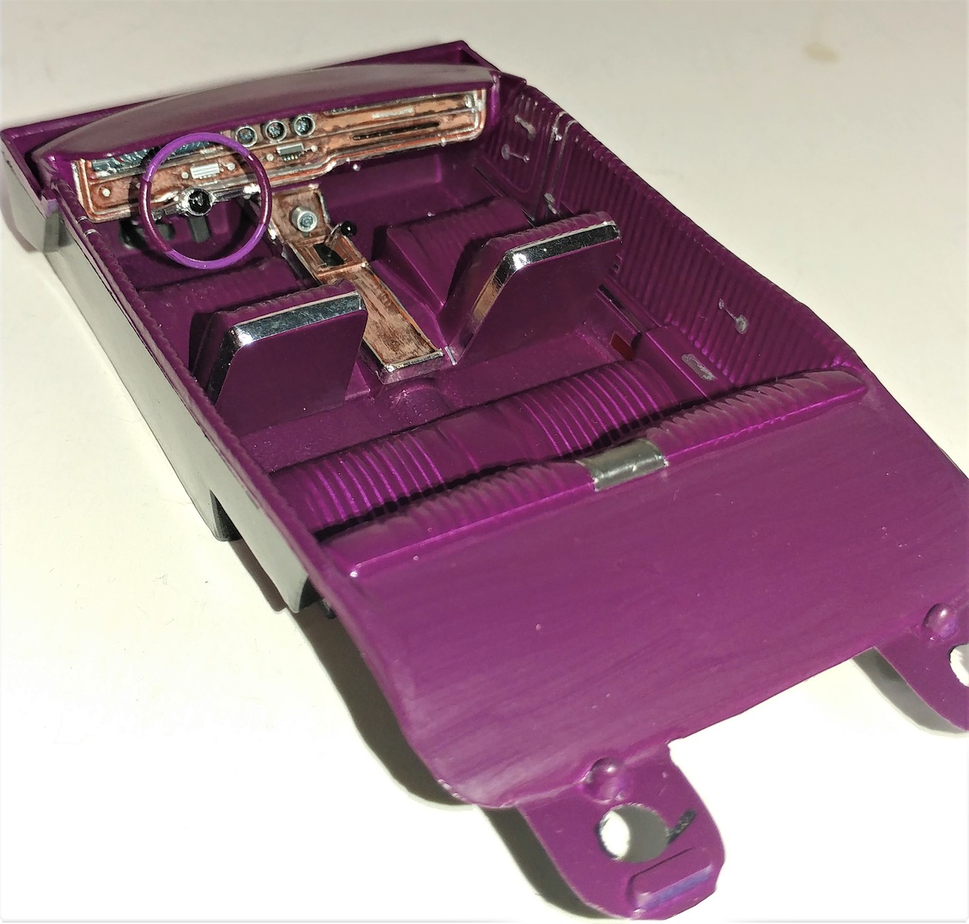

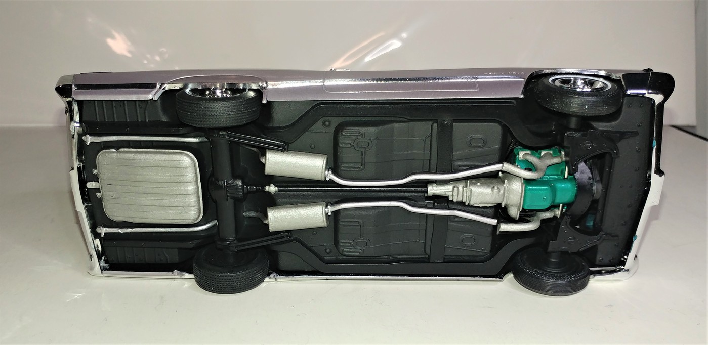

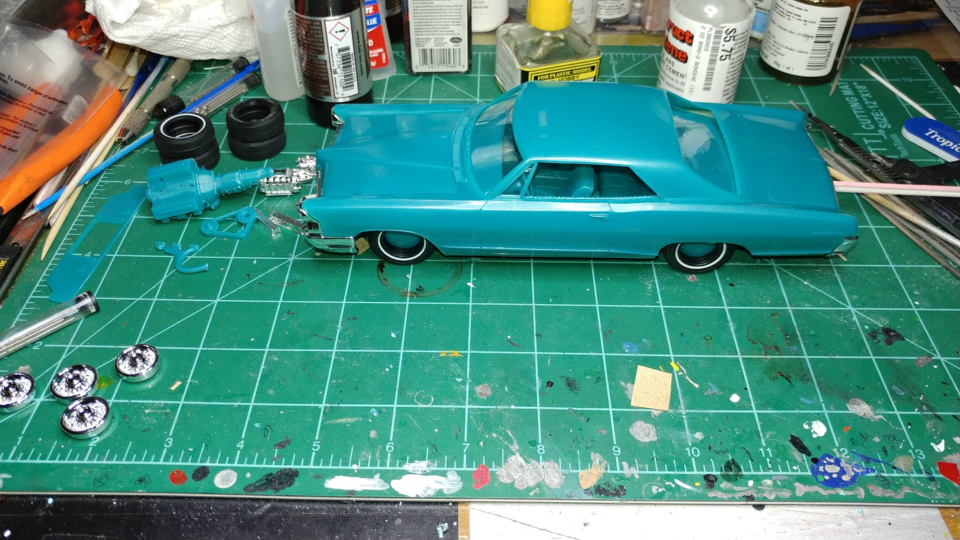

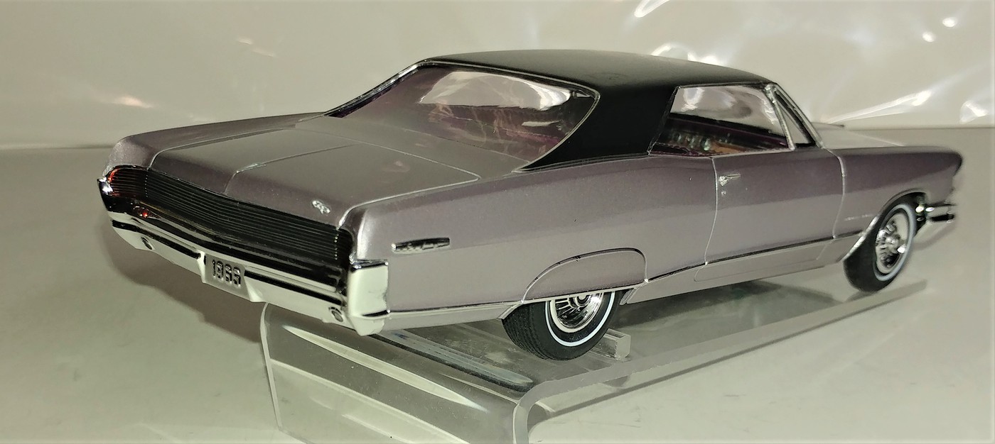

THarrison351 Posted June 23, 2023 Posted June 23, 2023 Simple kit, typical AMT promo chassis, low parts tub interior, metal axles, and an engine with a hole for the front metal axle. In other words, something that looks good on the shelf. This is the second effort painting with MCW paints, but I can say I'm much happier with the results this time. The first time was over a decade ago and well I ruined four models in one day. Lousy primer I guess. Anyways, I chose their evening orchid to represent Pontiac iris mist and because the trim was already present for the vinyl top, painted it as such. I did forget the seam strips, did not realize it until after the black was sprayed and well, it's my shelf. The interior is Rustoleum 2X satin aubergine to represent a plum interior. I should have used black primer, but did not expect the color to come out so light. The cap was much darker. Some things I did change were the wheel backs, I added some material to increase the width of the track. As they are the wheel tracks are too narrow. I also deviated from the stock build with the small supercharger and twin Weber side draft carburetors. The pulleys and the drive belt are so wrong, but it looks cool under the hood of the stock appearing car. Overall, it was fun to build and looks good next to my ancient build of the AMT Prestige 1965 Bonneville from the eighties. 5
bisc63 Posted June 23, 2023 Posted June 23, 2023 Very cool! I don't mind the interior color, I think it looks nice with the exterior color. The surprise under the hood is a fun touch. Nicely done.
StevenGuthmiller Posted June 24, 2023 Posted June 24, 2023 Looks splendid! And in case you weren't aware, 1965 Chevrolet "Evening Orchid" and '65 Pontiac "Iris Mist" are in fact the exact same color. General Motors "P-Code" So the color you chose doesn't just "represent", it is in fact correct. Nice job! Steve
karbuildr Posted June 24, 2023 Posted June 24, 2023 Very nice, I really like those big Pontiacs, simple is good. Sometimes they make the best models. I've always liked Iris Mist, very unique color and it looks great on your Poncho.

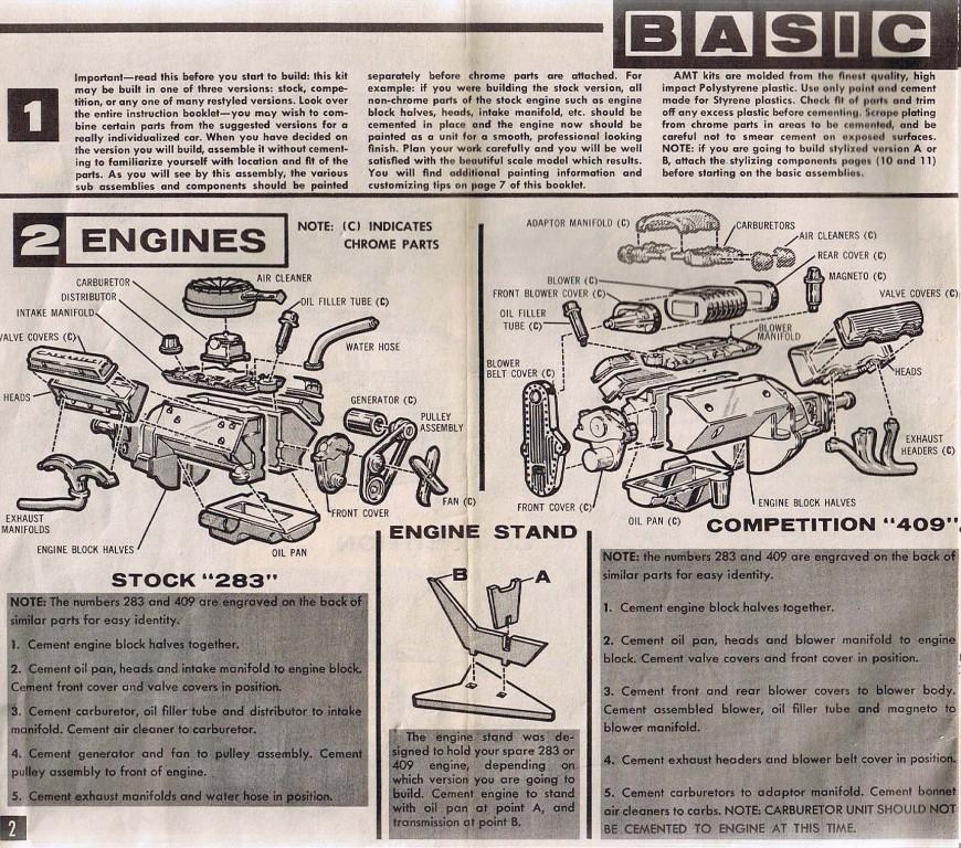

Bills72sj Posted June 24, 2023 Posted June 24, 2023 Nice GP. I am slowly working on one as well. What kit did that intake come from? What was your technique to do the tail lights?

ewetwo Posted June 25, 2023 Posted June 25, 2023 12 hours ago, Bills72sj said: Nice GP. I am slowly working on one as well. What kit did that intake come from? What was your technique to do the tail lights? The engine intake looks like the set up in the Buick Rivera kit.

bisc63 Posted June 25, 2023 Posted June 25, 2023 4 hours ago, THarrison351 said: What kit did that intake come from? Very similar (if not same) setup is found in AMT's older but common 57 Chevy with the optional 409:

carrucha Posted June 25, 2023 Posted June 25, 2023 Cool build. I like the body color. I built this kit a few years ago and found that the metal axels were too short so I cut new ones from music wire.
THarrison351 Posted June 25, 2023 Author Posted June 25, 2023 5 hours ago, Rattlecan Dan said: Very nice build. I also felt it was very original looking paint job (aside from interior color) which by the way looks very nice. Fine detailing all around. Thanks for sharing. Thanks! This is an original color, and for the interior color choice there were only three, parchment, black or plum. I tried to match the plum, but came up short. Here's what I was shooting for. 8 hours ago, espo said: Great looking color and paint finish. Clean assembly goes a long way on even the most basic kit. Thank you! 8 hours ago, Bronzekeg said: nice clean build! Thanks! 5 hours ago, bisc63 said: Very similar (if not same) setup is found in AMT's older but common 57 Chevy with the optional 409: Yes it is except, for the carburetion and the drive is a chain instead of a belt 2 hours ago, carrucha said: Cool build. I like the body color. I built this kit a few years ago and found that the metal axels were too short so I cut new ones from music wire. Thank you! Yeah, the axles are too narrow and so are the wheel backs, I added pieces from other wheel backs to widen the track. If you look at the picture of the car with no paint, you can see how narrow the track is before I modified the wheels.
