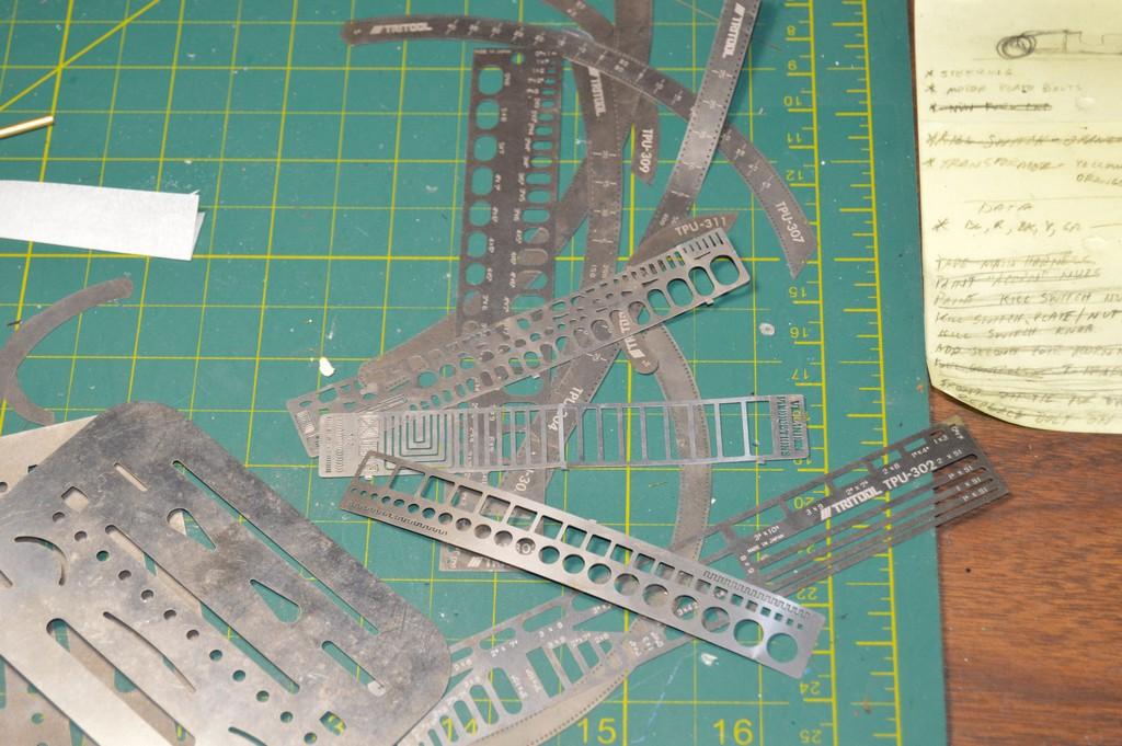

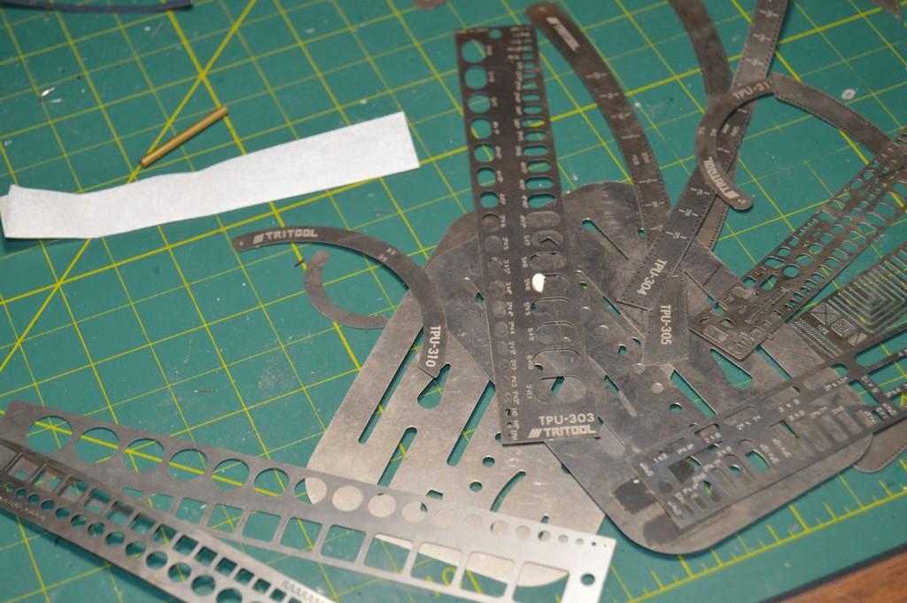

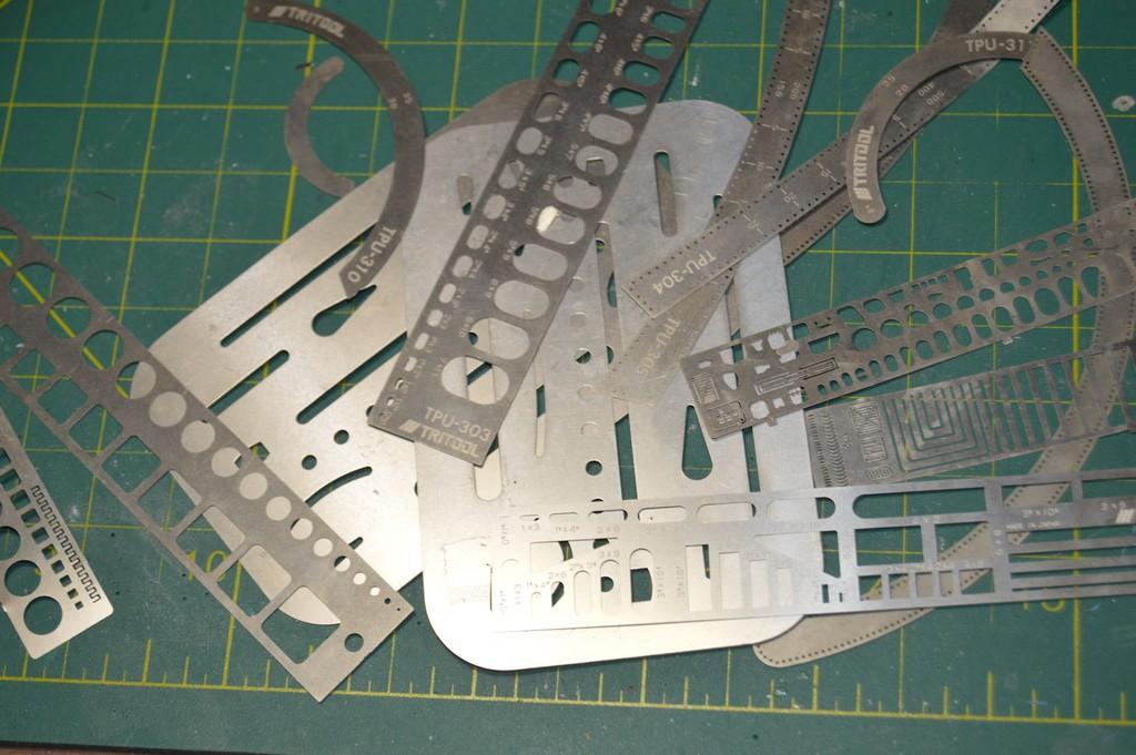

The best bet is to find something you can practice on. Barring that, just work slowly and carefully. I'm not aware of any magic elixir. You could try taping a piece of shim brass along the line you want to scribe. That should provide a more reliable stop for the tool. There are also photoetched templates for doing curves and rounded corners, etc. I have some from Verlinden Productions and some from Tri Tool. I got them long ago, and couldn't speak to their availability, now. I doubt it's likely!
