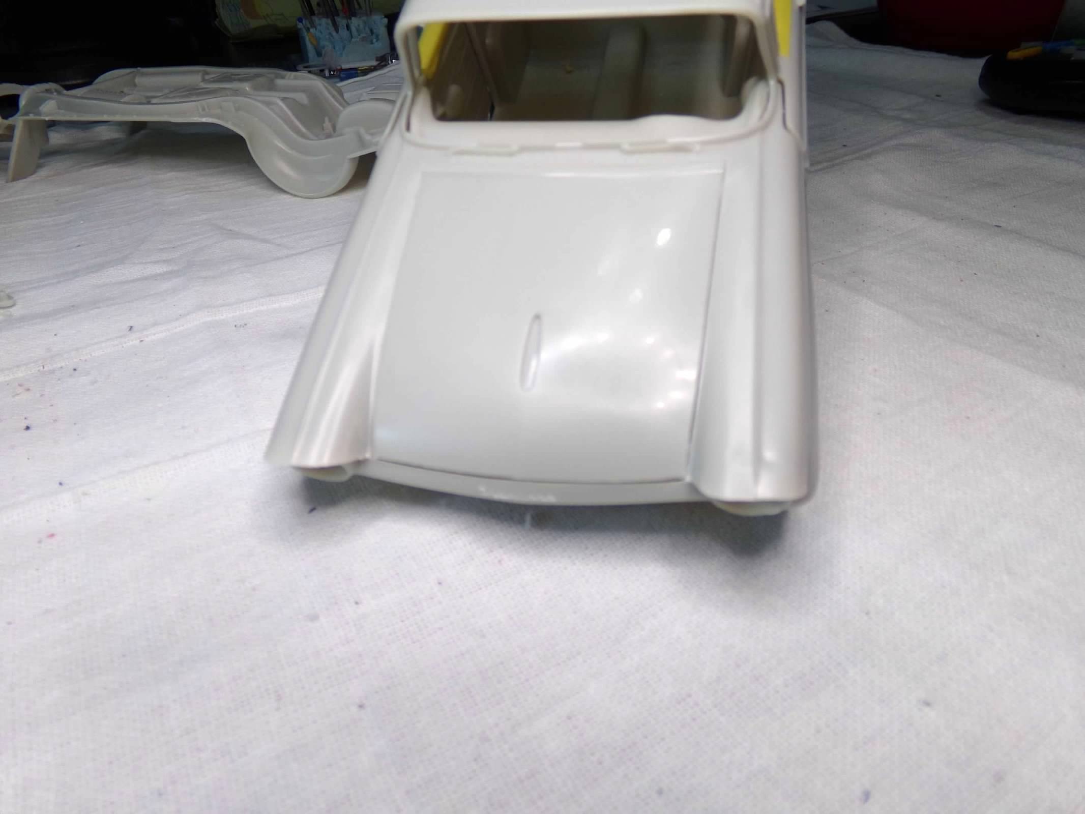

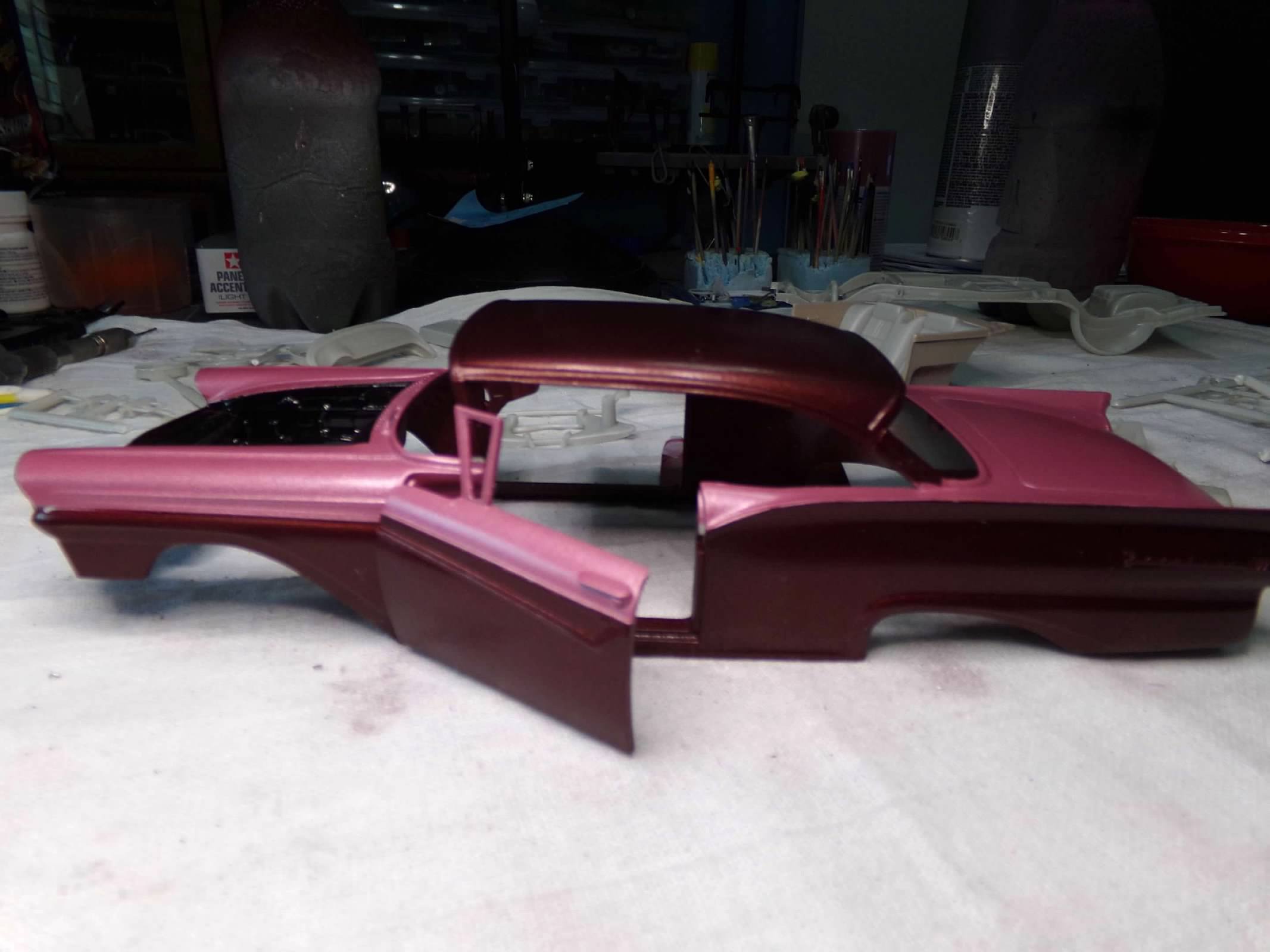

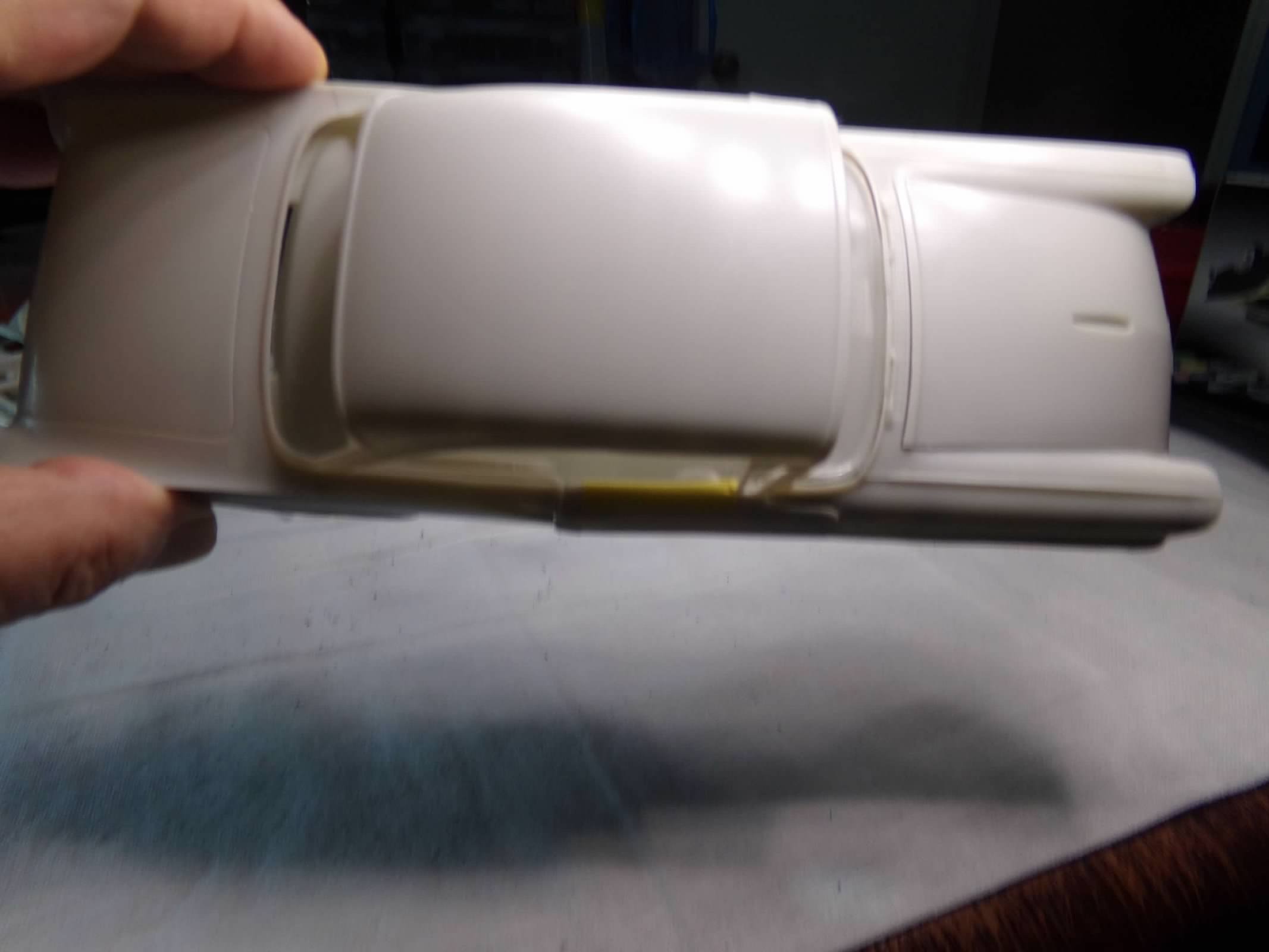

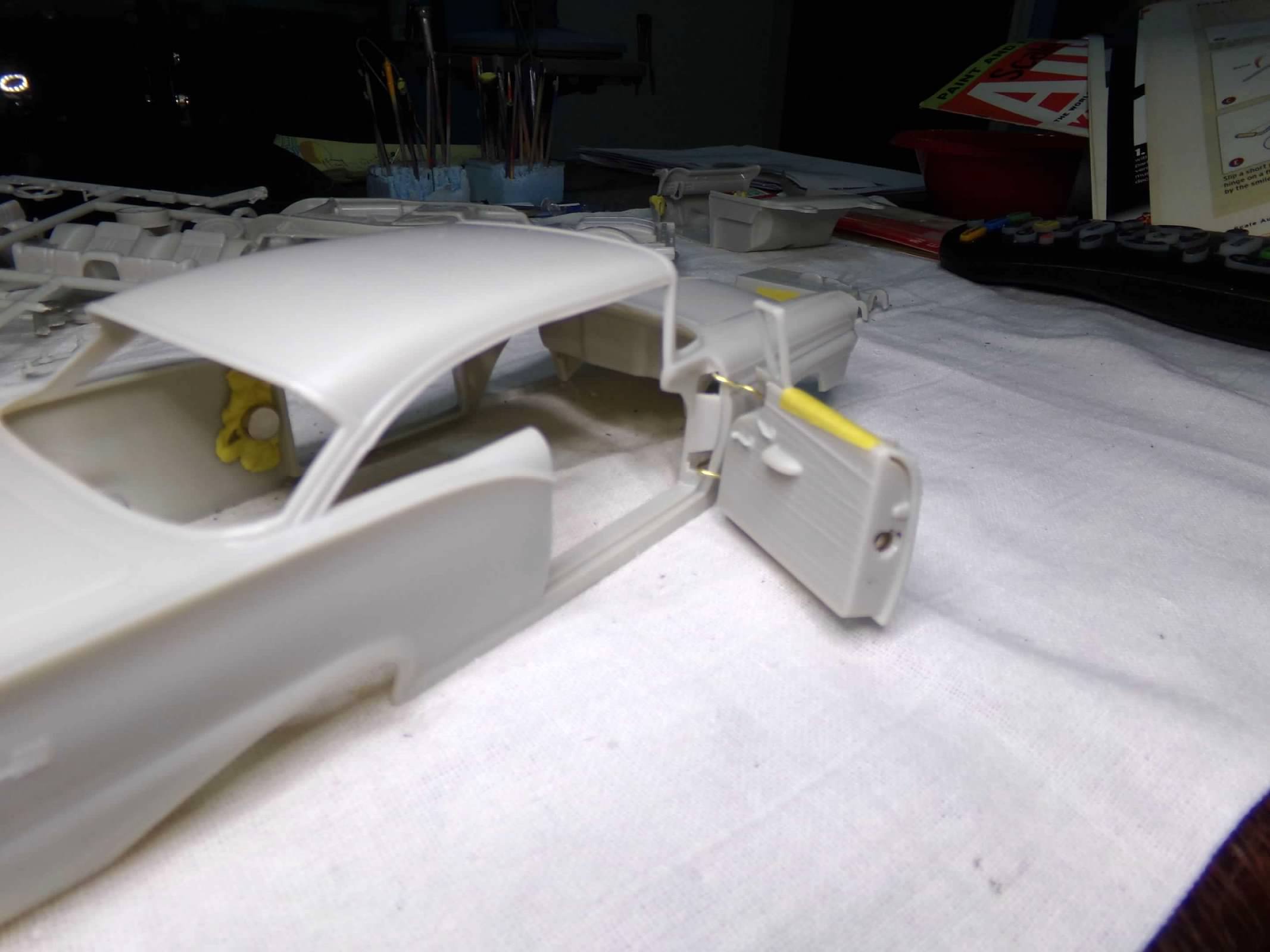

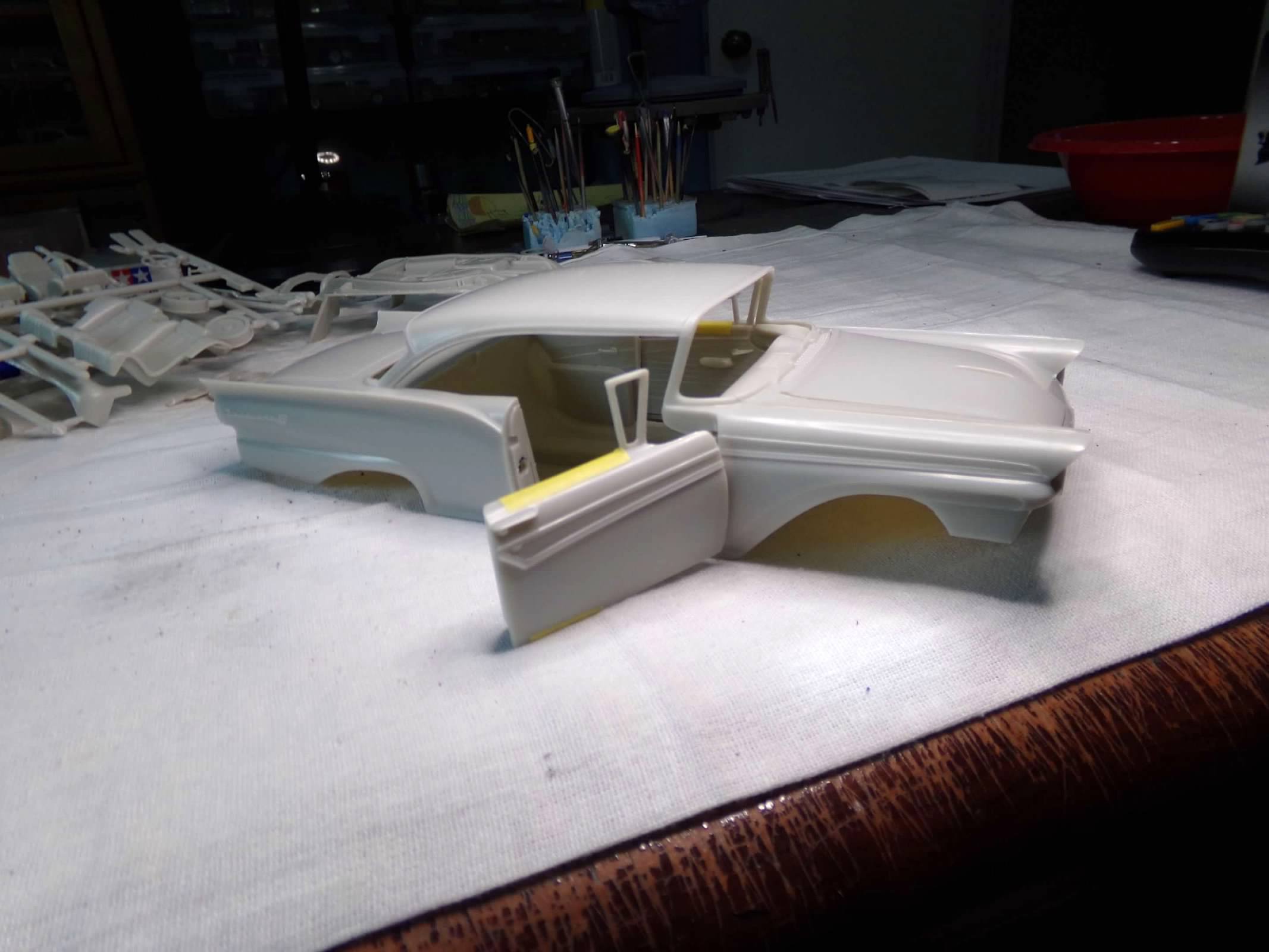

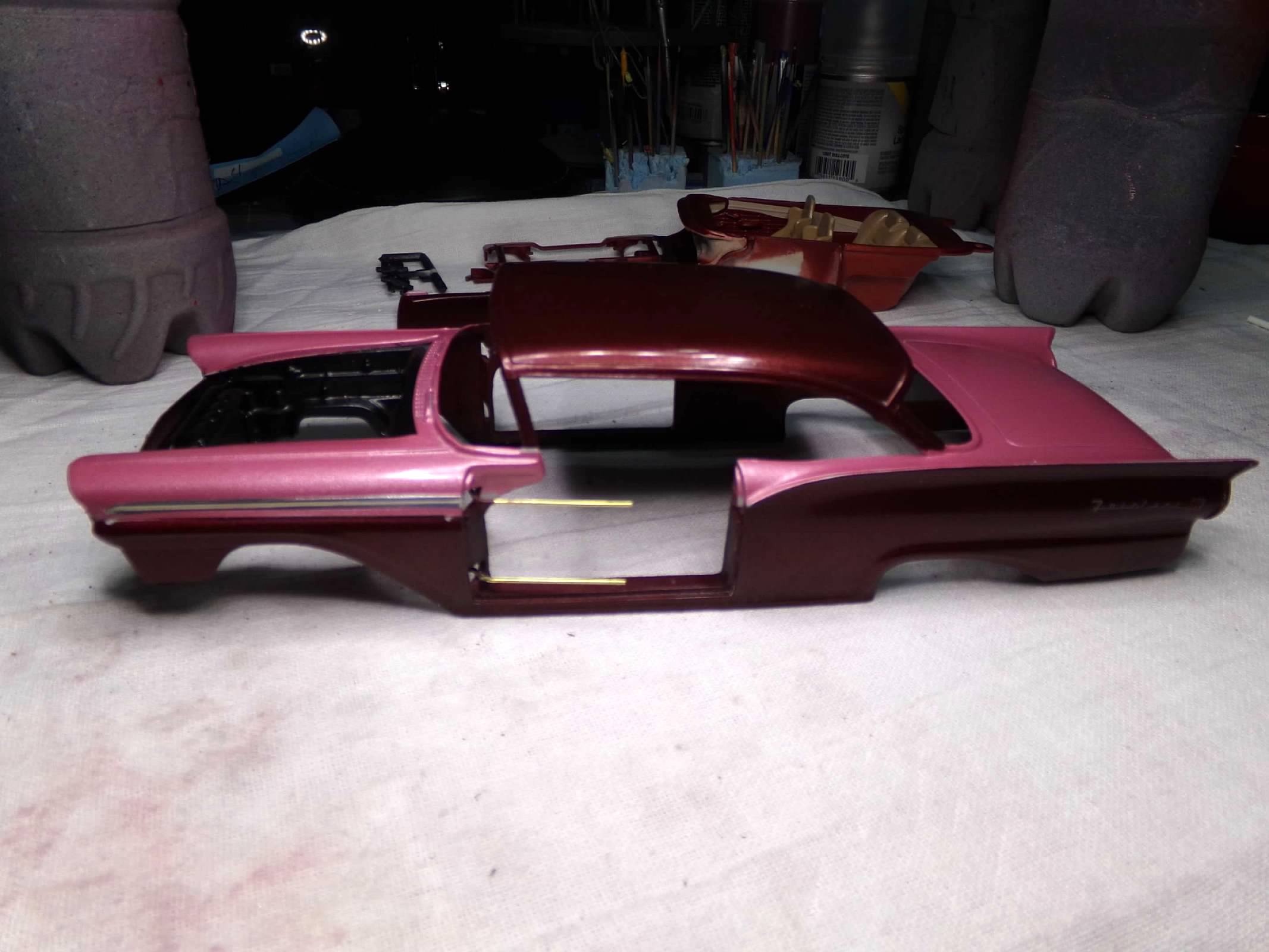

This is an old AMT offering that I haven't built in a long time. I won it at the last contest in the raffle. I always buy $5 worth of raffle tickets and luckily I usually hit on at least one. For this build, i am going to start with adding magnets for the door closures on the opening doors in this kit and also converting the opening doors to brass wire hinges using 1/32" brass wire and 3/32" plastic tubing. I also have some work to do on  the tops of the front fenders to eliminate two nasty sink marks. So I have started by adding the magnets with handy tack to mock-up how the doors will close and also installed the wire hinge for the right door. I want to get al that out of the way before painting. I'll cover the hinges with tape and remove the magnets once the body is ready for paint. You will notice a hole in the side of the opened right door. I thought I would mount the magnet in the hole but I didn't have to do that and it wouldn't fit anyway. So now I get to add some plastic and putty and repair the holes. Here are a few photos of progress so far. Thanks for looking!

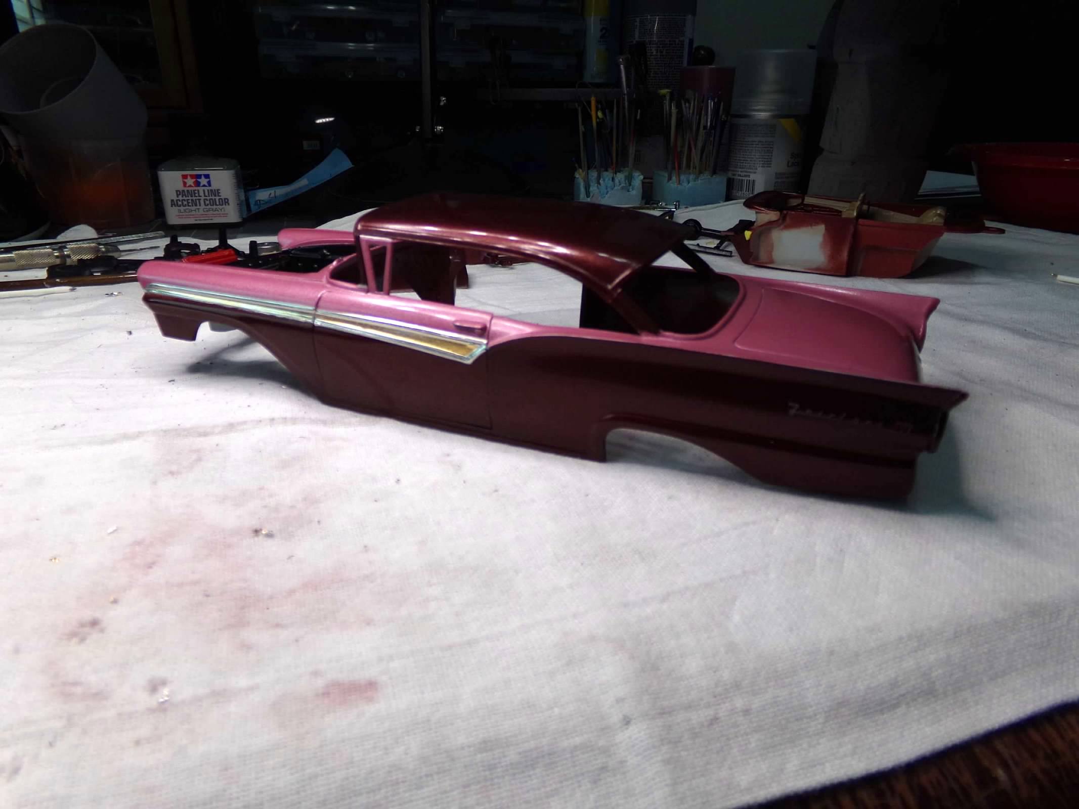

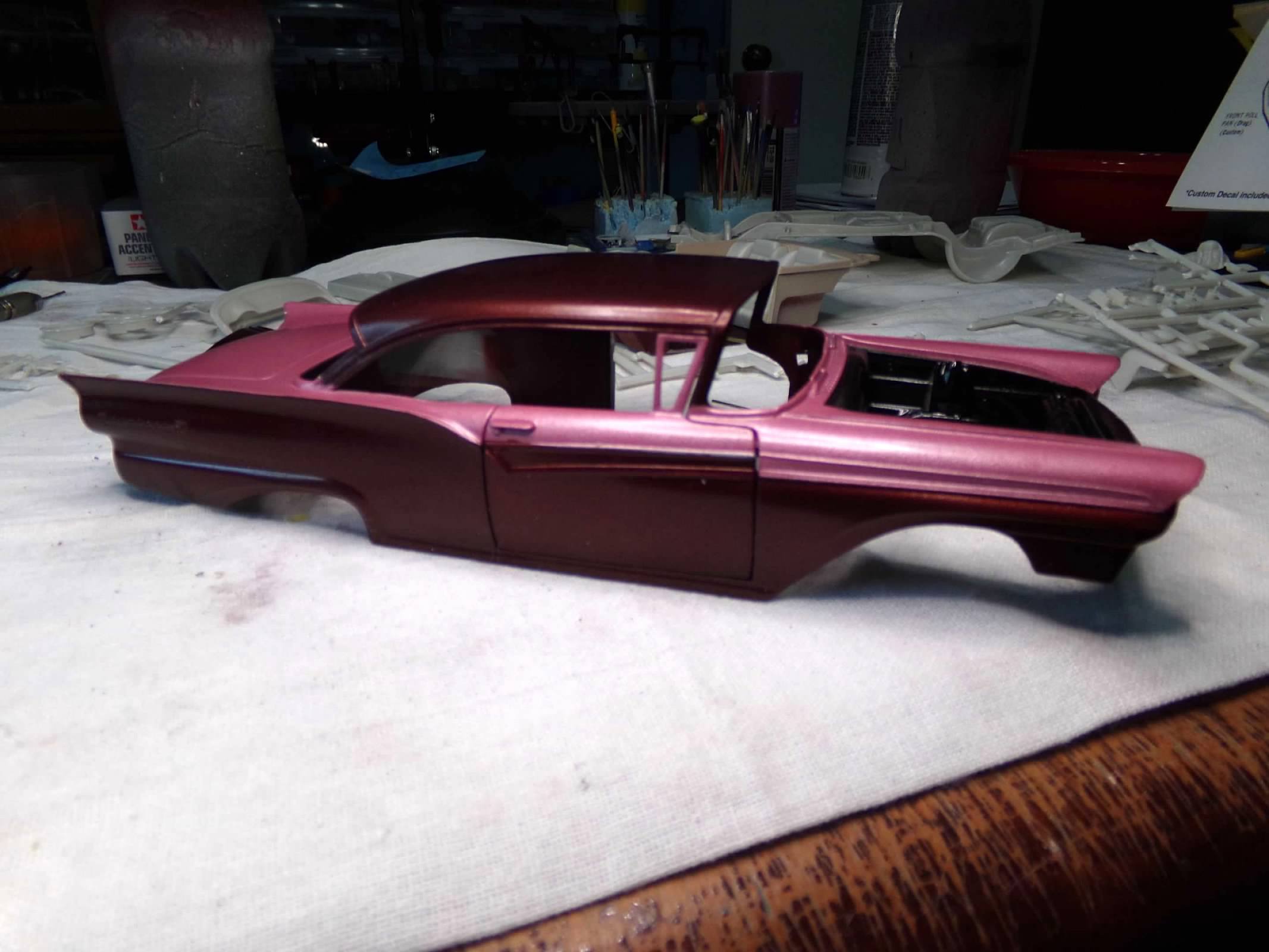

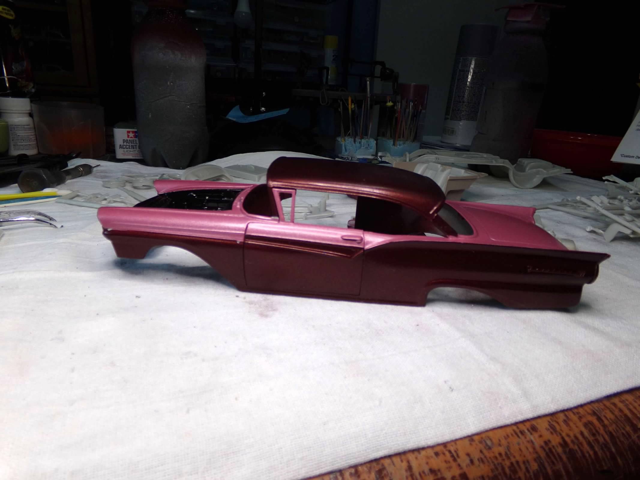

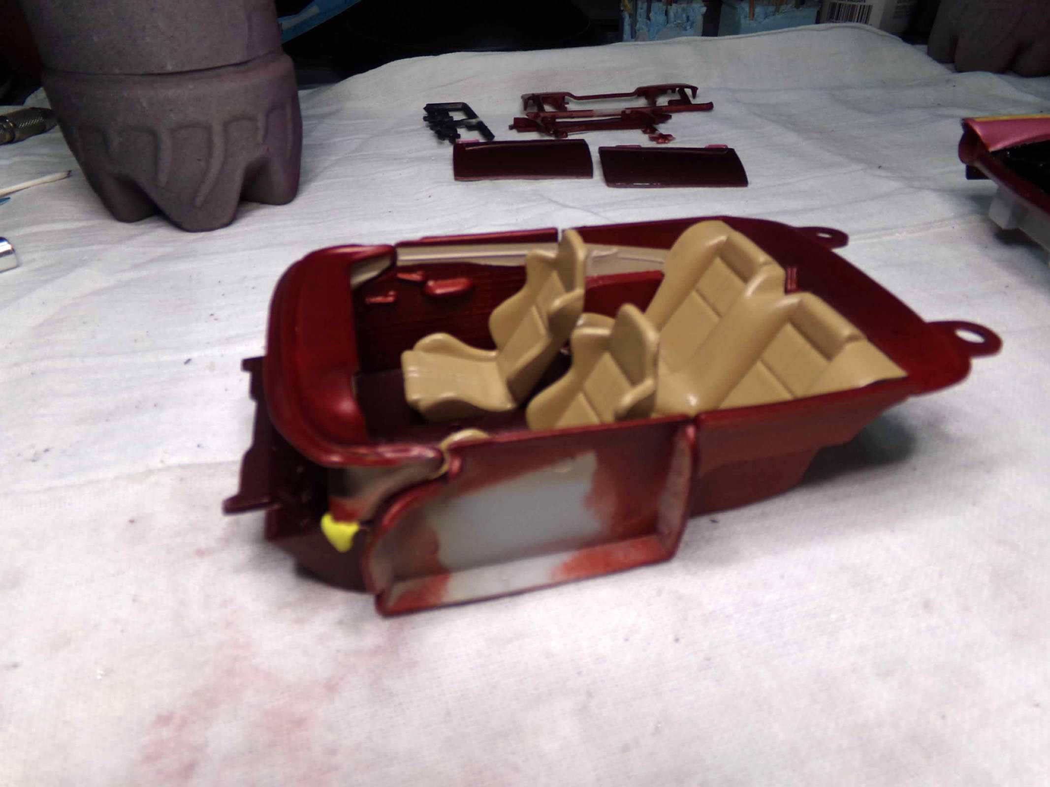

I've completed the body work and have painted the first color for this two-tone combination. Tomorrow I will do the second color after much taping. I'm going with my favorite color Dupli-Color Dark Toreador Metallic with Tamiya Light Red Pearl for the middle. I think the two will go together and the light red color gives it sort of a 50s look while still being a little more modern. I've painted the interior with Dark Toreador metallic and flatted it out for the carpeting. I may change the interior color for the door panels and seats. I don't know yet. Thanks for looking! ?

I like the way this is going, John. Two-toning looks terrific on these mid-fifties cars. Don't hurry it. Fight the urge....let that paint dry! ?
I am a big fan of two tone paint jobs whether contrasting or complimentary. I have the Fairlane 500, the Del Rio Ranch wagon, the Custom and the Ranchero Street Machine. I am following to see how yours comes together.

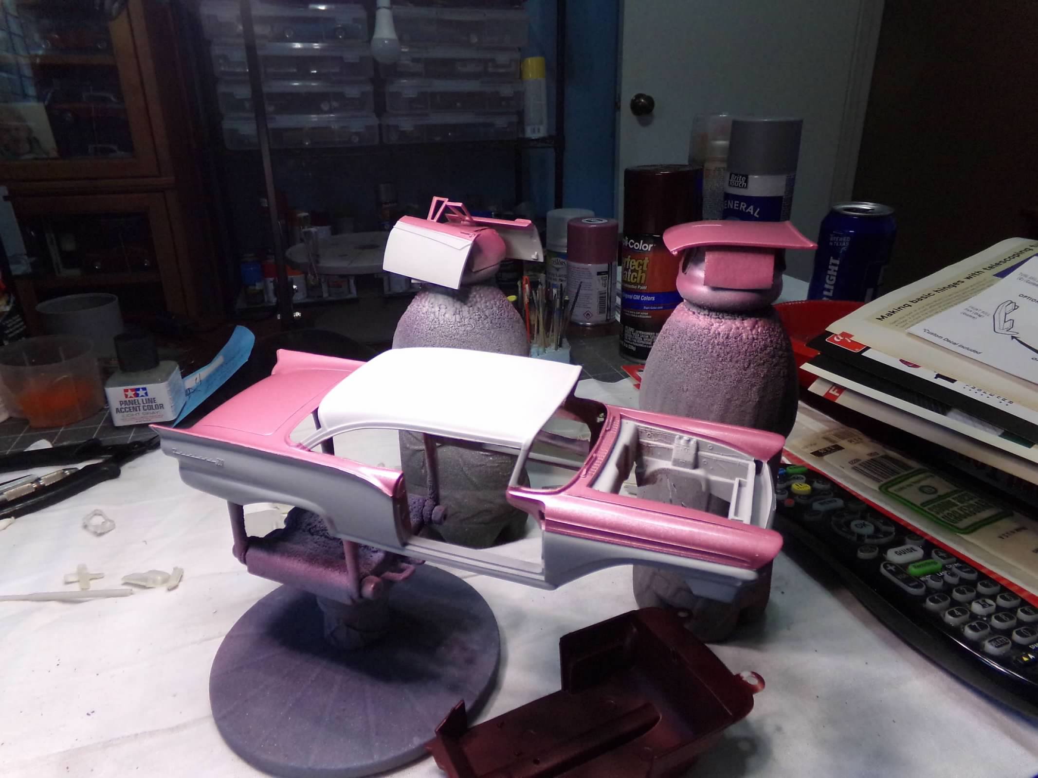

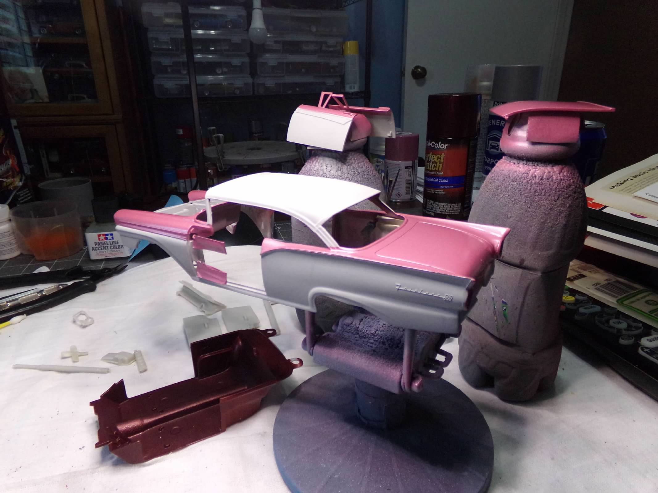

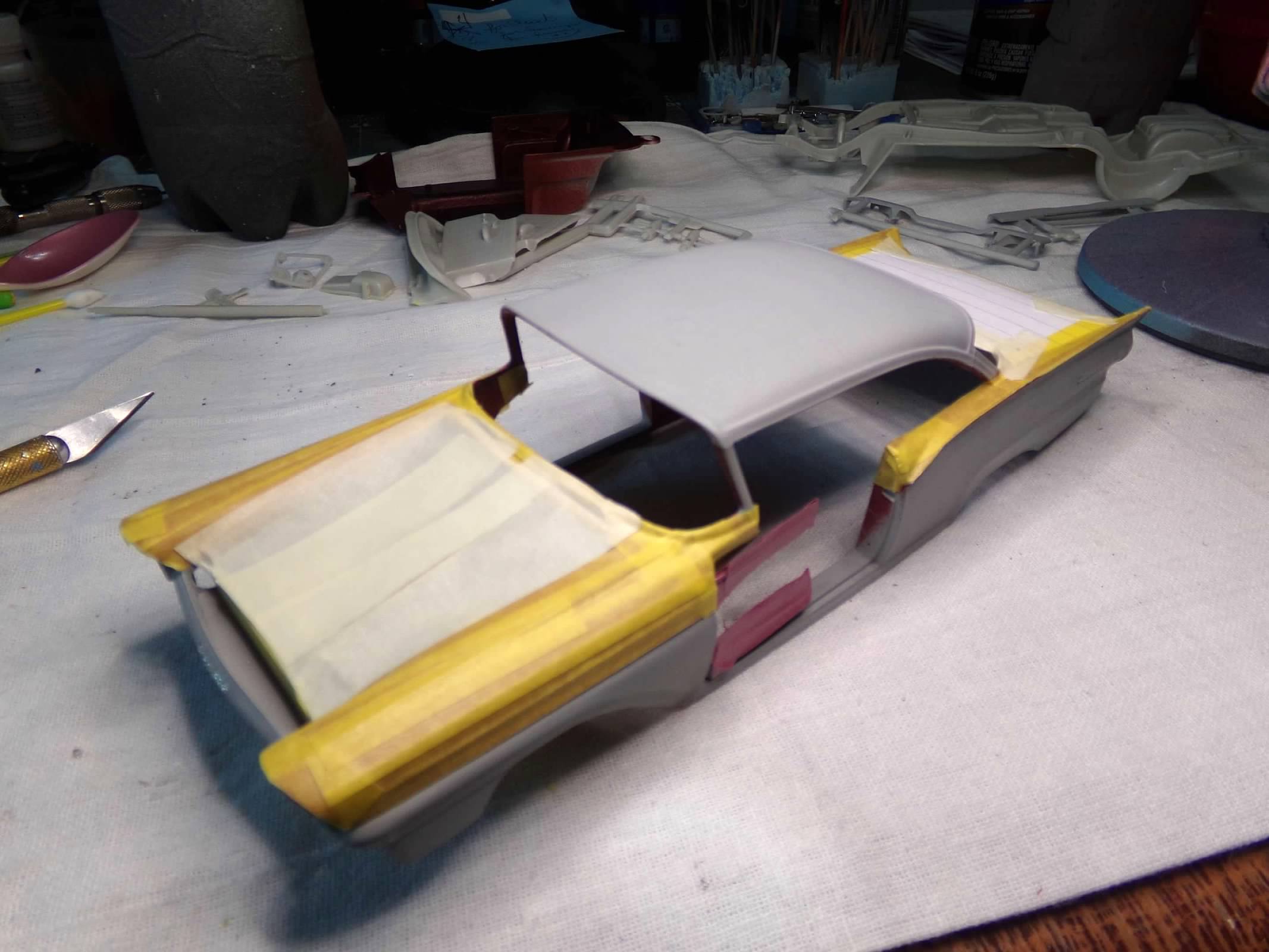

Spent most of the day taping and painting the body. This one is a tape monster! I did have the forethought though to tape the engine bay so that I could pull that tape over the hood opening and with the help of some index cards paint the engine bay black after painting the main body color. Since taking these photo, I have added a piece of plastic strip to the top of the wing window on the left side where it doesn't quite meet the roof. I hope to start rubbing out the body and foiling tomorrow. But first, I have to assemble the engine block, paint it and paint the remaining parts while the weather is hot and dry. Thanks for looking! ?

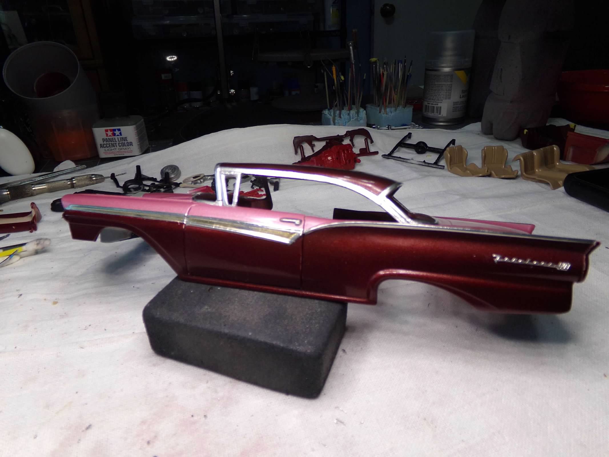

I usually have to wait until about 1 PM for the humidity to go down to about 40% but the temp is about 100 degrees on my covered patio so it isn't pleasant. I paint quickly and let it dry on the table on the patio. It dries pretty quick! I did get the rest of the parts painted today, including the basic painting for the interior. I'm using the custom seats and I may need to find another console instead of the one in the kit that looks like one side of a ramp that you would drive your car on to change oil. I need to touch up this interior and add some foil to straighten out the wrap pattern from the back seat to the dash. I've also almost finished rubbing out the paint on the body and have started the first piece of foil on the body. Tomorrow, I'll finish the foil. Thanks for looking! ?

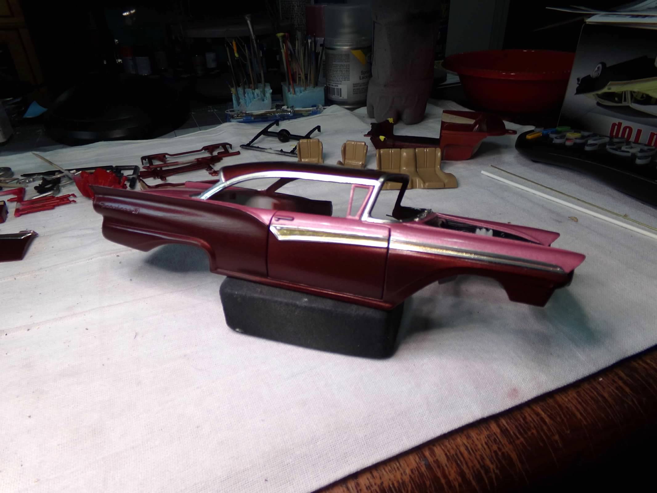

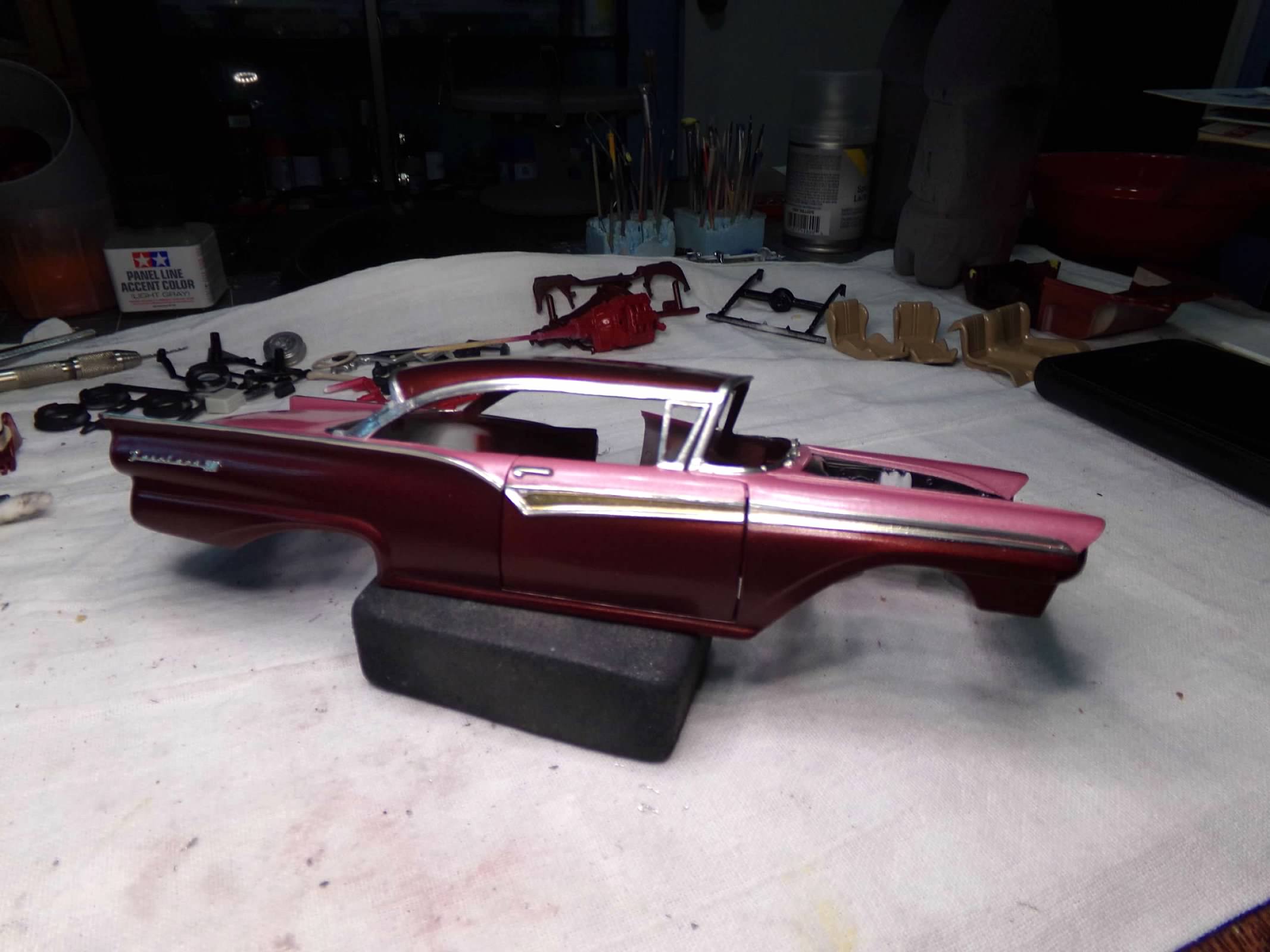

Yes, Jim, I do have some gold foil for the trim. Probably the same sheet that I used 30 years ago to do the first one. The one I did before was a standard red and white (probably yellow white by now) and I have tried to find it but I will have to extend my search into the 50 or so scrapbooking cases that I have stored here in my room that houses about 300 completed models. The sheet of gold foil is priced at $5.95, so I'm sure it is very old. Here are a couple of pics of the completed gold and chrome foil on the sides. Thanks for looking! ?

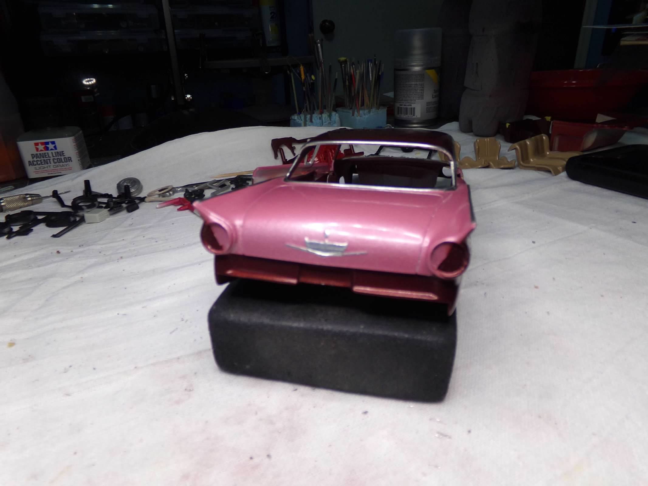

Finished the foil. It took a little longer in order to foil the Fairlane 500 scripts and the Crown V on the trunk. Now I just have to reveal the Fairlane script on the front that I foiled before paint. In addition, I have to build another hinge for the right door because the first one had arches that were too big for the holes in the door jam. But should be easy now that I have that hinge building knowledge from an article in a magazine. I'm also going to foil the interior doors and get that out of the way so I can finish and install the interior and opening doors. Thanks for looking! ?
