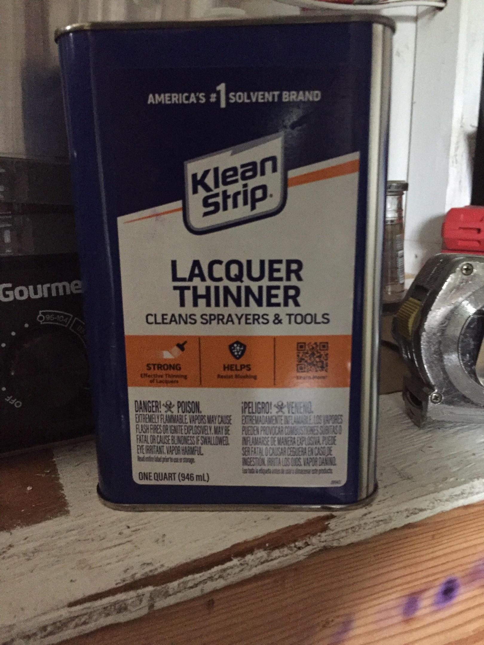

This may not be pertinent to this discussion but I have recently experienced an issue with the lacquer thinner I got at Lowes recently. I use it for cleaning brushes and noticed it was acting "strange".  Then I used it for thinning MM enamel for spraying last week and I noticed the solids in the paint were separating out and congealing and settling to the bottom of the jar. I stopped using it for anything immediately.
Edited by customline
