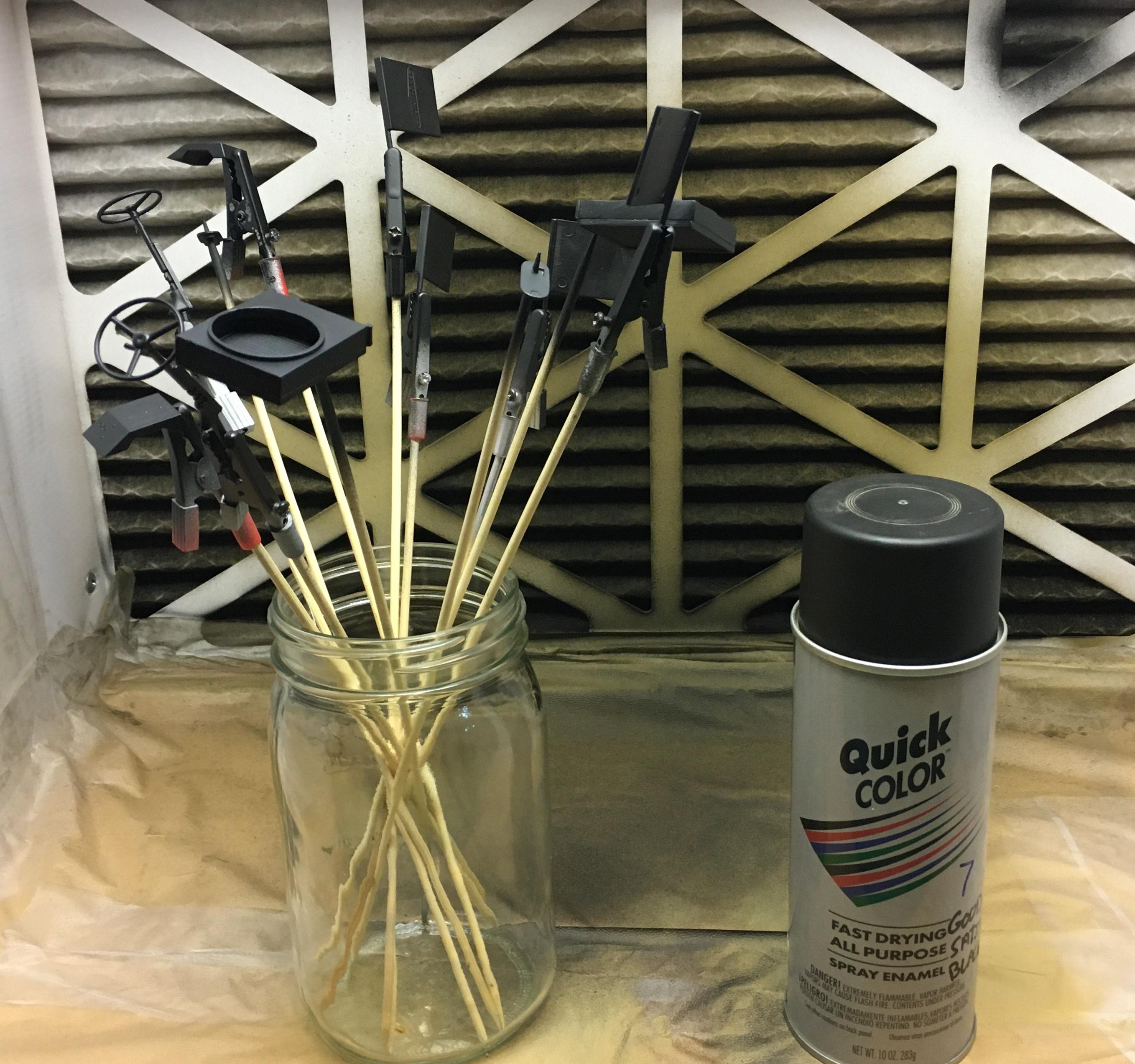

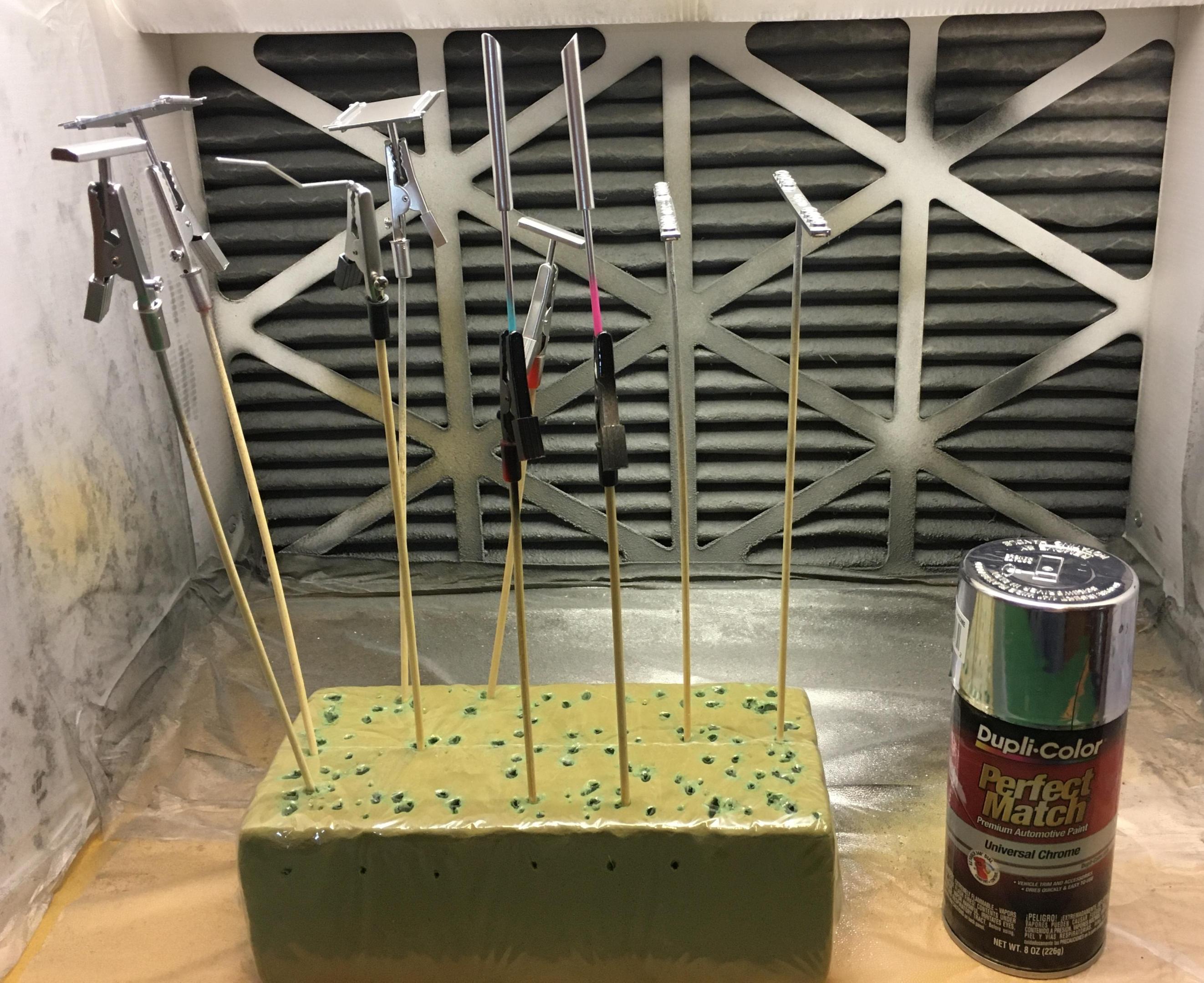

Bills72sj Posted September 15, 2023 Posted September 15, 2023 (edited) I do not paint parts on the sprue either. Most every part needs a little sanding or attention done to it. I CA glue the part to a stub of scrap sprue in a location that will not show when assembled. CA glue has a brittle bond which, while strong, snaps pretty cleanly when the cross sectional area is small. Edited September 15, 2023 by Bills72sj 2

Dpate Posted September 15, 2023 Posted September 15, 2023 On 9/15/2023 at 2:04 AM, Milo said: In that video the guy is spraying all of the pieces still on the sprues, when he's done how does he fix the parts where he cut them from the sprues. Wouldn't it leave little white cut marks? Expand He builds like that in the videos because he gets so many kits from sponsors. He does quick builds to show how the finished model looks. Lot of modelers do paint parts on sprues, and then cut them off and touch up. It just boils down to preference, and what works for you. There’s loads of different methods of painting parts too like you’ve seen in the pics here. Alligator clips, blue tack, pop sickle sticks with double sided tape or tack etc etc. There is no right or wrong way - just one way you get a better finish, and the other way no so much. 3

Skip Posted September 16, 2023 Posted September 16, 2023 I use the alligator clips like everyone else and stab them into a chunk of Styrofoam with a chunk of modeling clay stuck on the bottom, keeps it from falling over with painted parts on it. Plus some 1/2" X 1/2" double back tape bits that I stick the part onto a wood coffee stirrer stick, works for me! 1
