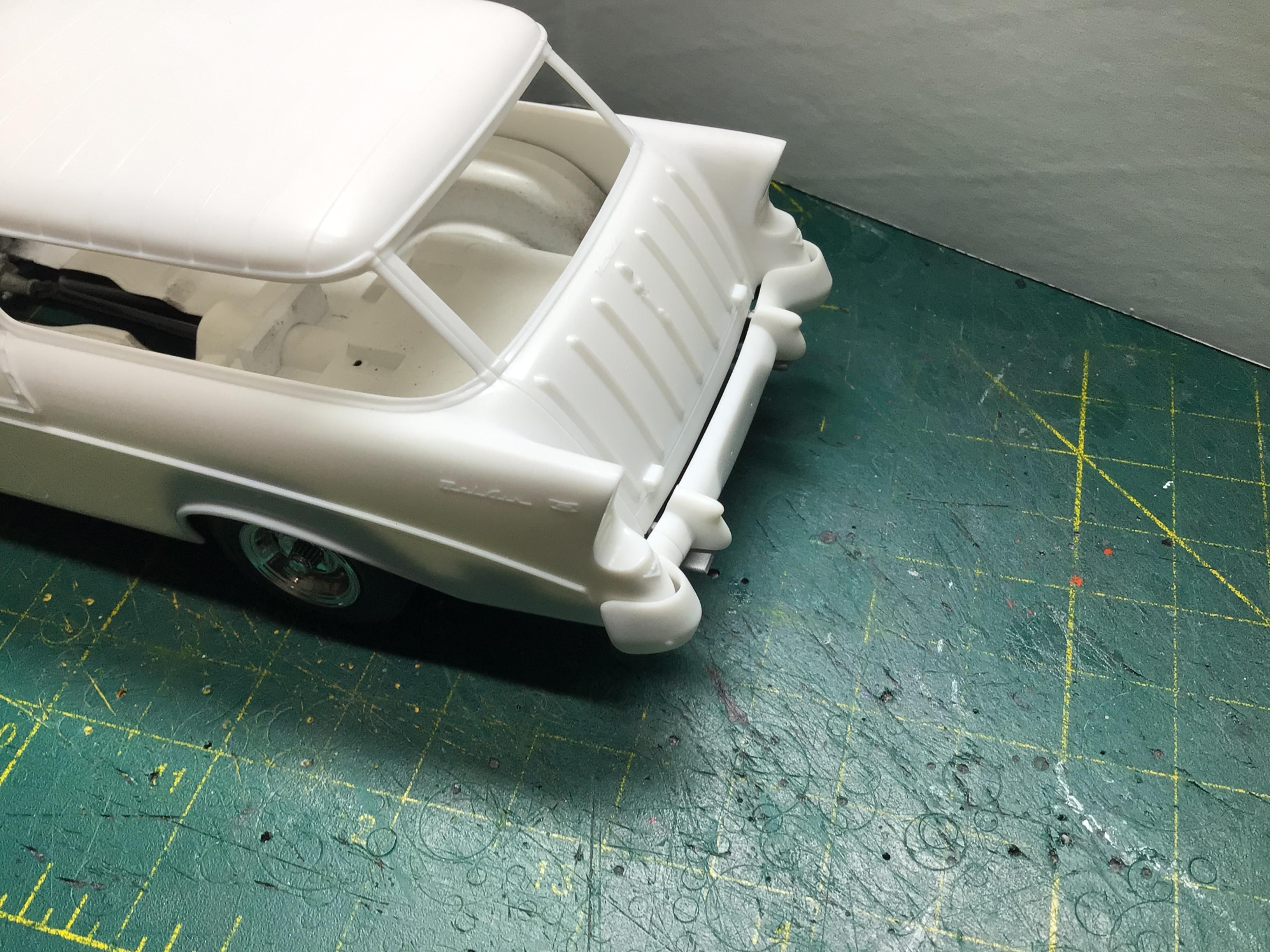

doorsovdoon Posted November 7, 2023 Posted November 7, 2023 Nice work on the bumper. Good looking mock up, I like the stance.

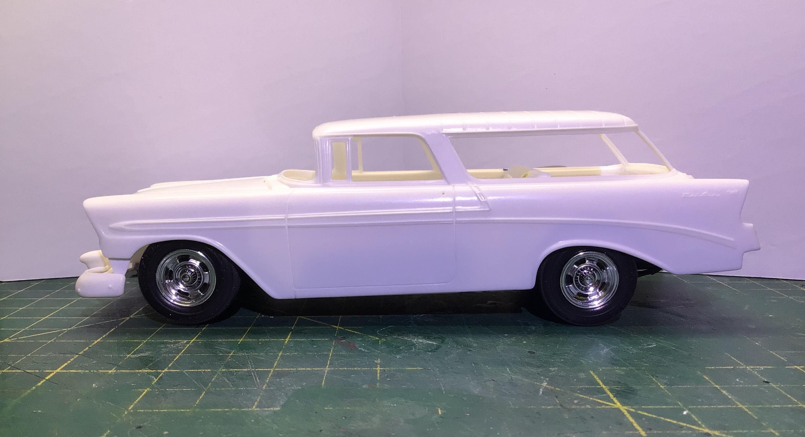

espo Posted November 7, 2023 Posted November 7, 2023 A thought if you're going with wide tires that will not fit inside the stock rear wheel wells. The kits front mounting point for the rear leaf springs are on the outboard side of the frame just like the real cars. First replicate the mounting point on the inside of the frame. Moving the front mounting point will create some clearance issues between the rear portion of the leaf spring and the kits exhaust. Minor rerouting of the exhaust pipes or even changing their exit point would not be hard to do. This would give you a little more rear tire clearance even without narrowing the rear differential or tubbing the rear wheel well. The last one I built I used the optional "California Wheels and Tires" from in of the '56 Chevy kits and everything cleared with zero modification, other than lowering the suspension.
NOBLNG Posted November 8, 2023 Author Posted November 8, 2023 On 11/7/2023 at 1:52 AM, customline said: My 2 pennies?.....go 100% stock with a cool 2 tone paint job. Sorry....?.... Expand Thanks. I don’t like the stock tires though, so I’m switching them.? On 11/7/2023 at 4:22 AM, Bills72sj said: After viewing them all twice. I like D followed by 2. Expand Thanks. I do like D, but the rally wheels won out in my mind. On 11/7/2023 at 8:22 AM, redscampi said: D3. Cragar mags belong on a classic Nomad. There’s reason they were ubiquitous.? Expand They are the nicest look, but the tires that fit the rims won’t fit the wheel wells.? On 11/7/2023 at 6:54 PM, Mr. Metallic said: The version of this kit with the green-on-green 1:1 is the original issue, and I thought I remembered that Revell redid the valance for later issues. Can anyone confirm that? Expand The newer Del Ray is corrected, but I don’t know if the California Wheels Nomad is??♂️ On 11/7/2023 at 7:17 PM, Ace-Garageguy said: Looking good. Kinda amazing how many people build this kit and don't even notice the glaring errors...especially the peaks on the front fender tops...you're correcting so nicely... My compliments on your work, sir. Expand I thank you for the compliments sir.? On 11/7/2023 at 8:02 PM, doorsovdoon said: Nice work on the bumper. Good looking mock up, I like the stance. Expand Thank you Gareth. On 11/7/2023 at 10:13 PM, espo said: A thought if you're going with wide tires that will not fit inside the stock rear wheel wells. The kits front mounting point for the rear leaf springs are on the outboard side of the frame just like the real cars. First replicate the mounting point on the inside of the frame. Moving the front mounting point will create some clearance issues between the rear portion of the leaf spring and the kits exhaust. Minor rerouting of the exhaust pipes or even changing their exit point would not be hard to do. This would give you a little more rear tire clearance even without narrowing the rear differential or tubbing the rear wheel well. The last one I built I used the optional "California Wheels and Tires" from in of the '56 Chevy kits and everything cleared with zero modification, other than lowering the suspension. Expand Thanks David. These rally wheels and tires fit nicely, and I can use the original wheel backs from the kit…so they win out. I doubt I will ever build the CW kit, so I will keep it sealed and trade it? Thanks again everyone!?

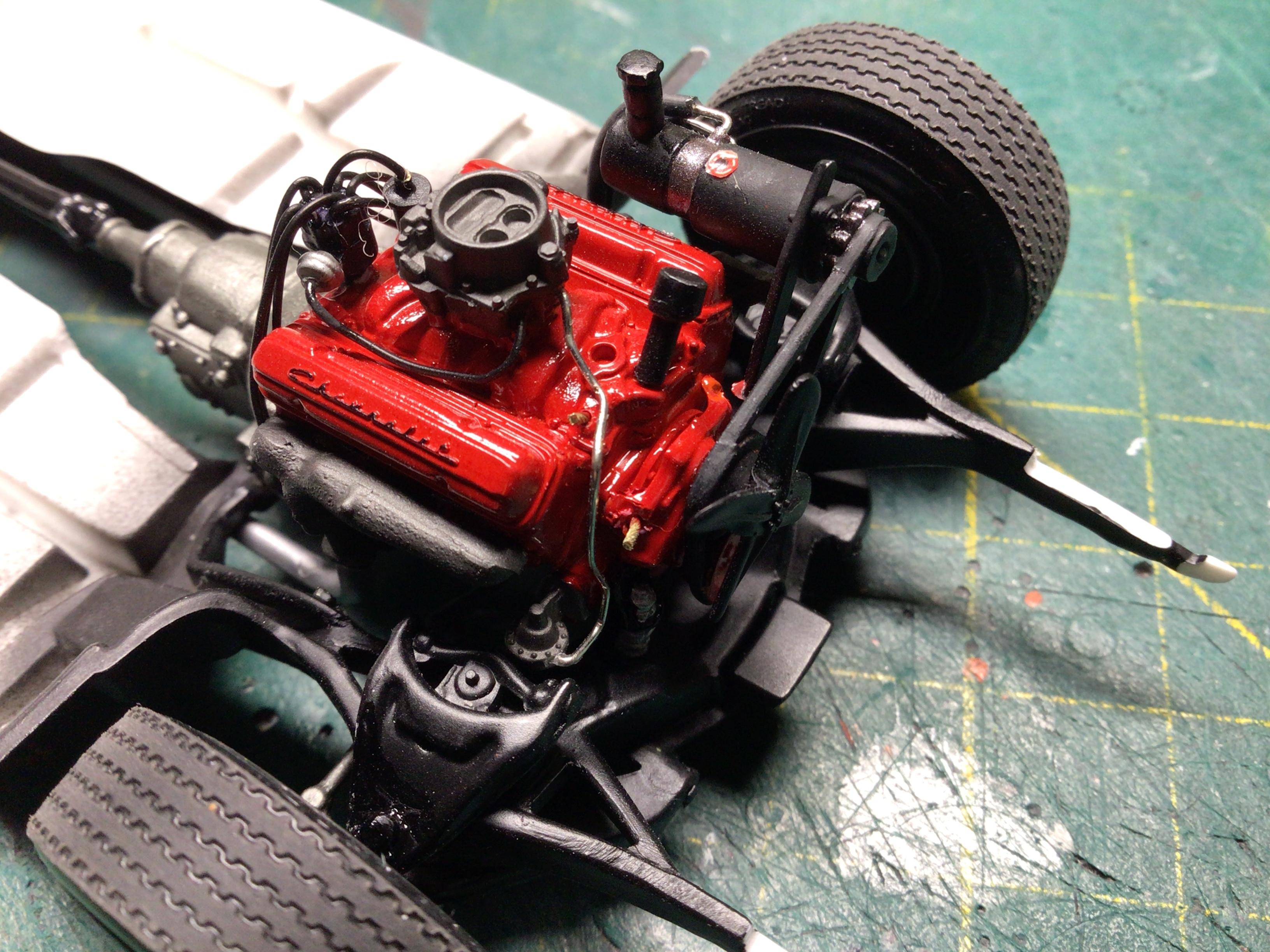

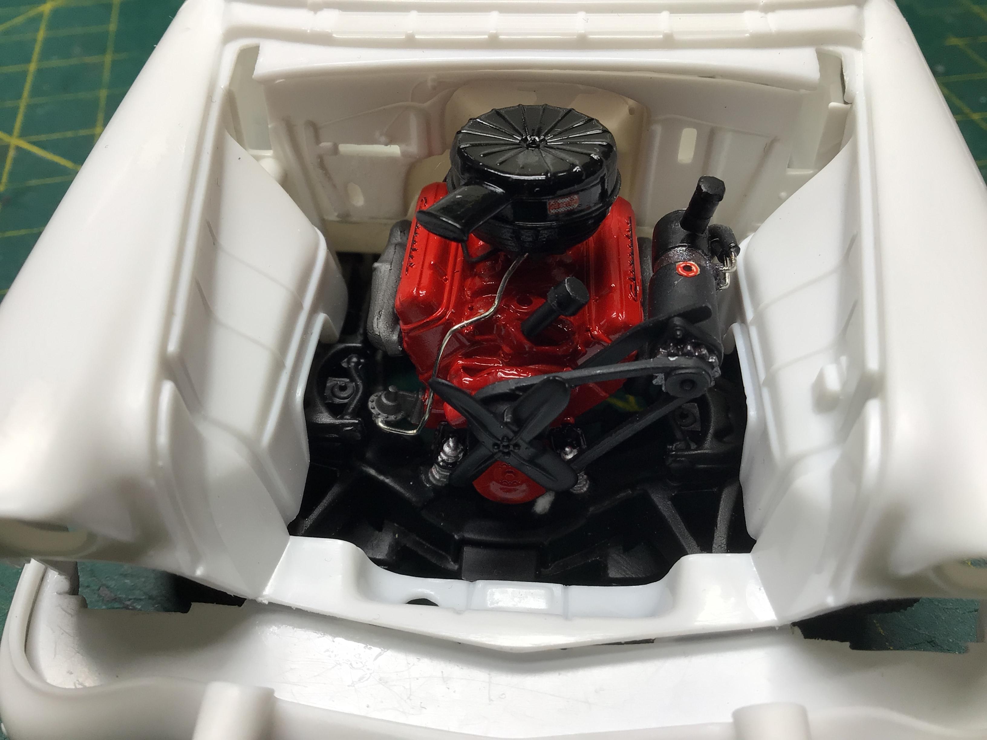

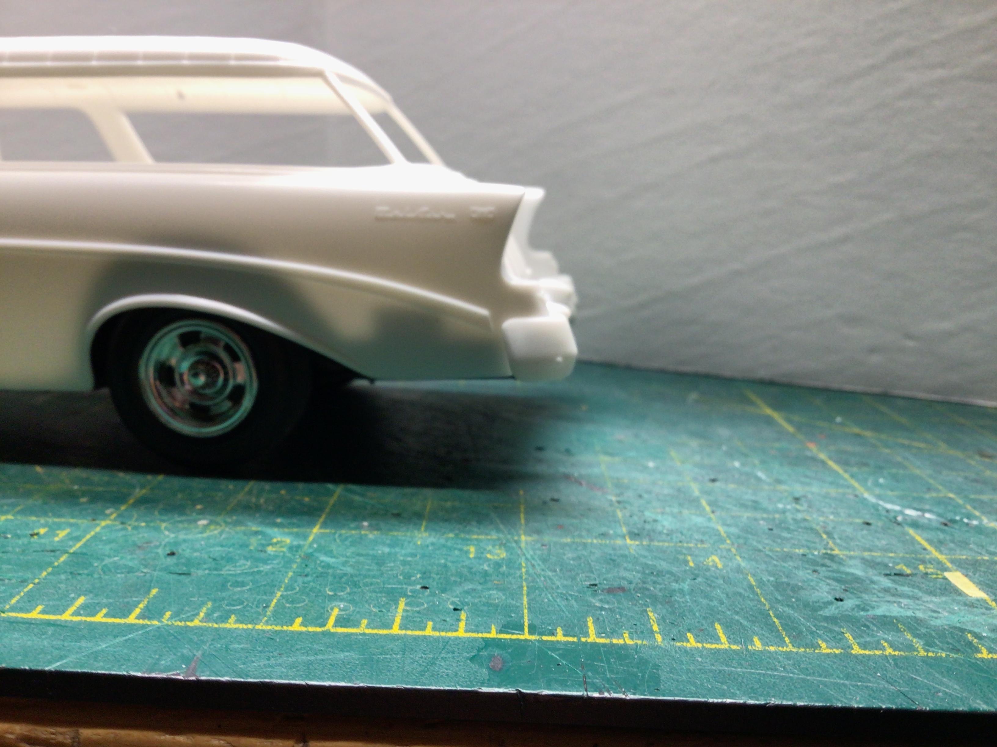

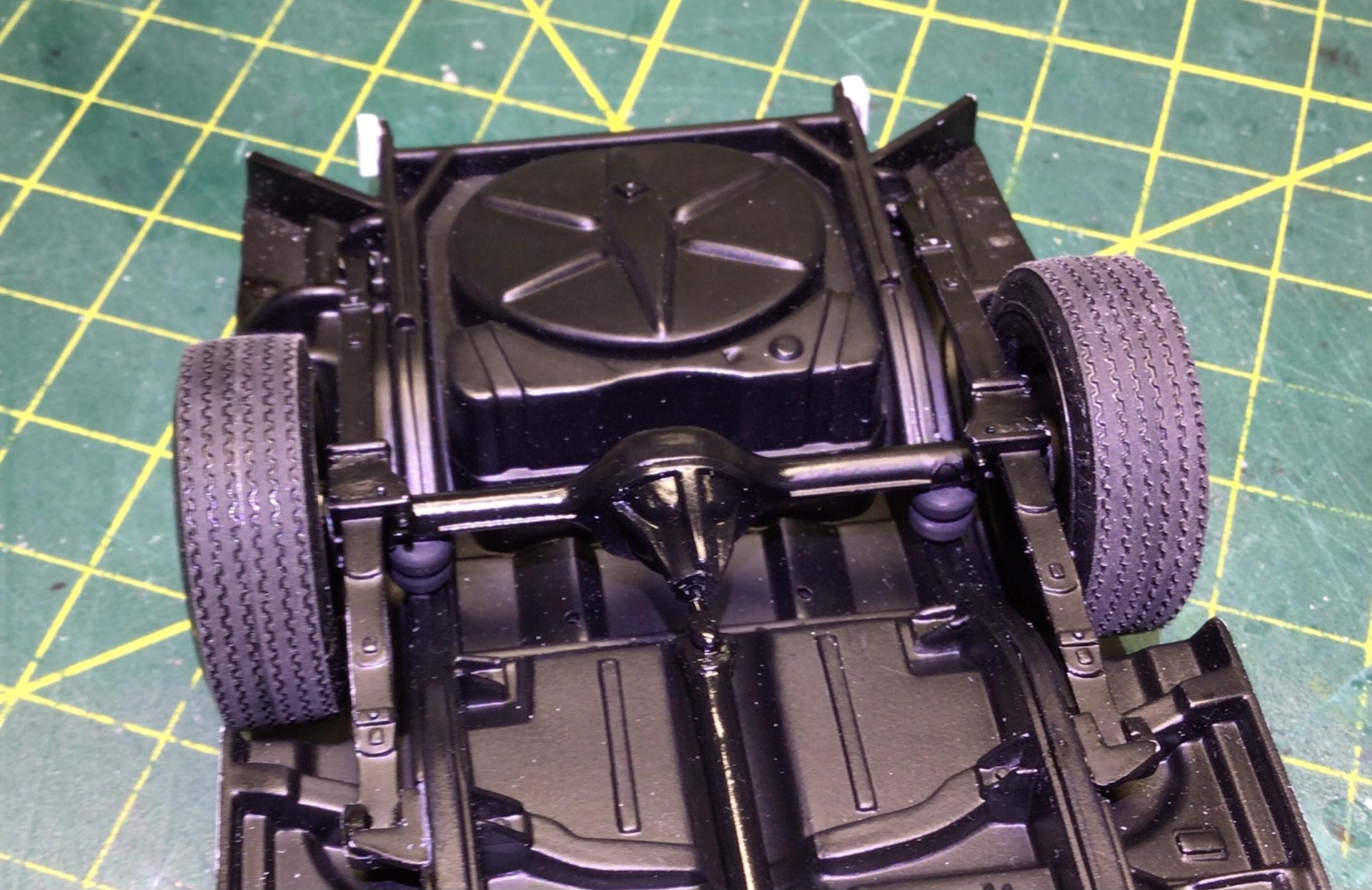

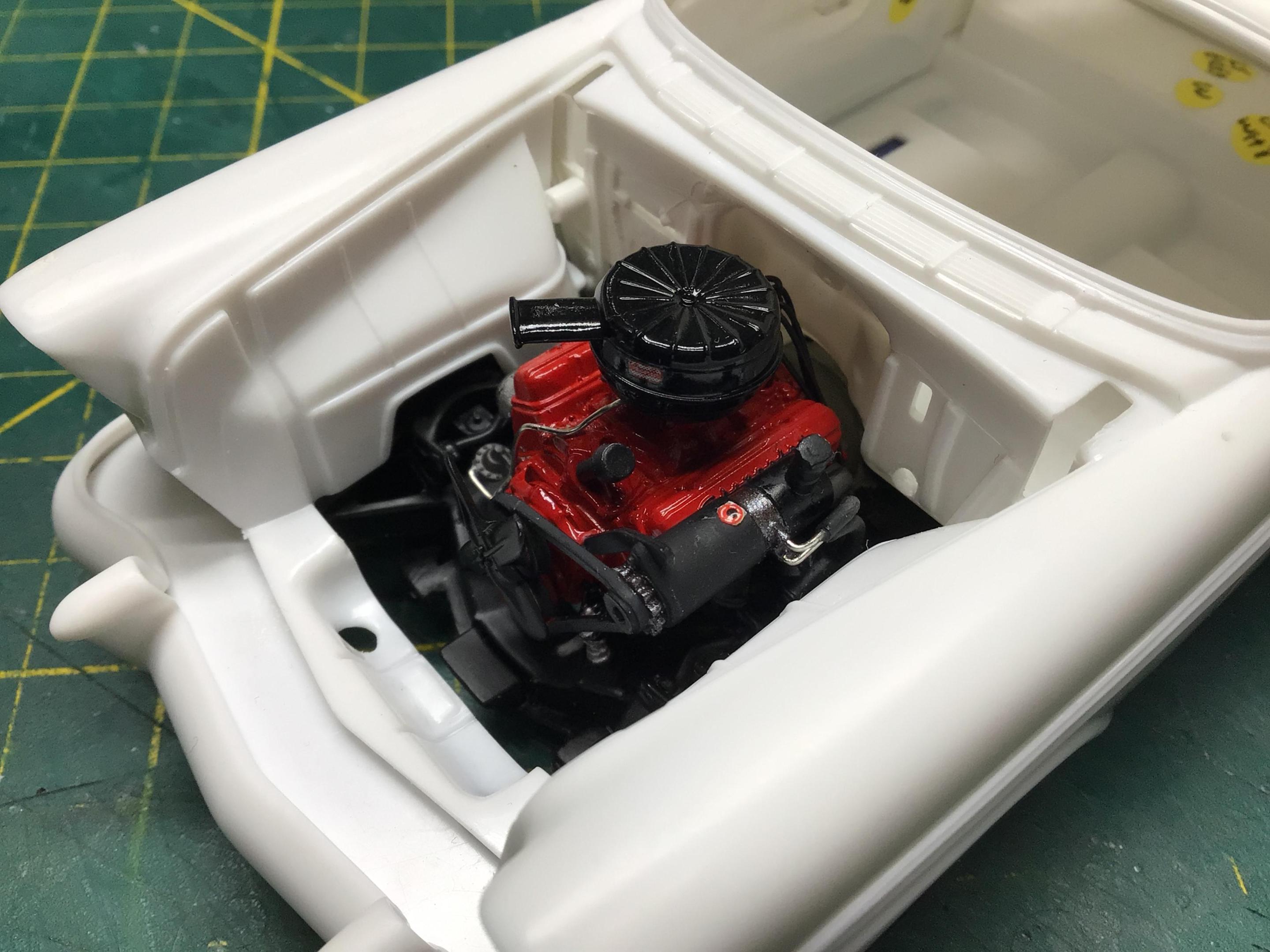

NOBLNG Posted November 8, 2023 Author Posted November 8, 2023 (edited) The wheels and ride height are now set in epoxy. I decided to use the rally wheels because: a) In the 1:1 world they would be a cheap and easy upgrade…the lug pattern is the same and you could get them for a song from anyone who put mags on their Chevy muscle car, and b) they are a cheap and easy upgrade for me now.? I raised the “spindles” .157” which dropped the front end a scale 4”, and I actually raised the rear a touch with some custom air bags.? I didn’t want the rims tucked up inside the fenders. I also got the engine mostly detailed and installed. I had originally painted the engine chevy orange, but through my research, discovered that the ‘56s were red…so I shot some red over the orange. I made up some power steering hoses for it, and installed some pins for heater hoses to connect to. Edited November 9, 2023 by NOBLNG 5

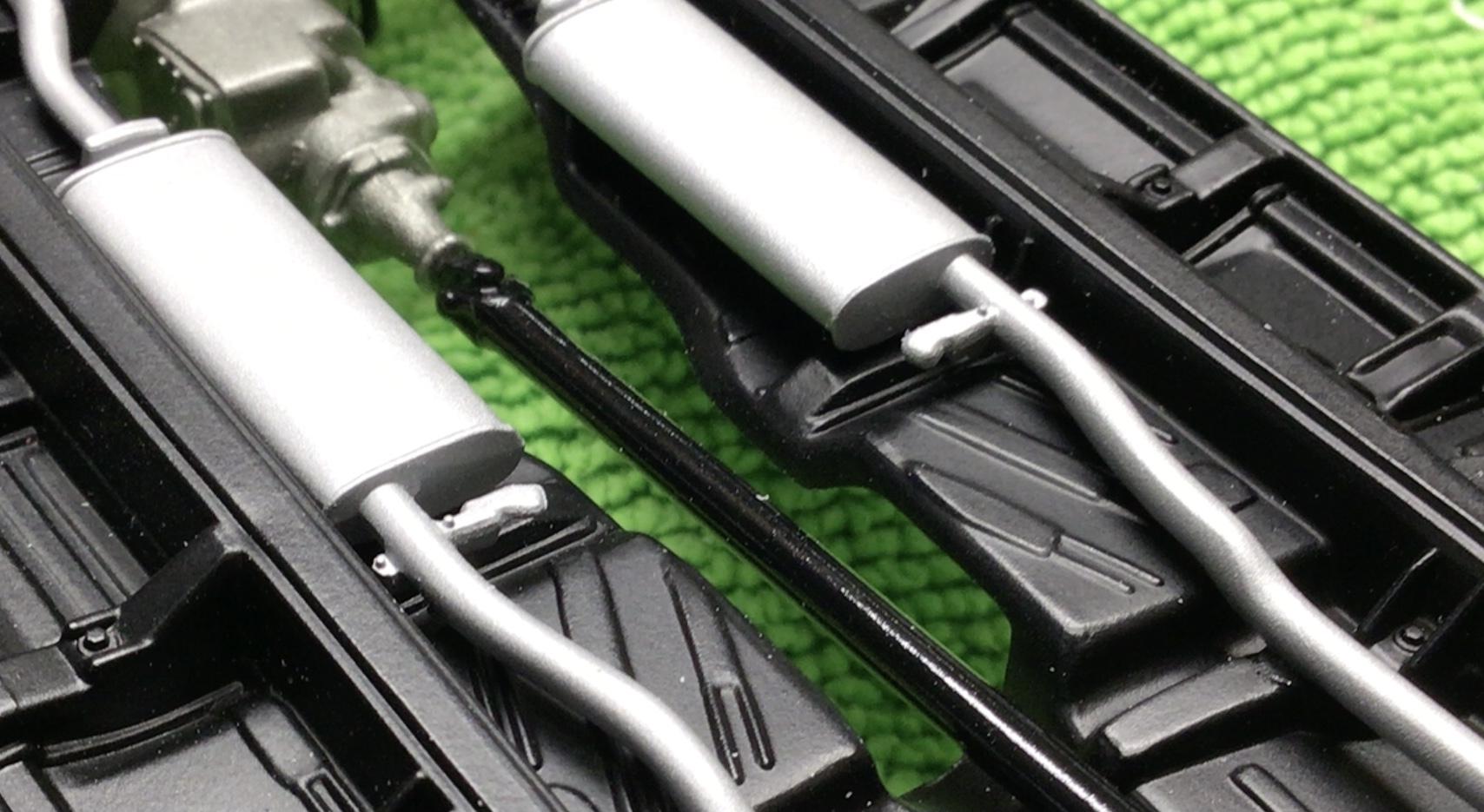

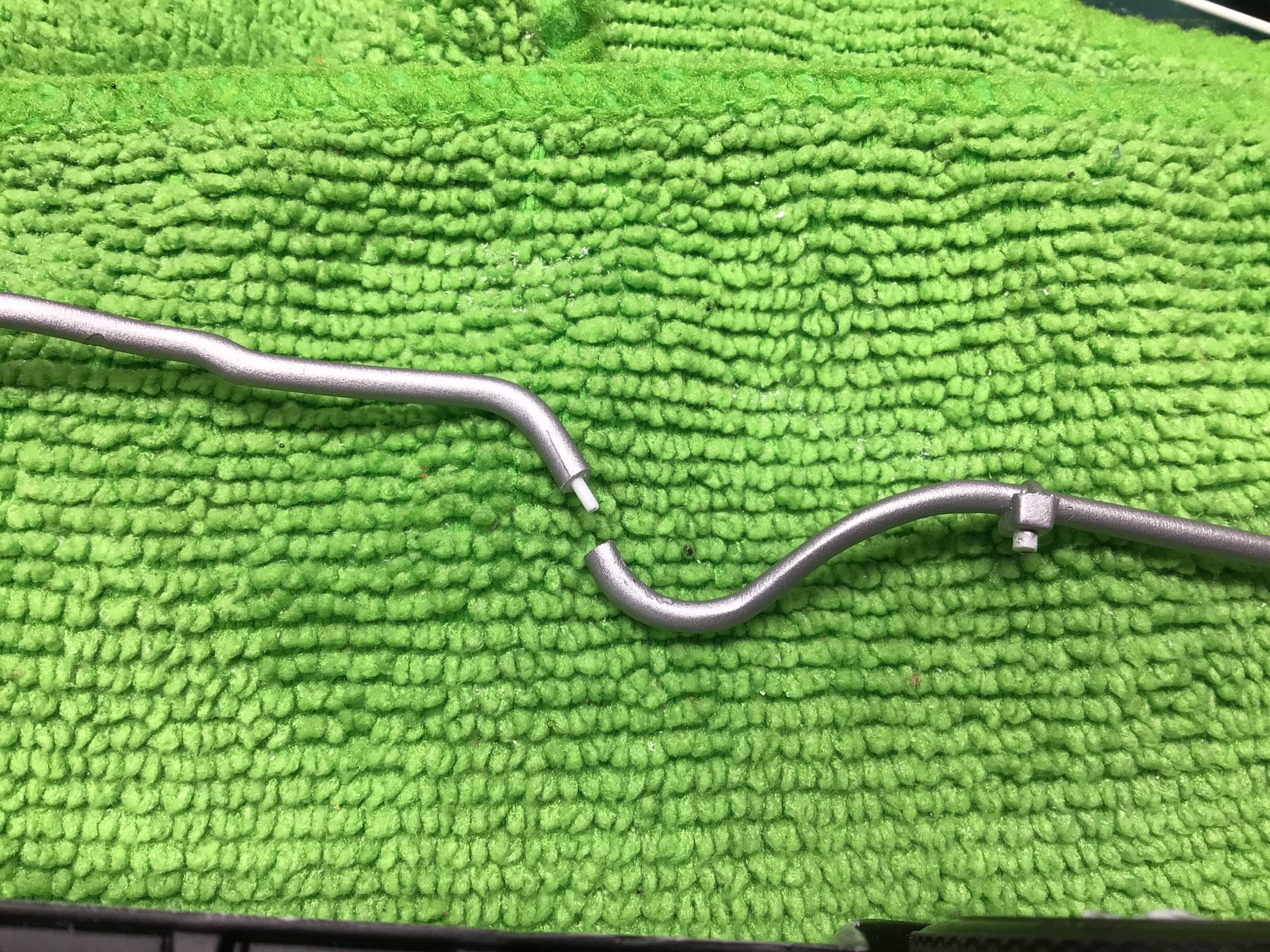

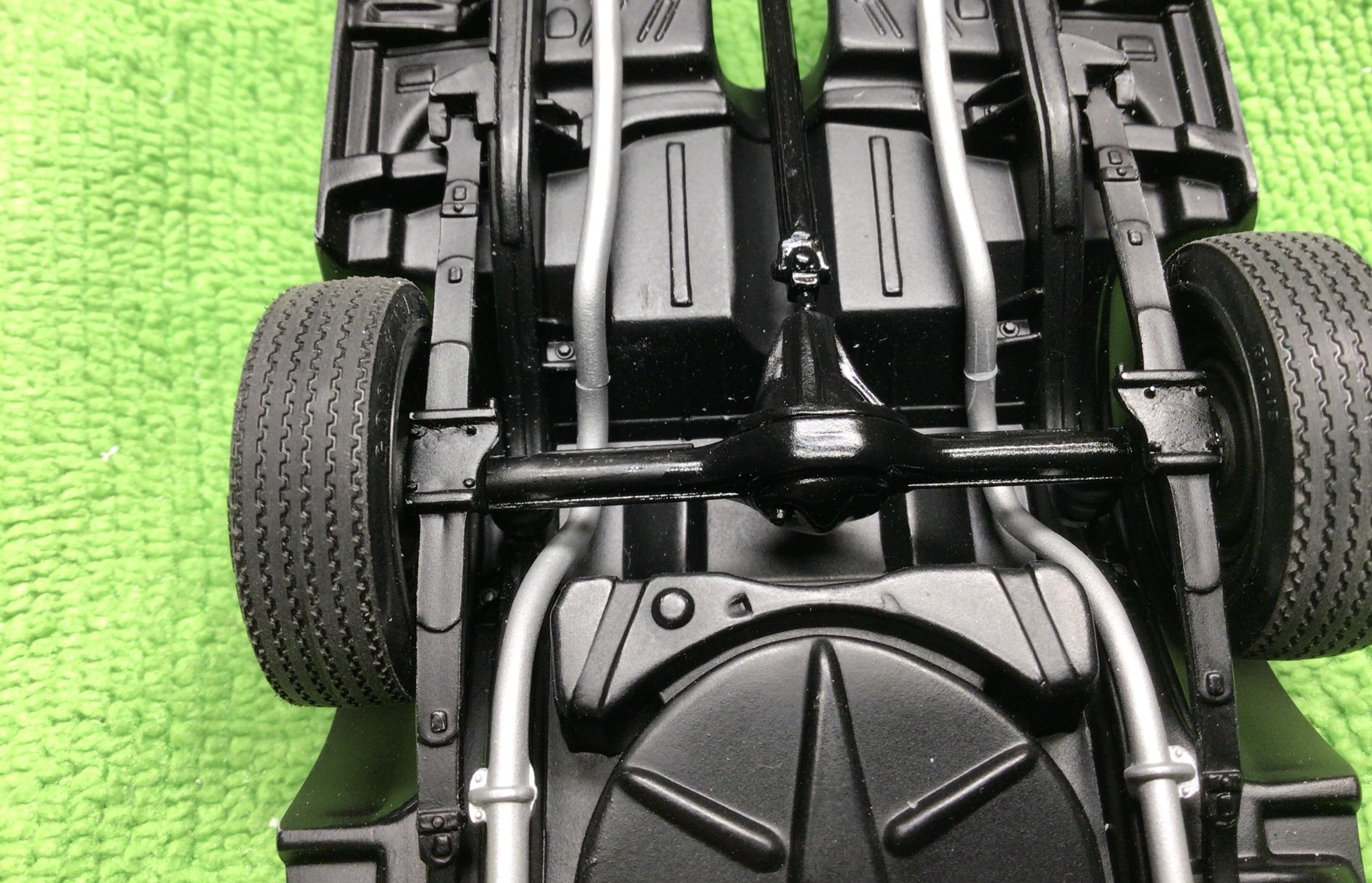

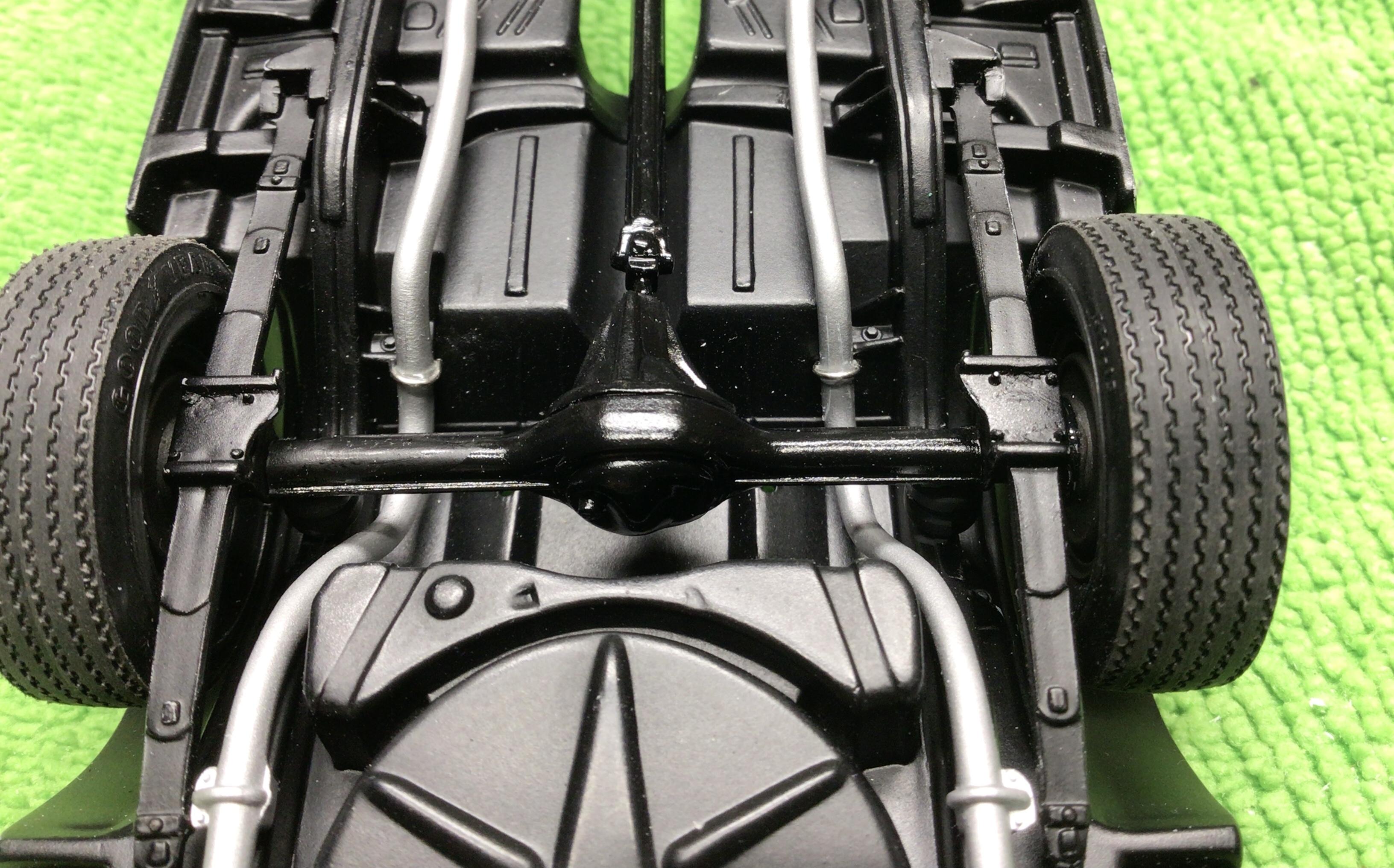

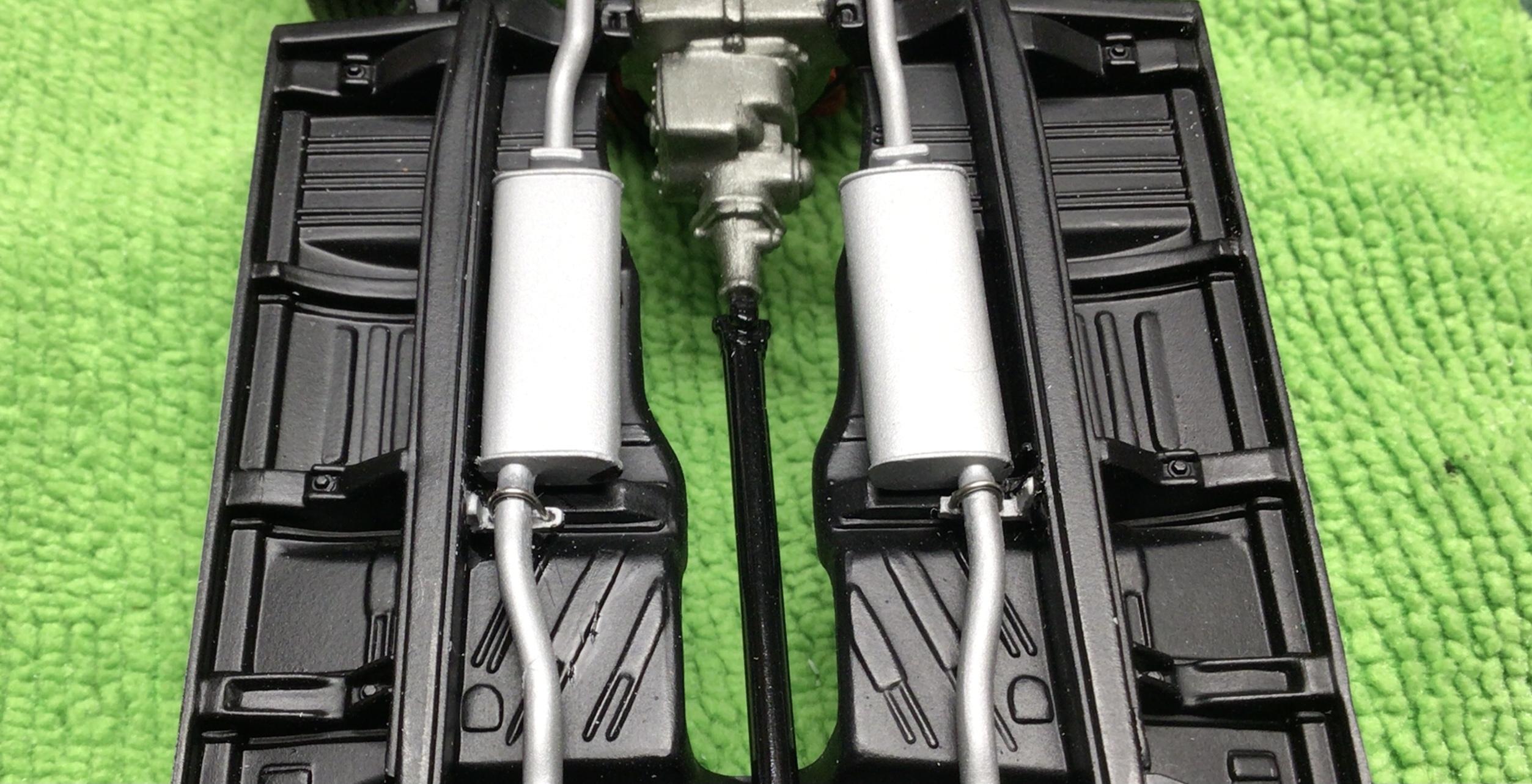

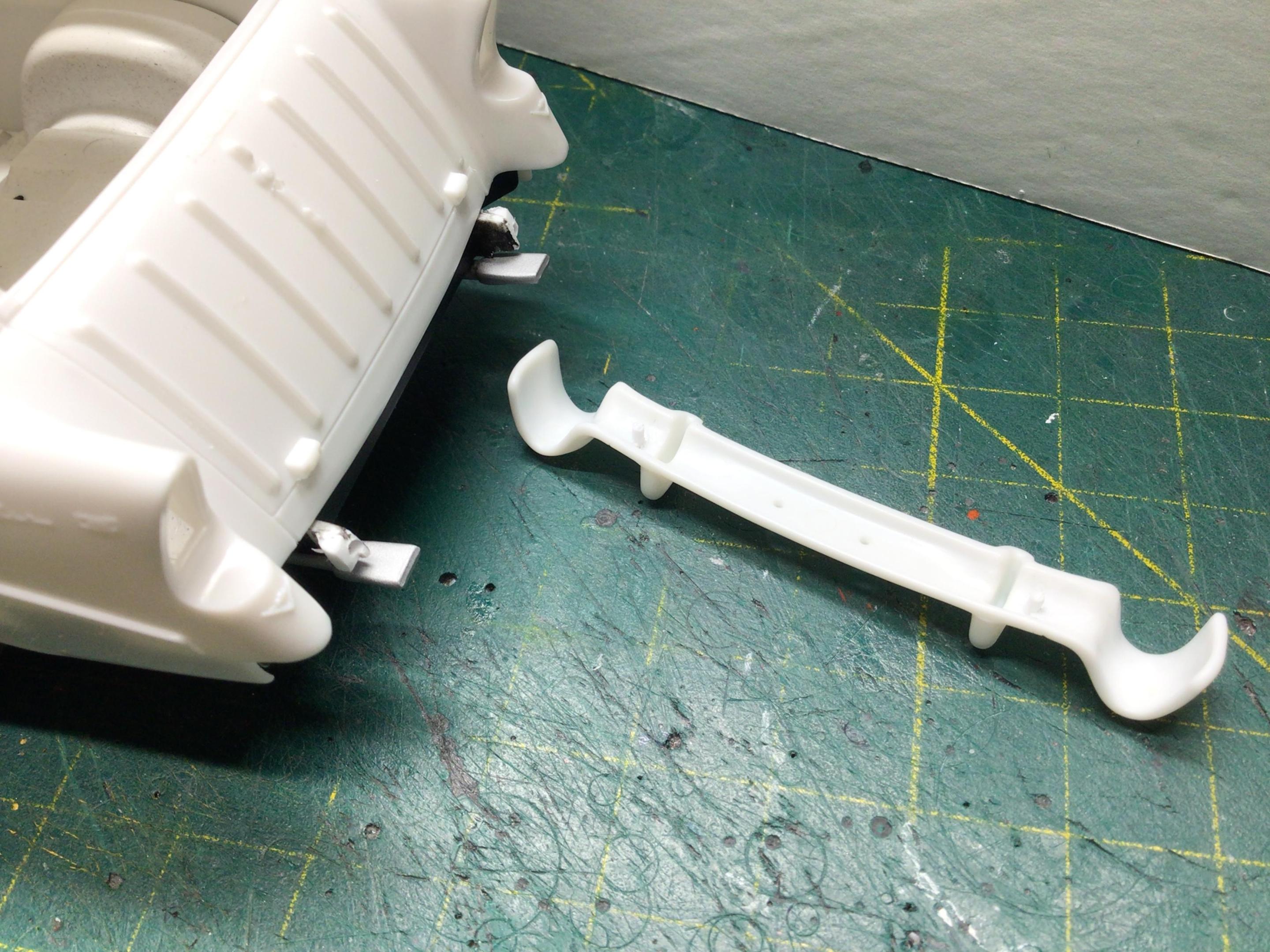

NOBLNG Posted November 9, 2023 Author Posted November 9, 2023 (edited) Typical me…getting ahead of myself.? I went and installed the rear suspension and then couldn’t get the exhaust system in place.? I pinned the splices and covered them with a couple of craft wire u-bolts. I’m not sure what these exhaust hangers are doing out in the middle of nowhere…just hangin’ out I guess?? So I made a couple that look like they might possibly hold something in place. I added some thickness to the rear frame horns and then drilled right through the bumper and installed some .050” styrene pins. It will be an easy install after I spray it and the other parts with the Revell chrome. Edited November 9, 2023 by NOBLNG 6

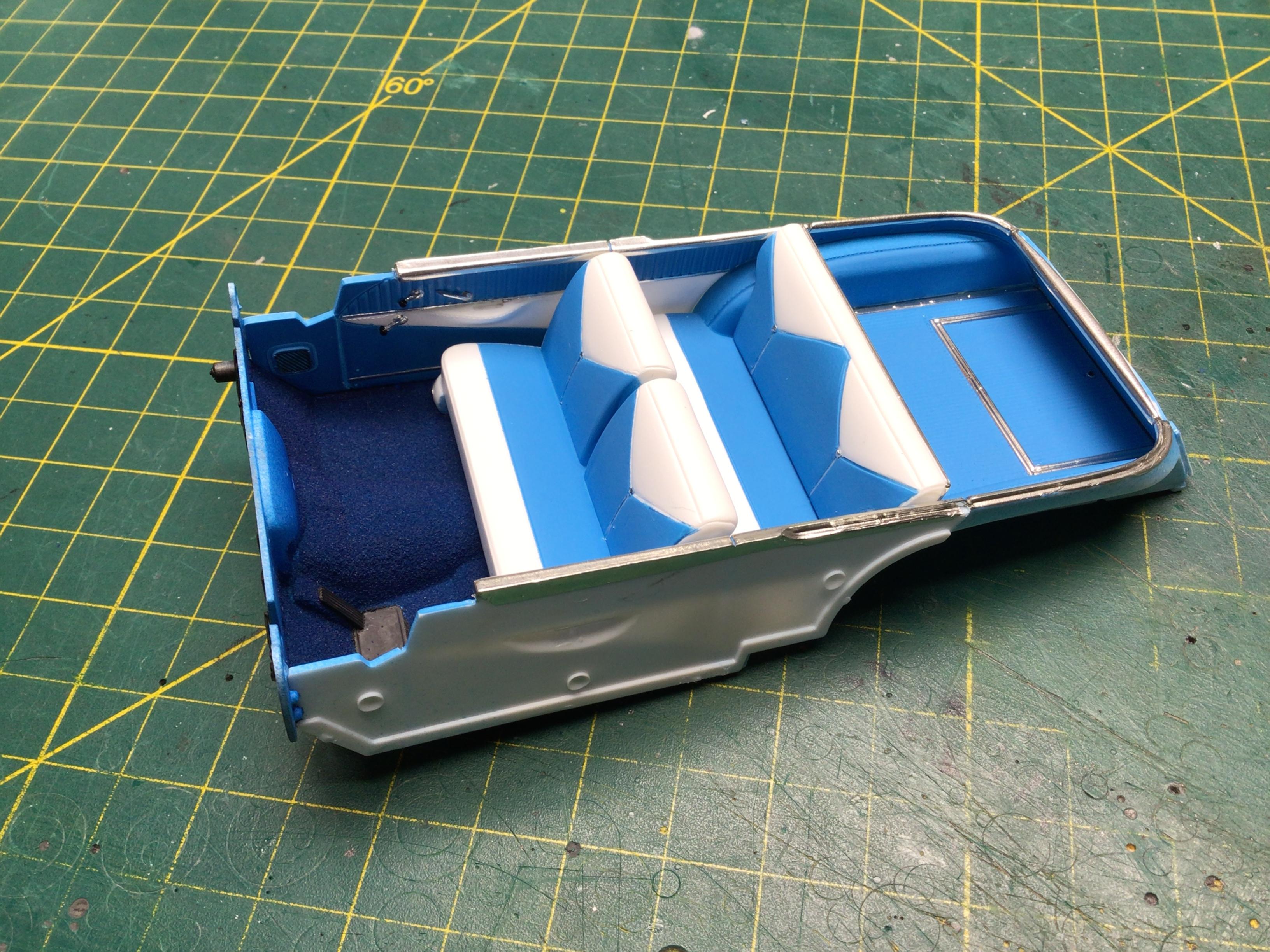

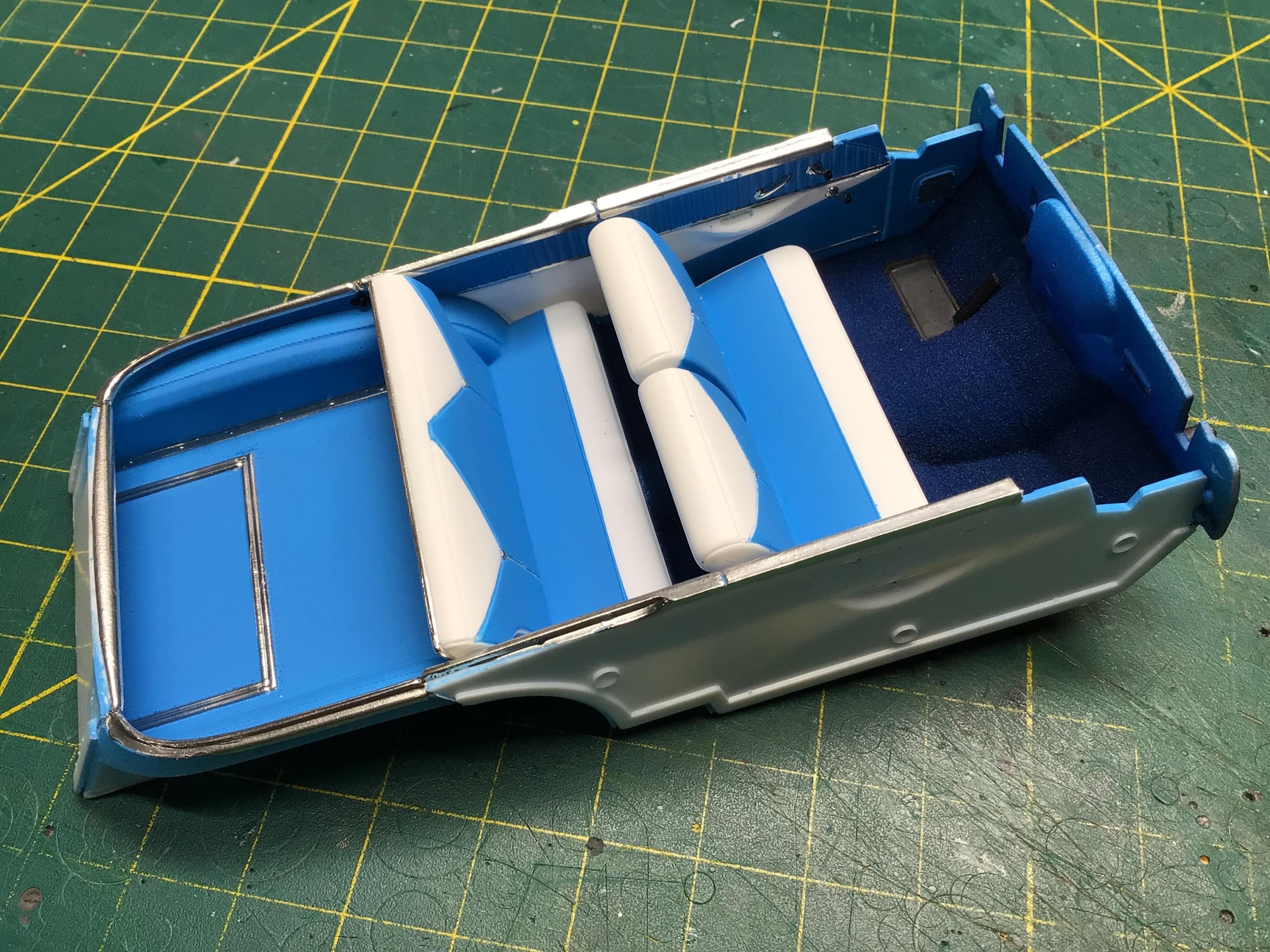

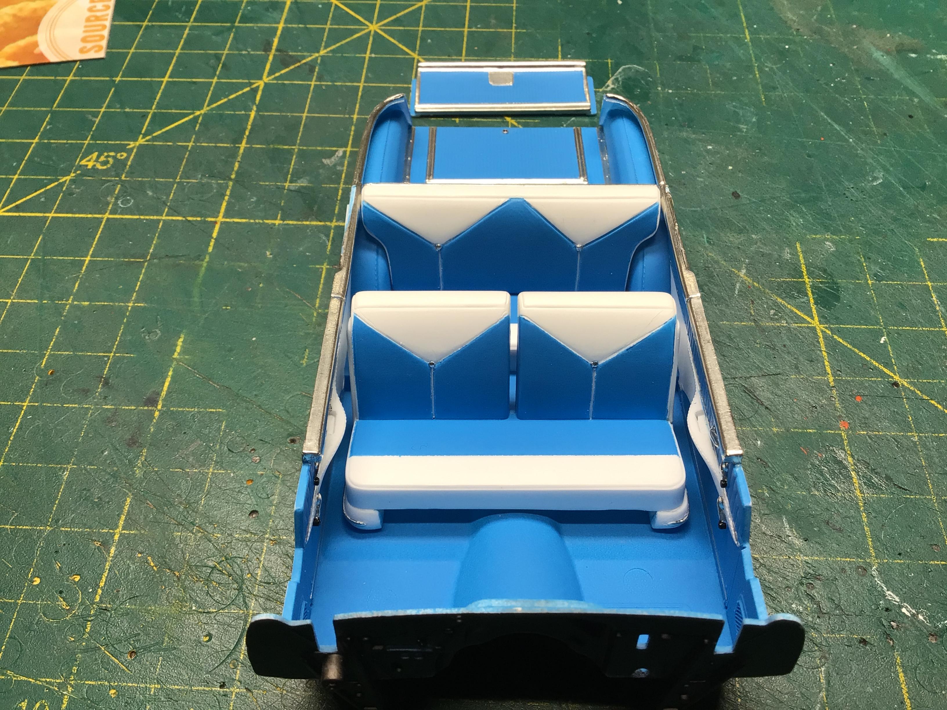

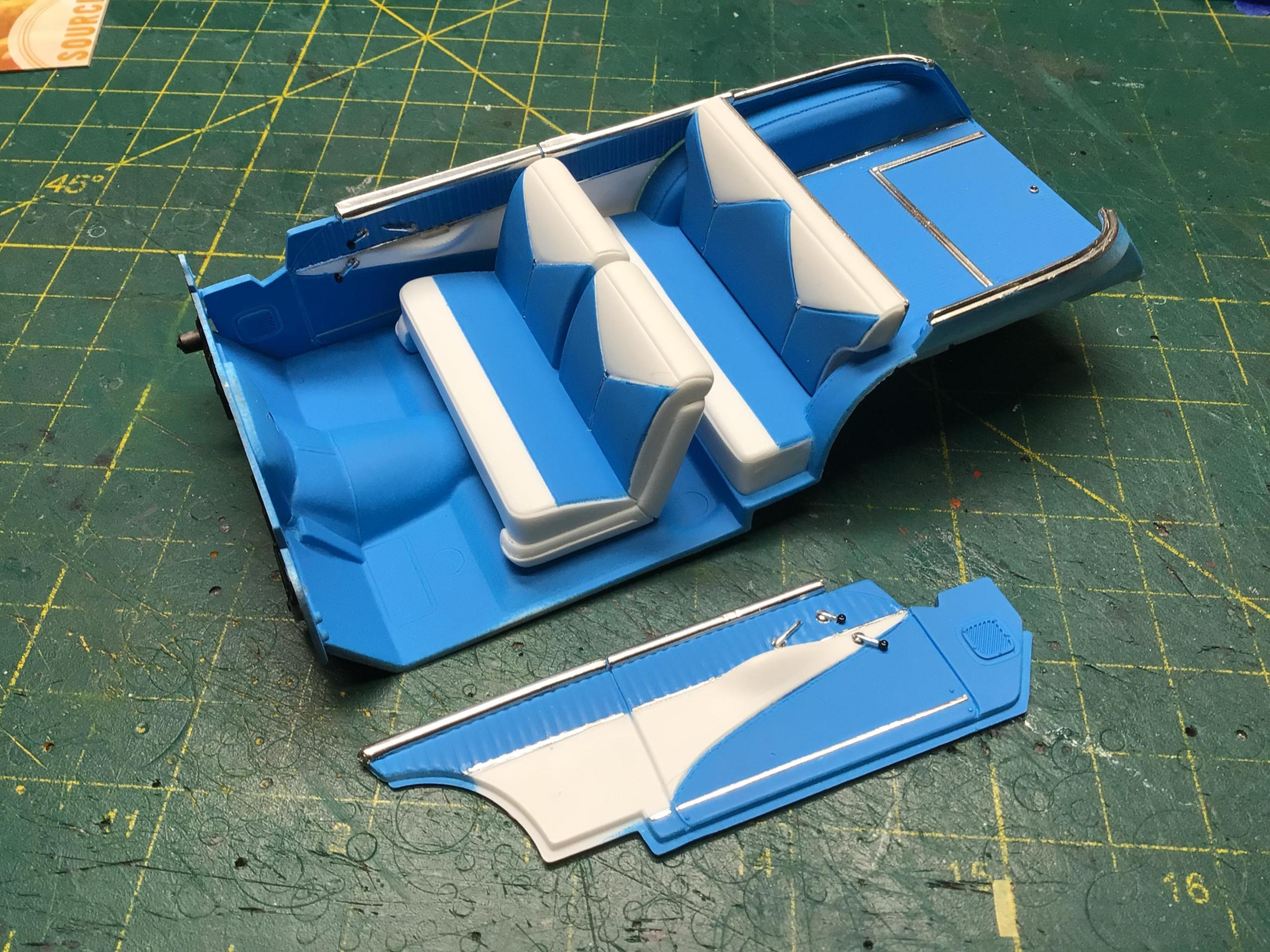

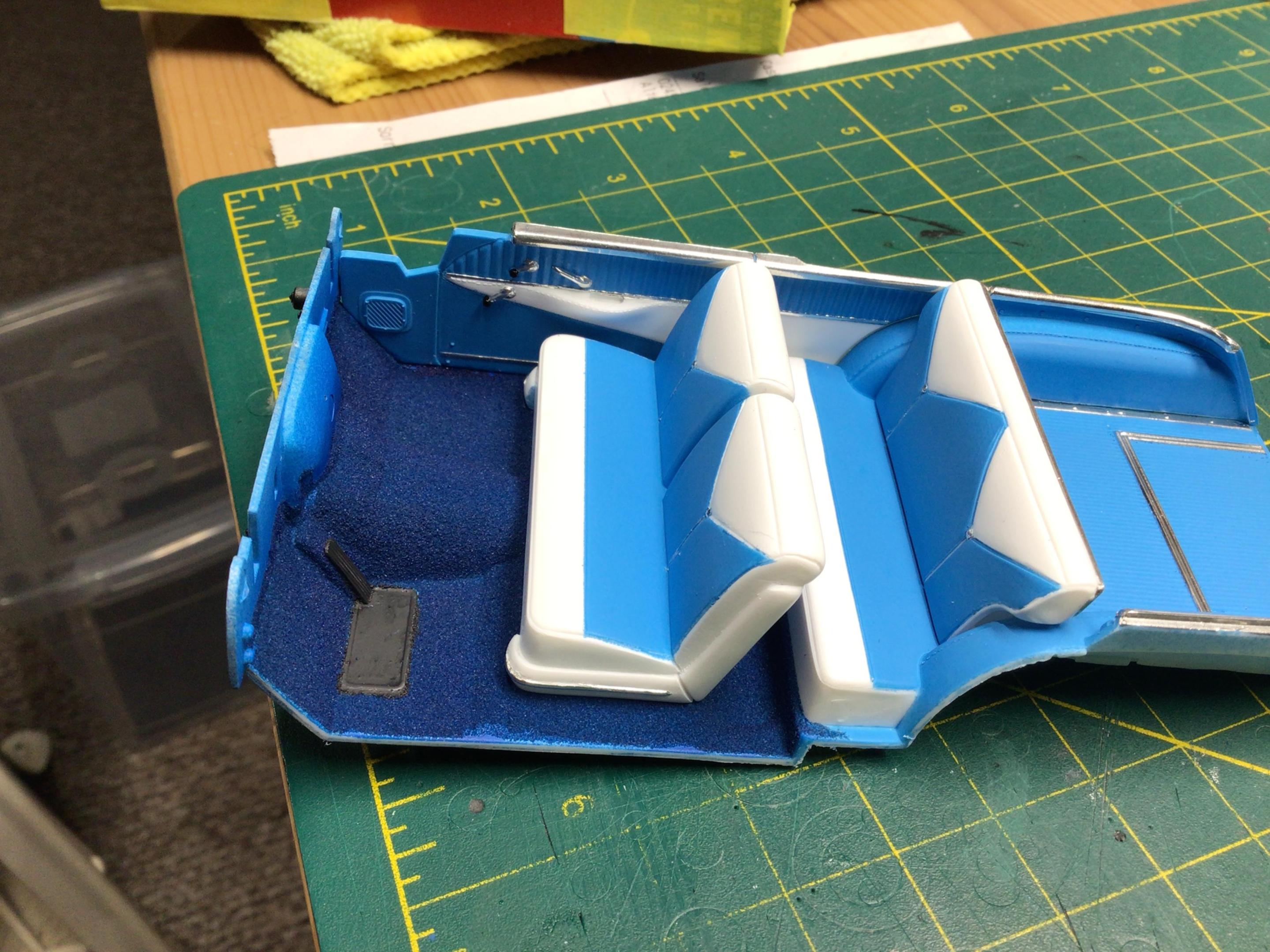

NOBLNG Posted November 10, 2023 Author Posted November 10, 2023 (edited) Got. Bit of work done on the interior. Ignore the ejection pin marks on the floor, I still have the carpet to do. Edit: Carpet is in.? Edited November 10, 2023 by NOBLNG 5

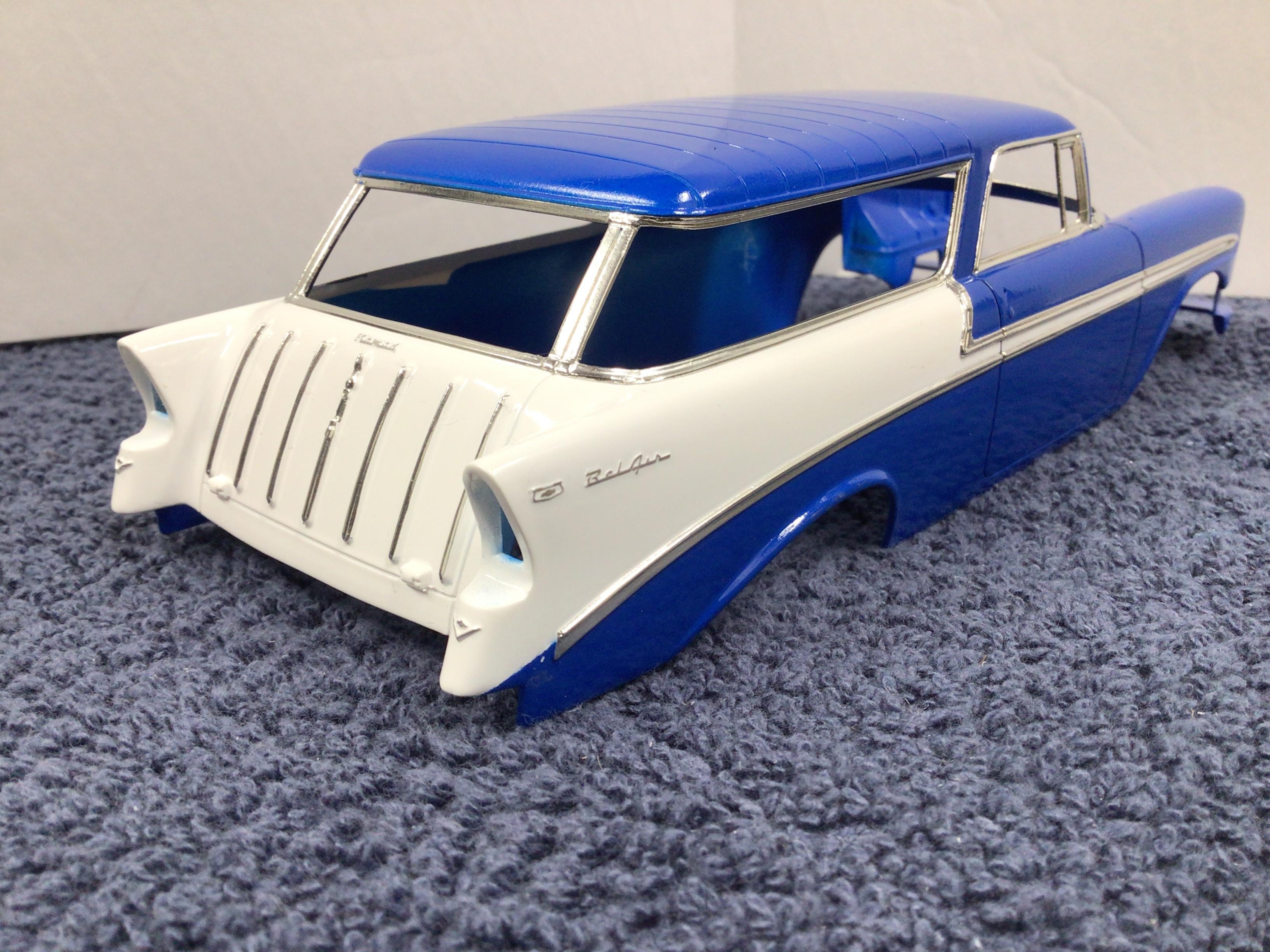

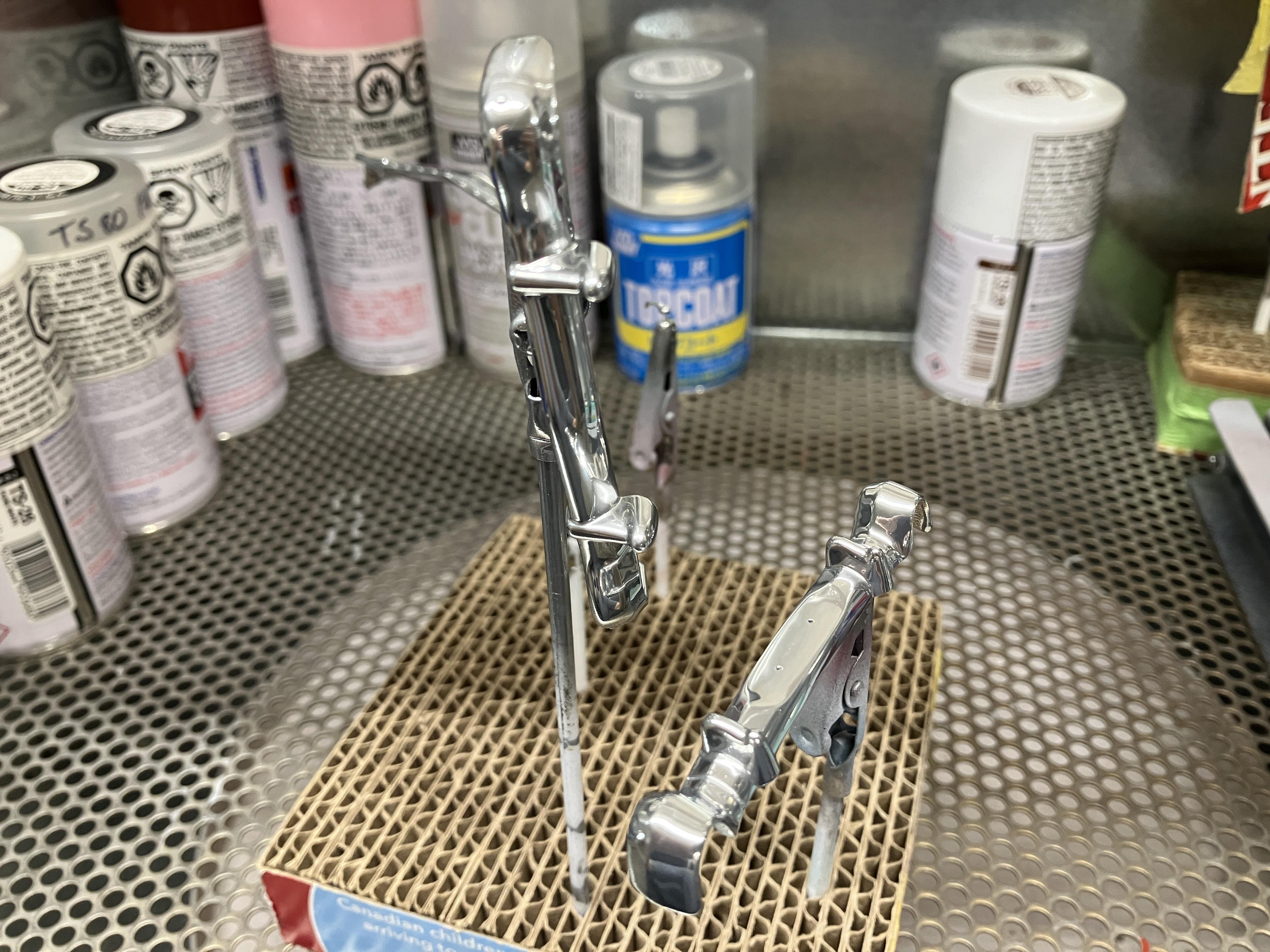

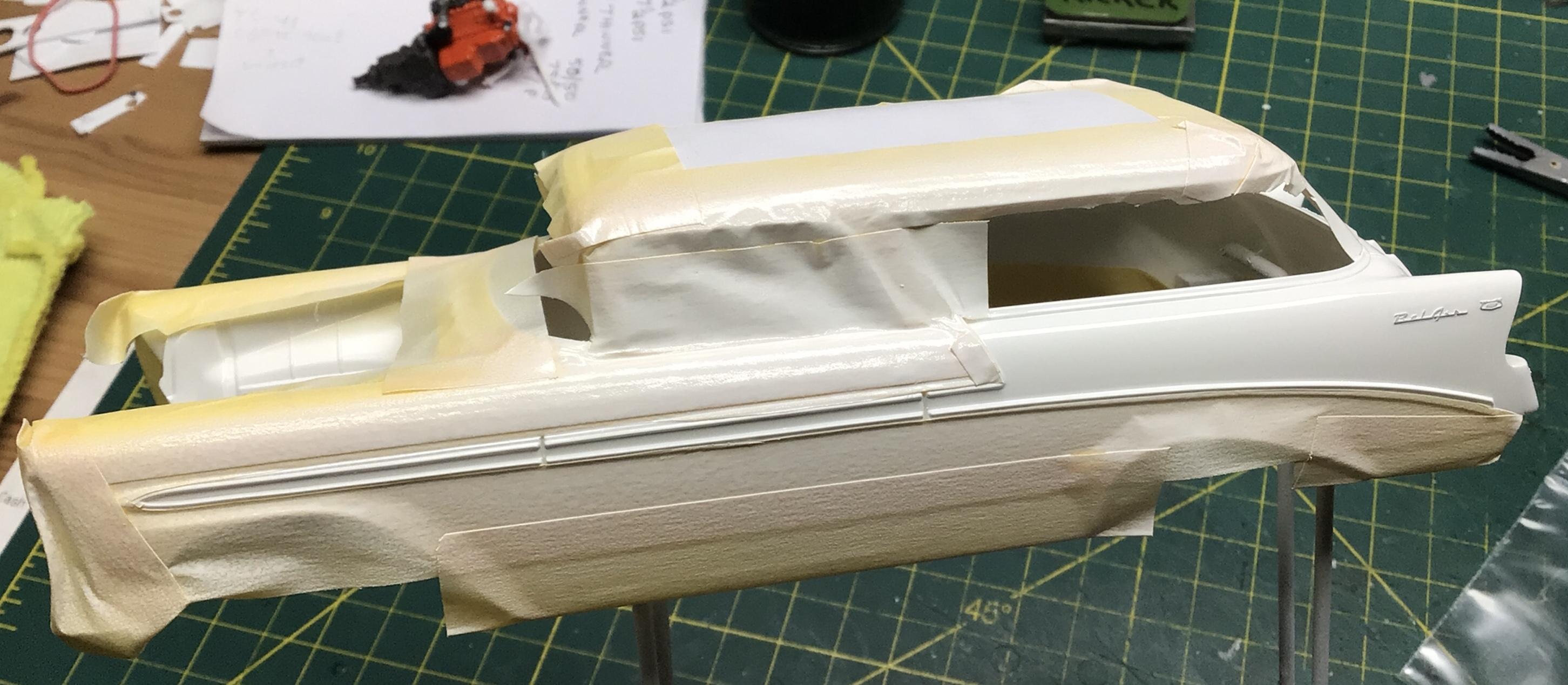

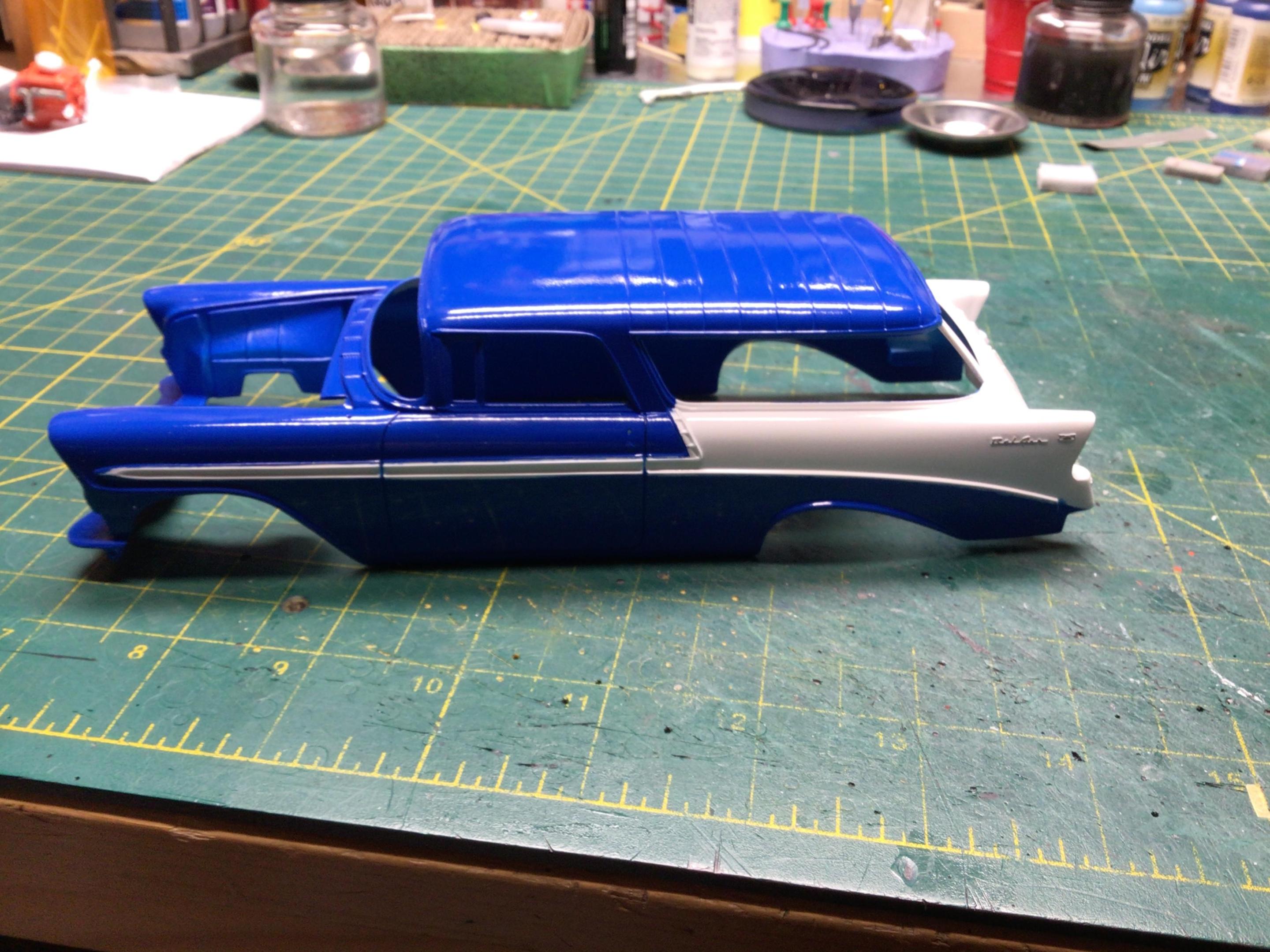

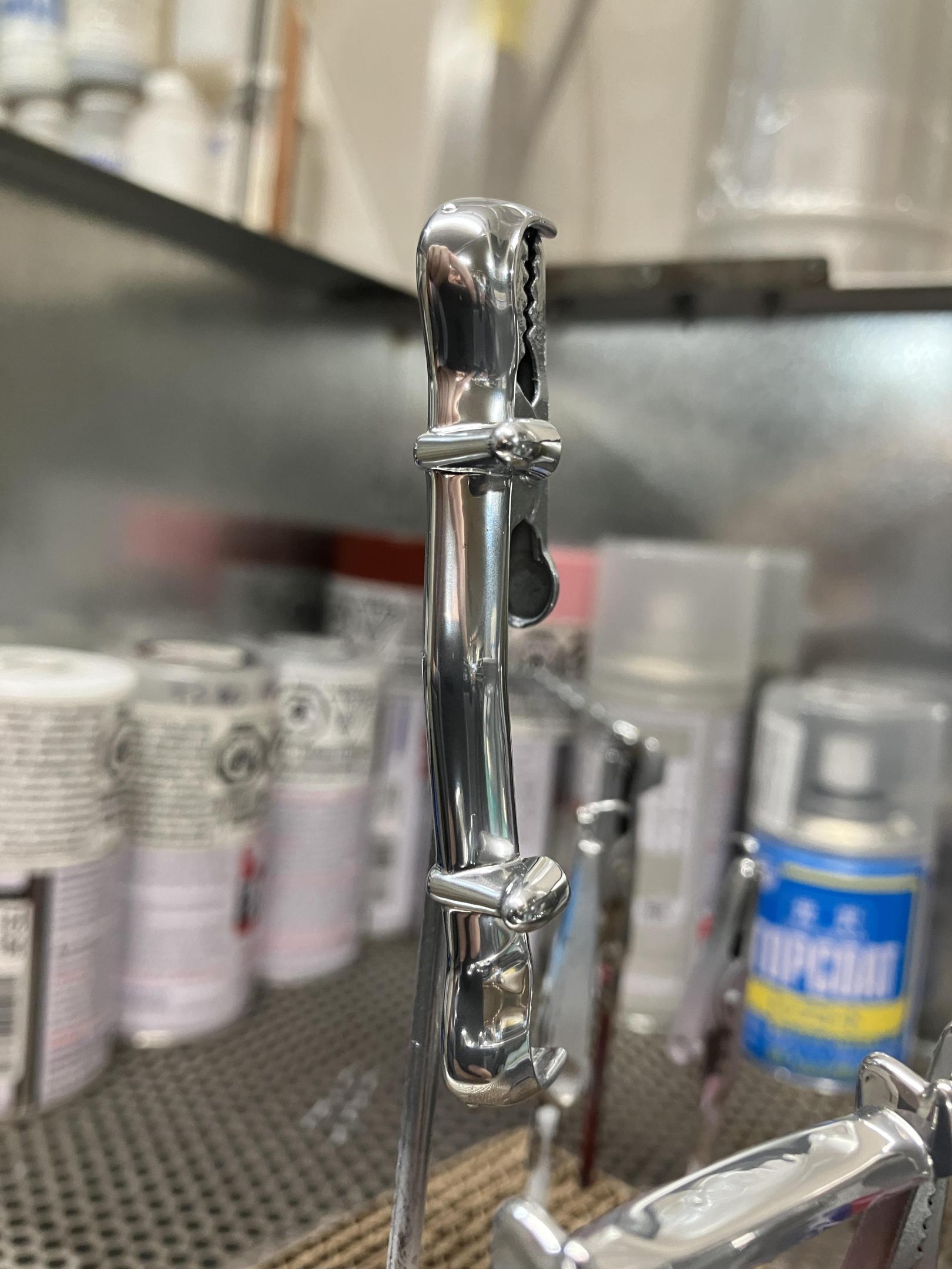

NOBLNG Posted November 10, 2023 Author Posted November 10, 2023 (edited) I foiled the script and got the Tamiya Pure White sprayed on the back half. I sprayed some Revell chrome into a plastic shot glass and used a pipette to transfer it to the airbrush cup. It sprays beautifully through the airbrush!? It is extremely thin stuff though and will drip right out of the pipette if you’re not quick about it.? Edited November 10, 2023 by NOBLNG 4

James2 Posted November 11, 2023 Posted November 11, 2023 Nicely done interior and the bumpers look pretty darn good too....
slusher Posted November 11, 2023 Posted November 11, 2023 Super nice interior and great looking engine and chassis!
espo Posted November 11, 2023 Posted November 11, 2023 Like the sharp lines between the colors on the interior and the flocking looks great. Those bumpers have me thinking I'll have to break down and get some of the Revell spray chrome paint.

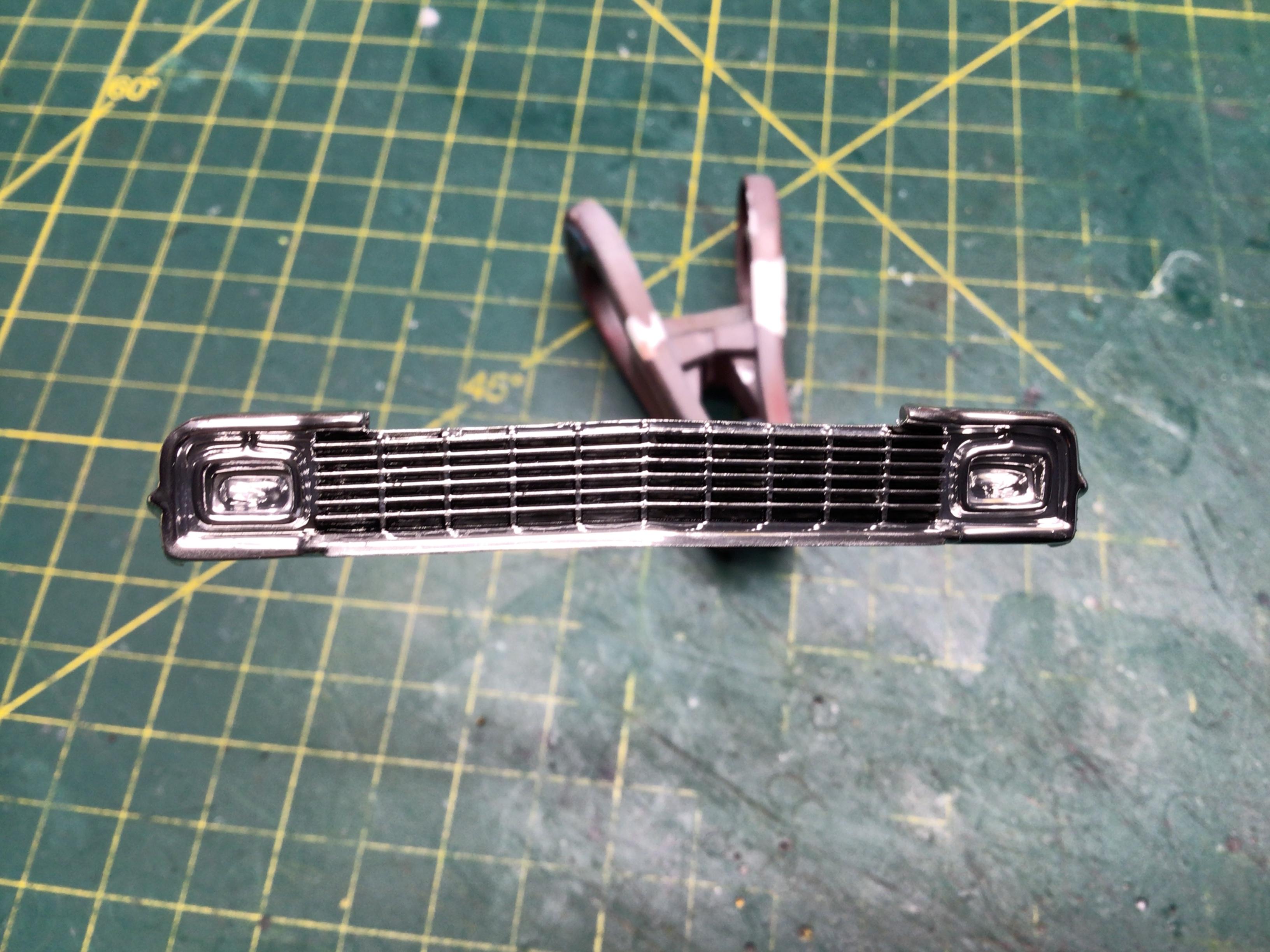

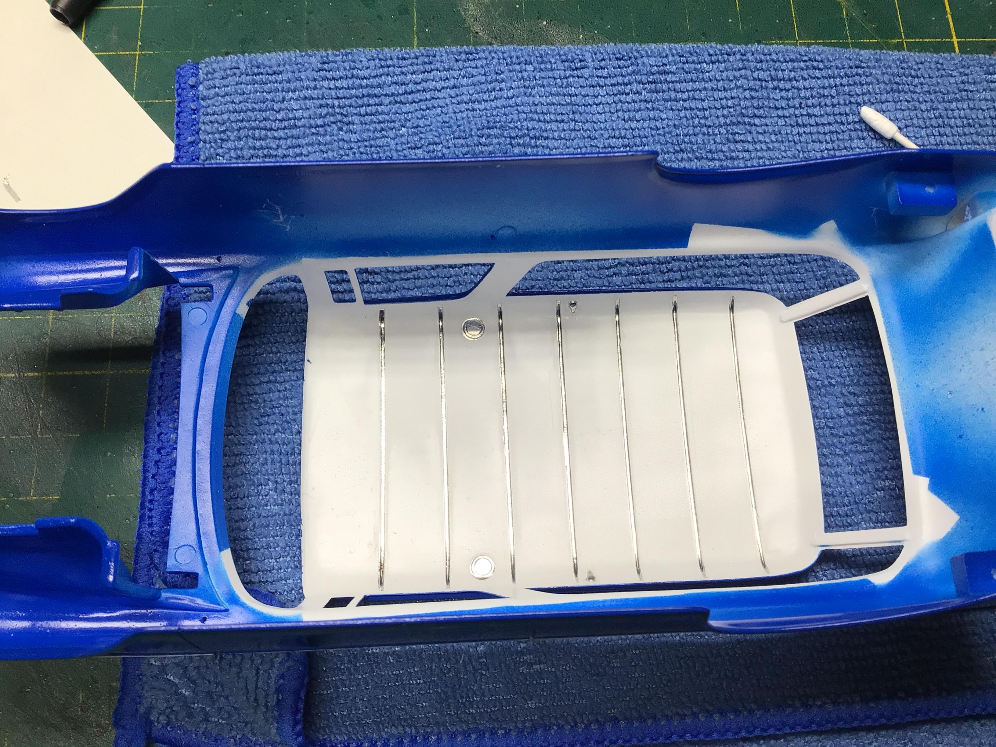

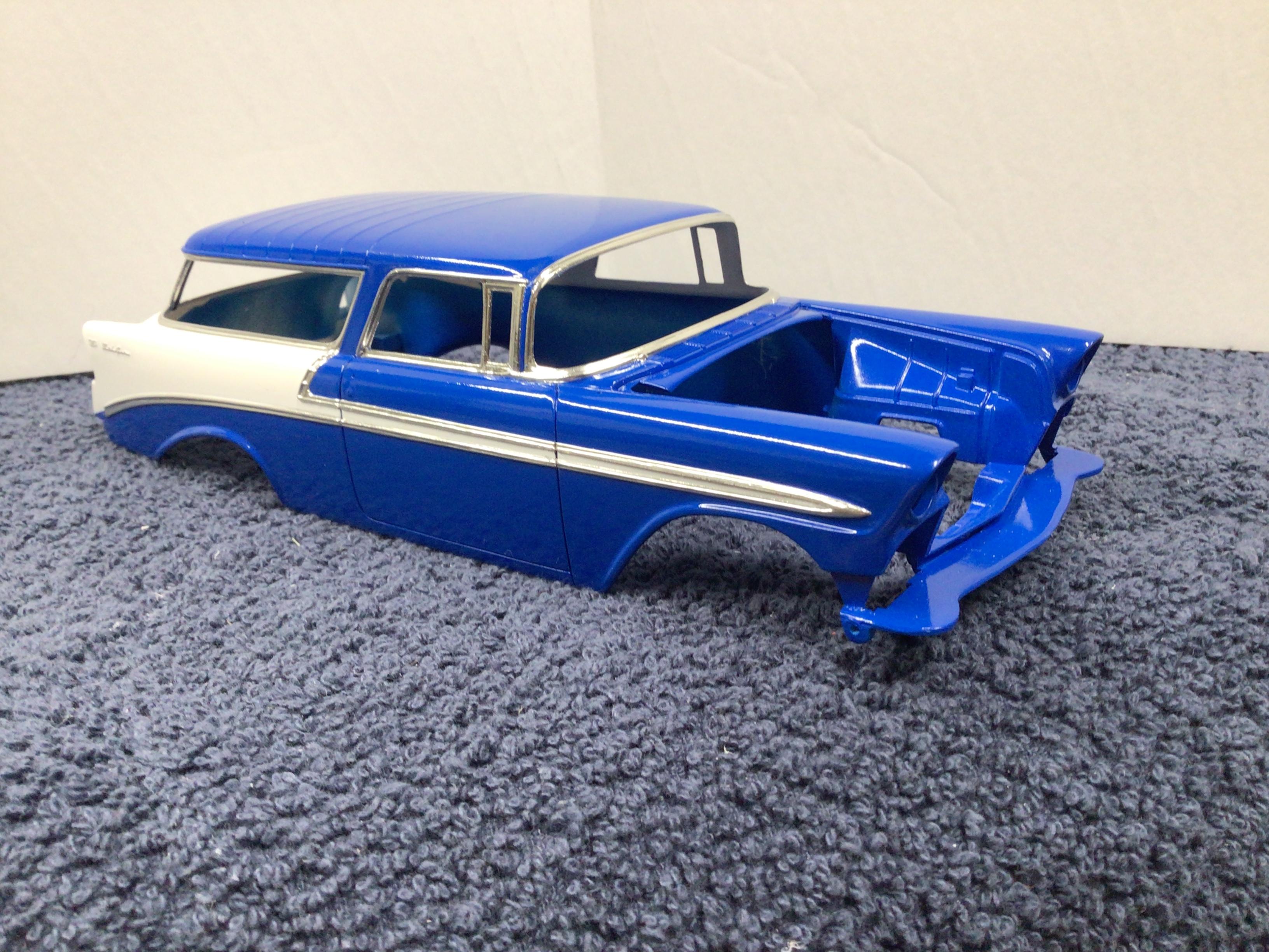

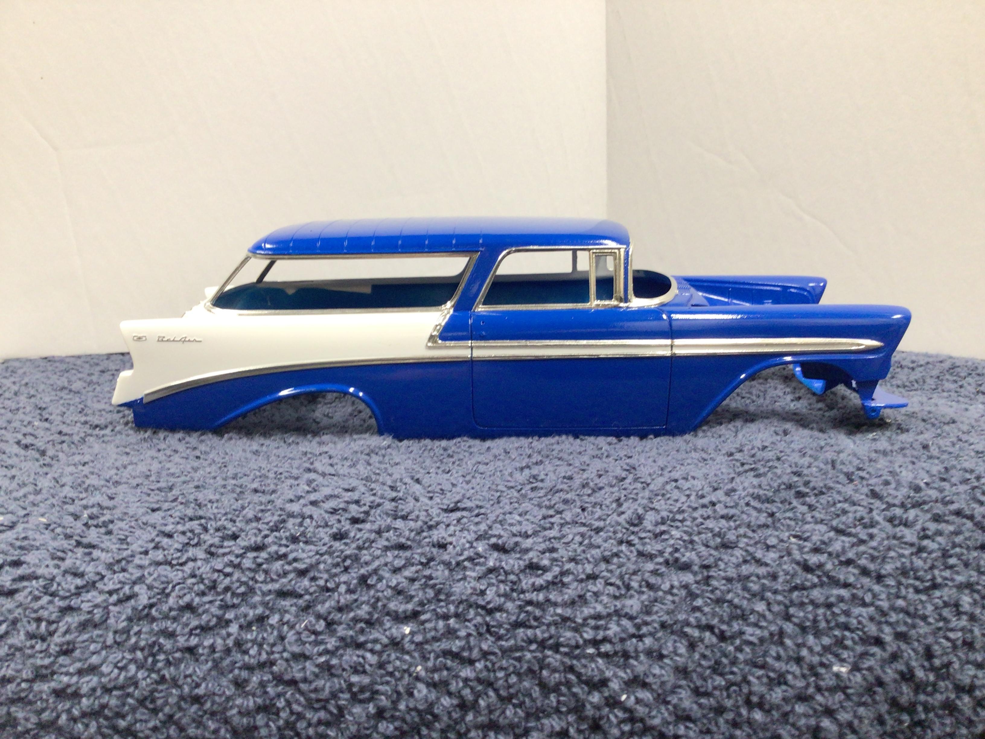

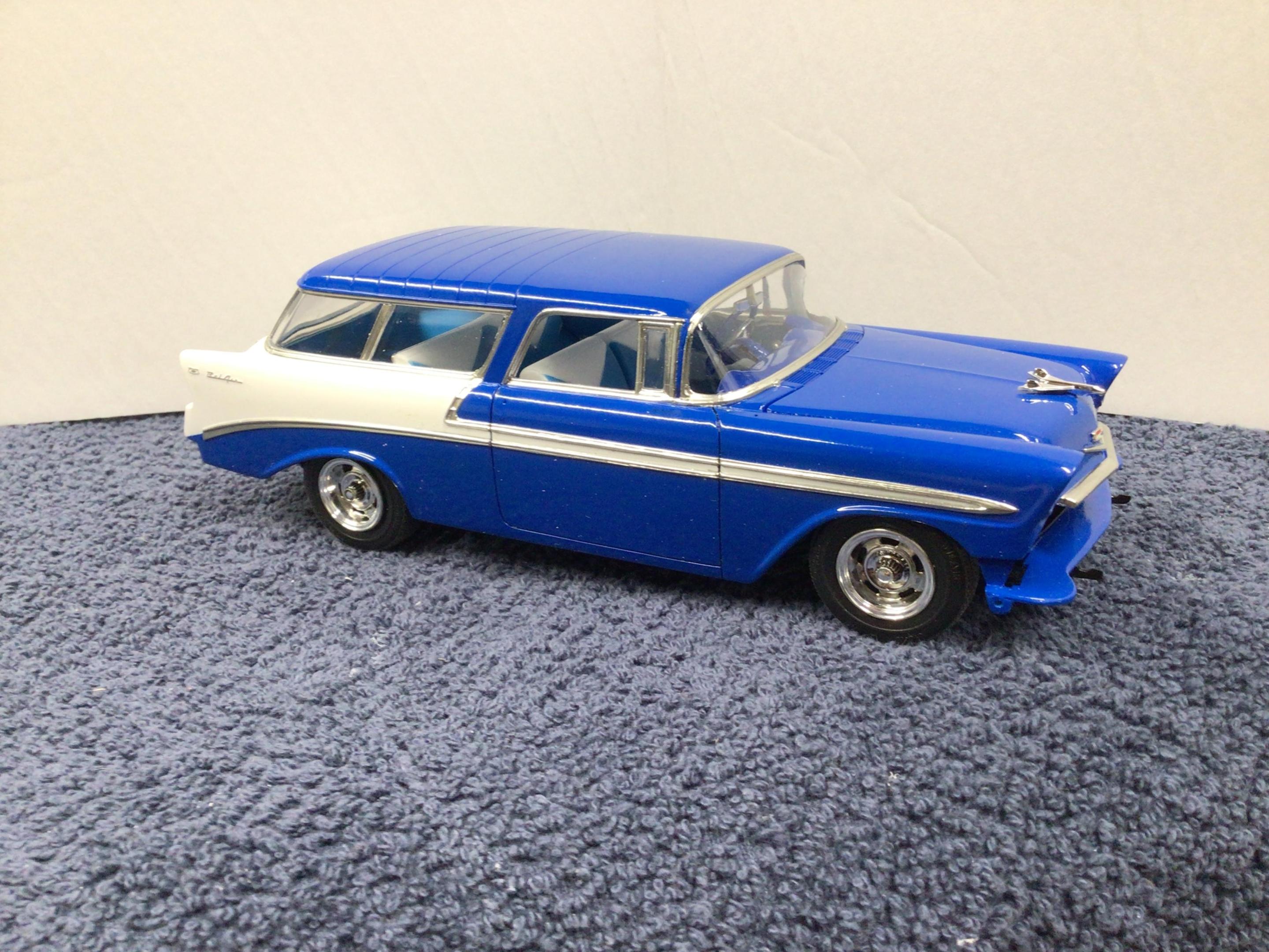

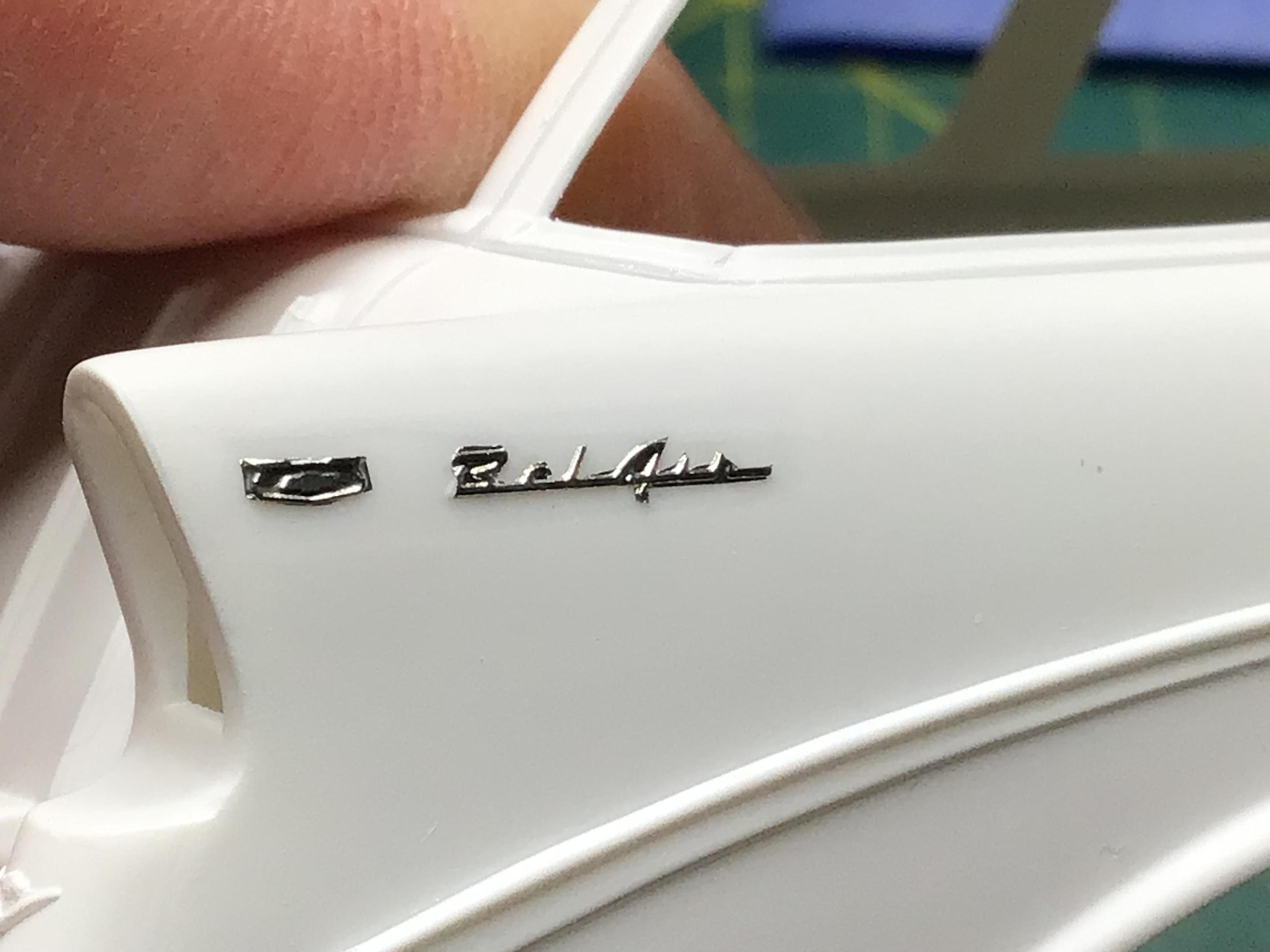

NOBLNG Posted November 14, 2023 Author Posted November 14, 2023 (edited) I managed to get the grill detailed, the body painted, and the foil work done. This thing is harder to foil than the ‘59 Caddy!? Edited November 14, 2023 by NOBLNG 2

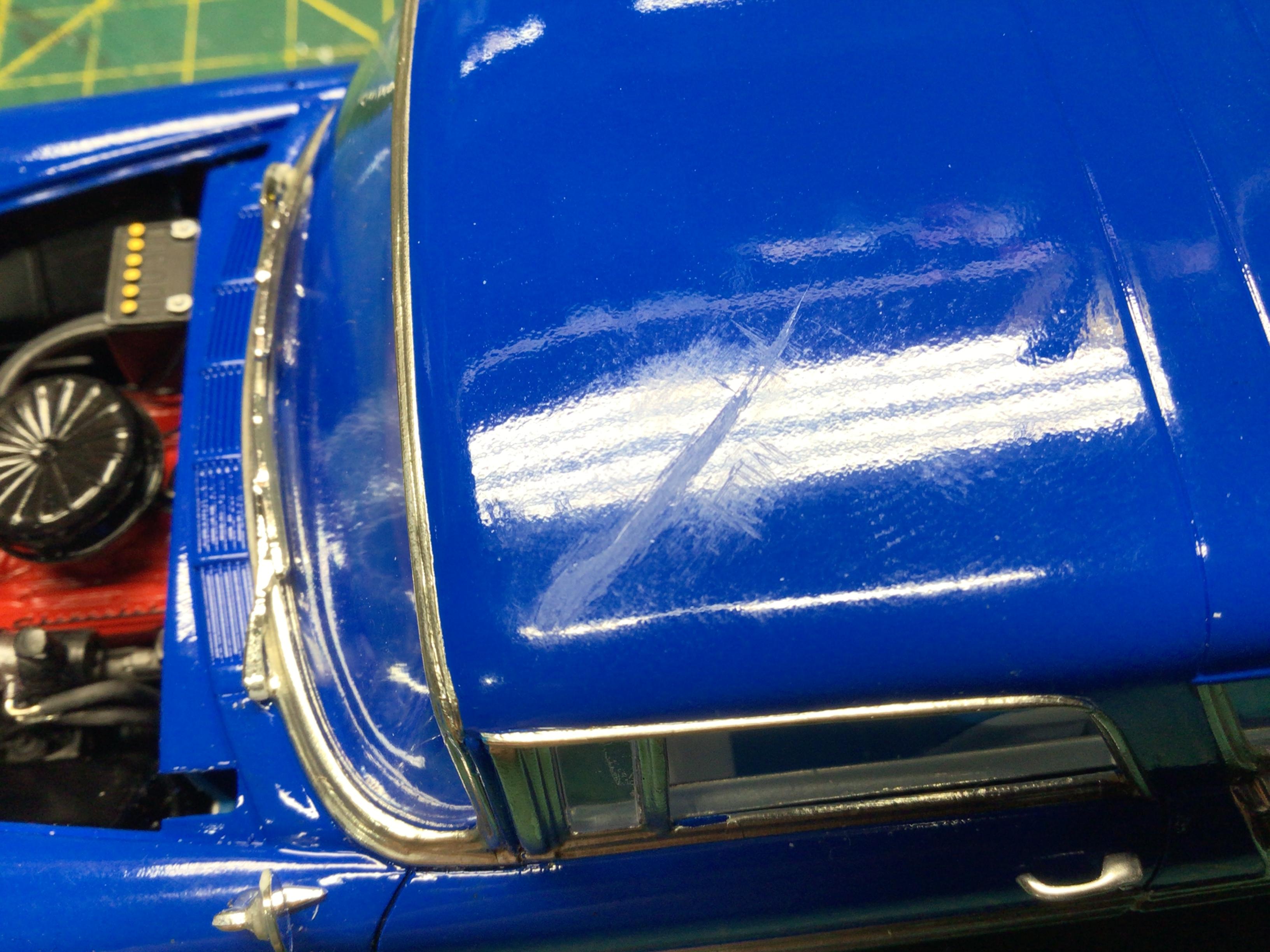

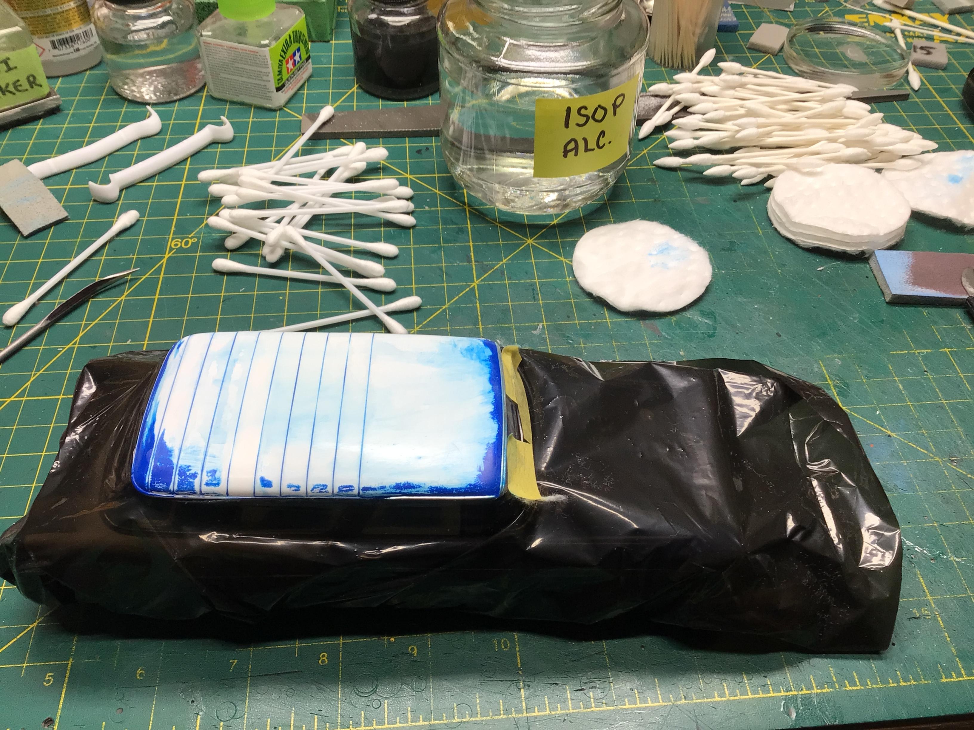

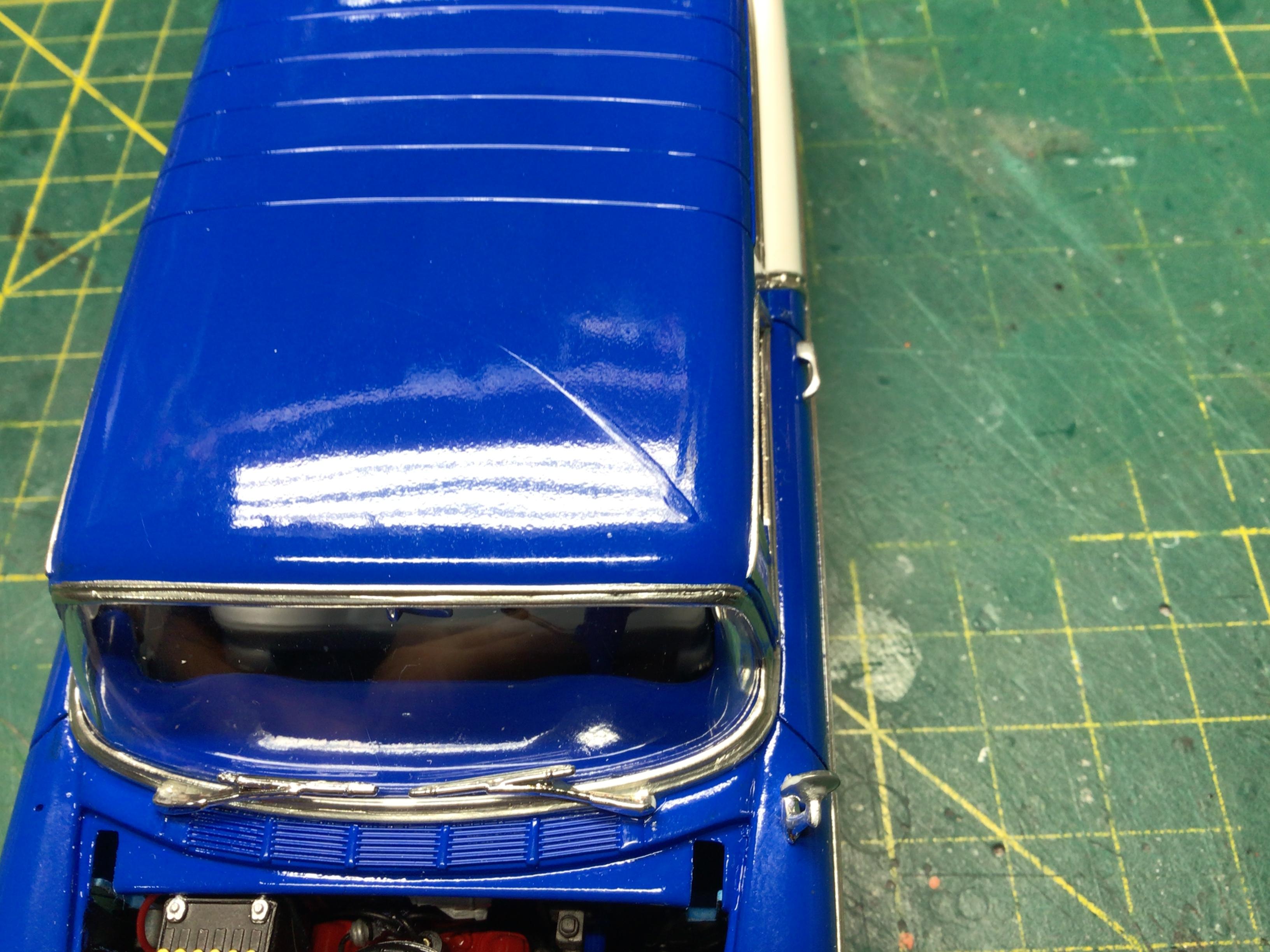

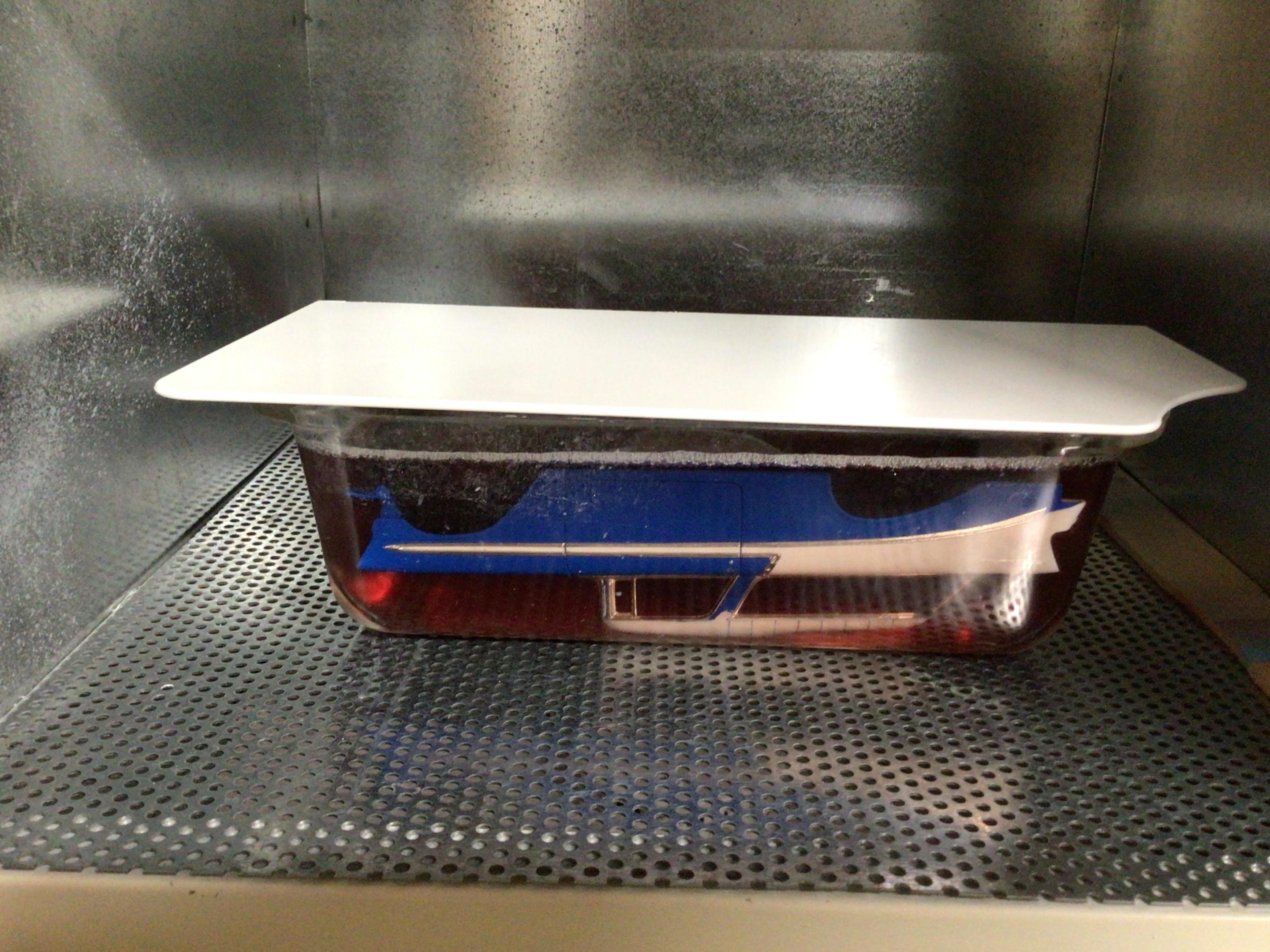

NOBLNG Posted November 17, 2023 Author Posted November 17, 2023 Two steps forward…six steps back.? I only had the antenna left to install when I dripped some CA on the roof. I tried filing and sanding it off and went through the paint.? I had given the entire thing a coat of Revell acrylic gloss, so no chance of just spraying another coat of Tamiya lacquer. So I tried stripping just the roof.? Eventually I decided to strip the whole thing.? 4
redscampi Posted November 18, 2023 Posted November 18, 2023 Man I would have added some rust and weathering and sent it! Too bad, it was beautiful! May be the second time is a charm?
Steve H Posted November 20, 2023 Posted November 20, 2023 Dang it !!! That sucks about the paint Greg, especially after foil… This is another fantastic looking build. I think the rallye wheels are a perfect choice on this, they look great. As always you have addressed many “little” issues that combine into a beautiful looking model. What colour of blue did you use on the interior, it’s gorgeous! Cheers, Steve
