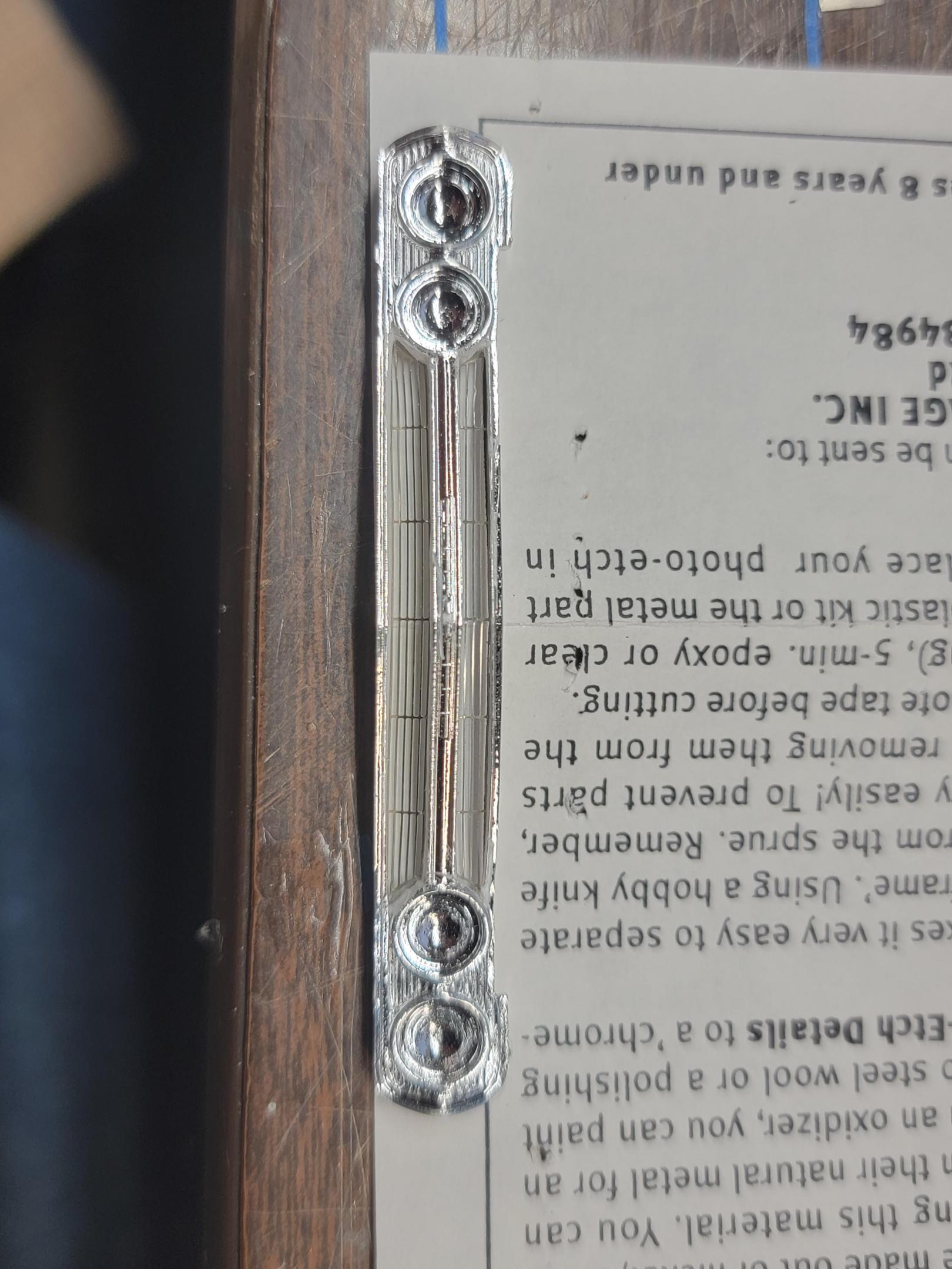

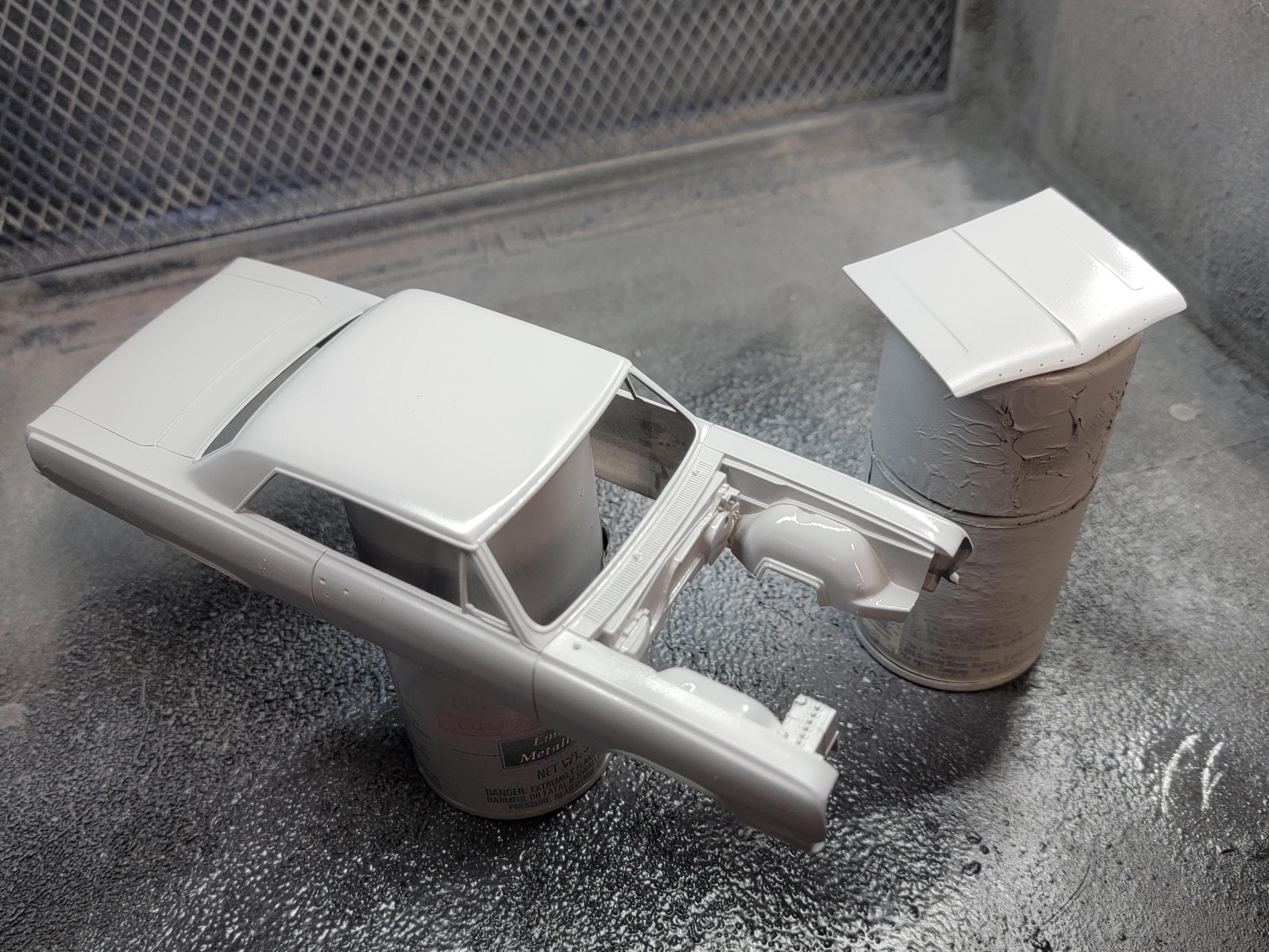

Now that my Miss Deal Studebaker is done (Under Glass Drag section) I am building this for a FB build-off. I am using the PE set from Model Car Garage. The grill was a pain to do but once I molotow and black wash it I think it will look fine.

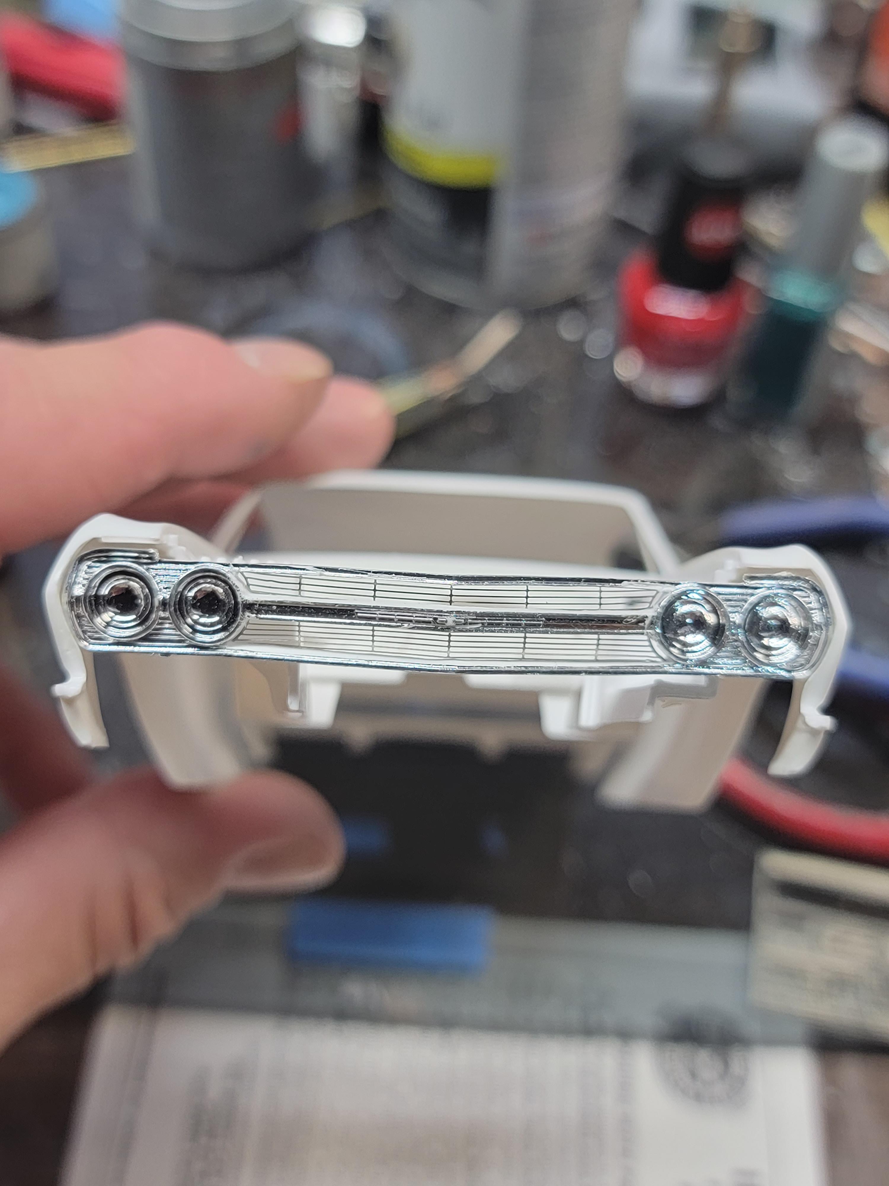

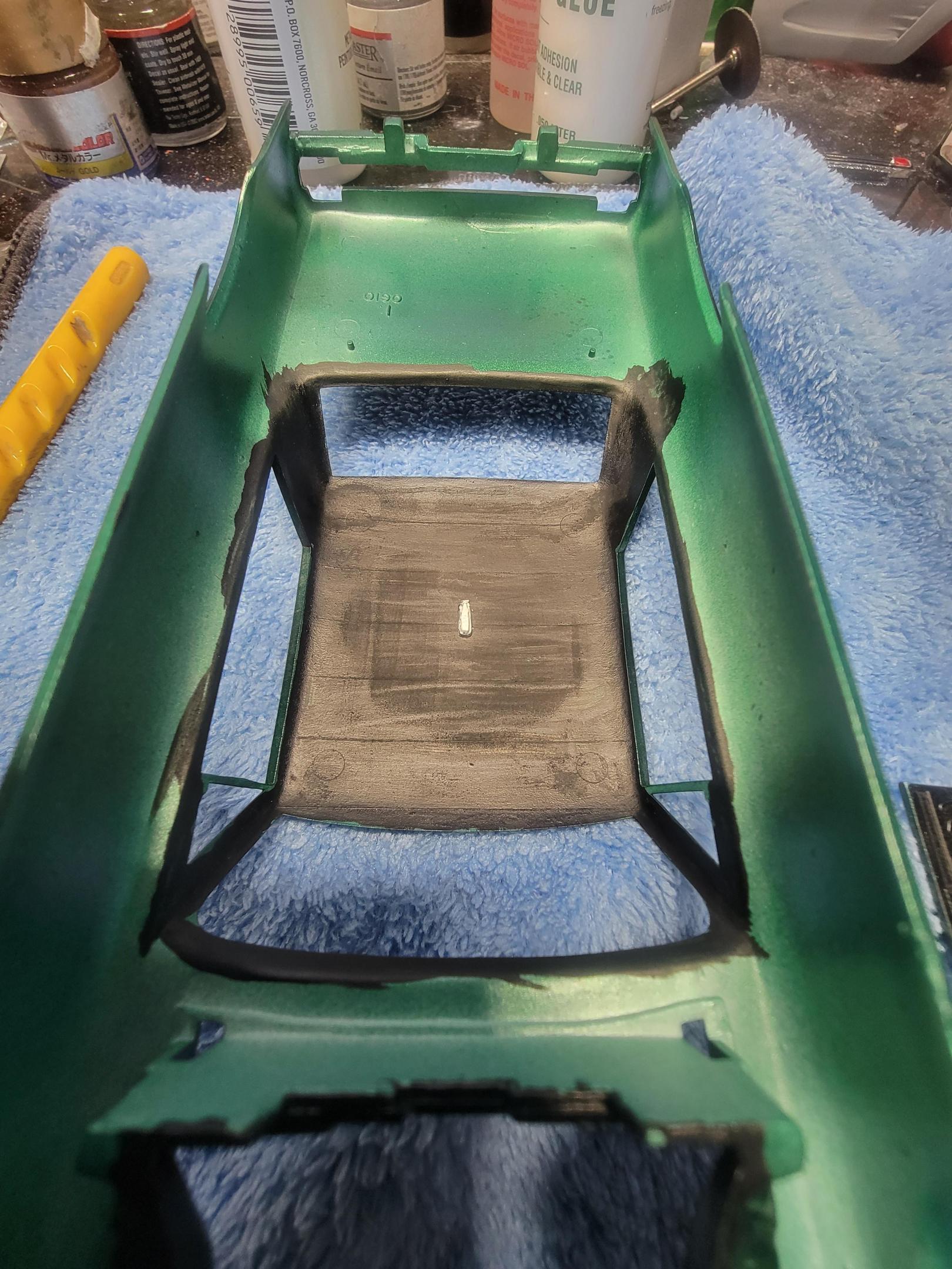

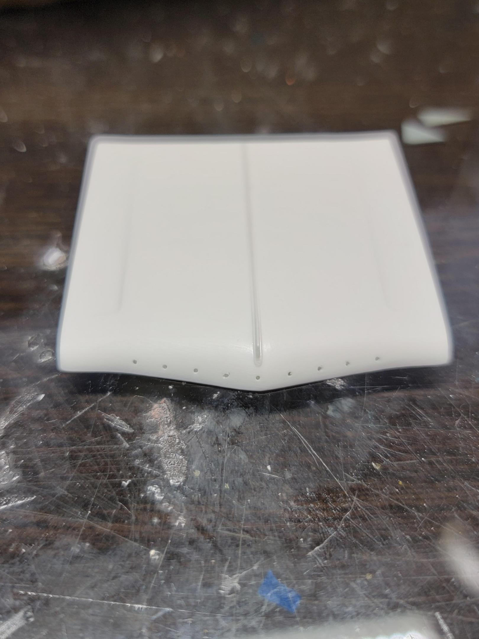

I drilled small holes where each PE piece will go to help locate them and then sanded the emblems off.20231113_115550.thumb.jpg.78e3e11fa4c3566fc13e03b996560326.jpg
20231113_105922.thumb.jpg.98bebe621d4ad4df2551503f88d3e7f2.jpg I don't believe the holes will be able to be seen after paint and PE.

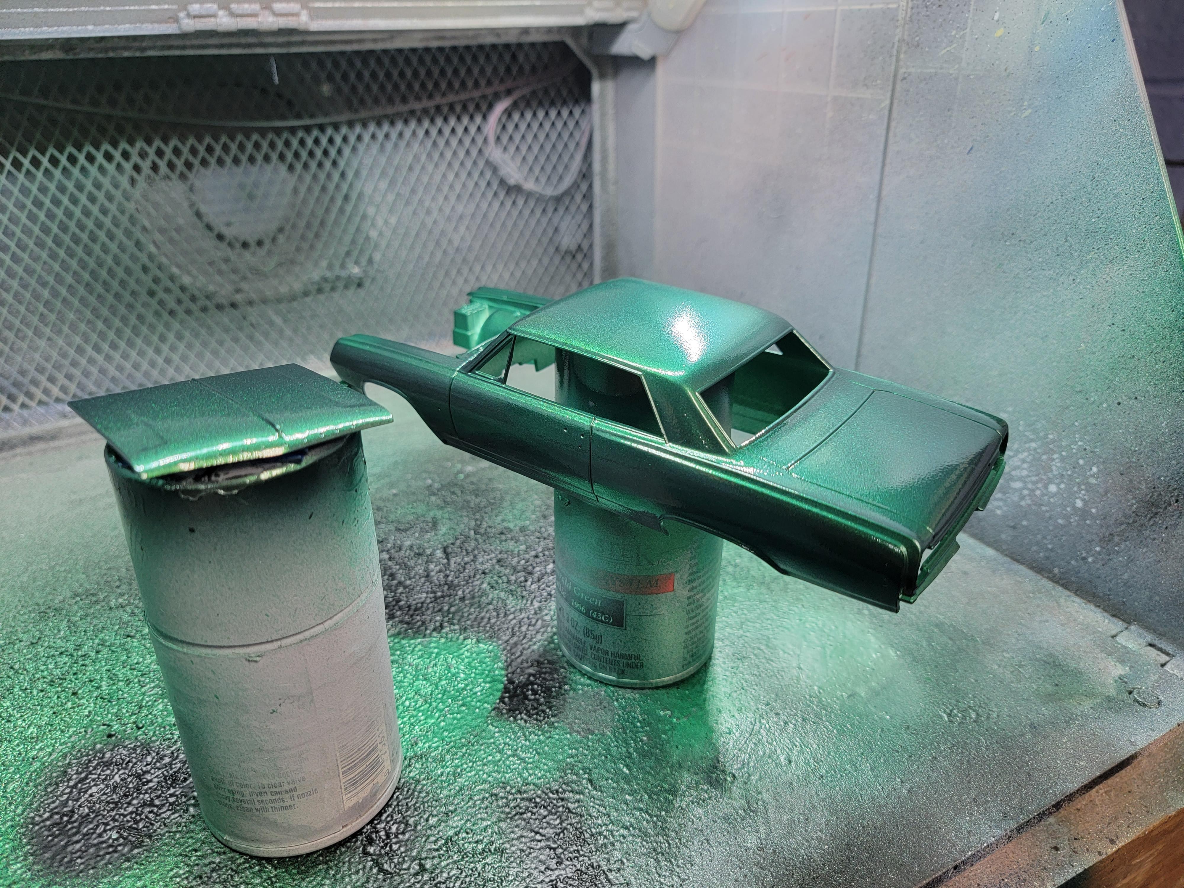

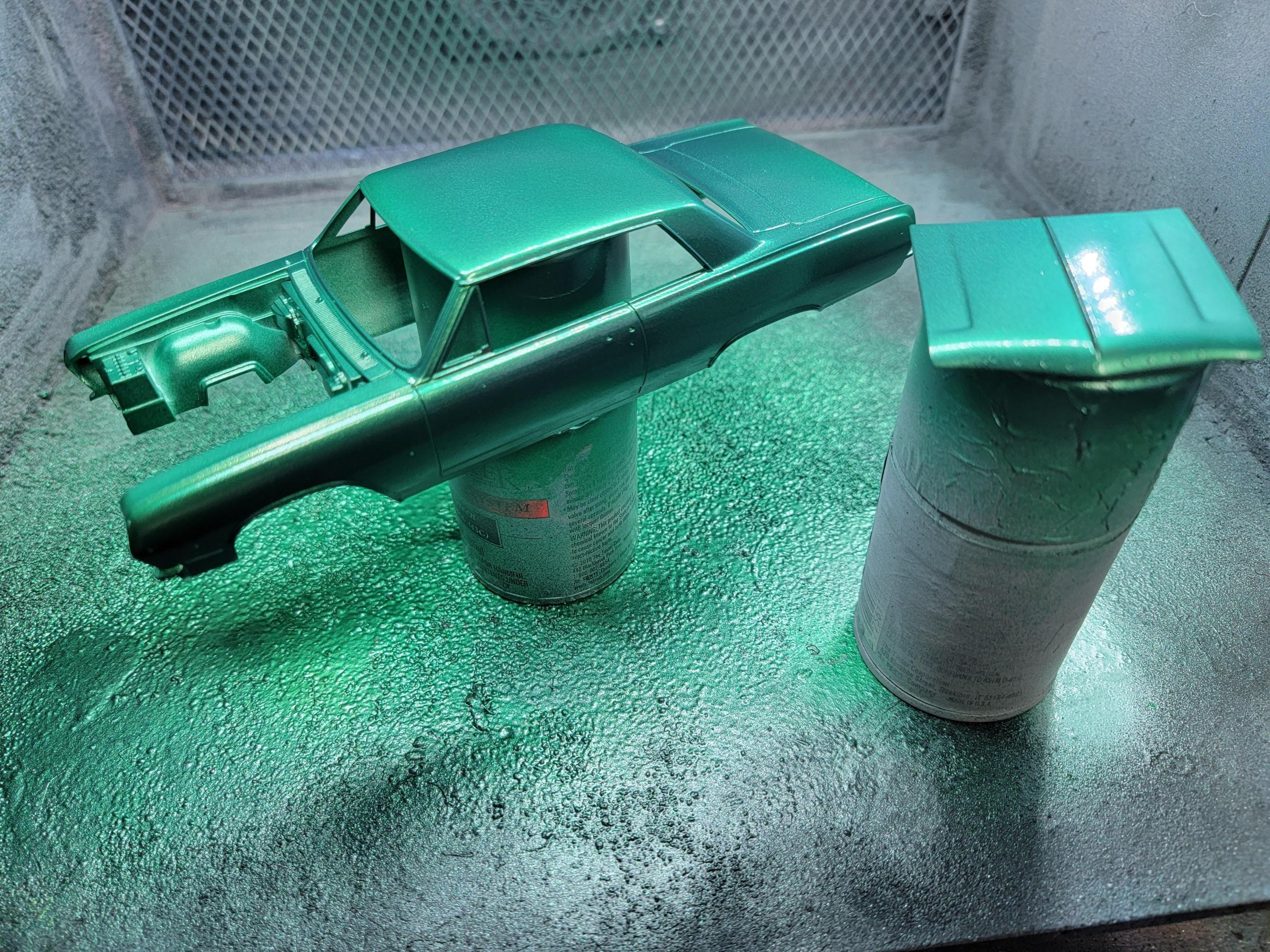

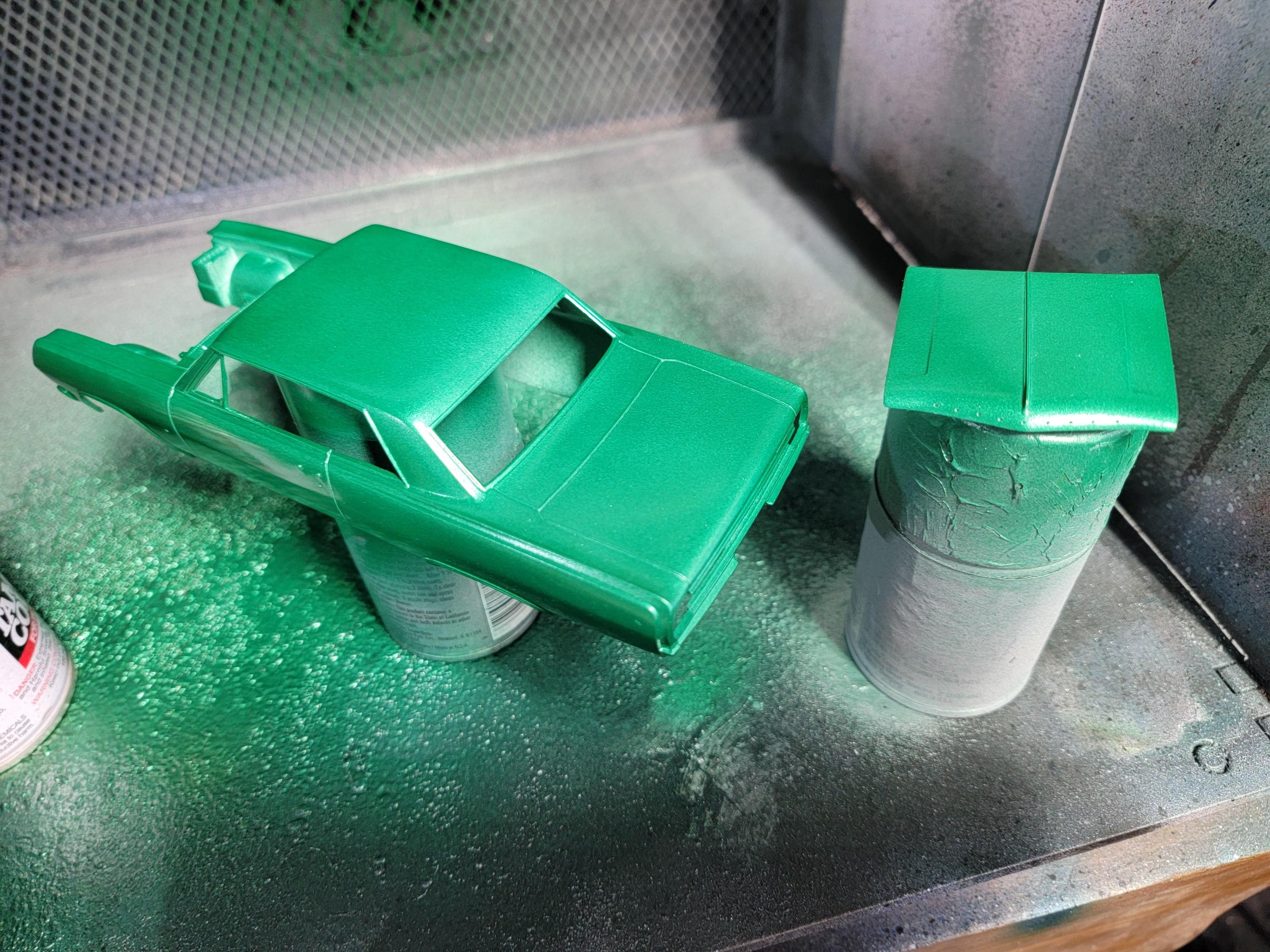

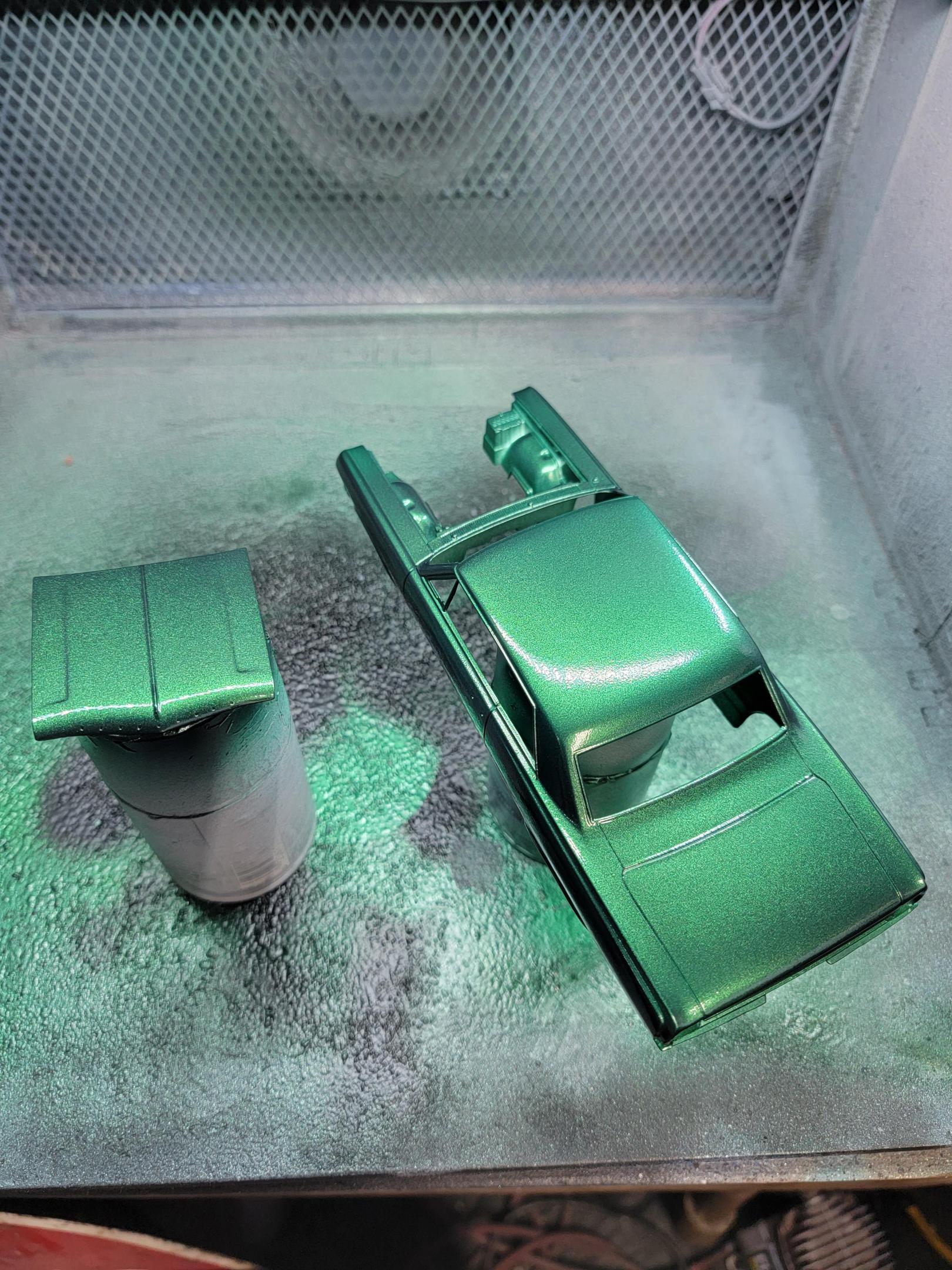

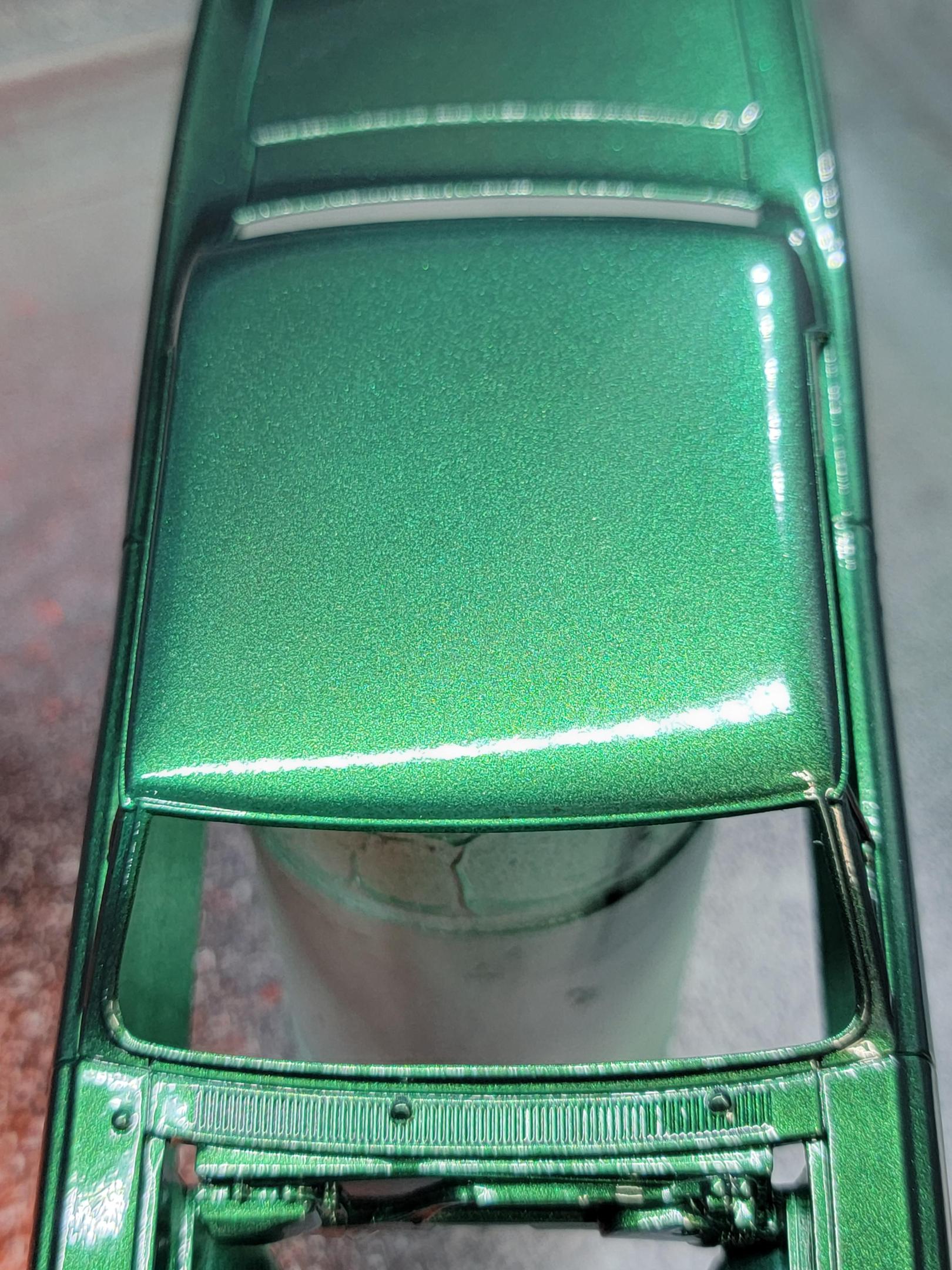

I primed the body and painted a couple of light coats of Tamiya Metallic green prior to the nail polish.
For the nail polish I mixed some black nail polish in with the green to darken it, about 70/30. I sprayed a couple of coats.20231113_155446.thumb.jpg.cf10113f7fd7ed65e6d9ed32fdb9663b.jpg
Then I decided that I want to go a bit darker. So, I remixed the polish to about 50/50.20231113_202258.thumb.jpg.c5ebab1f5de5dd48f7f328283232a5c2.jpg
Tomorrow night I will sand a bit of trash out of the body and respray a couple of coats.

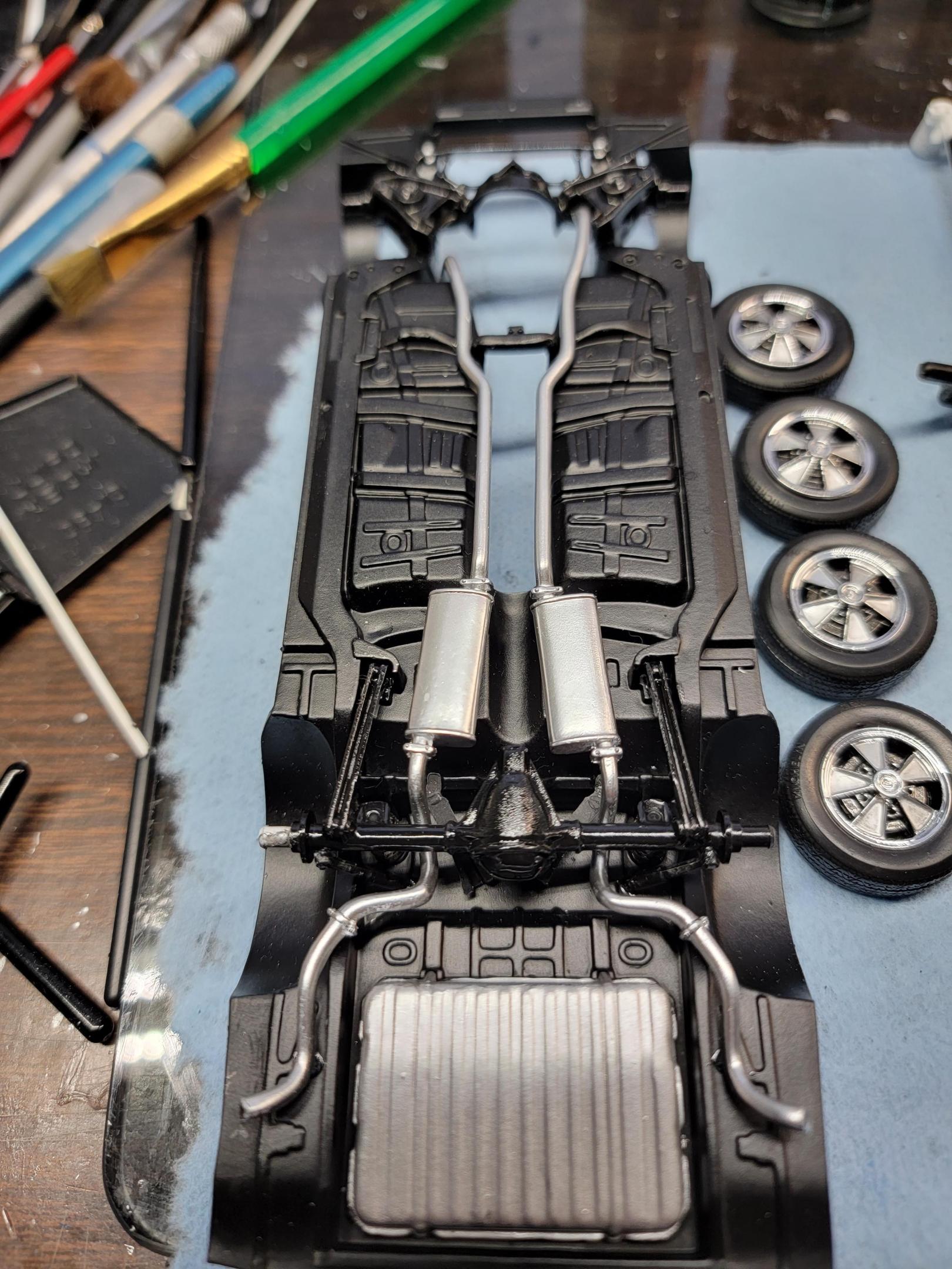

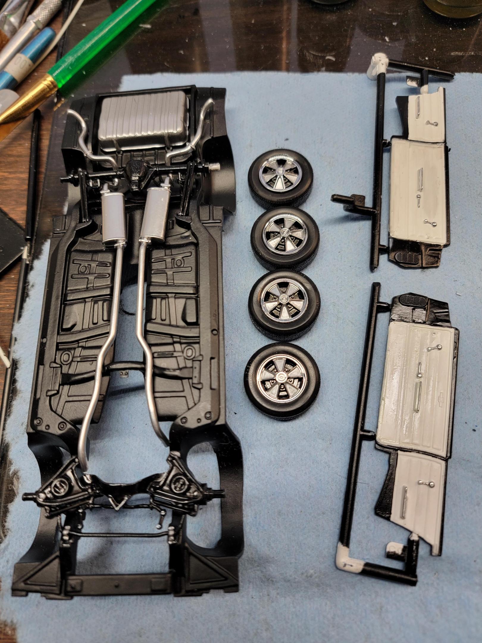

I also have managed to spray all of the chassis and associated parts in varying shades of black and I'm begining to get the chassis together.

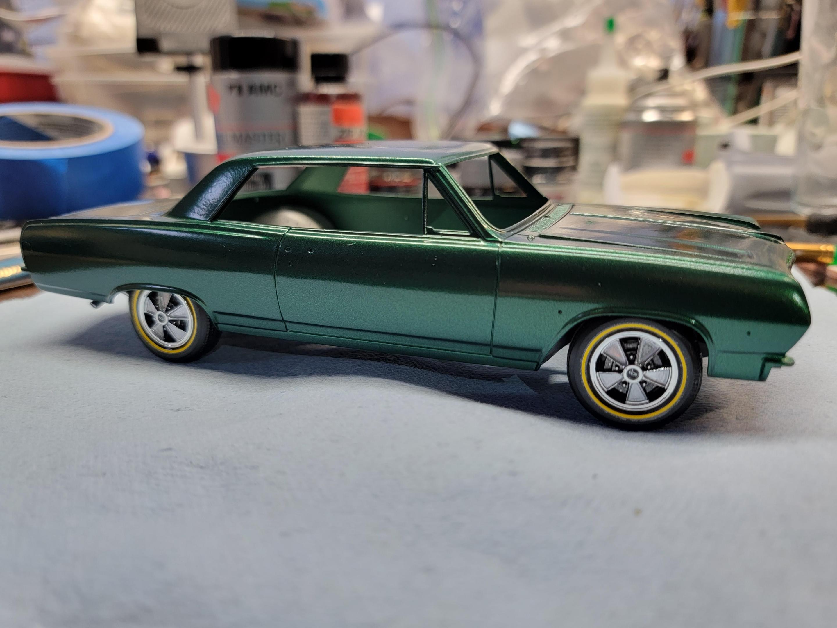

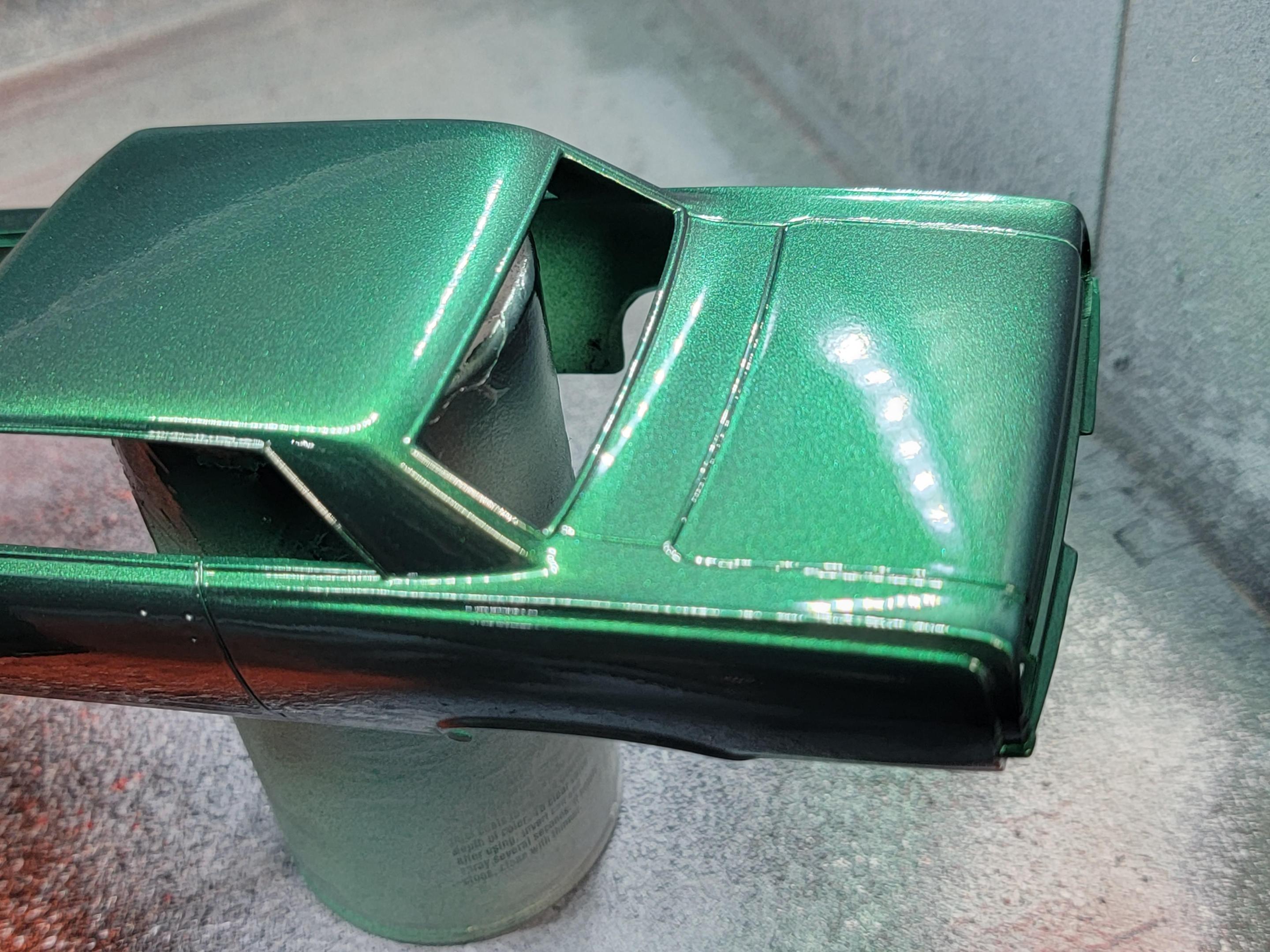

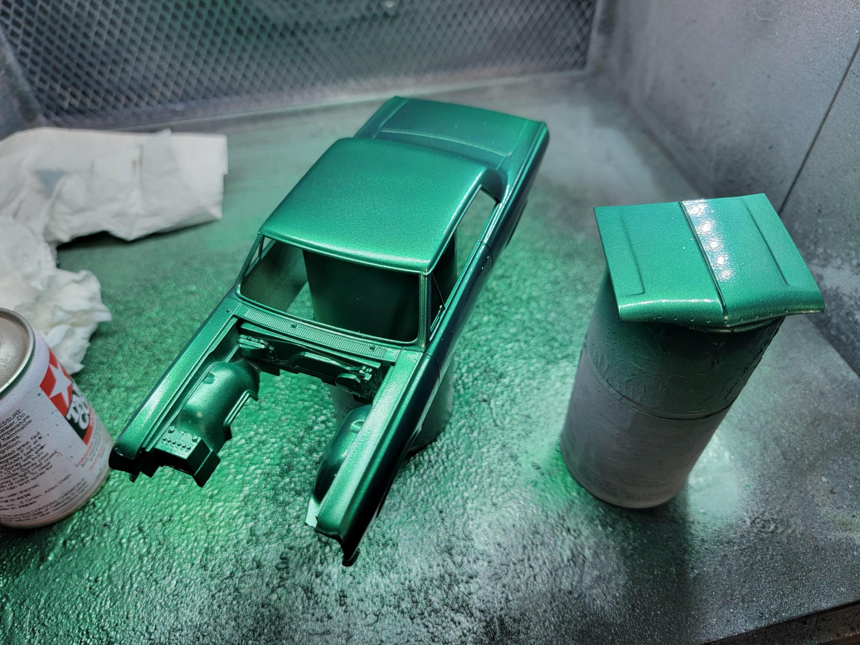

Wet sanded the body yesterday and sprayed the new mix on the body. Hard to tell the difference in this light but it is considerably darker. Now to let it sit a couple of days before clearing.

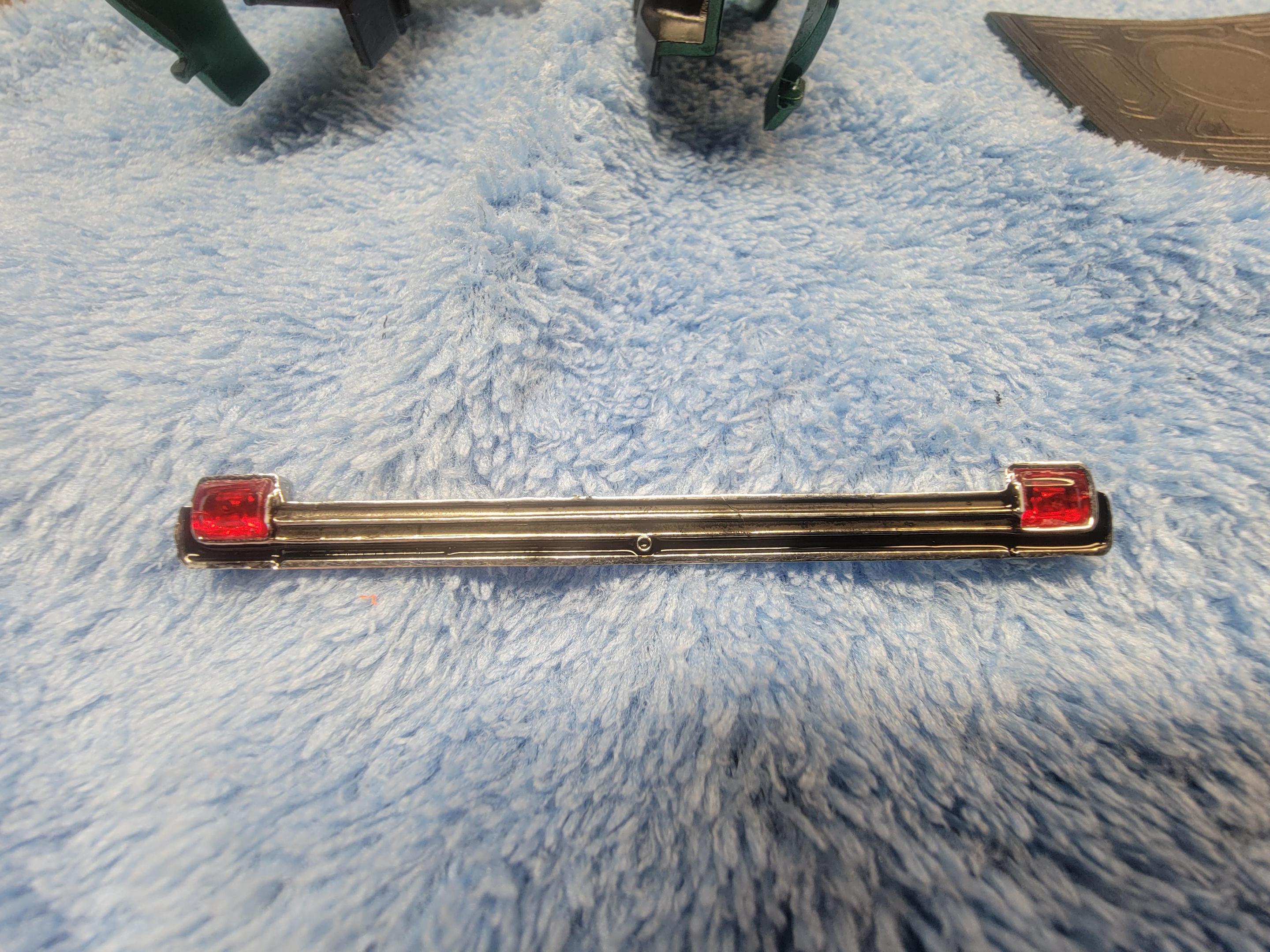

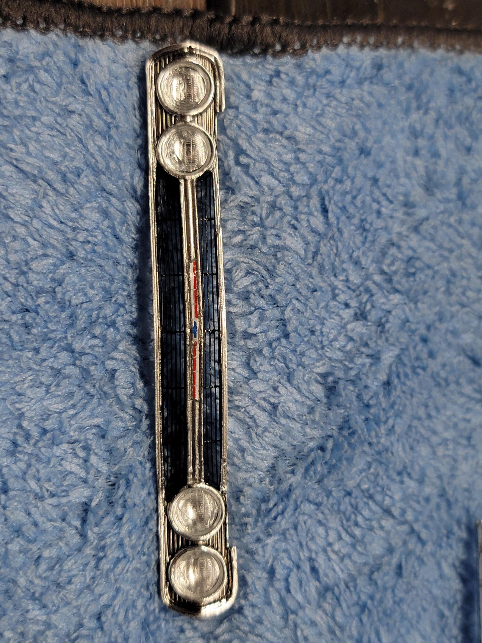

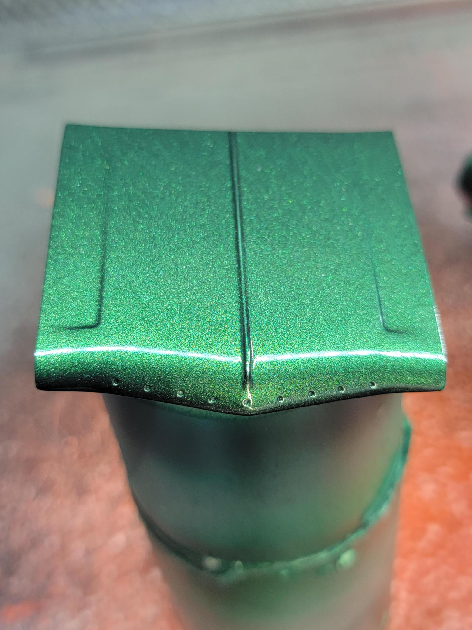

I figured I'll throw in a pic of the PE I added to the grill. I should have thinned the back of the grill a bit after opening it but once I get the Molotow and black wash on I think it will look fine.

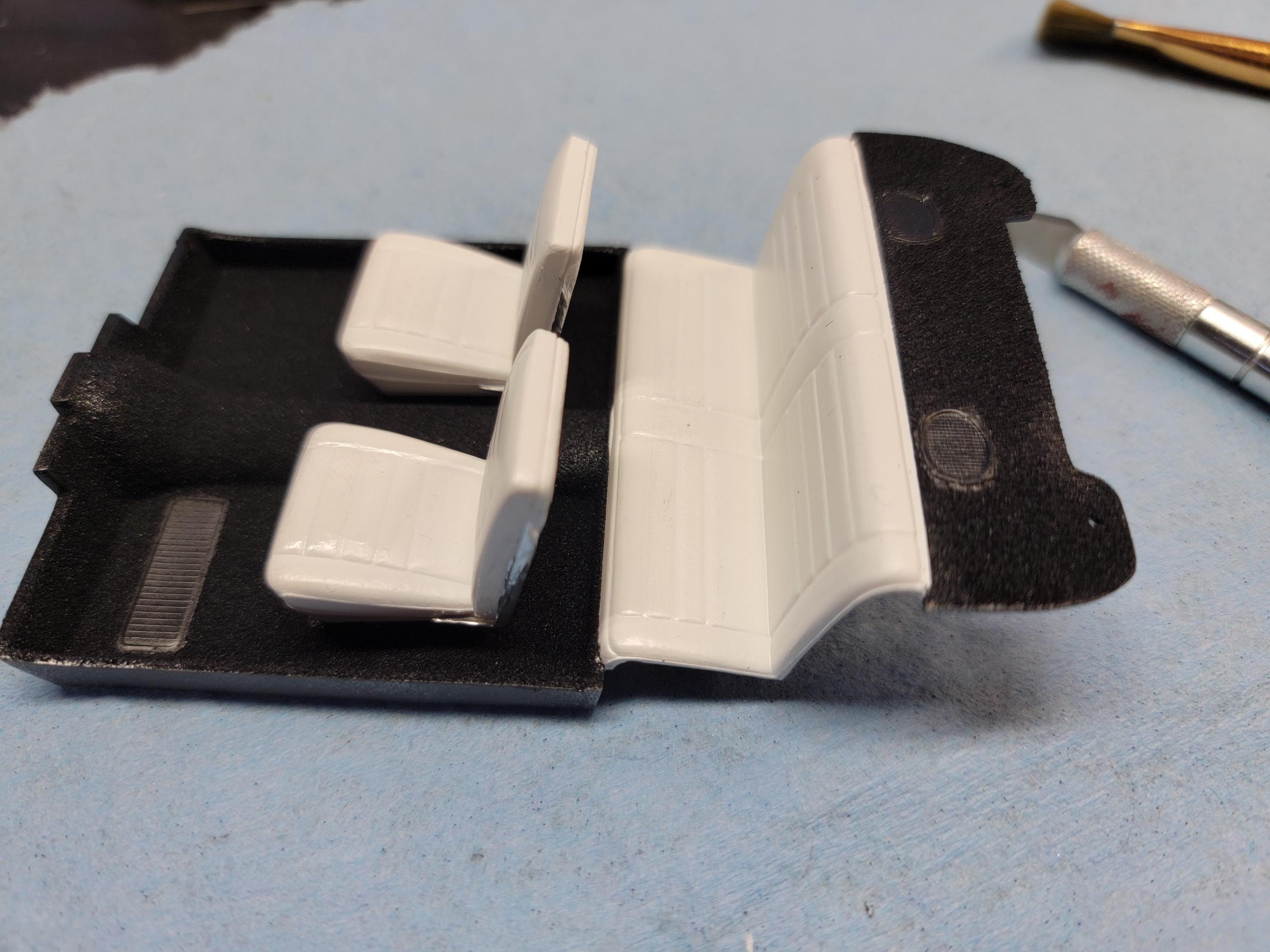

I got just about all of the chassis painted and the bulk of the interior. Still need to assemble the parts and detail everything. Progress has been slow this week. The seats are just sitting in.place for now. I bought some metal polish yesterday in order to polish the PE pieces to a chrome finish using my Dremel. Hopefully I don't bend them up.

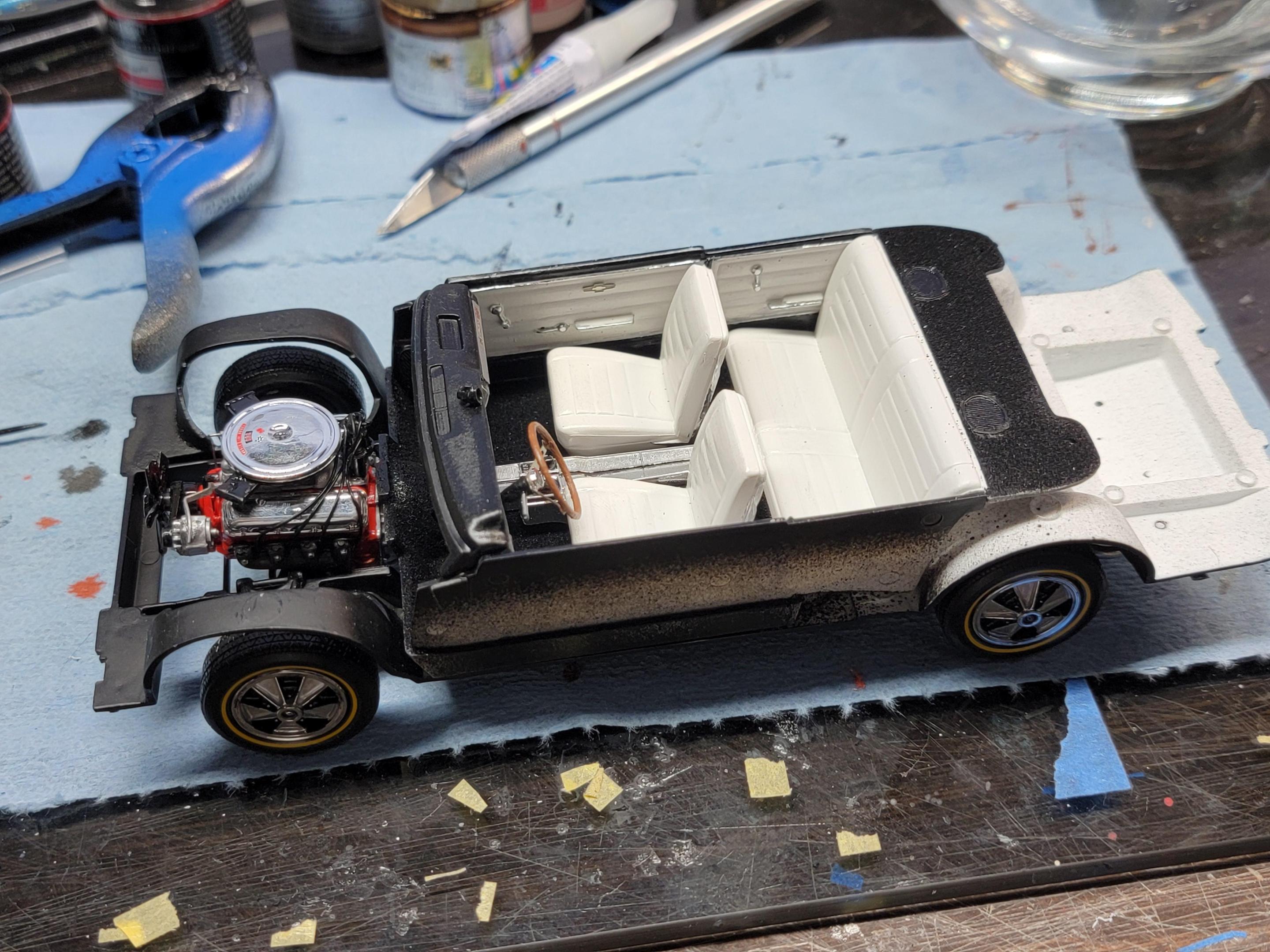

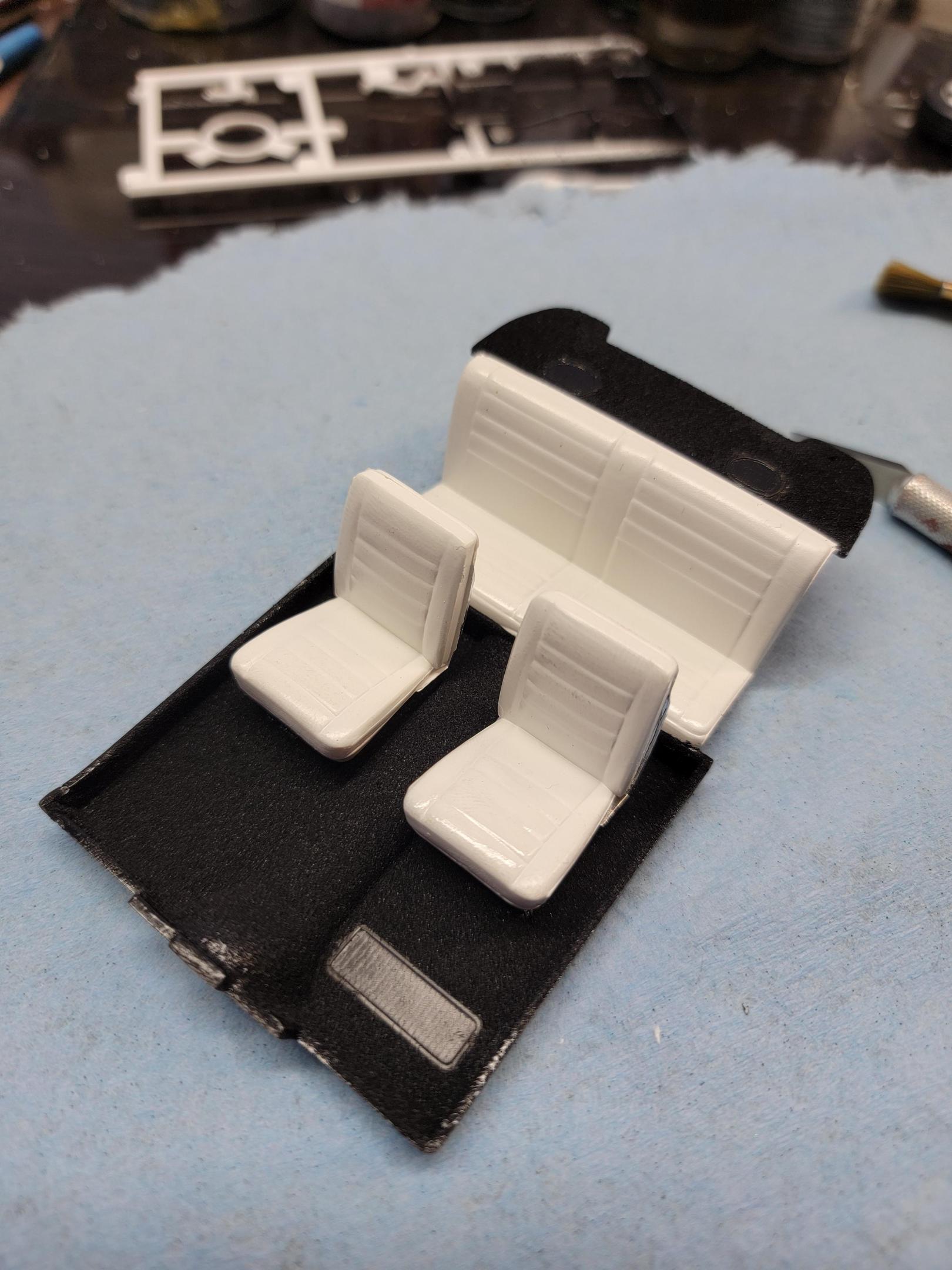

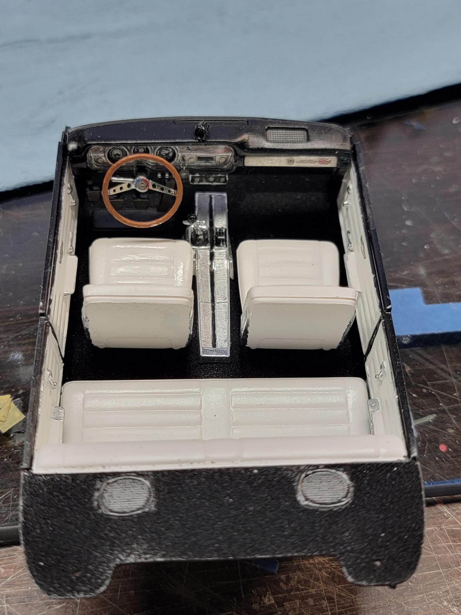

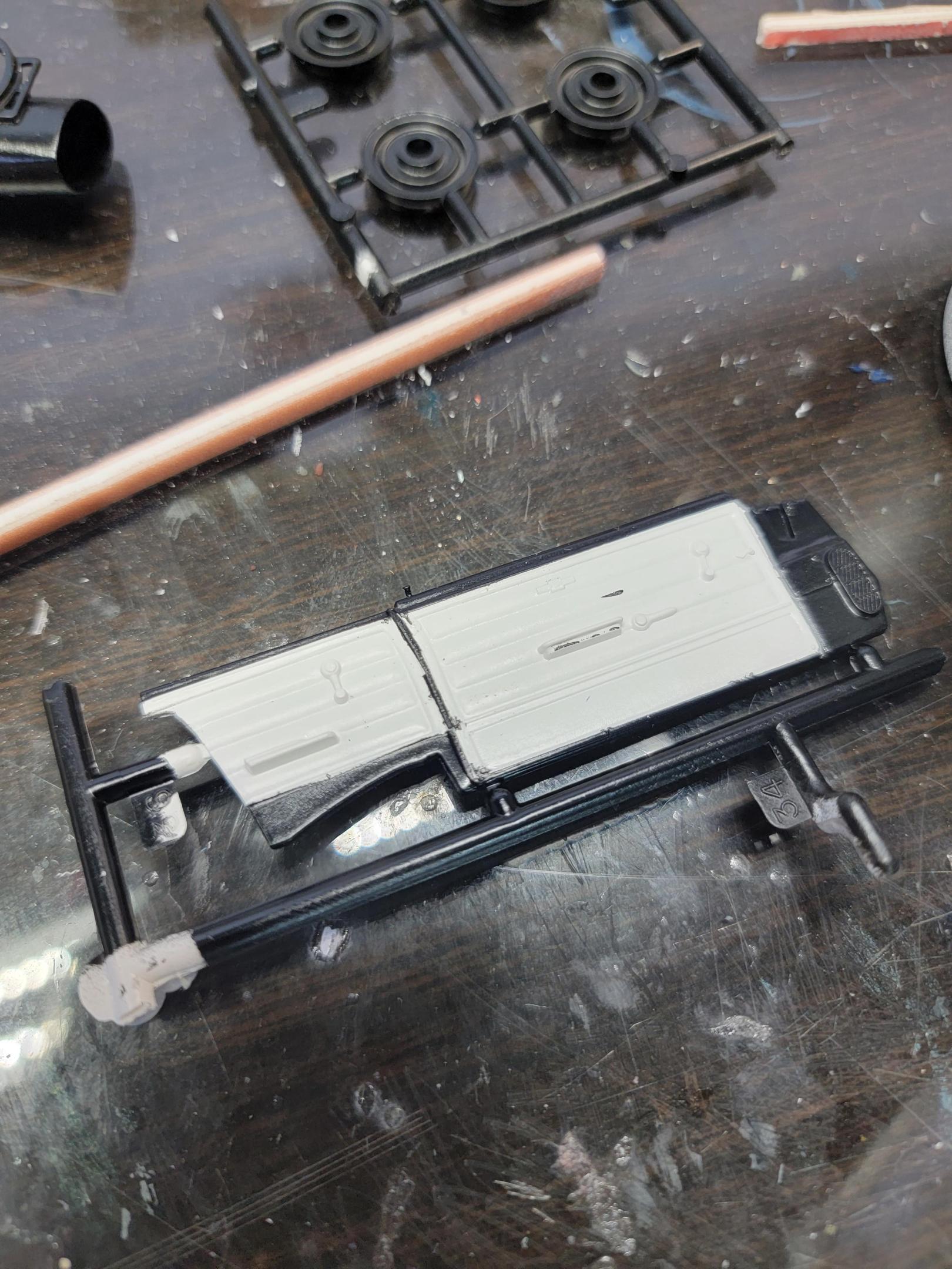

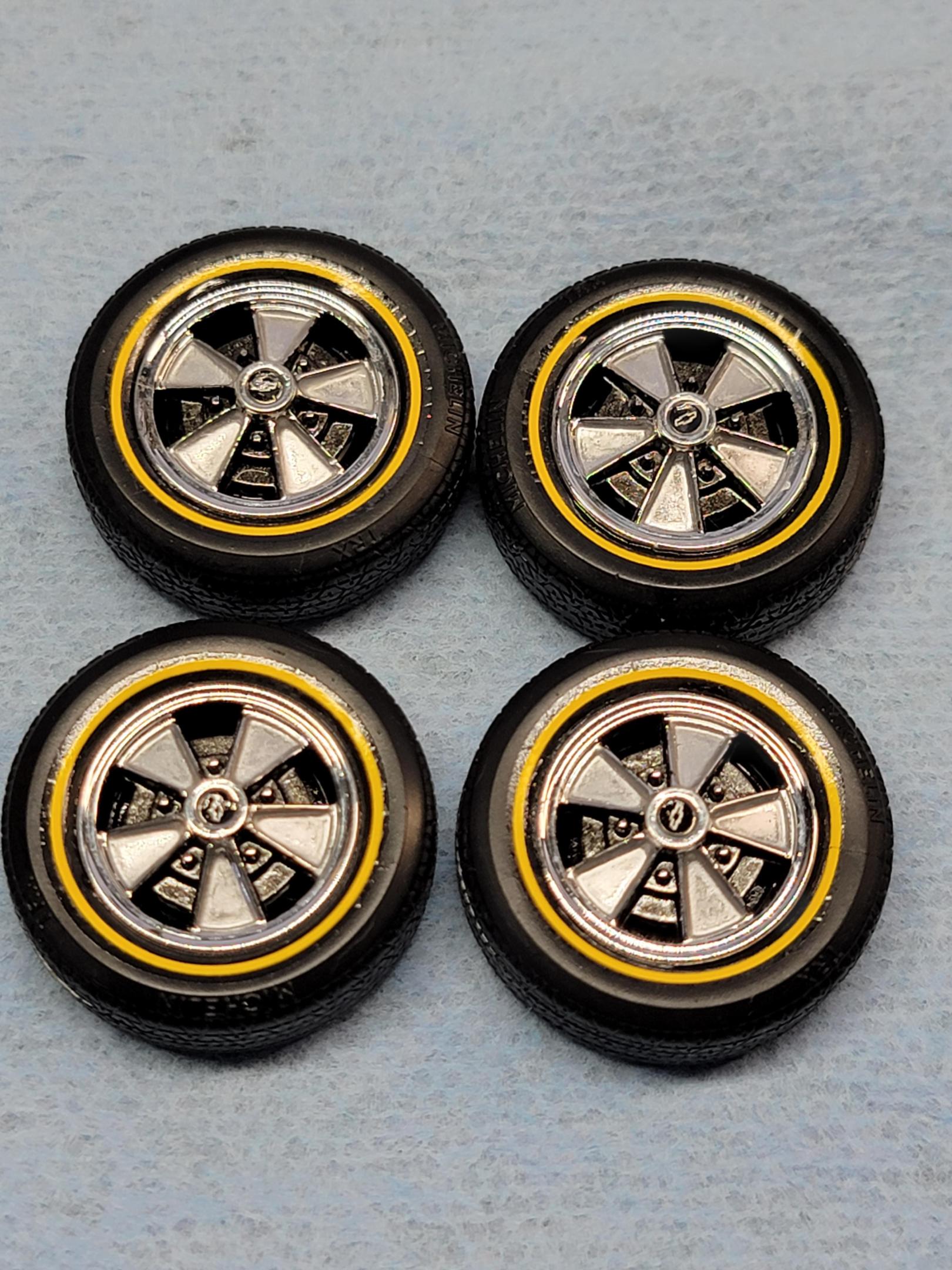

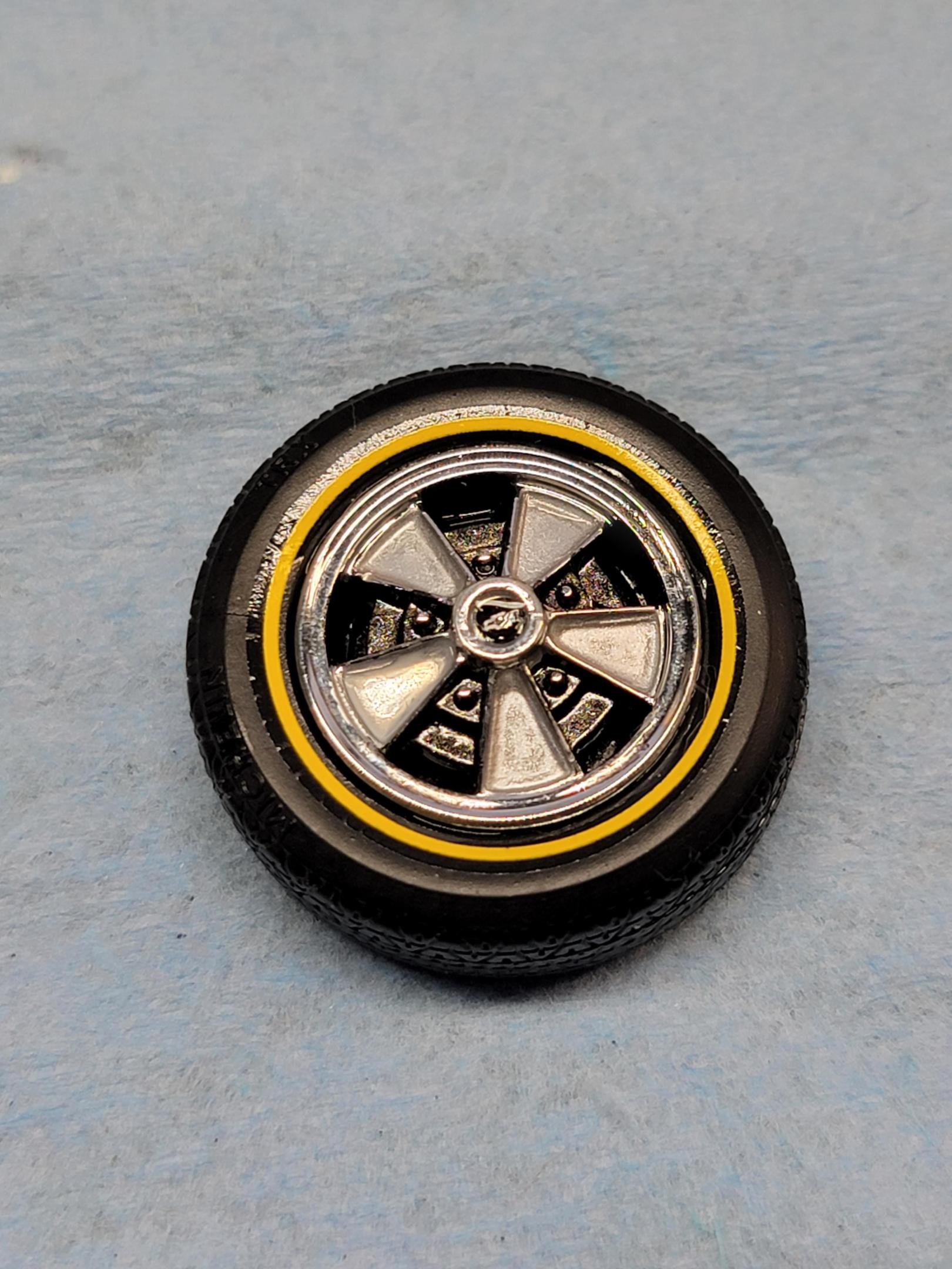

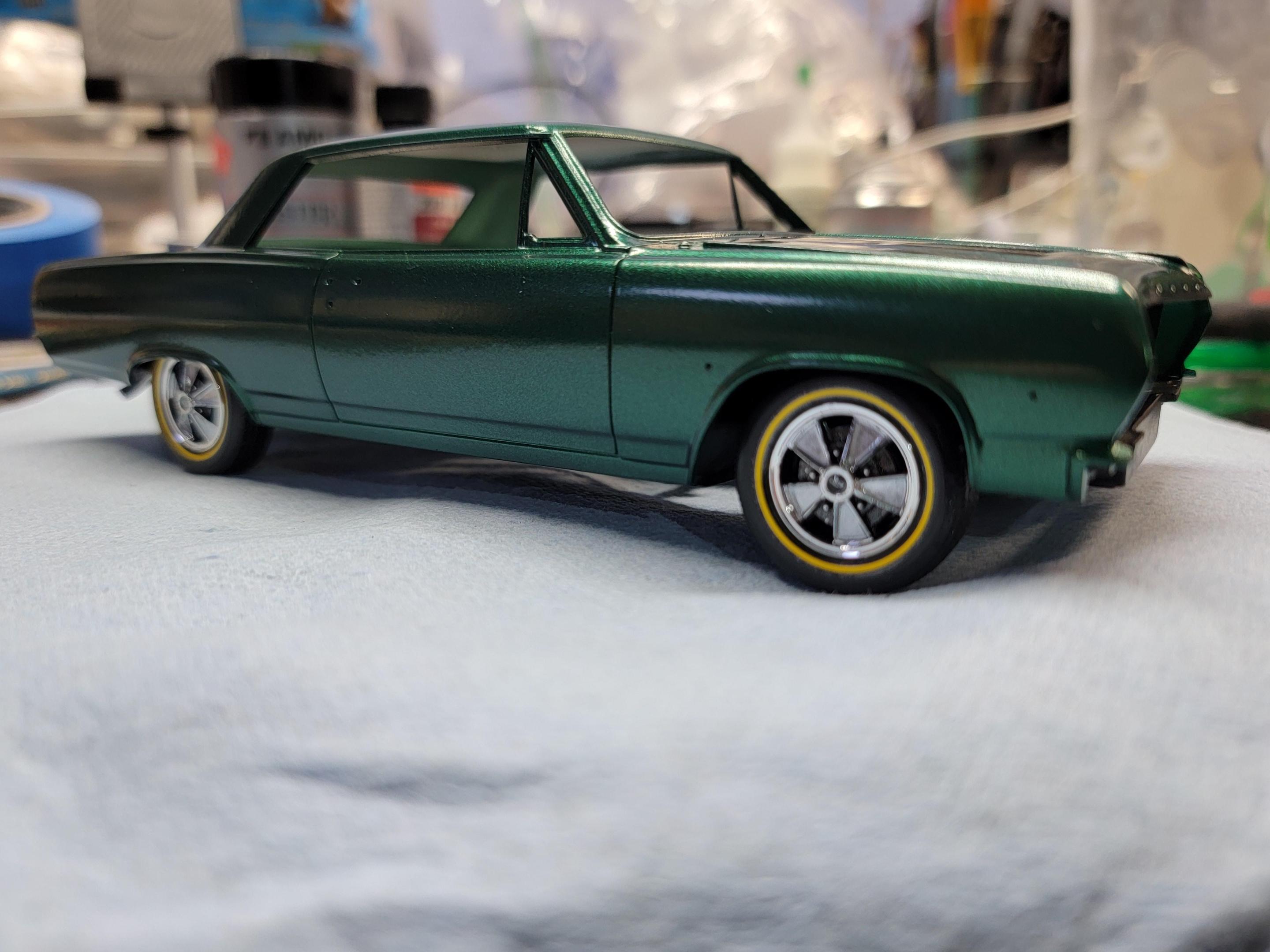

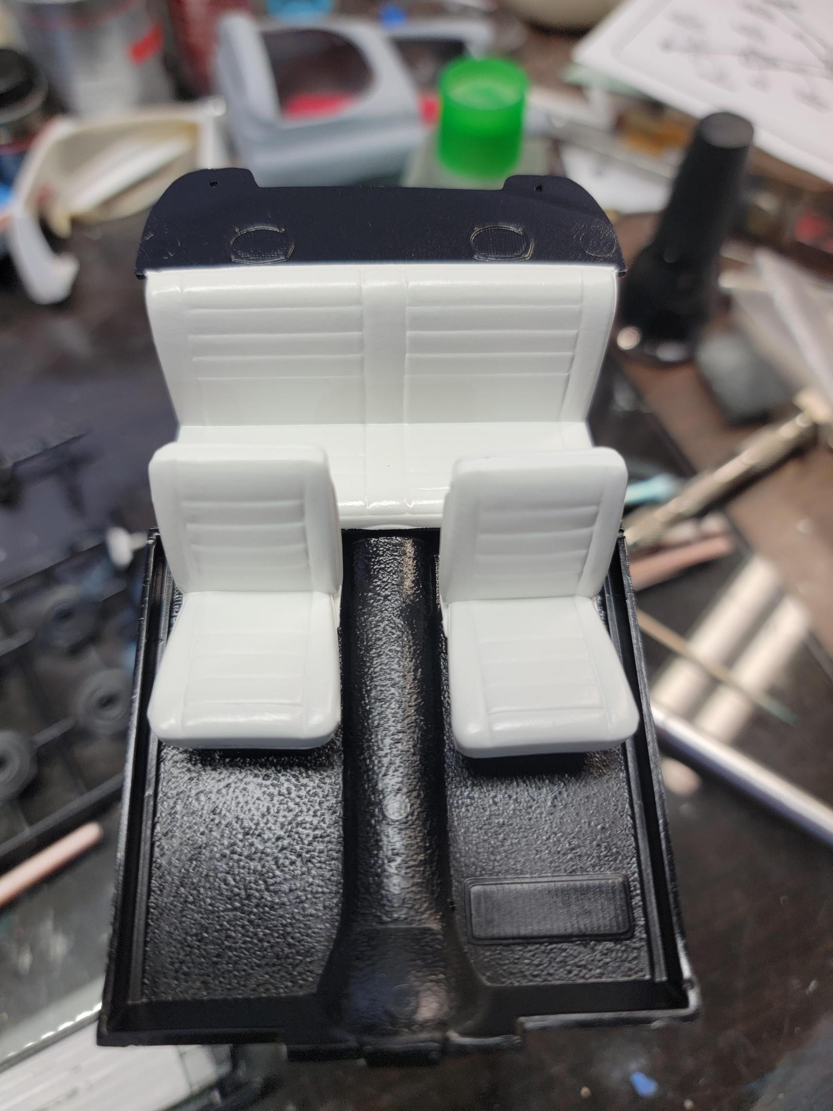

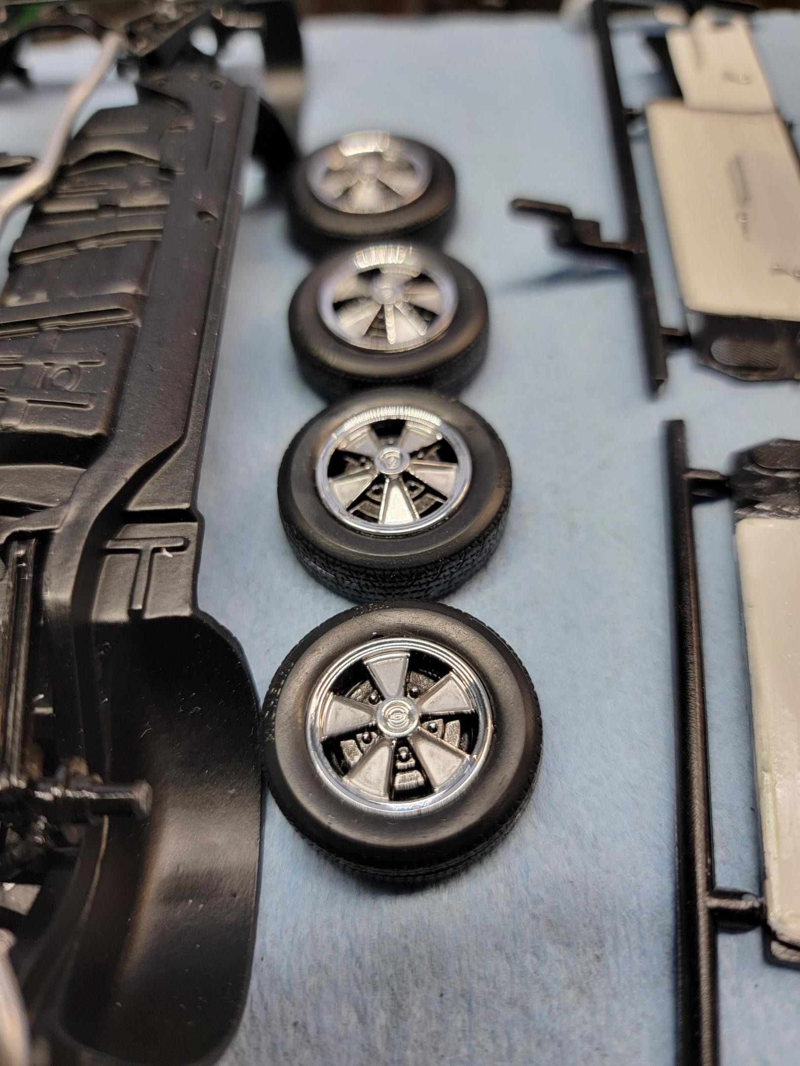

More progress today. Got the tires and wheels decaled, the interior floor embossed and the seats in. Then I had to mock the body up on the completed chassis to see how the paint looked against the tires and wheels. I'm liking the look.
Later-

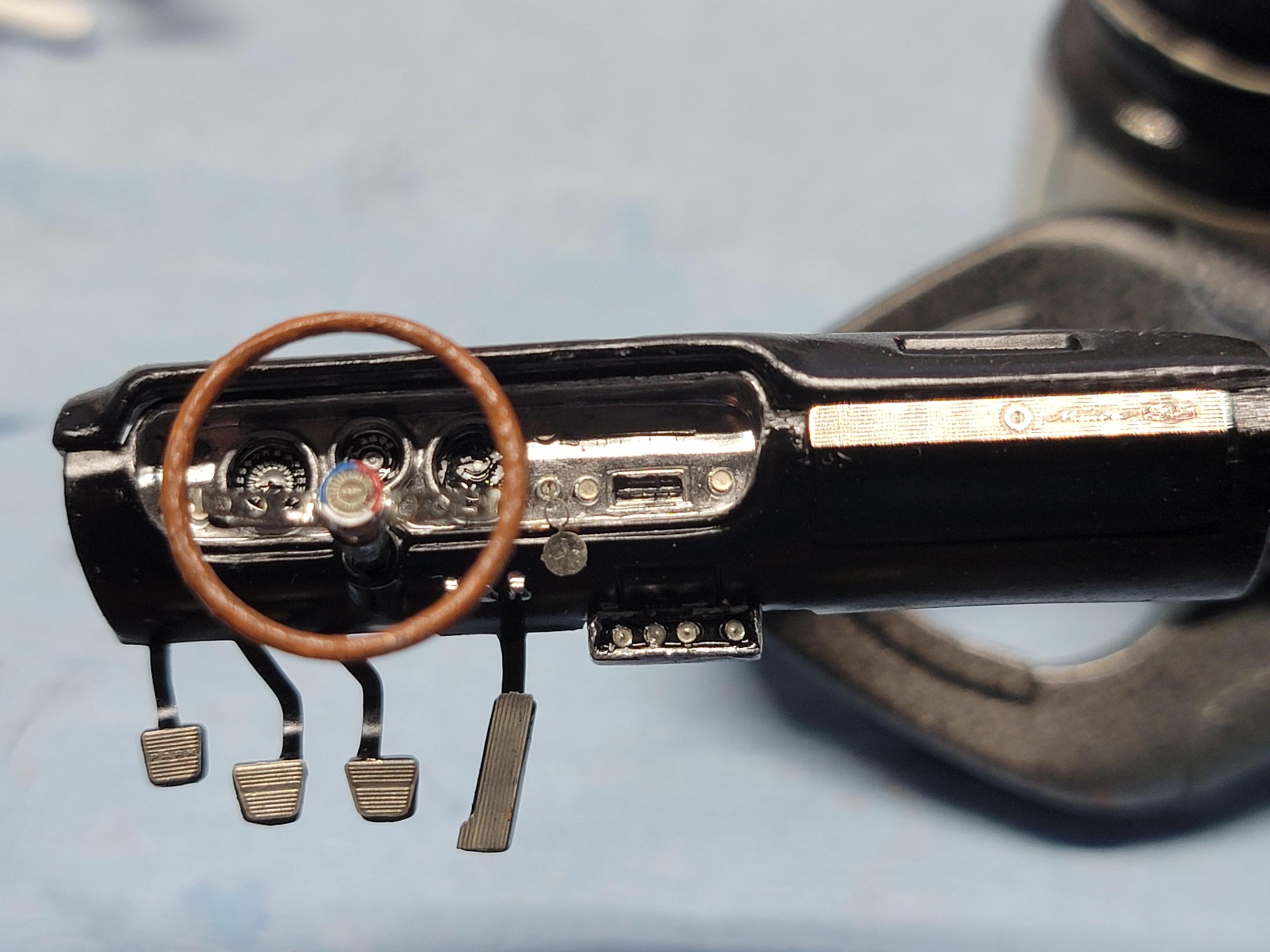

Spent some time last night on the engine and dash. One of my dash decals disintegrated on me. Moving along pretty good on this one. Today I am going to polish the PE sheet so I can start adding them to the mix.
Later-

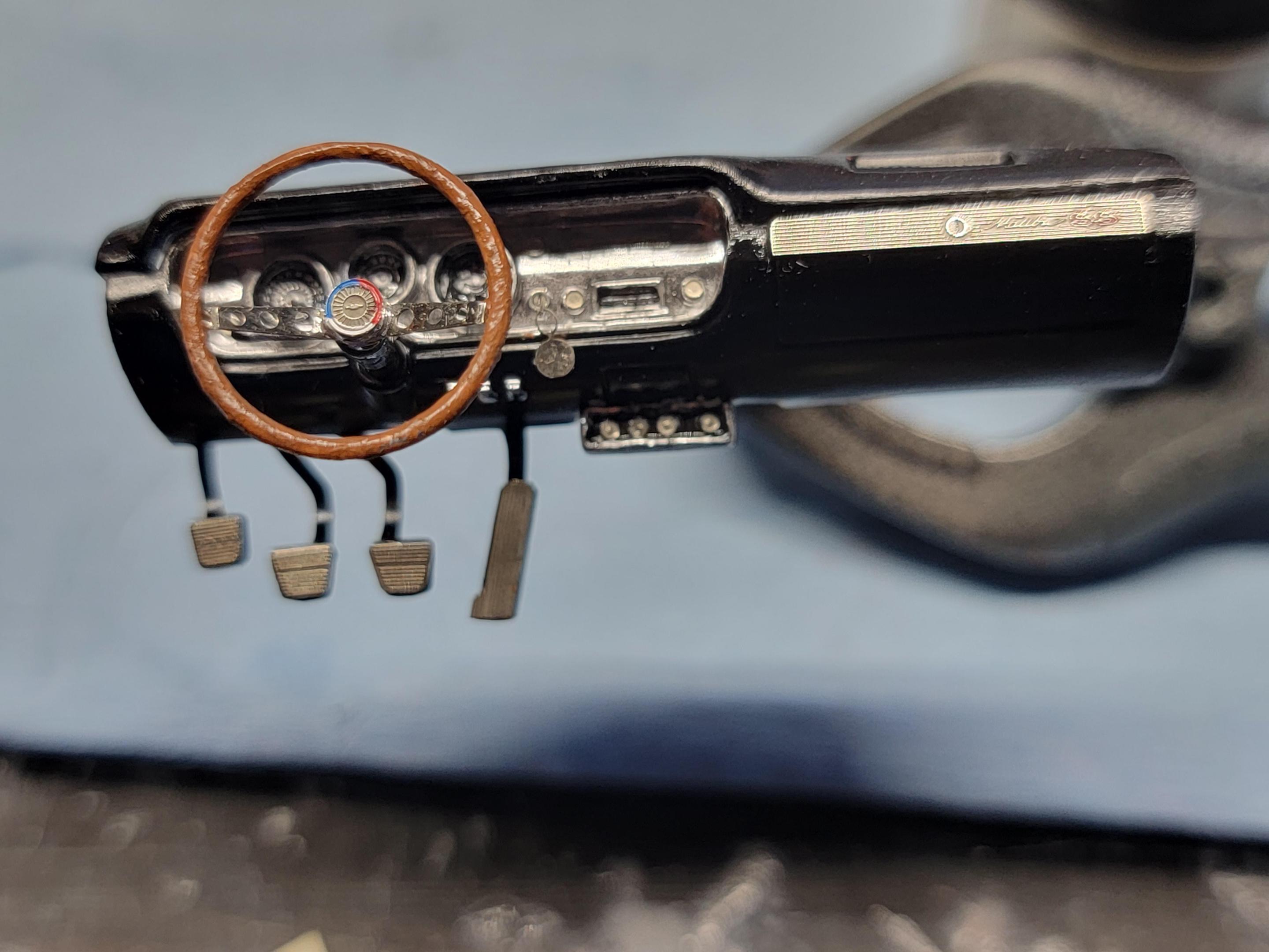

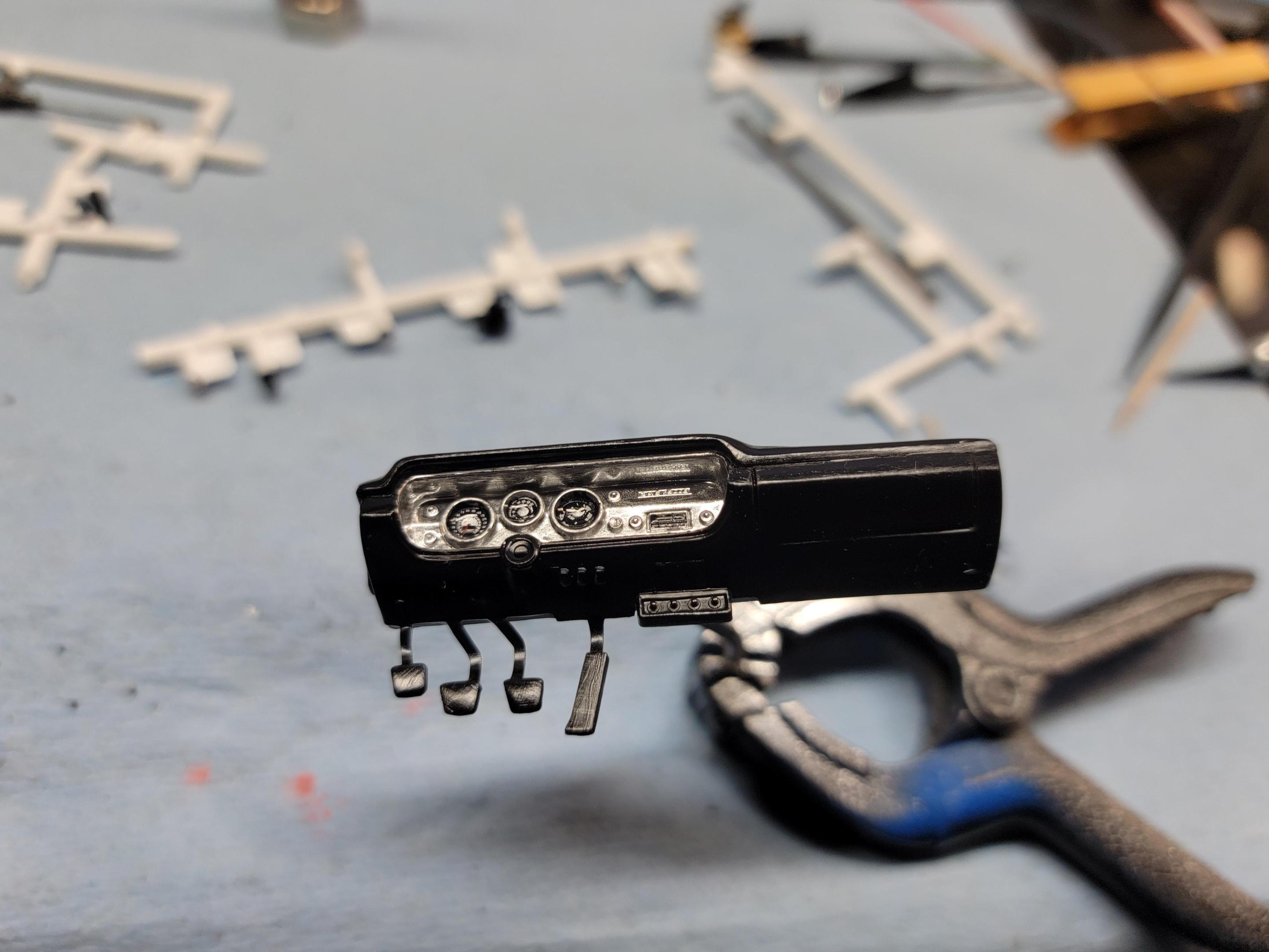

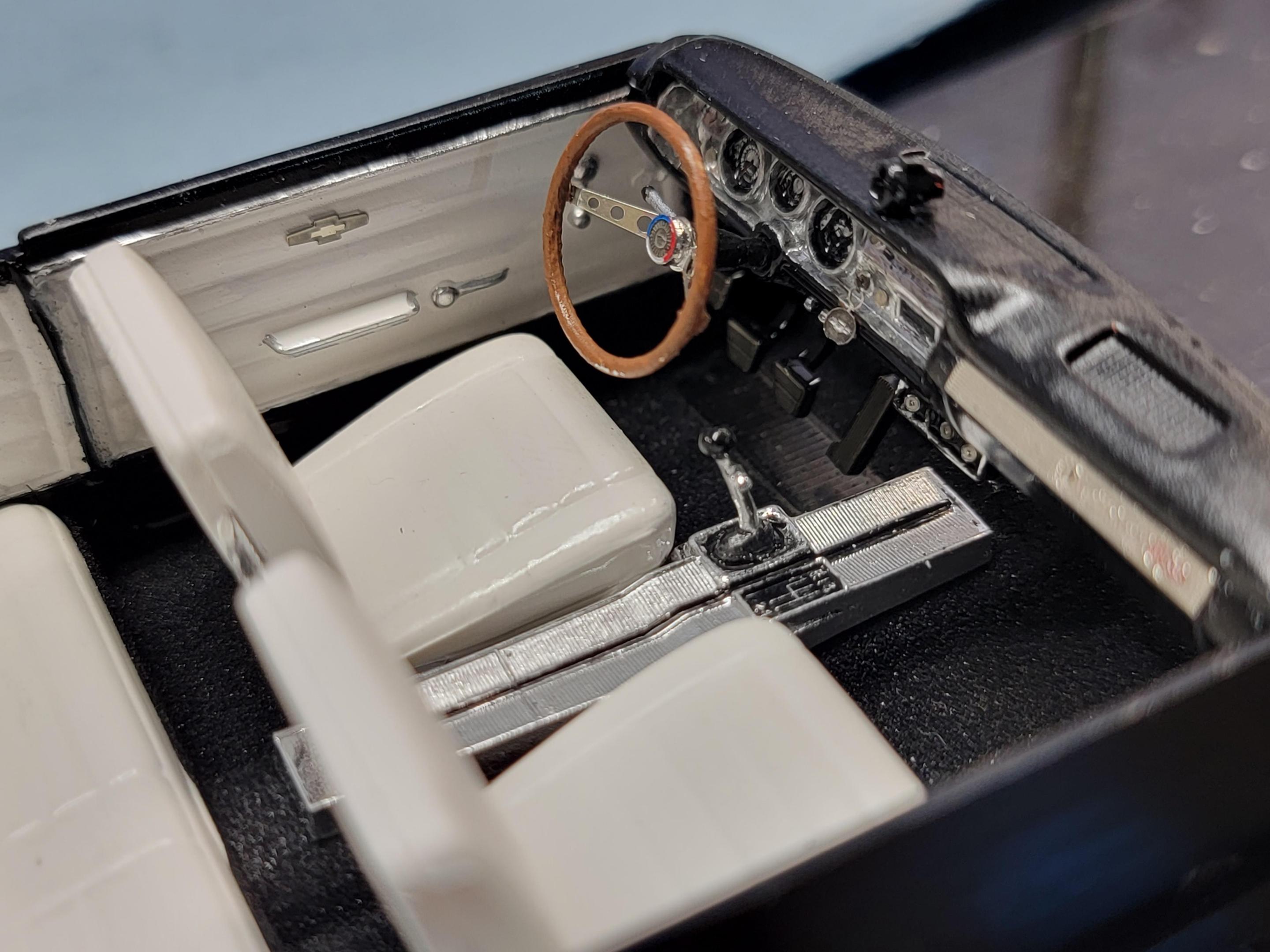

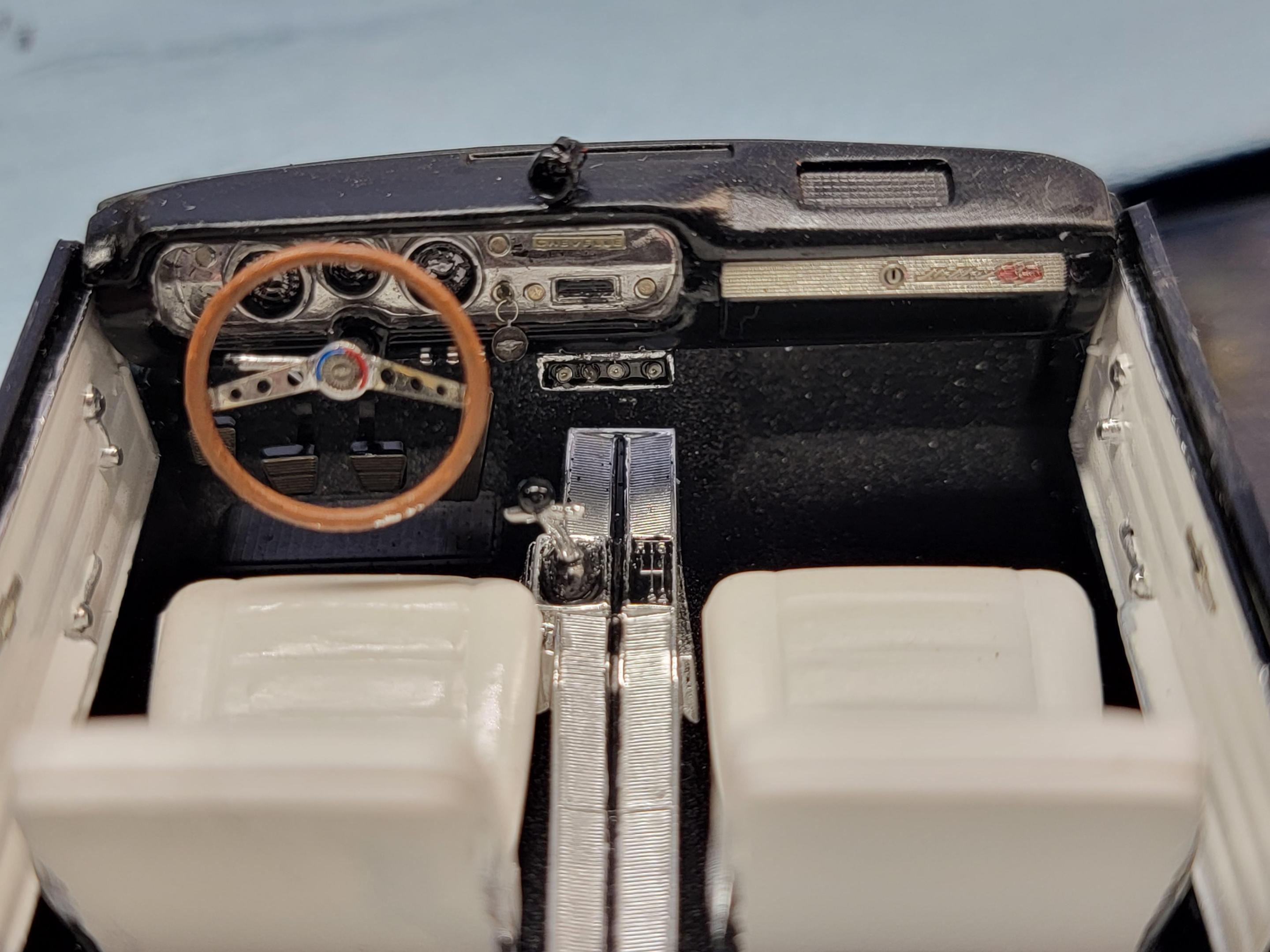

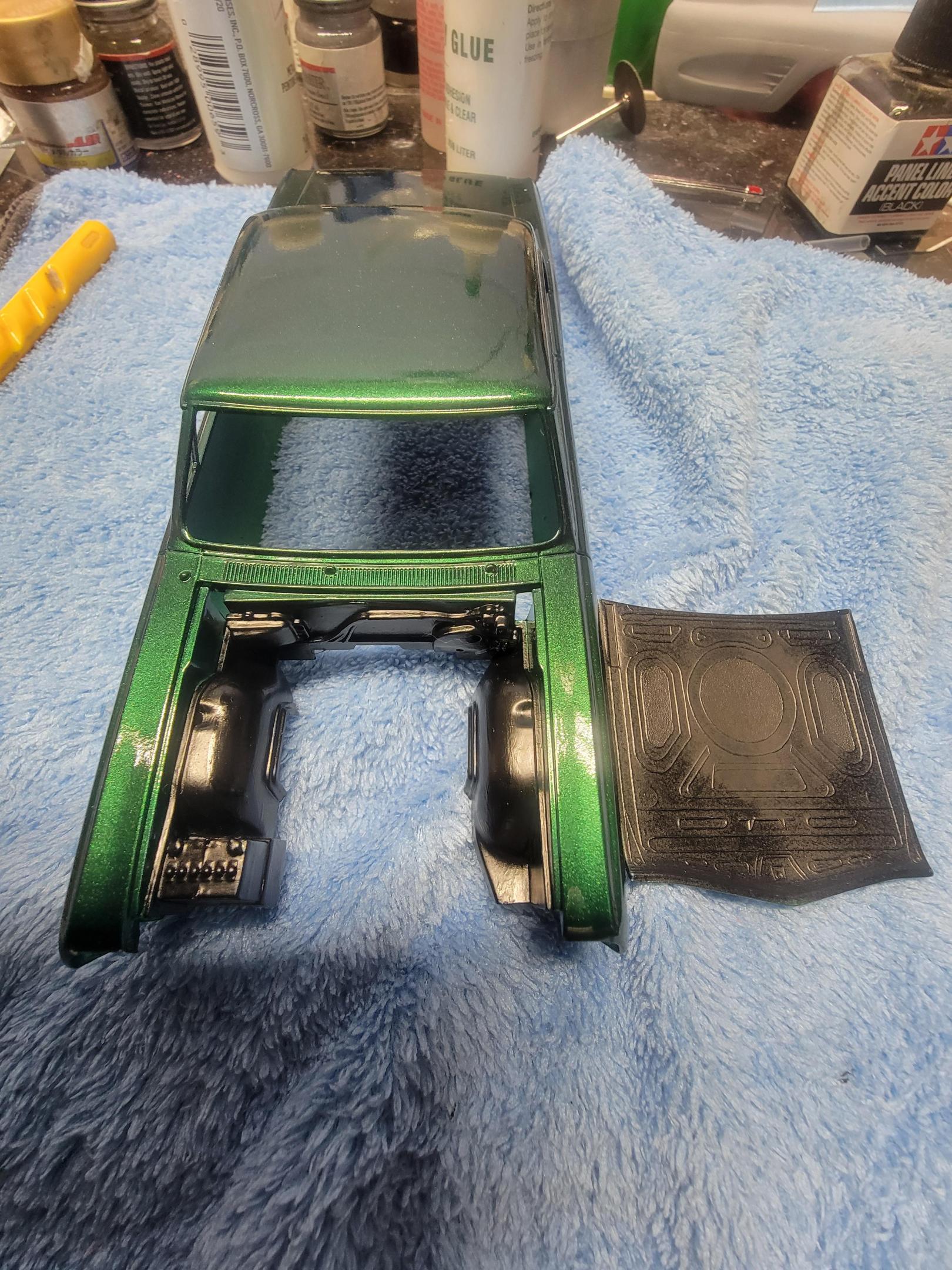

Getting progress made. Got the dash done. Wetsanded the clearcoat today and sprayed the final coat of clear. Now to head back down and assemble the interior.
Later-
Edited by Modlbldr

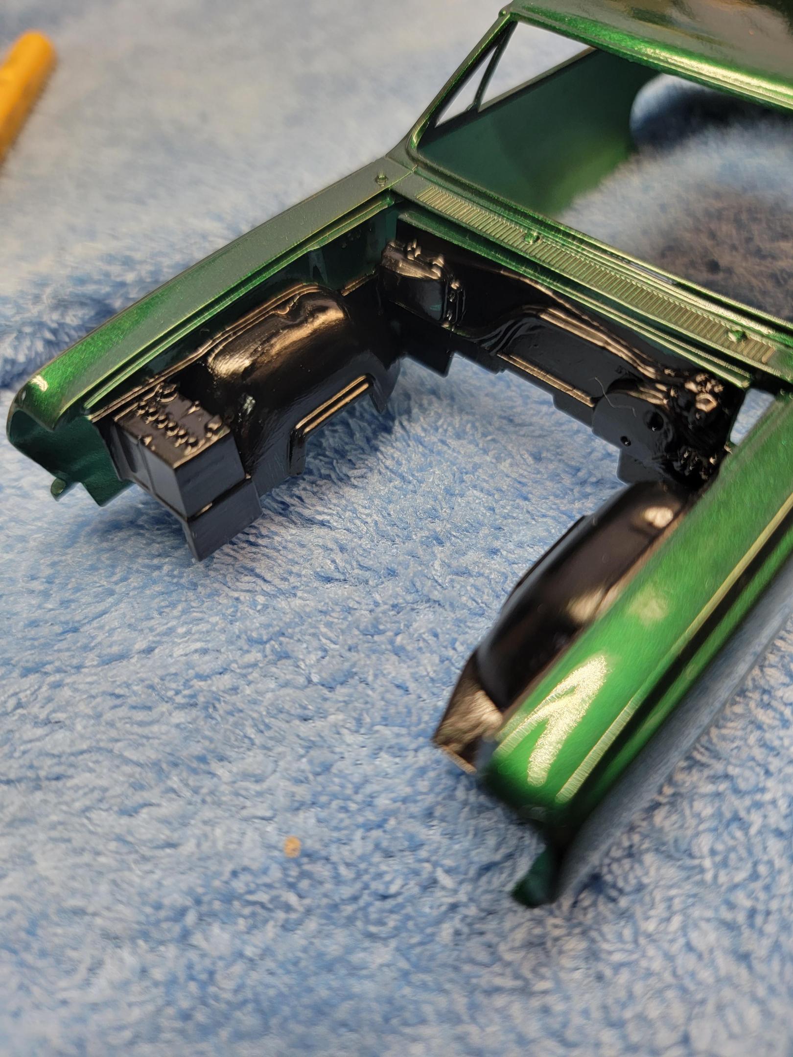

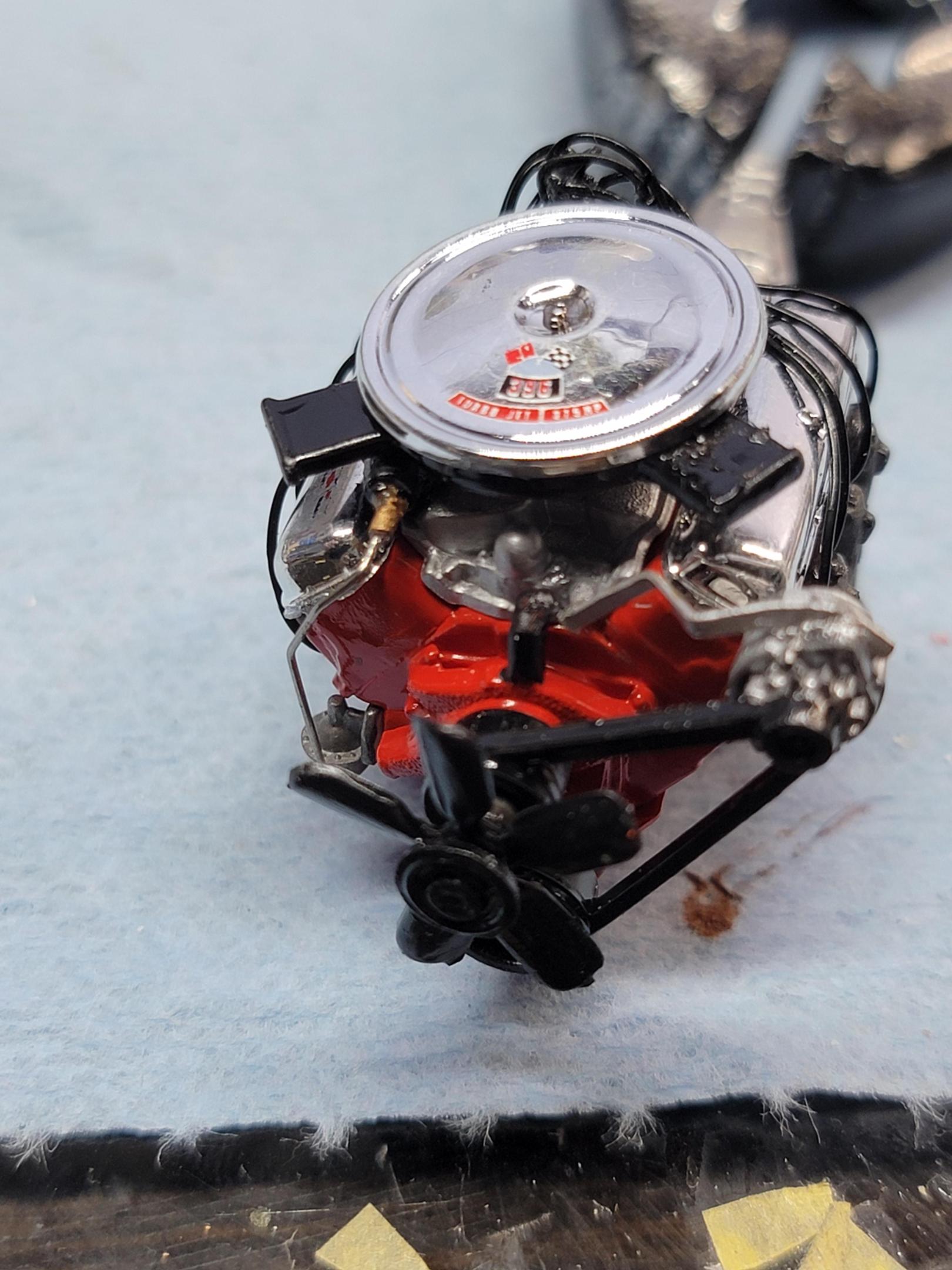

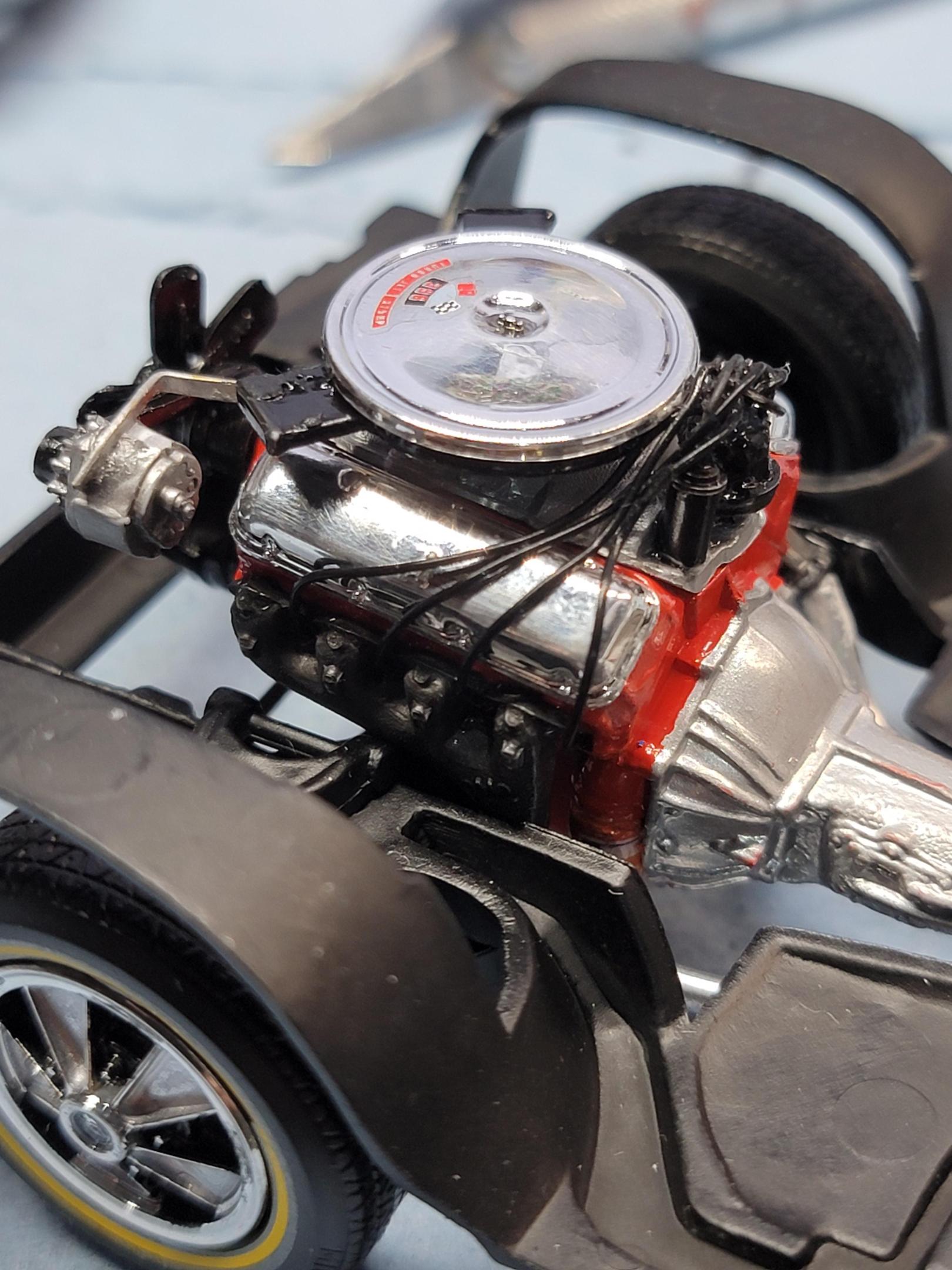

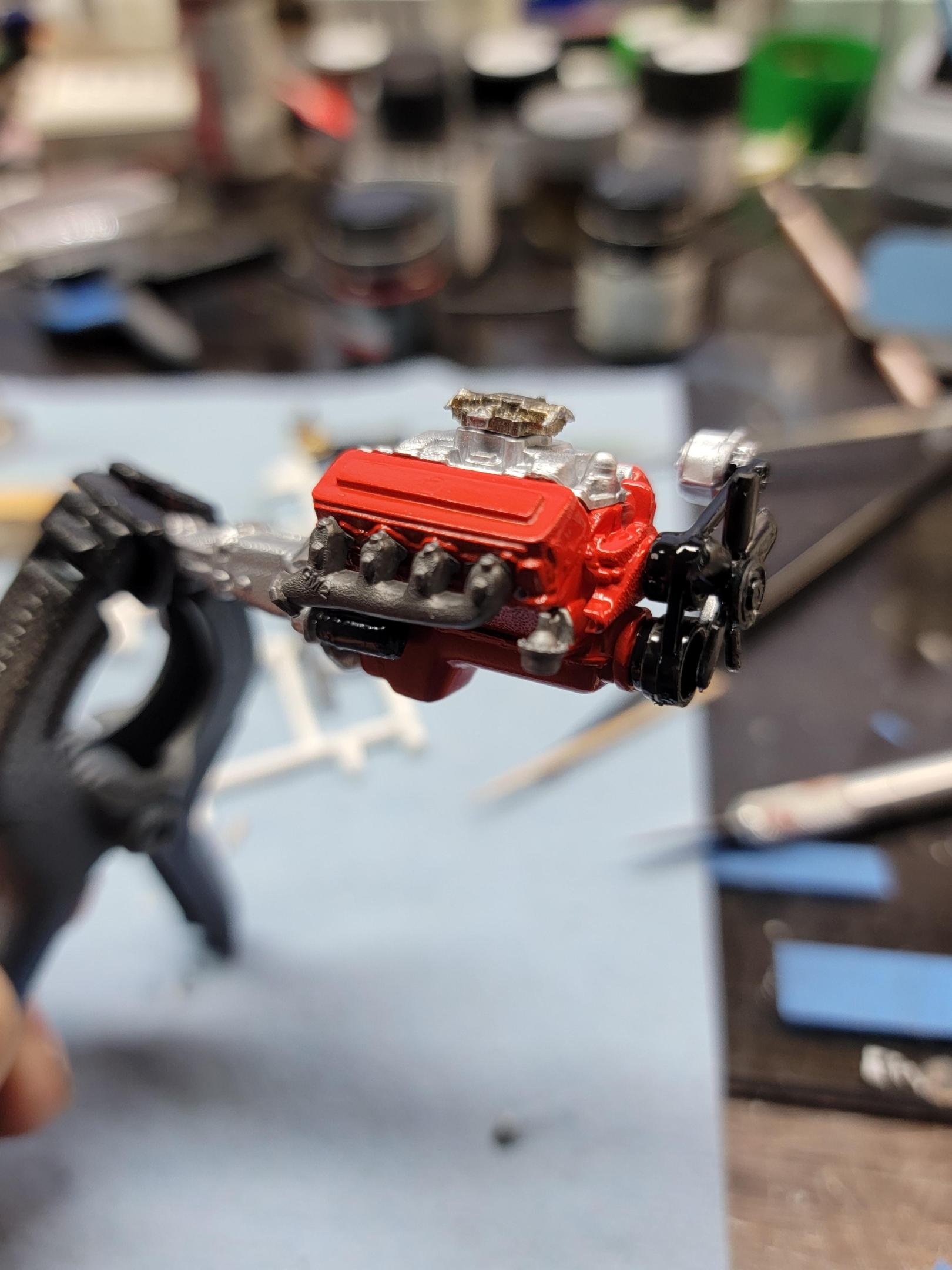

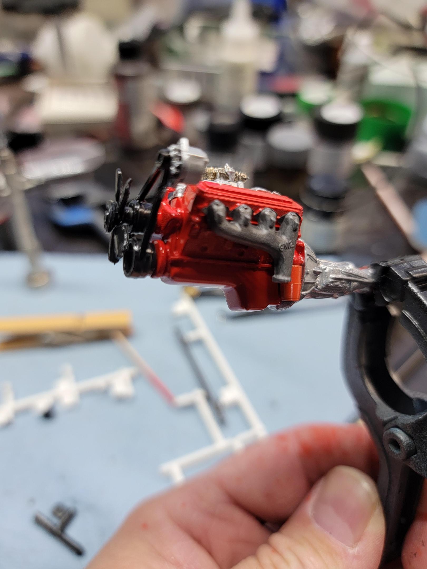

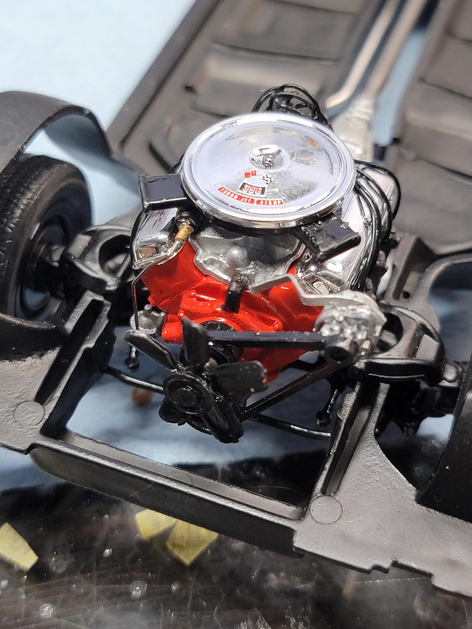

Finished and installed the engine today. Added an alternator bracket, spark plug wires and the visible parts of the fuel line for some added interest. I will be painting the headliner and the engine bay next, then polishing the body and adding the emblems.
Later-
