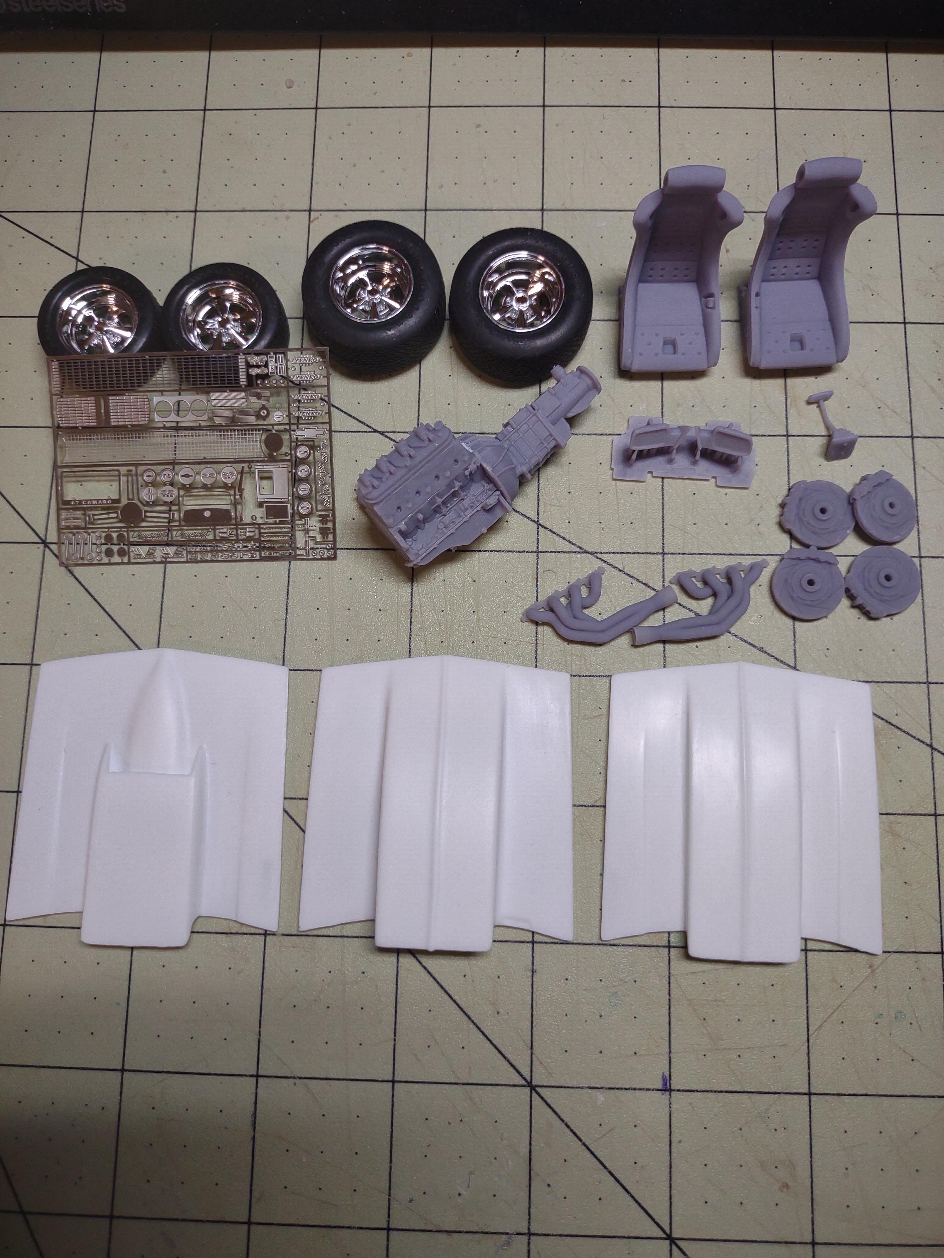

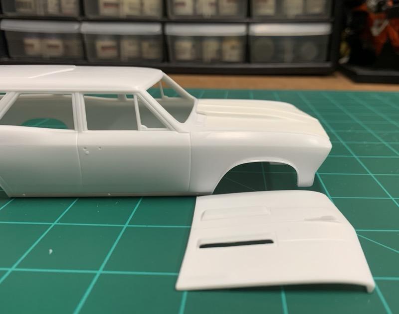

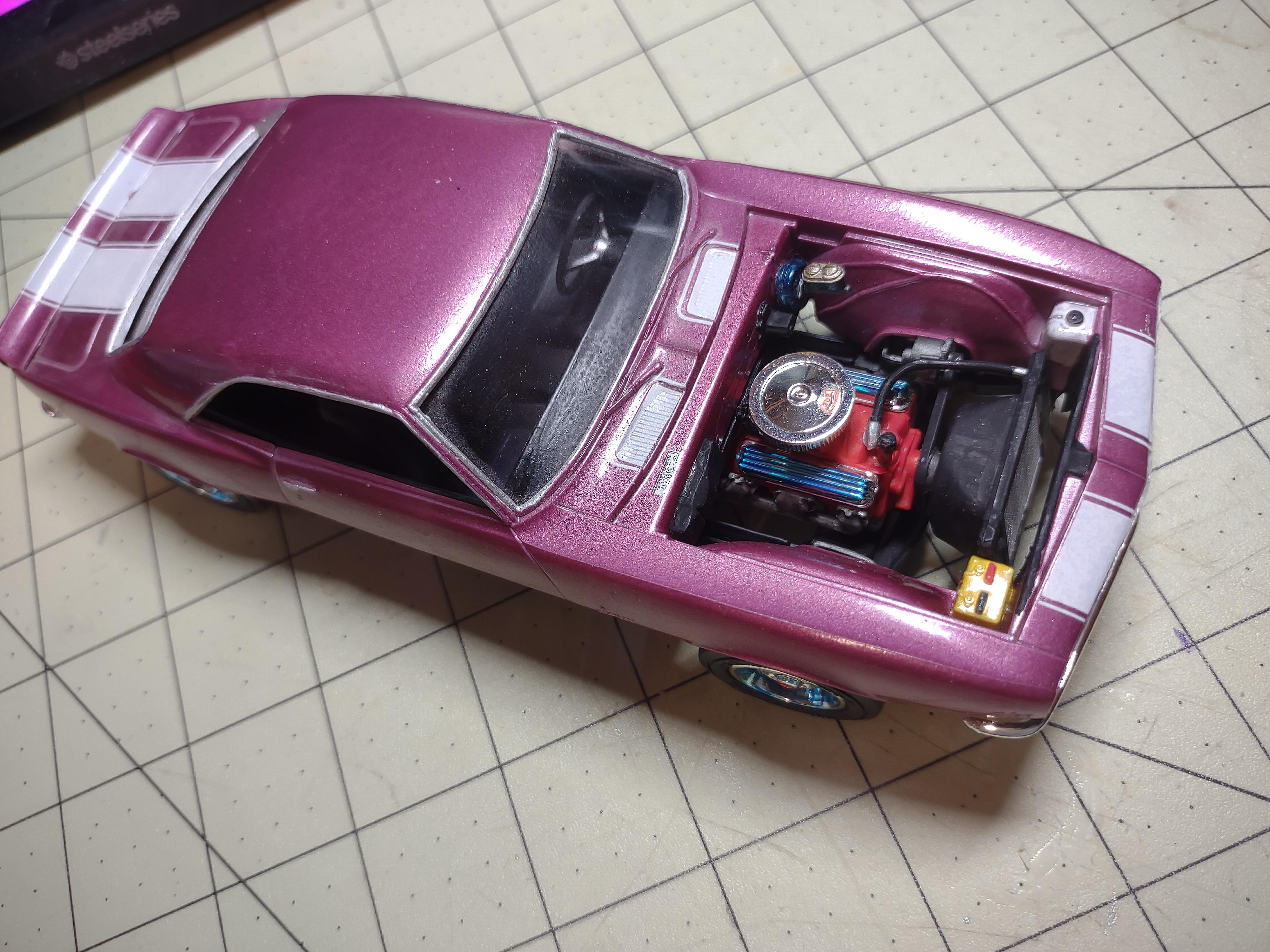

atomicholiday Posted January 11, 2024 Posted January 11, 2024 (edited) Just playing around and mocking some things up with this build this evening. Looks like I’m going to be cutting the intake manifold down a bit. Also, the resin hood I ordered is here now. I know nothing about resin, so I won’t condemn it. But I was hoping it would be a little nicer than it is. Looks better in the picture than it really is. Not sure if I want to use it or not. I think I’m going to clean it up and paint both hoods and use the one I like best. Resin hood is on the right. Edited January 11, 2024 by atomicholiday
Can-Con Posted January 12, 2024 Posted January 12, 2024 On 1/11/2024 at 10:45 PM, atomicholiday said: Just playing around and mocking some things up with this build this evening. Looks like I’m going to be cutting the intake manifold down a bit. Also, the resin hood I ordered is here now. I know nothing about resin, so I won’t condemn it. But I was hoping it would be a little nicer than it is. Looks better in the picture than it really is. Not sure if I want to use it or not. I think I’m going to clean it up and paint both hoods and use the one I like best. Resin hood is on the right. Expand Does the resin hood clear your injection setup, Jeremy?
Fat Brian Posted January 12, 2024 Posted January 12, 2024 On 1/11/2024 at 10:45 PM, atomicholiday said: Just playing around and mocking some things up with this build this evening. Looks like I’m going to be cutting the intake manifold down a bit. Also, the resin hood I ordered is here now. I know nothing about resin, so I won’t condemn it. But I was hoping it would be a little nicer than it is. Looks better in the picture than it really is. Not sure if I want to use it or not. I think I’m going to clean it up and paint both hoods and use the one I like best. Resin hood is on the right. Expand Yep, I bought the same hood from the same ebay seller and it's hot garbage.

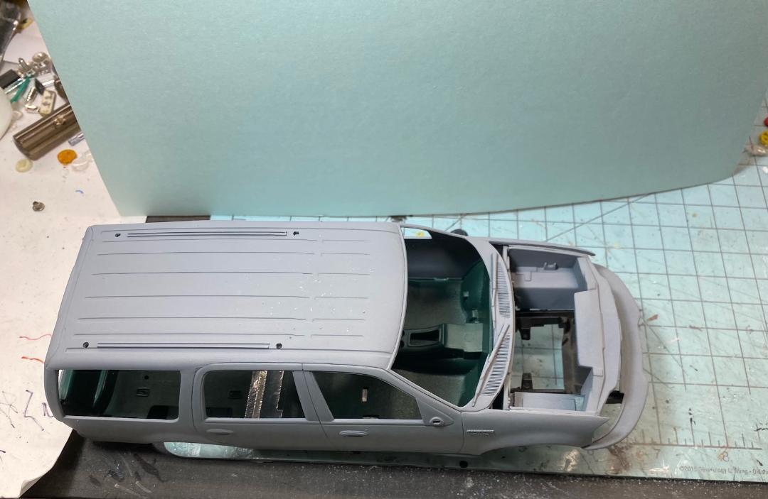

oldcarfan Posted January 12, 2024 Posted January 12, 2024 (edited) We are looking at our first really cold weather of the year here in central Texas. It's supposed to hit something like 9 degrees Sunday night. I'm starting to regret putting off buying a heater for my work area out in the shop. I wasn't planning to start on my Cannonball build quite yet as I'm waiting on some things from suppliers. However, knowing that next week will be too cold, I got started today. My selection for the Run is Revell's 1997 Expedition. As the kit is a SnapTite, I started off by opening the hood. That was as far as I planned to go today, but I came across a junk Lindberg 1997 F150 cab and frame so I thought those might work. As it turns out, the Lindberg engine bay fits very well and the frame fits, too. After that, I gave it a shot of sandable primer and will look at working on it again after the temp get back into the 50s. Edited January 12, 2024 by oldcarfan 2

atomicholiday Posted January 12, 2024 Posted January 12, 2024 On 1/12/2024 at 12:07 AM, Can-Con said: Does the resin hood clear your injection setup, Jeremy? Expand No, there isn't actually any extra clearance. The material is just thicker in the center. And the whole hood is too thick already. It'll need to be thinned down just to fit level after paint. No huge deal. I just wanted something different from the kit part. I still have an idea or two I can try. On 1/12/2024 at 1:20 AM, Fat Brian said: Yep, I bought the same hood from the same ebay seller and it's hot garbage. Expand Lesson learned. At least it wasn't too expensive. 1

Keef Posted January 12, 2024 Posted January 12, 2024 On 1/12/2024 at 1:43 AM, atomicholiday said: No, there isn't actually any extra clearance. The material is just thicker in the center. And the whole hood is too thick already. It'll need to be thinned down just to fit level after paint. No huge deal. I just wanted something different from the kit part. I still have an idea or two I can try. Lesson learned. At least it wasn't too expensive. Expand Out of idle curiosity would you mind sharing who the seller is? Does it start with an “L”?

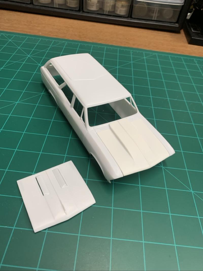

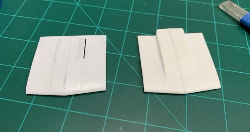

atomicholiday Posted January 12, 2024 Posted January 12, 2024 Working on the resin hood now to see if I can get it to fit properly. It was WAY too thick to use as is. A course sanding stick was used to thin the whole thing down to the same thickness as the kit hood. It’s definitely better now, but it still needs a little more work in a few areas. For instance, the raised section will need more sanded if I want wiper blades. Might need those since we’re going cross country! 2
Fat Brian Posted January 13, 2024 Posted January 13, 2024 On 1/12/2024 at 10:10 PM, Keef said: Out of idle curiosity would you mind sharing who the seller is? Does it start with an “L”? Expand Yes, it certainly does. I had heard his products had gotten better but at least this piece is still junk.
MeatMan Posted January 13, 2024 Posted January 13, 2024 On 1/11/2024 at 10:45 PM, atomicholiday said: Just playing around and mocking some things up with this build this evening. Looks like I’m going to be cutting the intake manifold down a bit. Also, the resin hood I ordered is here now. I know nothing about resin, so I won’t condemn it. But I was hoping it would be a little nicer than it is. Looks better in the picture than it really is. Not sure if I want to use it or not. I think I’m going to clean it up and paint both hoods and use the one I like best. Resin hood is on the right. Expand I used that same setup on my 67 Impala but changed the top to resemble the early Corvette injectors. you could modify yours to give it another look while reducing the height. 1

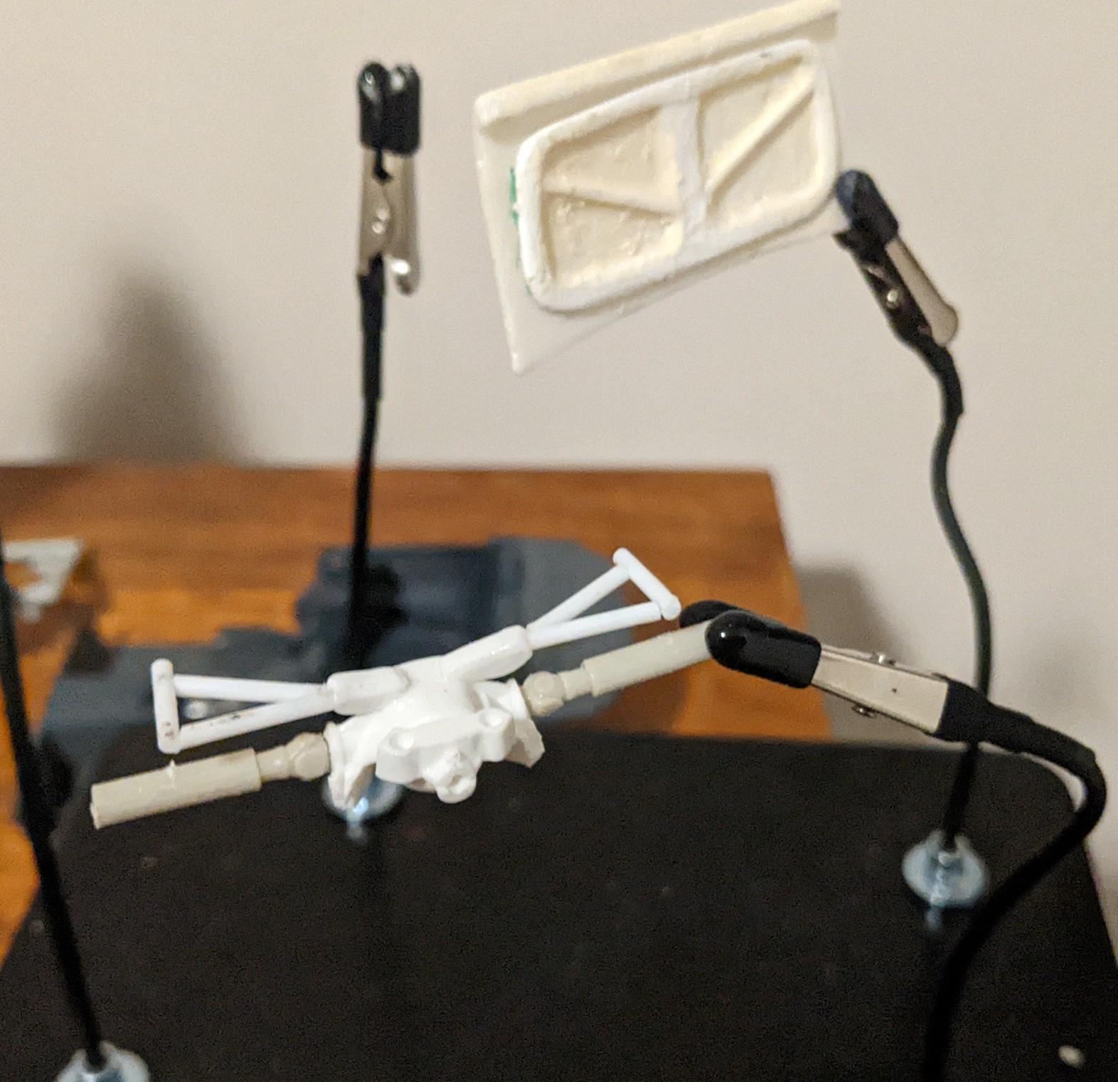

Beans Posted January 14, 2024 Posted January 14, 2024 It's trunk lid underside detail day. Also made progress with scratch building some rear suspension. Modeling it on the Shelby GT 350R suspension so it's age and make correct for the 66 hardtop. Kind looks like something from star wars. 2

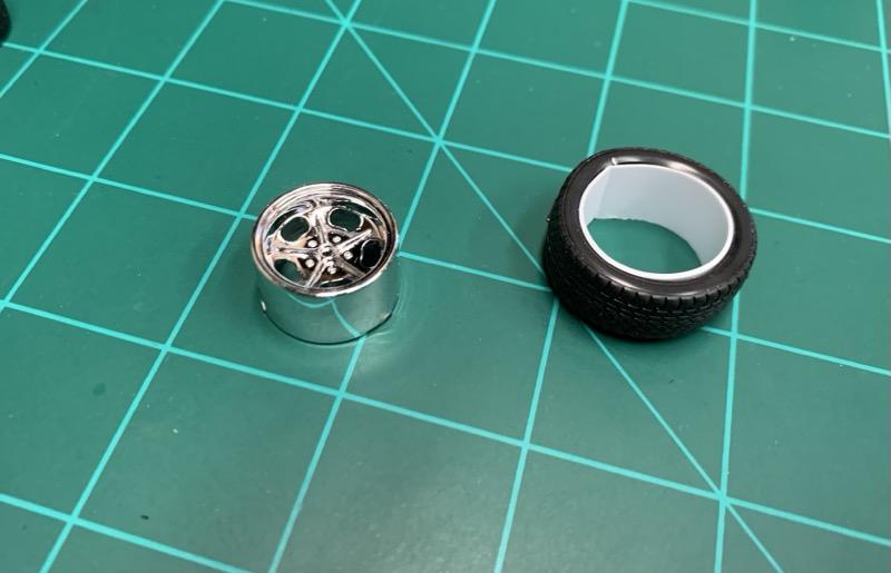

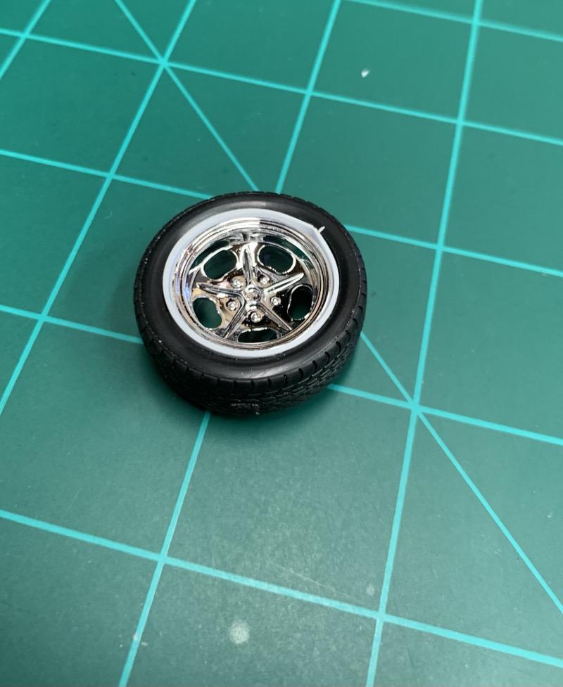

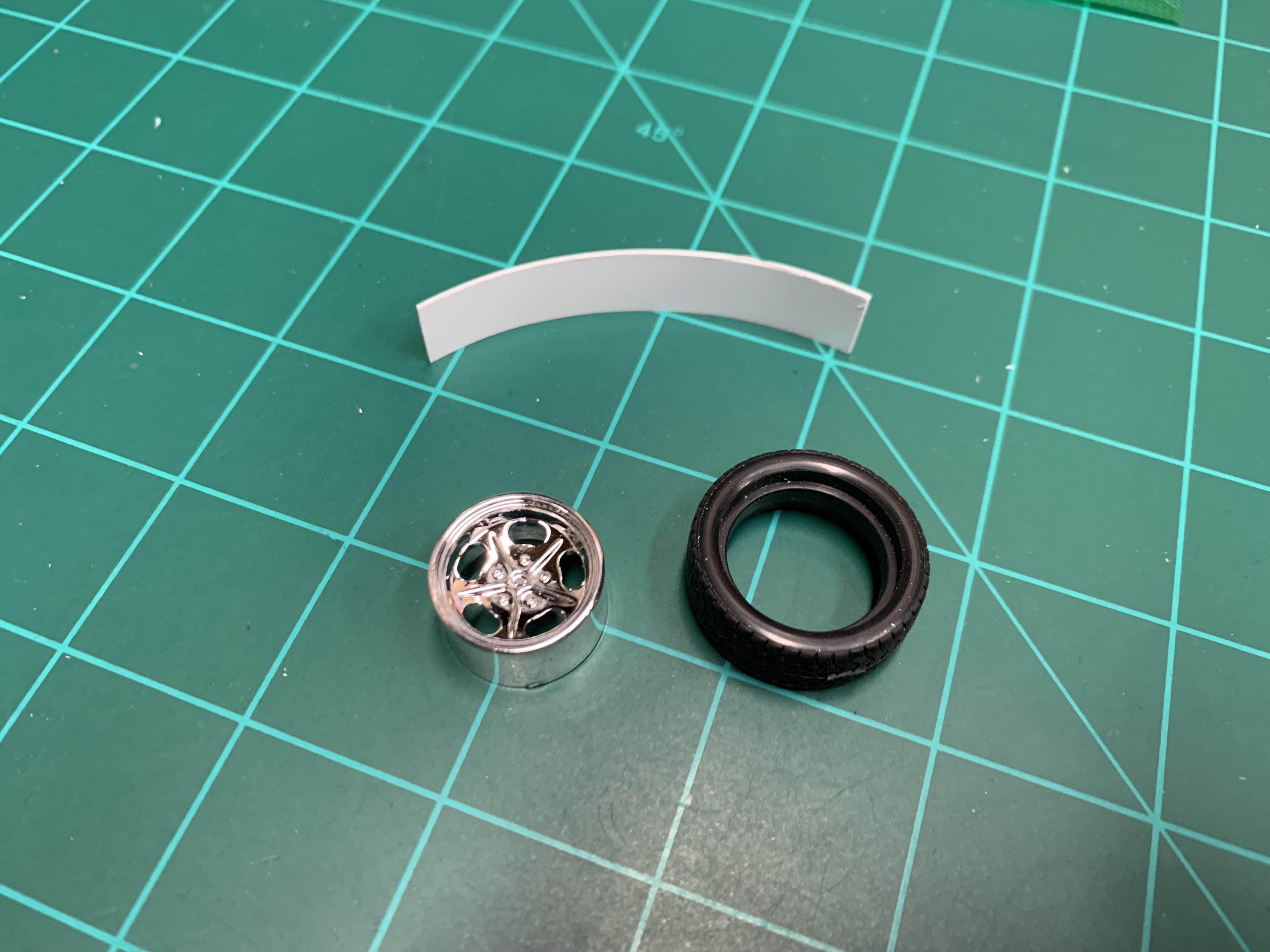

atomicholiday Posted January 14, 2024 Posted January 14, 2024 Working on the rear wheels today. The rims are too small for the tires, so I’m going to attempt to make sleeves using .02” stock. Here it is prior to any gluing or filling. Still a ways to go, but you get the idea. 2

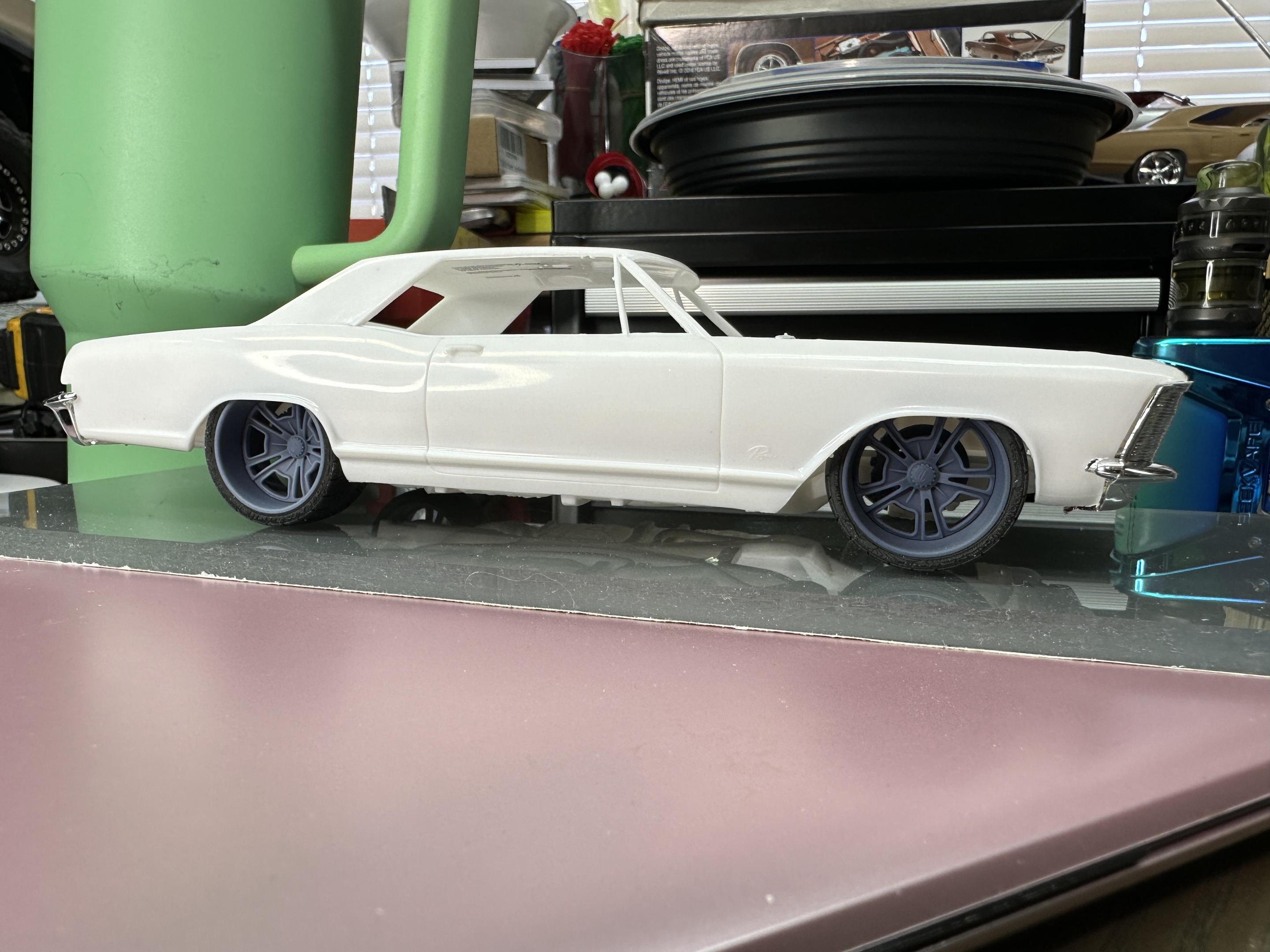

Keef Posted January 14, 2024 Posted January 14, 2024 Finally decided on my wheel choice. Got them mocked up yesterday. Going to start getting the body prepped next. Color combo will be revealed later on. Engine choice is going to be an LT4 from the AMT 94 Vette. 2
