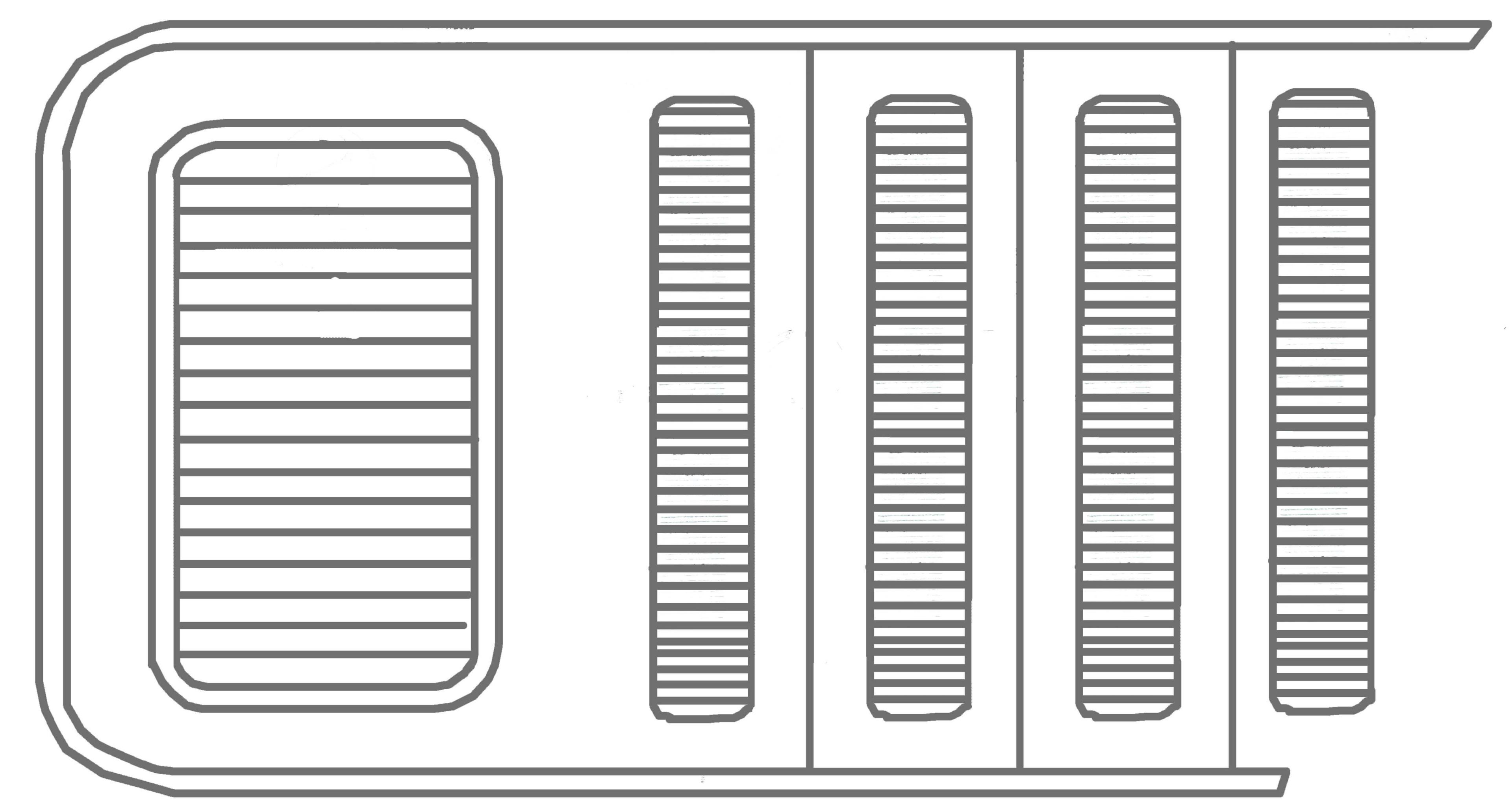

TheBEAUMONTGURU Posted December 30, 2023 Author Share Posted December 30, 2023 (edited) I have scratch built a 65 beaumont grill based off of the revell Z16 kit. It also works in the AMT wagon with a bit of mods and filler. I cut up a z-16 grill, scratchbuilt all the center section with plastruct and evergreen, then resin cast multiple copies for future projects. I did the same process for a 1967 beaumont grill, to be discussed in another upcoming thread. i resin cast and modified a GTO dash from some other crappy kit. All beaumonts use a tempest/gto dashboard in canada. Edited December 30, 2023 by TheBEAUMONTGURU typo 3 Quote Link to comment Share on other sites More sharing options...

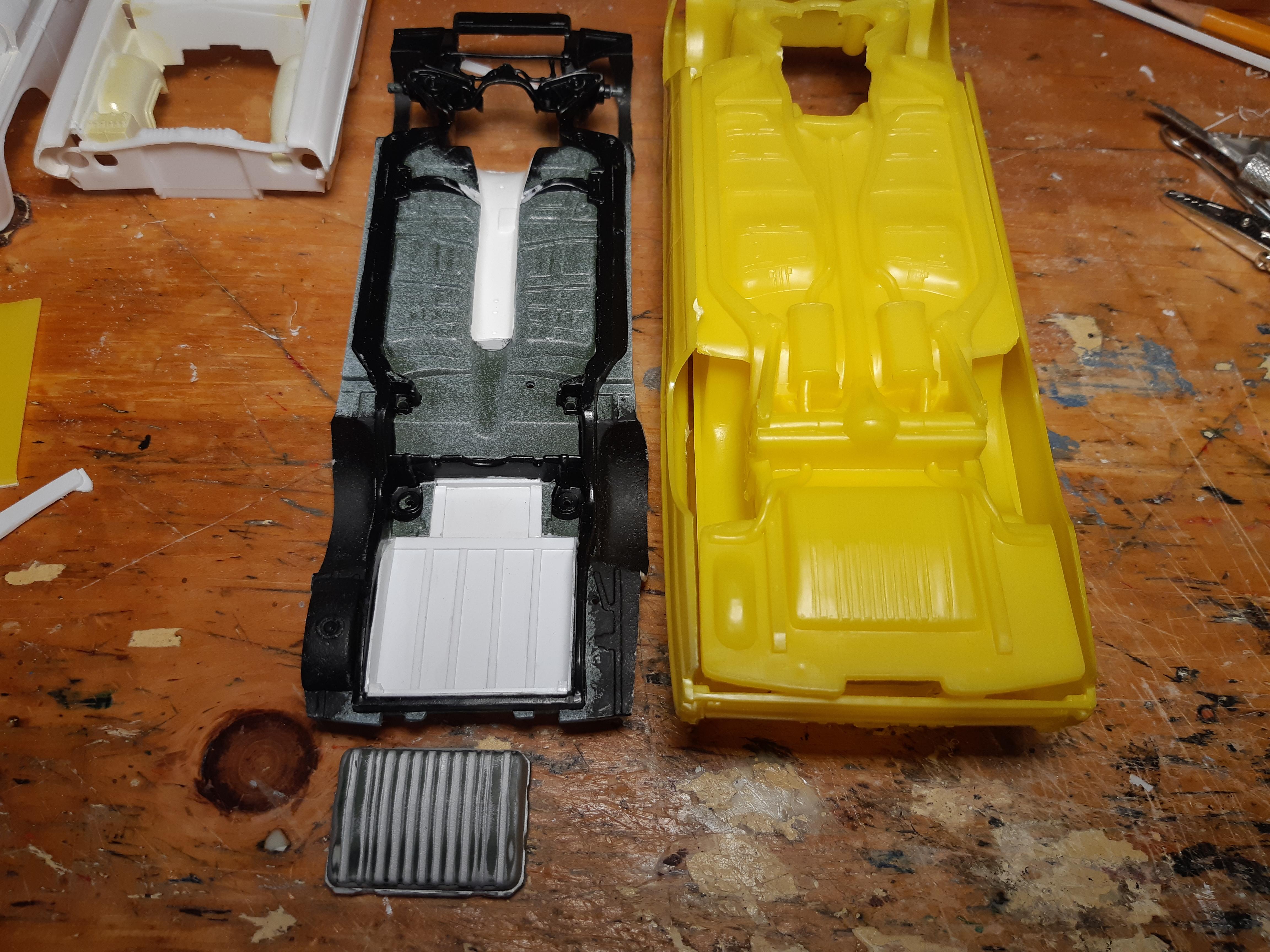

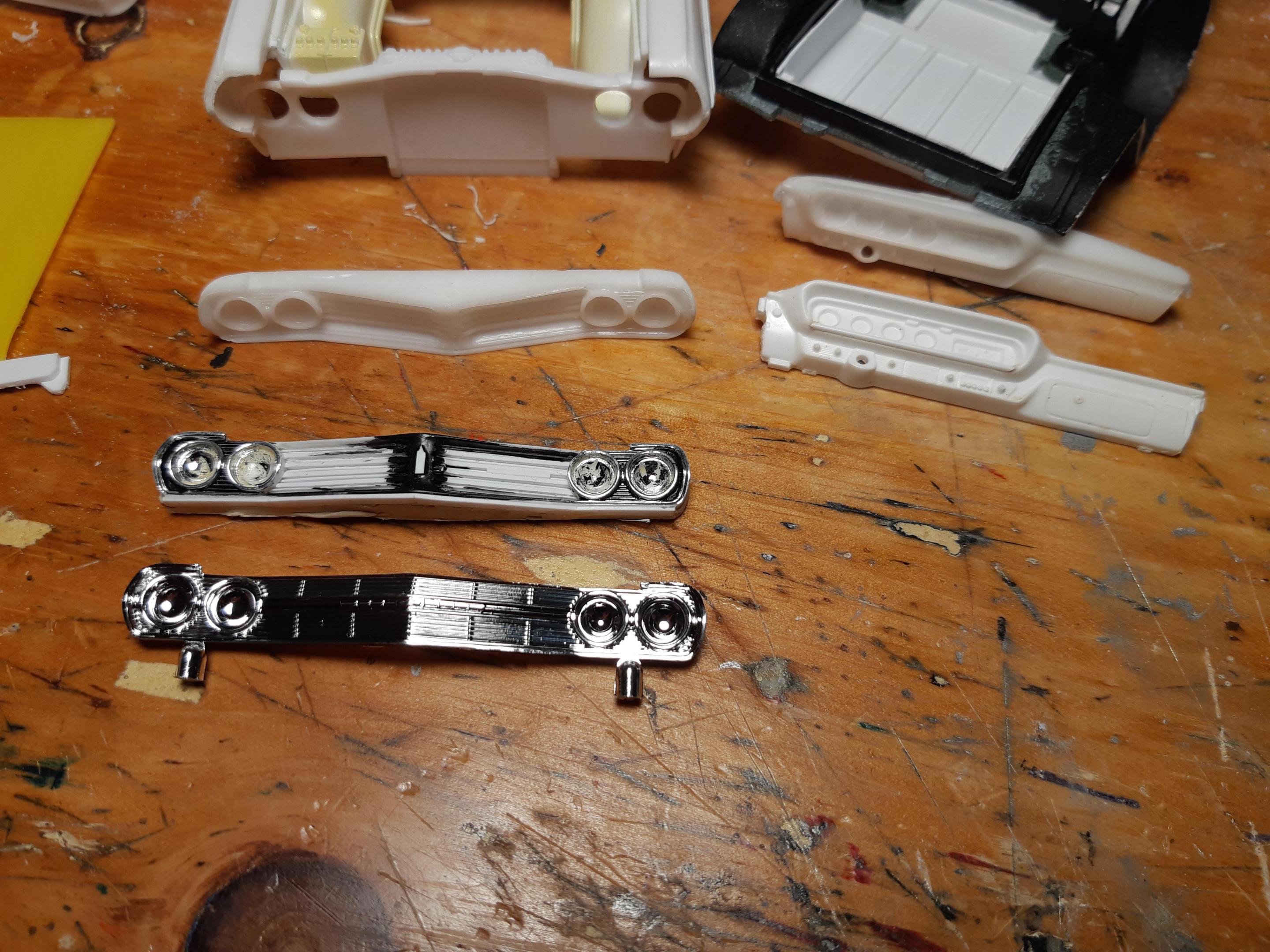

TheBEAUMONTGURU Posted December 30, 2023 Author Share Posted December 30, 2023 this AMT wagon kit is so horribly bad im going to use the entire engine bay and chassis pan from the revell 66 wagon and 65 z-16 kits. I have cut out the rear section and am making it more correct for a station wagon floor and gas tank. The z-16 rad support is going to work great along with a leftover 66 wagon engine bay 2 Quote Link to comment Share on other sites More sharing options...

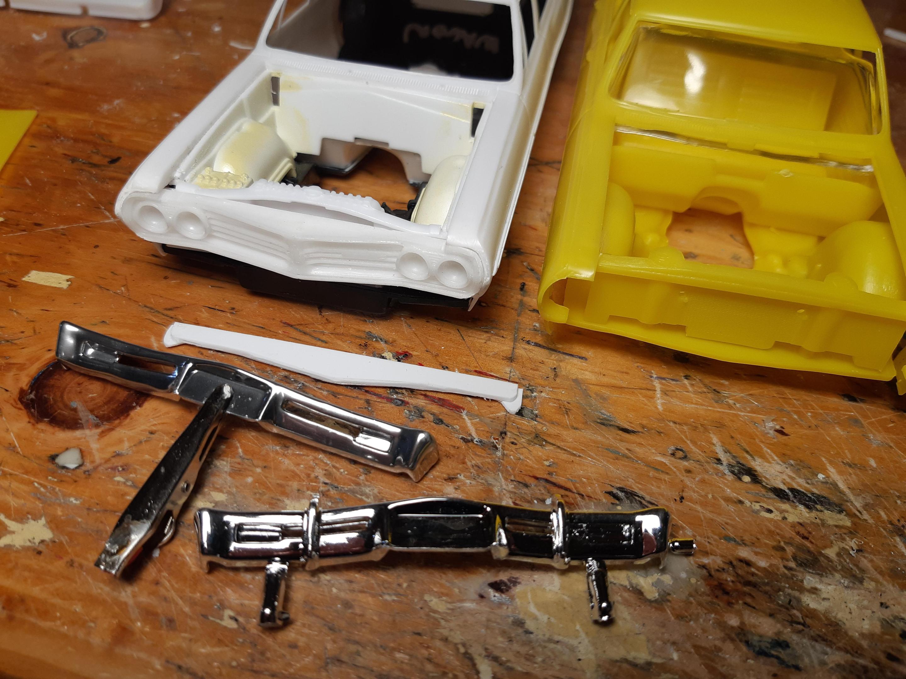

TheBEAUMONTGURU Posted December 30, 2023 Author Share Posted December 30, 2023 Here i am shaping and fitting the resin cast grill. I made a separate bumper valence panel out of sheet styrene to fill the gap between the grill and bumper Speaking of bumpers. the AMT one is BLAH_BLAH_BLAH_BLAH so i took a z-16 one and cut off the bumperguards(this is a huge undertaking for anyone that tried it. each guard is hollow in back, so you basicly have to rebuild the entire bumper and chrome it) Quite an improvement over the original yellow 1965 mold. 3 Quote Link to comment Share on other sites More sharing options...

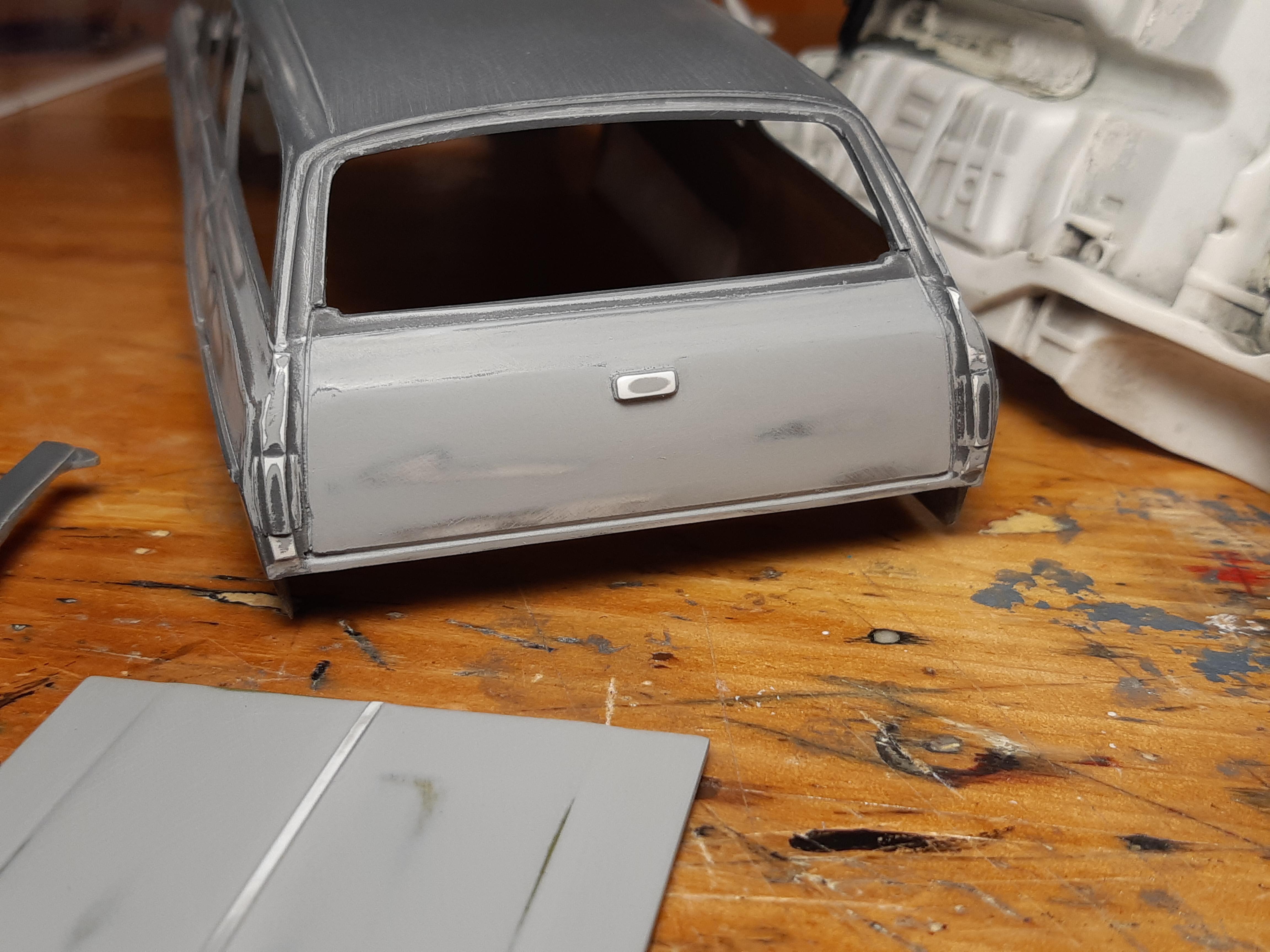

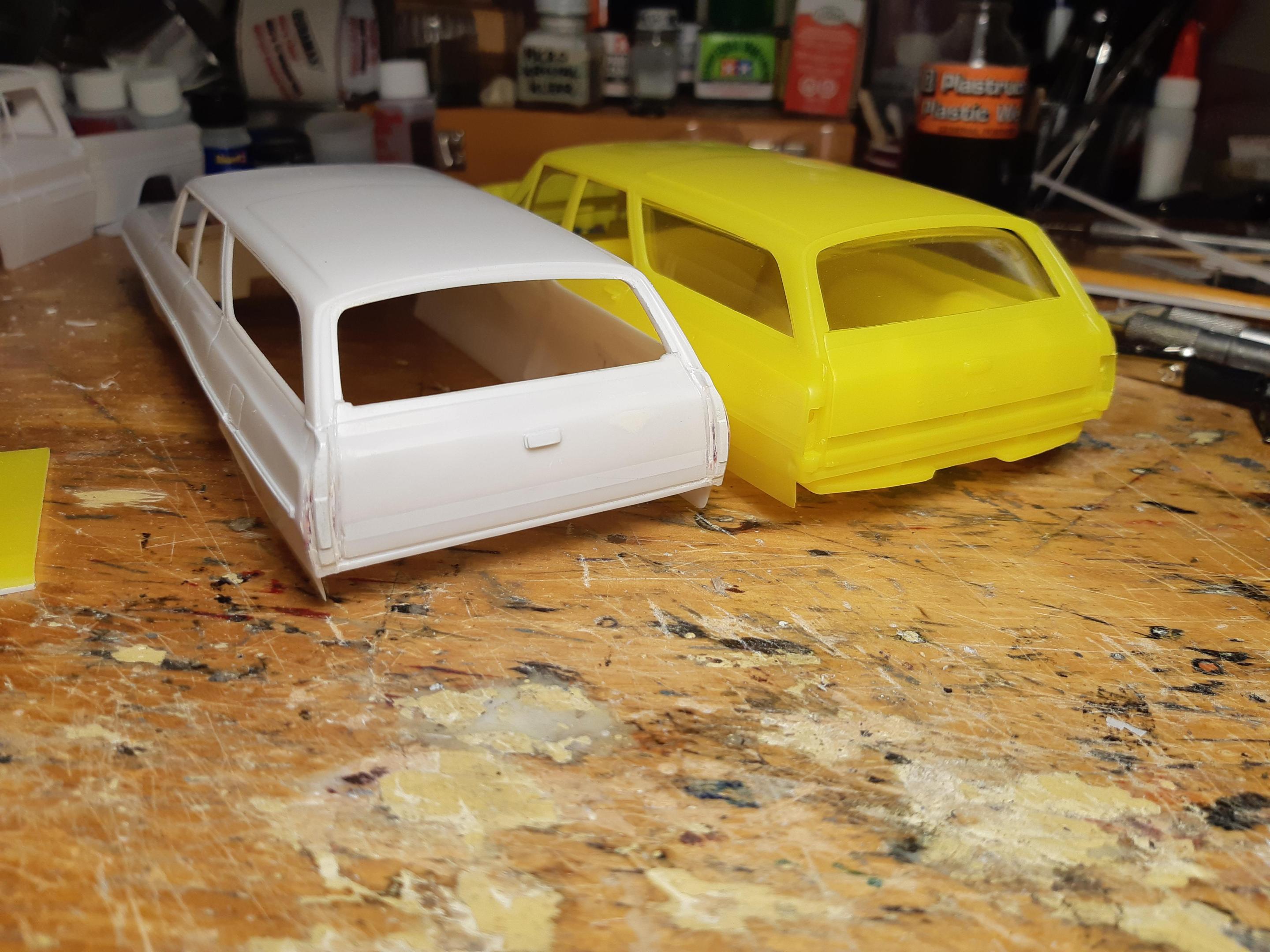

TheBEAUMONTGURU Posted December 30, 2023 Author Share Posted December 30, 2023 the back end of this kit is so badly deformed and incorrectly proportioned i decided to sand off most of the back end and rebuild it from square stock. Here we see i have filled in the tailgate chrome so i can ad the ACADIAN emblems later. I have sanded off all the chevelle side trim and built my own profile with 2 sizes of evergreen. i also have to add the missing rear tailgate glass trim surround 2 Quote Link to comment Share on other sites More sharing options...

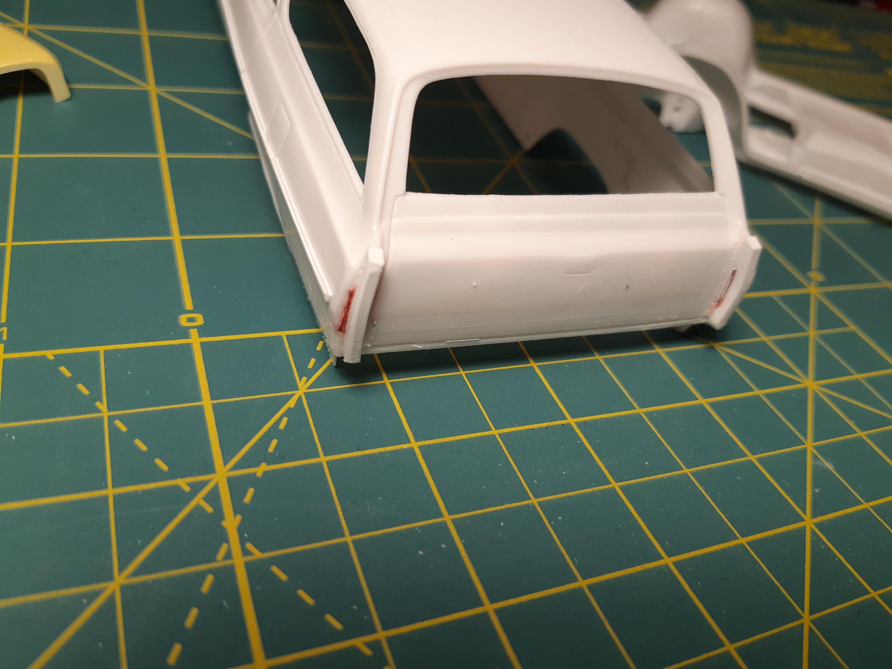

TheBEAUMONTGURU Posted December 30, 2023 Author Share Posted December 30, 2023 Lots of filing, filling and shaping. the back end is starting to take shape, i made a new gate handle and added the window trim, i also had to rescribe most of the door and window trim lines as they are so shallow on this body. this show the comparison to the yellow original kit. Trust me, mine is way better shaped now! 2 Quote Link to comment Share on other sites More sharing options...

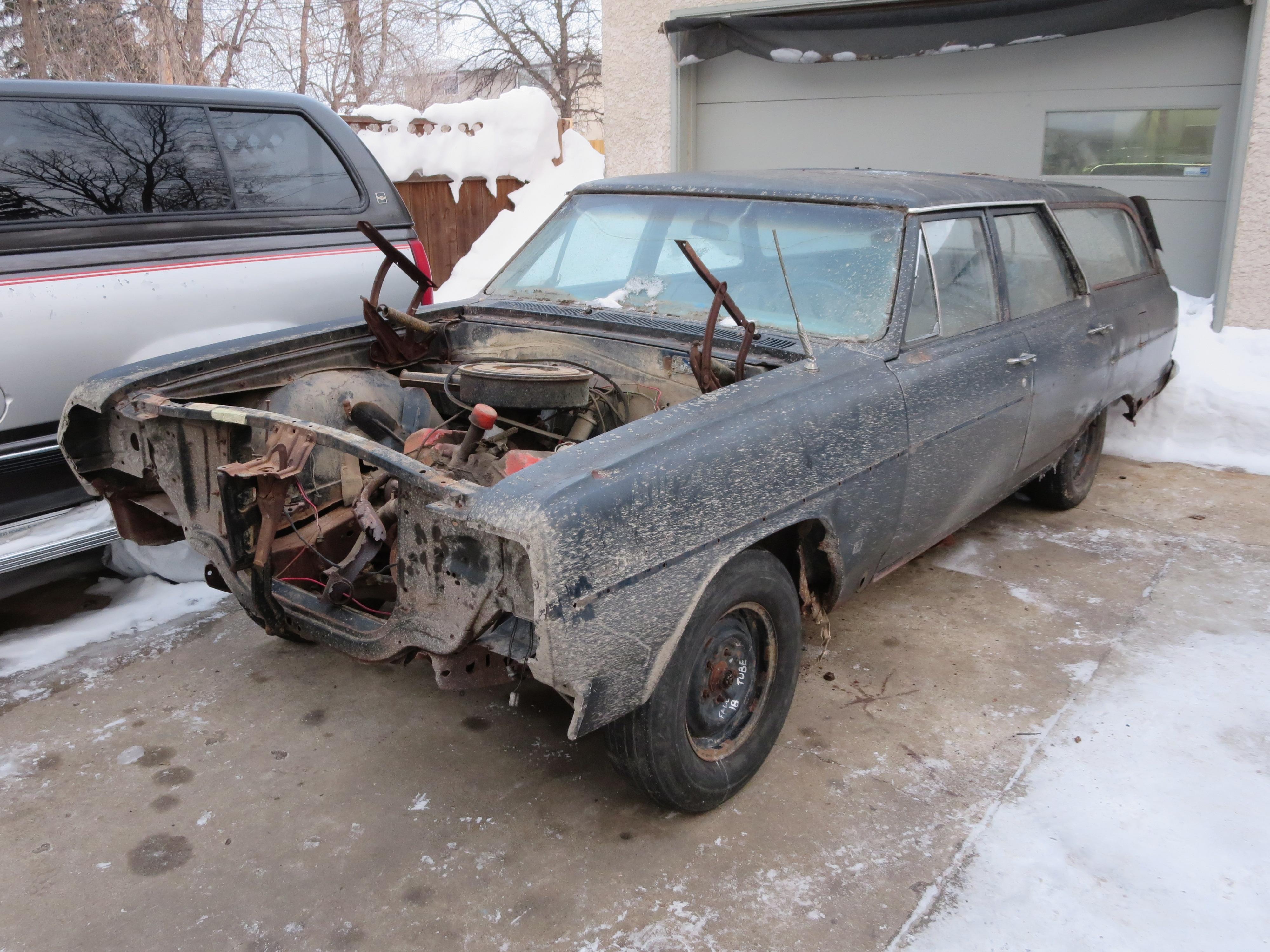

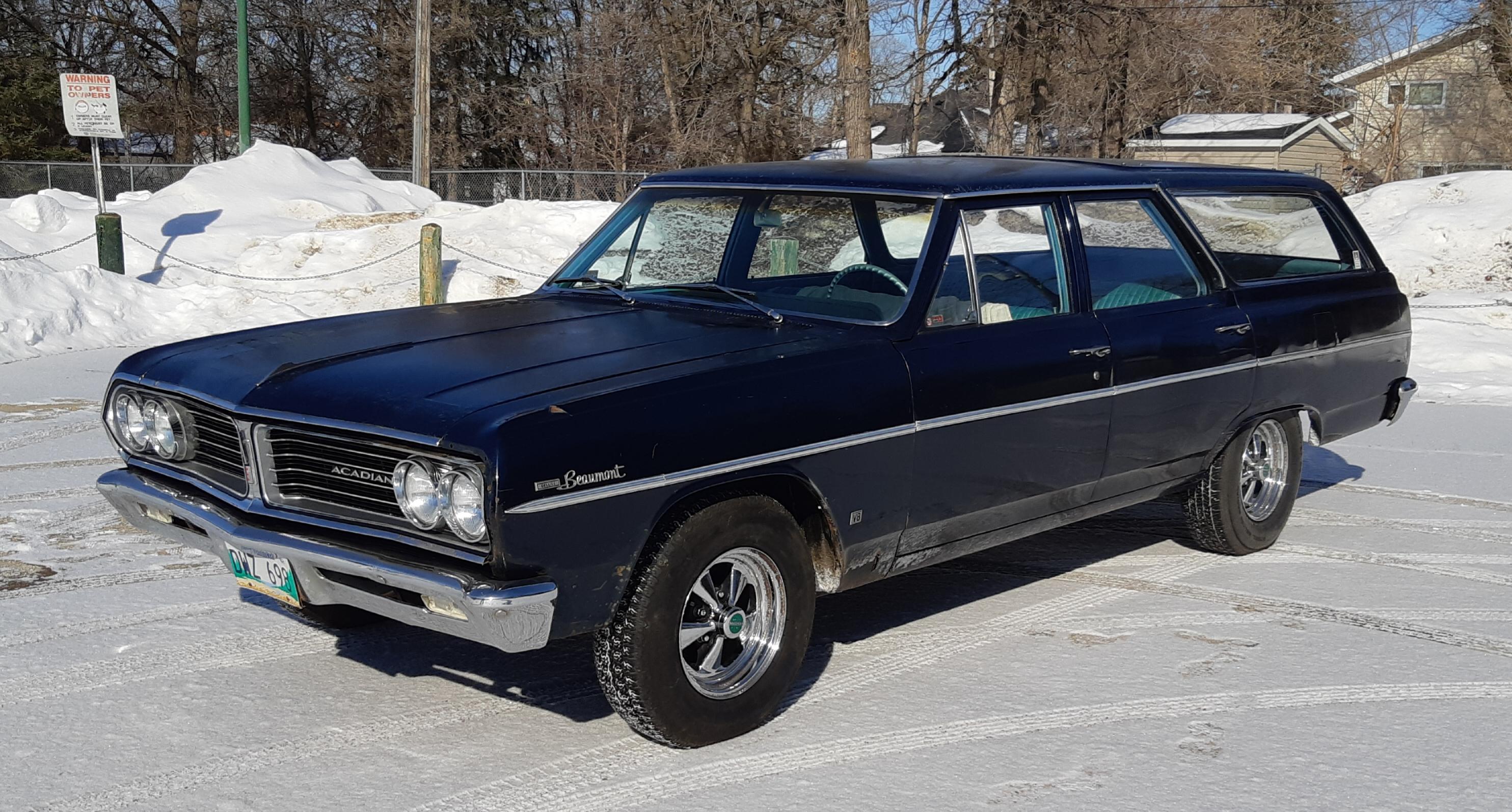

TheBEAUMONTGURU Posted December 30, 2023 Author Share Posted December 30, 2023 (edited) here is my real car that i built from the ground up a number of years ago. Before and after note the dent on the top of the front fender. I managed to salvage the original Danube blue paint. Edited December 30, 2023 by TheBEAUMONTGURU typo 5 Quote Link to comment Share on other sites More sharing options...

Duddly01 Posted December 31, 2023 Share Posted December 31, 2023 The current image of your real car is the same paint saved? Amazing job! Quote Link to comment Share on other sites More sharing options...

TheBEAUMONTGURU Posted December 31, 2023 Author Share Posted December 31, 2023 1 hour ago, Duddly01 said: The current image of your real car is the same paint saved? Amazing job! yes about 90% . only blown in where rust was repaired. Quote Link to comment Share on other sites More sharing options...

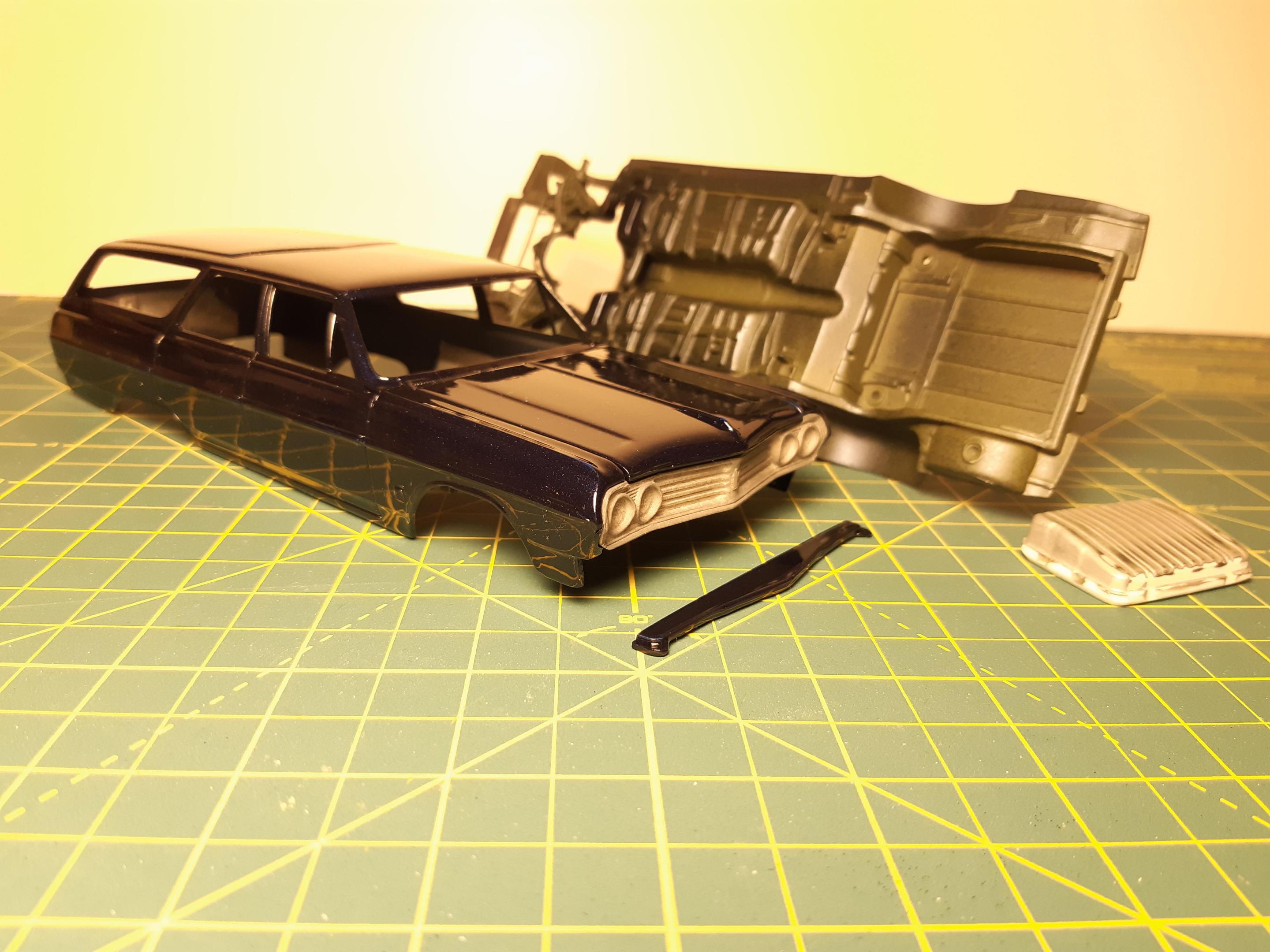

TheBEAUMONTGURU Posted January 20 Author Share Posted January 20 got some primer on it and painted finally. I used the real paint from the real car. PPG Omni GM 1965 Danube Blue. It got a bit orange peely. will block out some, but overall its good enough. the modified floor pan worked out good, just have to paint the frame now. 7 Quote Link to comment Share on other sites More sharing options...

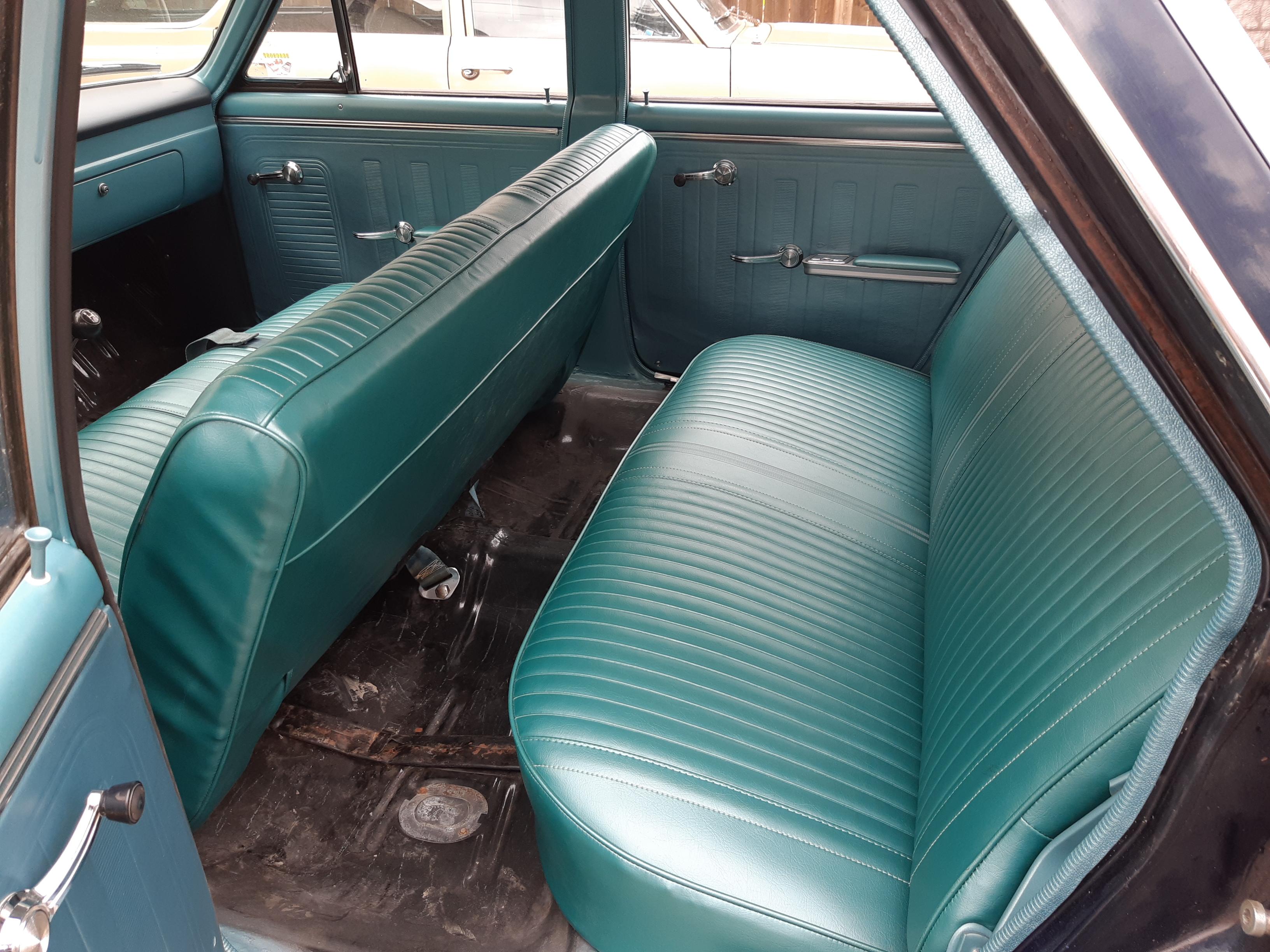

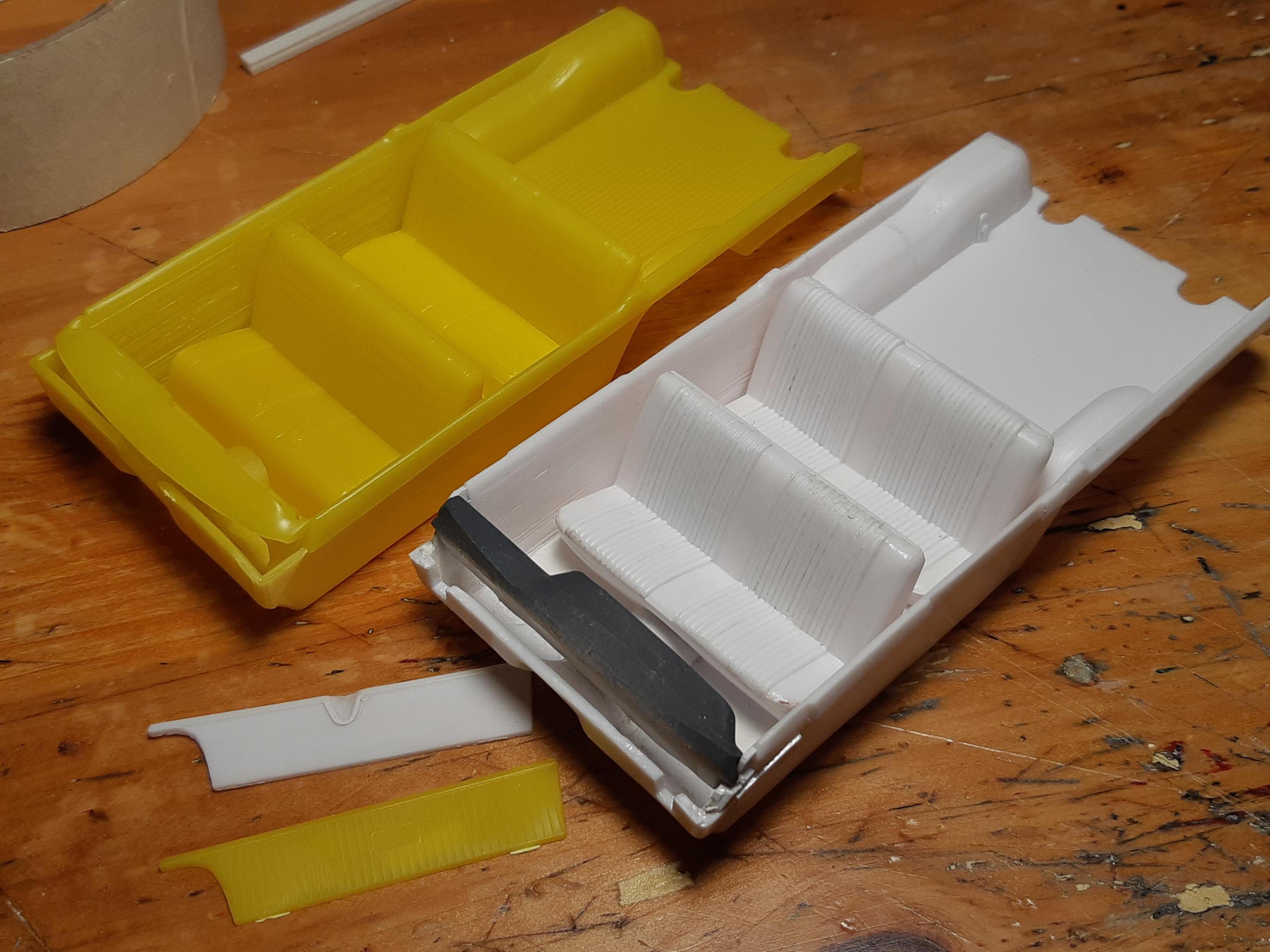

TheBEAUMONTGURU Posted January 29 Author Share Posted January 29 Starting in the interior, cut out the seat and sanded all the patterns off the seats and doors, making all my own patterns. Used 2 packages of .040 1/2 round to make all the pleats. Also scribed the rear cargo panels more correctly, added the spare tire cover latch. also complete redo of AMT's epic failure of the tailgate inside panel. Not even one thing correct about the model part! And of course the Dashboard swap to the Beaumont "Lemans/gto" one. Photoshopped up a set of door panel decals that will replicate the embossed pattern unique to a "beaumont custom" 5 Quote Link to comment Share on other sites More sharing options...
Steve H Posted January 29 Share Posted January 29 Those pleats on the seats alone represent a ton of work. Sheesh. Great stuff going on here Dave, enjoying watching your progress. Steve Quote Link to comment Share on other sites More sharing options...
Nazz Posted January 29 Share Posted January 29 Very interesting project DA. I will be following this one for sure! I have a '67 I would like to build. Can you tell me what materials and sizes you used to do your '67 grill? This will probably be the only '65 Beaumont on this forum! Jerry Quote Link to comment Share on other sites More sharing options...
