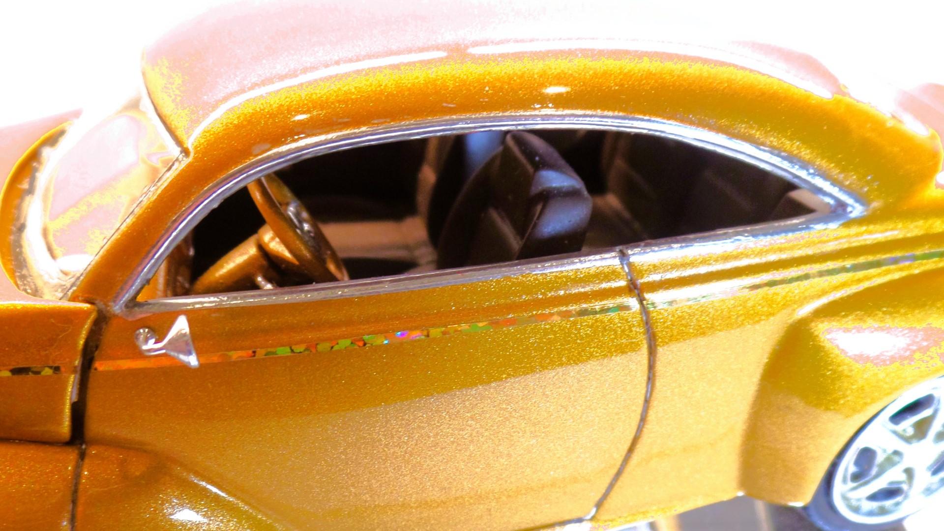

Made a couple of mods to the interior, adding some Evergreen half round on the door cards and then some wood decals for extra visual effect (although hardly visible).  Also added same wood decals on the dashboard plus BMF for the vents.  For the carpeting, I masked off the areas not to be carpeted and then sprayed Krylon Stone Texture Paint.  The color I chose gave a mottled brown color that looked right for what I wanted.

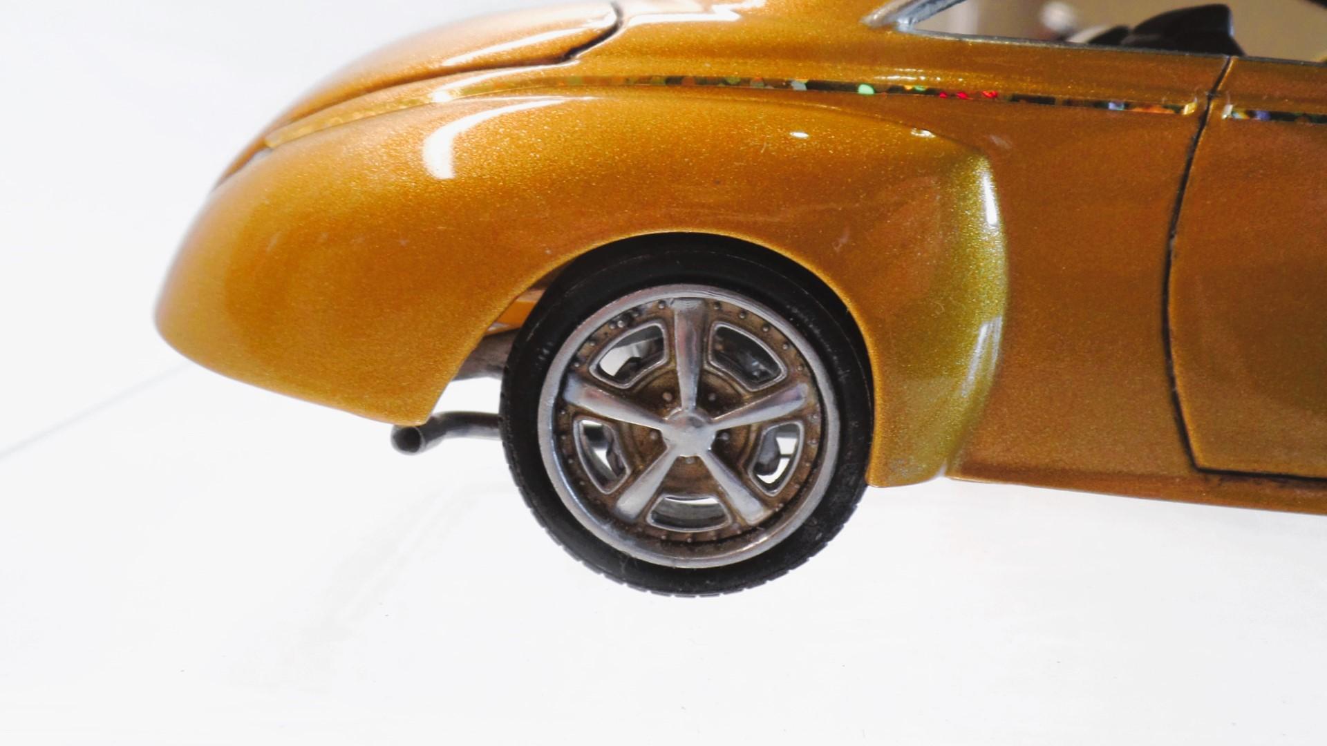

I appropriated the aftermarket big and little tires from a Revell 69 Camaro kit.  Wheels are 3D printed from Off the Sprue.

The exterior color is Testors Inca Gold coated with their Wet Look Clear.  At the last minute I added the metallic stripe for some extra zest.  The tape is usually used for fingernail art.  I acquired a set of tapes to use on another model and decided this would be a good addition.
