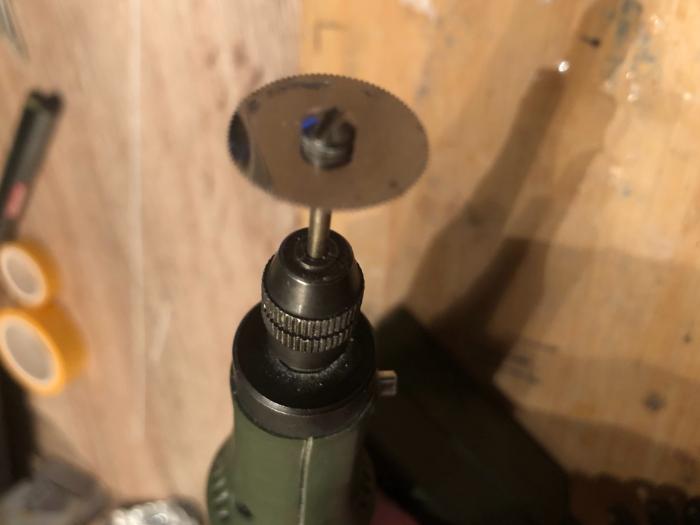

21 hours ago, milo1303s said:
You say Dremel to cut that  what are you cutting with and at what speed ?
Actually, it‘s a Proxxon motor tool
but it‘ basically the same as a Dremel. When cutting, I use this little circular saw
at speed stage 2 or 3. Sorry, I don‘t have clue what rpm that is but  it cuts through styrene like a hot knife through butter...

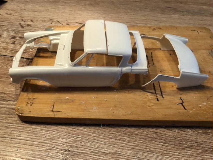

I decided to stick to my original plan and to shorten the body first before I chop the top. I cut the body in half and removed the section between the rear door lines and the rear roof pillar...
...and glued it together again:
Next step will be to shorten the rear window and to move the rear wheel wells forward, so more cuts will happen here:

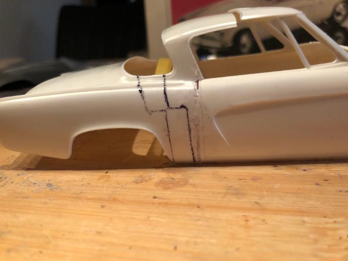

Now that I took off some material from behind the rear pillar...
...I still think it is not short enough, yet. I engraved new, curved door lines and again I marked the area where I want remove material from between the doors and the rear wheel wells  and to shorten the trunk a little bit:

Some nice slicing and dicing going on here!👍 Not that you need any advice from me…but I think that door line would look better straight (not curved), to match the angle of the back of the cove and front edge of the rear wheel opening. I’ll follow along ‘cause I love this kinda stuff!😎

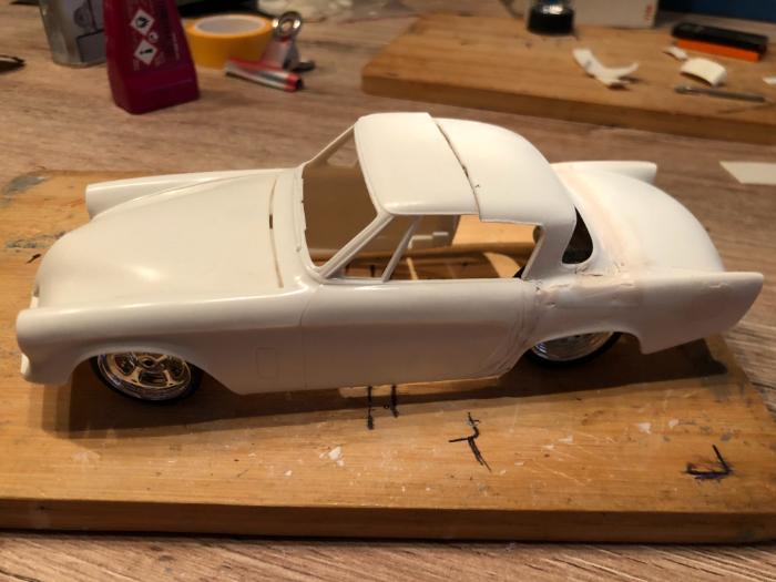

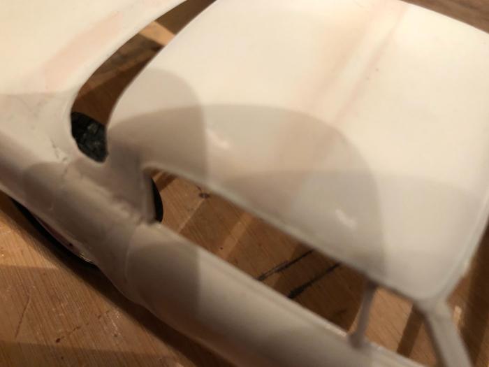

I compared my previous body work with the Stanford rendering and realised that it won‘t meet exactly the proportions Steve Stanford had drawn. I guess I should have taken out some material from the door and trunk areas but I will continue to try to build a nice looking sport coupe with a more daily use suitability and decided to perform the top chop a little bit less aggressive. First I lowered the rear section of the roof:
And continued with the front:
The resulting gap was filled with a piece I cut from the middle of the roof earlier:
Now the real putty and sanding orgy can begin...

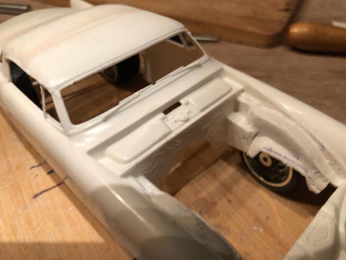

After some dusty hours of sanding, "Stoo Short" is taking shape slowly:
I lost a lot of the drip rail details during sanding, so I made new rails from small diameter Evergreen rod:
Under the hood I scratch built new inner fender arcs:
And I also frenched the headlights:
I‘m pretty sure I will have to do some touch ups here and there, a coat of primer will tell. But first I want to take care of the  interior tub and the chassis plate...

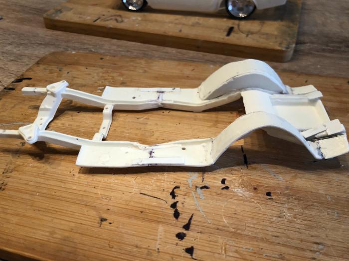

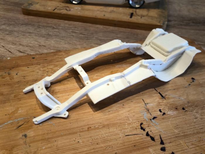

Health issues are keeping me away from the work bench but I got a few things done. The chassis plate...
...has been shortened and I scratch built rear wheel tubs:
The interior tub...

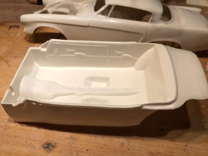

has been shortened, too:
...featuring scratch built wheel tubs, too. Scale Production seats...

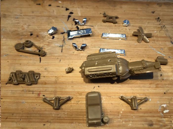

Also decided to use this engine:
which came from the amt 1972 Corvette Street Machine kit
