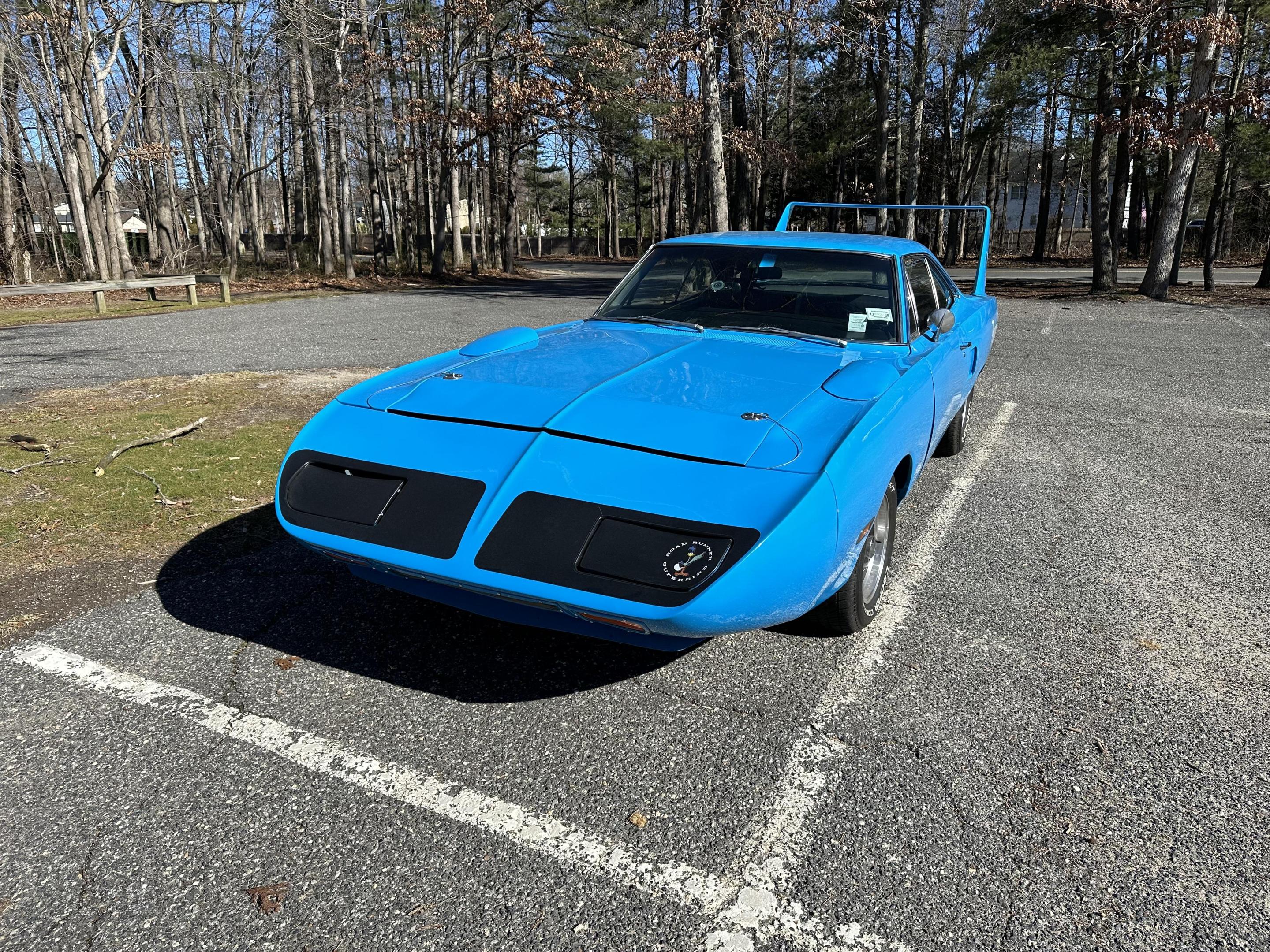

This past December I took delivery on my dream car! A 1970 Plymouth Road Runner Superbird Tribute car!

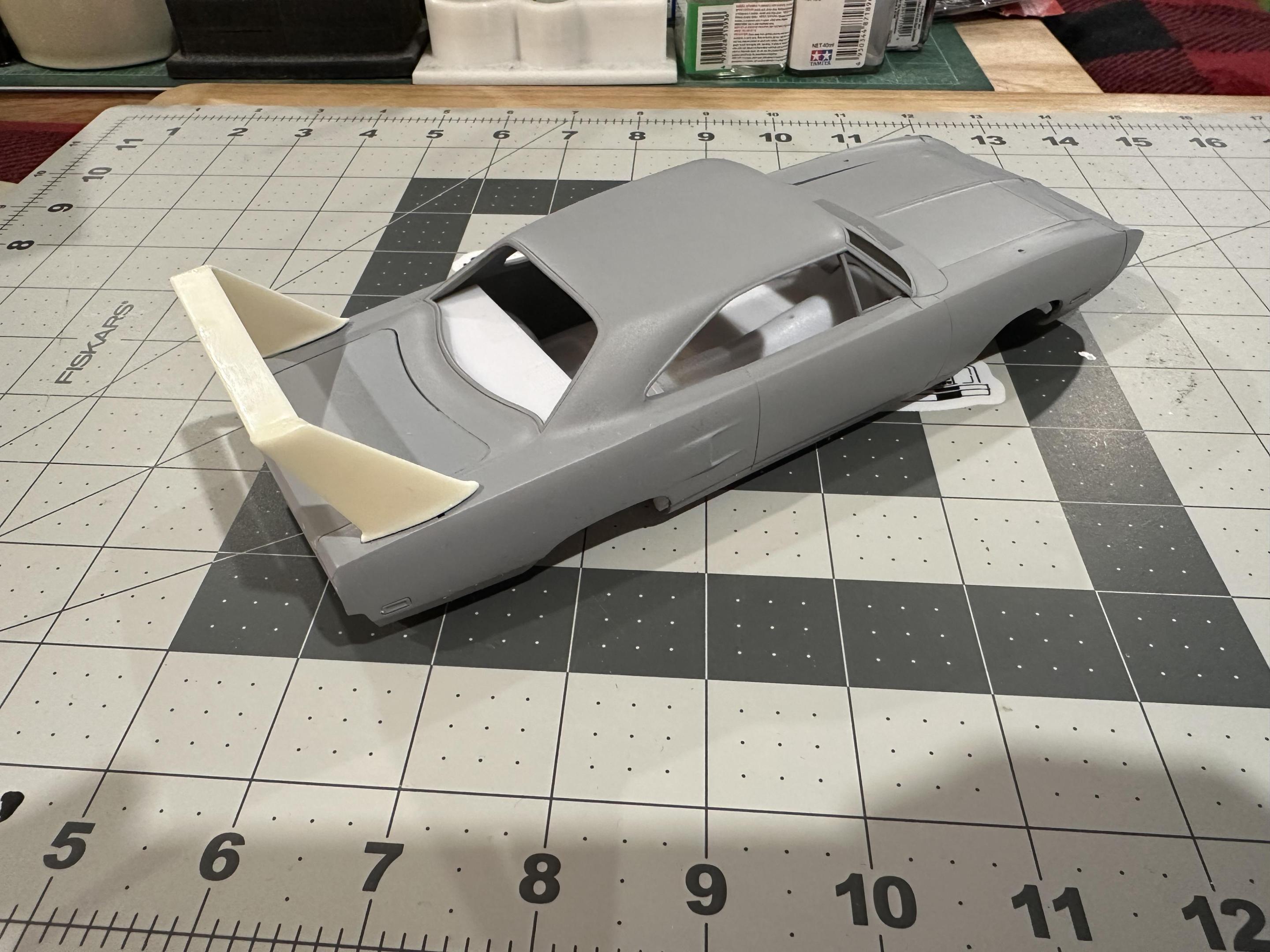

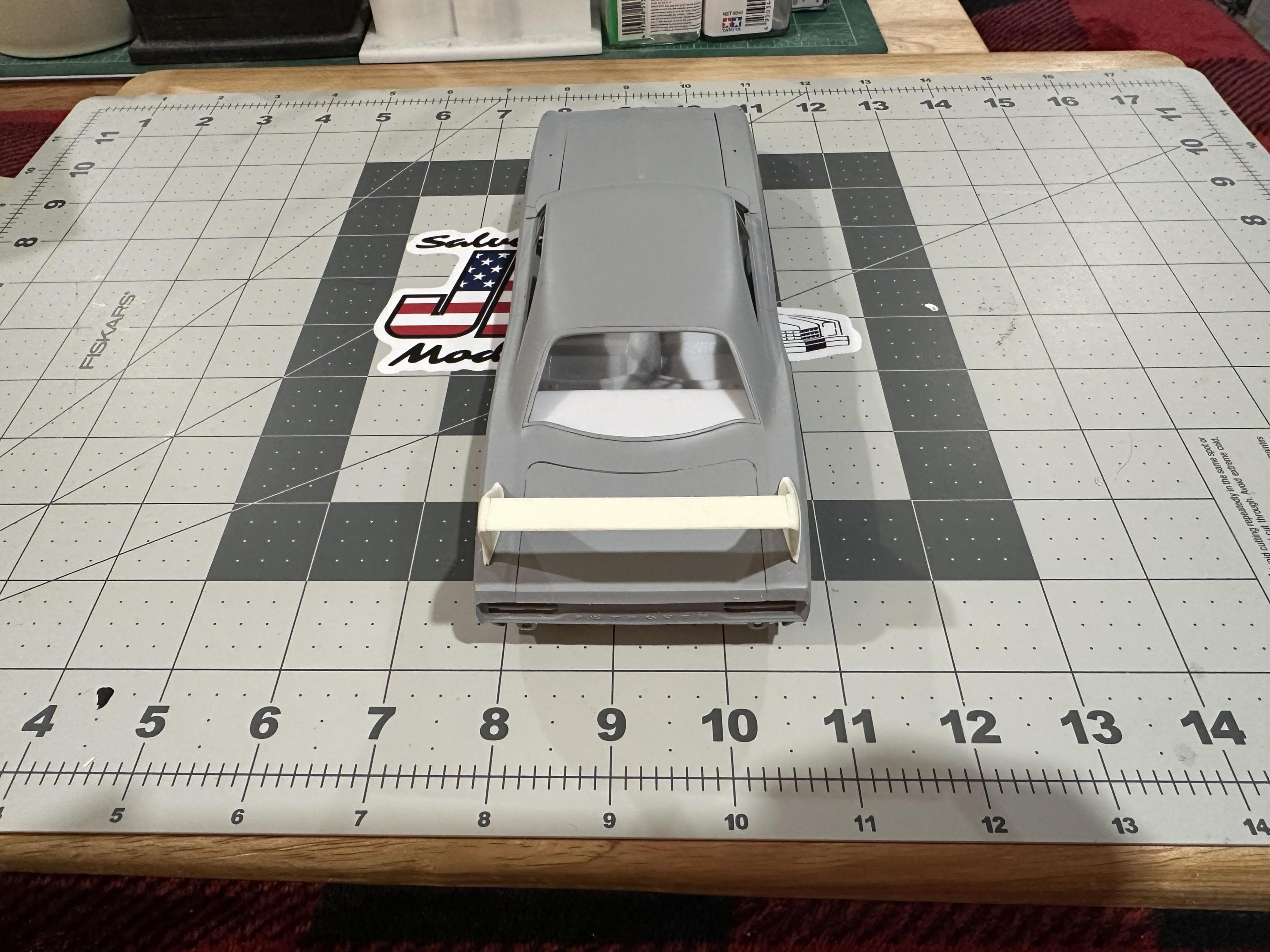

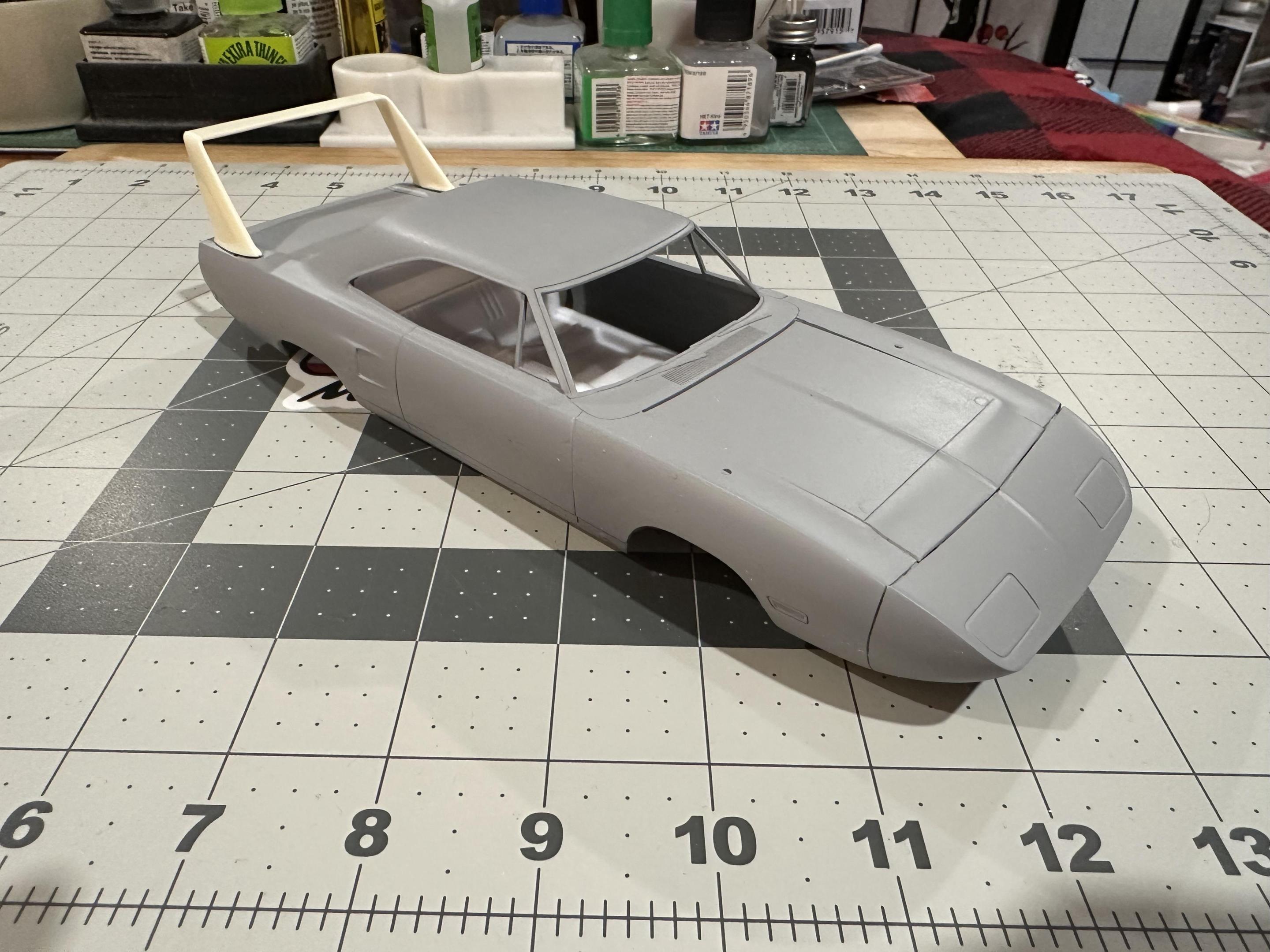

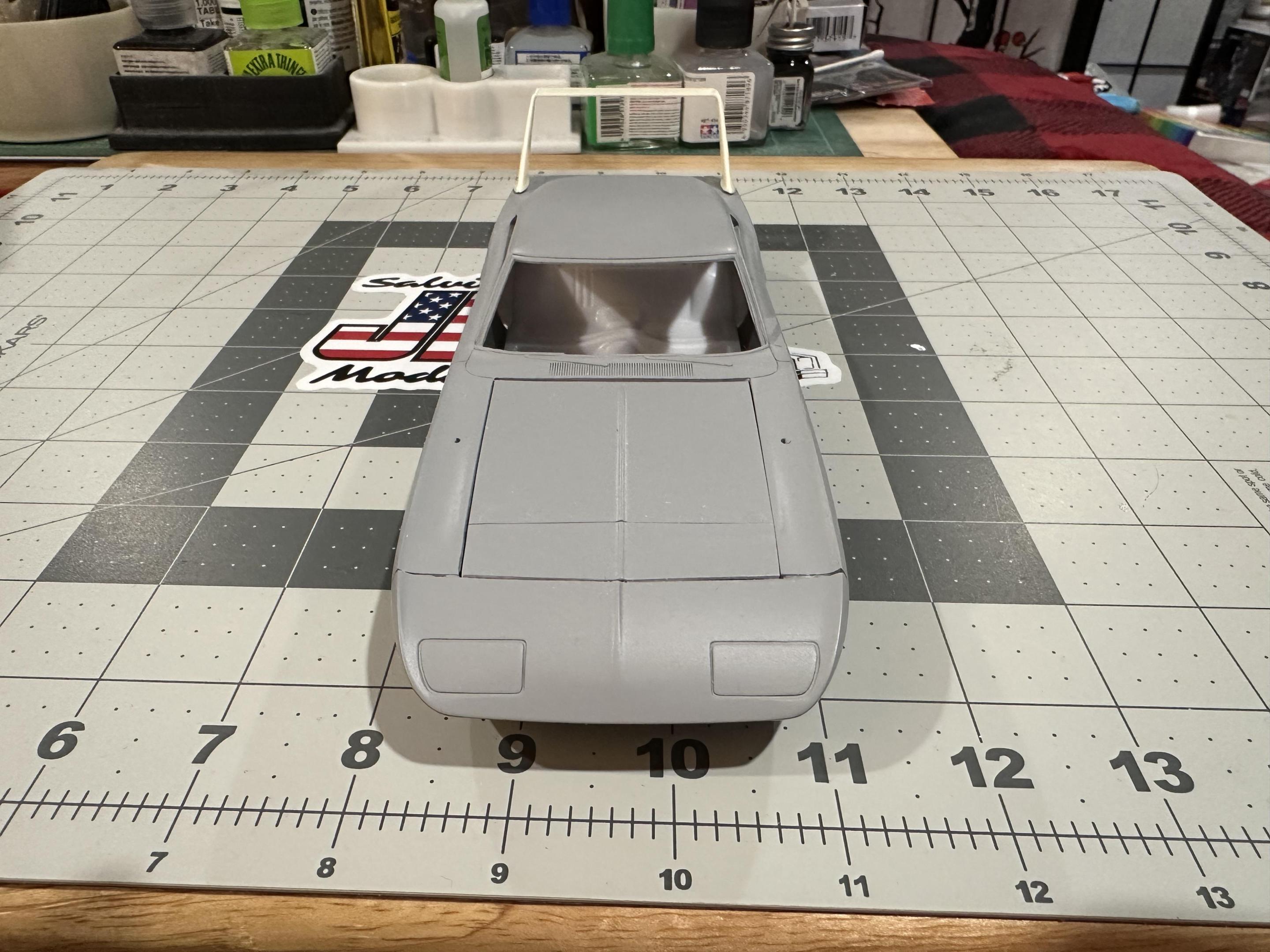

I started with a Jo-han Superbird body I had laying around. I also had a destroyed 1970 GTX promo to source the back window from.
Many years ago, I resin cast all of the parts for the Superbird in 25th scale. I found that the Monogram nose fit right on the Jo-han kit, with slight tweaking. I also cast the wing and scoops from the Jo-han kit.
Believe it or not, the Jo-han wing actually scales out better for the monogram kit, then its own wing does!

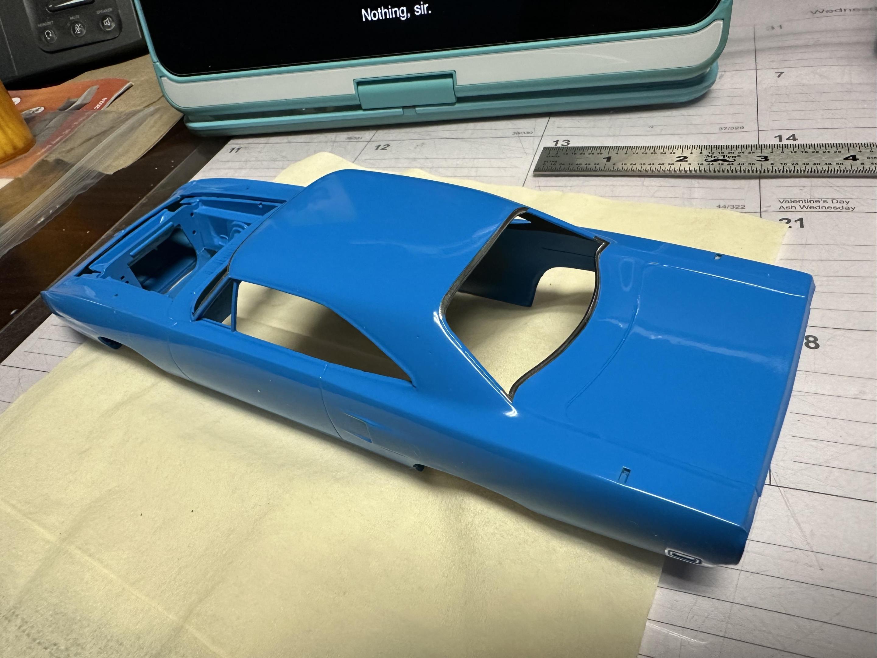

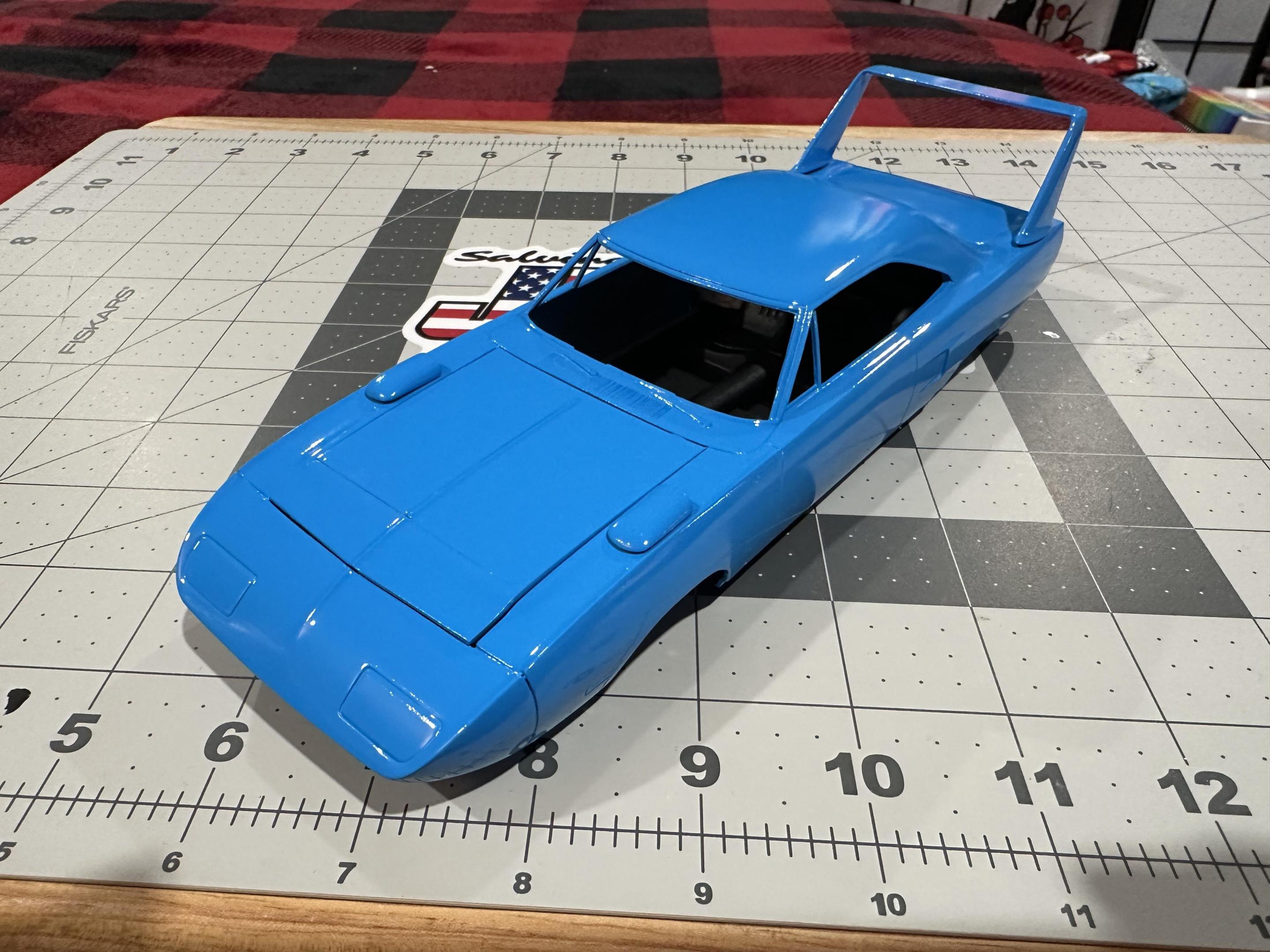

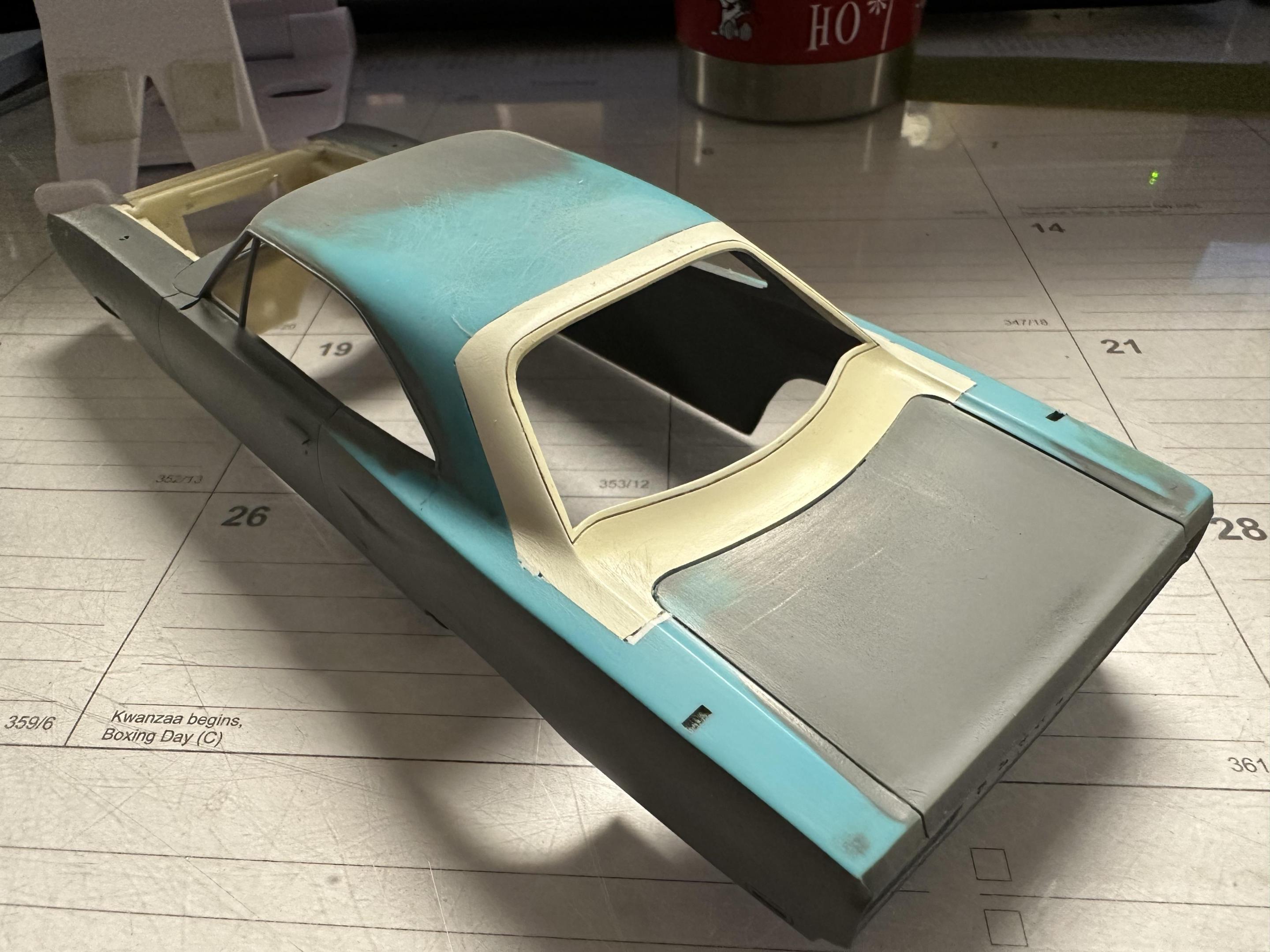

Here is the body in the first paint job. I ended up sanding in the whole thing down and then using this as a base color. And then put another three coats over this. Paint is Tamiya TS 23. IMG_8809.thumb.jpeg.f60b4fc9277bd462203e126f4a8e9f30.jpeg

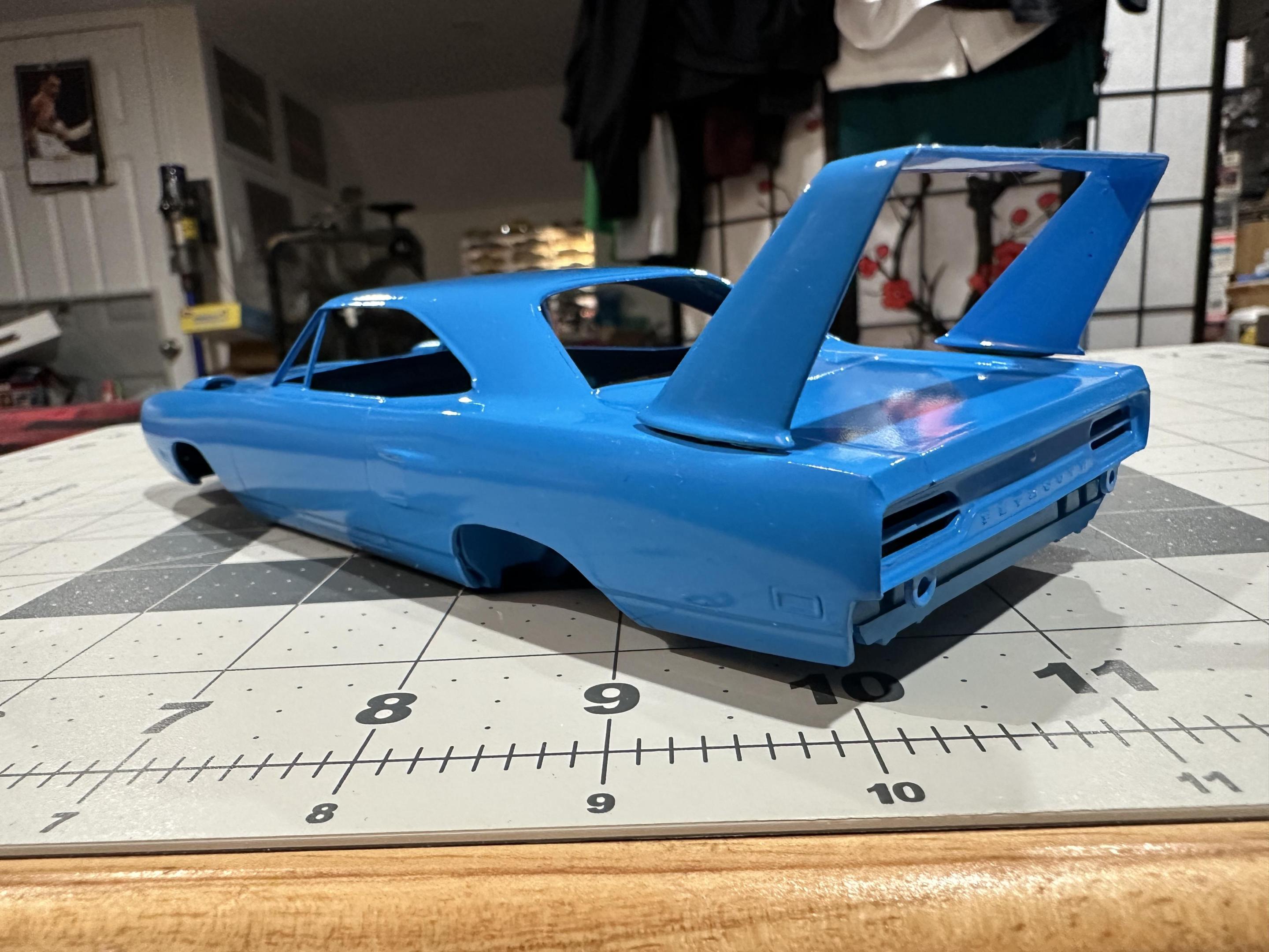

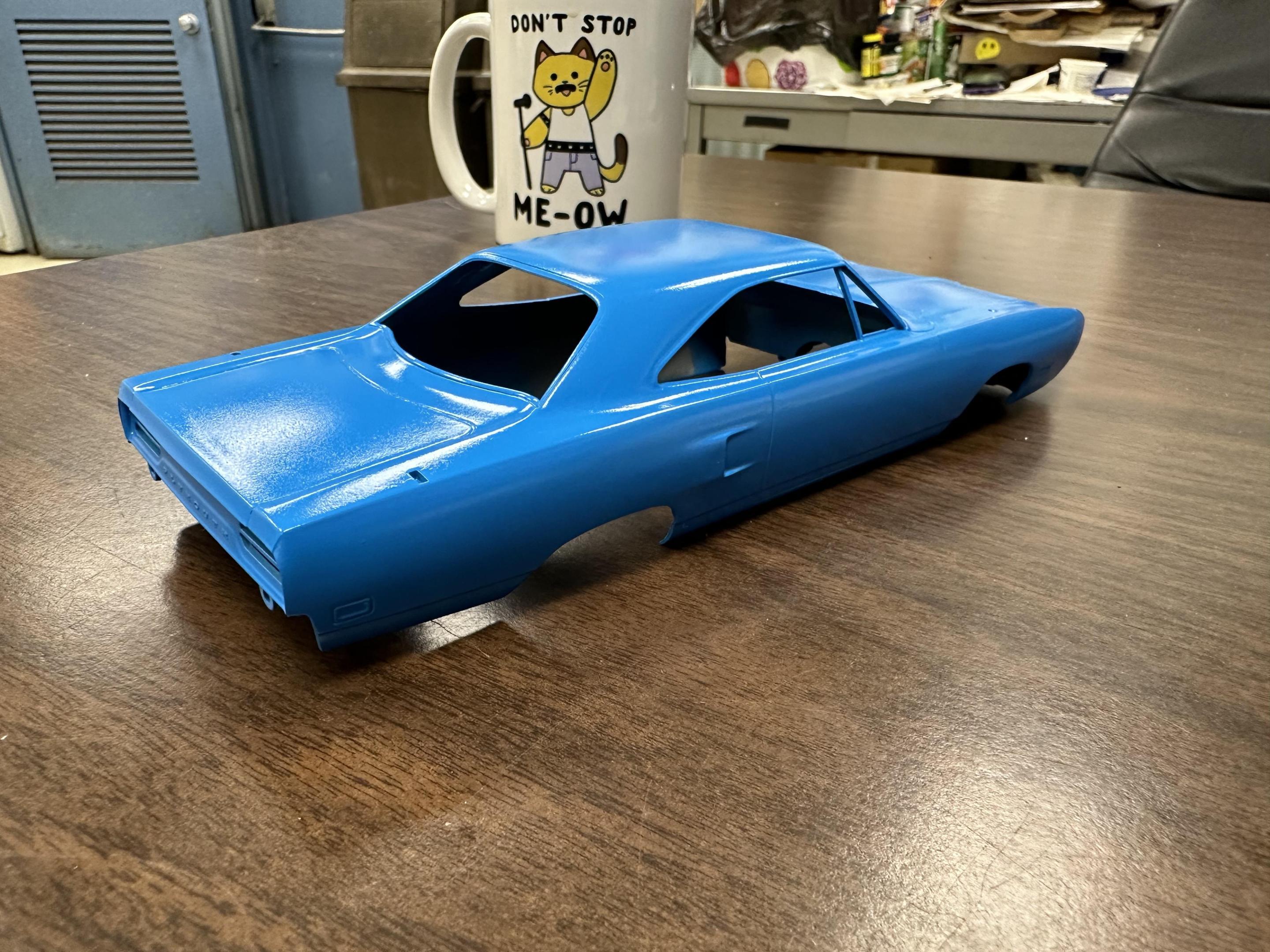

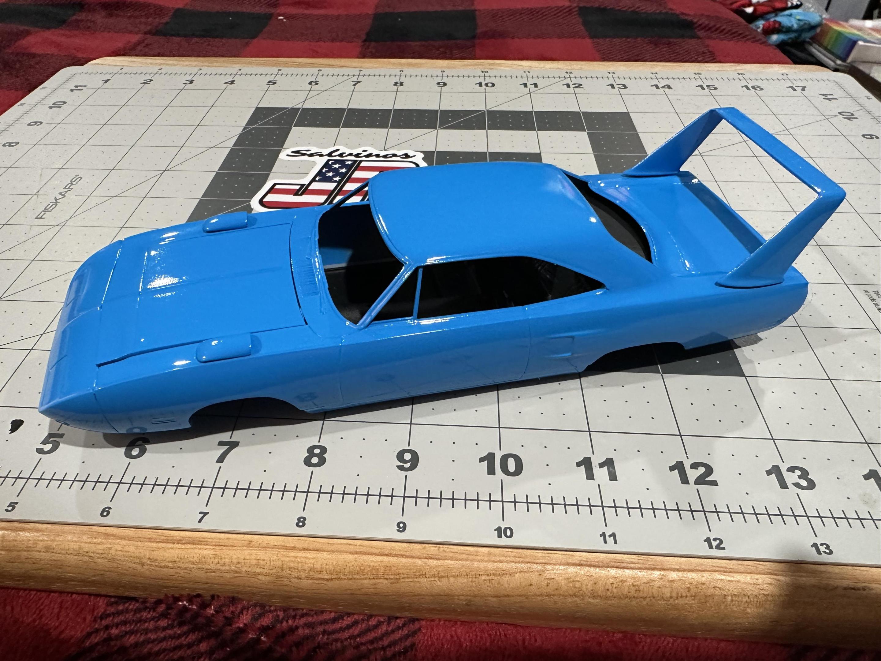

Those three coats went on much nicer! Began mocking up the exterior bits.
The wing and scoops were mounted with blue FunTak temporarily.
I’m using the chassis from a Revell 1968 charger.

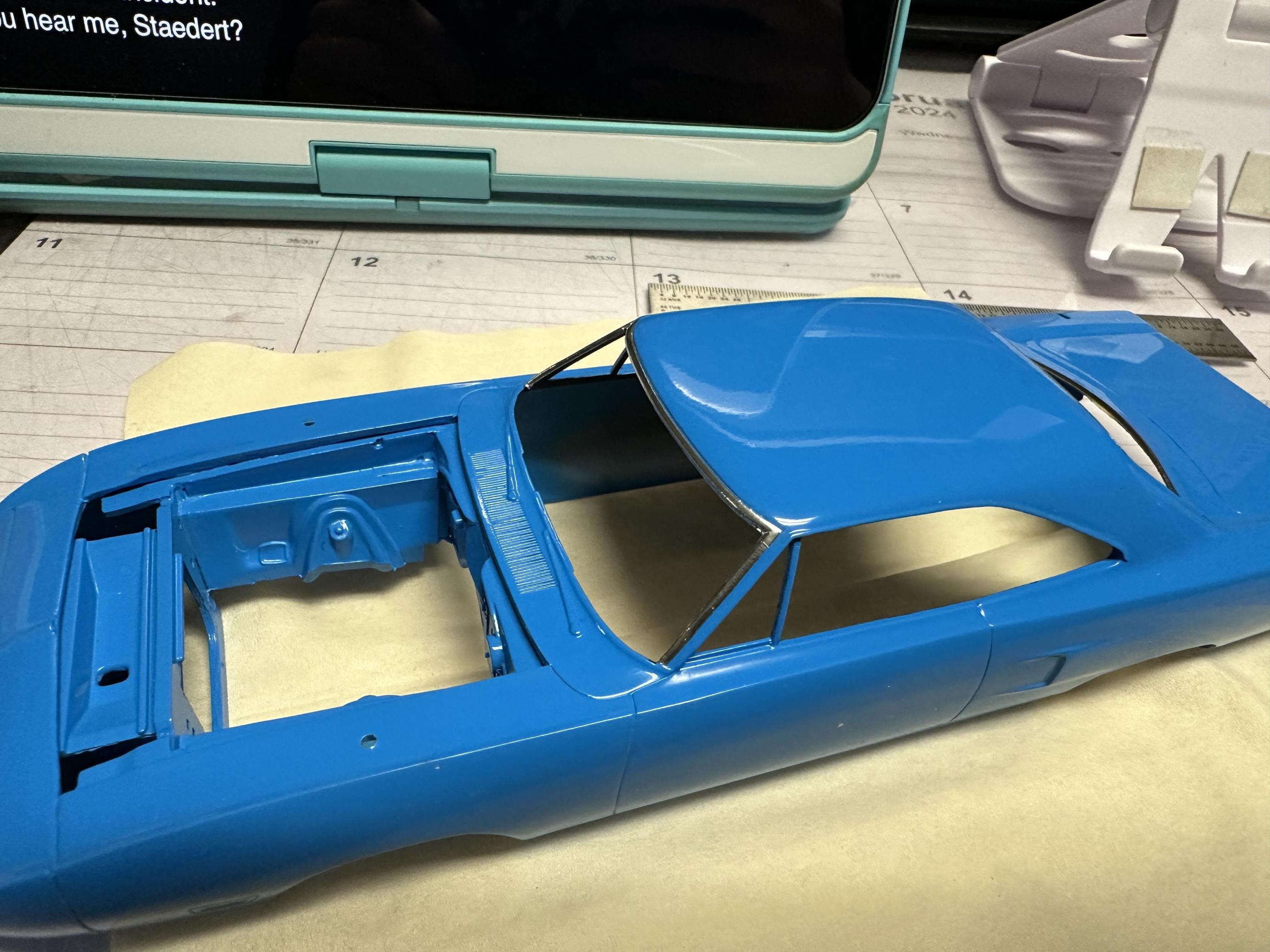

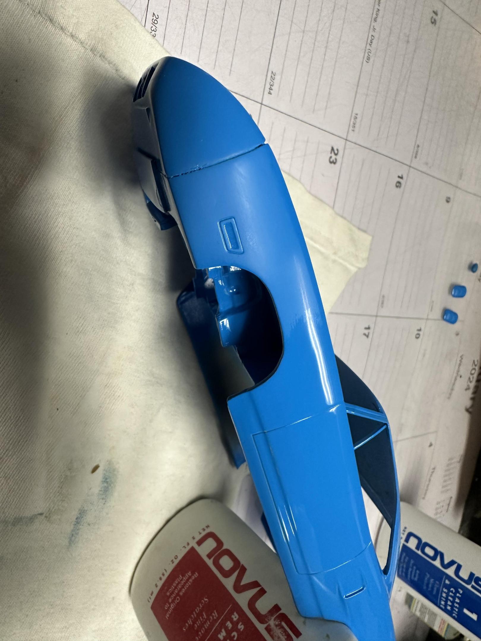

I decided to do a little wet sanding.
Novus has been my go to polish for over 25 years.
Edited by Superbird McMonte
  • Like 4

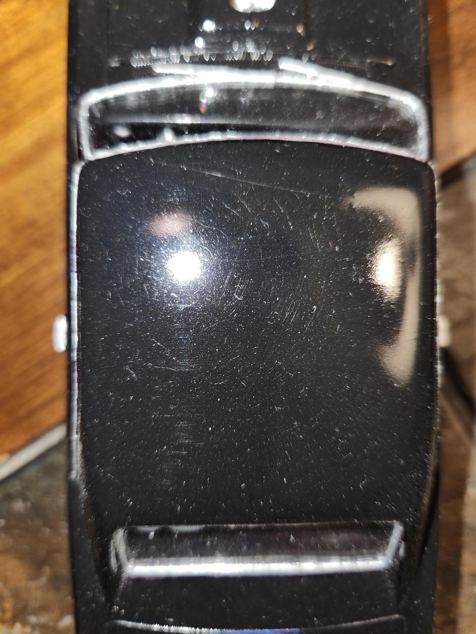

Looks good. I've never polished a model before and I've always wondered what grits and what types of sanding pads/paper people use. If you could enlighten me on what products you use that would be great.
This is my most shiny paint job ? I think polishing could make my stuff look like yours (much better than mine).20240302_213410.thumb.jpg.4785de2a82c559a0cdd47a401b434bb6.jpg

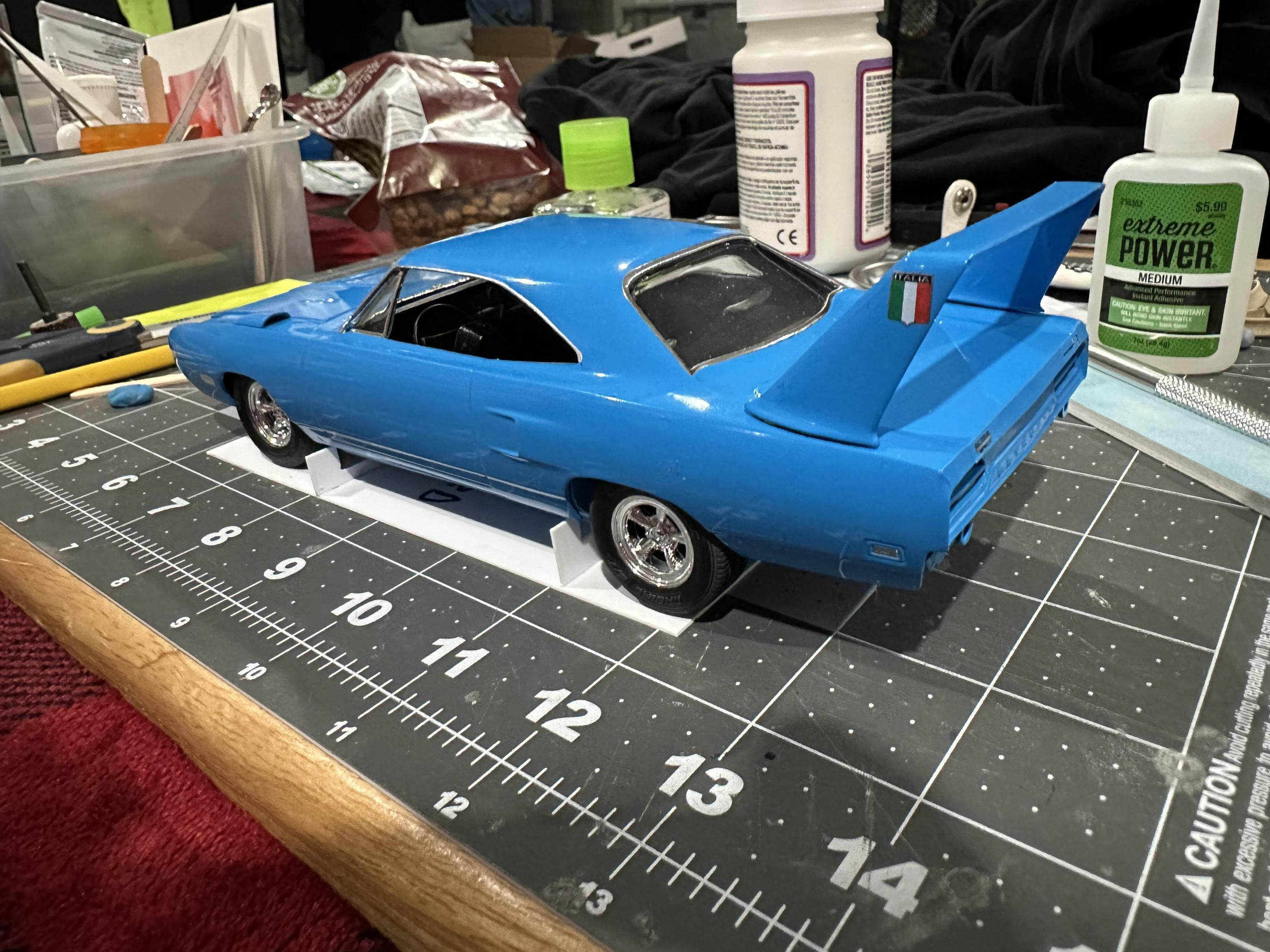

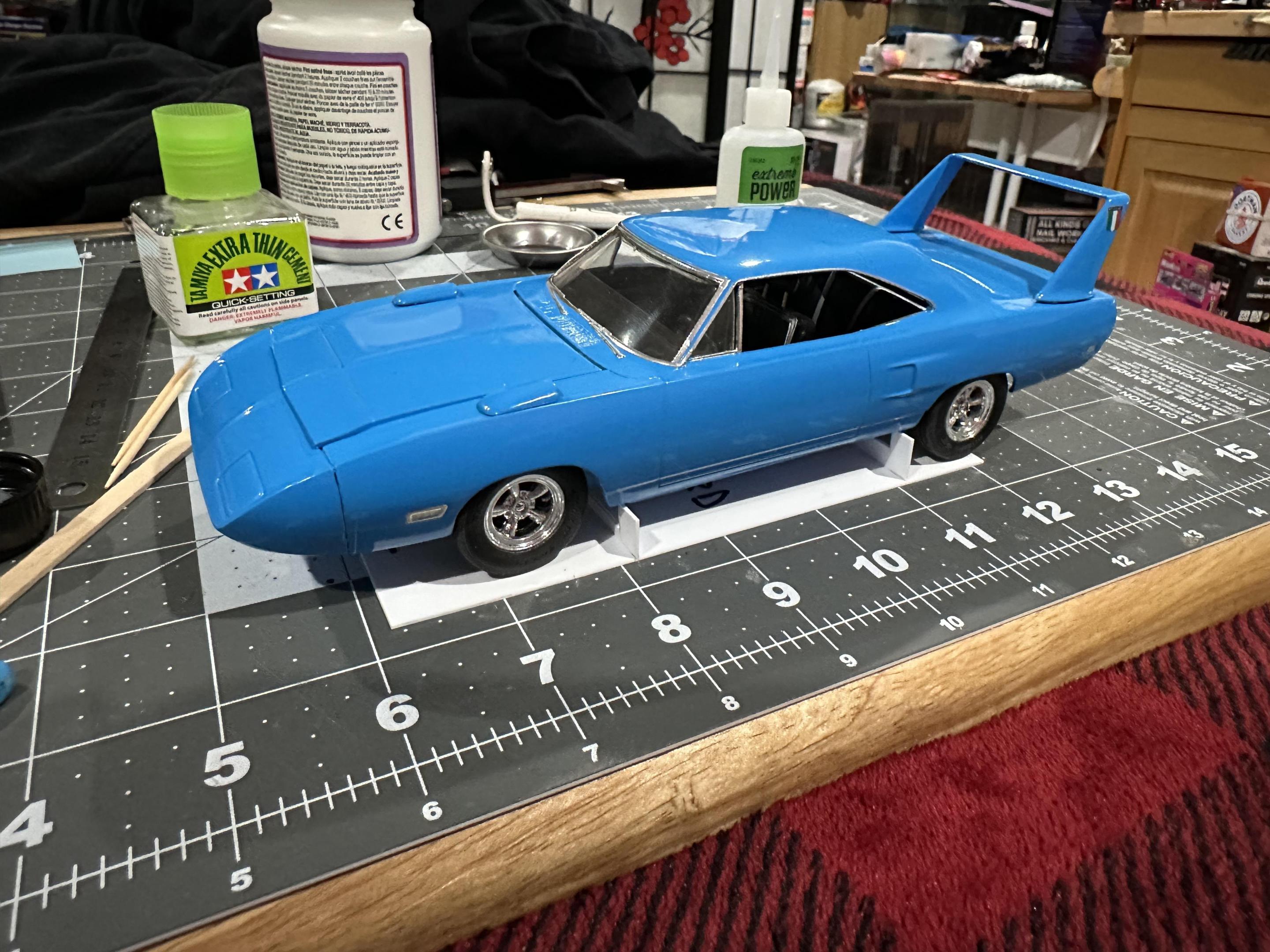

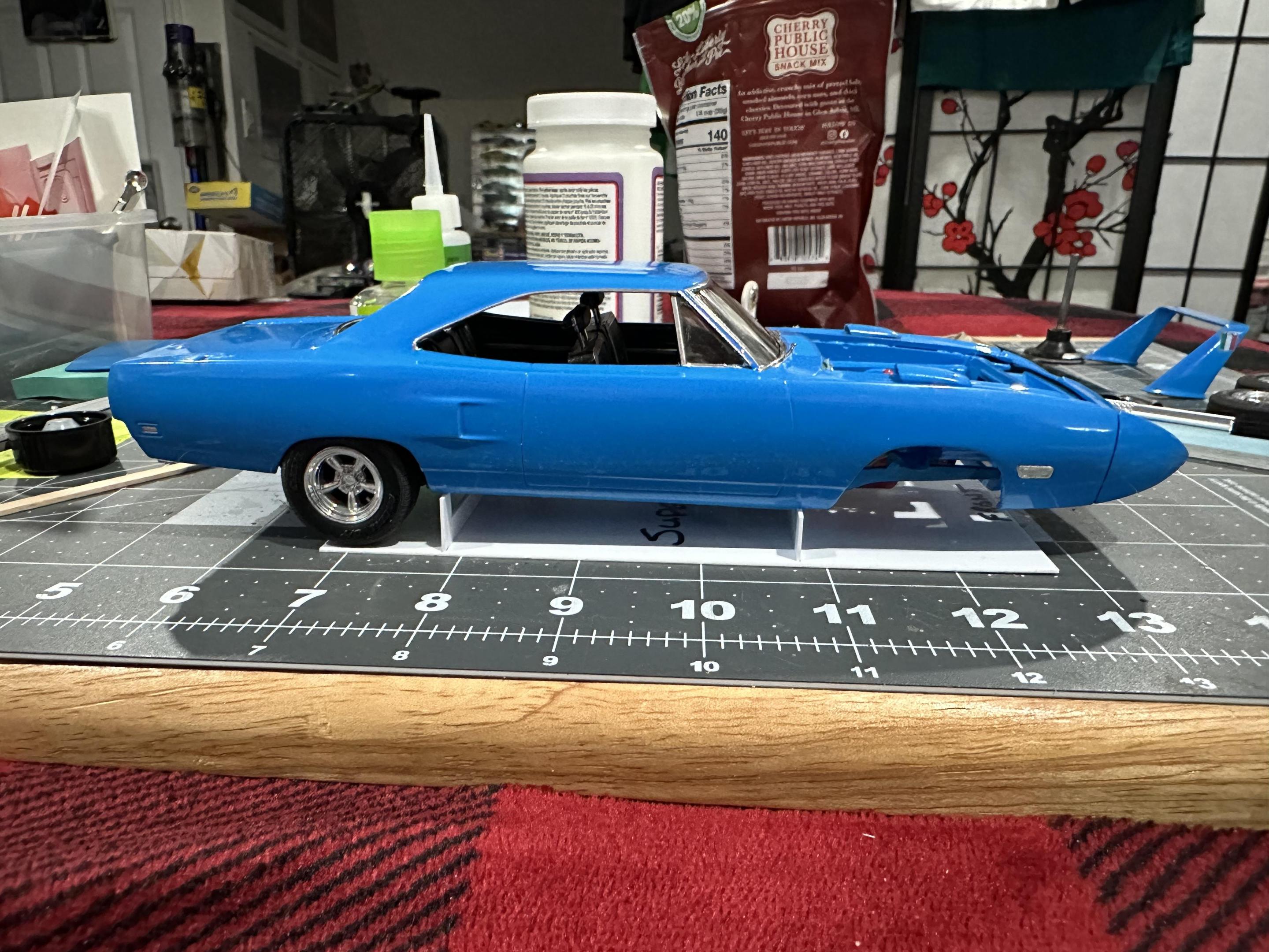

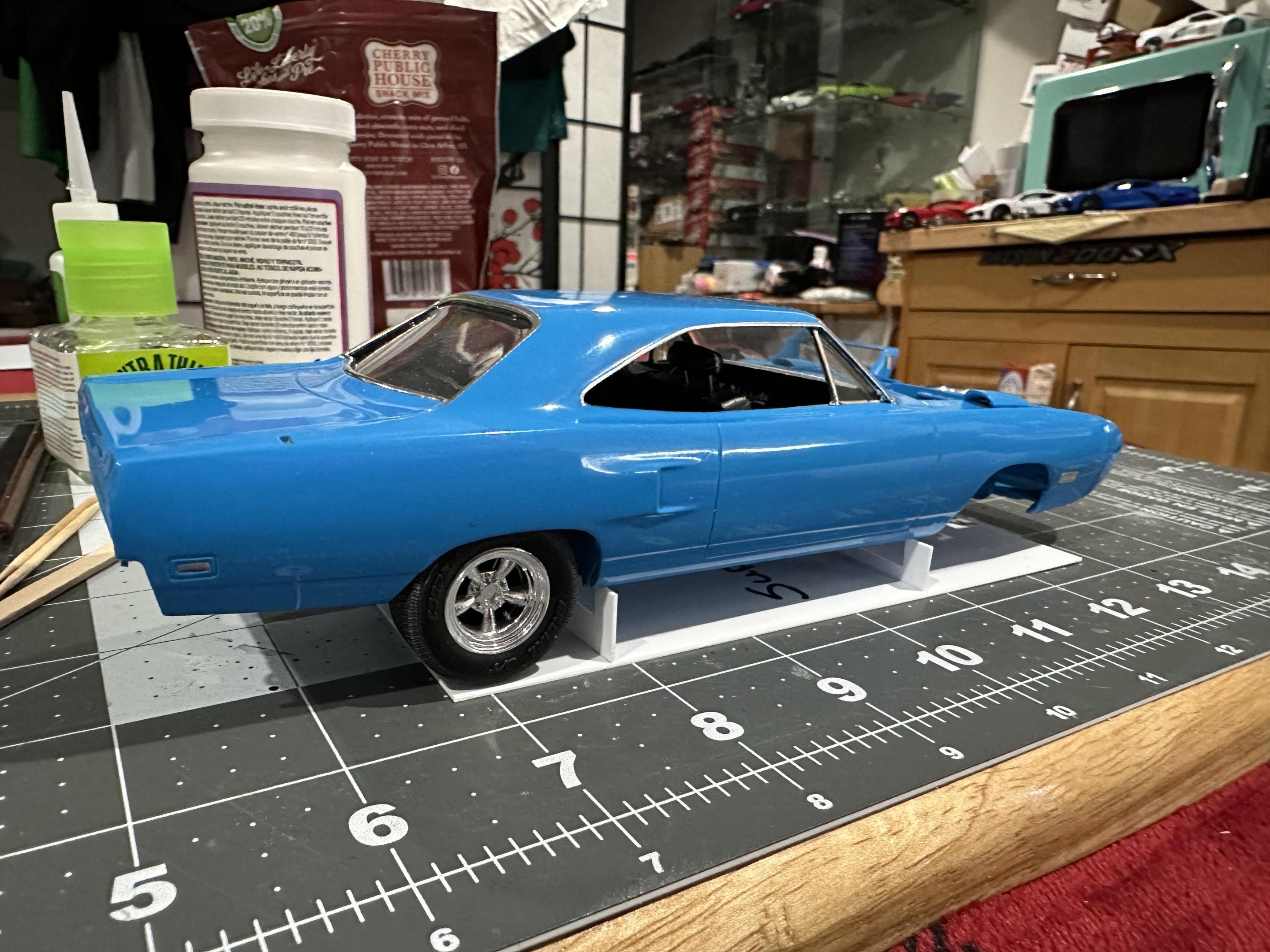

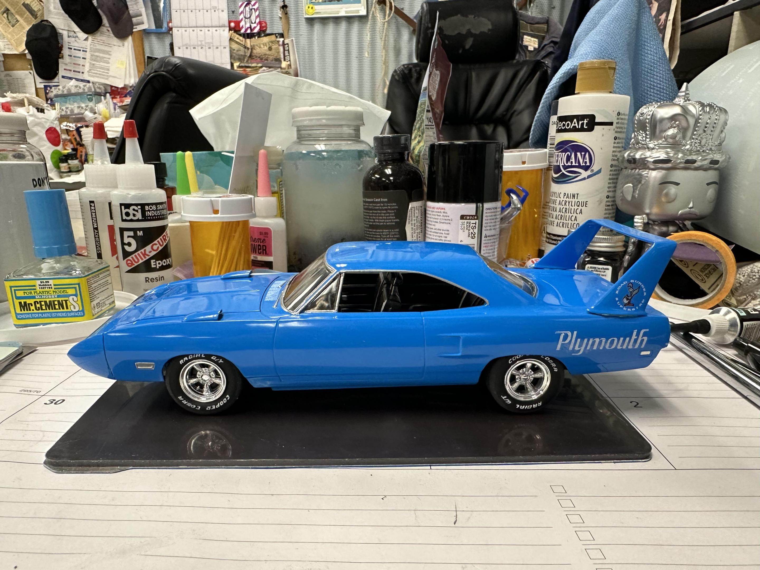

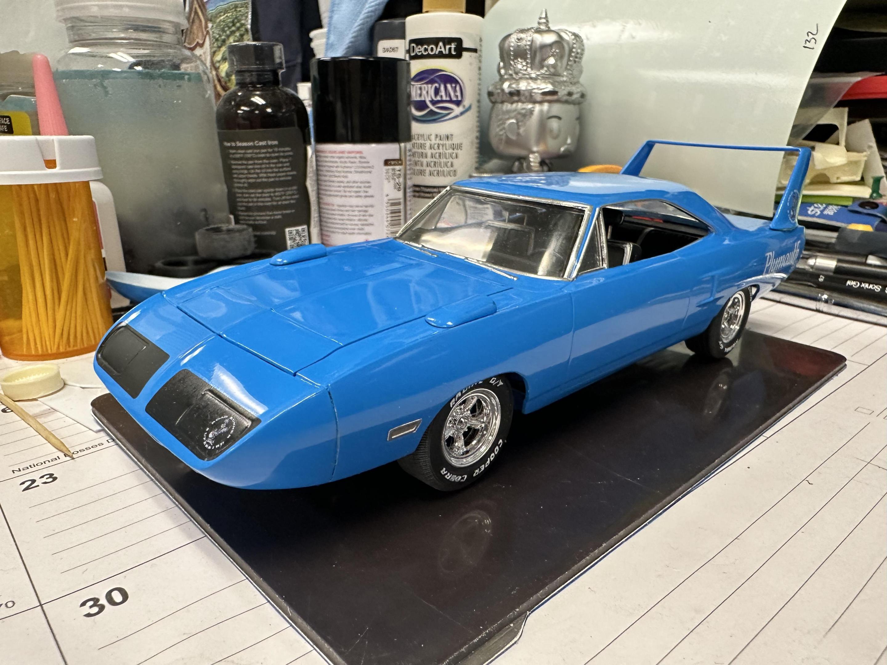

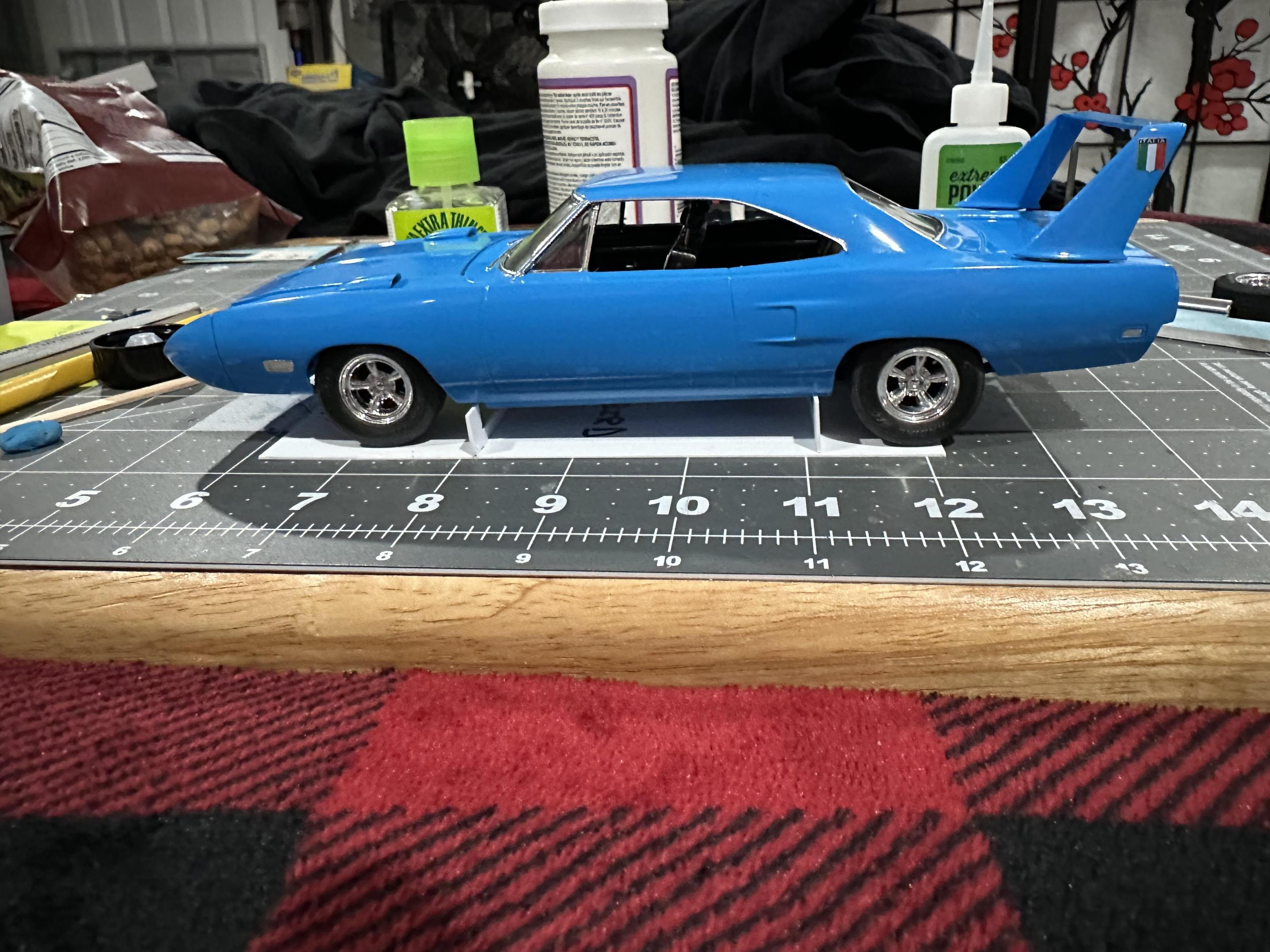

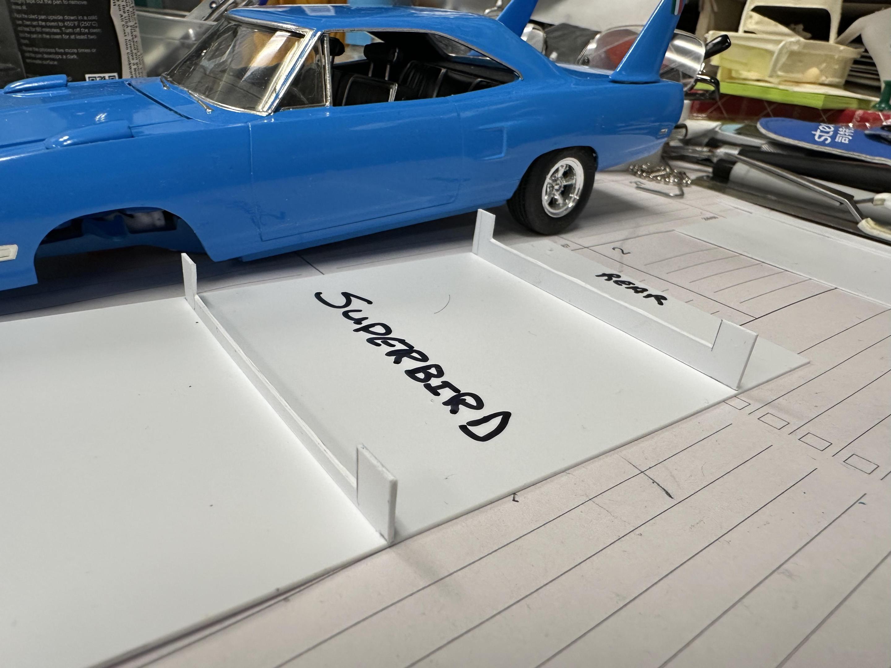

After foiling, I set up the ride height. I measured from the rocker to the ground next to both wheels. Made up this jig in scale for the body to sit on. I oblonged the hole in the wheel backs and slid them into place. A little 5 minute epoxy set them all in place for ever!
Very happy with the way she sits!
  • Like 3

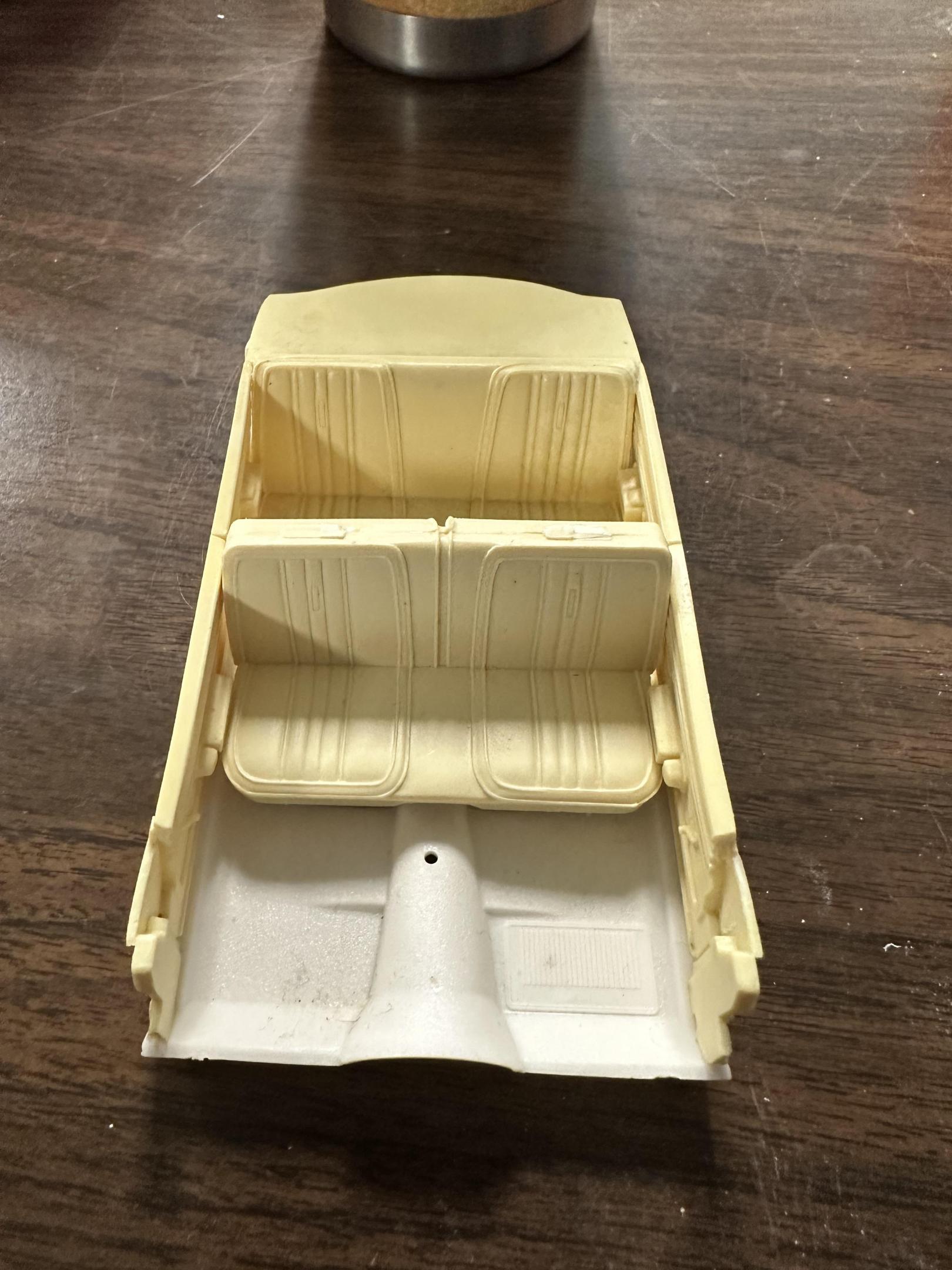

I made up this resin interior as part of a Superbird trans kit I was developing. The body is ready for molding and the last part that I need to do.IMG_2389.thumb.jpeg.ad03b5934b1837880c3f210079899b77.jpeg
All of the resin interior parts are from the Monogram 1970 Road Runner kit. They have been modified to fit the Revell Charger floor pan.

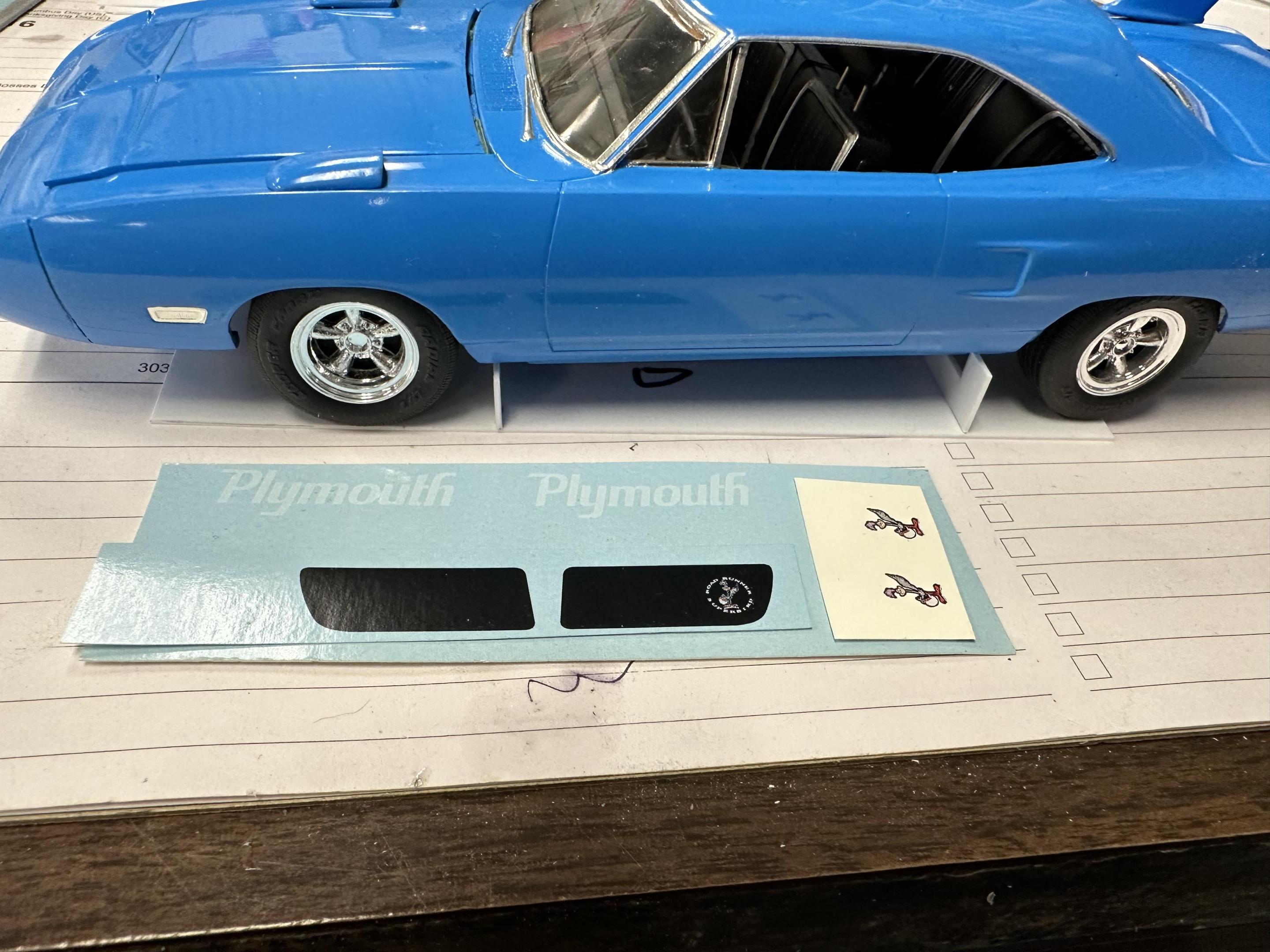

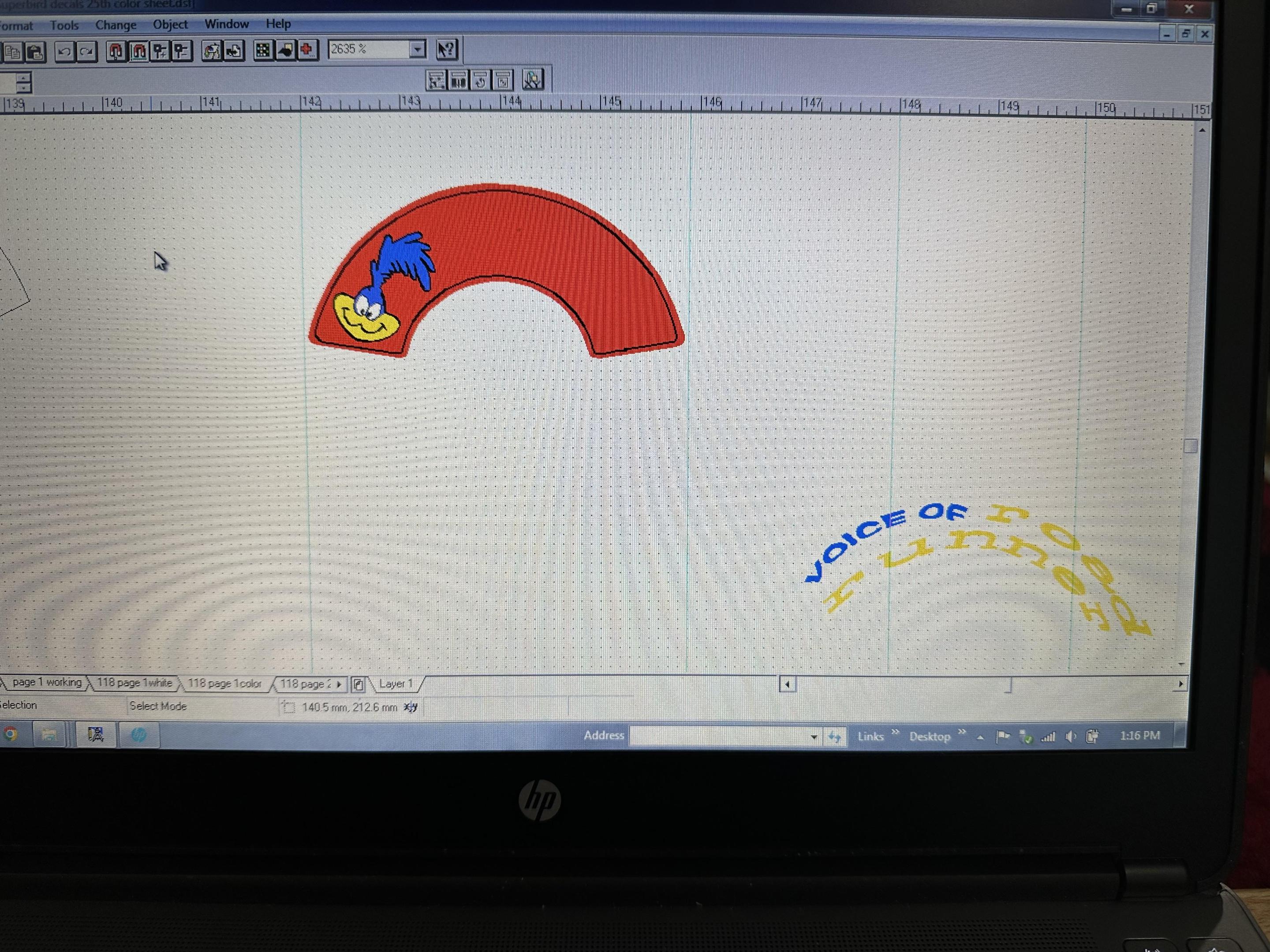

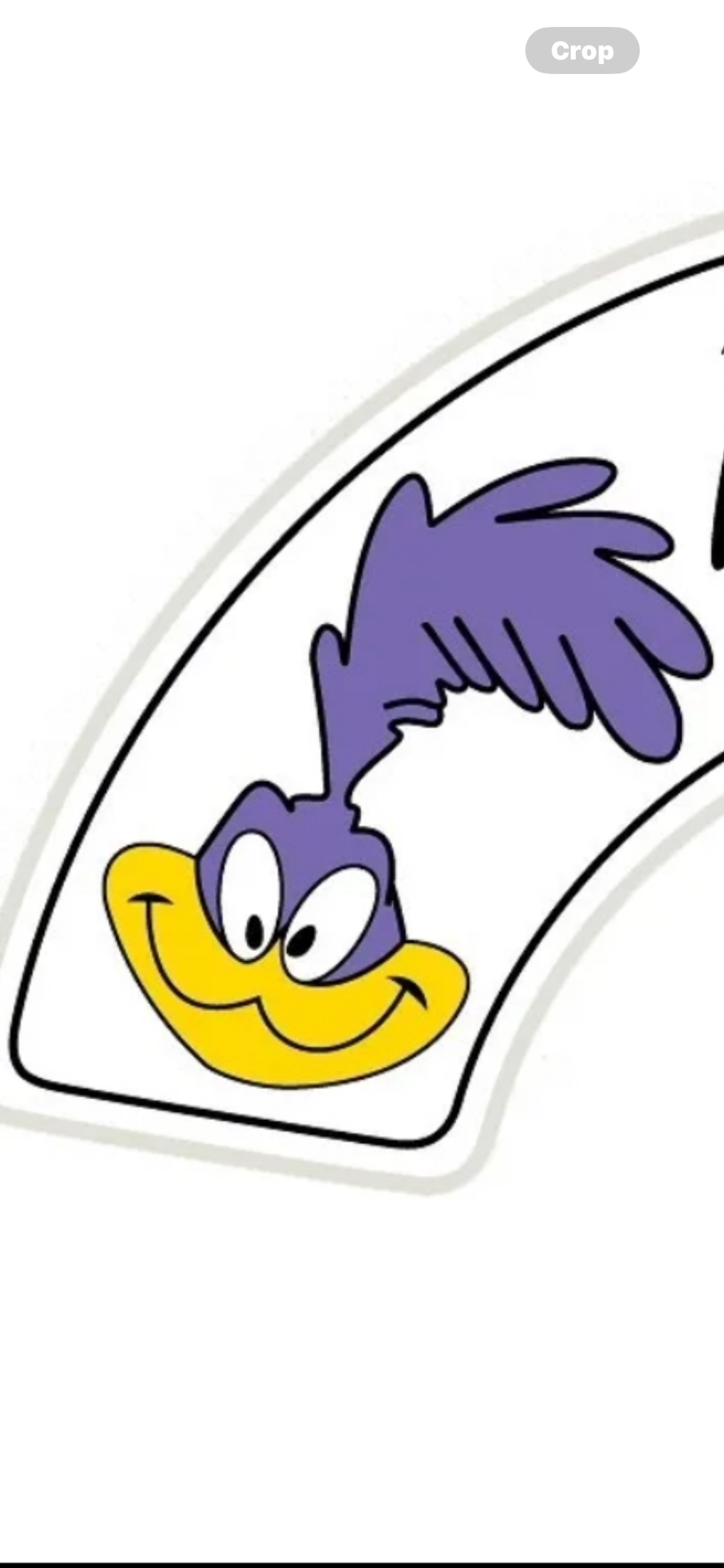

Decal time! These decals are of my own creation.
The Plymouth lettering would end up getting replaced with fresh printed decals, and two layers.
Working drawing for the horn decal.
IMG_1201.thumb.jpeg.4902e5e455846db0124a7225efde096f.jpegIMG_1200.thumb.png.dbc0a40d04e439ac1095d776a391e075.png
