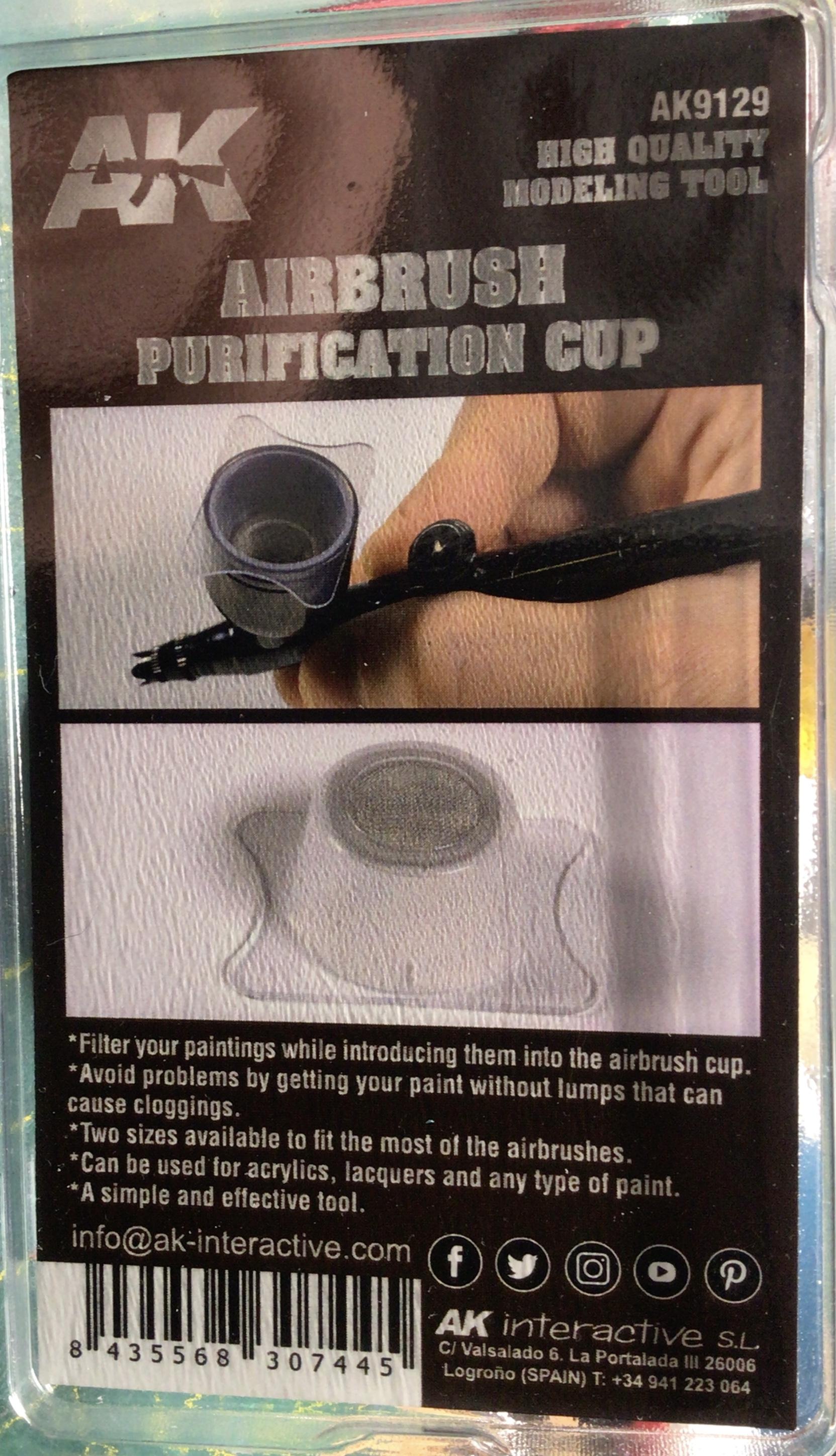

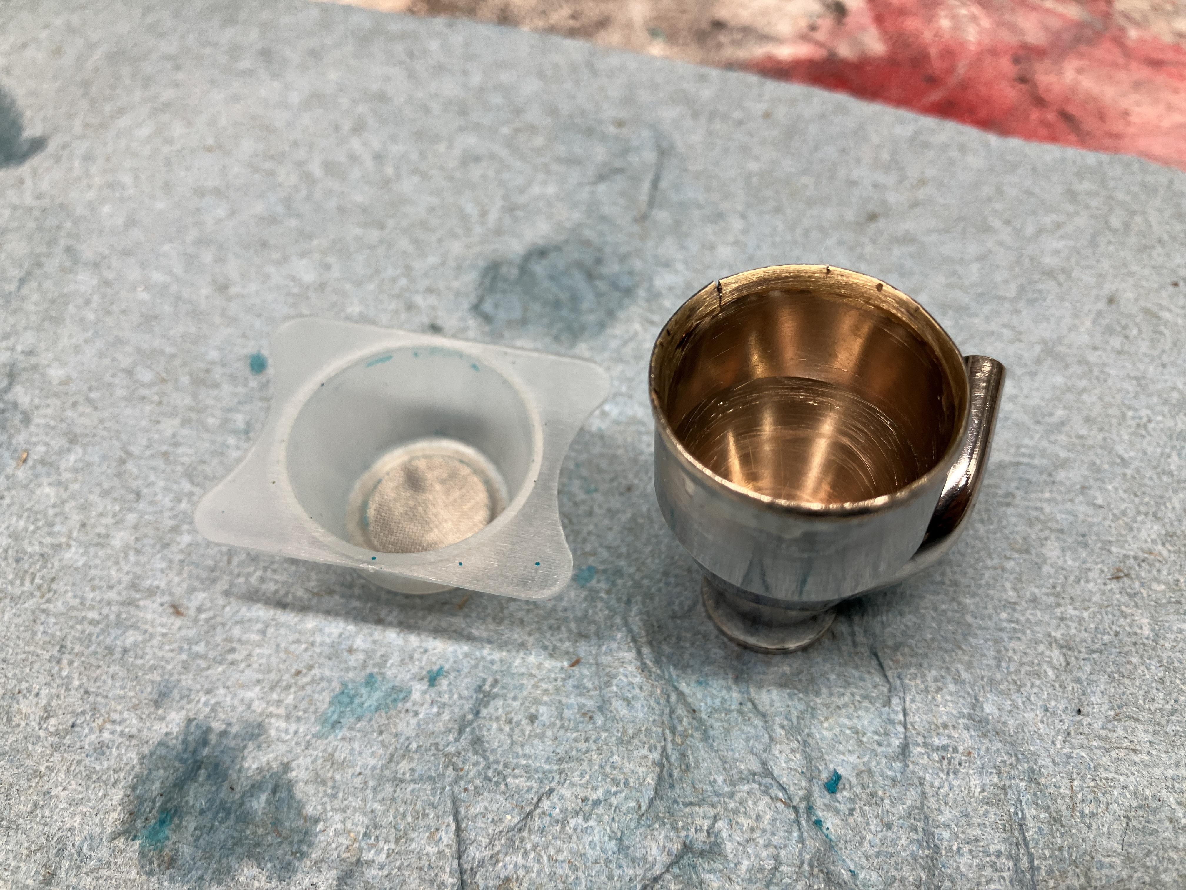

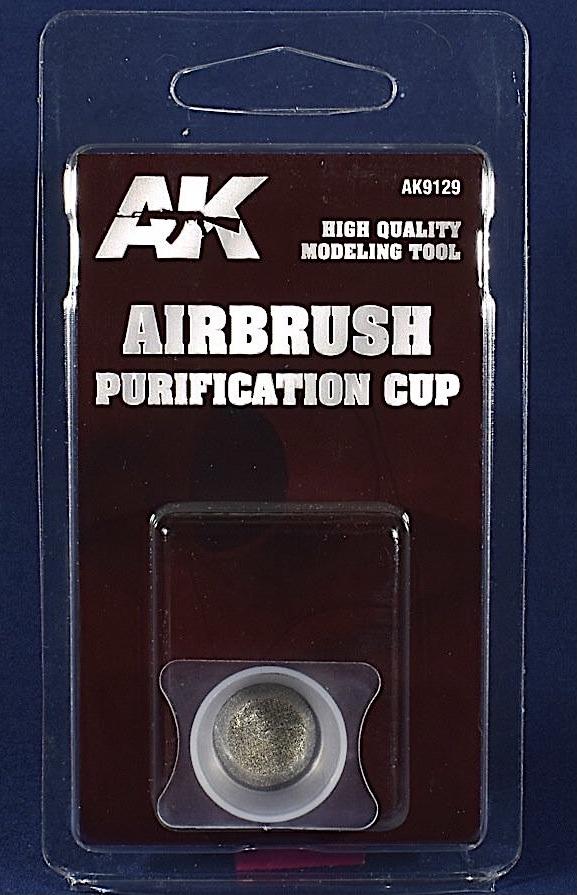

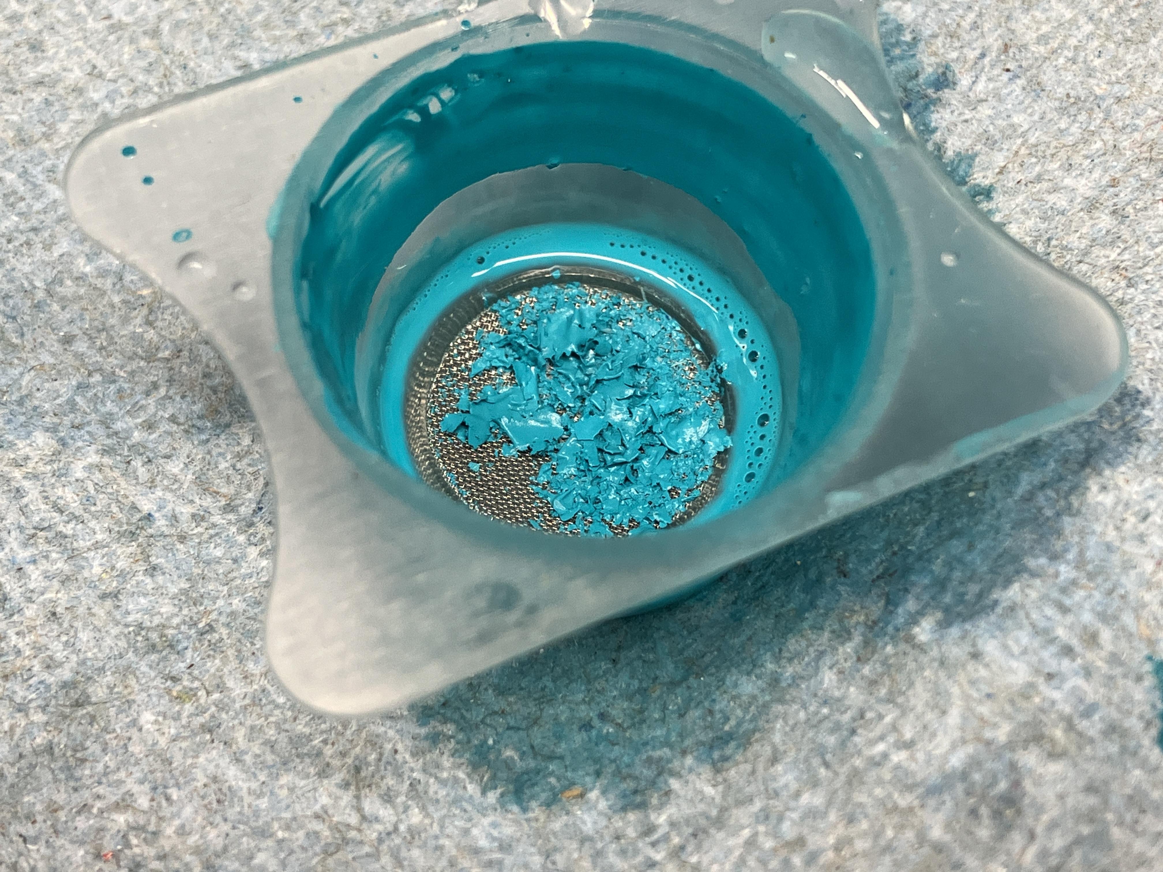

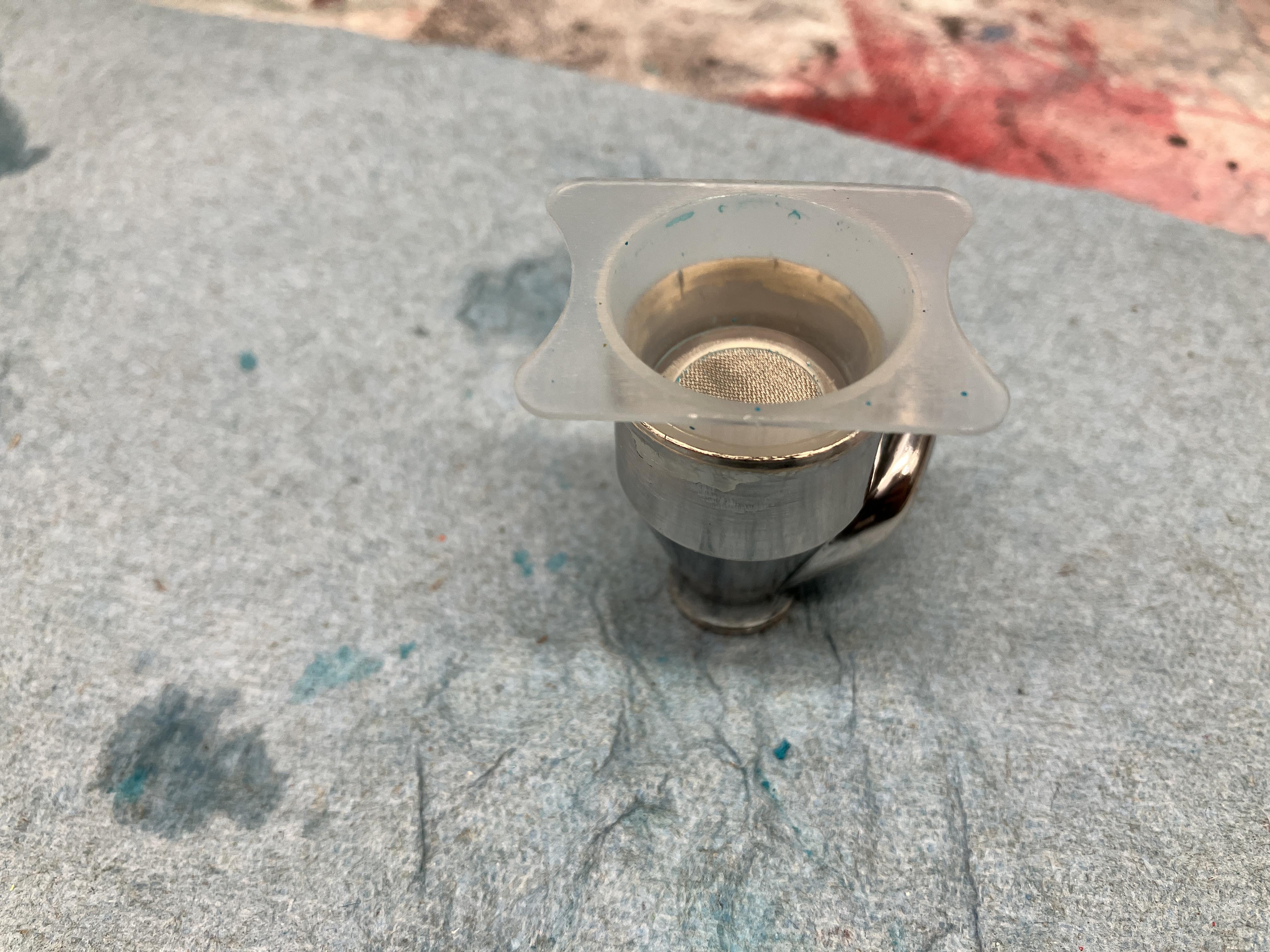

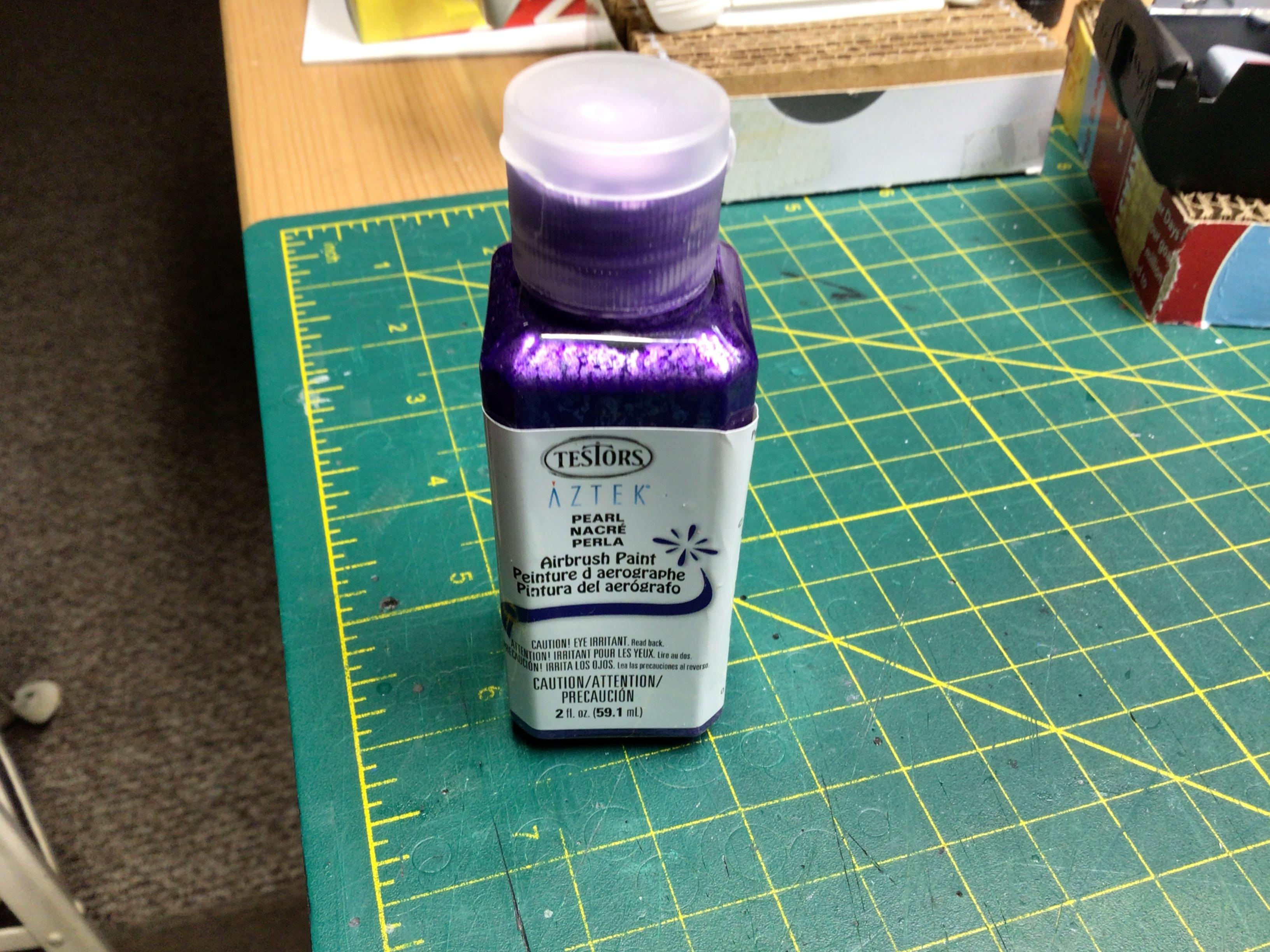

NOBLNG Posted February 27 Share Posted February 27 (edited) I have had good luck with this Testors Aztek paint in the past. This time though, when using a previously opened container, I get little chunks of stuff on the surface with every coat.🤬 So I picked up this little AK strainer at a local hobby shop. It wouldn’t fit my Paasche H airbrush cup because of the little lip in at the top of the cup, so I modified it slightly. I have a couple of spare cups on order just in case I screwed it up.😬 I’m amazed at how much dried paint crud it filtered out. The paint is going on very nicely now!🙂 Edited March 4 by NOBLNG 4 Quote Link to comment Share on other sites More sharing options...

Oldriginal86 Posted March 1 Share Posted March 1 These were posted on here before and I wanted to get a few. I’ll have to look for them at my LHS. That’s a bunch of trash. I’m guessing dried up paint that fell back into the bottle? Quote Link to comment Share on other sites More sharing options...

David G. Posted March 2 Share Posted March 2 Wow! Is that old paint or is Testors QC just that poor now. Either way, I'll have to have a look for these filters at my LHS. Thanks for the tip Greg. Quote Link to comment Share on other sites More sharing options...

Bugatti Fan Posted March 2 Share Posted March 2 David, we all get build up around the top edge of a paint bottle or tinlet, so it is probably not generally a paint problem but how we clean and seal our paint bottles and tinlets after use that causes the problem. I am as guilty as anyone else at neglecting this aspect of paint use, so those filters would be a saviour as far as I am concerned. Quote Link to comment Share on other sites More sharing options...

NOBLNG Posted March 6 Author Share Posted March 6 (edited) 1 hour ago, customline said: Oooo, I didn't mean for you to test it...hope it's OK 😯. I just wondered if it could be used over and over. I remember buying full size paper strainers from the body shop supply house that were throw-aways. Wouldn't that be nice if we had little ones? Hmmmm...... I guess all I had to do was read the back of the package.🤪 Soaking in lacquer thinner is having no effect on it. It won’t fit a small airbrush cup though. It measures 0.725” at the bottom and 0.92” at the top. It will sit on top of an airbrush paint jar. Edited March 6 by NOBLNG Quote Link to comment Share on other sites More sharing options...
