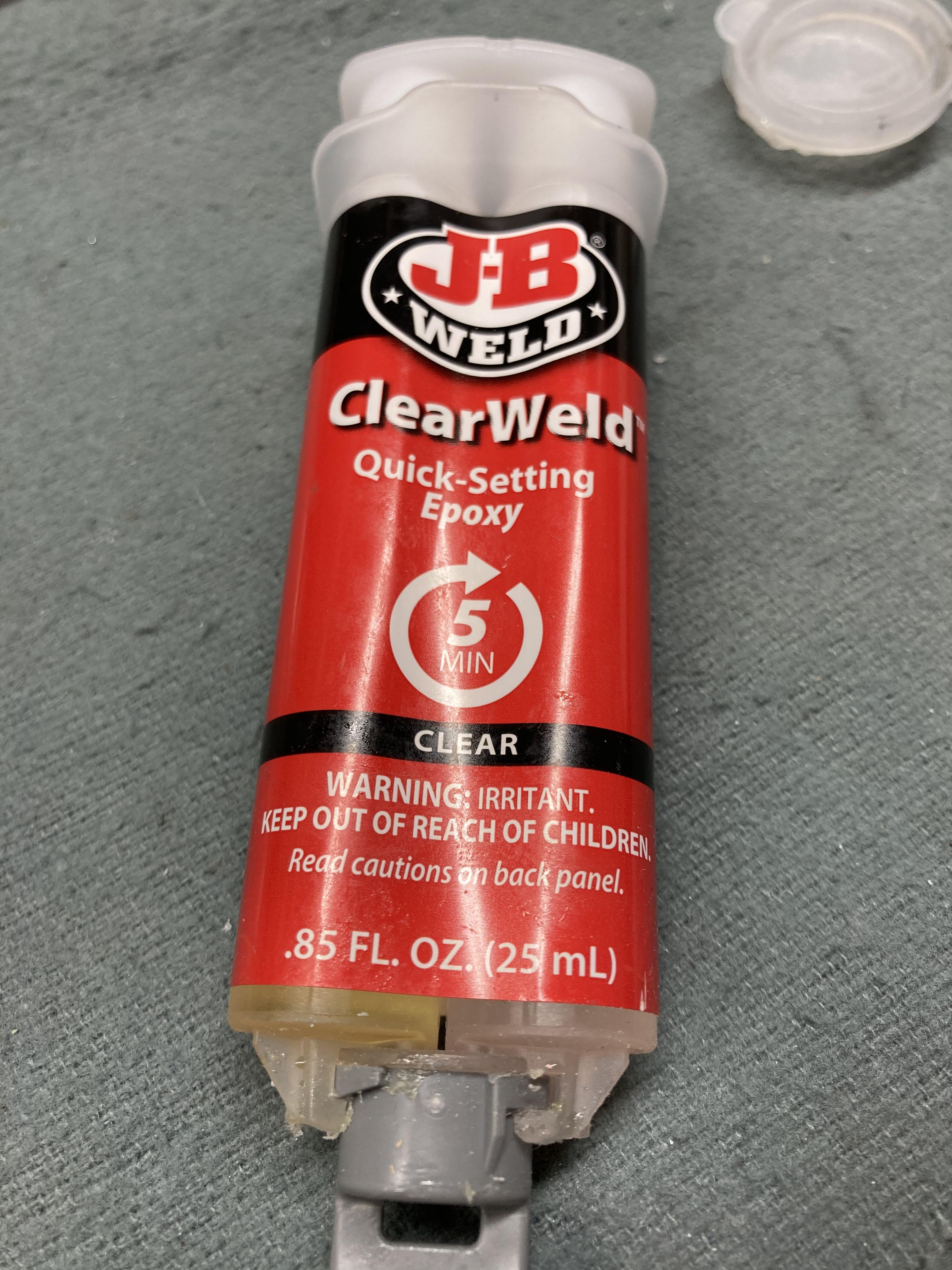

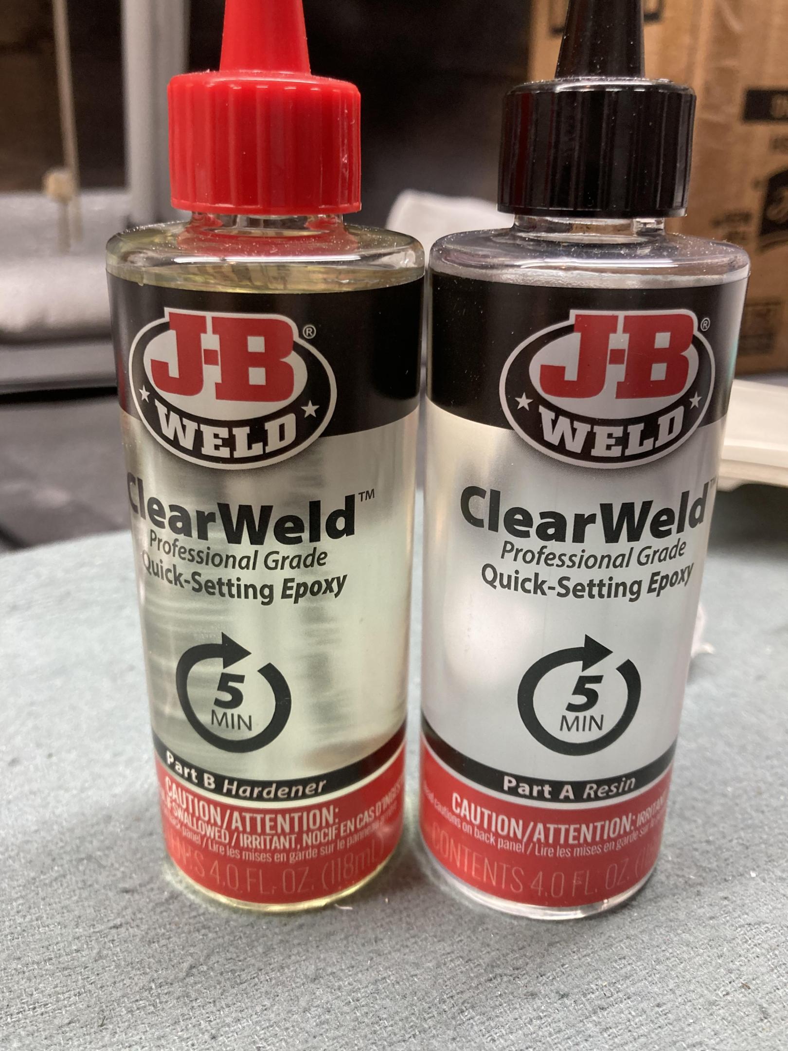

Ace-Garageguy Posted March 3 Share Posted March 3 43 minutes ago, StevenGuthmiller said: Already done. Videos above. OK. I'm convinced. But that sure as heck is nothing like the 5-minute epoxies I've tried in the past. What BRAND are you using here? Always good to have another option in the box. Quote Link to comment Share on other sites More sharing options...
StevenGuthmiller Posted March 3 Share Posted March 3 41 minutes ago, Ace-Garageguy said: OK. I'm convinced. But that sure as heck is nothing like the 5-minute epoxies I've tried in the past. What BRAND are you using here? Always good to have another option in the box. Just JB Weld, Clear Weld. You can find the syringes at many auto parts stores, or the individual bottles on line. I believe I bought the bottles on Amazon. Steve 1 Quote Link to comment Share on other sites More sharing options...
