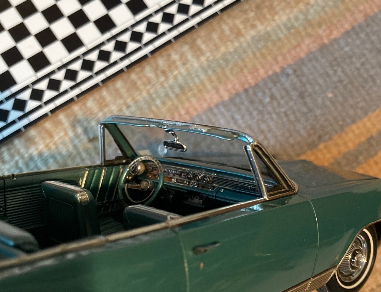

I sometimes leave material for little tabs when I am making up "glass". This gives a bond surface away from what will be visible. Some plastics bend better than others. I'm now using something from Hobby Lobby that is .015" thick and will hold a bend.
I just unwrapped a new dress shirt and of course saved the pins (great for shifters) and the little clear plastic part that supports the collar.

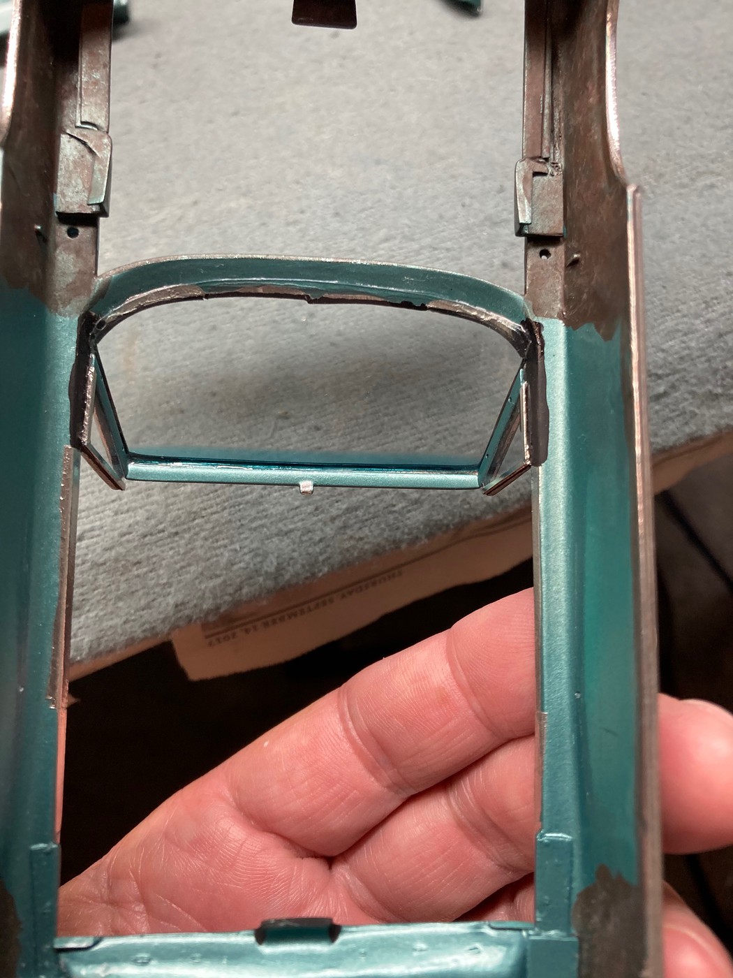

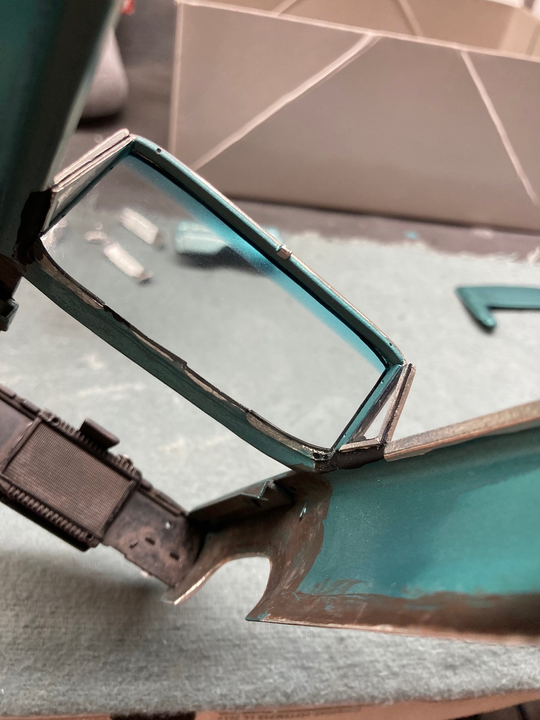

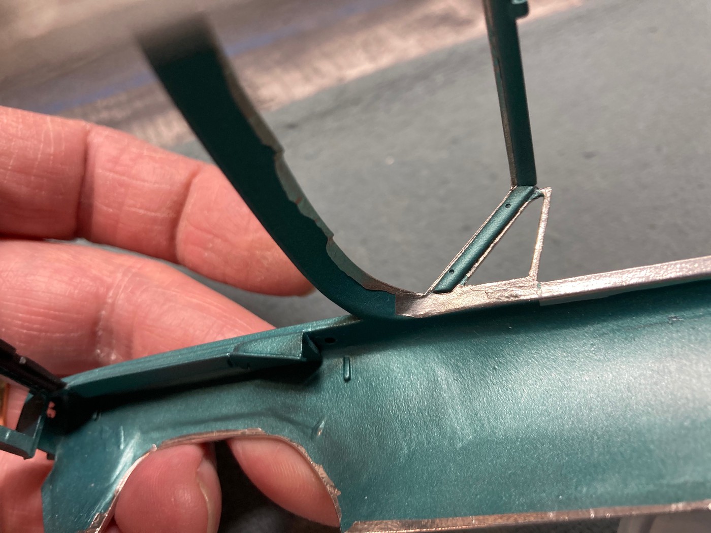

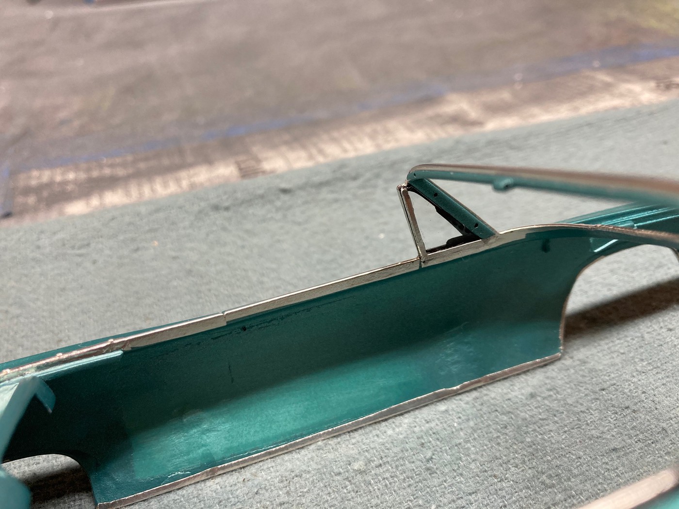

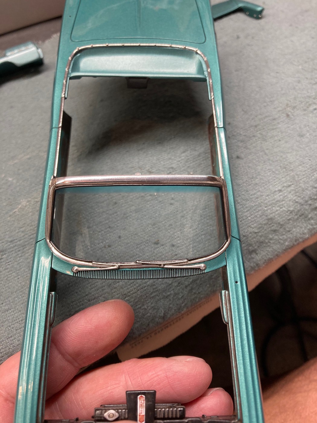

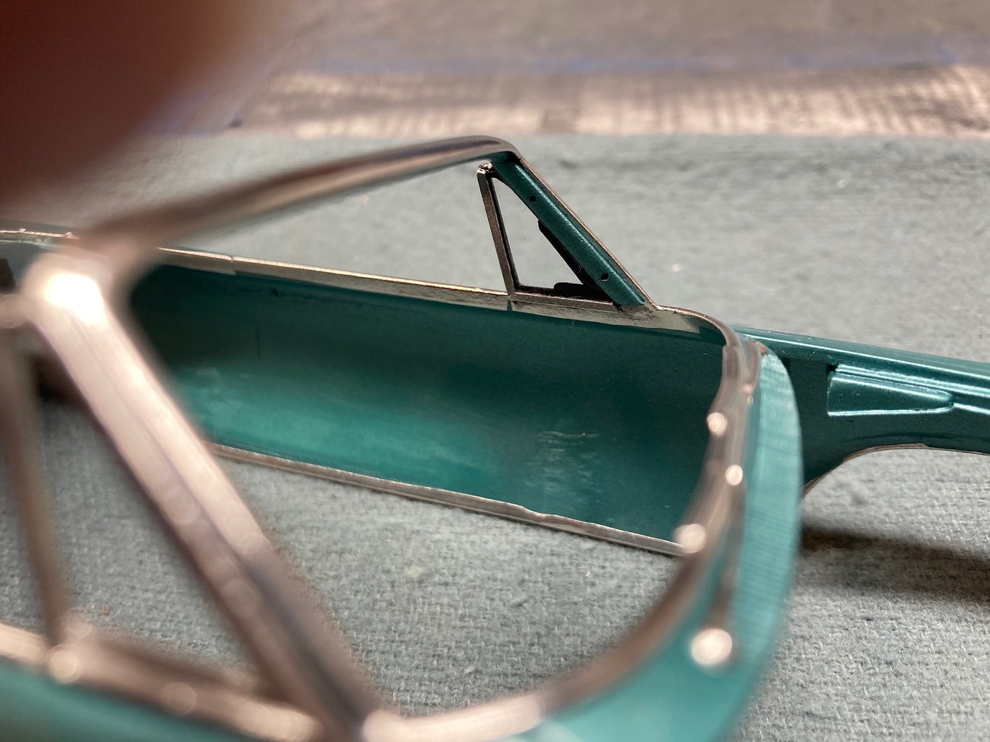

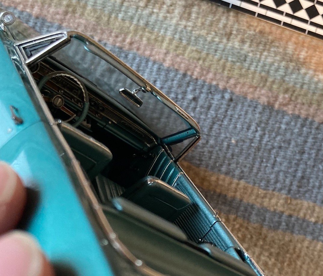

The method that I've been using is probably a little unorthodox and requires some forethought, but it will give you a very clean finish on the inside instead of the obligatory globby glue mess that you generally see around the inside of the glass on a model.
This technique involves adding plastic stock to the inside of the A-pillars and the windshield header, creating a slight channel, so that when you clear sheet plastic is ready to be installed, it can be cut slightly larger than the opening, and "friction fit" into the opening.
With this method, you can run a small bead of clear epoxy along the windshield header, let it tack up slightly, slide the glass into the opening from the bottom, and then tape or clamp the lower cowl edge into place and glue.
The glued cowl area will be covered by the dash board, the sides of the glass require no glue due to friction, and the only exposed glued area will be along the header, the least noticeable area. and even there, you'll notice a much cleaner look.
Of course this technique is much more involved, but it will make installing the glass itself much easier, and if you want the interior windshield area to look as realistic as possible, this will do the job.
The green painted A-pillar pieces and header were the plastic stock that I added to the kit frame.
I think you'll agree that the interior windshield area looks much more realistic using this method than what you'll normally see.
Steve
