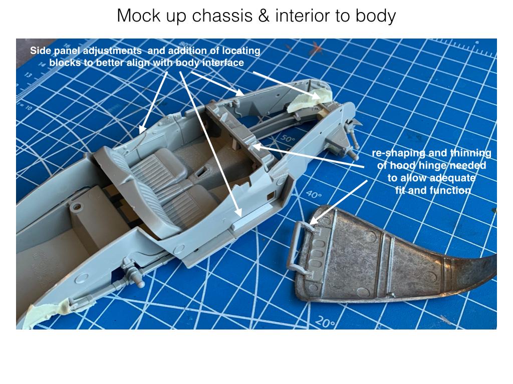

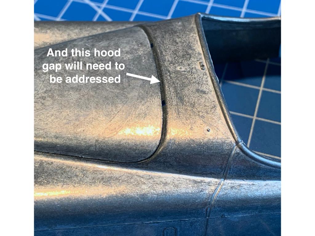

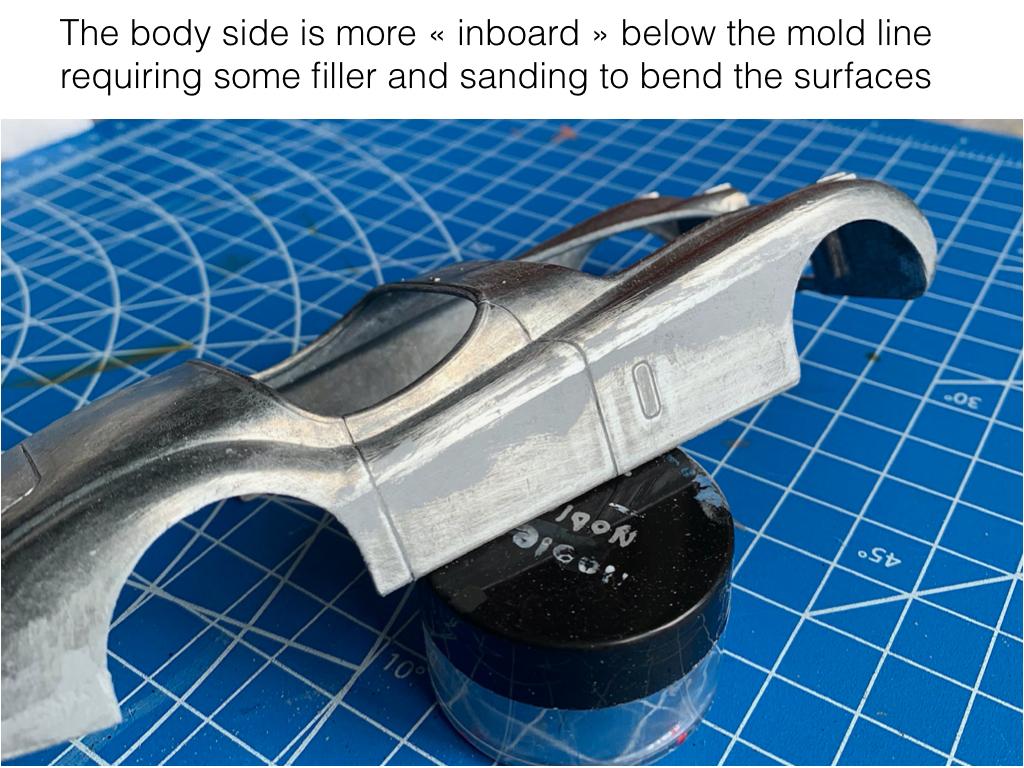

Ace-Garageguy Posted May 26, 2024 Posted May 26, 2024 (edited) I have several of these, one as a WIP Chevy-powered Bonneville contender. That's NOT a "mold mismatch" around the rear wheel-arch. It's a flange put there specifically to mount the fender skirts. After you file down the body side parting lines, you'll need to re-scribe the door opening lines. The best way to deal with the hood gap is to file the body on the front to allow the hood the slide a little farther back. Don't overdo it. And there's some variation from body to body unfortunately. The hood hinge slots in the firewall are huge and klugey too, and really need to be filled so as not to show...with smaller more prototypically correct hinges fitted. The body is very well proportioned though, and responds beautifully to some metalwork...and the flanges for the rear skirts can be removed entirely OR minimized to the point they're almost invisible but still allow mounting the skirts with rubber cement or white glue if you want them to be removable for some reason. One more thing...I'd recommend a self-etching automotive primer for the metal parts. Edited May 26, 2024 by Ace-Garageguy 1 1

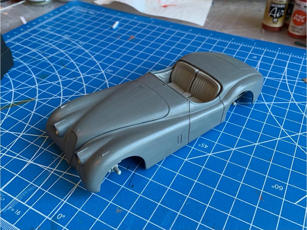

Pierre Rivard Posted May 27, 2024 Author Posted May 27, 2024 Work on the body has started. Not as difficult as I had feared.

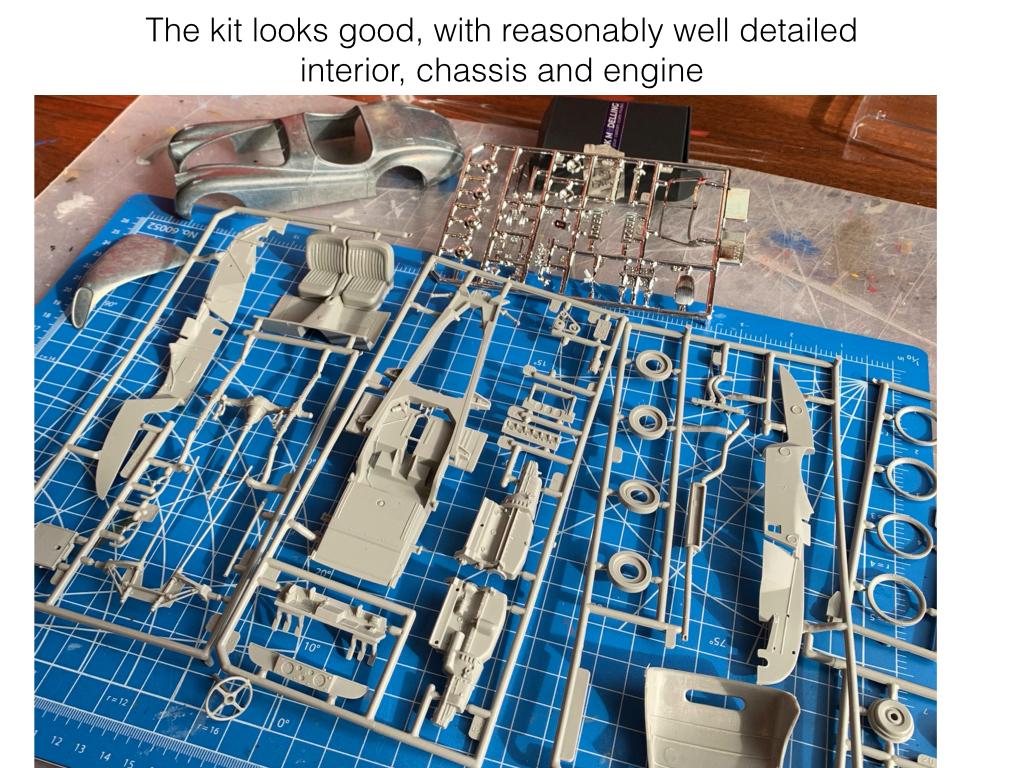

absmiami Posted May 27, 2024 Posted May 27, 2024 This is a good kit choice - the die cast metal is a pain - but the kit features an unusually well detailed chassis - and the engine - as i recall - im 100 miles away fr my w/shop - is not half bad …

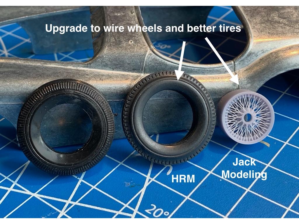

Pierre Rivard Posted May 28, 2024 Author Posted May 28, 2024 22 hours ago, kensar said: I'll be following this one. Really interested in seeing what you do with it. Many interesting possibilities. Indeed ken, many possibilities and I need to choose something. Definitely a race version of the car. 21 hours ago, iBorg said: This is going to be really nice. Thanks Mike. Metal body is a bit of a head scratcher but it is beautifully shaped. 16 hours ago, absmiami said: This is a good kit choice - the die cast metal is a pain - but the kit features an unusually well detailed chassis - and the engine - as i recall - im 100 miles away fr my w/shop - is not half bad … Yup, nice kit. Engine is good enough for what I want to do but for not having a separate one piece oil pan. I hate that split in the middle of it. 13 hours ago, Dave B said: Hi Pierre, this is a decent kit, built an OOB years ago and Ace Garageguys comments are spot on. Looking forward to seeing it finished. Dave B Ace is the reference. He confirmed my thoughts on how to deal with the hood fit and so far the changes are working. The kit is good but I'll upgrade to better wheels & tires and I have to consider bucket seats for a race version. 8 hours ago, Rich Chernosky said: Pierre...you have taken on a real challenge. Metal kits are something else. But you are off to a good start and have gotten lots of good feedback. I am quite sure you will persevere. So far so good Rich. The metal body is manageable for me as I just plan to make it smooth and clean without adding modifications. Why they did the body in metal escapes me but I don't mind working on something different.

Pierre Rivard Posted May 29, 2024 Author Posted May 29, 2024 (edited) Edited May 29, 2024 by Pierre Rivard 4
MarkJ Posted May 29, 2024 Posted May 29, 2024 Looks like you figured out the hood. Fits like a glove now. The body prep is coming along very nicely. No one will ever know this body is metal unless you tell them. 1

Pierre Rivard Posted June 4, 2024 Author Posted June 4, 2024 (edited) body primed and now proceeding to assembly fitting process Edited June 4, 2024 by Pierre Rivard update 1
