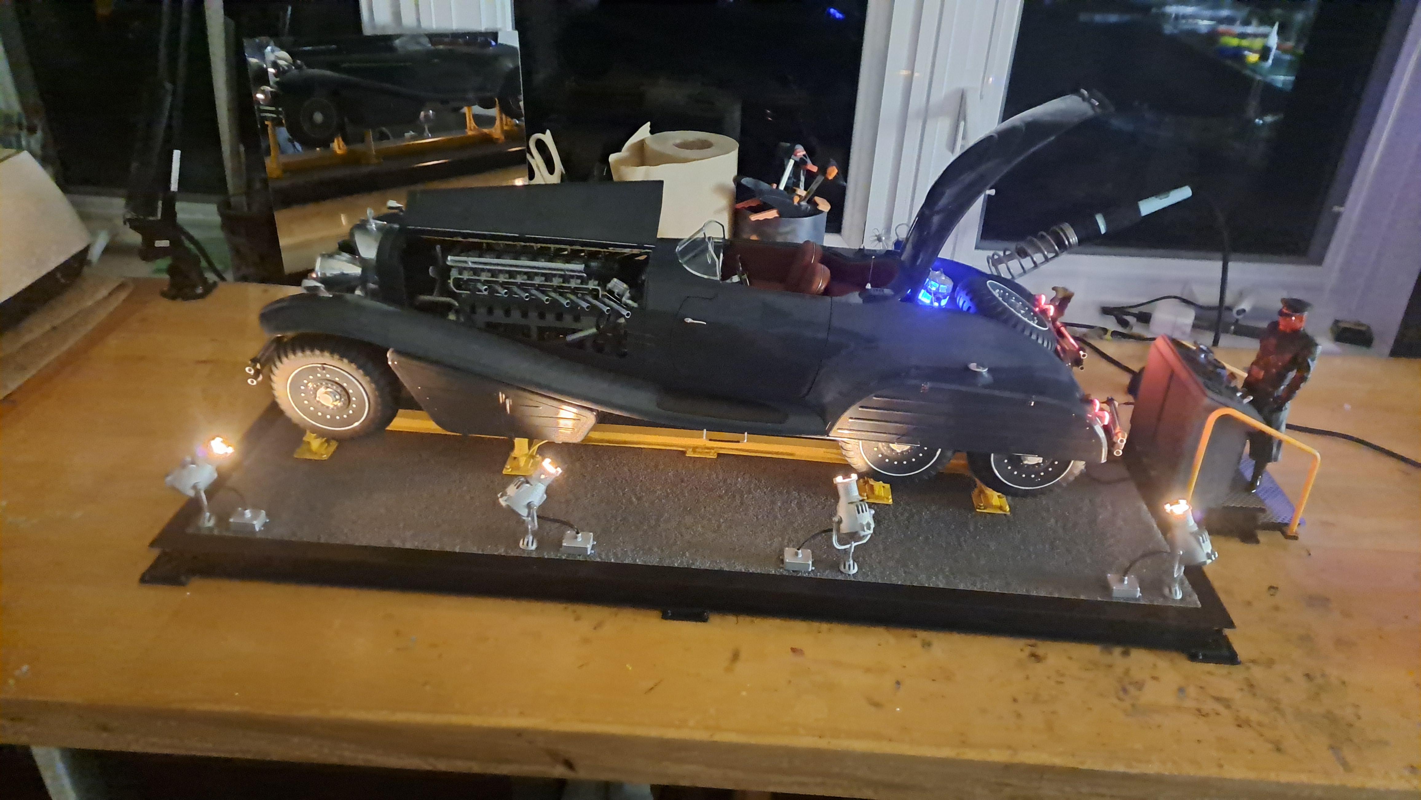

François Posted July 3 Author Posted July 3 (edited) Ok so the base is painted, I raise the car a full inche for a better view of the underside and I but in a grayish floor (a bit like in the bentley's display). And, I don't like it. I don't like it for a 3 reasons. First, it's too big, second, it's too big and third, it's too big. I'm a 'builds first and ask questions later' kinda guy, and the first question I asked myself after completing the didplay was 'where am I going to put this thing'. I didn't have an answer. So in comes plan B. I'll redo the base but much narrower, it has to fit on a 12 inche deep shelf. Instead of overhead lighting, l'll install 4 spot lights on the floor. The grayish cardboard floor will be replaced by a mini graveled surface, I might even try to make some tire tracks in the gravel. Red Skull will still be at the controls, and lastly, there will be no cover as the glare in the plexiglass really bothers me. I wanted to display the car in 'Marvelesque' environment but I think I went overboard with the idea. Here's the completed display case (the too big one). I'll try to find a place for it somewhere, a lot of work went into it and it would be a shame to get rid of it. And here's the proposed plan B Edited July 3 by François 5

Unatural Posted July 3 Posted July 3 I like the idea of the low lights on the new design. What do you think about putting them on the other side of the car as well? That way if you ever take it to a show or have any kind of 360 degree visibility, it will be even all the way around. The best part about having the lighting inside of the plexiglass is that when the room around it is dark, then you won't see as much of a reflection.
François Posted July 11 Author Posted July 11 So, the model is complete. The base is done, the lights are connected, all is well. Yes, all is well... until it wasn't. While trying to turn the motor, the crank broke... again. So now the car is in the repair shop. I removed the body, wheels, seats and anything else the is not glued. I temporarely modified the support rack to hold the car upside down and started to analyse the situation. It's not good. The crank shaft broke in 2 places. I'm not sure it's repaireble but I'll try. Best scenario is the I fix everything, worst will be that I glue the broken parts in place and nothing move again. The middle ground would be to link the remaining crank with the gear motor via a straight shaft (no pistons attached to this portion). This would permit rotation of 10 out of 16 pistons plus all of the valve train. I'll see what is possible but I'm not overly confident. I do have a video showing the motor running so at least I have that to prove I was able to pull it off. Here's the situation as of today. Body removed whatever was removable removed Car flip over on temporary cradle Broken crankshaft wish me luck!! 4

François Posted July 13 Author Posted July 13 Unatural, I used anycubic's waterwash resin for the entire model. I probably should have used a stronger resin for the crank but it is what it is. The biggest error I did was the gearmotor location. My original design had the gearmotor located at the transmission and was to drive the ring gear which is attached to the crank and is a much sturdier area but it didn't fit. So that's when I decided to hide it in the blower and drive everything from the front on the crank. This brought on two problems, first I had a slight misaligment issue between the gearmotor and crank so I needed to put in a universal joint shaft. Second, all the torq needed to rotate everything was taken by front of the crank which was weaker than the rear. I tried to repair but wasn't able to so now the crank is glued in place. But like I said in my previous post, I have it on video. I've learned alot with this build, if I ever do another motor, I won't make the same mistake. 2
