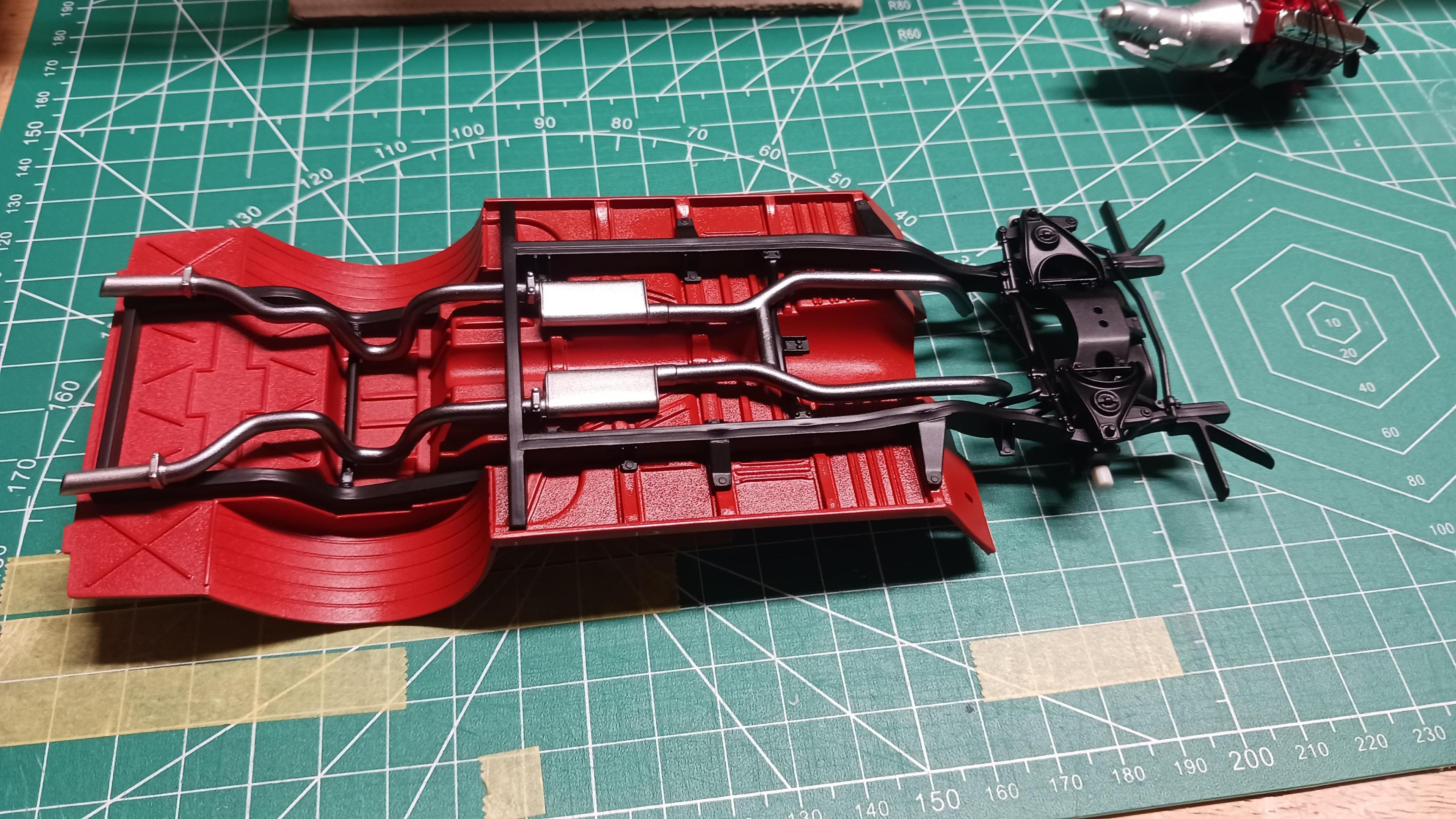

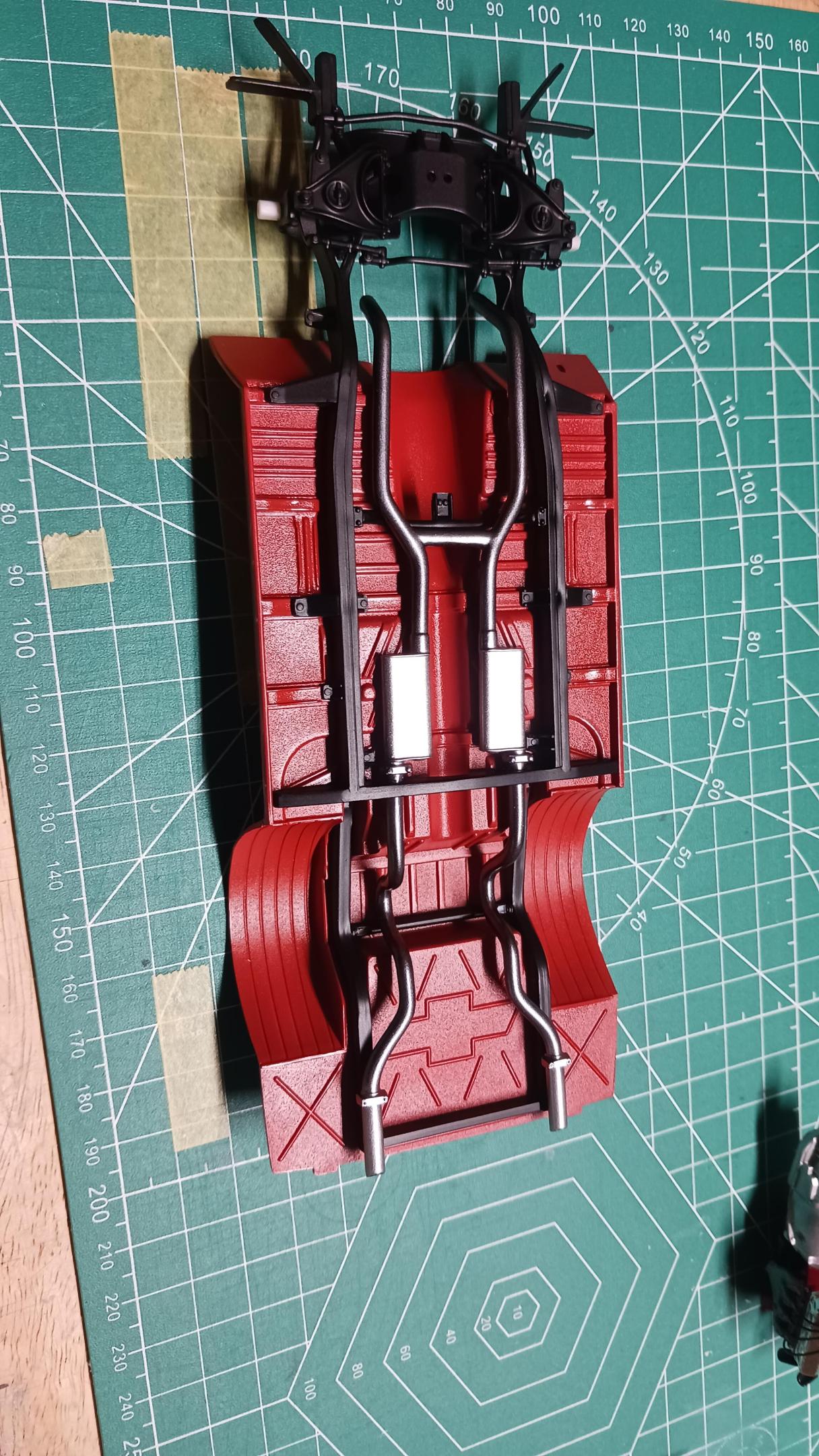

wisco8 Posted September 28, 2024 Author Posted September 28, 2024 11 minutes ago, David G. said: Nice detail and wiring on the engine Steve. I think it looks fine, maybe a light blackwash would help bring out what detail is there. David G. That is a great idea David. I do have most of the Tamiya wash colors, looks like black would work best with a pin wash. Thank you David, Steve

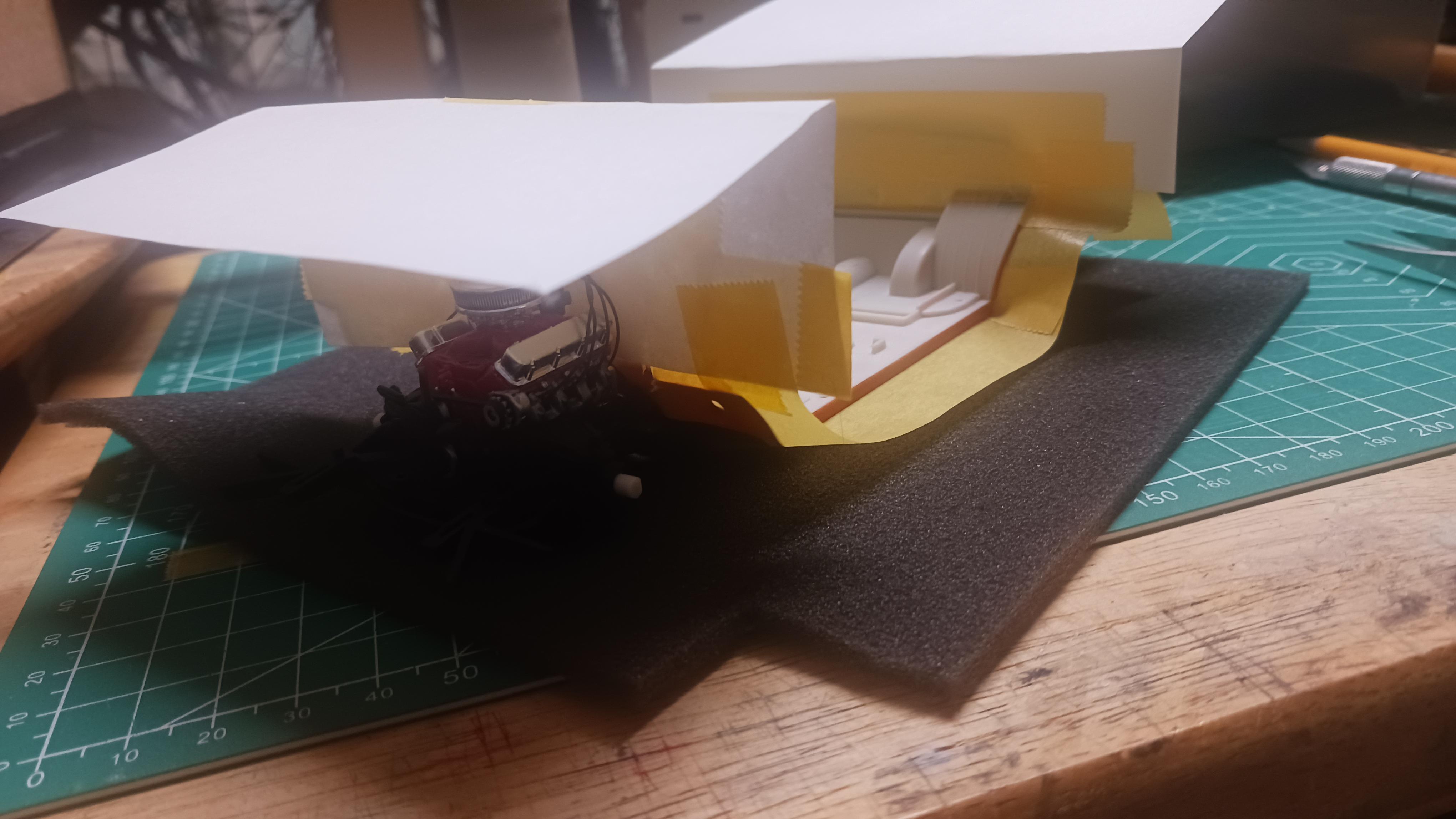

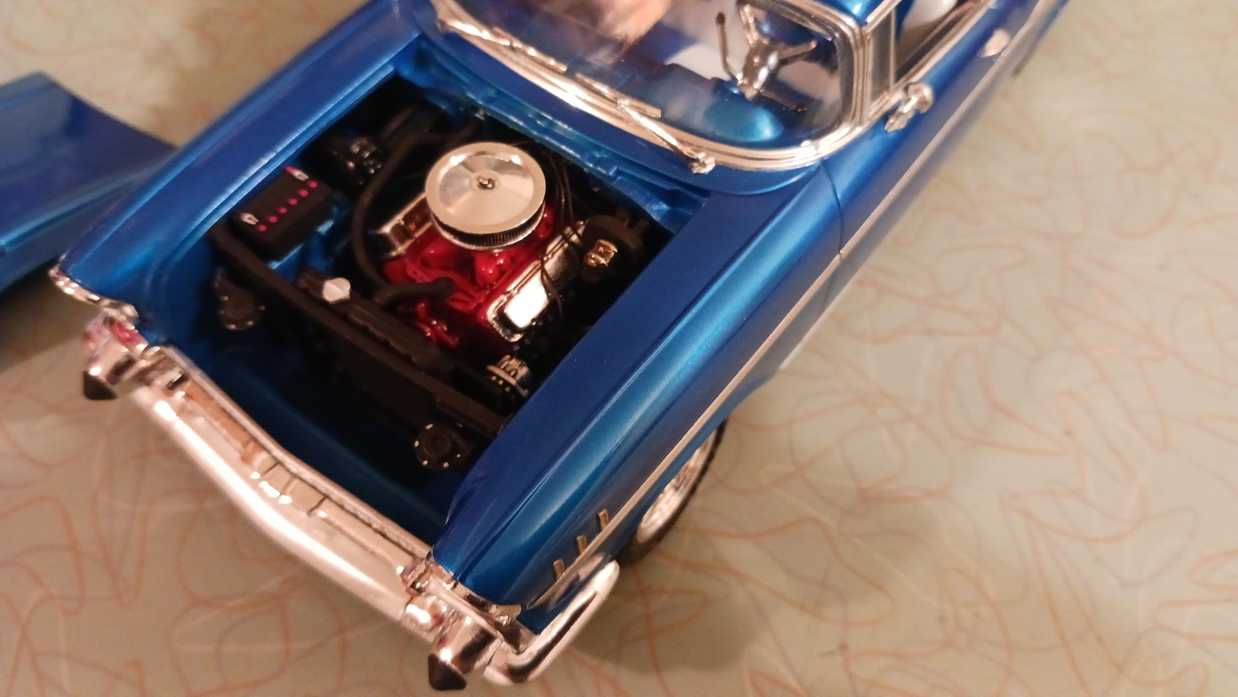

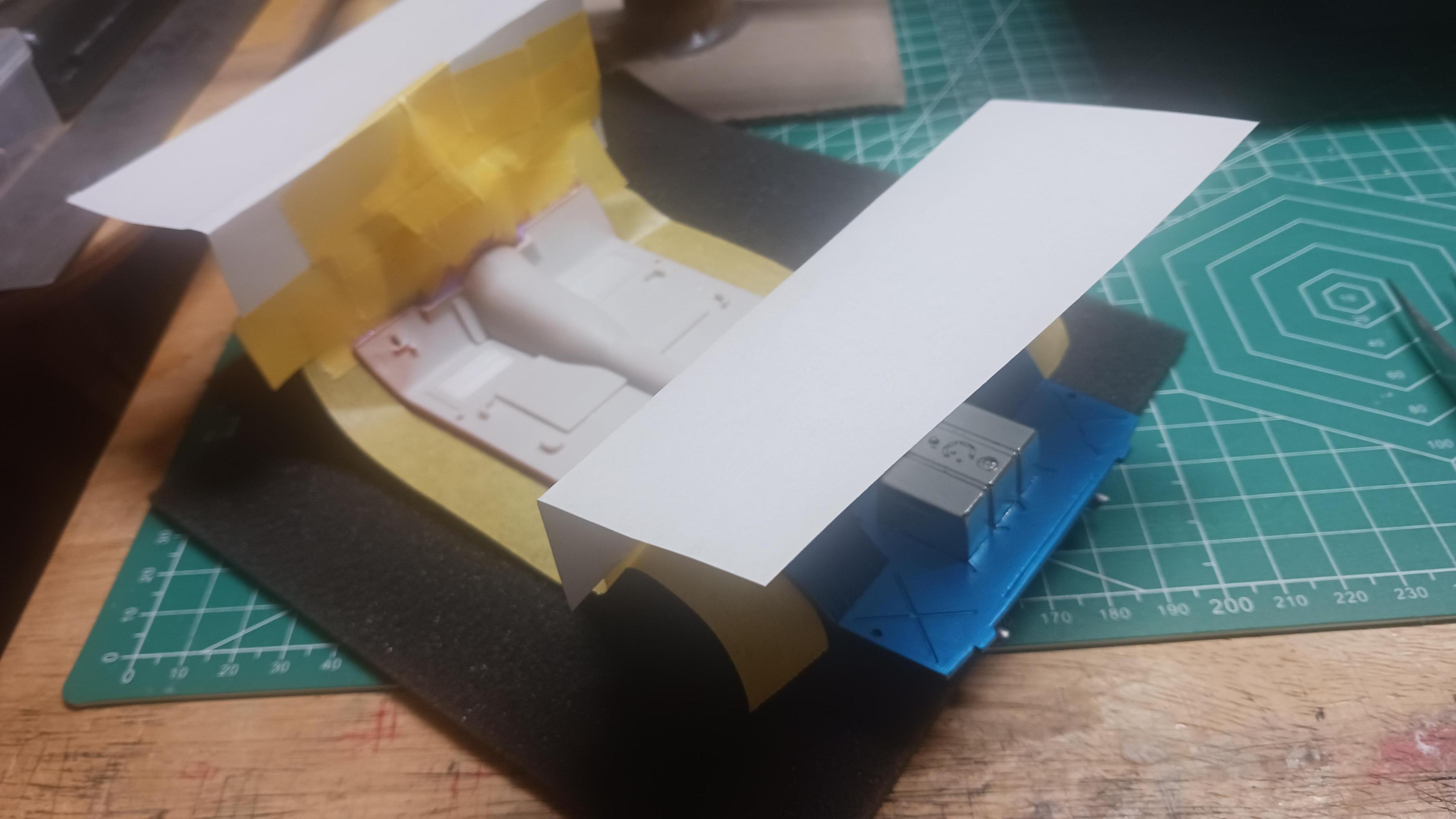

wisco8 Posted September 29, 2024 Author Posted September 29, 2024 Underside painted, trunk area, and engine installed. Masked off the interior for painting. 2
David G. Posted September 29, 2024 Posted September 29, 2024 That chassis is clean and sharp! ? Great looking paintjob! David G. 1

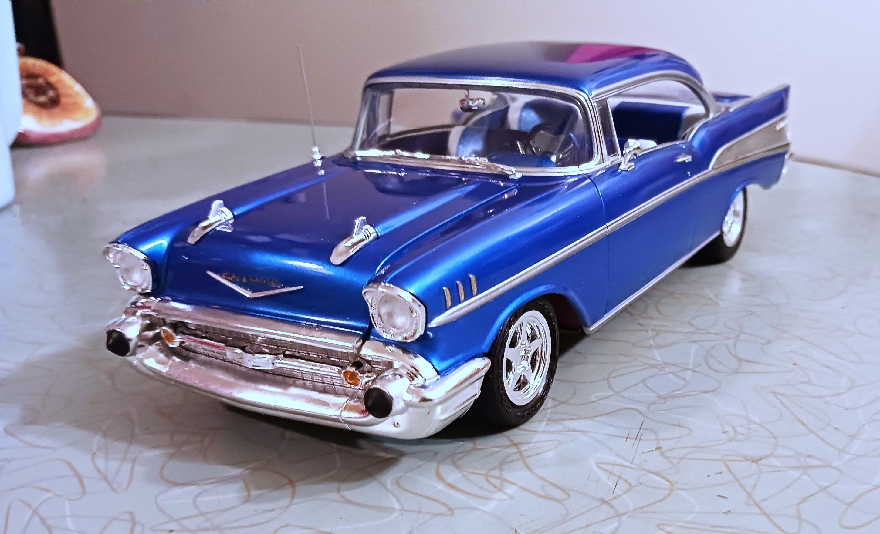

NOBLNG Posted September 29, 2024 Posted September 29, 2024 (edited) On 9/24/2024 at 9:01 PM, wisco8 said: I haven't built many car models lately so this is another practice build to learn more about this model. 1st coat is Tamiya primer and then lightly sanded, followed by a rinse of tap water with a medium soft brush to whisk away any left over sanding residue. Then I applied 3-4 coats of Mr color metallic blue did not sand any of the paint, it would have been a big mistake. I then sprayed 3 coats of Mr color clear gloss followed by a very light wet sanding with 4000-6000 micro-mesh sanding sheets. Then I applied 3 more coats of clear Mr color gloss and wet sanded again with 6000-8000 wet micro-mesh sanding sheets. Finished up with Tamiya med, to fine polishing compound. I know you all have much better methods, so for me this is kind of an experiment.Hope you like it so far. Steve I don’t know what “better methods” could achieve that you haven’t Steve! Your paint finish is stunning.? Love the color, and the chassis is looking great too.? Edited September 29, 2024 by NOBLNG 1
wisco8 Posted September 29, 2024 Author Posted September 29, 2024 4 hours ago, David G. said: That chassis is clean and sharp! ? Great looking paintjob! David G. Thank you David ☺️
wisco8 Posted September 29, 2024 Author Posted September 29, 2024 3 hours ago, NOBLNG said: I don’t know what “better methods” could achieve that you haven’t Steve! Your paint finish is stunning.? Love the color, and the chassis is looking great too.? Thank you Greg. ?

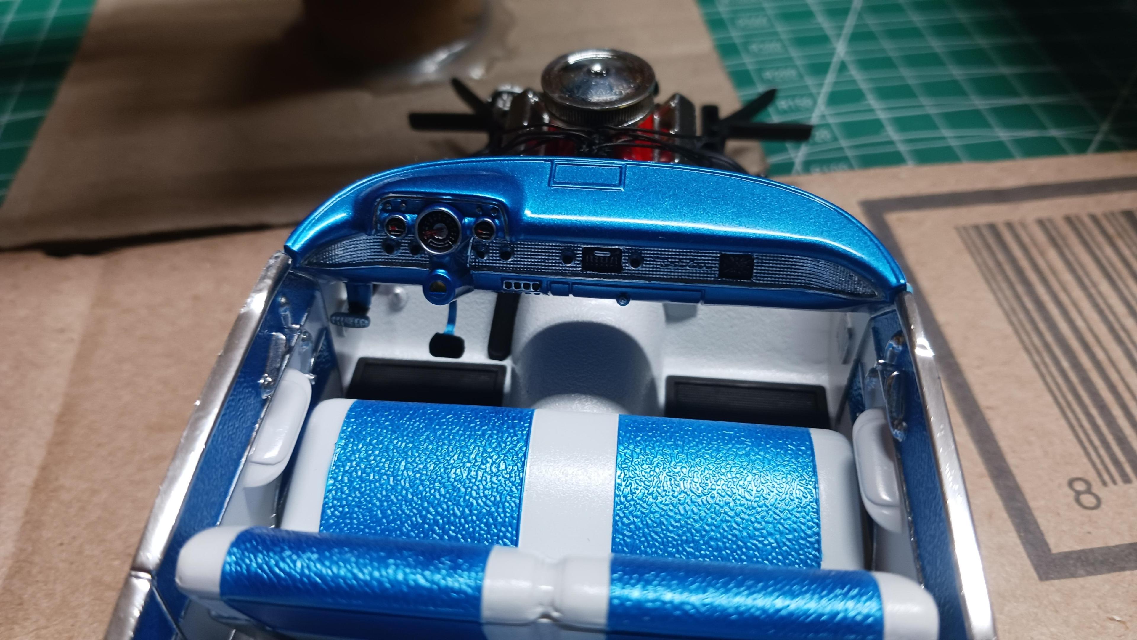

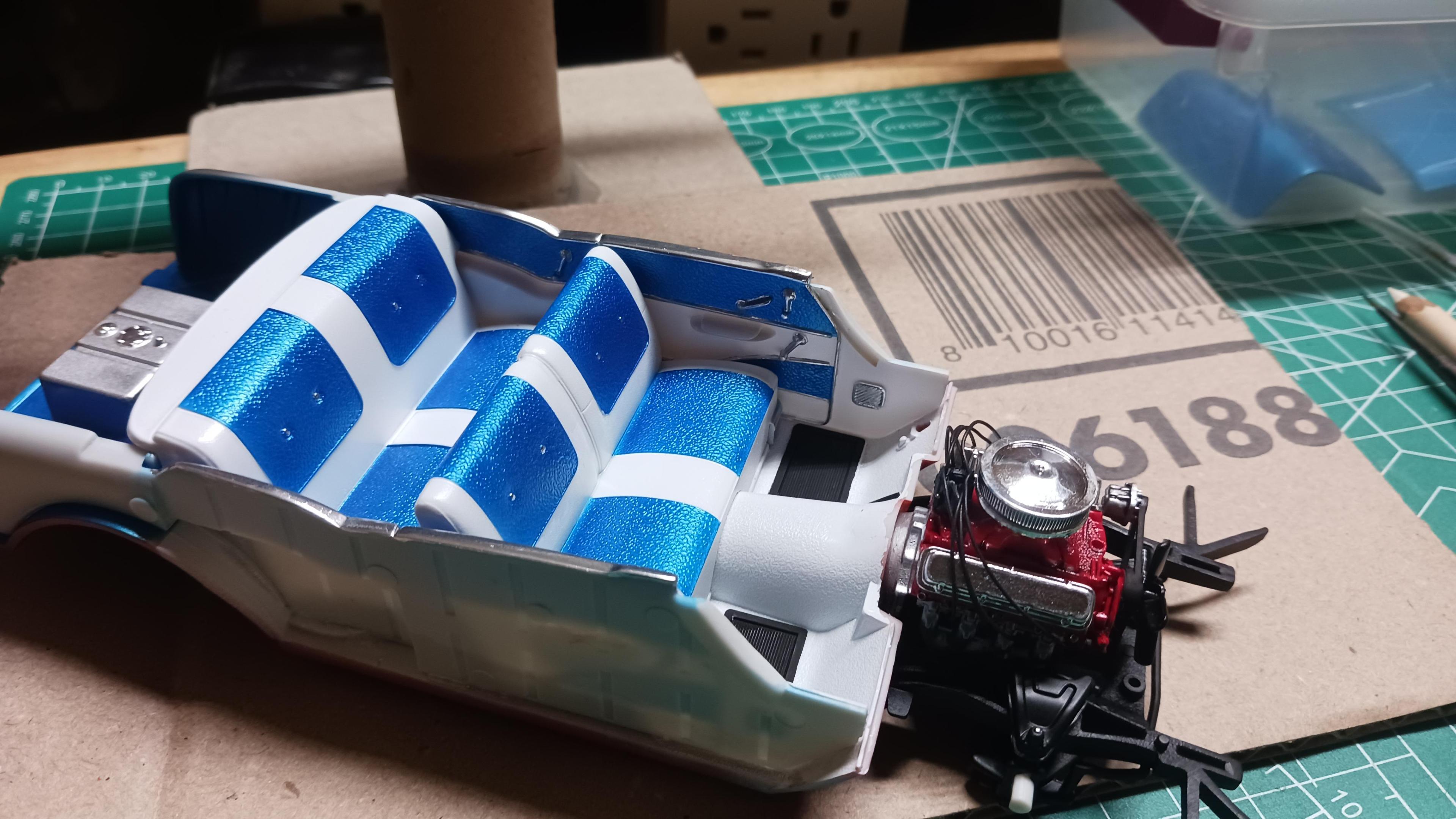

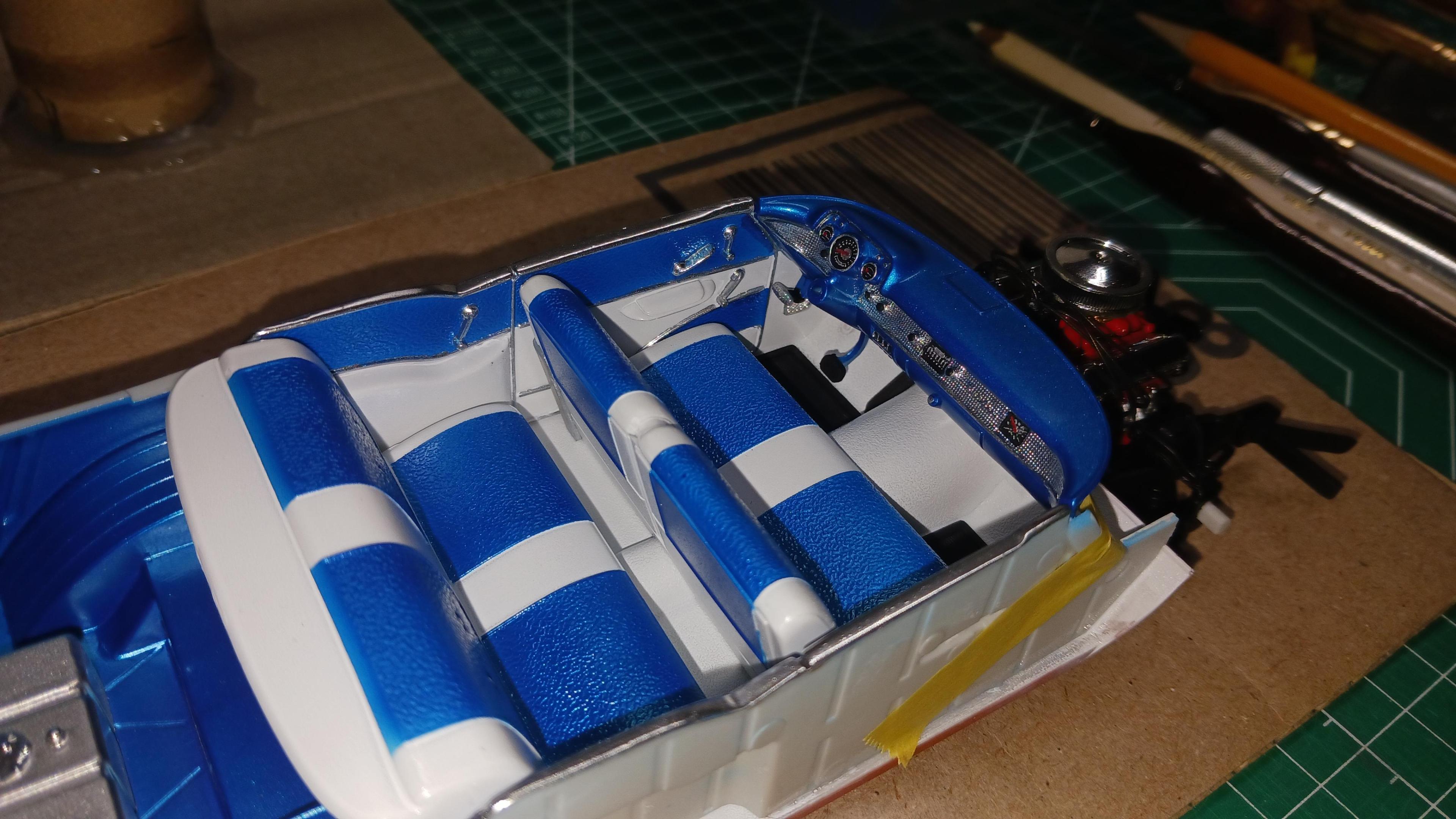

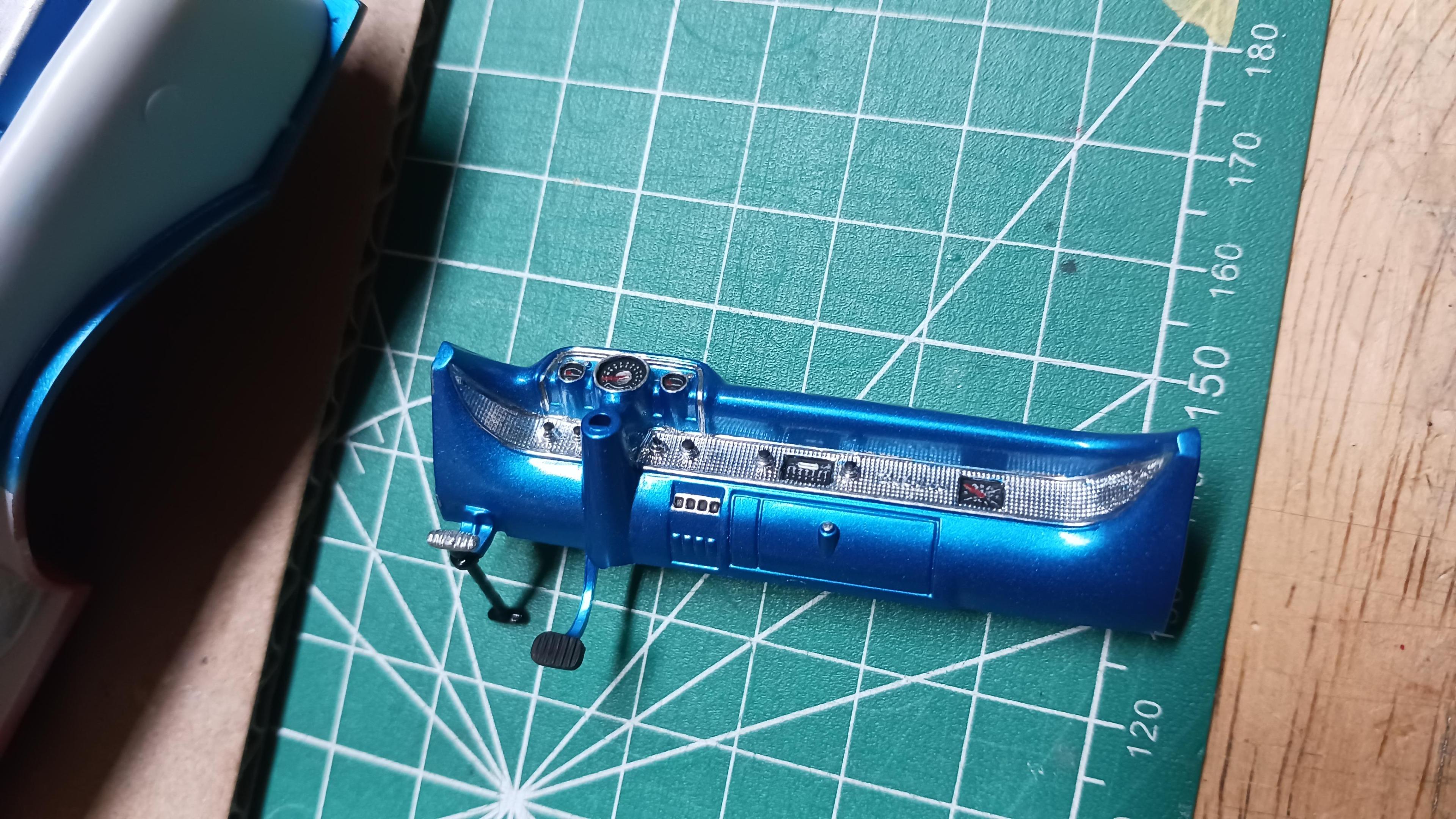

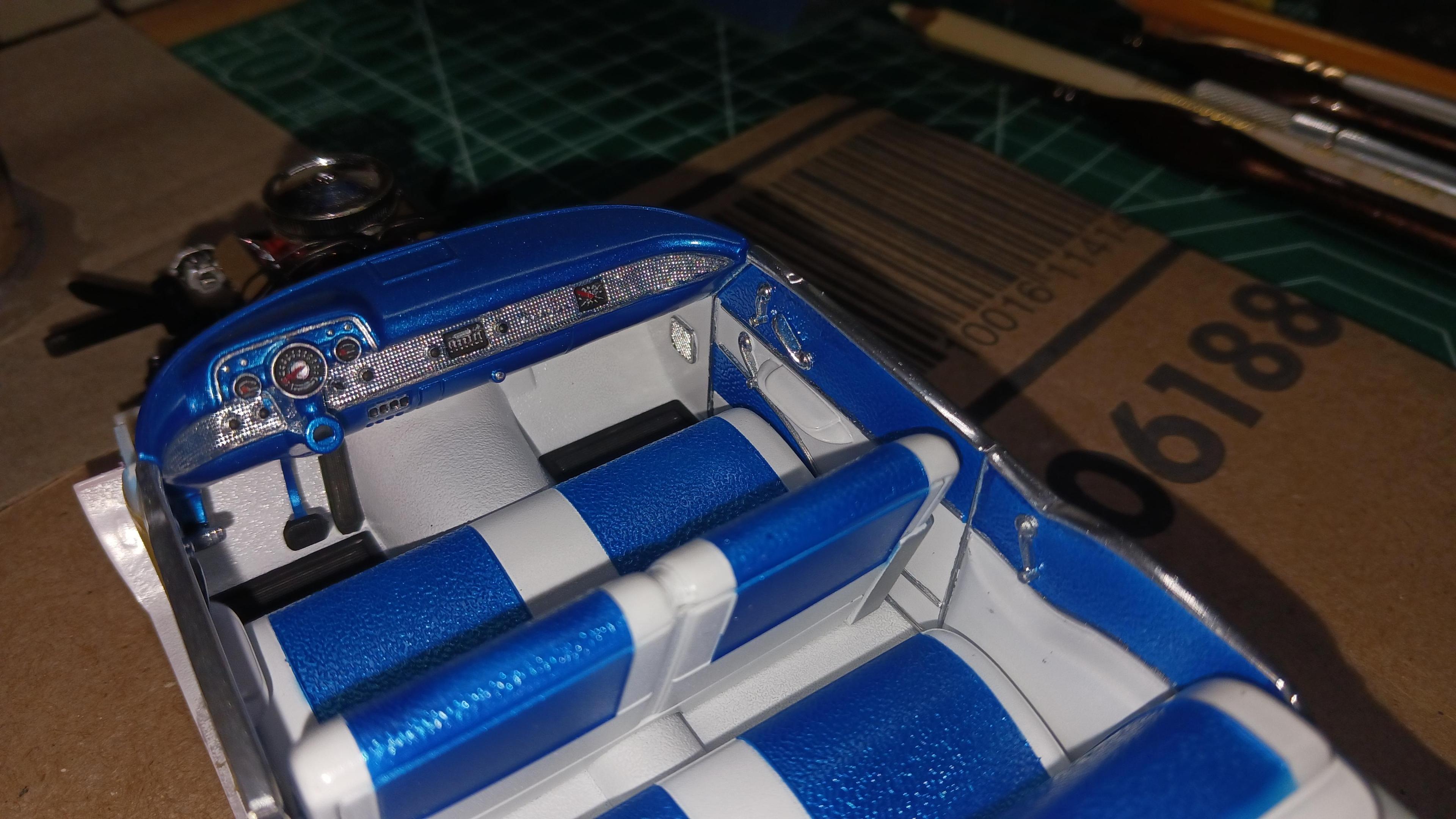

wisco8 Posted September 30, 2024 Author Posted September 30, 2024 Interior painting. Not sure why there weren't any seat-belts included with the kit. 5
wisco8 Posted September 30, 2024 Author Posted September 30, 2024 2 hours ago, deuces wild said: Absolutely beautiful!!!!!.....??? Thank you Sir. Steve 1
wisco8 Posted September 30, 2024 Author Posted September 30, 2024 1 hour ago, Zippi said: That interior looks Awesome dude. Thank you Bob. I'm just taking a break from doing model aircraft for a while. I think model cars are more fun to build. Steve 2
wisco8 Posted September 30, 2024 Author Posted September 30, 2024 4 minutes ago, Moparman18064 said: A big thumbs up! Thank you Rich. The picture of the Cuda brings back some memories of the one my foster brother had, it was a 440 six pack and had a kick that would pin you in your seat. Use to chirp in every gear, and lighted up at intersections like the drag strip without any bleach!! Steve 1
rv1963 Posted September 30, 2024 Posted September 30, 2024 Yep that chassis and interior are looking really good.

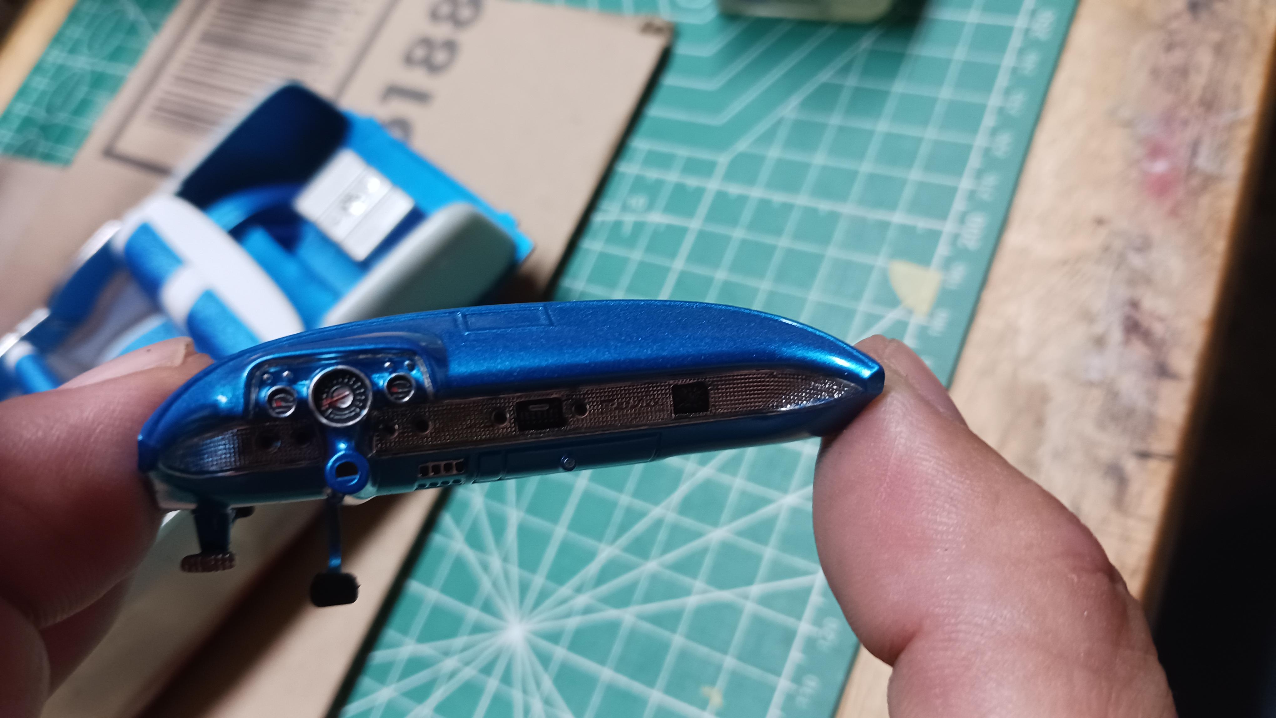

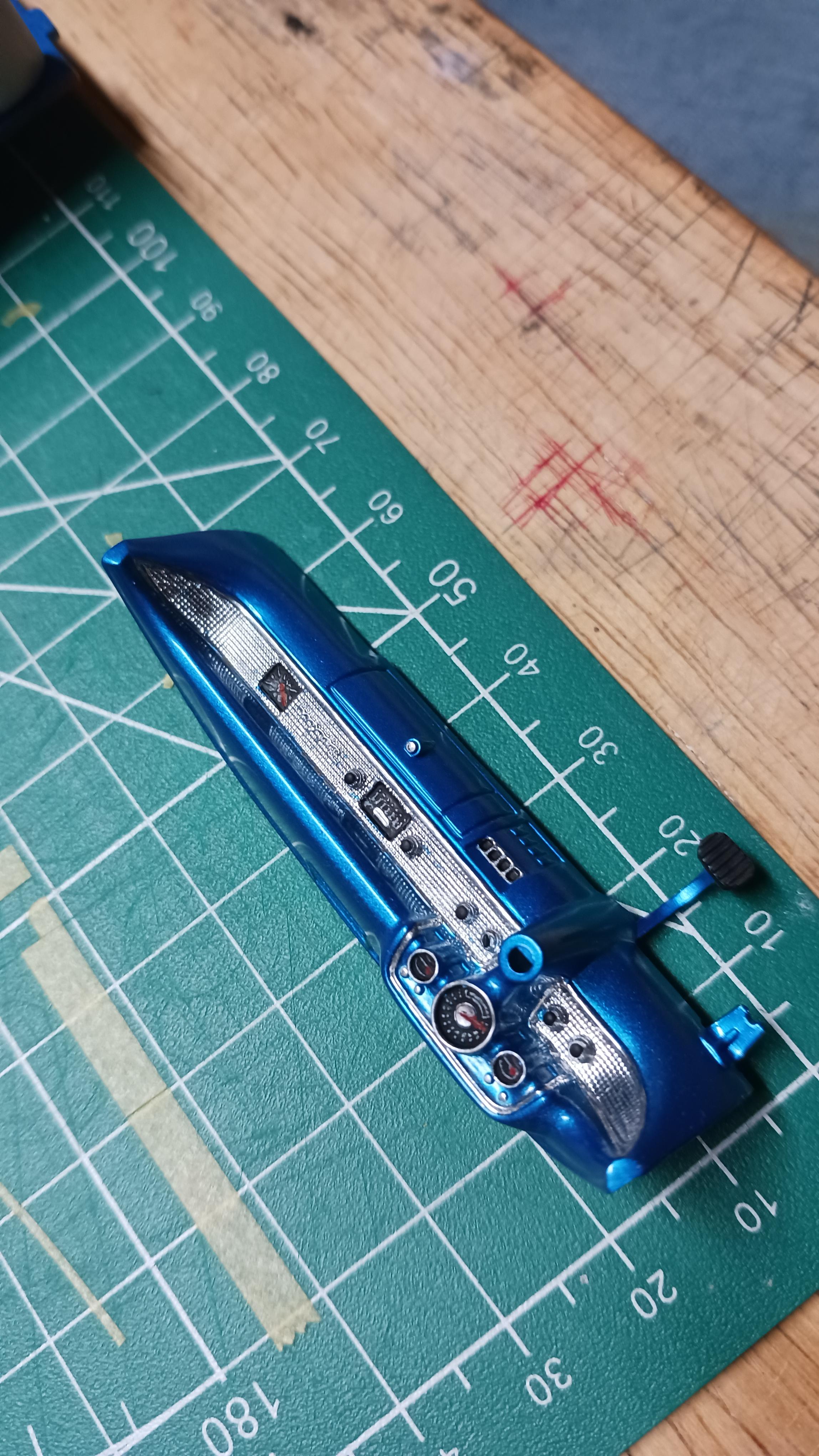

David G. Posted October 1, 2024 Posted October 1, 2024 That dash detail is fabulous! The rest of the interior is great too. David G. 1
Bob Ellis Posted October 1, 2024 Posted October 1, 2024 I have never seen a 57 chevy kit done so nicely 1
gman Posted October 1, 2024 Posted October 1, 2024 On 9/30/2024 at 1:40 AM, wisco8 said: Interior painting. Not sure why there weren't any seat-belts included with the kit. Great work. Seatbelts weren't quite standard equipment back in 1957. I have owned a 1:1 vehicle (sadly not a '57 Chevy) for 41 years that my grandfather bought brand new in 1965. He ordered the optional front lap belts so it has them, but nothing for rear seat passengers. The US government mandated seatbelts be provided for new vehicles in 1968, and local laws required their use much later. 2

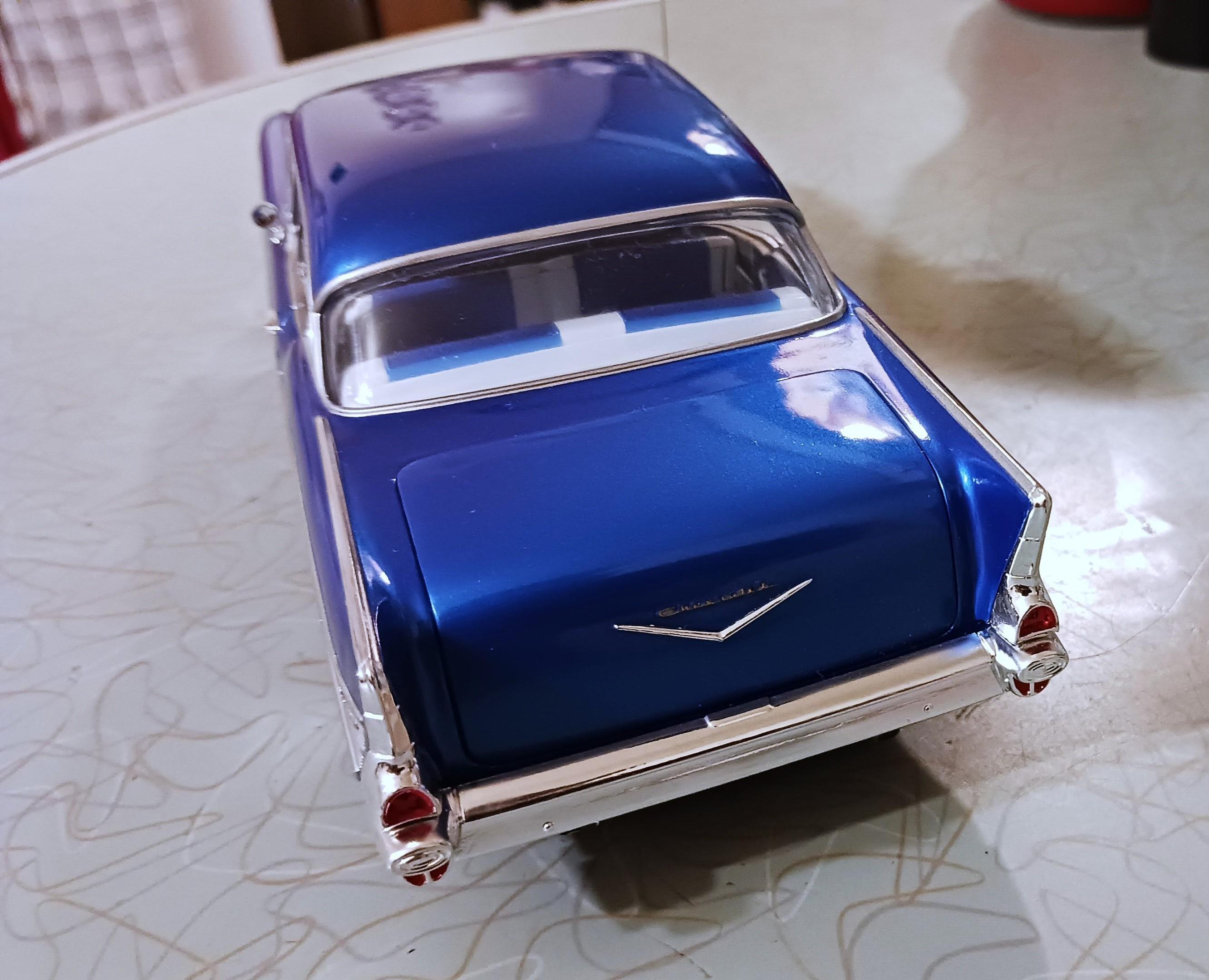

wisco8 Posted October 2, 2024 Author Posted October 2, 2024 Need help with the trunk, how to you get it to open and close. I don't want it in the open position if I have to glue it in place. 3
Moparman18064 Posted October 2, 2024 Posted October 2, 2024 1 hour ago, wisco8 said: Need help with the trunk, how to you get it to open and close. I don't want it in the open position if I have to glue it in place. There is a very good tutorial on this in the main index. You can look up door and trunk hinges
