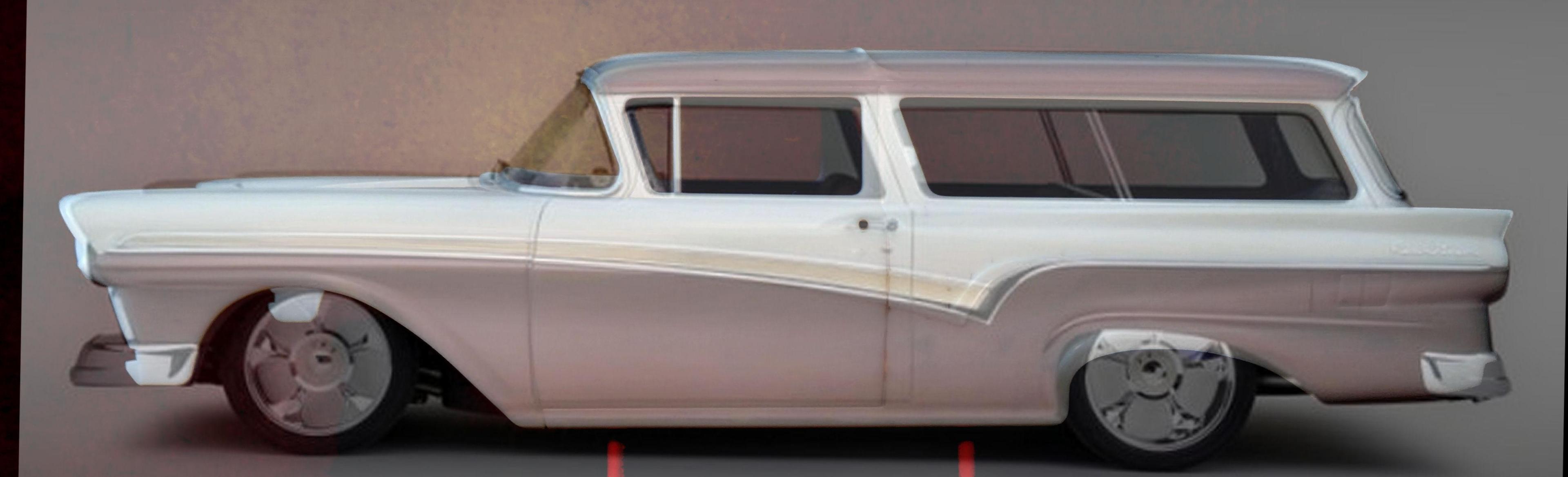

I have no clue on how to replicate the trim but in looking at the rear wheel well on the PV car vs. kit car...the PV wheel well looks cut higher into the quarter panel than the kit car.  Maybe it's just my eyes but...
It certainly looks that way to me, and it also appears the side trim "V" is extended towards the rear of the car. It's really hard to be sure since the pics aren't scaled, but the old eyeball engineering says yes.
Yes, I agree I looks that way and I think it has been to some extent. Maybe when I get home from vacation I’ll take some measurements.
Yes, the side trim has been extended, that’s what I’m trying to replicate. You will also notice the curve of the trim follows the curve of the wheel opening more closely on the PV body.
PV made their changes very subtle so it’s hard to tell what they changed some times.
maybe i can resize the kit photo for comparison
KitFord2.jpg.f5931955310c43a1f2d90b37a76df3ed.jpgPureVisionford.jpg.ed16b6b1419345383e5ed80f0d42d924.jpg
well, not perfect but it helps.  I did crop and flip the PV photo.
Looking at Brians nice side by side pictures of the kit body and the "Shooting Brake" edition, the side trim looks to have a gentler slope as it passes over the door section. The chrome trim extending too the rear looks to be in the stock position on the body.
Thanks Brian, as I’m looking at it now the rear wheel opening is clearly enlarged. If you follow the shadow below the taillight forward it goes above the wheel opening while on the PV it goes straight into it.  So I think I need to start by changing the wheel opening as that will change the perspective on the molding.  As David mentions the slope of the molding looks gentler and I agree because I think the point at the end is at the same height on the PV as the original. Which would mean the molding is longer but doesn’t go down any further.
But what bugs me a bit is the rear section of the molding after the bend looks parallel to the ground on the PV but appears to go downhill on the kit. But that may just be the rake on the PV.

Before  I start carving up this body I decided to do a little more photo editing. I took a few more pics of the kit body to get one to closely match the PV pic. Then I overlapped the two and scaled and adjusted the PV to get the approximately the same size. With the PV on top I adjusted the transparency so I could get a good idea of how things lined up. I have to say the results were surprising.
I was so focused on the molding but it appears that was not changed all that much. The "V" is actually just shifted a bit to the right. And as espo pointed out the slope is a bit gentler. But it doesn't dip any lower. ? The big difference is the rear wheel opening. As the image above provided by DJMar indicates the wheel opening was raised 2 1/2". Along with the eyebrow over it.
So I think at this point the first thing to do is cut out the wheel opening, remove 0.1 inch from on top of it and shift it northward. Then maybe scribe the new door edge and see how things look at that point. Wondering if it is even worth doing anything with the trim.
Another observation is the gas door. The larger of the two doors and the one favoring the left is the PV. As it says in the above illustration PV shrunk the door, but that doesn't appear to be the case here. Maybe the kit door is smaller then it should be. I think I can probably just leave that as is.
