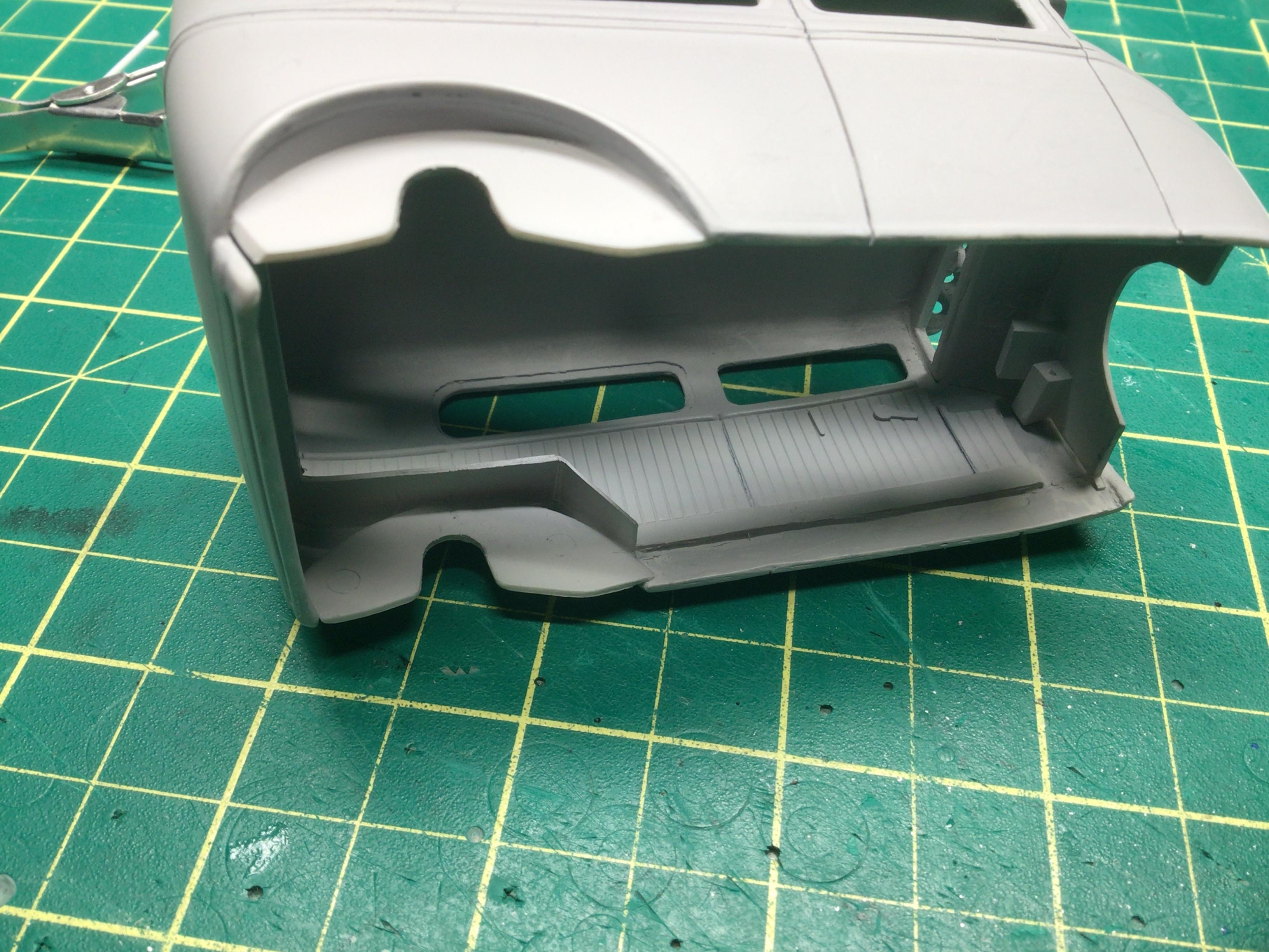

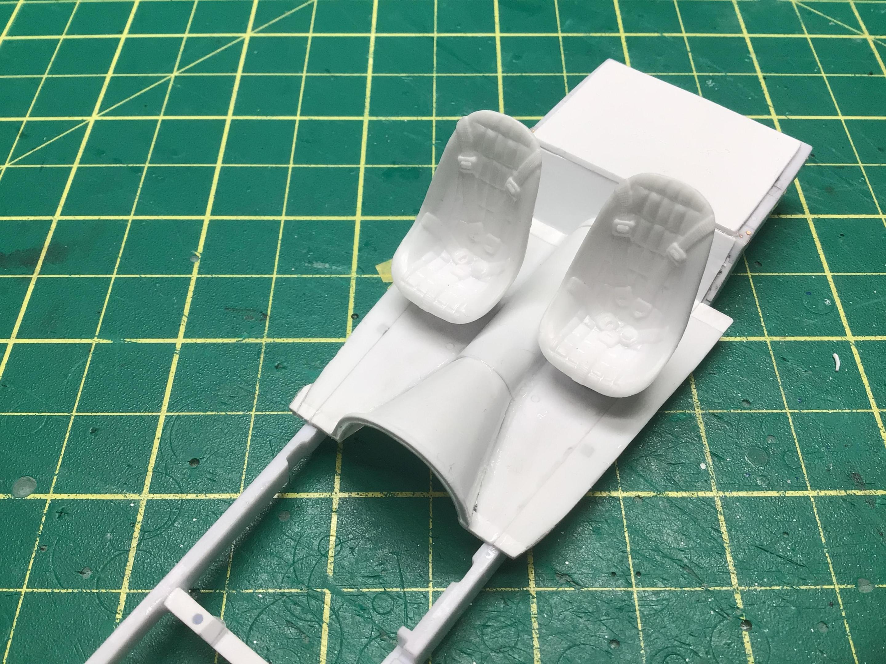

Well that turned out to be a half-baked plan.🙄 I couldn’t get seats to fit up into place with those floor pan sections attached to the body. So I re-attached the lower sections to the frame. The rearward part will still work as is.

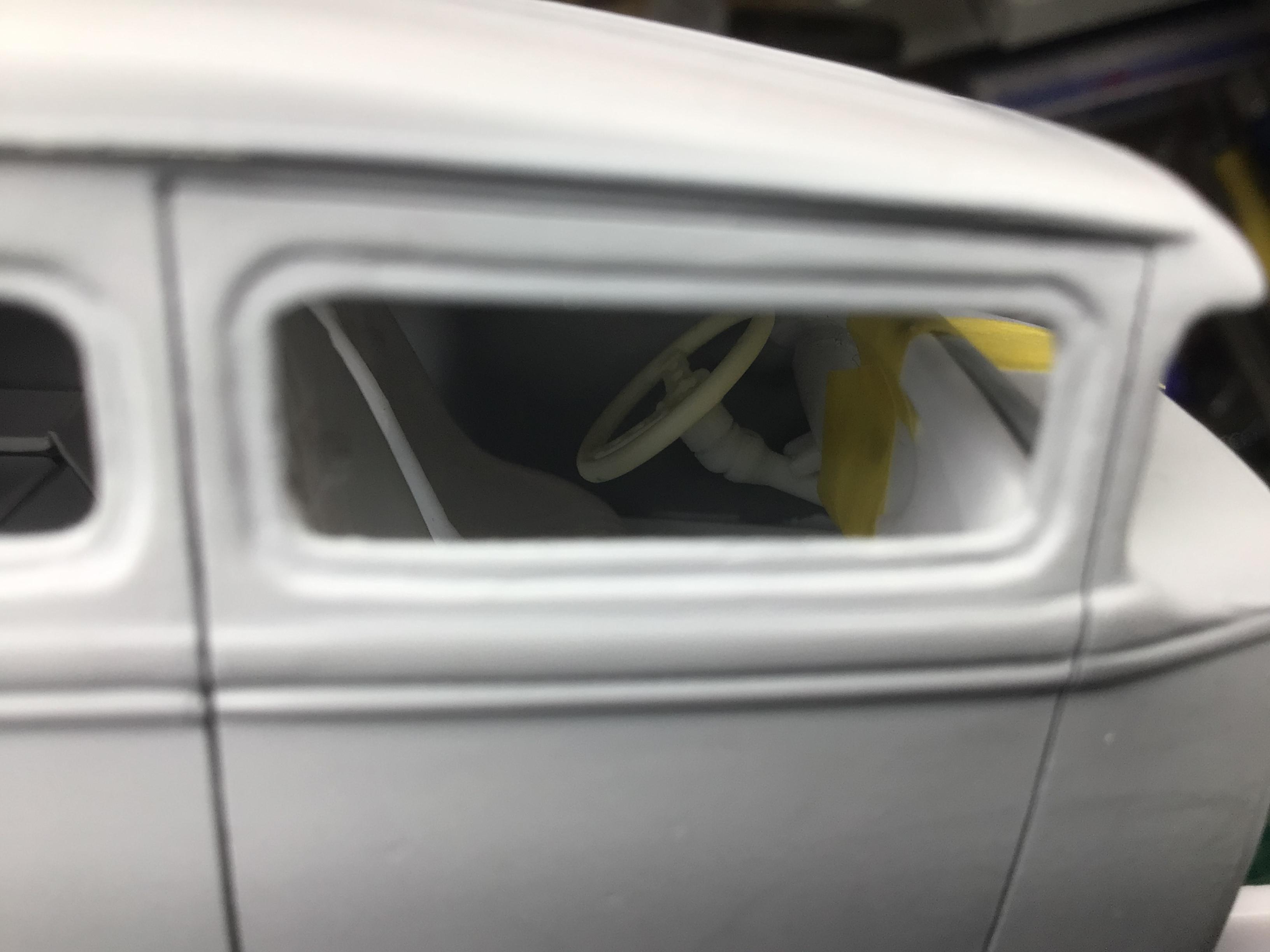

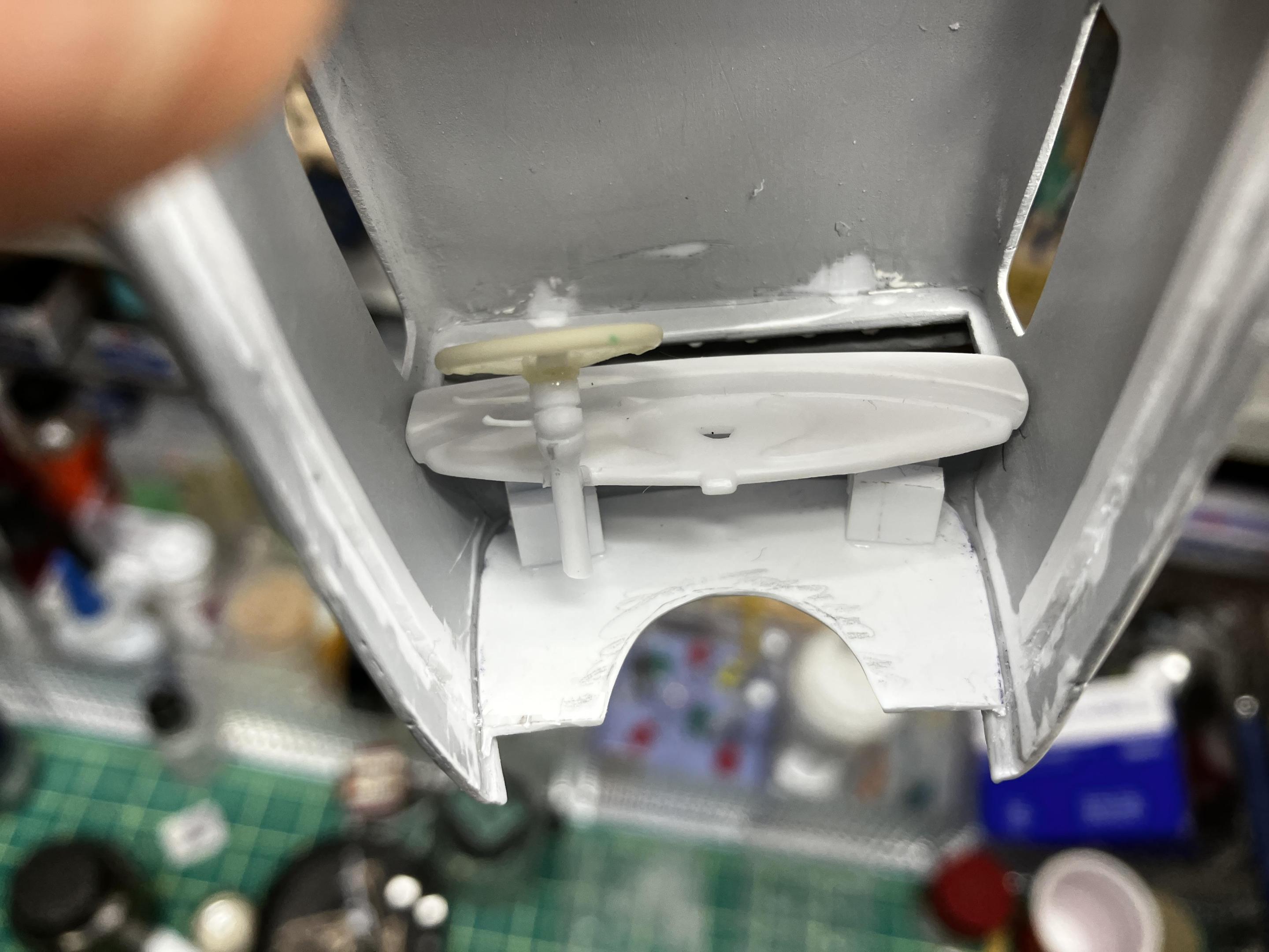

I have been working on mounting the dash and a few blocks of evergreen glued to the dash and firewall give it a positive mounting location. I scratch built a tilt steering column and mounted it to the dash.

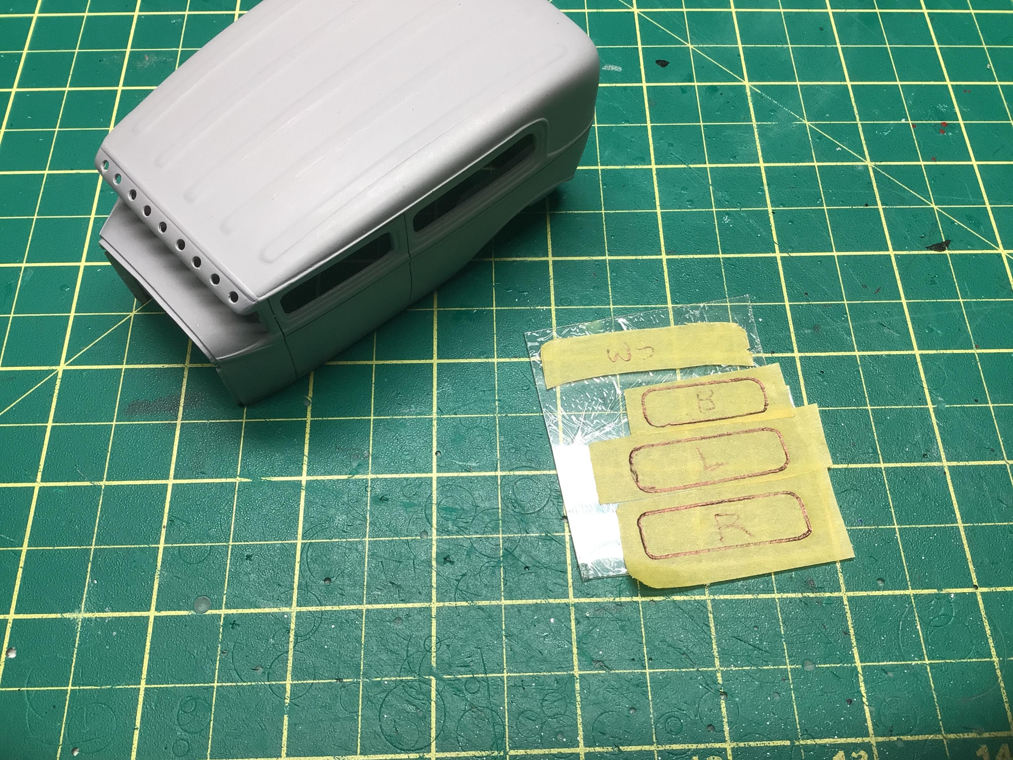

Also made patterns for the windows. That’s all for now.🙂

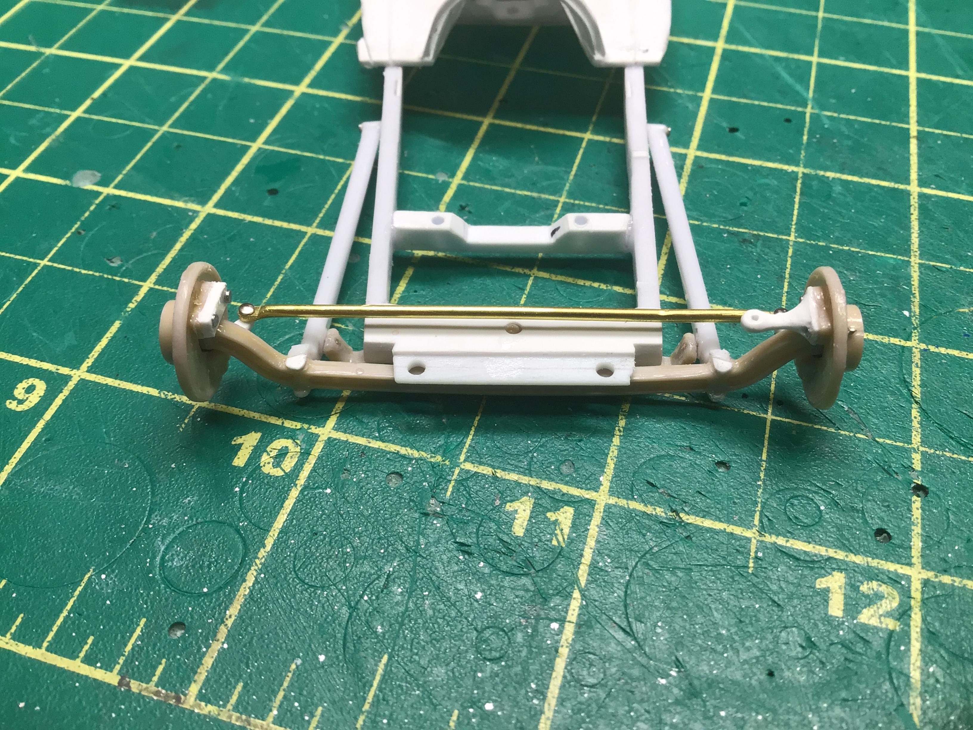

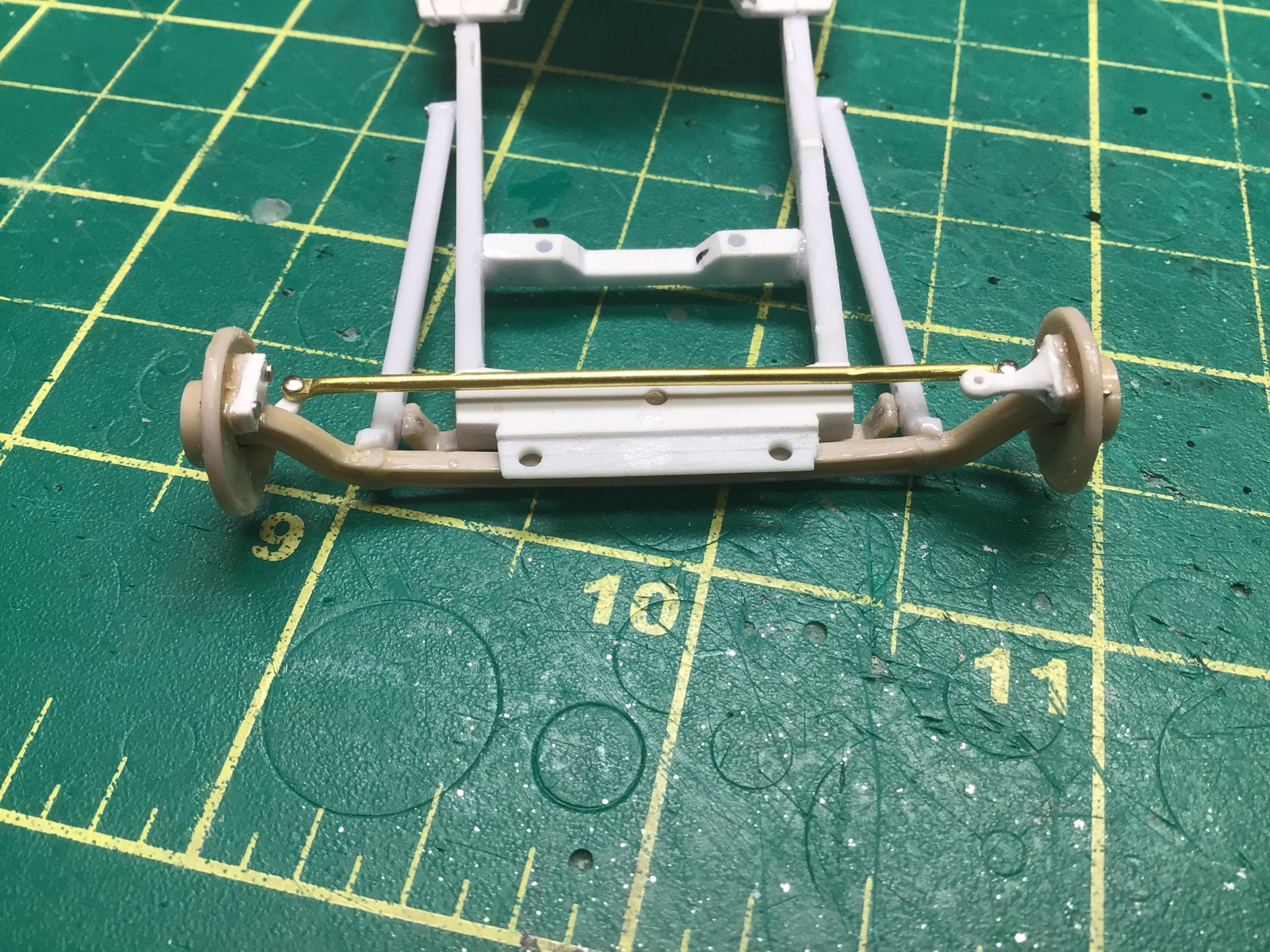

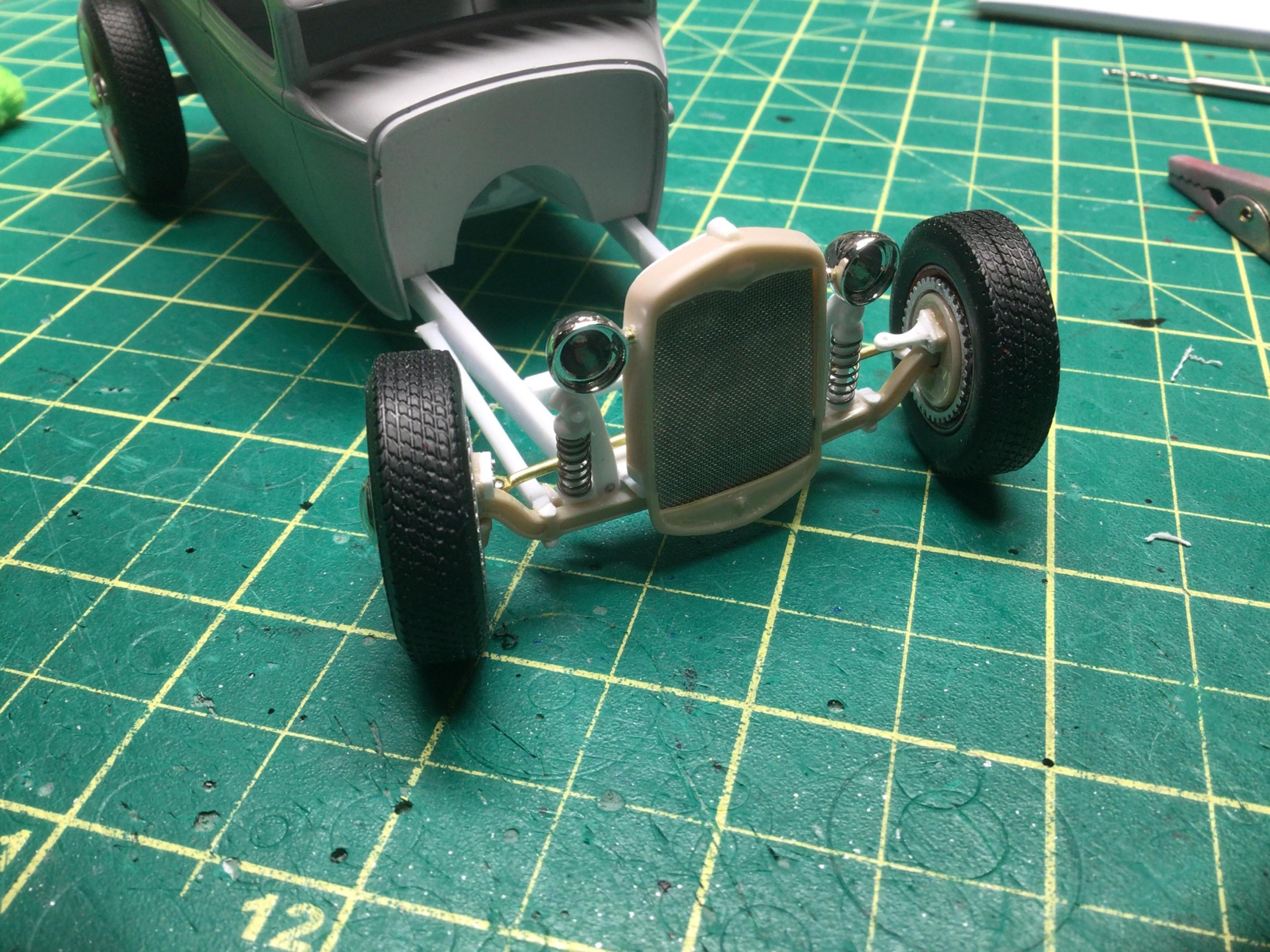

Thanks for the compliments fellas!🙂 The kit has some very nice steering components, but they won’t work with my modifications. Plus, they are meant to be glued in place I think, and I want pose-able steering. So I made a new steering arm from evergreen and a new tie rod and drag link from .047” brass rod.

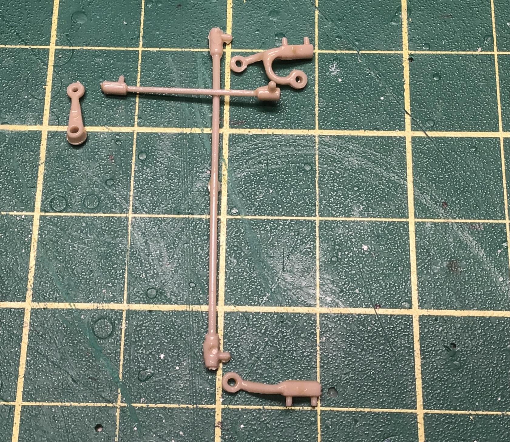

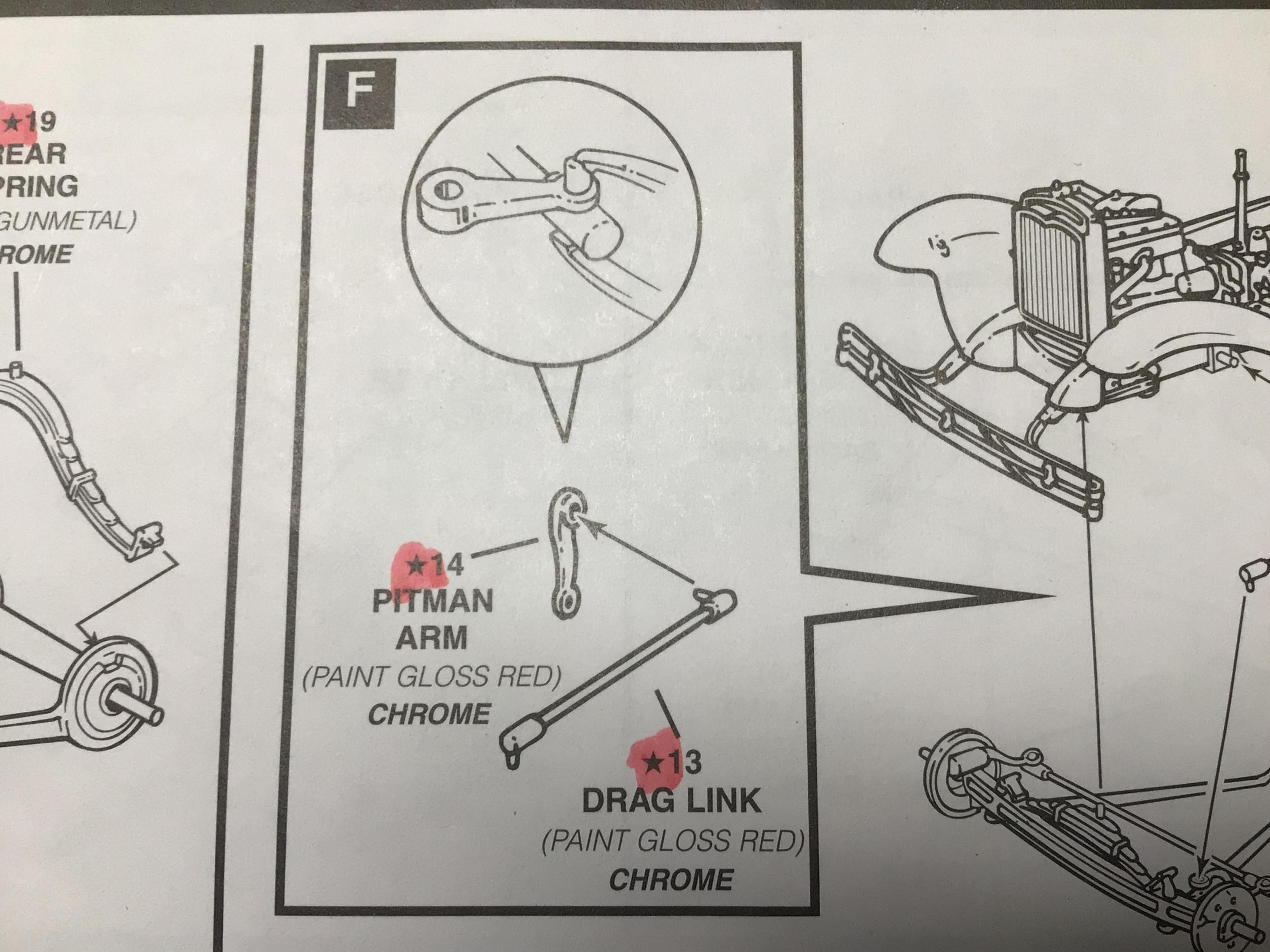

... The kit has some very nice steering components, but they won’t work with my modifications. Plus, they are meant to be glued in place I think, and I want pose-able steering.
IIRC from several hundred years ago, the pins on the steering parts were originally s'posed to be melted flat on the ends with a hot knife or screwdriver blade...after assembly, of course.
Anyway, she's still coming along nicely.  :D
  • Like 1
Well it’s been a few weeks since I looked at the instructions,🥴 but the actual pins don’t seem long enough to get melted? That does seem to ring a bell though….maybe I read it on someone’s build thread?🧐 Now that I look out of curiosity, the only reference to joining the steering components is this picture.

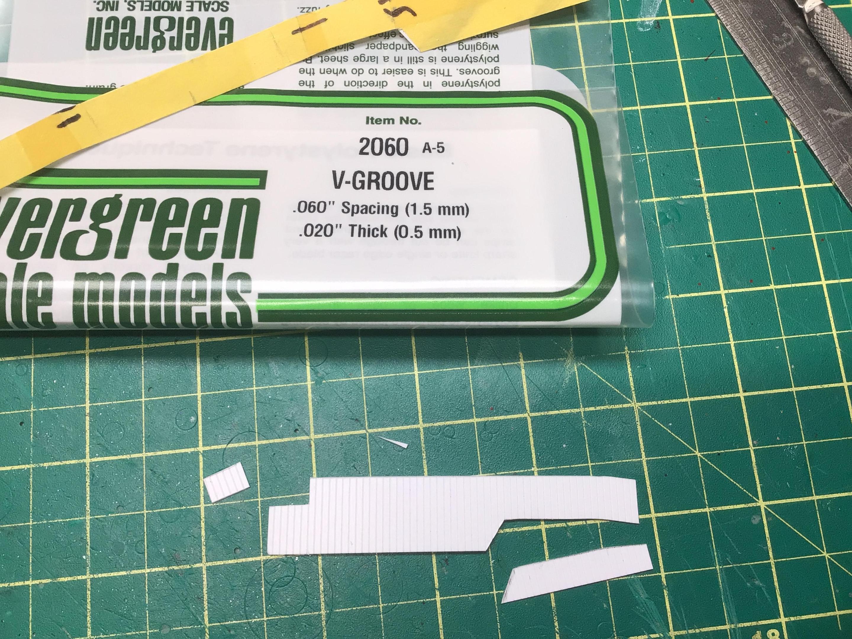

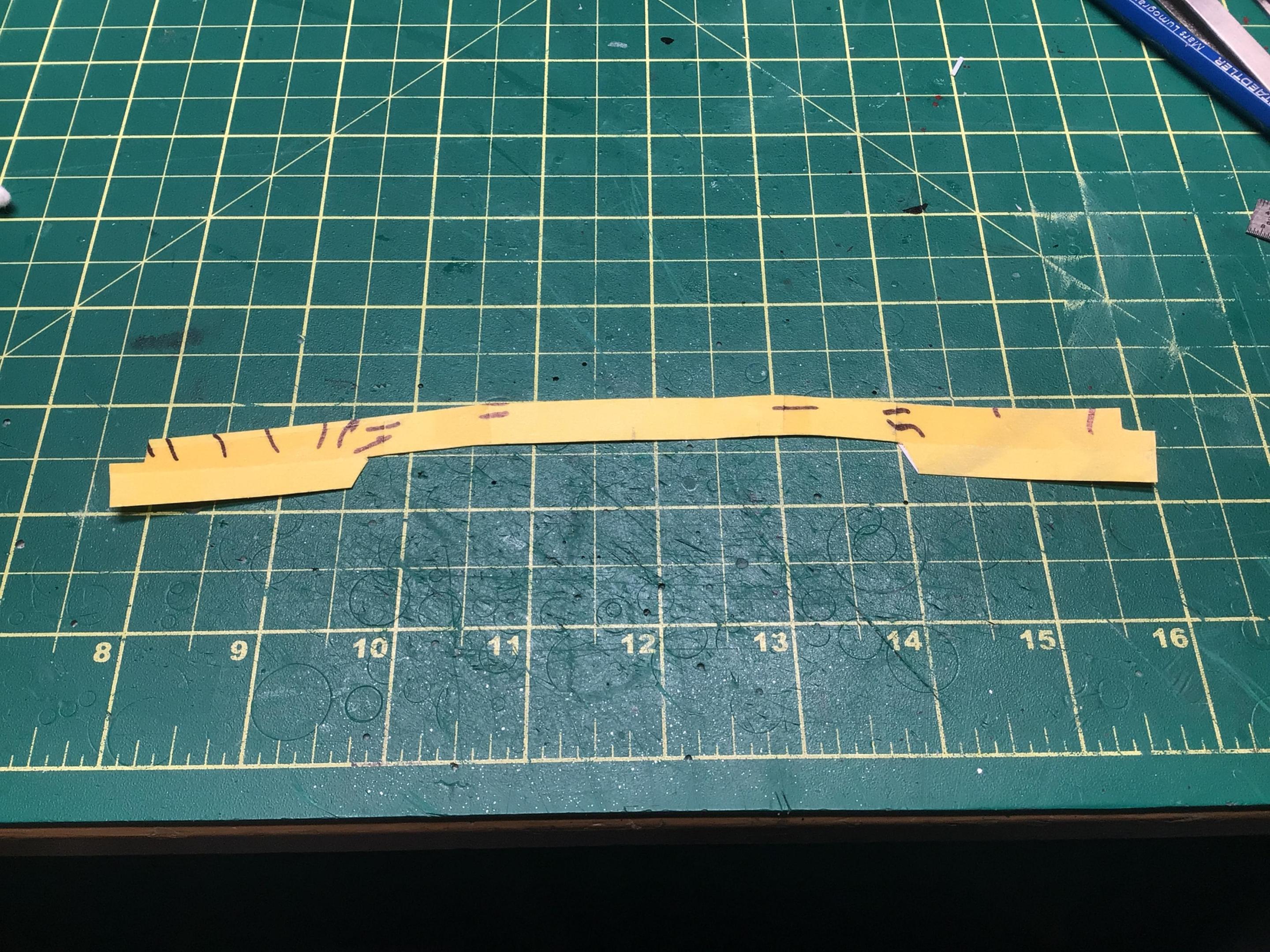

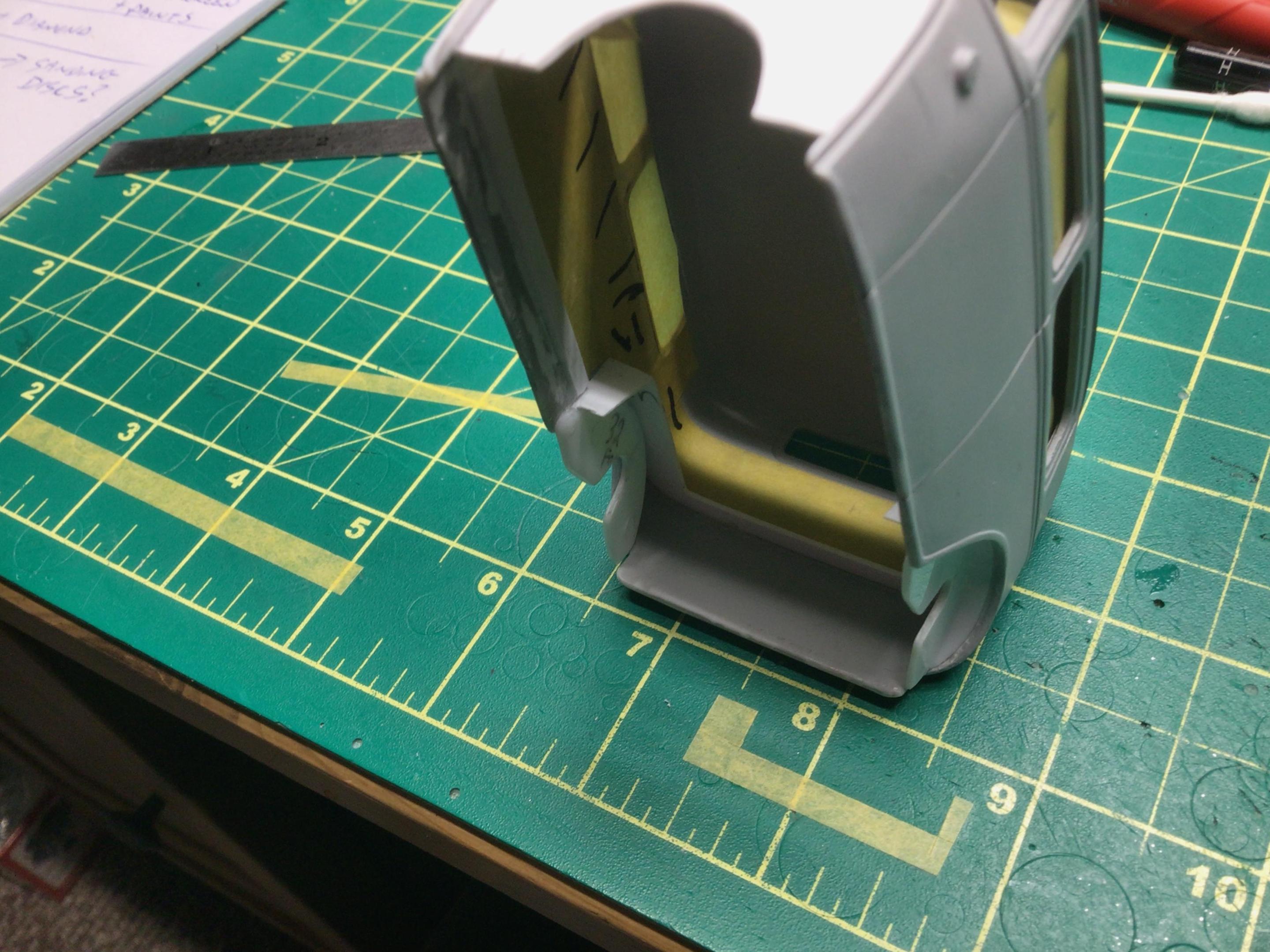

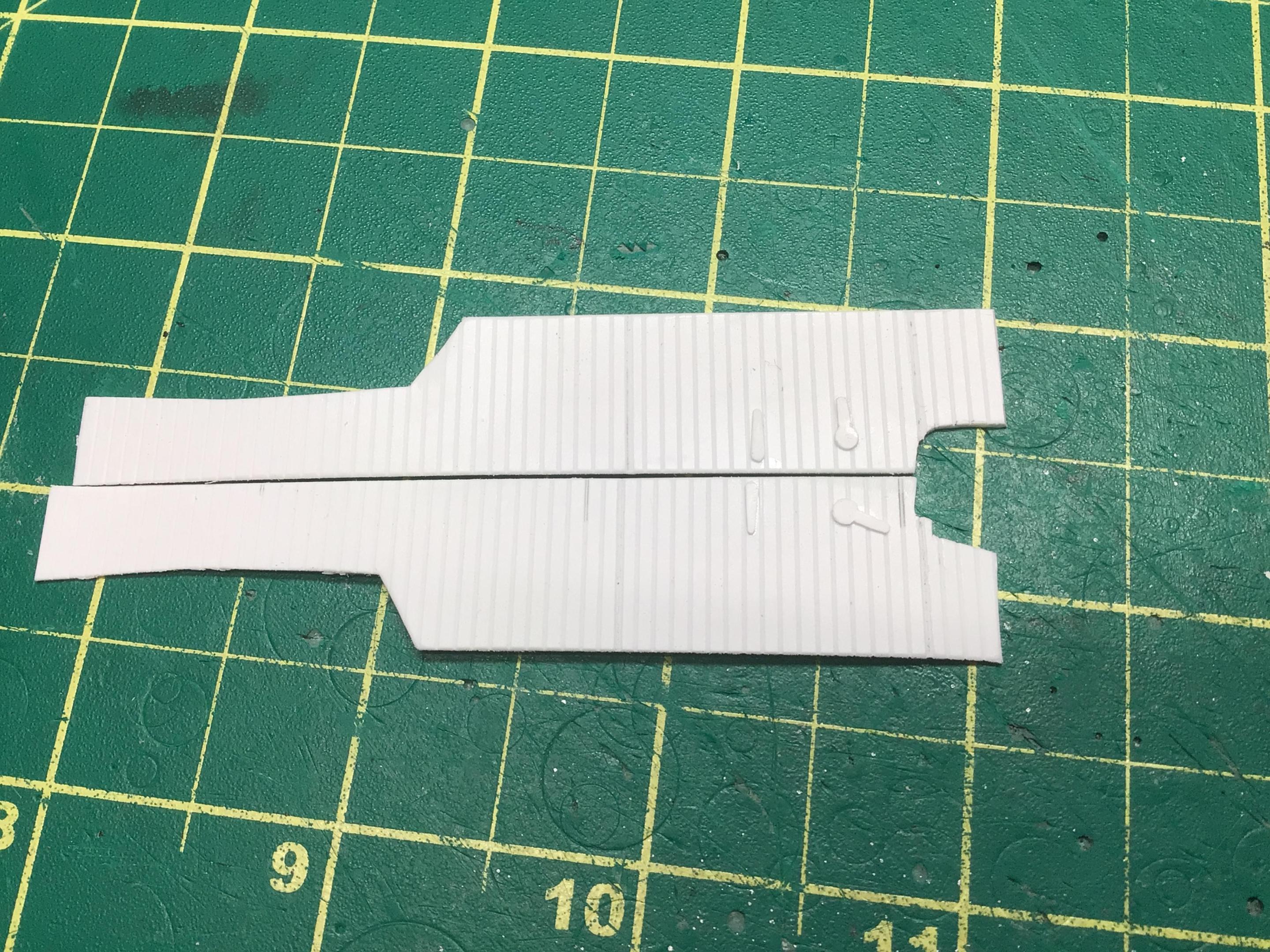

Added a rudimentary interior by making a pattern out of tape. I was hoping to do it in one piece, but the body taper would not allow keeping the pleats vertical.
So I chopped it into three sections and made them from Evergreen V-Groove sheet. Then made some simple handles and window cranks.
I glued them in with thin CA and topped it off with some .040” half round. Nothing spectacular, but better than nothing or what the kit provides.

I fixed the missing tabs on the radius arms last night, and today I built some shock absorbers and mounts, and mounted the headlights.
