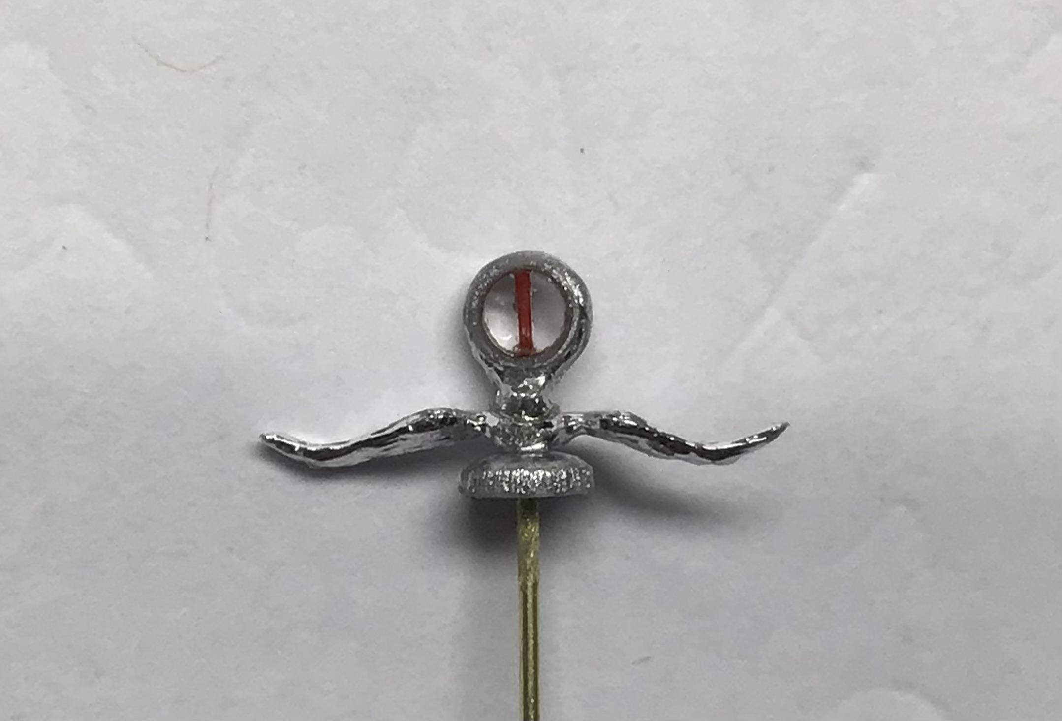

Well I can’t let you wait.🤪 I did a little work on the rad cap and since we can’t post pics at the moment, I will try my best to describe it.
This kit comes with a 3 piece setup. It consists of a chrome radiator cap, a very elegant looking set of spread wings and they are topped off with a Boyce Motometer temperature indicator. It is an exquisite combination that I feel would greatly benefit from a little detailing. The cap itself has the mounting hole off center, so I made a new one from a piece of 1/8” evergreen. I first rolled it over a file to get a knurled edge, then domed it slightly and cut it to length. It then got the Molotow treatment.
Next, the wings themselves are quite nice, so I only trimmed the sprue attachment points and touched them up with Molotow.
Now the Motometer unit needed the most work. I started by drilling a small hole through it and gradually enlarged it until finally sizing it with a #44 drill bit (0.086”). While doing it I broke the little mounting stub, so I drilled it for a new 0.020” brass mounting rod.
I then took a piece of clear sprue chucked in my drill and filed it down to approximately 0.0860123” for a nice press fit.😬 I used a razor saw to slice off a piece which happened to be exactly (give or take a bit) 0.032” thick. I polished it with my micromesh pads until it was smooth and crystal clear. Then came the tricky part….I used a #80 (0.0135”) drill bit to drill a hole edgewise exactly (give or take a bit) through the center of the disc. I used a piece of 0.010” rod to push a little Tamiya clear yellow paint into the hole.
I carefully pushed the disc into the hole of the Motometer temperature indicator. After a few trial attempts (give or take a couple) I got it installed with the hole aligned vertically. I then slid the wings and the new cap onto the previously installed brass rod and fixed them with a touch of CA.
Thank you all for sharing this endeavour with me. I can only hope that the photos to follow eventually will do this description justice.😞

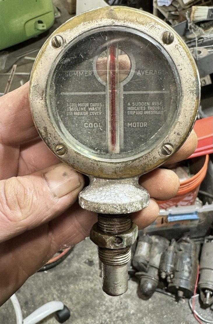

Can post pics now.🙂 These were not a factory ford item I believe, but an option that was available to a number of manufacturers. It was patented by Boyce in 1912 and was pretty much obsolete by 1930 or so due to dash mounted guages. But it looks cool so I’m using it.😎IMG_7510.jpeg.e0ba434a8a83cb683386699f4737203a.jpeg

Nice added touch there Greg.  And yes, that was an aftermarket item, I have seen some that were quite elaborate. I would imagine you would need to have pretty good eyes to read some of the from behind the wheel.

Yes. Apparently the hole in the front plate was to allow the light from oncoming traffic to illuminate the thermometer tube. It the driver sees red he knows the engine is too hot. I am currently recharging mine with the proper red fluid.🙄 I’m not going to bother with the disc though, it’s just too tiny to see.

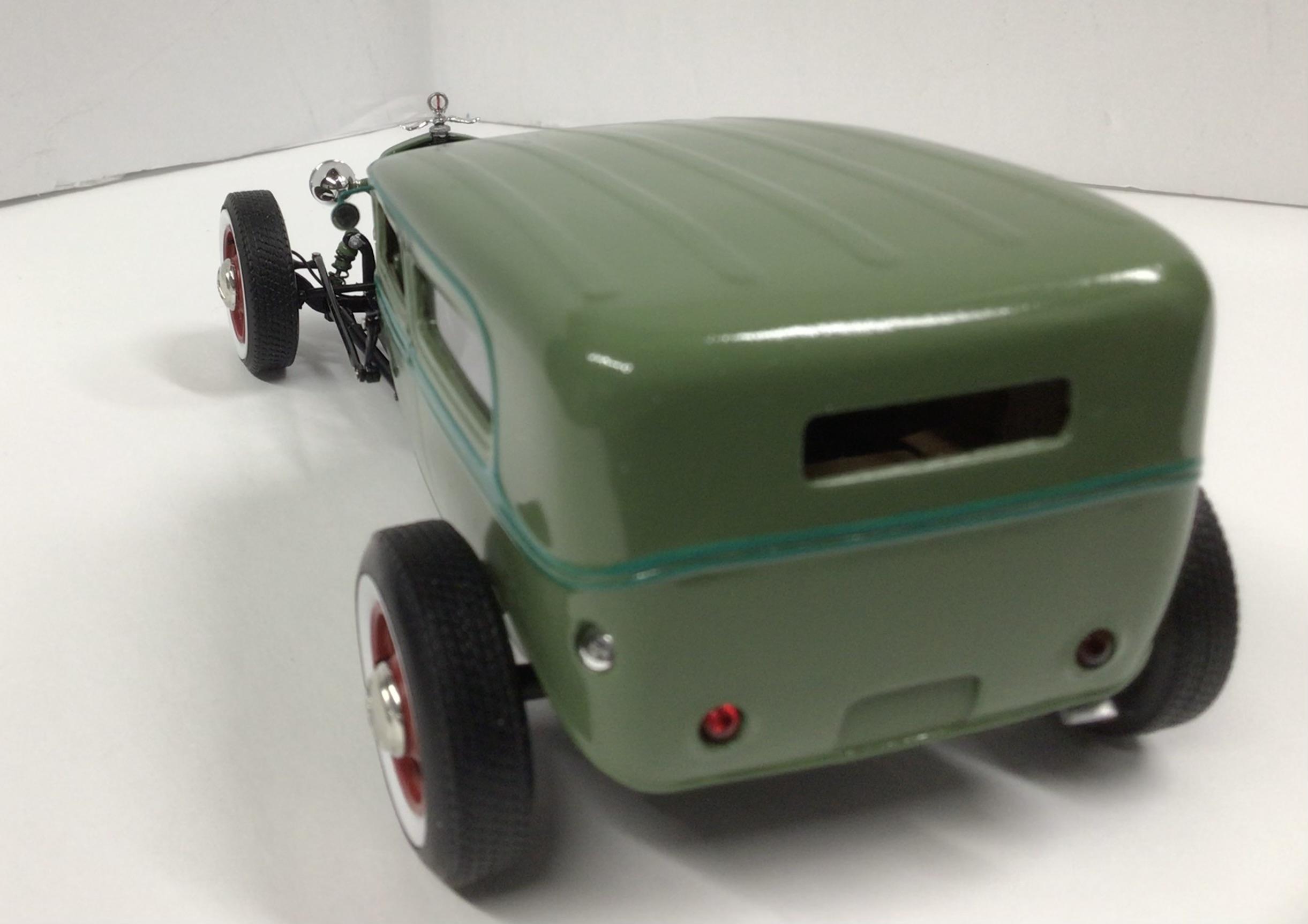

I got the steering gear connected and a side mirror installed, so this one is pretty much done. I just need to install the door handles, a license plate and a couple of paint touch ups.
  • Like 6
