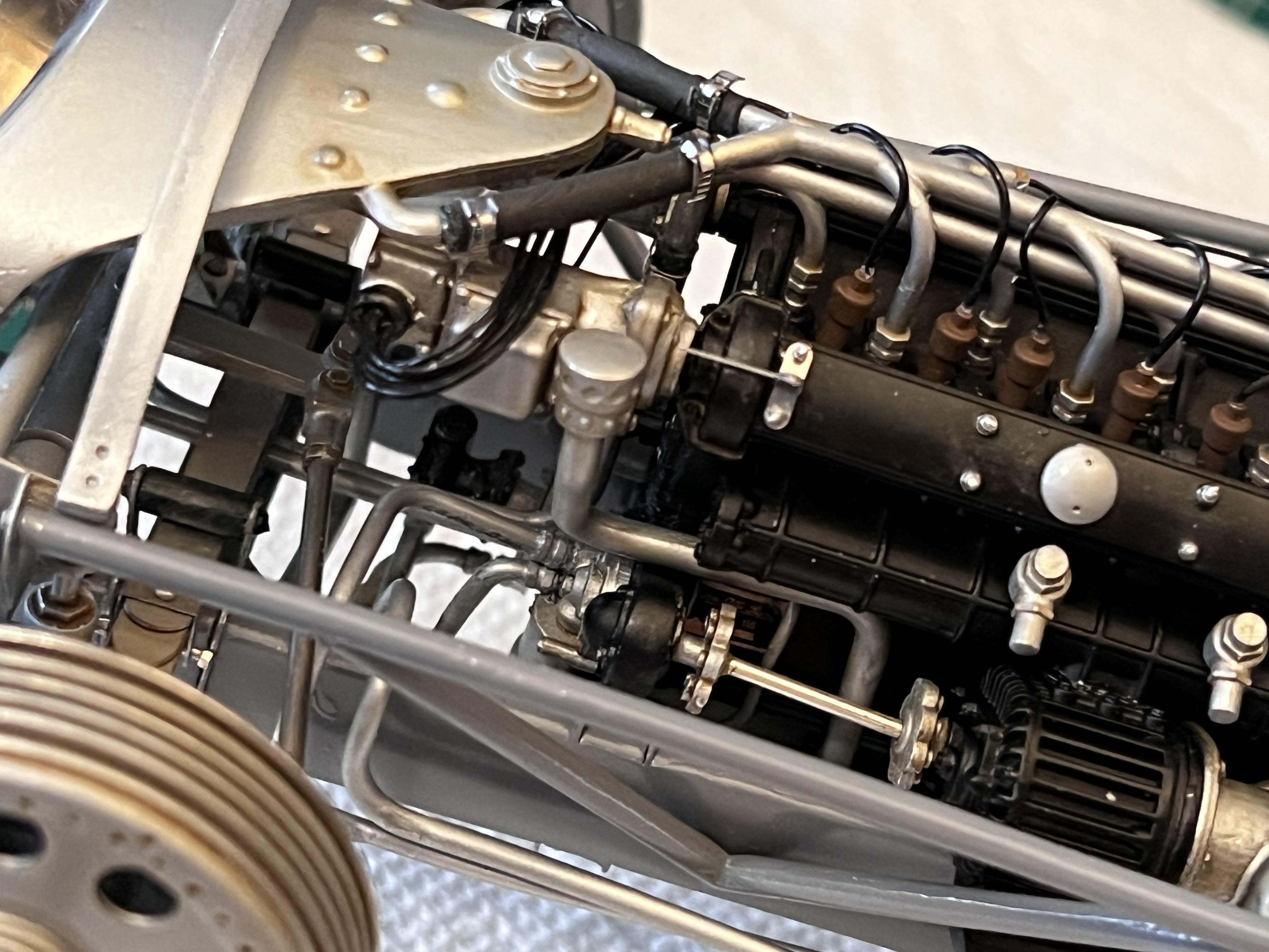

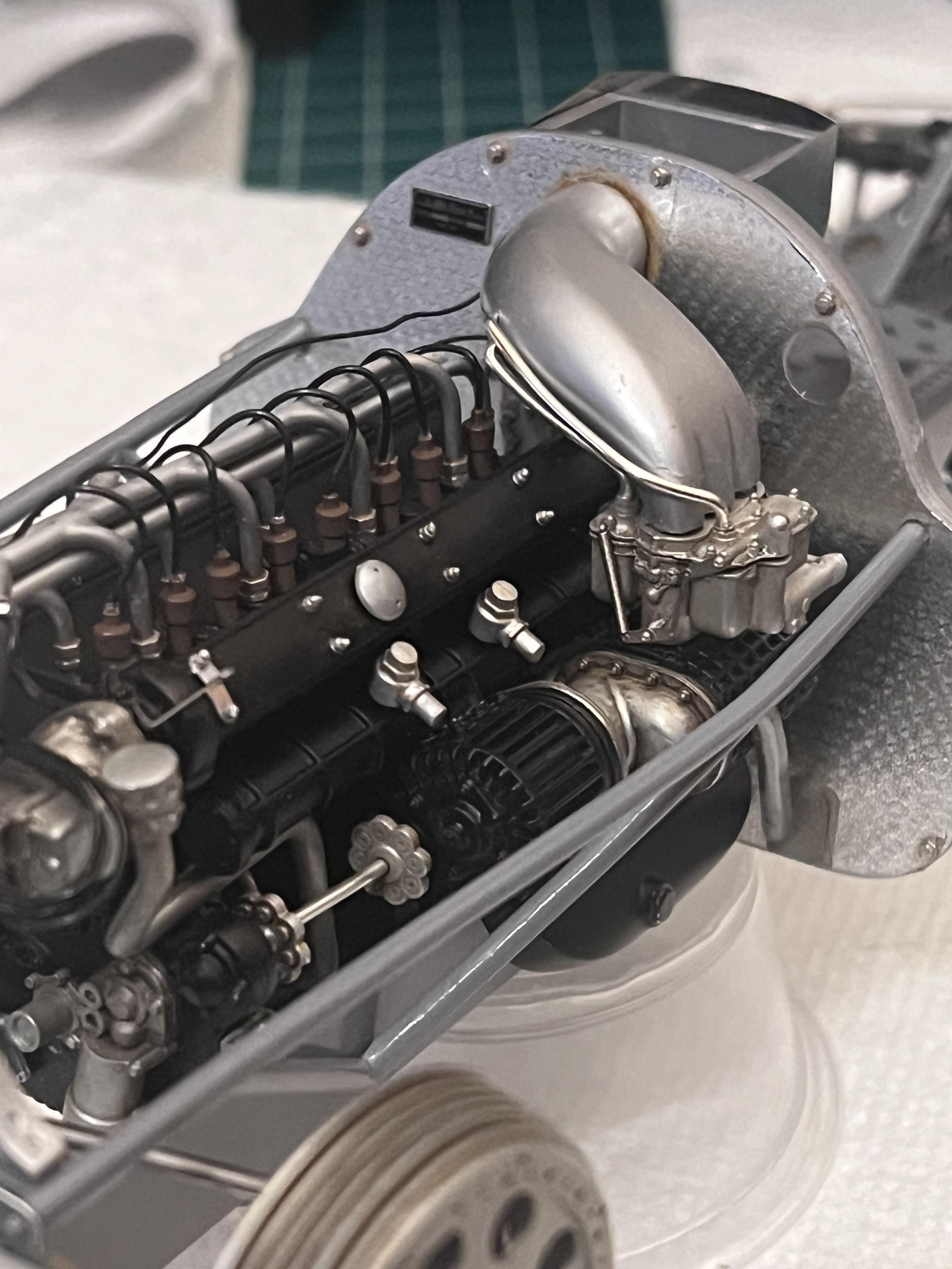

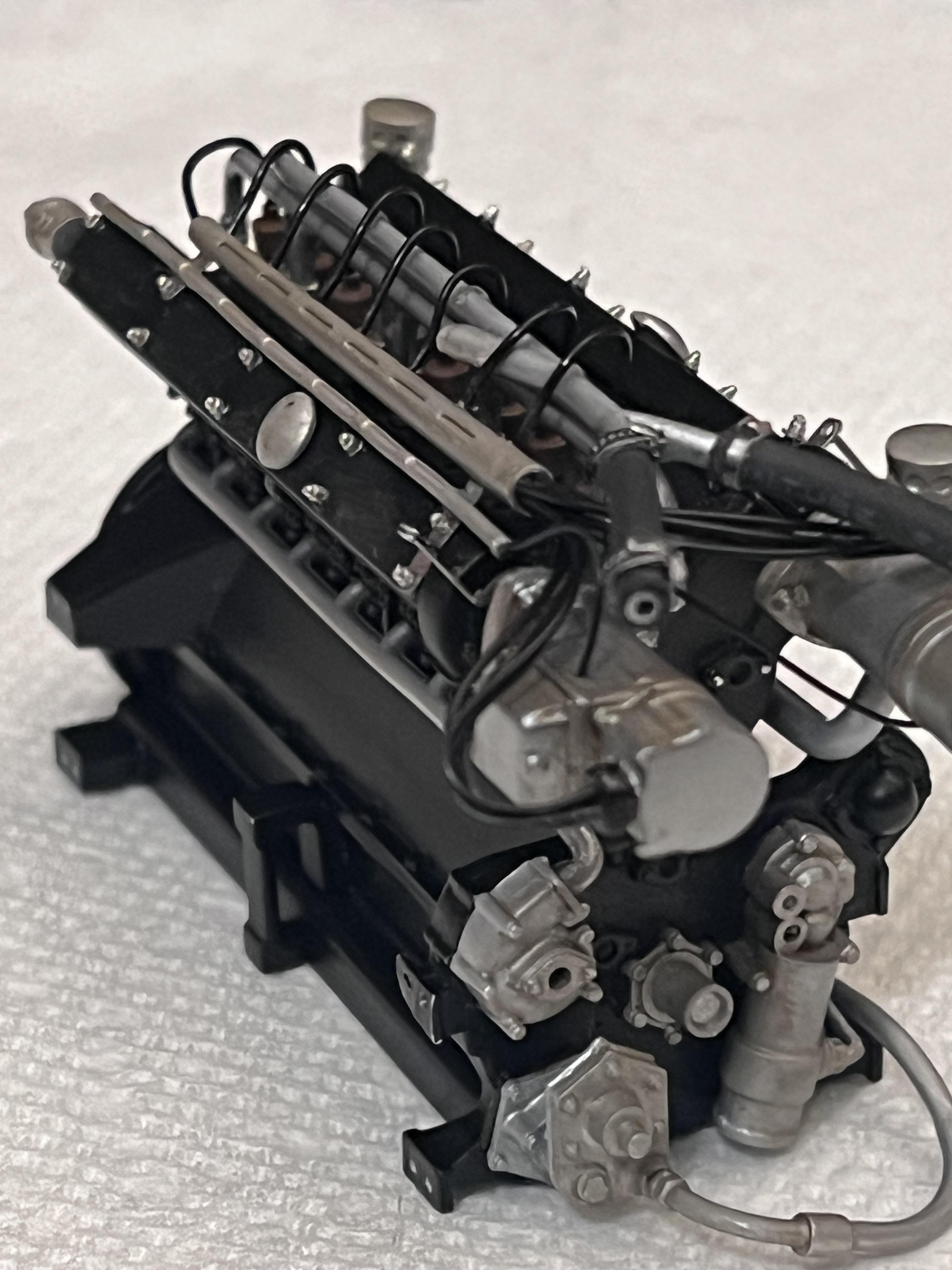

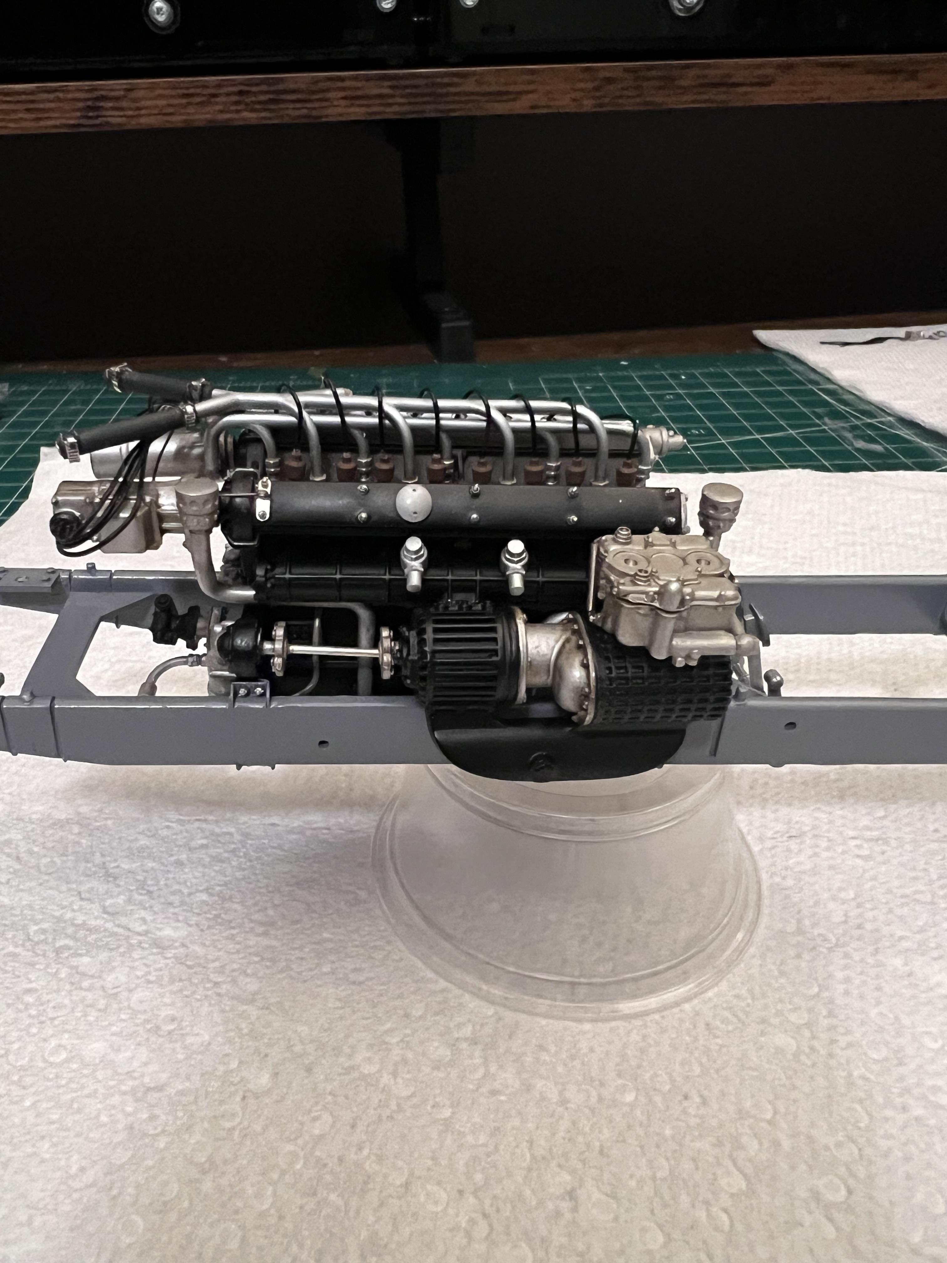

I have been hesitant about starting a thread about my latest project. But a good friend of mine kind of suggested that I should. So here goes.
 I am building the Model Factory Hiro 1951 Alfa Romeo 158/59 in 1/12 driven by one the most iconic race car drivers of the 20th century, Juan Manuel Fangio. This is the 159 version and to let you all know I started this in early December.
so with a large number of photos I will share with you where I am at after 2 and a half months of work.
thanks for looking
Chris

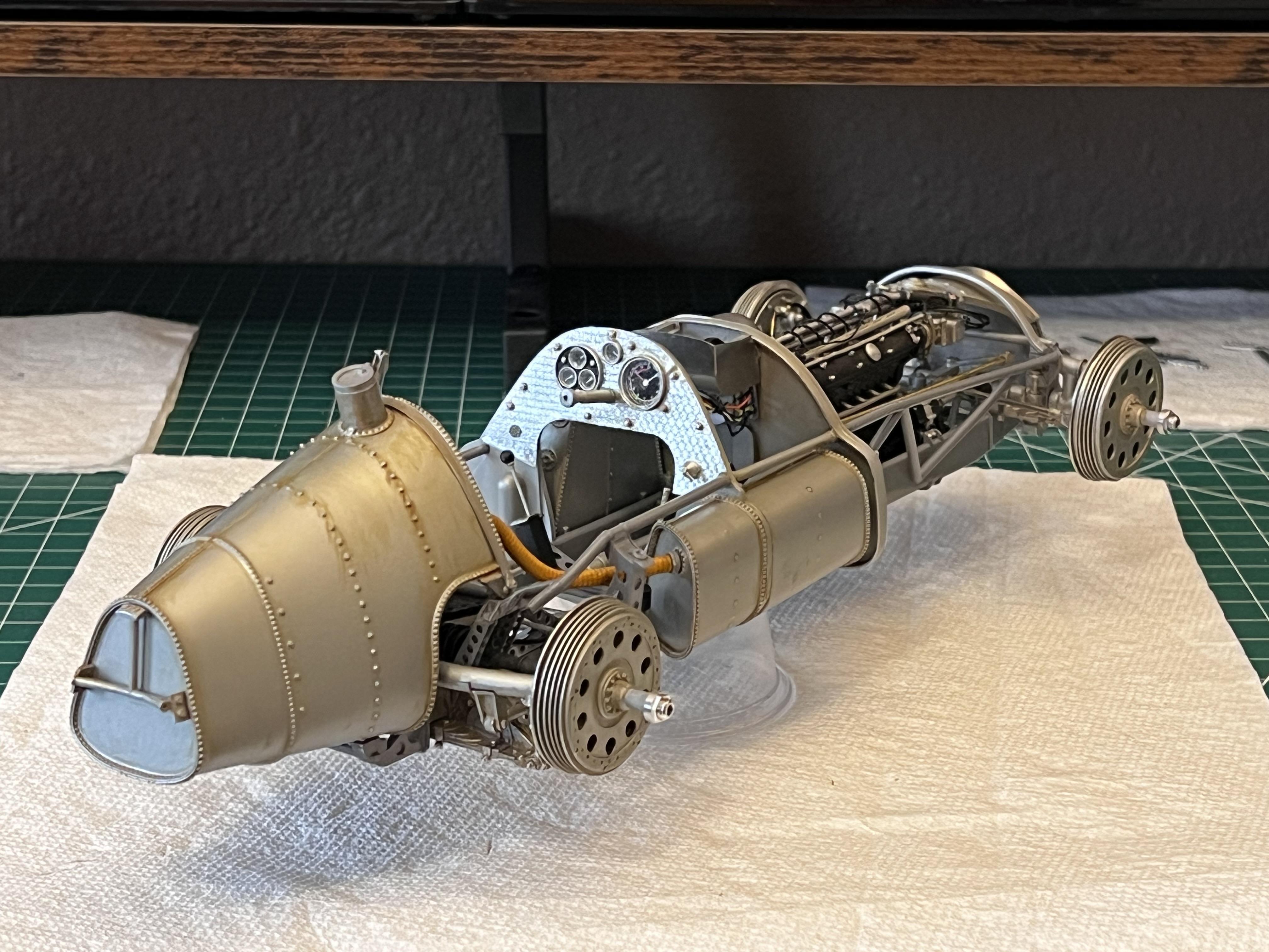

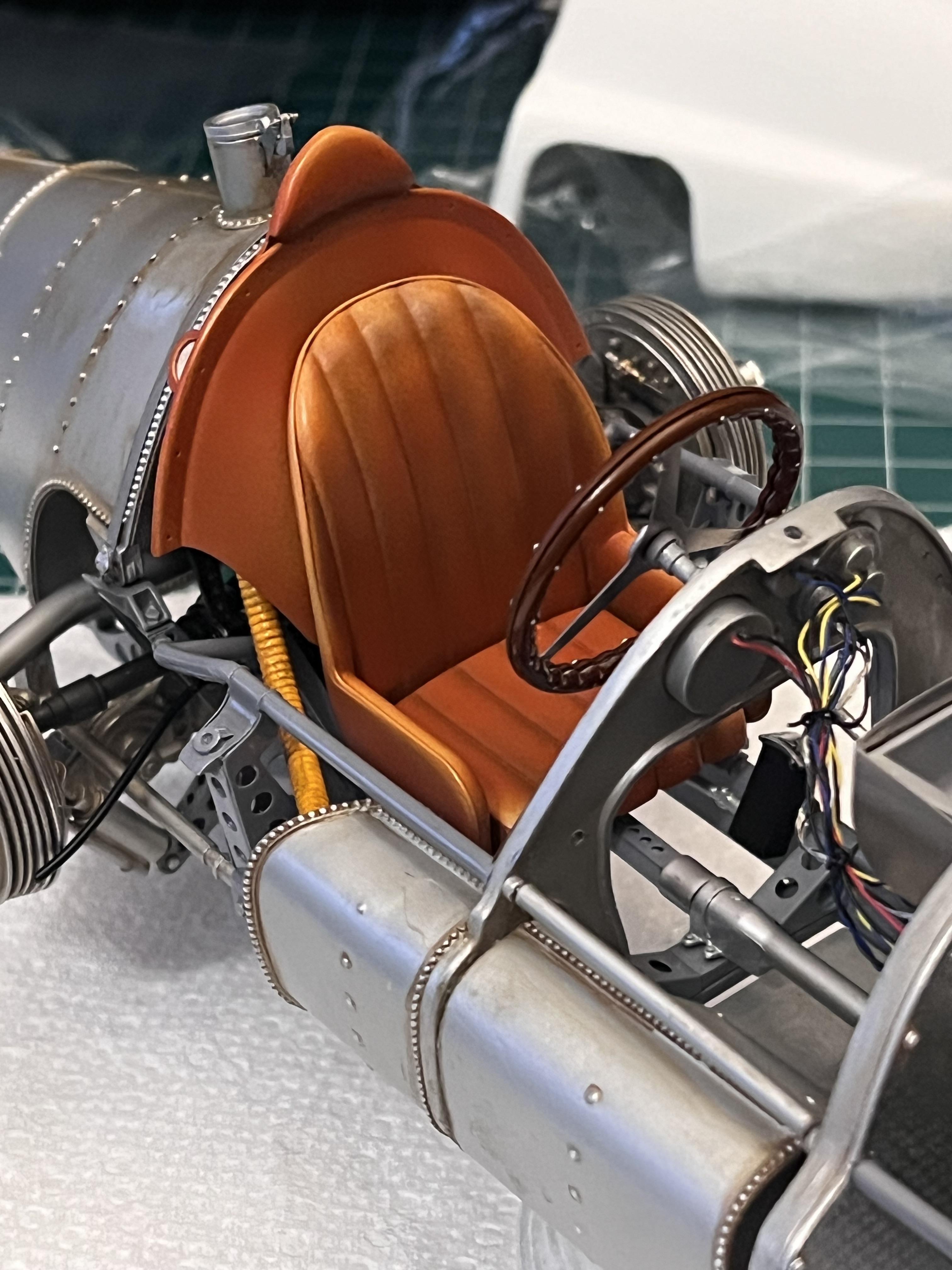

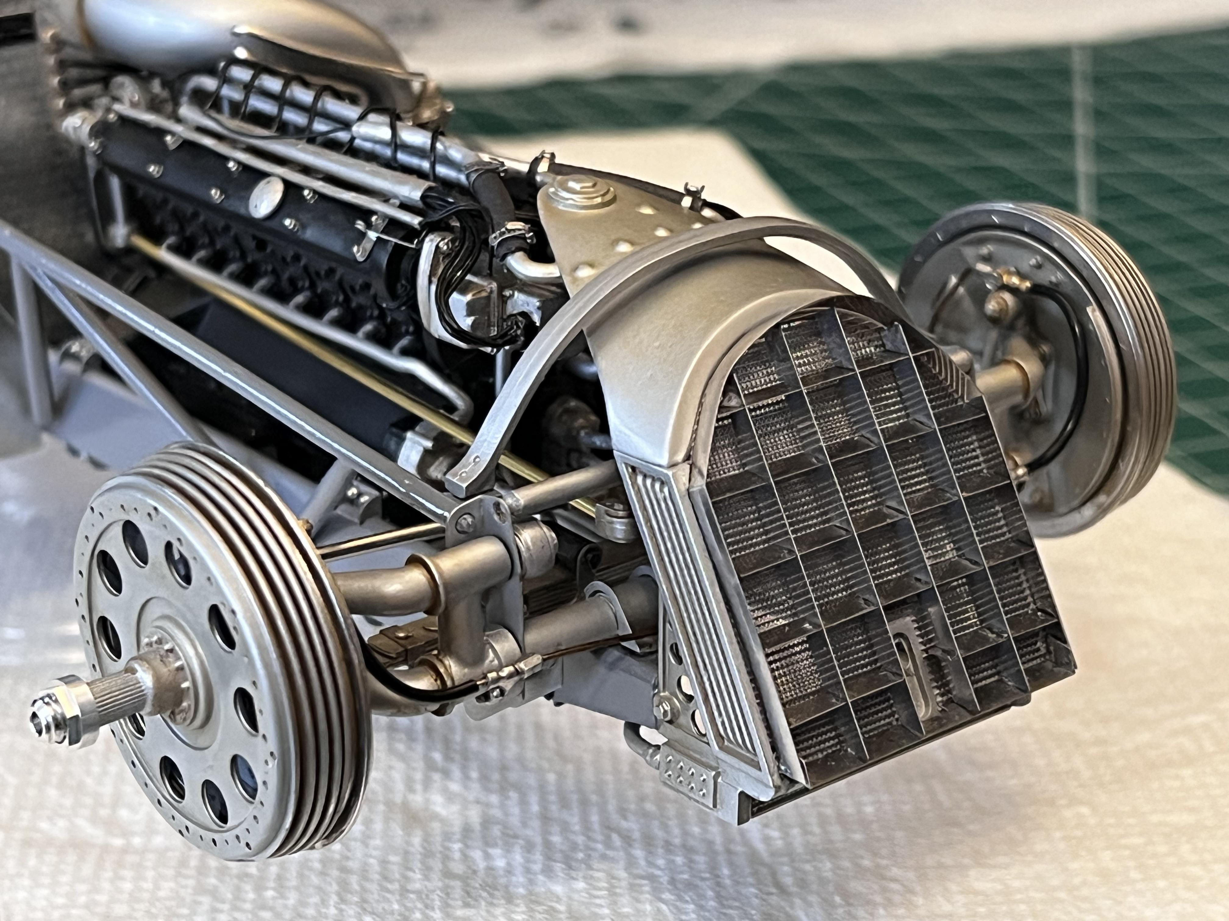

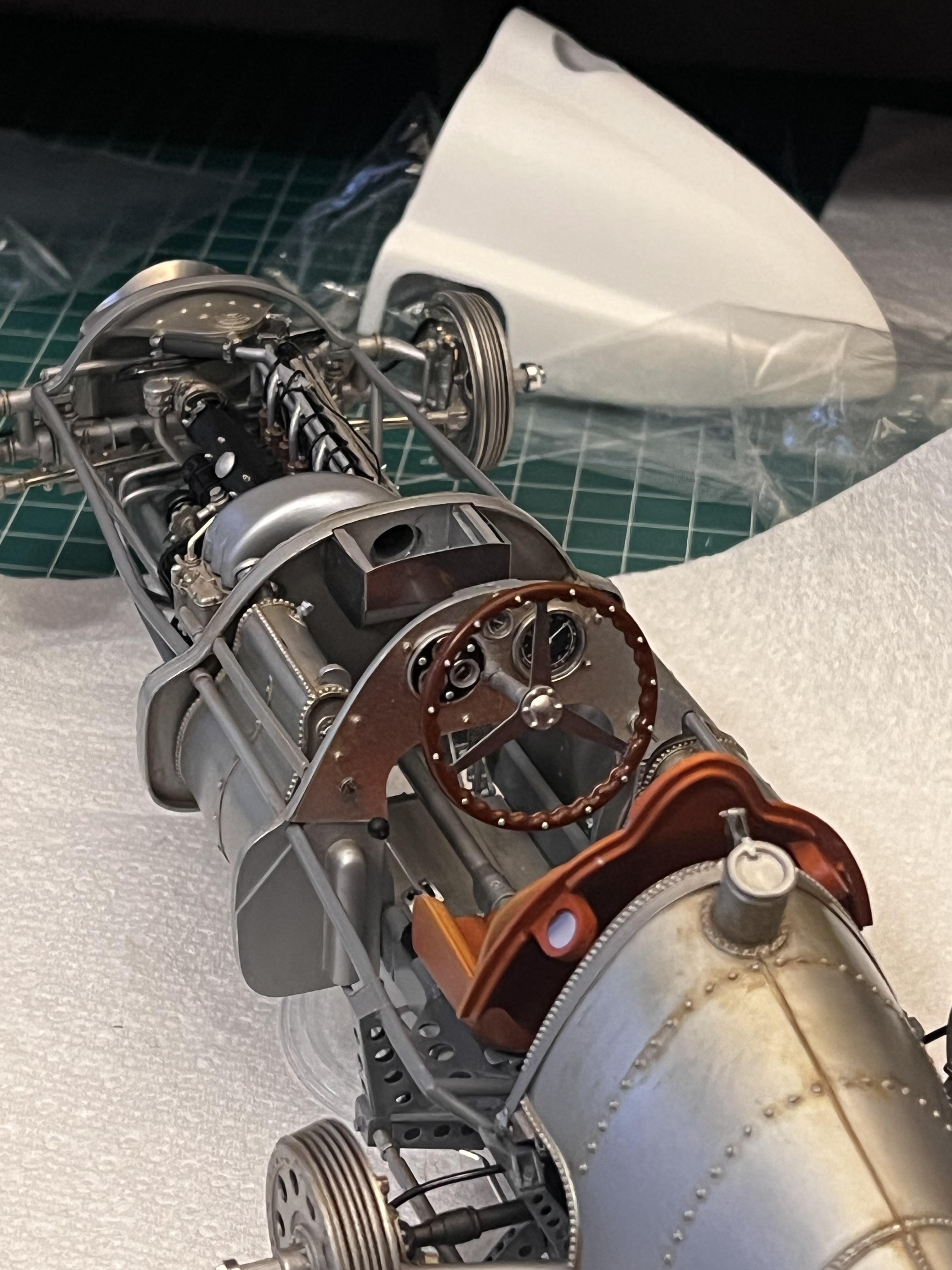

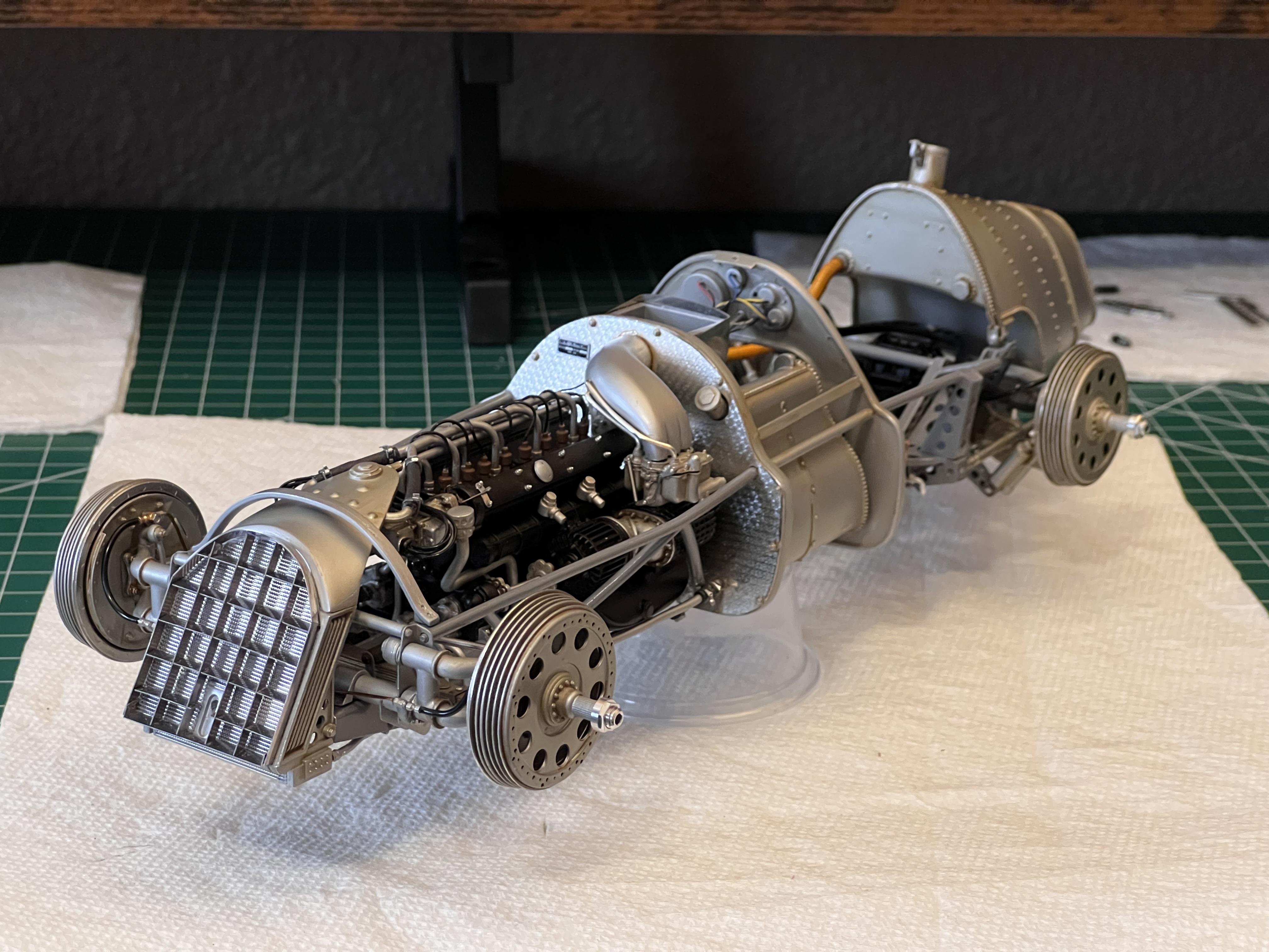

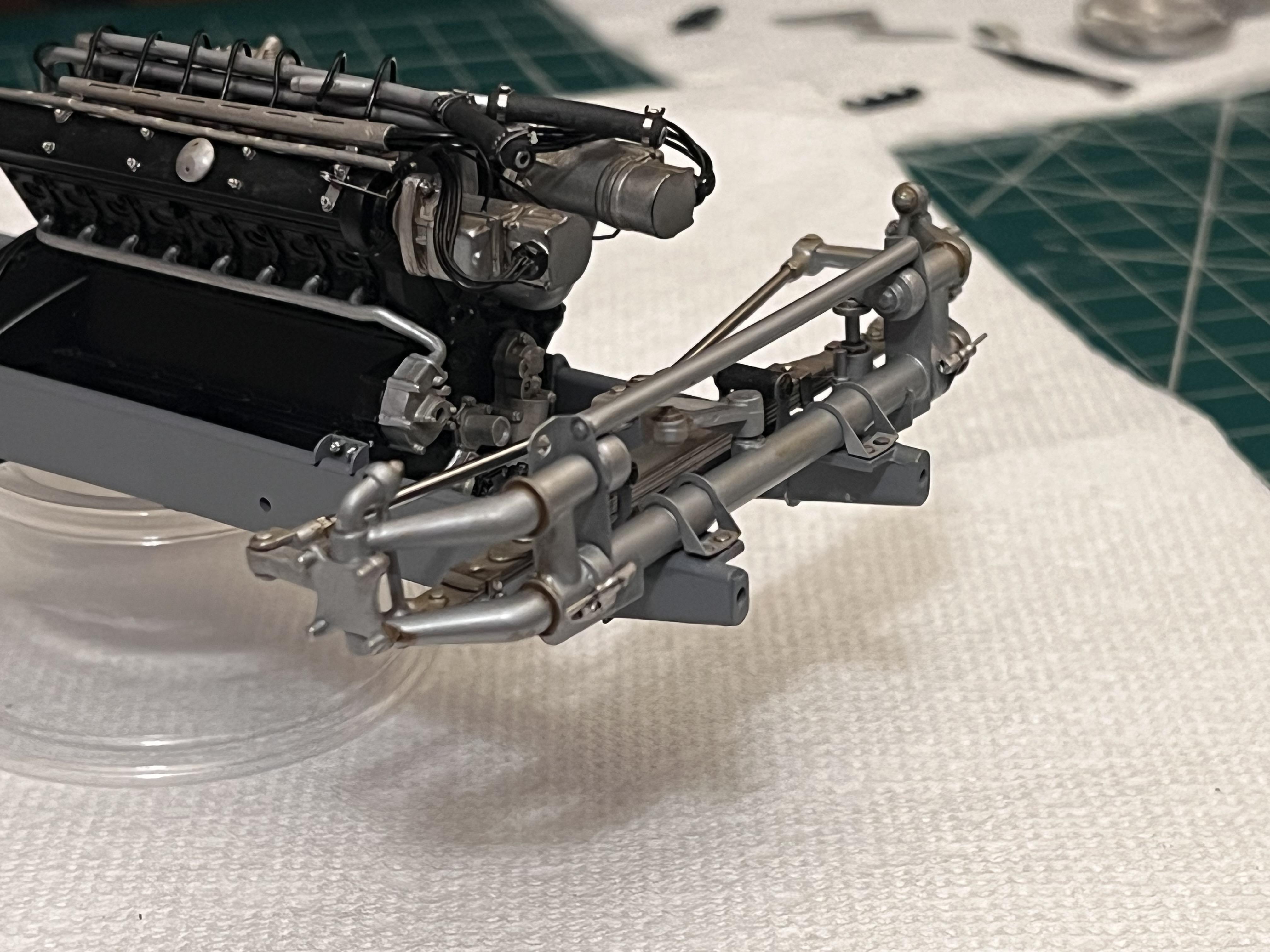

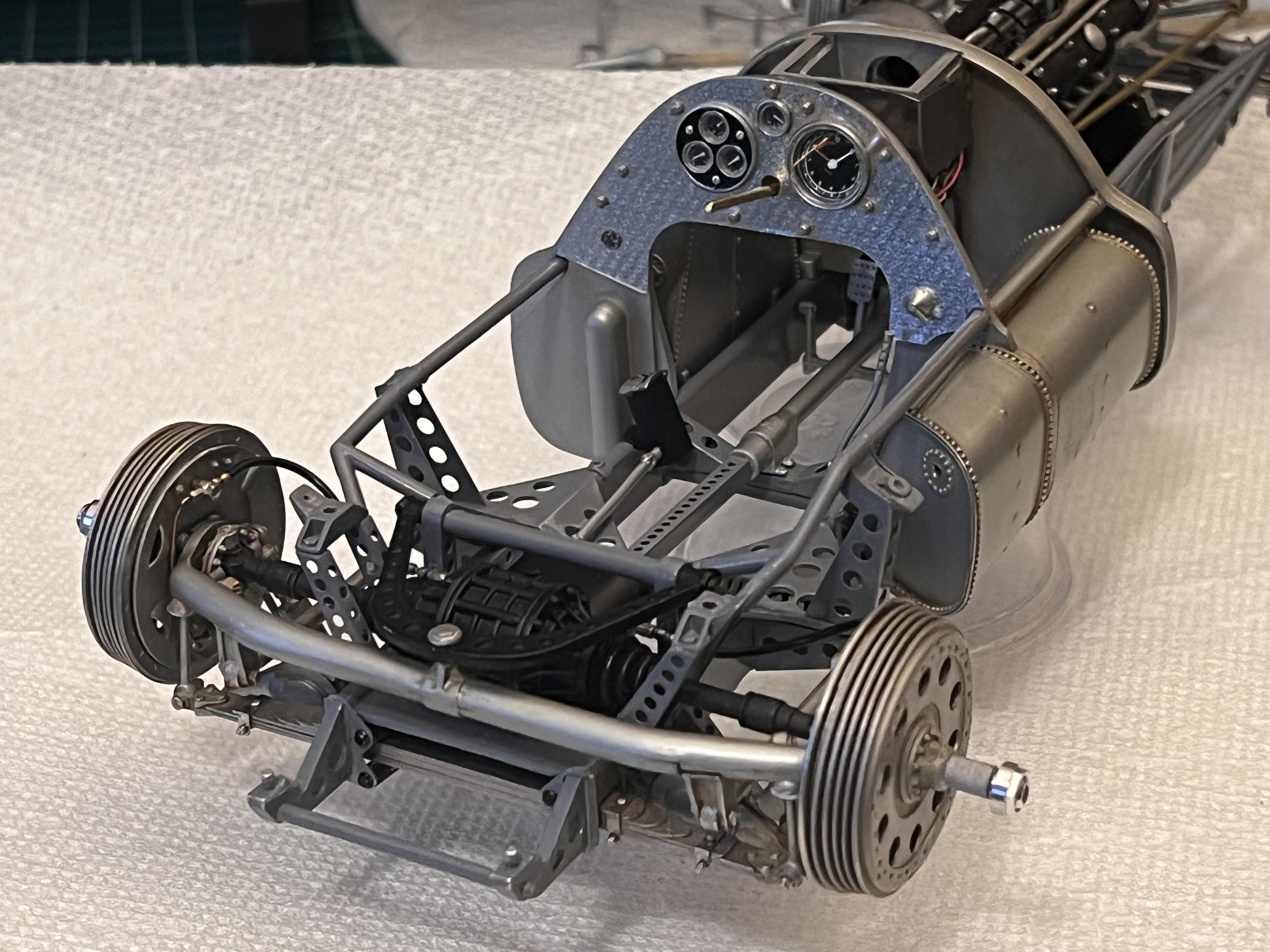

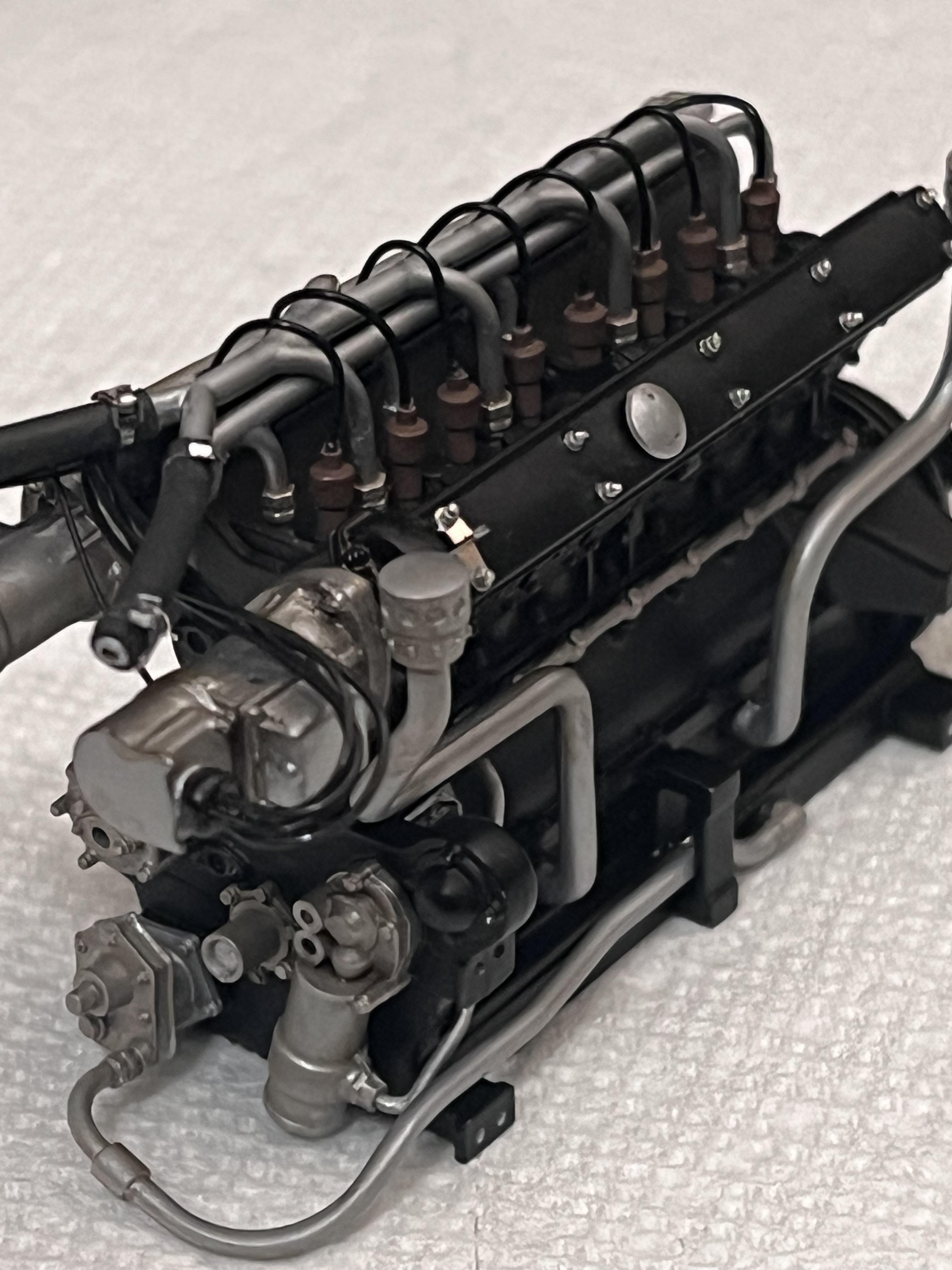

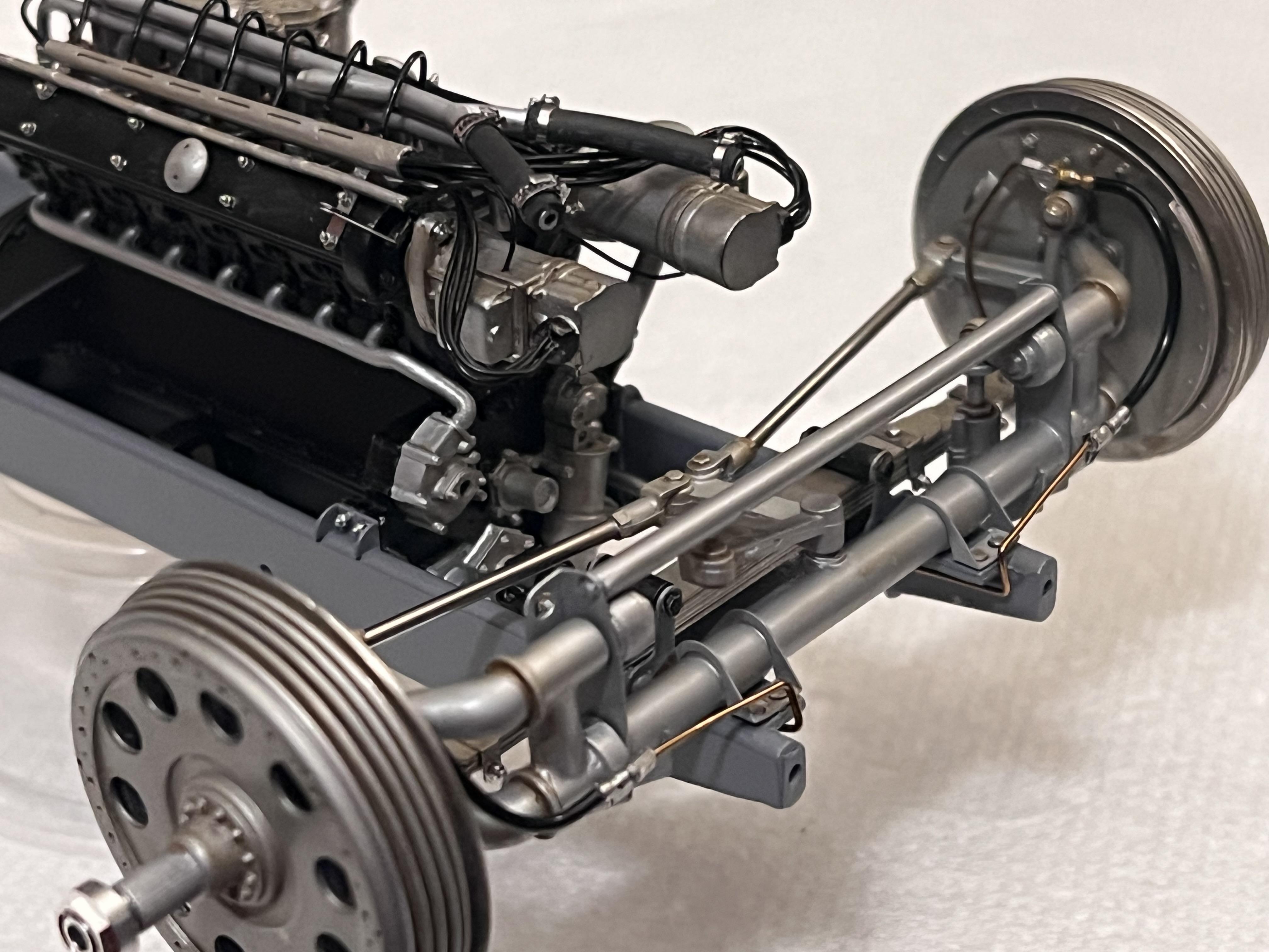

😳 WOW!  Doing a fantastic job, the subtle weathering really brings out the details.  You doing it as right after finishing a race?
Incredible work as always Chris. Tell me the thousand rivets were molded into the tanks, not individually added?
You are a master of paint finishes, which adds so much to the appearance and realism of a replica. All the subtle metal hues and fine weathering are a feast for the eyes. I'm sure everybody would want to learn more about the materials and techniques you use to achieve such amazing metal finishes.
Very nice work, Chris.  Very clean looking.  I'm curious as to how you got such smooth finishes on white metal parts.
Pierre, Good to hear from you!
Fortunately I did not have to install all those rivets on the tanks. As for the finish, it’s quite simple Alclad aluminum and Tamiya brown panel liner. I just dab the panel liner in the low spots and let it sit for a minute then rub it down with a cotton buds, I like the effect.
To be honest, most of the parts aren’t too bad that some Tamiya primer will take care of it with some light sanding, the deeper gouge’s are filled in with either CA or putty. If it’s really bad, I have had to request a replacement part from Hiro. That has only happened once 😁
Edited by Chris Smith

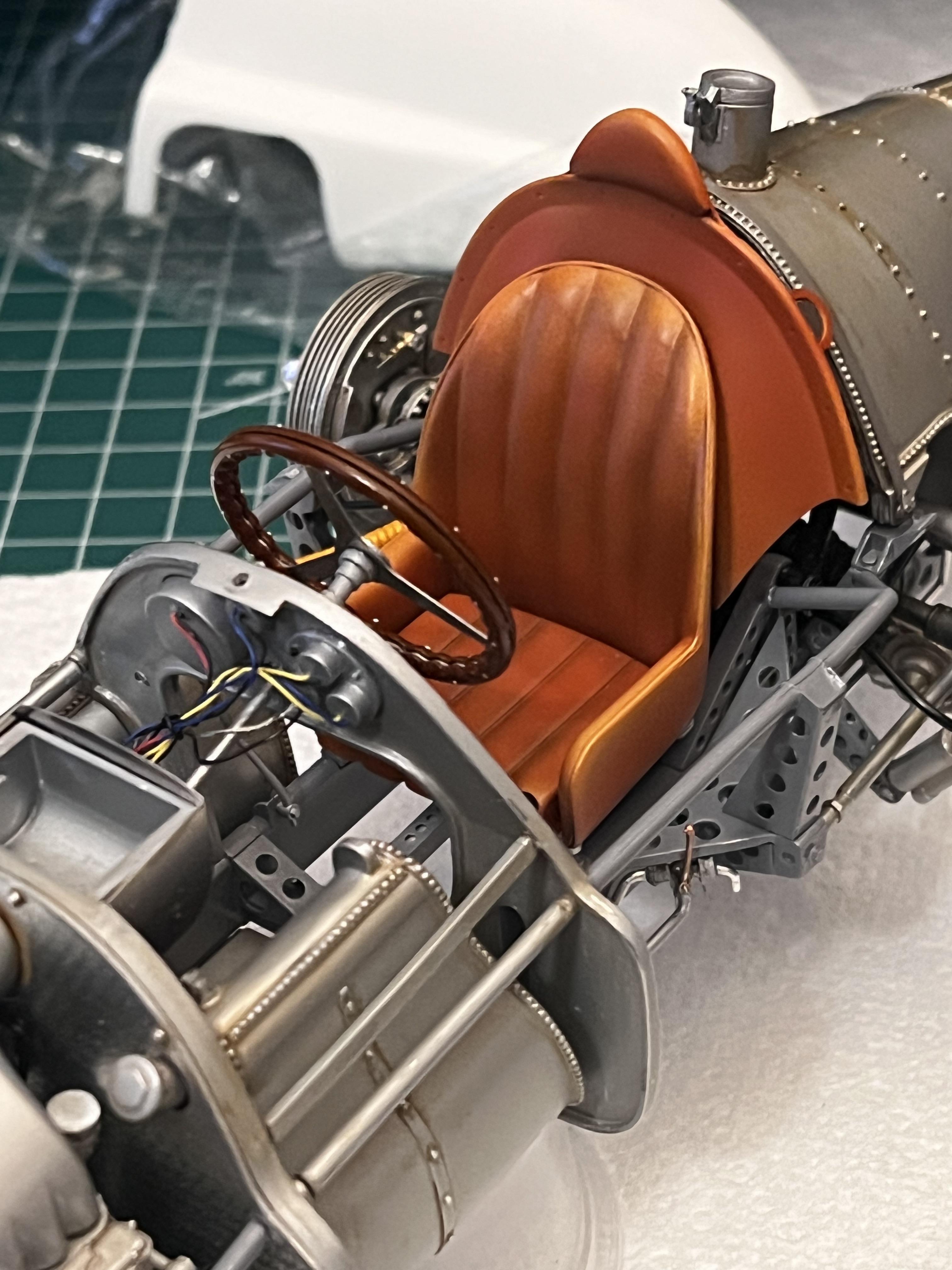

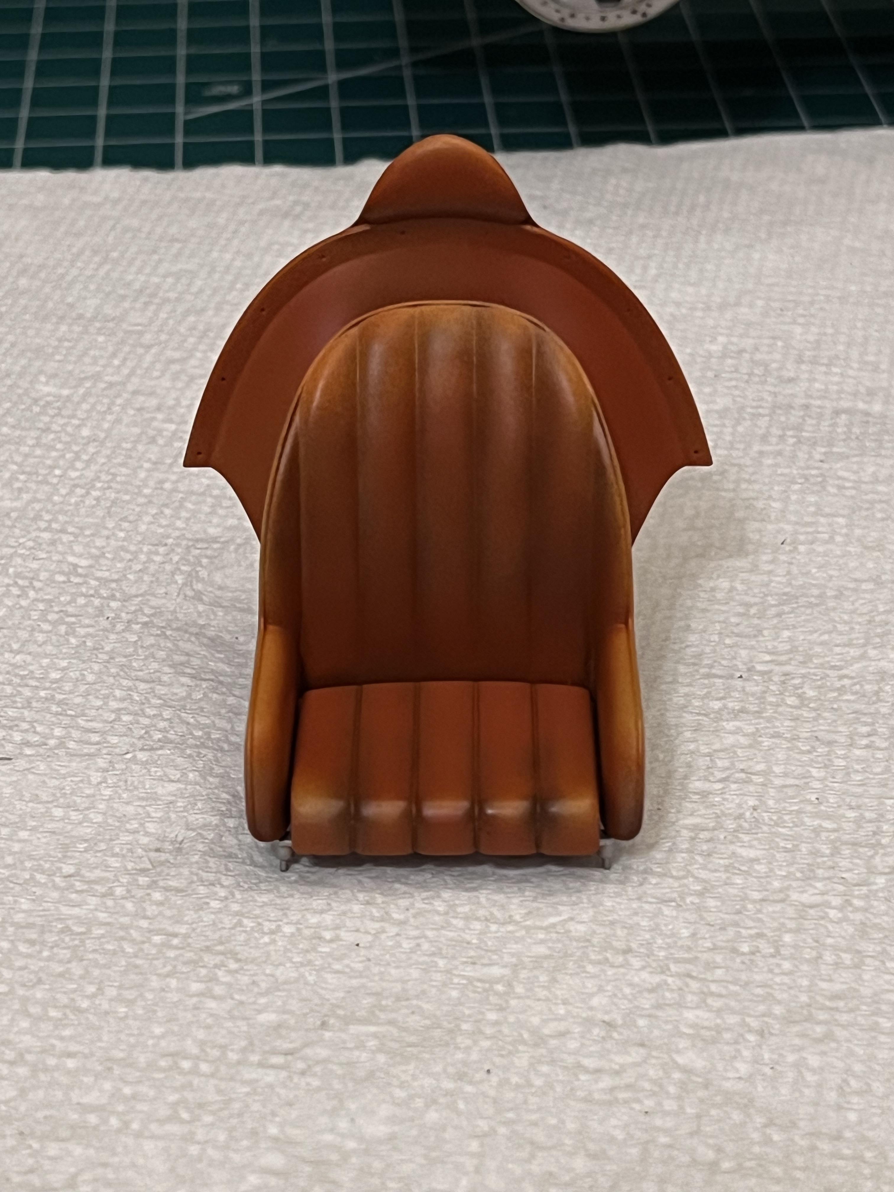

Hey there Chris......like the others, count me a fan of your techniques AND results.  You should share more of your "how to" or in process tricks along the way.  I, like others would like to know more how you go about getting certain results.  The one you shared about the rivets today was insightful.....certainly yields a convincing result.  I'm most impressed with your technique for leather seats. You shared it before and it's nice to see that the results are consistent AND spectacular.  The most realistic finish using paint that I've seen yet.   cheers, tim
  • Like 1

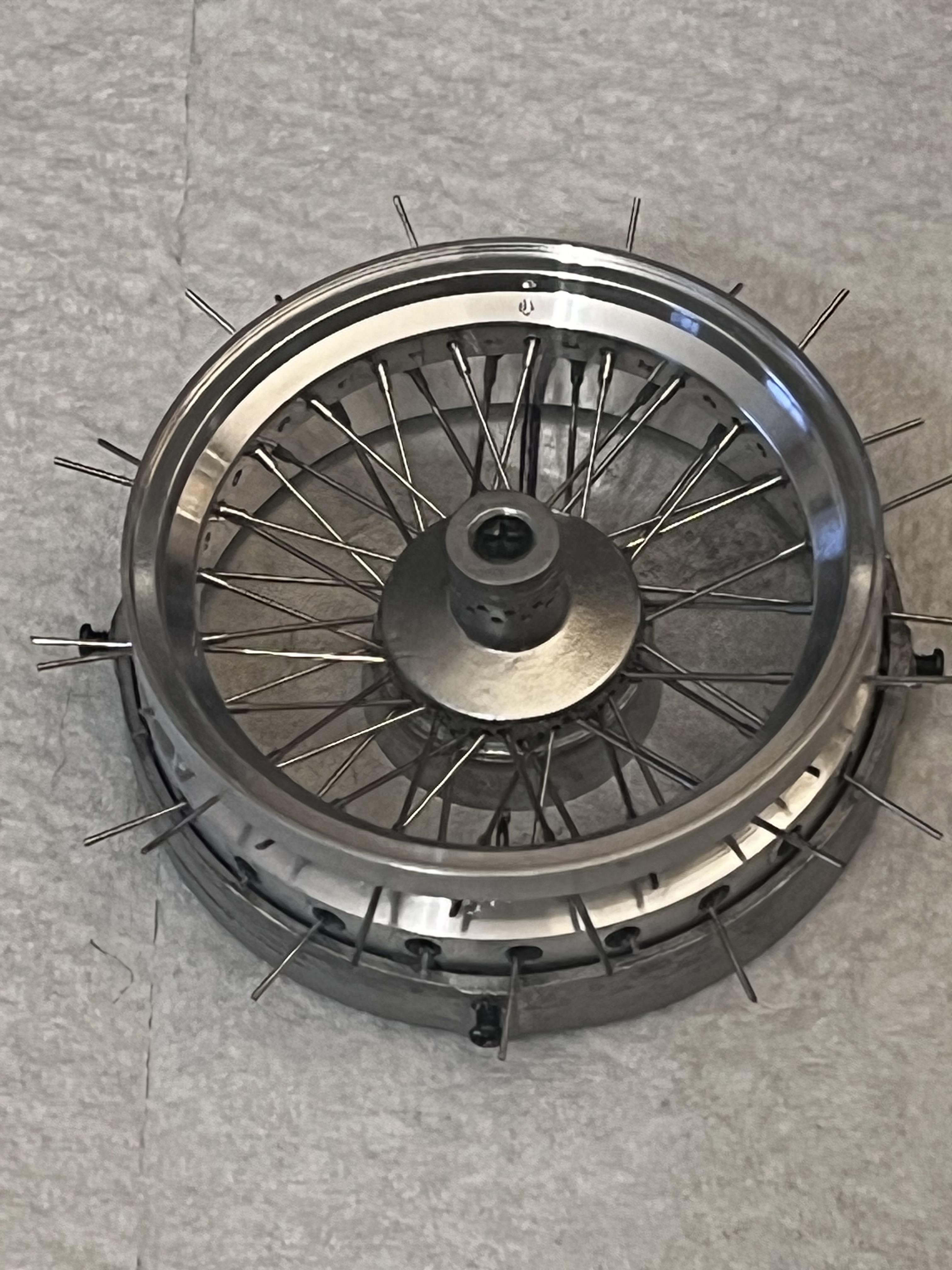

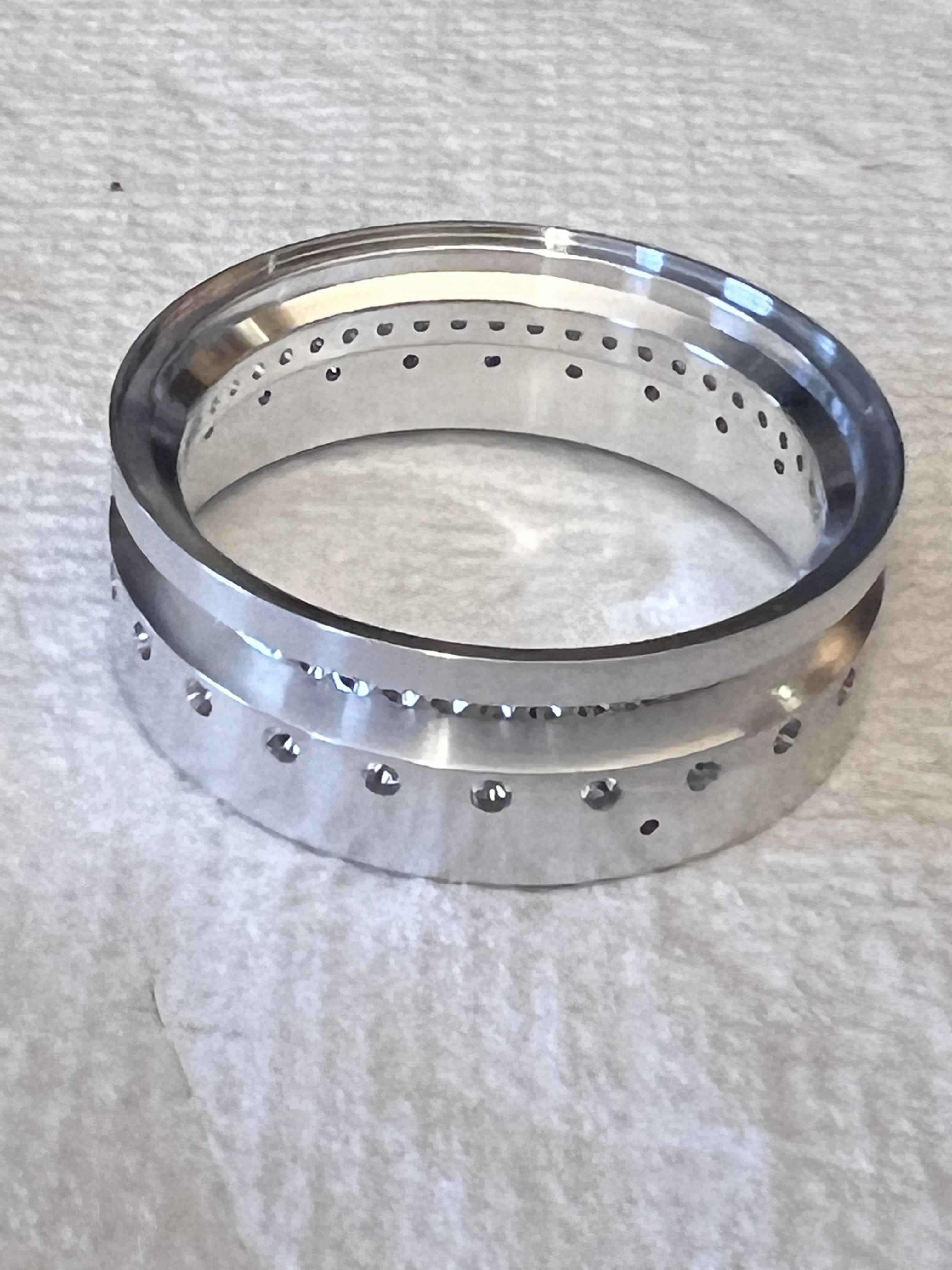

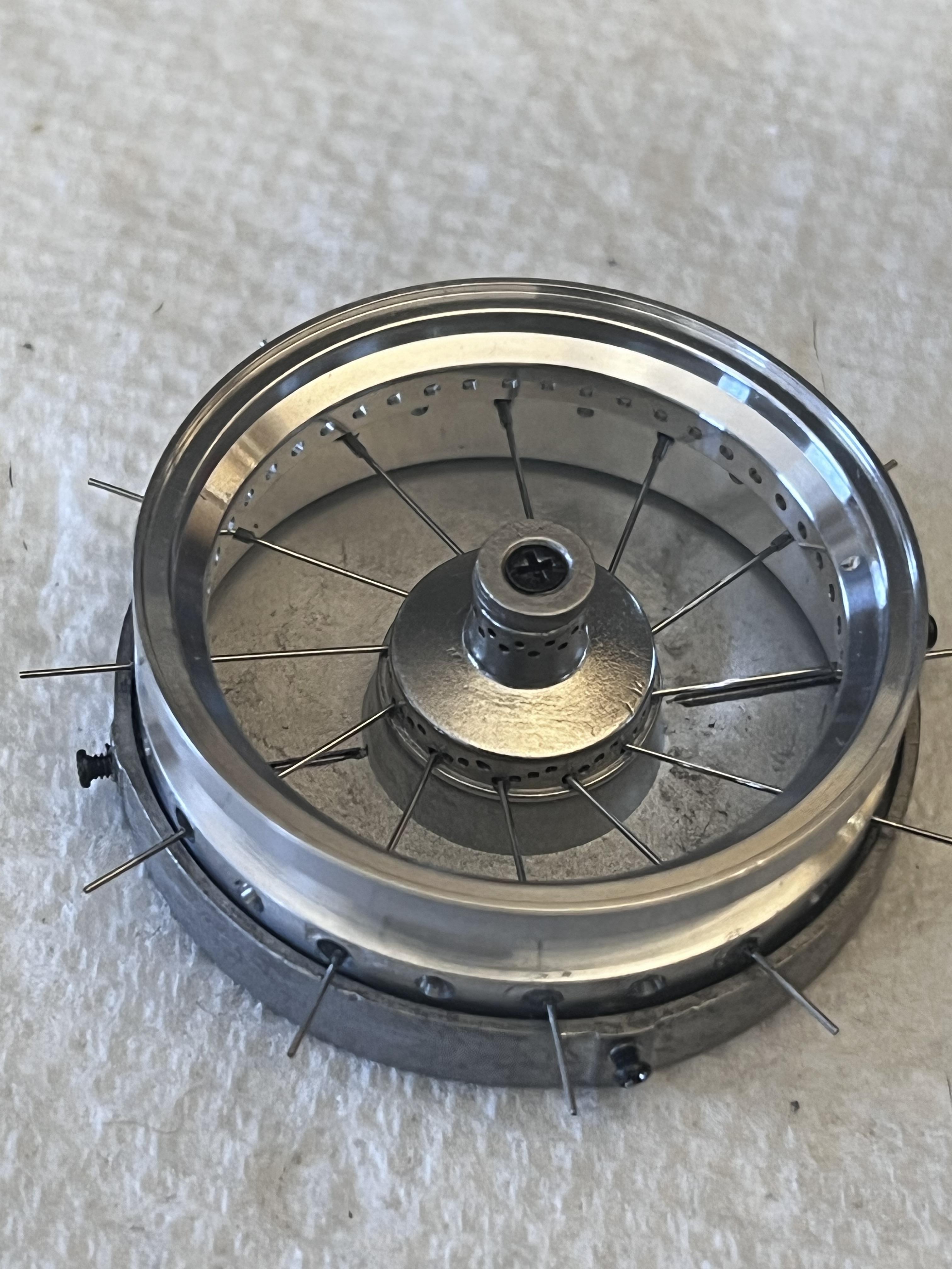

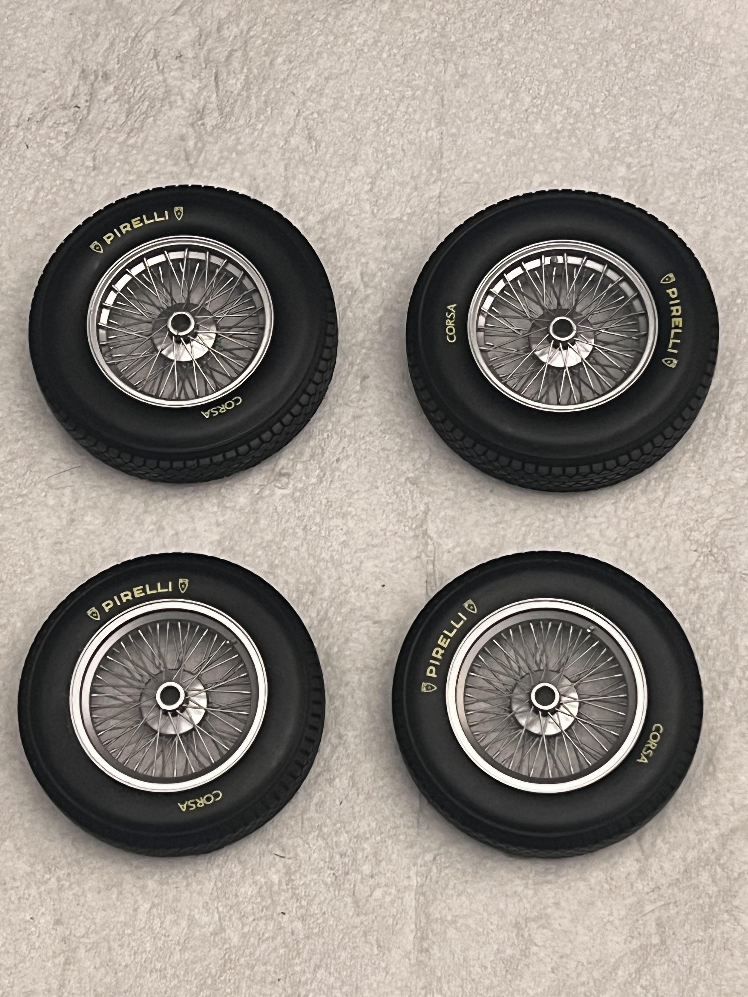

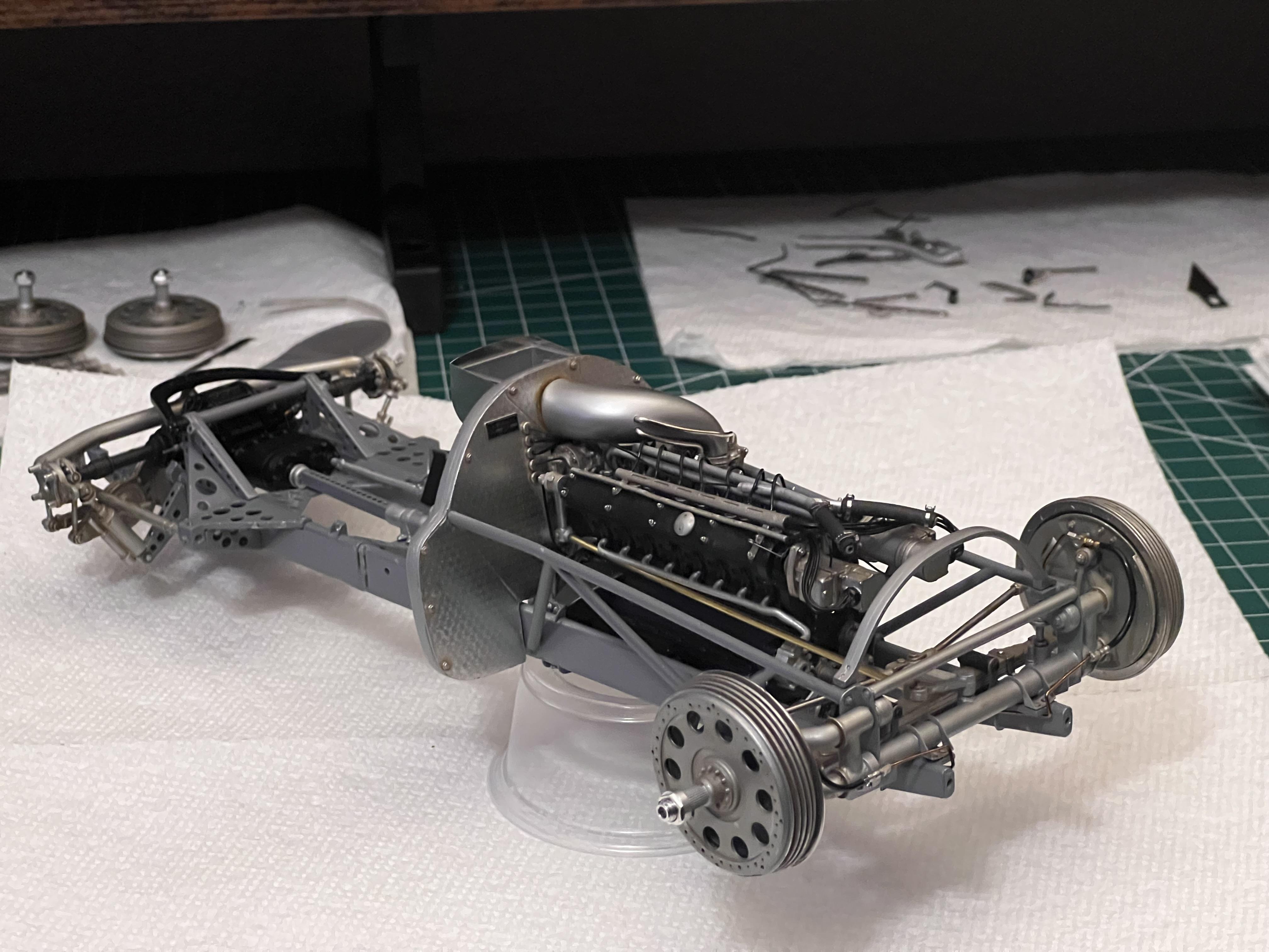

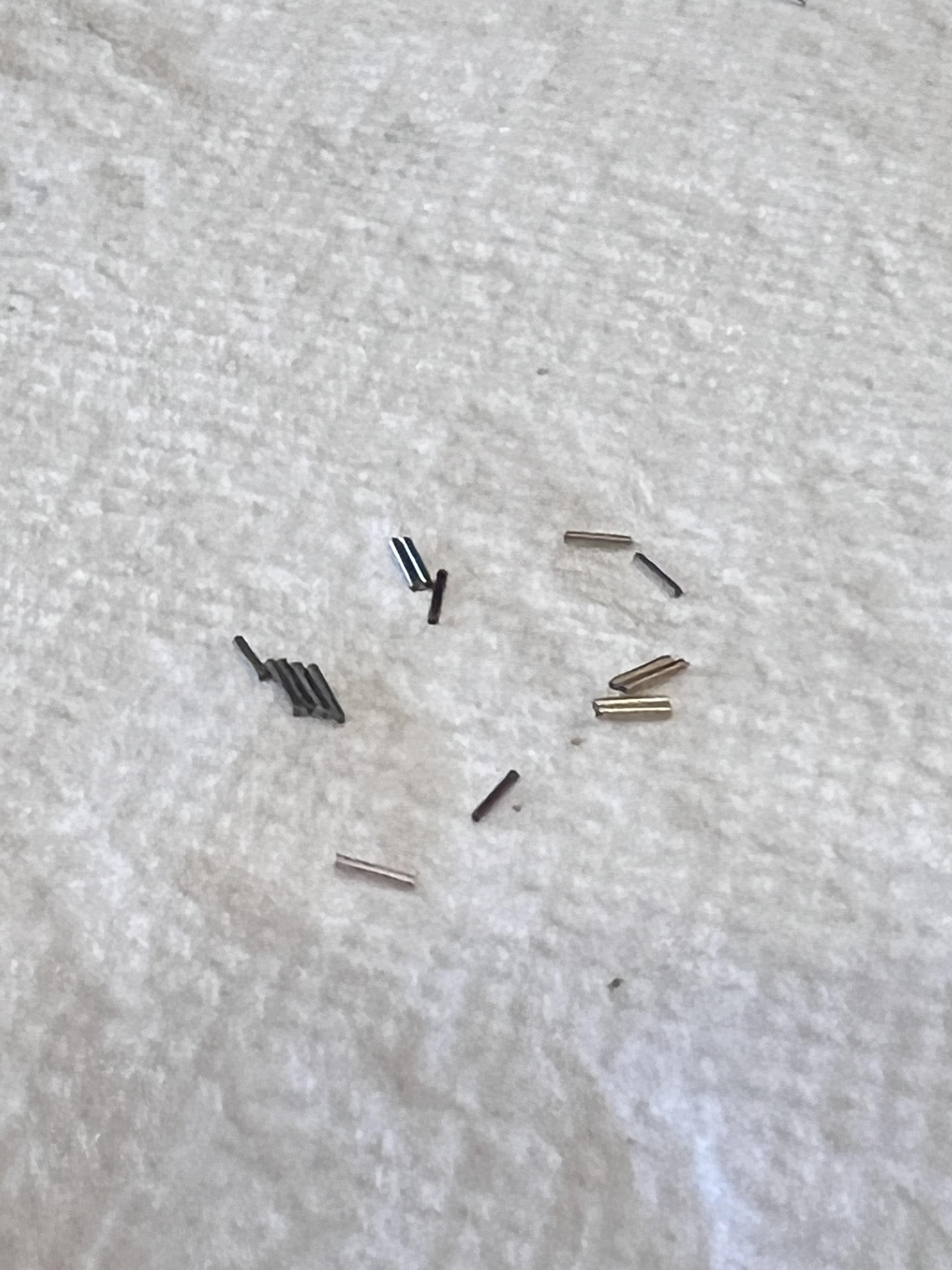

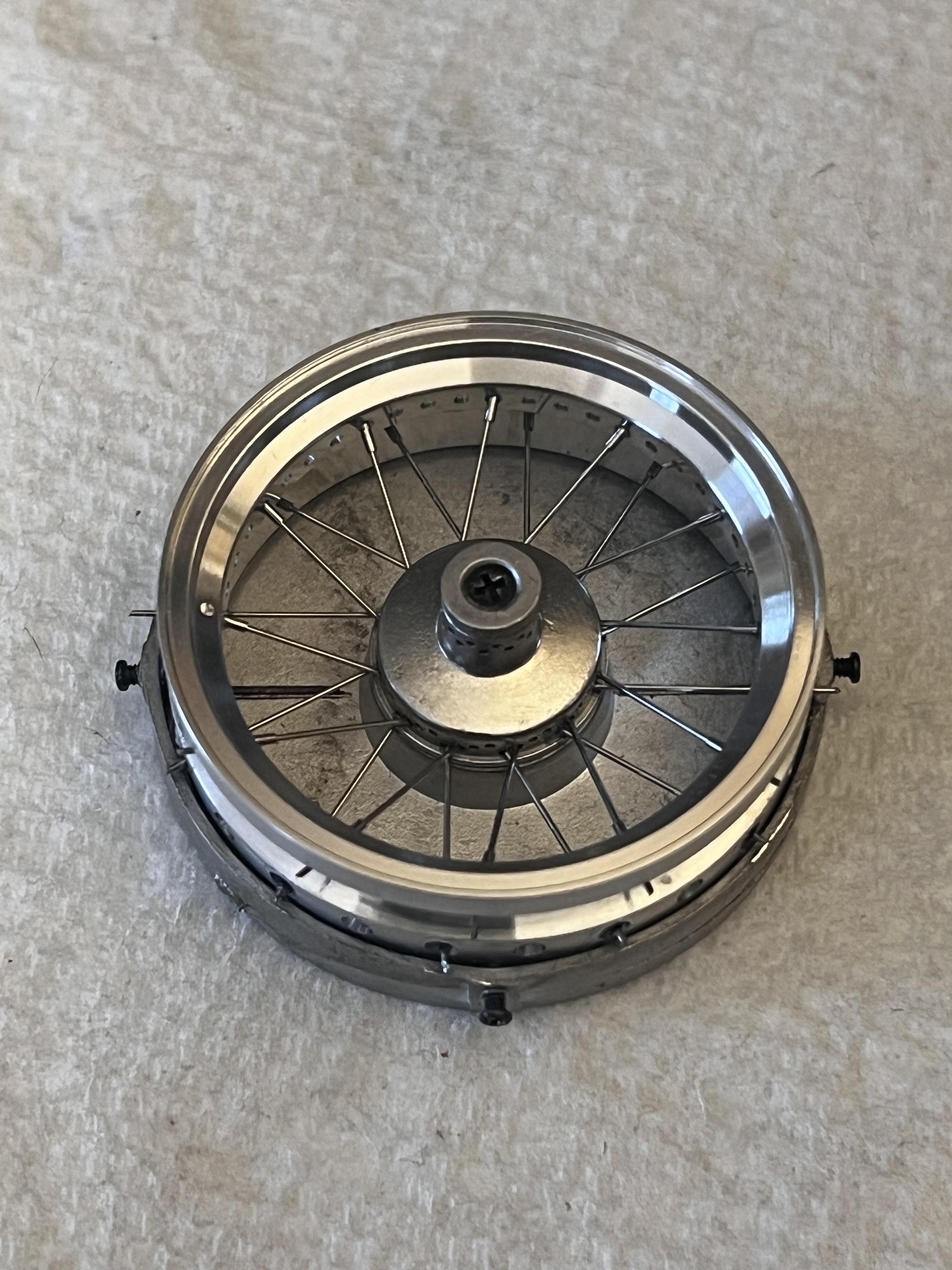

Well, since the weather is crappy and the chassis is pretty much done. I thought I would start on the wheels.
For you guys that know, wire wheels are a bit of a challenge, but I personally don’t mind assembling them. Now for those of you that haven’t had the joy of lacing up a set, I thought I would share, the best way I can.

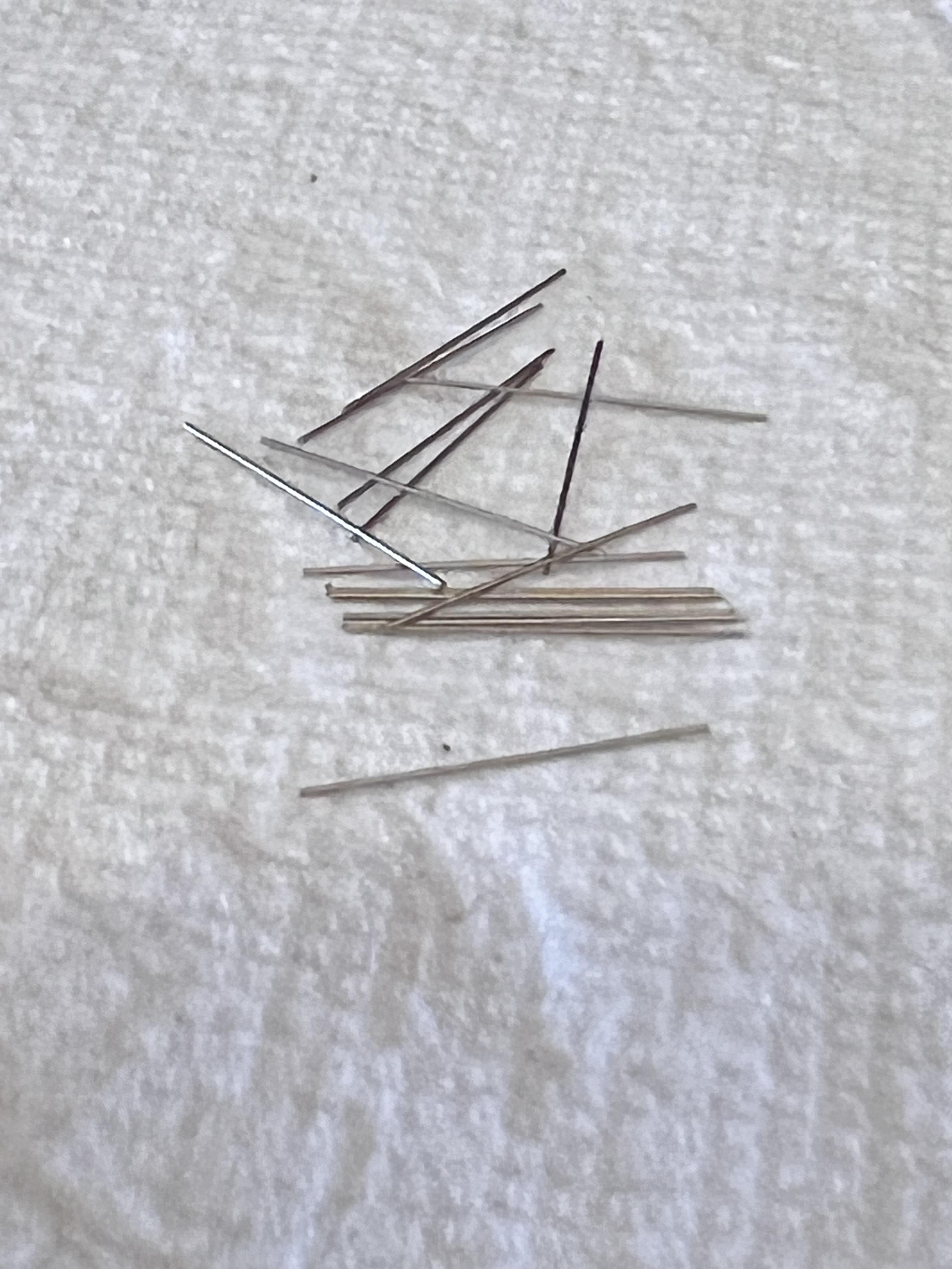

Model Factory Hiro gives you a jig to center the hub and hoop. The first step is to drill all the holes into the hubs for the spokes. The hoops are machined aluminum that has been pre drilled from the factory. The spokes are .4mm stainless steel rod and the nipples are .6mm stainless steel tubes that have been cut into 4mm lengths.
You have to look over the instructions to make sure you follow precisely, the pictures in the manual seem somewhat vague. So I take my time and double check before I glue.
hopefully it kind of helps, but like all of you , practice and patience make it look easy.
  • Like 2

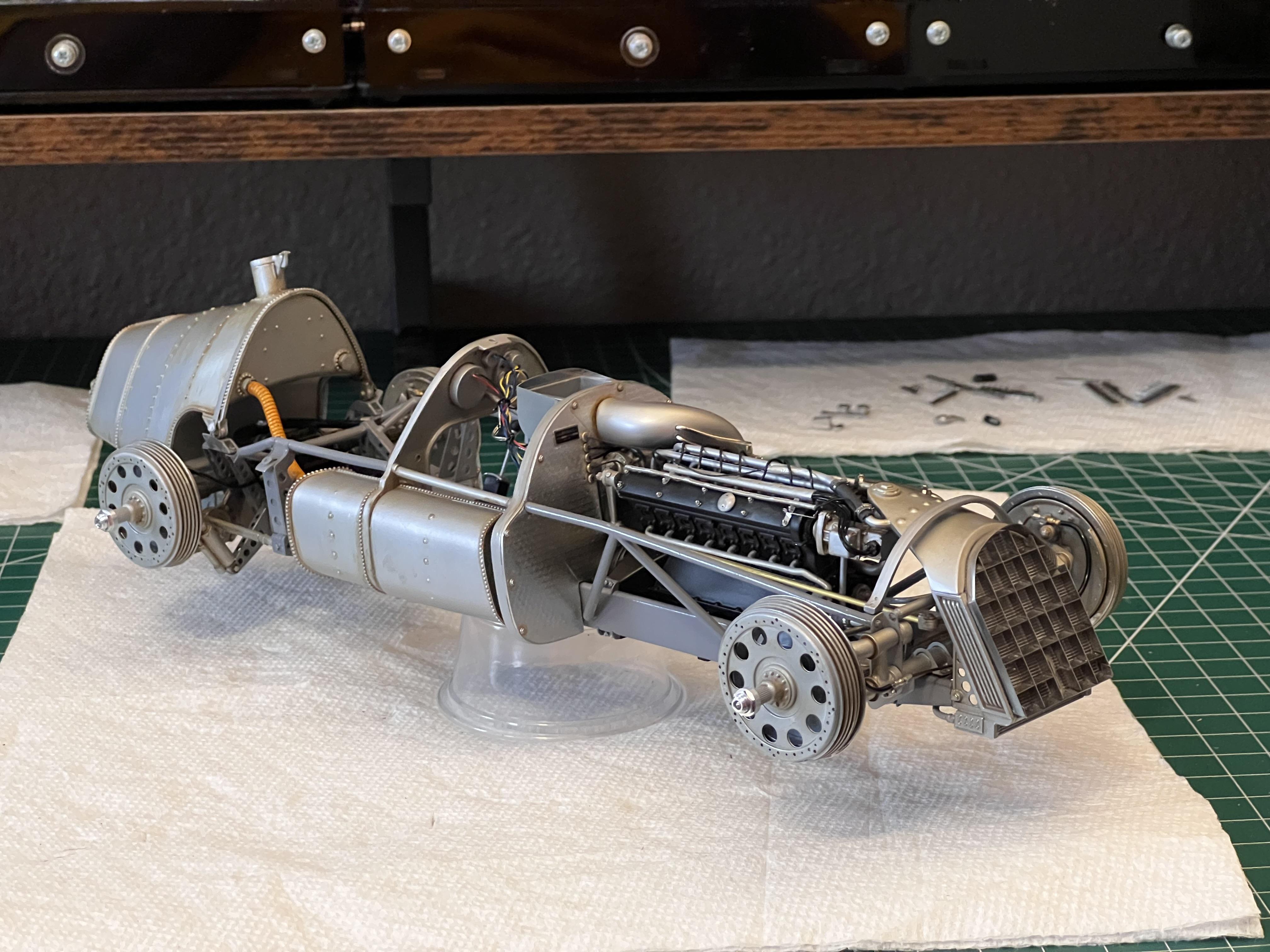

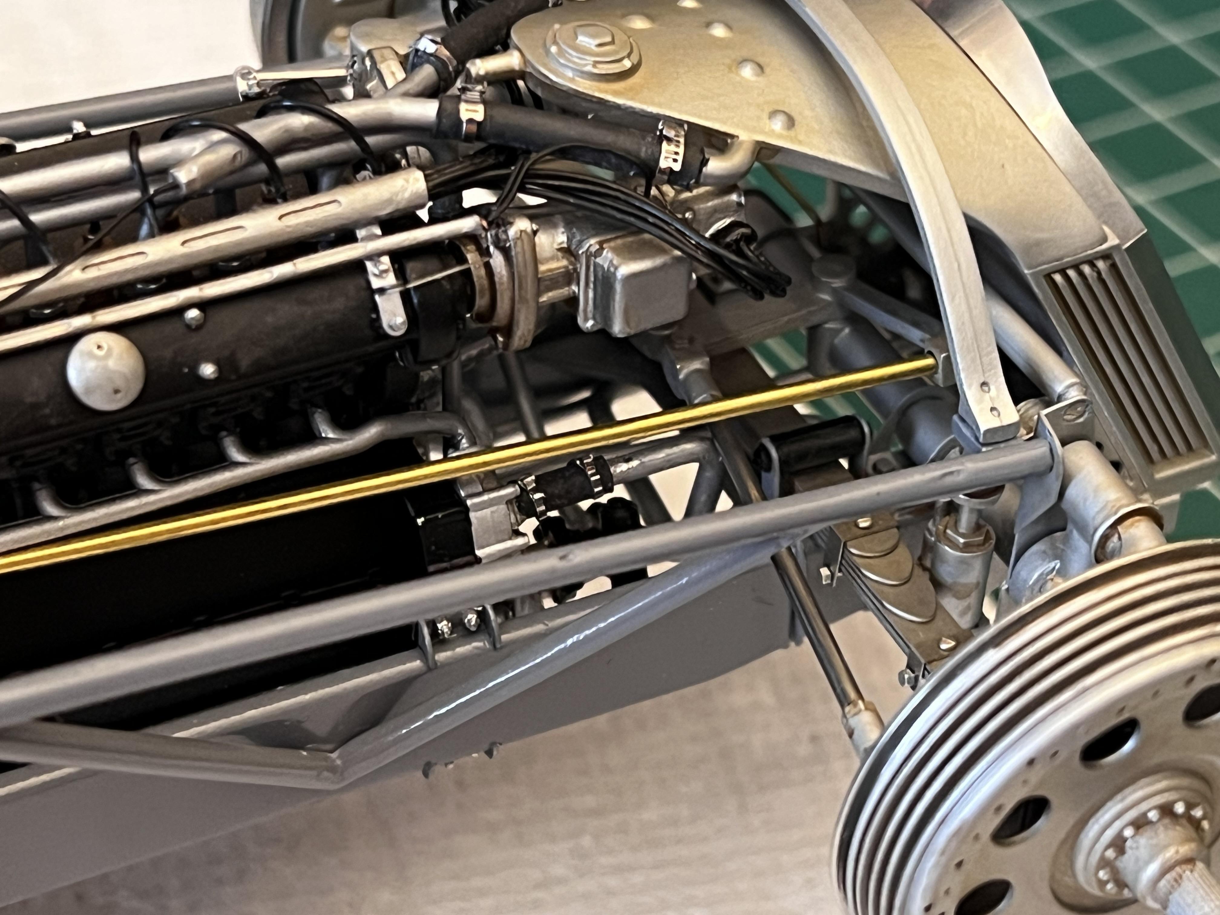

Looking at all the 'under the skin' detailing that you have already done on the chassis, engine and running gear it almost seems a shame to place the bodywork on and hide much of it when complete! None the less we are seeing a superb model taking shape here.

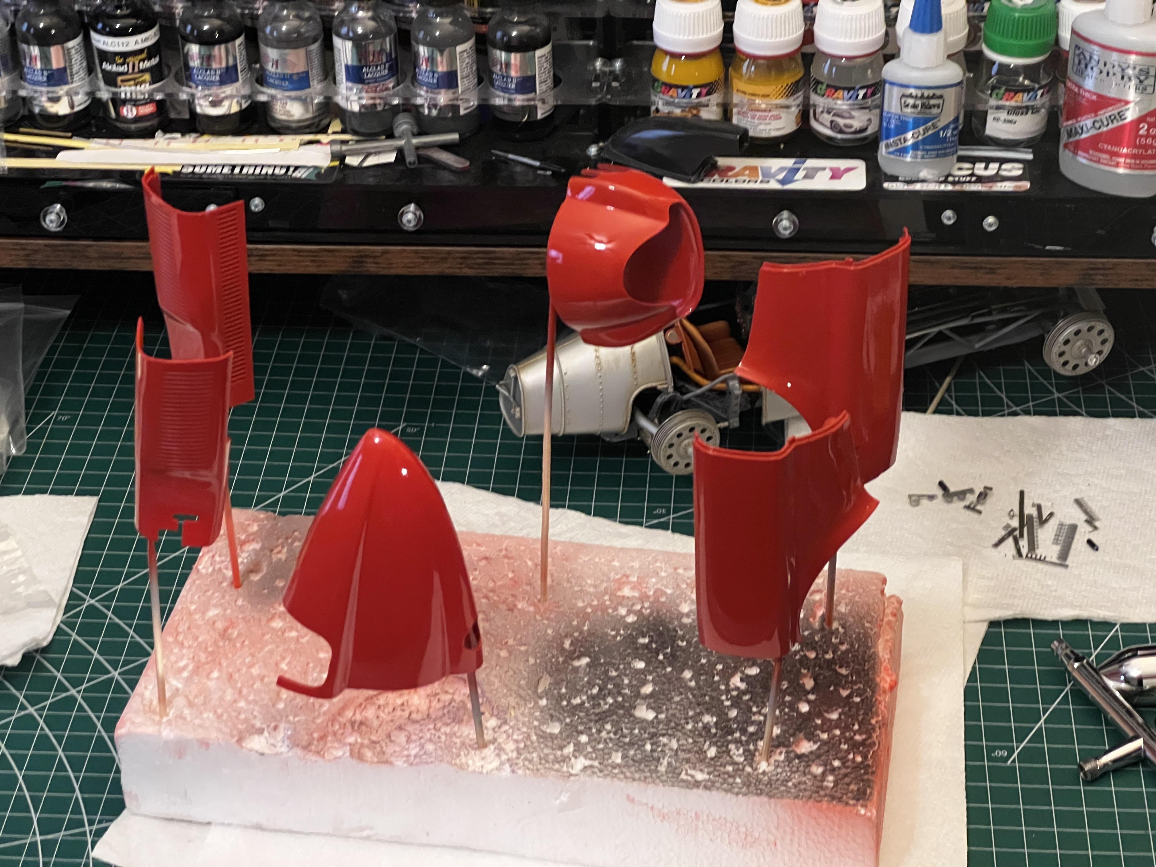

No worries Chris, we know you haven't been slacking. You obviously won't need to polish that paint.
We do have an issue though. Would you please mess up your work bench a bit.... if you really want to belong... lol
  • Haha 2
So Chris........when the paint lays down that beautifully, describe for me the size of the smile on your face and how long it lasts.  That's gorgeous.   cheers, tim
