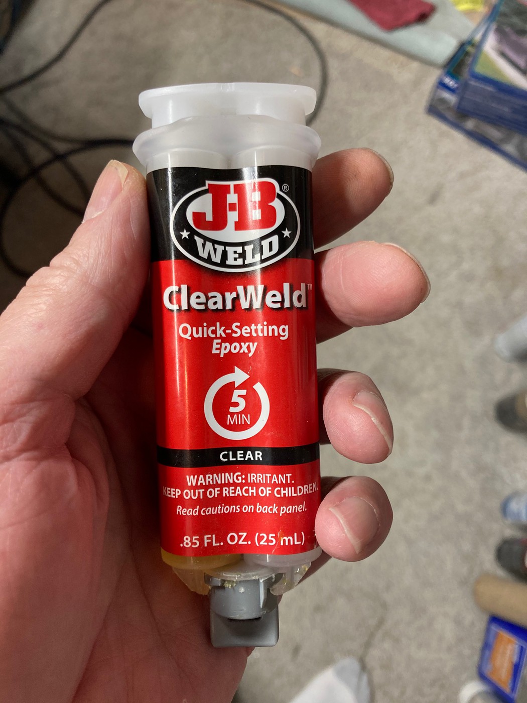

StevenGuthmiller Posted March 12 Posted March 12 (edited) I use 2 part epoxy. I mix a little and put a dab on the body with a tooth pick. Then I let it set up for ten minutes or so to tack up. Once it has tacked up sufficiently, you can stick the part onto the glue and it will pretty much stay where you put it, yet there will still be enough viscosity where it can be positioned if needed. That said, I pretty much pin all of those parts now. It’s just a lot easier and more secure. Oh, and by the way, always apply the glue to the surface that the part is to be glued to and not the part. That way, if you happen to slip and drop the part, you’re not going to wind up with a glue smear down the side of a quarter panel. Steve Edited March 12 by StevenGuthmiller 1

StevenGuthmiller Posted March 12 Posted March 12 On 3/12/2025 at 1:31 PM, peteski said: 10 minutes? You are the likely not using 5-minute epoxy because in my experience after 10 minutes while not fully hardened it is hardened enough not to adhere to anything. Expand The epoxy that I use is a "5 minute" epoxy, but it takes longer than that to tack up to the point of being able to hold the part without slipping. As a matter of fact, I'll often let it sit for longer. (maybe 15 minutes) I'll gauge progress by checking the viscosity of the glue that's left on the card, and when it feels right, I'll install the part. Steve

peteski Posted March 12 Posted March 12 On 3/12/2025 at 4:22 PM, StevenGuthmiller said: The epoxy that I use is a "5 minute" epoxy, but it takes longer than that to tack up to the point of being able to hold the part without slipping. As a matter of fact, I'll often let it sit for longer. (maybe 15 minutes) Expand Interesting. That is not my experience with 5-minute epoxies (I'm currently using Devcon brand, but I have used multiple brands in the past, but not JB Weld). While it does take longer to set in cooler ambient temperature (my workshop is currently at 59 deg. F) even then, after 10 minutes mine would be gelled enough not to be able to push the emblem into it. Anyway, forget I mentioned it. If someone waits too long, at least in that stage the gelled epoxy can be easily peeled off the surface of the model for another attempt.
NOBLNG Posted March 12 Posted March 12 (edited) With the Permatex 5 minute epoxy that I use, I would expect that I could wait no longer than 3 minutes +/- before it would be too “set” for any part to be added. If I was to use this method, I would mix up a test batch, spread a thin line out and try every 15 or 30 seconds (assuming 5min epoxy) to stick a piece of sprue to it. Record the results so you know what wait time is optimal. I’m pretty sure Steve must have done this? Edited March 12 by NOBLNG
StevenGuthmiller Posted March 12 Posted March 12 On 3/12/2025 at 8:24 PM, peteski said: Anyway, forget I mentioned it. If someone waits too long, at least in that stage the gelled epoxy can be easily peeled off the surface of the model for another attempt. Expand Well, as I said, with this particular product, (and I use it all of time) it definitely takes longer than 5 minutes to begin to tack up. I'll usually set the timer on my phone for somewhere around 10 minutes after applying the glue and then leave the shop. After that initial time, I'll return and periodically check the glue remaining on the card until it feels right. Strangely enough, in most cases, the glue on the card will actually set quicker than the glue on the parts, so I generally have additional time. I suppose the quicker set time on the card is probably due to absorption as I just use pieces of regular cardboard. Steve

peteski Posted March 12 Posted March 12 On 3/12/2025 at 8:51 PM, StevenGuthmiller said: Strangely enough, in most cases, the glue on the card will actually set quicker than the glue on the parts, so I generally have additional time. I suppose the quicker set time on the card is probably due to absorption as I just use pieces of regular cardboard. Expand 2-part epoxy adhesive hardens (polymerizes) due to a chemical reaction between part A and B, regardless of whether it sits on a non-porous surface or gets partially absorbed into the cardboard. For mixing epoxy I use a small piece of plastic with masking tape placed on top. Masking tape surface good for mixing epoxy and I can easily remove discard and replace the masking when the remains of the glue harden.

StevenGuthmiller Posted March 13 Posted March 13 On 3/12/2025 at 9:52 PM, peteski said: 2-part epoxy adhesive hardens (polymerizes) due to a chemical reaction between part A and B, regardless of whether it sits on a non-porous surface or gets partially absorbed into the cardboard. For mixing epoxy I use a small piece of plastic with masking tape placed on top. Masking tape surface good for mixing epoxy and I can easily remove discard and replace the masking when the remains of the glue harden. Expand Well, whatever the reason, it seems to set faster on the card than on the parts. Steve
