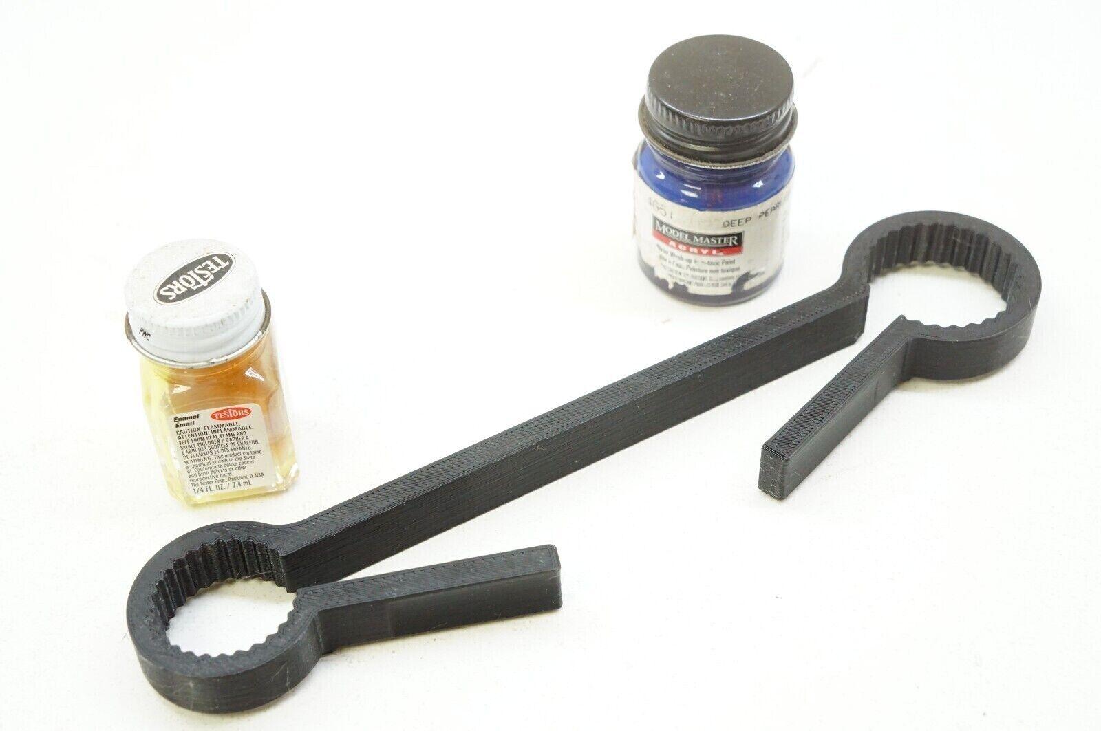

slusher Posted June 7 Posted June 7 tMy wife has a sheet of somethimg like rubber that helps open jars I have used it on paint jars. I have a set of channel lock plyers that I use also.. they are small an fit in my pocket..
slusher Posted June 7 Posted June 7 https://www.ebay.com/itm/325372061702 Then ther are thes on eBay for 7 dollar and some change. I am not connected to the seller I plan on buying one.. 1

stavanzer Posted June 9 Author Posted June 9 Thanks for the many helpful answers. All of these are Brand New, and have been stored upright. They have never been stored on their sides. So, I don't think there is much paint in the threads. Mostly, they are just very old. BTW, none have prices on them, and all have settled solidly. I'm going to order one of those ebay opening wrenches that was linked up above. I may spring for an Electric shaker. Any ideas which one is any good? P.S. to Dave Van. I have my Ford Script Monkey Wrench in my tool box. I'll be using it. Thanks. Thanks, Alan
