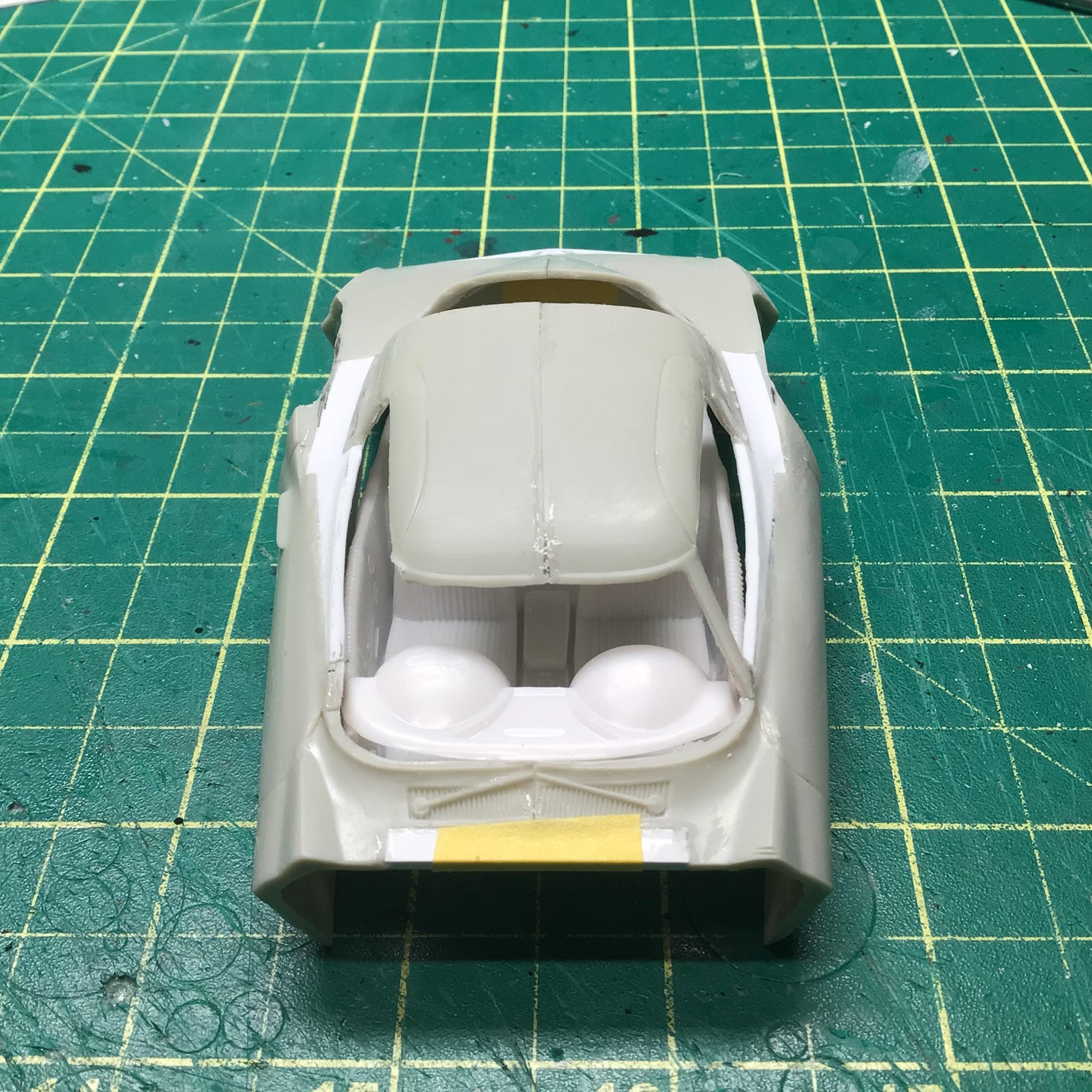

I started by narrowing it quite drastically,(too drastically😬) and then sectioned it by about 3/16”.IMG_9305.jpeg.f2f3e4bd6134aaf1cf005cdecbc3e0bd.jpeg
Then I bobbed it by about 3/8” behind the rear window.  I’ll be the first to admit that I don’t really know what I’m doing….just cutting and hacking in the direction I want to go.😳 This is where I ran into trouble because the body lines no longer line up.🙄 Abort,Abort!🤬

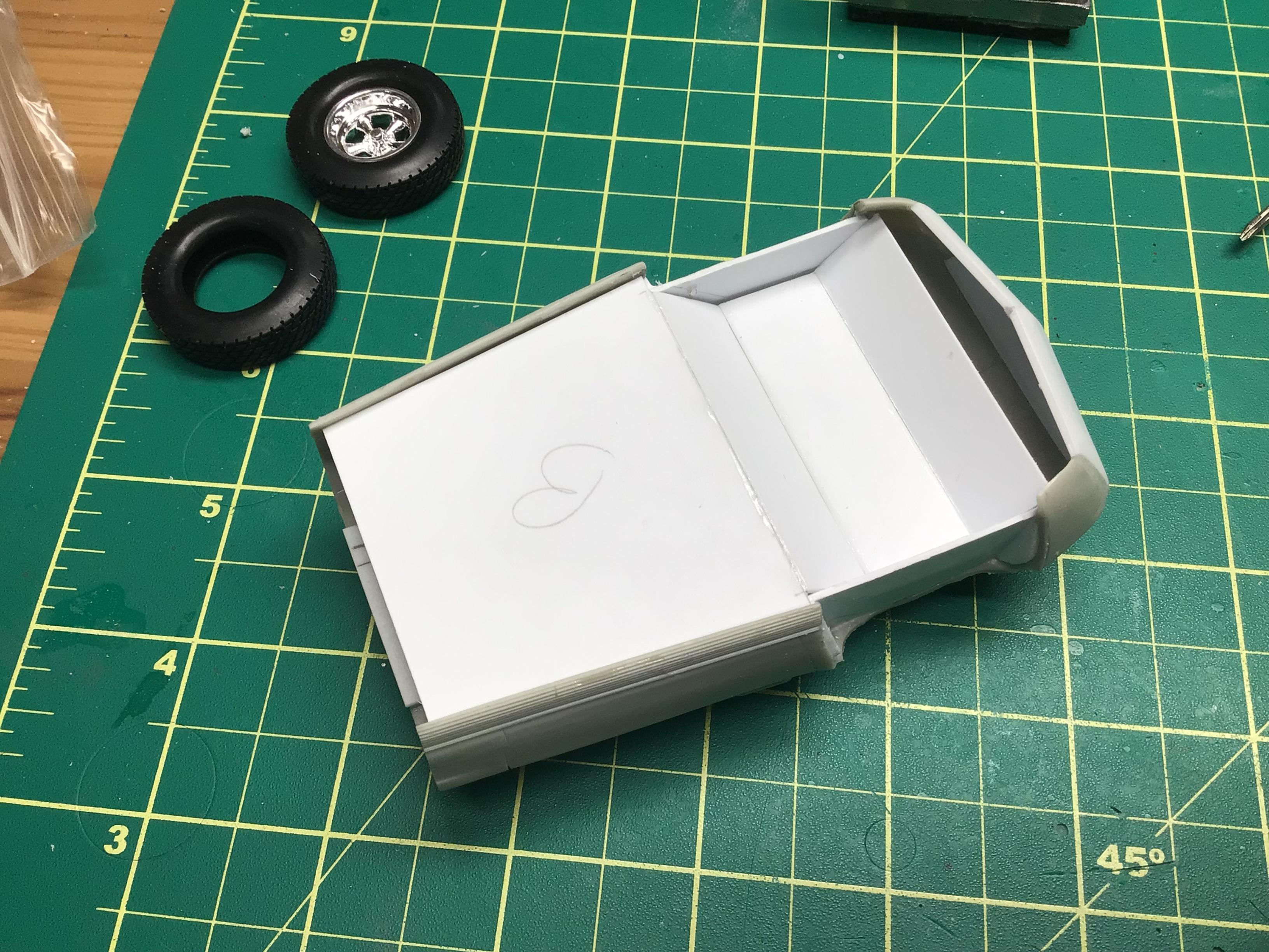

So off to the Flea market to pick up another five buck gem.🤪IMG_9333.jpeg.540df063ca126fcdf0f9ed1568a8f912.jpeg

And what a gem it was!😳 I pretty much had to hack the interior out in pieces and then grind the glass away. IMG_9334.jpeg.45cedeff599fd8488d5c20492c8c0e61.jpeg

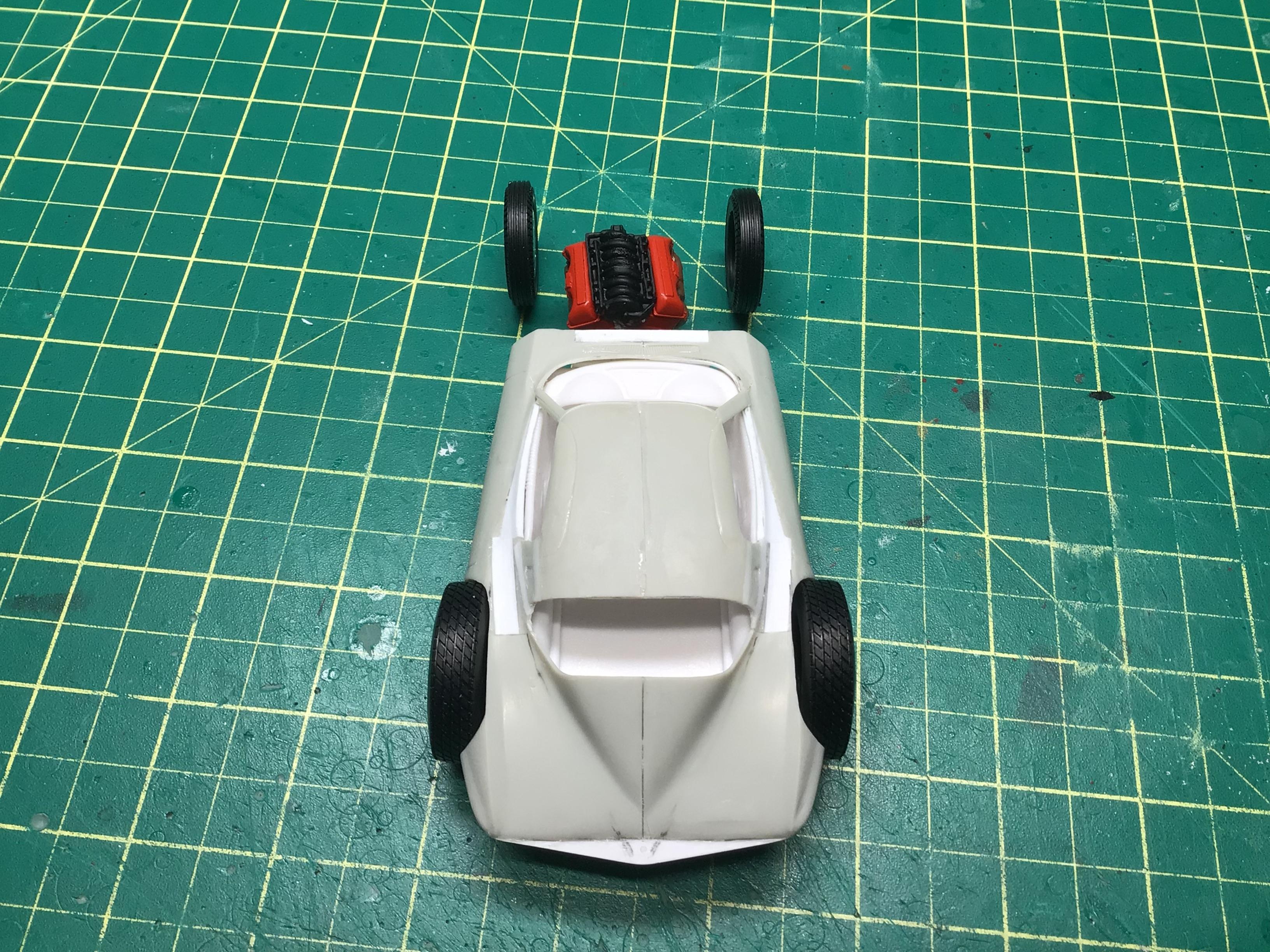

This time I shortened it at the peak of the rear fender bulge so that the body lines would line up. Kinda gives it a Cheetah look I think.😎IMG_9359.jpeg.562866175769e2fccffcf4225b8094eb.jpeg
Then enlarged the wheel well back to its former shape.IMG_9368.jpeg.8dfbbe4ab8b8adb720039fc1c31ddb8d.jpeg
I narrowed the roof so the rear window edges lined up and filled the resulting gap behind the doors, and chopped it slightly to get the roof slope to line up  more or less.IMG_9364.jpeg.79b9951b347d0eff178c74f754018f3e.jpeg
I took about a 1/4” out of the cowl and spread the A pillars to mate up with the doors again. Then added a chunk of Evergreen to each door and shaped them a bit. They may need more, but I’m going to let it sit for a bit while I ponder my next move. Thanks for looking. As always…all comments welcome.😎

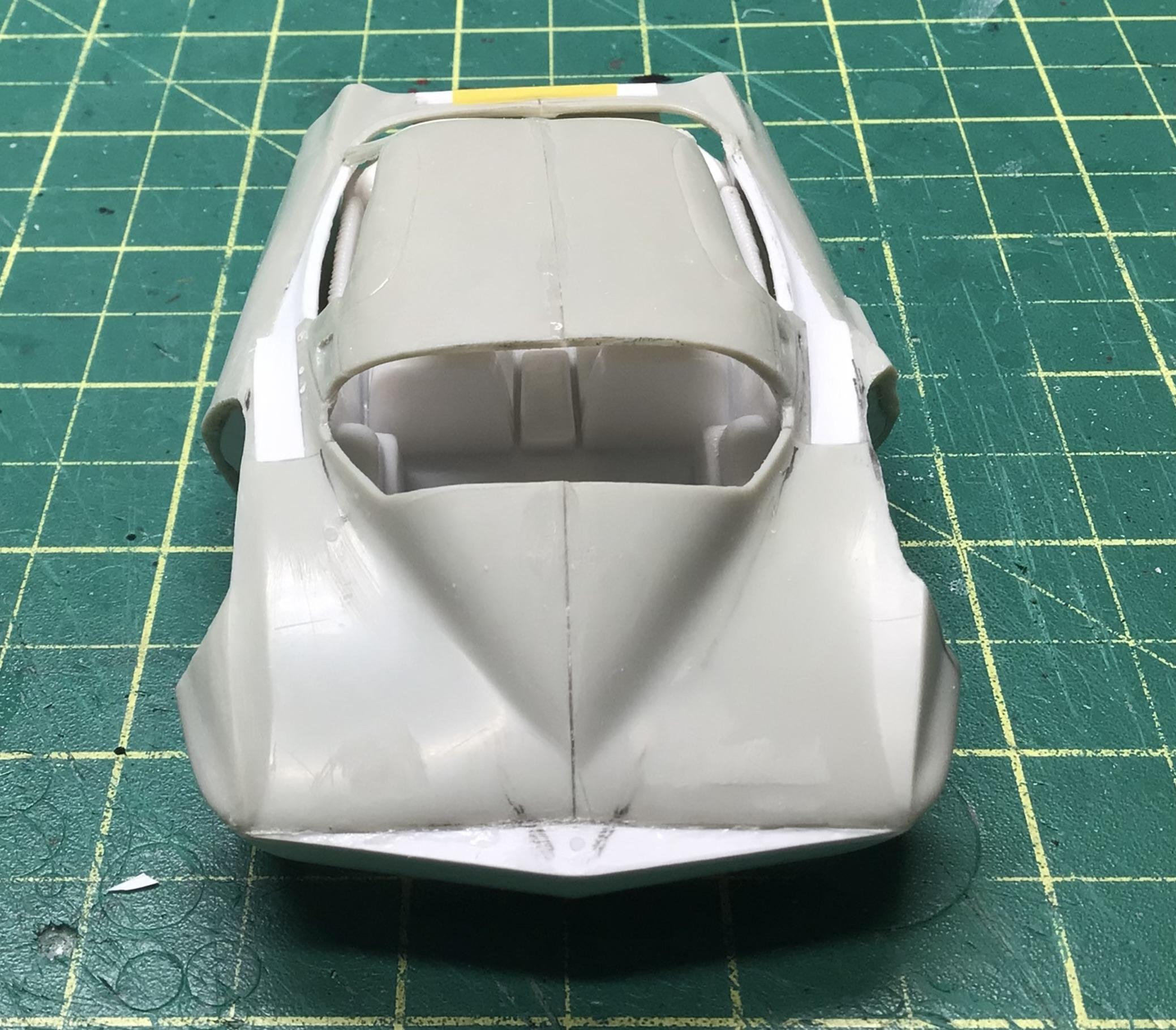

Thanks for all the compliments fellas. So I’m guessing this has a some potential after all? Glad I aborted my first attempt.😬 Today I did a little more shaping.🙂

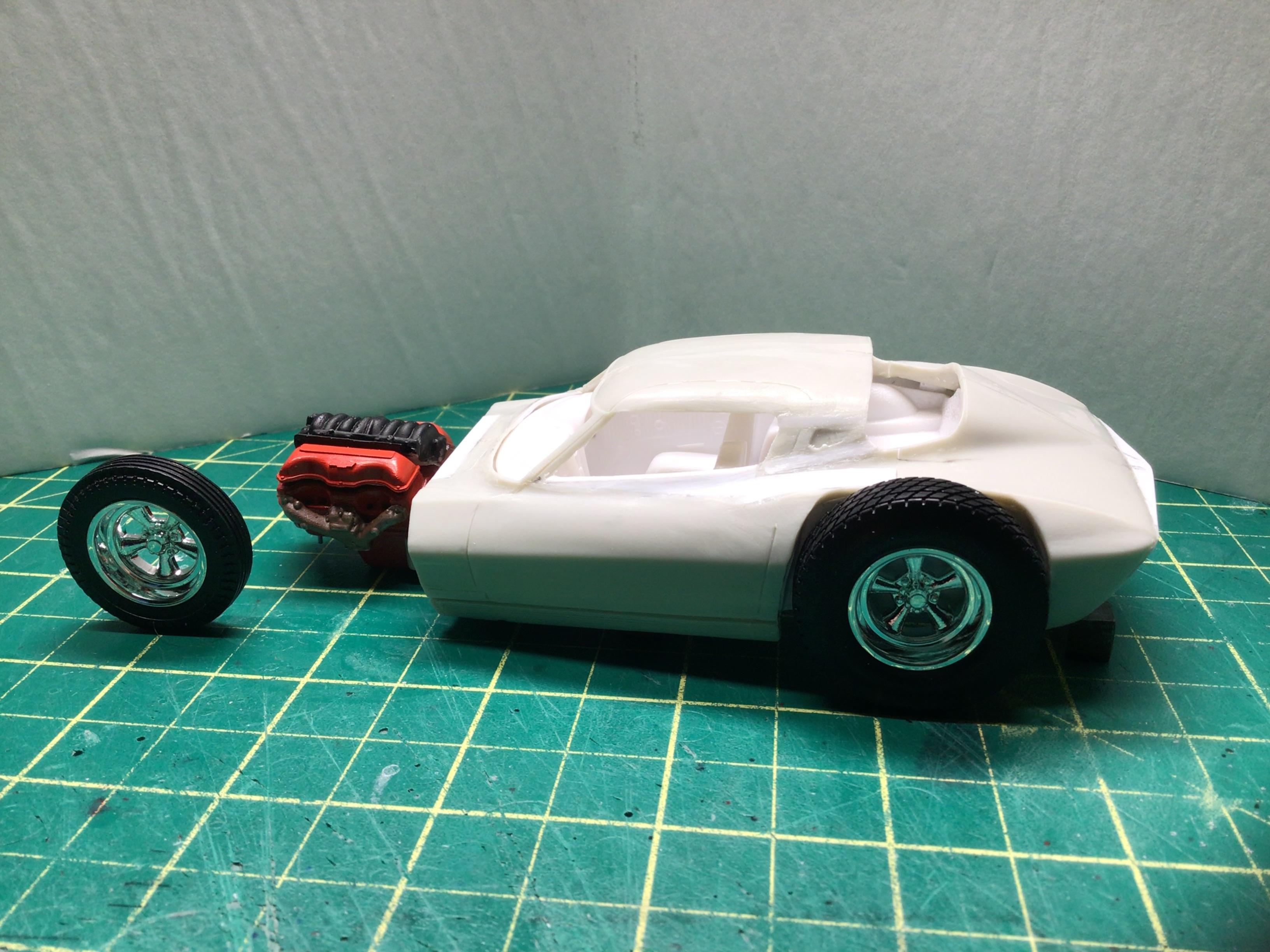

Due to my exhaustive research and diligent planning 🙄…. the 1/32 interior fits with very little modification. I had to do some grinding and I re-oriented the dash slightly. Much easier than starting from scratch.🙂
  • Like 8

I haven’t been at the bench much lately, but I am still plugging away at this once in a while. I got a floor pan partially scratched. Cut out the rear wheel openings and re-shaped the body lines a bit.  Still lots more bodywork to be done.🥵
