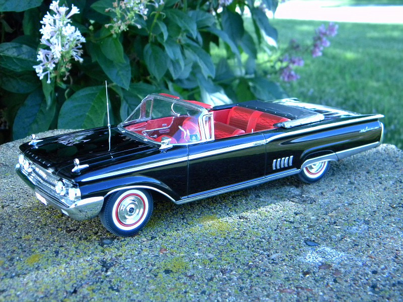

peteski Posted Thursday at 01:01 PM Posted Thursday at 01:01 PM Orange peel surface is caused by very bumpy paint surface. To make it smooth, those bumps have to be removed until the paint surface is even with the thinnest areas of the paint layer. That is why you will see lots of paint being removed. I would recommend practicing spraying or airbrushing in a way minimizing orange peel. I manage to paint my models in a way no sanding/polishing/buffing is needed. It is doable. Like this one:
