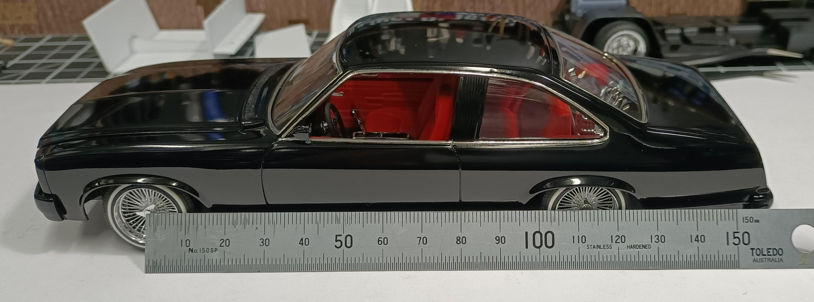

The real car's wheelbase is 111 inches.
Divide by 25, as the MPC kit is 1/25 scale.
Therefore the actual wheelbase of the kit should be 4.44 inches.

I guess this is a joke, but 1) I don't know what a "differenct" is, and 2) never in over 50 years of working on real cars have I ever seen a staggered rear axle.
And the 112 mm shown above is 4.4 inches...like I said.
