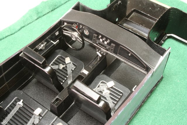

NOBLNG Posted 18 hours ago Posted 18 hours ago Great work designing it and actually building it Ken!😎 At first glance I got a Corvette vibe off of it. 1

kensar Posted 13 hours ago Author Posted 13 hours ago Seems I forgot to include some interior pics. I wanted the interior to have a early 1970s look. 2
