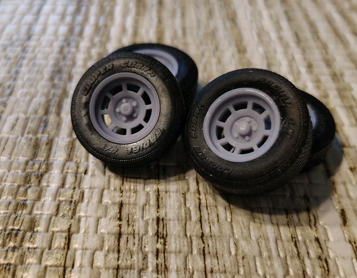

Monty Posted 21 hours ago Posted 21 hours ago First, my intention is not to slam the vendor. I've never used anything that was 3D-printed, and these C3 Corvette wheels looked decent, but the "graininess" of the tire sidewalls gives me pause. What would make them presentable as realistic tires? I couldn't imagine trying to sand that out, especially around the letters. Light coats of primer?
stitchdup Posted 20 hours ago Posted 20 hours ago you could try dusting on primer but you'd need to be very light. i'd sand between each dusting with sanding sponges at 800 grit or higher and repeat until your happy. even just a light go with the sponges might work as they look worse than they really are. maybe even a dusting of filler primer but i'd try the sponges alone first
Ace-Garageguy Posted 19 hours ago Posted 19 hours ago (edited) If it was me, I'd elect to do without the raised lettering, which I'm not much of a fan of on real cars either...unless they're period Dunlop or Goodyear or Firestone racing tires. Advertising for somebody on my street ride doesn't appeal to me, I don't care if everybody knows I paid a lot for "name" tires, and so many of the tire names and texts are just dork-o-tronic anyway. After sanding the lettering off, I'd primer and sand as usual, probably masking the tread edges so they wouldn't get filled too. Edited 19 hours ago by Ace-Garageguy punctiliousness 1
mcs1056 Posted 18 hours ago Posted 18 hours ago Personally, I'd return them. I've said I would be unlikely to buy 3D stuff too often. These look unsalvageable. You paid for Cooper tires with those wheels. Even the lettering is bad. If you're so happy with the wheels, it may be a different story. However, those tires are, in my opinion, not good enough. That is, of course, unless the were presented as shon and you still bought them.
Monty Posted 17 hours ago Author Posted 17 hours ago 1 hour ago, mcs1056 said: Personally, I'd return them. I've said I would be unlikely to buy 3D stuff too often. These look unsalvageable. You paid for Cooper tires with those wheels. Even the lettering is bad. If you're so happy with the wheels, it may be a different story. However, those tires are, in my opinion, not good enough. That is, of course, unless the were presented as shon and you still bought them. I haven't bought them, I was just sniffing around for model stuff on eBay when I came across them. TTBOMK, no kit manufacturer offers raised letter Cooper Cobra tires, so I was intrigued until I saw the sidewalls. If I decide I really need Cooper Cobras for a build, I can always get sidewall decals from Fireball Modelworks. My query here was just to find out if these could be easily salvaged.

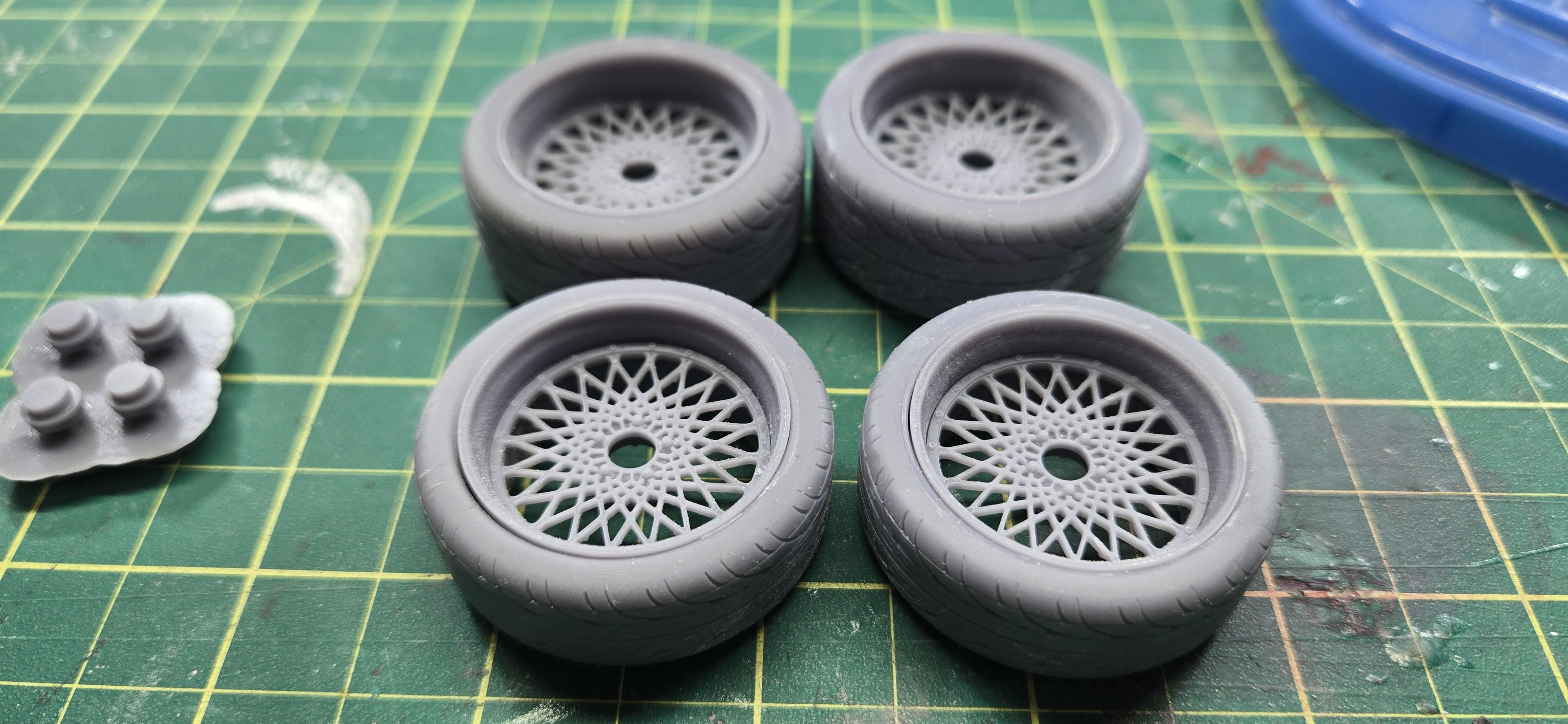

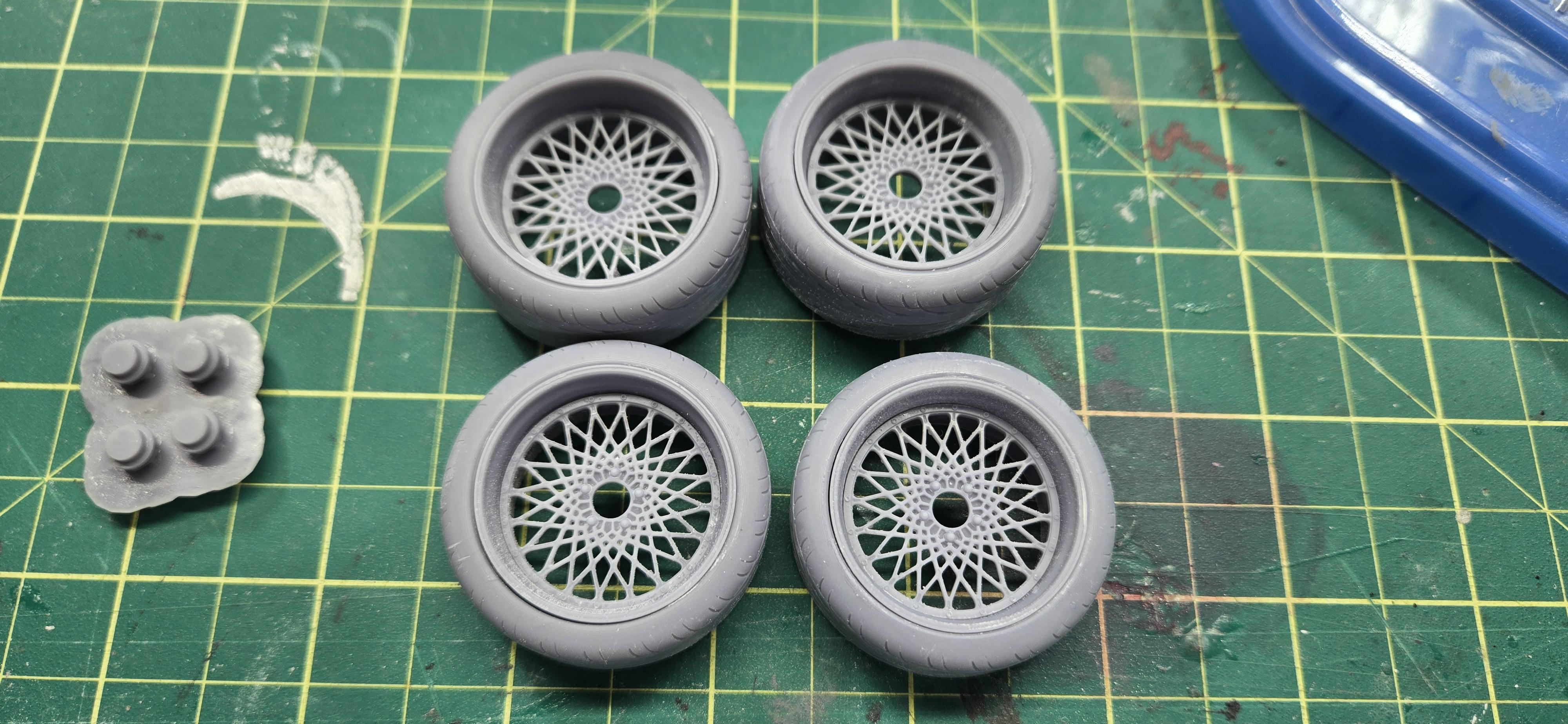

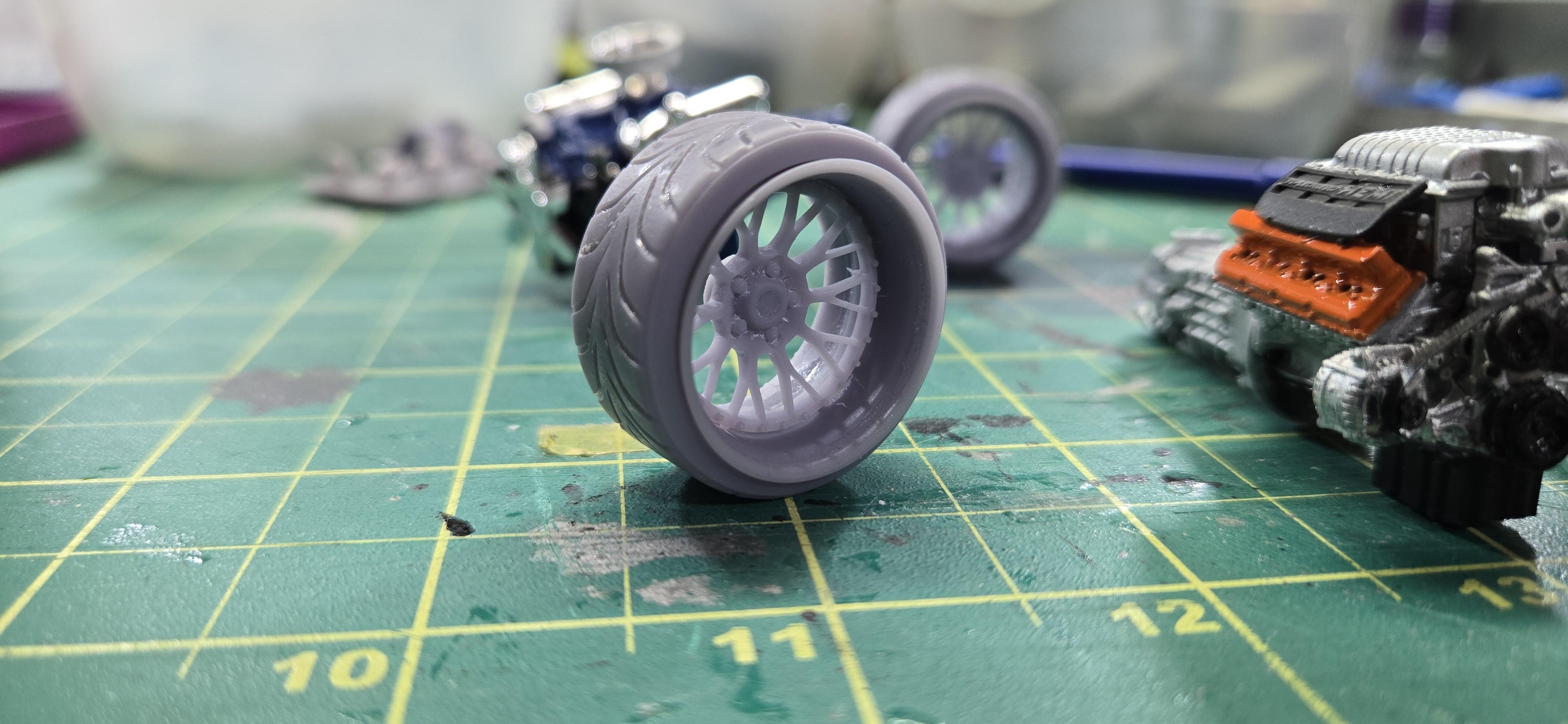

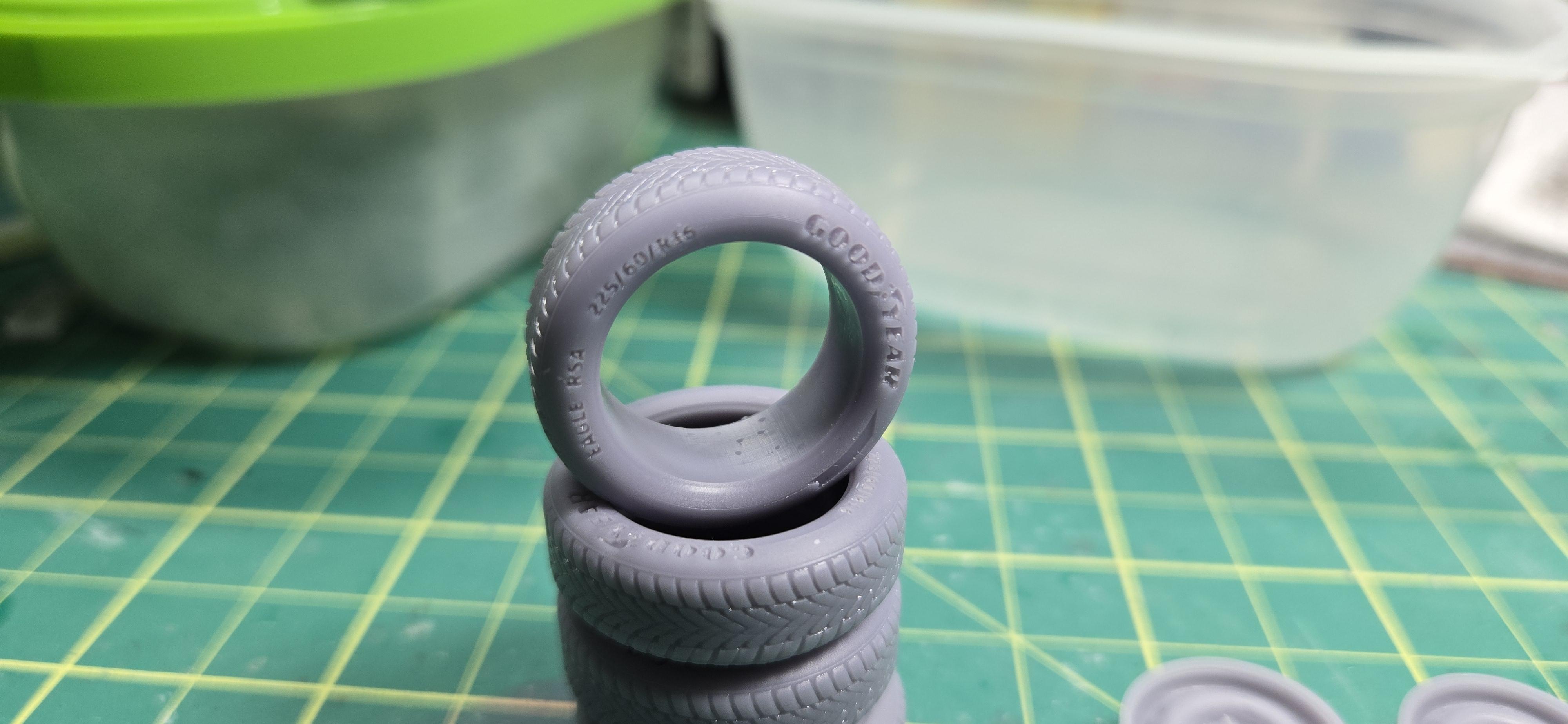

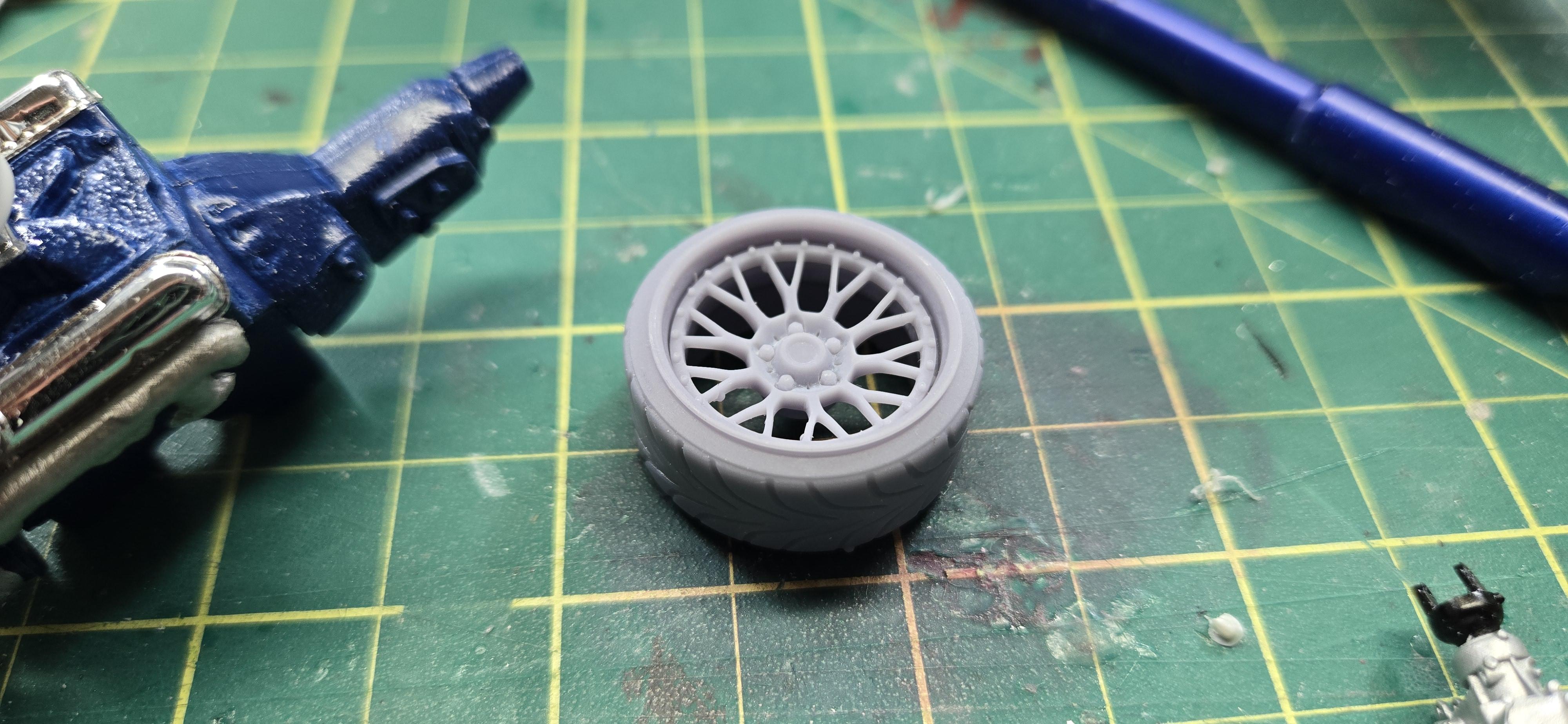

iamsuperdan Posted 3 hours ago Posted 3 hours ago 13 hours ago, Swamp Dog said: their is nothing you can do if you want the raised lettering. that is just the way 3D printing looks. you gotta sand it. if you buy them do as Bill said said.. Will respectfully disagree with you here. Layer lines can be virtually non-existent, depending on how thick you make each layer, and how you position the print on the build plate. Here are some recent prints, prior to any sort of cleanup. You still need to do a little sanding and cleaning, but I don't think there's any excuse for a vendor to be selling prints with layer lines as pronounced as the OP's example. 1
