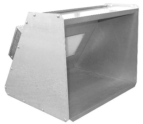

Drake69 Posted February 20, 2015 Posted February 20, 2015 I have the Paasche HSSB-22-16, and back when I got it Amazon had it for sale at $150 plus shipping... http://www.amazon.com/Paasche-HSSB-22-16-Hobby-22-Inch-18-Inch/dp/B0038DANR6/ref=sr_1_1?ie=UTF8&qid=1424461445&sr=8-1&keywords=paasche+hssb-22-16 Definitely worth it if you can get it on sale for close to that price. Only caveat is there's no lighting inside it, but an LED strip and some velcro works wonders.

Skip Posted February 21, 2015 Posted February 21, 2015 (edited) I have the Paasche HSSB-22-16, and back when I got it Amazon had it for sale at $150 plus shipping... http://www.amazon.com/Paasche-HSSB-22-16-Hobby-22-Inch-18-Inch/dp/B0038DANR6/ref=sr_1_1?ie=UTF8&qid=1424461445&sr=8-1&keywords=paasche+hssb-22-16 Definitely worth it if you can get it on sale for close to that price. Only caveat is there's no lighting inside it, but an LED strip and some velcro works wonders. I've got the Paasche HSSB 22-16 booth and am happy with it too, used cheap LED strip lights on the sides works well. Picked mine up at Coast Airbrush a while ago when I was in Southern California, no idea what the freight would have been, it's all sheet metal so it's heavy package. Don't think Coast carries the Pace Booths or not, this was the one Dave Monnig recommended for the type of stuff I paint. Edited February 21, 2015 by Skip
