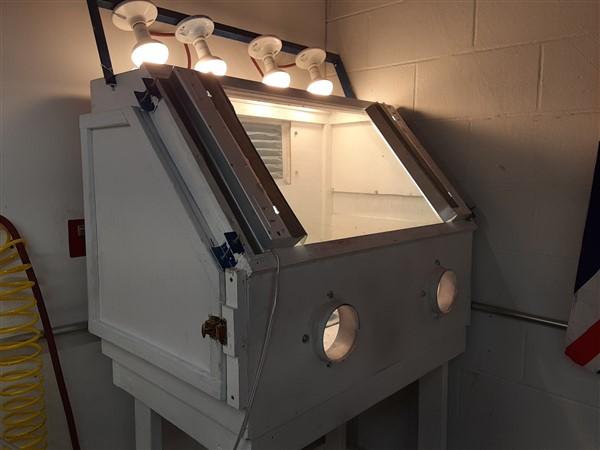

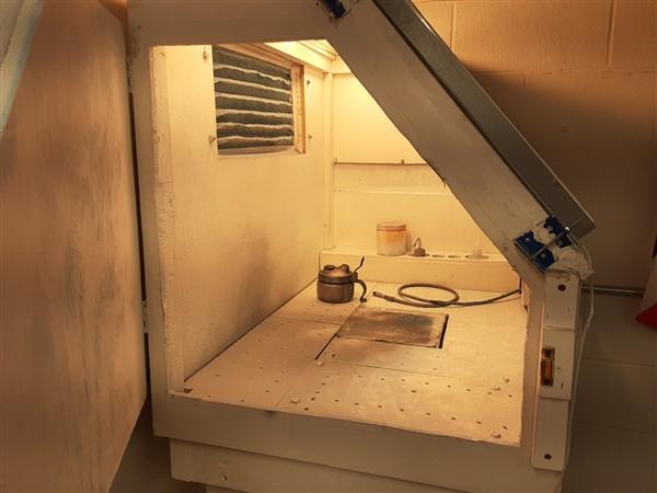

Miatatom Posted November 28, 2020 Posted November 28, 2020 Hey Mike! I've got a Harbor Freight compressor with a small tank. I usually set my pressure at about 21.5 and it'll drop to 20 when I'm spraying. I built this booth for less than $250, including the bilge blower and connecting ducting. It's on legs and casters to roll it around when cleaning.

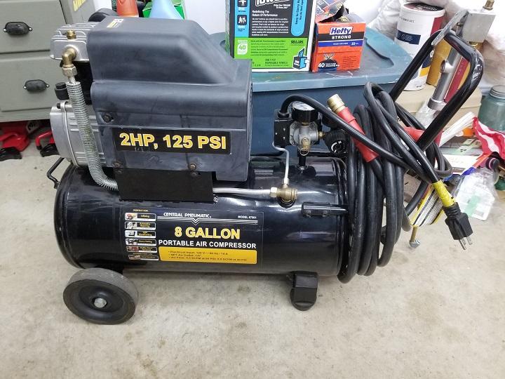

Dave G. Posted November 29, 2020 Posted November 29, 2020 Mike, My Paasche H will drop the pressure about 1- 1/1/2lb fwiw.. I use an 8 gal portable compressor. The key is whatever the drop is that it holds there, you don't want to see a continual falling off. You don't want a drop from say 21lb to 20 or to19-1/2 that only holds a few seconds and starts dropping more to 14, 12, 10. You gotta be able to maintain flow once the initial drop occurs. That's expected, it's called working pressure vs static pressure. Static pressure is what you set you gauge to before flowing air. Working pressure is what you get with air flowing. You should be able to set the gauge so you compensate for the loss by cracking the pressure up that little bit ( if you need to). If you can't then your compressor is inadequate or you got air leaks someplace. I typically mix my paints to flow well at around 18-20 psi flowing. Enamel I might bump up a bit more and lacquer a bit lower, sometimes quite a bit lower. I shoot all my acrylics the same, I just thin them to flow where I like it. Thick paint obviously uses typically larger needles and higher pressure, thin paints smaller needles and lower pressures. Nuff said here, over and out.
